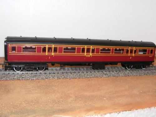

Noel Posted October 28, 2014 Posted October 28, 2014 (edited) Another old rolling stock item dug out from storage Please don't slag too much My first repaint to CIE colours - over four decades ago when I was about 12 or 13 I was desperate to have some Irish trains to run so decided to repaint my LMS train set coaches Hand painted Triang LMS coach - I actually remember mixing multiple samples of humbrol paints and test patches to try and get a reasonable CIE tan colour. Can't believe I hand painted the white lining - My hands couldn't manage that anymore. It used to look like this LMS toy coach - a lot better (not my photo) The actual body shell seems a prototypical botch job, a sort of mk1 shell with makey up side panels pretending to be old world LMS. Don't think any such coach actually ever existed. What will I do with this now? Could convert it into an imaginary presidential coach. I vividly remember seeing President Childers sitting comfortably in an armchair on the then presidential coach about to depart Heuston station some time in the early 1970s, but that was a much earlier style coach and shorter. Edited July 21, 2017 by Noel

Noel Posted March 29, 2017 Author Posted March 29, 2017 Another old rolling stock item dug out from storage Please don't slag too much My first repaint to CIE colours - over four decades ago when I was about 12 or 13 I was desperate to have some Irish trains to run so decided to repaint my LMS train set coaches Hand painted Triang LMS coach - I actually remember mixing multiple samples of humbrol paints and test patches to try and get a reasonable CIE tan colour. Can't believe I hand painted the white lining - My hands couldn't manage that anymore. It used to look like this LMS toy coach - a lot better (not my photo) The actual body shell seems a prototypical botch job, a sort of mk1 shell with makey up side panels pretending to be old world LMS. Don't think any such coach actually ever existed. What will I do with this now? Could convert it into an imaginary presidential coach. I vividly remember seeing President Childers sitting comfortably in an armchair on the then presidential coach about to depart Heuston station some time in the early 1970s, but that was a much earlier style coach and shorter. A bit of fun comparing re-paints. 1974 brush painted (not 100% sure if it was 1972 or 1974) 2017 recent respray training Both side by side. Recent 2017 respray to CIE livery on left, 1974 hand repaint to CIE livery on right

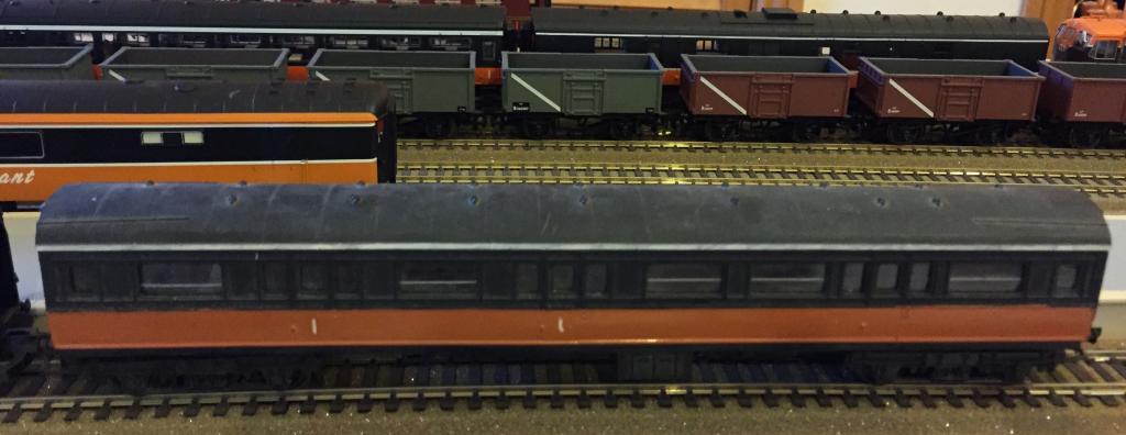

Noel Posted March 29, 2017 Author Posted March 29, 2017 Well done Noel, you dug up some interesting photos, mind telling me exactely how you got that white line looking sooooo good, TIA. Paul Which white line? If the 1972 model - paint brush in the steady hands of a child with a child's eye sight to match, if the 2017 model, reverse masking using 2mm tape.

burnthebox Posted March 30, 2017 Posted March 30, 2017 Which white line? If the 1972 model - paint brush in the steady hands of a child with a child's eye sight to match, if the 2017 model, reverse masking using 2mm tape. Well Noel to begin I have to say a quick look at the pc of the two side by side sees YOU ON TOP of the old coach, PAINT BRUSH IN HAND doing what you do best now I know nothing about Reverse Asking Tape !!! Can you explain please, Paul
Noel Posted March 30, 2017 Author Posted March 30, 2017 Well Noel to begin I have to say a quick look at the pc of the two side by side sees YOU ON TOP of the old coach, PAINT BRUSH IN HAND doing what you do best now I know nothing about Reverse Asking Tape !!! Can you explain please, Paul Well Paul, I know little myself about 'reverse asking', but it sounds like a technique how I get out of something my dear wife has asked me to do around the house! Now as to 'reverse masking' I only picked up this tip myself recently from some of the talented and experienced folk on the forum and over on RMweb. Basically instead of two parallel masks to create white stripe (very difficult to keep absolutely straight and parallel), use one piece of masking exactly the width of the required strip to cover over white paint already applied, paint over the lot (reverse masking the white to keep addicted colour off it). Hope this makes sense. 1. Spray white paint roughly where it will be on the model (no masking needed) (top coach) 2. When dry (48hrs) put masking tape over the white paint where the stripe will be (bottom coach) 3. Then air brush the model including over the masking tape which is hiding the white (you can just see the tape under the black on this pic) 4. After about 4 hours of drying pull off the thin masking tape strip to reveal the white under neath
Dhu Varren Posted March 30, 2017 Posted March 30, 2017 To save one lot of masking, after masking off the white why not spray the tan colour first before the black, then all you have to do is mask the tan and spray the black.
burnthebox Posted March 30, 2017 Posted March 30, 2017 To save one lot of masking, after masking off the white why not spray the tan colour first before the black, then all you have to do is mask the tan and spray the black. Well DV I thought that's what he did !!! But then what do I know, I'm sure he'll be on here very soon to tell, ths is great fun finding out how to spray, & I don't have a spray gun setup.... but the cans used correctly can ( no pun ) do the job...
Dhu Varren Posted March 30, 2017 Posted March 30, 2017 Well DV I thought that's what he did !!! But then what do I know, I'm sure he'll be on here very soon to tell, ths is great fun finding out how to spray, & I don't have a spray gun setup.... but the cans used correctly can ( no pun ) do the job... No BTB, what Noel did was:- 1. Undercoat the coach with grey primer. 2. Spray white at the top of the coach. 3. Mask the white with narrow masking tape. 4. Mask the bottom grey below the windows with masking tape. 5. Spray window area and roof with black. 6. Remove all masking tape to leave white top, black window surrounds, black roof, and grey bottom. 7. Mask the bottom of the black below the windows. 8. Spray the tan. 9. Remove the masking to reveal a very neat finish to the coach. My suggestion was to do steps 1 to 3 & miss out step 4. 5. Spray the tan to give a good even coat on the bottom of the side. 6. Mask the top of the tan below the windows, and spray the black on the side & roof. 7. Remove all the masking to reveal a very neat finish to the coach. The same excellent result with one less masking step.
Noel Posted March 30, 2017 Author Posted March 30, 2017 No BTB, what Noel did was:-1. Undercoat the coach with grey primer. 2. Spray white at the top of the coach. 3. Mask the white with narrow masking tape. 4. Mask the bottom grey below the windows with masking tape. 5. Spray window area and roof with black. 6. Remove all masking tape to leave white top, black window surrounds, black roof, and grey bottom. 7. Mask the bottom of the black below the windows. 8. Spray the tan. 9. Remove the masking to reveal a very neat finish to the coach. My suggestion was to do steps 1 to 3 & miss out step 4. 5. Spray the tan to give a good even coat on the bottom of the side. 6. Mask the top of the tan below the windows, and spray the black on the side & roof. 7. Remove all the masking to reveal a very neat finish to the coach. The same excellent result with one less masking step. Hi Dhu Varren. Thanks, that's another really great tip. Will try next time. I only thought of it afterwards. One thought did cross my mind though was had there been any masking bleed, would it have been easier for me to touch up the black or the tan colour with a paint brush afterwards (i.e. black being darker)? A very tricky one is now facing me, to add both tippex white lines to a mk2d super train EGV to convert it to IE/IR EGV livery. The white lining is only 3" in real life which would be 1mm in 1/76 scale. It looks like I will have to remove the roof and all the black grip rails and handles from the coach sides. It will be tricky to use two masking tapes and leave exactly 1mm between them. Reverse masking not an option as the coach is already painted, but if I make a dogs ear of it, I'll have no option but to do a full respray, and then reverse mask using 1mm tape will come into play (and while I'm at it paint the correct deeper shade of orange for ST era). Noel
