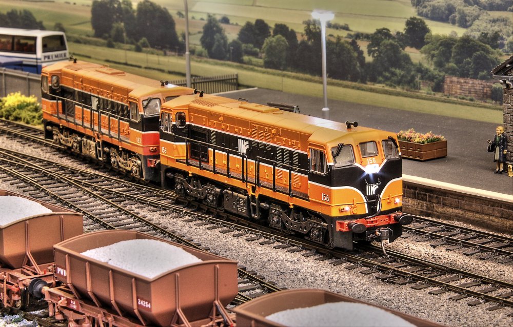

2 hours ago, Dr Gerbil-Fritters said:
what chip/speaker combo is that?  sounds different to both of mine (which sound different to each other!)
Its a free download sound file from ESU with a Irish horn style added. I just edited myself. The speaker is also upgraded from the standard one.
Edited by NIRCLASS80
