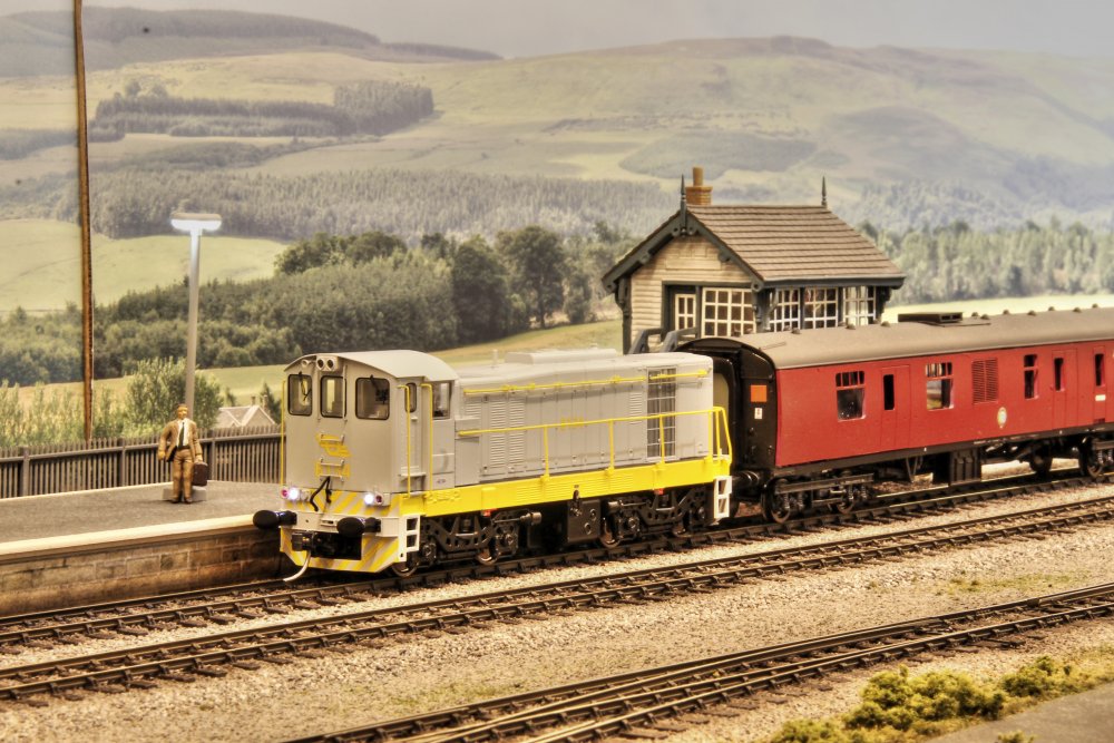

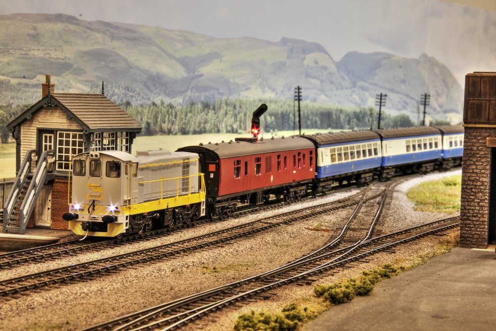

Super sequence, love the prototypical driving. The 3173 BCK looks great, love the see through grills. Are they part of a detailing kit you sourced? Did you respray a few cravens to match the RPSI set. A rake of six looks well. Noticed some of the coaches didn't have the MM/RPSI wobble. Trackwork looks epic. Class all round. 👍
Link to comment
3173 is a Bachmann Mk1 with brass overlays fitted and sprayed with BR maroon and transfers fitted from Railtech.
Still work required to beef up the underframe. It’s more a model to represent the van rather than an accurate model with exact details.  Here’s a link to the brass sides.
https://www.mousa.biz/fourmm/coach/sides/CIE/cie_sides4.html#cie-mk-1-steam-heat-boiler-van
Thanks for the positive comments

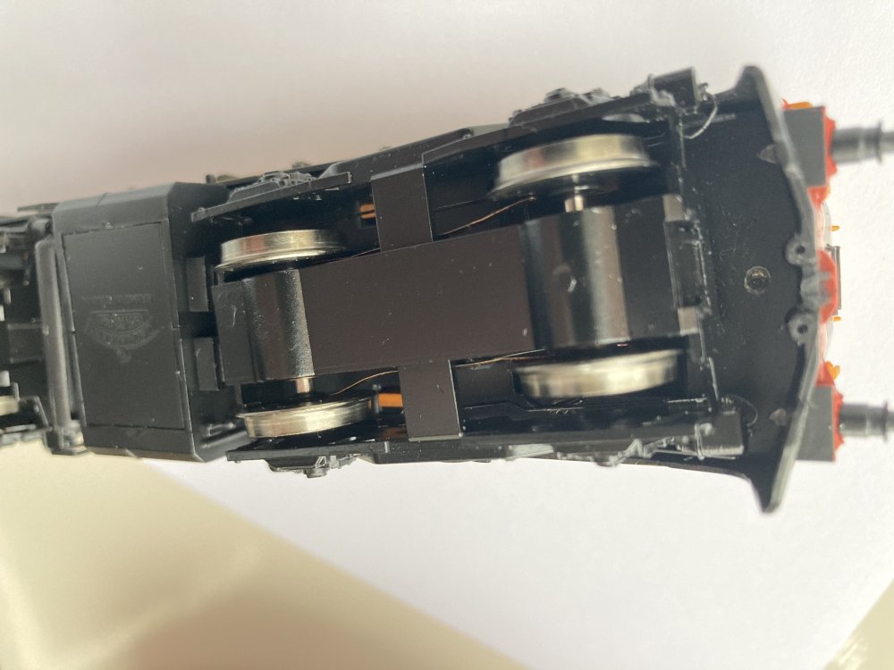

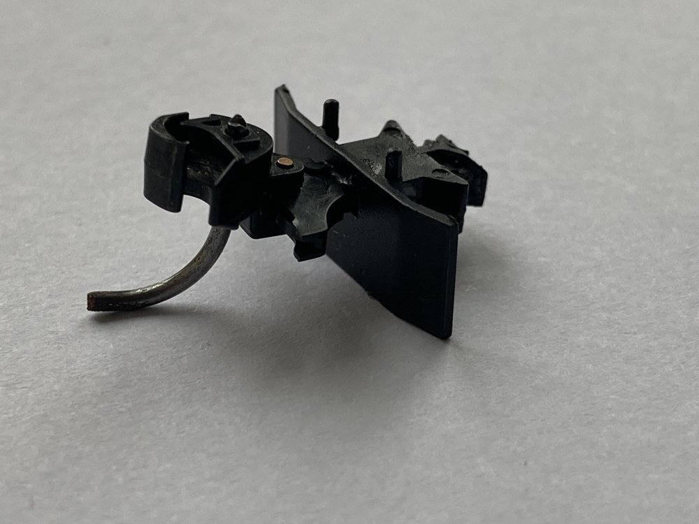

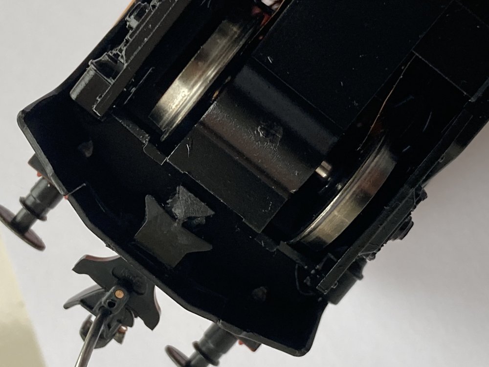

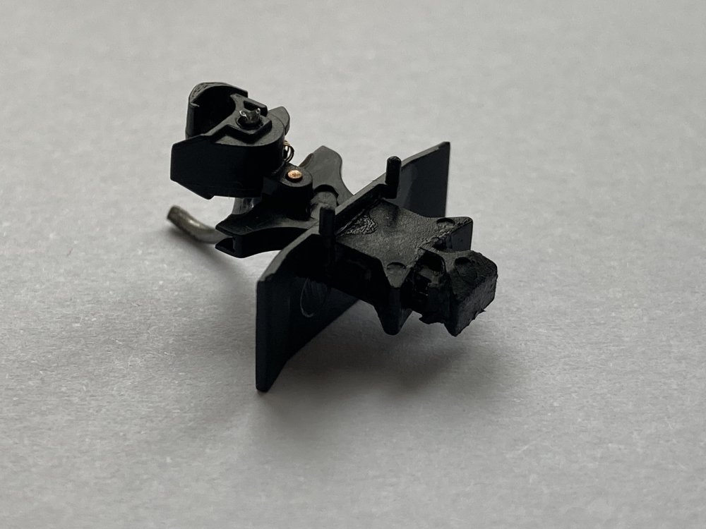

43 minutes ago, irishthump said:
Yes please! I've done the same with my locos but I'm always interested in any techniques I can steal!
Ok here goes. Firstly one word of caution is that this worked ok for me on my layout with a minimum radius of 24inches.
Cut off coupling mount from the locomotive’s bogie.
Then take the valance in the detail pack and cut a small slot.
Then glue a NEM coupler pocket to the back of the valance in line with the slot.
Once the glue is dried fit the Kadee NEM style coupler.
Then fit to loco. I haven’t glued this to the loco and so far haven’t had any issues.
Hope the photos make this all clear.
Total time 30 minutes both ends.
  • Like 7
  • Informative 2
Link to comment

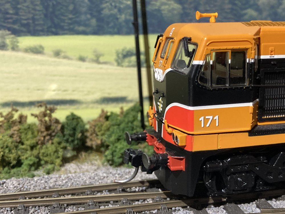

That's nice, neat work. My version was a little more involved
That's neat work. My own method was a but more invoved...
Like you mentioned I was'nt confident the NEM couplers would pivot enough for tighter curves so I installed draft box Kadees instead.
Link to comment
