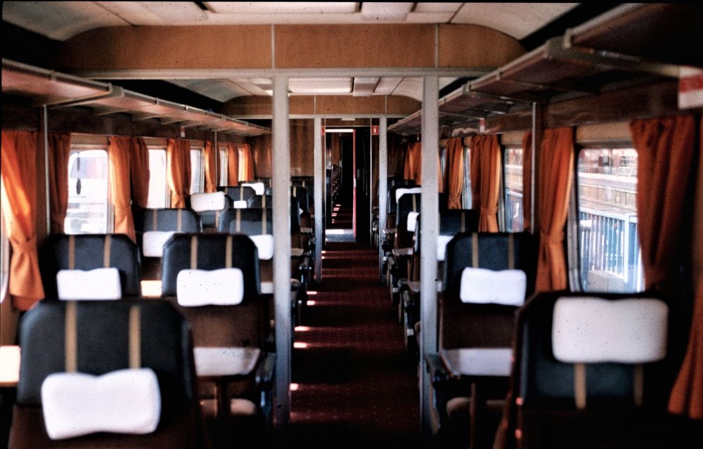

No problem. I have scans of the as-built internal layouts if it helps at all.
And as I omitted it above - the composites were converted at various dates. 4 initially in April/May 1973. Then another 1 in 1989 leaving 3. One of the 1973 conversions was then converted back to composite by 1993.
When Sligo became standard class only again the remaining 4 were gradually converted to Standard. The last was 5156 which was still a composite internally as late as May-2005 by photo evidence.
2 minutes ago, flange lubricator said:
5106 Full First
Magnificent, don't suppose you've one of a Compo?
