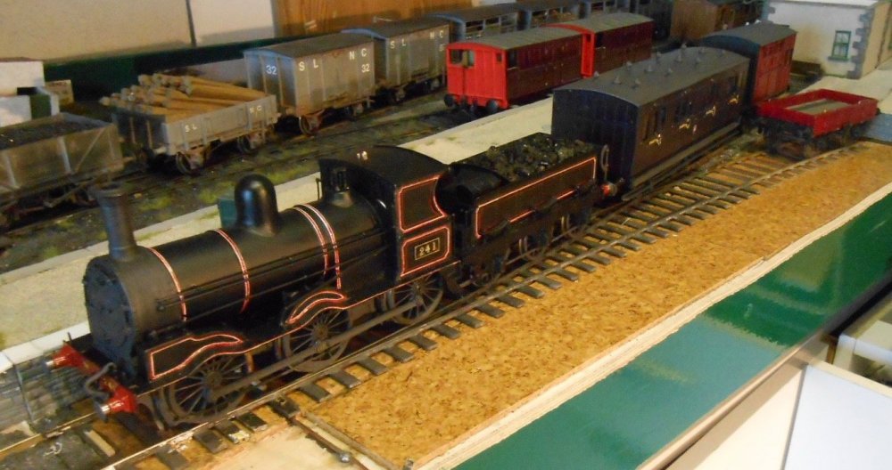

Couldn't have done it without your help, JB. However, to my eyes, the boiler bands need toning down a bit, so the red stripe is wider and the white either side less prominent. That's how it appears in  black and white pictures anyway. Want to do the inner, fine red line on cab and tender too.
 Buffer beam number, a bit of light weathering - this is depicting an almost new loco - then a spray of satin varnish and that should be it. Hopefully!

I presumed that you meant that, David, in saying nearly finished.
If it’s not TOO fiddly, when you’re adding the red to the white on the boiler bands, you could take that opportunity to narrow the white bit?

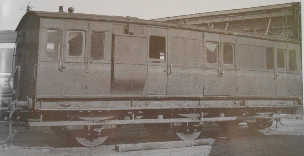

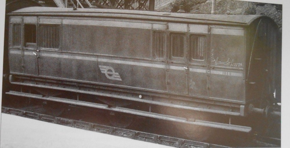

  • WLW/GSW passenger: 101 0-6-0, plus GSW six wheel first and WLW centre van six wheel third [see photo below]. This train will go south to Claremorris and on to Limerick. The GSW are trying out one of their newest [Coey] 101s, while the 6w 1st is an experiment to bring the well heeled up to Mayo from Cork. A couple of horse boxes will be included and there might be room for a carriage truck too. The servants will travel in the brake third, of course...
  • WLW 'mail-goods': 0-6-0 'Shannon', WLW 6 w parcels [see photo], plus carriage truck, D&M goods brake and GSWR brake. Straight out of Castle Rackrent this one and likewise headed down to Limerick and maybe onwards to Waterford. Only the 6w parcels is needed to complete this train.

Mails were carried in the guard's van. You didn't really get dedicated mail vans on lines like that - however, artisitic licence might allow a mail train on account of some new port. This, again, might allow a "boat train" once a day - probably from the W & L direction.
Goods traffic would primarily be vans for the same reason, and then there's the inevitable monthly cattle fair, with good healthy beasts being walked up from Binghamstown and other places on the Belmullet peninsula.
