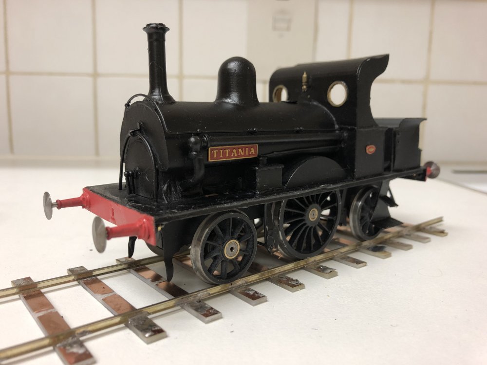

Galteemore Posted October 6, 2019 Author Posted October 6, 2019 (edited) A huge leap in progress today - by tackling two jobs that I’d been avoiding....track and a working loco. Both fairly key elements in a model railway... Permanent way first. The soldering is rather dodgy but that will get better. I made the mistake of using too large an iron and the joints are solid but not neat. Smaller iron next time. Excuses over, I give you...my first panel of 36.75mm track. One of the frustrations of not doing a sensible RTR project is that, well, nothing is RTR, so everything takes a bit of time to get things together. I’d put off doing track due to a bit of a hassle experienced when cutting out the jig a few months ago. But I can’t put it off for ever. So I promised/threatened myself that as soon as the station building was done I’d start on the track. And it’s the standard SLNC 45’ length so at least I know that’s right! And to cap it all off I managed to motorise my first ever Irish loco today....the prospect of fitting pickups etc rather spooked me but here’s this afternoon’s work - including a short video.... IMG_1167.MOV Edited October 6, 2019 by Galteemore 7
David Holman Posted October 6, 2019 Posted October 6, 2019 Track looks right - because it is! Have just been experimenting with representing the fixing clips used in Ireland on FB rail. None on Arigna, so uprating on Belmullet would need about 3000 of them. The idea of drilling and fitting that number of Peco track pins doesn't bear thinking about. Hence am trying the following alternatives - 2mm lengths of 40x20 microstrip, blobs of canopy glue and blobs of acrylic paint. A combination of the last two is looking promising, so will report in a couple of days. As for the loco, no coupling rods, no valve gear - simples. As if! A fine job, especially as a first effort and really looks the part, sitting nicely on the track My own experience with single wheel drive is that it will need a fair bit of extra weight to pull anything, though am guessing the prototype didn't pull the cover off many rice puddings either... 1

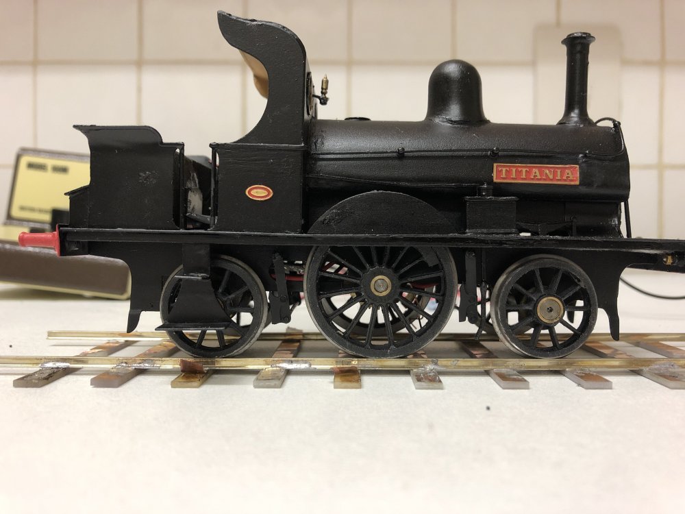

Galteemore Posted October 6, 2019 Author Posted October 6, 2019 (edited) Thanks David! Sounds like a good plan for the track. I’ve managed to get the loco to move but the front and rear wheels stick a bit - not sure how to sort that. But you will probably be pleased to see another 36.75 loco on the rails! Short vid enclosed.... IMG_1171.MOV Edited October 6, 2019 by Galteemore 1

David Holman Posted October 6, 2019 Posted October 6, 2019 1 hour ago, Galteemore said: Thanks David! Sounds like a good plan for the track. I’ve managed to get the loco to move but the front and rear wheels stick a bit - not sure how to sort that. But you will probably be pleased to see another 36.75 loco on the rails! Short vid enclosed.... IMG_1171.MOV 16.47 MB · 1 download Great fun. Seems to run well and that is half the battle. 1
David Holman Posted October 7, 2019 Posted October 7, 2019 You might need to open up the bearings a little on the non powered axles, so they spin freely. If a bit more weight doesn't solve the stickiness, consider opening the bearings even more on one axle, so they are oval, in the vertical plane. A millimetre or so will be enough. What you can do then is to have a price of wire, say 1mm nickel silver or brass, soldered to a chassis spacer and bent to bear down lightly on the centre of that axle. This will add a small amount of compensation, which should improve both running and pickup. Not sure the other axle needs this treatment, as it might over complicate things. Also, even if it goes wrong, the worst thing you'll need to do is fit new bearings, but use this type of compensation on my Clogher Valley 0-4-2Ts and it makes a real difference. 1

Galteemore Posted October 7, 2019 Author Posted October 7, 2019 (edited) Thanks David - I splashed out on a decent parallel broach so may try that on the bearings. I am very fortunate to work 5 minutes away from a professional loco builder who has agreed to look at it tomorrow. I know that this wheel arrangement can be problematic, and Richard Chown’s version of this loco was driven on the carrying axles rather than the single wheel. Many of the key issues are already in place - the loco seems to pick up current from each wheel, all the wheels touch the track, and the driving wheel turns quite happily at low speed. So I’m hoping only a little fettling is required...I do like that idea about the compensated axle. Edited October 7, 2019 by Galteemore

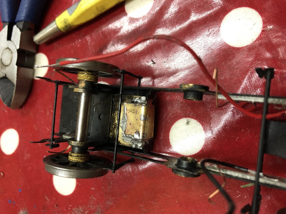

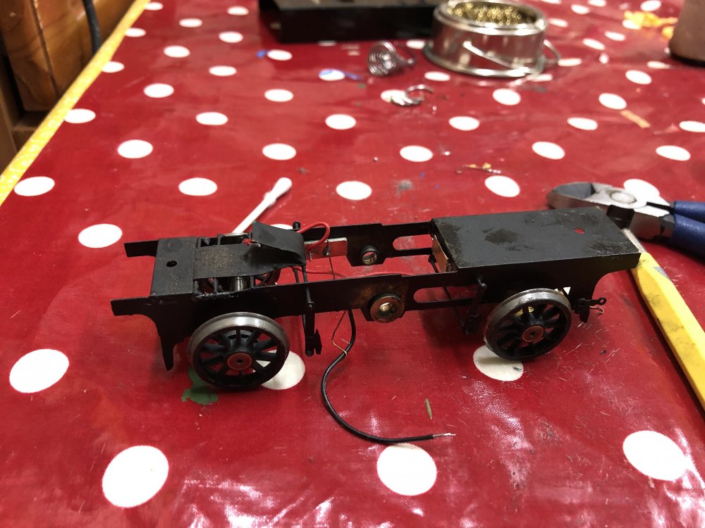

Galteemore Posted October 9, 2019 Author Posted October 9, 2019 (edited) I spoke too soon! Through repeated testing and adjusting since the chassis was built earlier this year, the bracket in question has weakened and tonight it snapped - you can just glimpse the bright metal to the right of the gear wheel. Too late to tackle tonight. But will strip the loco tomorrow and clean the joint area with a fibreglass pencil before soldering back together....I did also use the opportunity of having the loco upside down to stick more lead over the front axle so hopefully when all does go back together it will work better....thankfully I know at least one other builder - who is incredibly skilled and can make such beasts as 8Fs from scratch - who has really struggled with this little kit! Edited October 9, 2019 by Galteemore

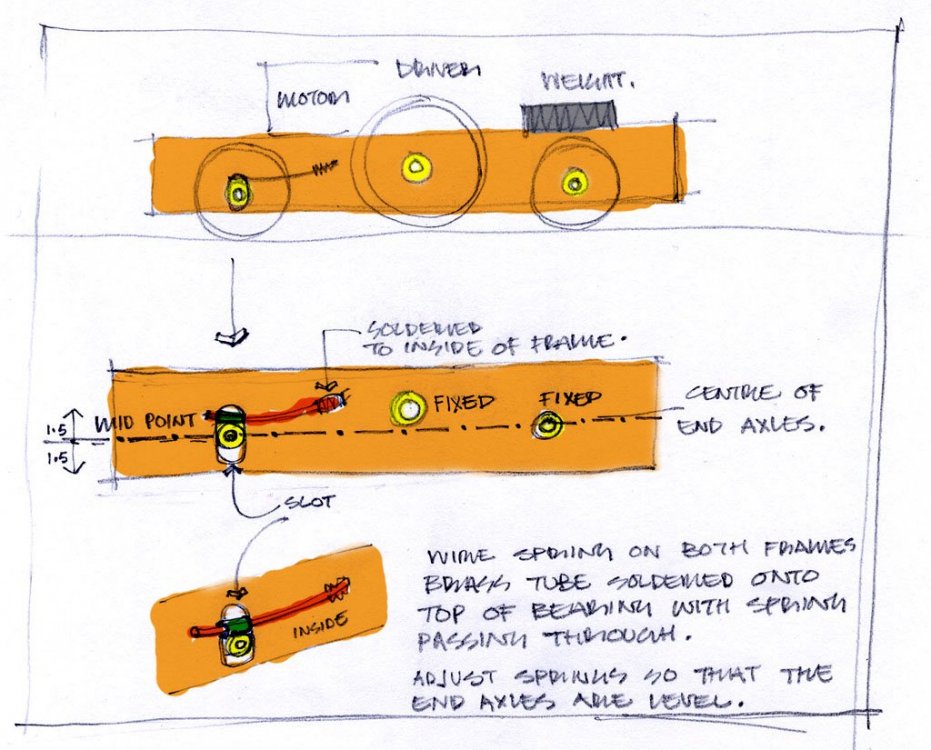

murrayec Posted October 9, 2019 Posted October 9, 2019 Galteemoe Single wheel drive chassis are notorious for bad running, it's one reason why a lot of modellers stay away from single wheelers! In my view the key thing is to allow the chassis to pivot around the driver axle and have one of the other axle suspended (which seems to be the way your chassis is set up), the suspended axle can be done with this axle's bearings in vertical slots in the frames which are then allowed to move up and down, the bearings are held in place by a suspension spring fixed to the chassis and passed through a tube soldered to the top of the bearing! Kind of what David was suggesting above..... I have a sketch which is not identical to your situation but if you study it and use the principle it should lead to a reasonable running chassis Eoin 3
Galteemore Posted October 9, 2019 Author Posted October 9, 2019 (edited) Thanks Eoin - that’s a very helpful illustration! Starting with a single wheeler probably wasn’t the most sensible choice for my first ever loco build but on the plus side I’m learning a lot. The rear axle slides as you suggest so I hope that some kind of spring arrangement as you describe will resolve the issue. Another plus is that I have actually seen the loco running - with all the wheels touching the track and taking power. So I know that it isn’t hopeless! Edited October 9, 2019 by Galteemore 1

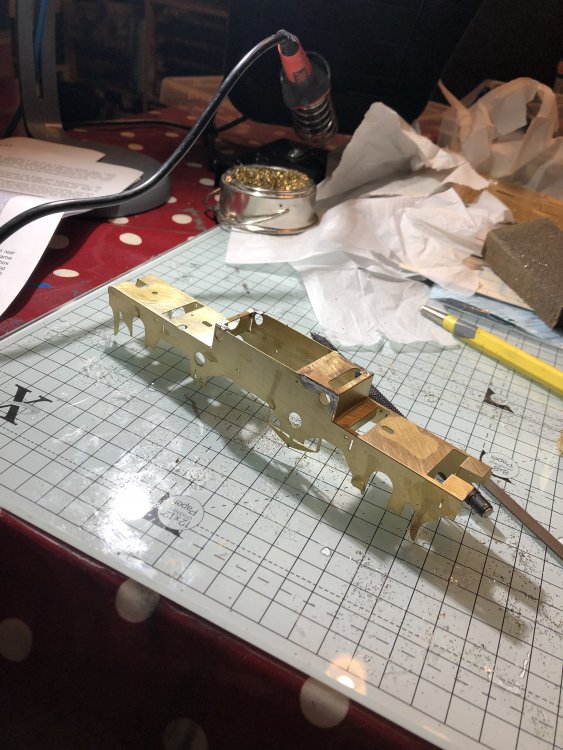

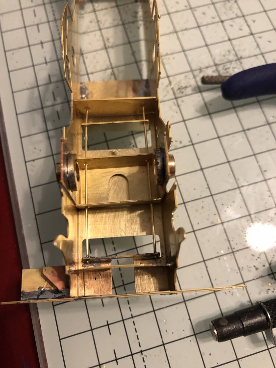

Galteemore Posted October 11, 2019 Author Posted October 11, 2019 (edited) Titania went on the bench tonight for stripping down. Two axles off, motor and gearbox off. Reamed out the bearings with a 4.8mm parallel broach to ensure smoothest possible surface. Solder/repaired the spring and laminated a strip of brass on top to reinforce the joint. Took off some sticky pickups and replaced with finer gauge p/b strip. Hopefully this will do the trick! Edited October 11, 2019 by Galteemore 3
Galteemore Posted October 11, 2019 Author Posted October 11, 2019 She’s back together. All the pickups are delivering power and the motor turns over. The only remaining problem is the single driver. The wheels are a press fit on the axles and one of them refuses to press home. So although the loco is on the rails and nicely balanced, only one wheel is actually doing any work. So the little beast just sits there with one wheel spinning. Loctite should sort it. She is already loaded with more lead than a Chicago gangster’s vocabulary so adhesion shouldn’t be a problem once both wheels turn! 4
murrayec Posted October 11, 2019 Posted October 11, 2019 (edited) @Galteemore Can I suggest you push the loose wheel on over a piece of tissue paper laid over the axle end to hold it fast until you are sure of good running before you use Loctite- just in case more adjustments are required.... Another thing I would do, though you may have done this, is to allow some more side movement in the axle with all the washers on in the photo above- the drive axle should be held with minimum side play but the other two should have a bit of play. Eoin Edited October 11, 2019 by murrayec
Galteemore Posted October 12, 2019 Author Posted October 12, 2019 (edited) Thanks Eoin - I tried the tissue paper and it worked! Loco cruises up and down nicely - albeit with sparks flying off the pickups! I suspect the p/b strip is shorting off the chassis. I’ll possibly replace with wire ones....short vid attached. Many of the problems associated with this loco are down to a single factor - the decision to regauge after the chassis was built and squared off. I didn’t want to disrupt it by removing and refitting the bearings that I had solidly soldered in, so packed out the difference with washers, which I will now adjust. The main driving axle was more complex, being a tapered fit on a tapered axle - and Slaters don’t supply the tapered axle in 36.75....I got a friendly engineer to make a new axle and he did warn me that it would require a bit of permanent fixing in the final stage of construction. In retrospect I should probably have just built the loco to 32mm gauge and sold it! After all, Shakespeare’s Titania is a proud fairy who gets her comeuppance.... But for all her quirks, she is a genuine Irish loco, with that distinctive MGWR cab and smokebox door, so a fitting way to start as an Irish modeller. It has also been a very useful test bed for techniques I can use again. Let’s just say, though, that any future loco will have at least 2 driven -or certainly coupled - axles ! IMG_1215.MOV Edited October 12, 2019 by Galteemore 5

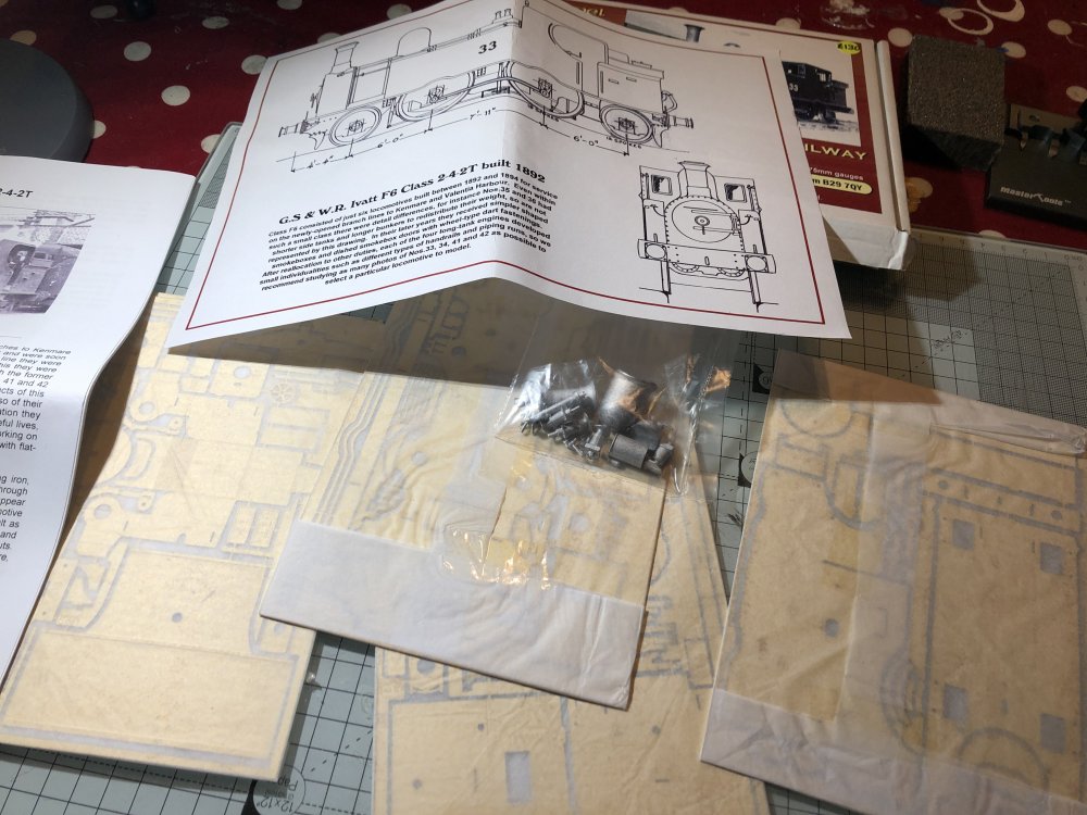

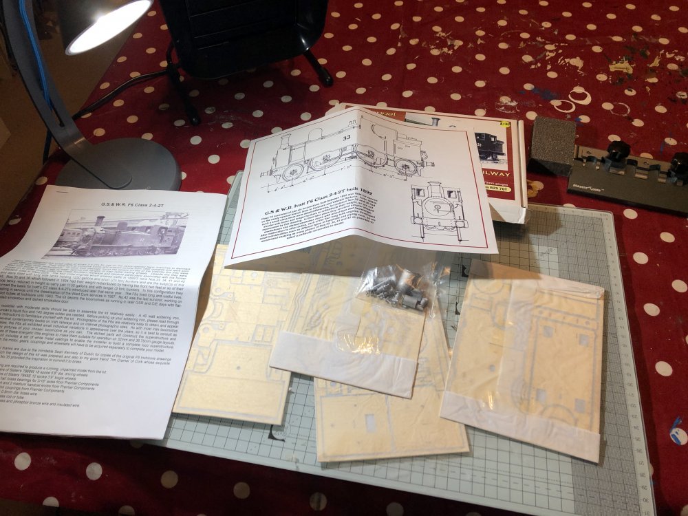

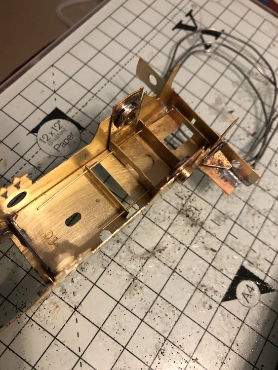

Galteemore Posted October 17, 2019 Author Posted October 17, 2019 Last March I went to an 0 gauge trade show and picked up quite a few Alphagraphix brass kits with the proceeds of selling my English outline stuff. Trying out new techniques in other media has meant that these kits remained untouched. I realised recently that I needed to get soldering again before I forgot how to do it! So tonight I started into another loco. Slow progress at first but the mainframes are up..,, 6
David Holman Posted October 18, 2019 Posted October 18, 2019 A GNRI 2-4-2T? Nice prototype and what looks like a fairly simple chassis. Am guessing the leading and trailing wheels will require a fair bit of sideplay, though two coupled axles should be easier than three. A logical progression from a single, methinks! Have built several Alphagraphix Tyrconnel kits and though fairly basic, they seem to go together nicely, so will look forward to seeing progress. 1
Galteemore Posted October 18, 2019 Author Posted October 18, 2019 (edited) Thanks David. She is a 2-4-2t indeed but a GSWR one - F6 class. That’s a helpful tip about the unpowered axles - thank you. This will be my first loco built to 36.75 from the start so looking forward to seeing her take shape.,,and I have a 6 coupled loco in the pile as a logical successor! Edited October 18, 2019 by Galteemore 1
