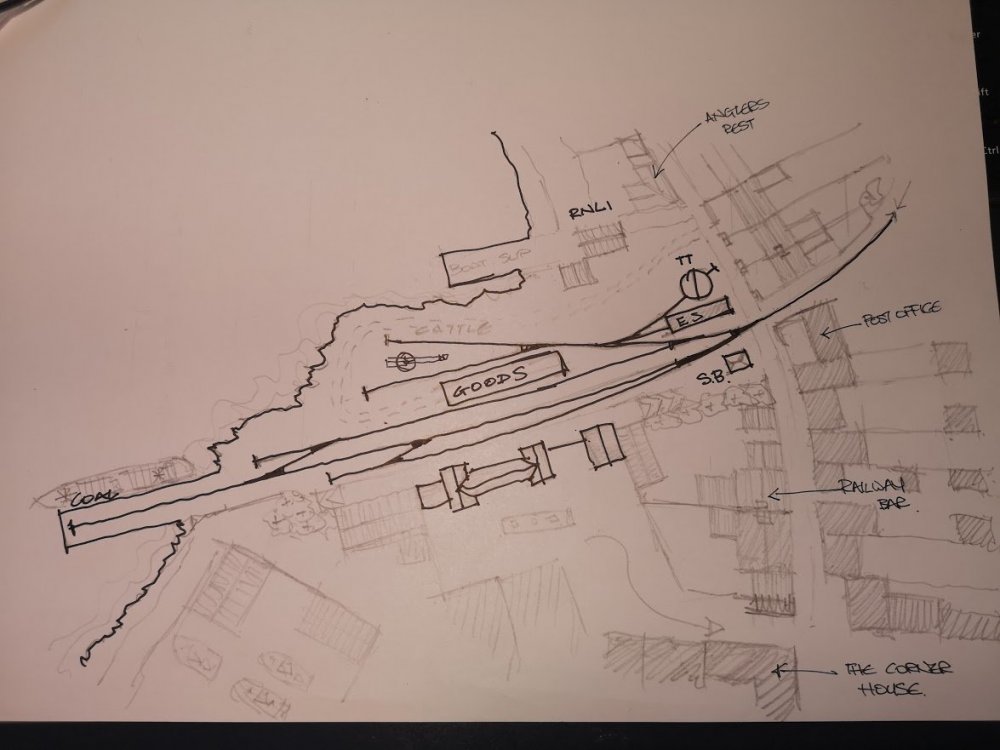

You could have a heap of industries, like boat yards, warehousing, distilleries, timber merchants. Fish going east and onward to the UK, all realistic in that timeframe. The main track would be about 6 ft long I reckon, in 2mm.

Bugger, some compression required then !!! Richie.
Link to comment

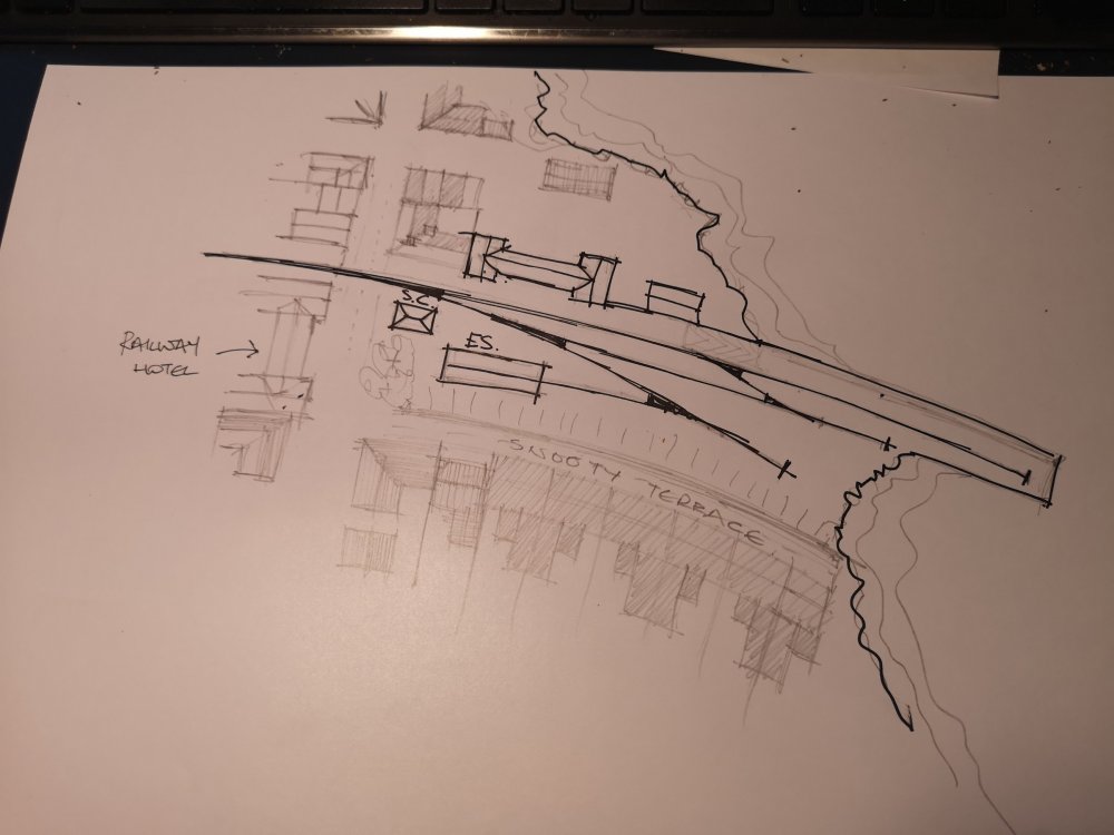

Holy sh... now that is a truely inspirational drawing, I have to say!
The station area in particular catches my eye, and not just because of The Fawls (the railway bar). I love how I can actually picture this looking in real life? (or in scale? I'm not sure now, my mind must be playing tricks). I think I can integrate this with a station idea I have. Best of all? I think I can make out what is what and why thanks to jhb171achill's drawing. There's just two abbreviations that I can't make sense of, RNLI and ES?
I think I have to do something with this drawing just from the sheer inspiration it gives, did this drawing come from some other project? or did you actually just draw all of this as per my request??

The RNLI would be a lifeboat station, with a slip way. The idea was to give the idea that there was something "beyond" the railway station, I'd imagine a proper dock of some sort further north, a bit grittier and more industrial. E.S. is engine shed and quite a few small stations would have had one.
I looked at Baltimore and sorta invented a town/small village around it. Market town like Mitchelstown combined with the fishing stuff like Warrenpoint, and just kind of imagined what it might be like as a workaday place, rather than a touristy driven place (at the time). Then kind of wondered where'd be the best place for a bowl of chowder and a pint, watch the world go by, but that's the Covid kickin in 🤣
I'll have a go at something more suitable for the smaller dimensions....!

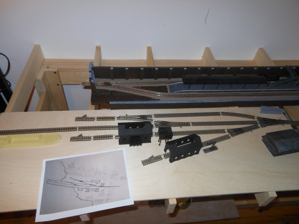

Made a start with a platform and received some points to start figuring out exactly how to do the trackwork for the harbour. I might have to look into printing myself some semaphore signals, the only lower quadrant ones I can find in N gauge are by Dapol, and they don't appear available yet...
I'm going to keep track of progress on my site: https://frozenchaos.net/
Already had it and has been sitting idly, so why not use it as a place to track this stuff.
Anyway, my start at a platform:

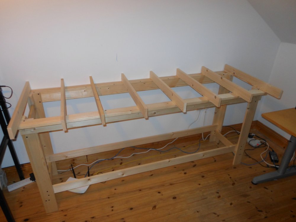

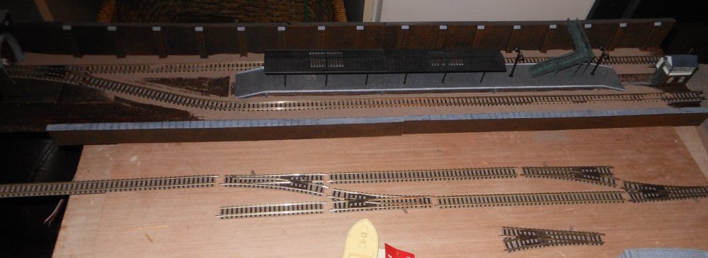

Finally, after a long long time... I've finally constructed some benchwork! Been wanting a proper train table for over a decade now.
With a slightly modified trackplan for the harbour (the printed plan was posted earlier in this topic by Glenderg), though I'm still doubting my modifications. Full story can be read on http://frozenchaos.net/?p=28
