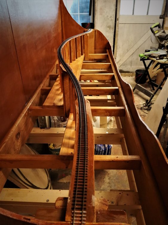

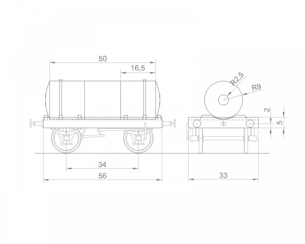

Angus,
Saw your question in my workbench thread & answered there.  But again here for convenience.
You can always shorten the tank, or lengthen the wagon and add in the headboards & strapping you were referring to in your post earlier.
My timber supports are probably a little too big on the model, however it seems to work, so I'm happy to leave it.
 Regards,
Ken
Thanks Ken,
That is much appreciated,  although the  Sligo tank is somewhat different it is always useful to have some comparable dimensions to compare to.

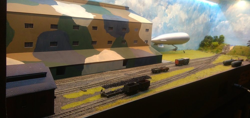

I've a semi-completed 2mm finescale "cameo layout" based on a WW1 Airship base that was built for the MRJ Cameo layout competition. This sits in the room that I use as my home office, library (it sits on top of the bookcase) and modelling room.
Although this has been exhibited a couple of times it has several shortfalls. The original plan was drawn up for a 6'6" scenic section with a 1'6" fiddle yard. This was shortened to comply with the rules of the competition to 5' scenic section and 1' fiddle yard. Being lazy, to create the shortened layout I compressed the Templot plan by increasing the sharpness crossing angle on the points and reducing the run in from the fiddle yard over the stream. I also reduced the length of the loops to suit the shortened fiddle yard.
Unfortunately the knock on effect of simply increasing the crossing angle created some unduly tight curves (I now have a better understanding of how Templot works and could have avoid this with some simple adjustments, this is user error rather than a criticism of the software). As a result anything longer then a short wheelbase wagon is derailed by the coupler loop on the DG couplings.
The length of the fiddle yard severely restricts train lengths so I find the layout a bit unexciting to operate (combined with derailing issue due to the tight radii), I also made the mistake of using a MDF base, which has misshapen slightly with the application of water for ballasting while minor, given the small tolerances of 2mm finescale, does produce a bit of annoying roller coaster effect.
The result is I seldom operate the layout, and frequently come away frustrated when I do.

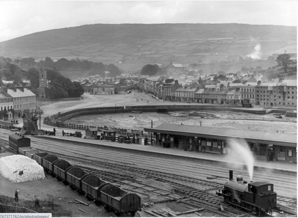

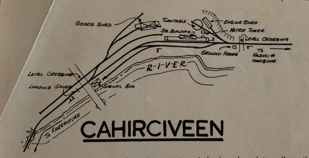

The second was the view of Cahirciveen in The Farrenfore to Valencia Harbour Railway Vol 1 (P118)
This particular photo is snipped form this online article:
https://docplayer.net/122870130-Chapter-15-archaeology-architectural-and-cultural-heritage.html
I like the juxtaposition of the harbour, the railway and the town and whilst examining the track plan at Cahirciveen
it occurred to me that with some compression it could be converted into a terminus and if a turntable release was used at the end of the run-round loop could be squeezed in to the sort side of "L" shape I have available. This would allow a bit of a longer run in and also permit another small station to be modelled, this avoiding the "shuffle on - run around - shuffle off" on most terminus to fiddle yard layouts.
I was a bit worried about the turntable release at first but was then reassured when I found this arrangement at Edenderry:
and Athboy:
(all track plans above are lifted from the Government of Ireland's Historic Environment Viewer 25" to the mile historic maps)
Both are MGWR termini.
I've developed some thinking about where this mythical branch line would be located and some history but will follow up with that in another post.
Any thoughts so far? Is nicking a GSWR through station a step too far for an MGWR/SLNCR terminus 😁

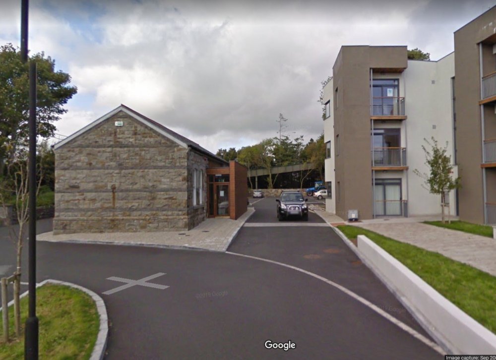

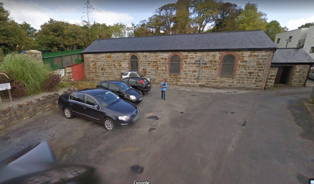

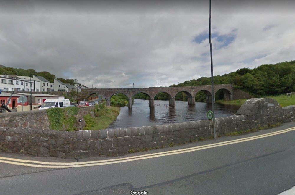

As an option for the MGWR flavour, would you consider Newport.  Visually very impressive with the multi arch bridge over the river, the incoming line emerging from a tunnel crossing the bridge and entering the station.
The road bridge on the North end of the station provides an excellent scene break with the opportunity to use a sector plate or traverser / fiddle yard depending on operating preferences.
Looking North to the road bridge along the original trackbed.
Photos courtesy of Google Maps.

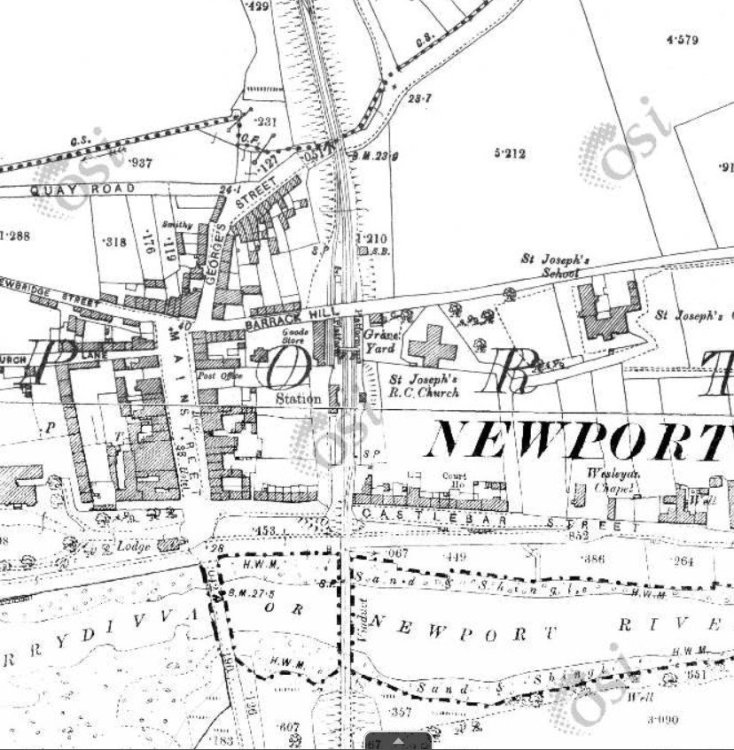

A view of the original station from OSI historical maps
Although not in my area of interest, it was a station that I thought would provide some excellent visual and operational potential and thus a good layout.
Just a thought

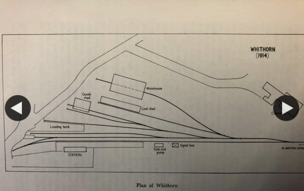

Rice's Westport Quay is just one many clever ideas from the design guru. Have always liked his pier terminus in the Scottish section of his light railway book that is worth a look.
Hi David,
that is exactly the plan I was referring to earlier in the post above. I was contemplating it as drawn with the addition of the obligatory turntable for Irish operation. I realised whilst it fulfilled the scenic potential operationally there was a lot of "dead" layout. The extension through the the quays would only be used for occasional shunts meaning half the layout would used intermittently in operation with most trains coming on and going off scene without the benefit of the longer run. One of the things I like about 2mm scale is being able to give a sense of journey. shunting layouts and small terminus to fiddle yard layouts I feel are better suited to larger scales (as I've found to my cost).

I always liked Cahirciveen mainly because of its compact nature and scenic location with a lot of trackwork crammed in between the level crossing and the high ground at the Valencia end of the station. I am surprised that Jim Harrison or Iain Rice did not come up with a West Country, Welsh, Scottish version's.
Cahirciveen certainly had elements of Tor Point or Craig about it with the station hemmed in between the sea wall with the town as a scenic background, the line to Valencia Harbour could be treated as staging or a fictitious goods only "Harbour Branch".
I suppose I could do a Rice and use Cahirciveen as the inspiration for an EM or P4 light railway station and harbour branch some place in South West Scotland, the Llýn Peninsula or remote part of the East Anglian coast.

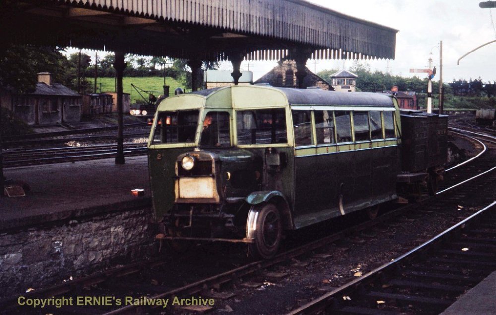

Cahirciveen was the first bit of Ireland I “knew” as it was featured as Prototype Layout No.3 in the early “Railway Modeller”, placing it in the early 1950s (sorry I cant be more specific) It was the terminus for some time before the line was finally finished to Valentia Harbour, so kept the engine shed and turntable.
Recently Ernie has put an album of pictures of the branch on Flickr, some of them breathtakingly beautiful, and doing it in N should give you the chance of some plain line running through this.
i think it could form a setting for any of the old Irish firms without embarrassment, including the SLNC?
Me, I’ll miss the Blimp.

12 hours ago, Galteemore said:
I’ve always liked the Galloway branches in Scotland.
Indeed and also well represented in Mr Rice's writings. The timber bridge on my airship base layout is based on the one on on the Kirkcudbright branch. Plenty of inspiration there!

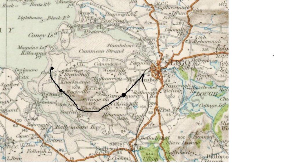

So that just leaves where to locate the plan.....
It was the SLNCR that drew me into an interest in Irish railways so that line needs to be present along with my other main Irish interest the MGWR. This means the sweet spot stays around Sligo, especially as I can add in the WL&WR with a smattering the the GSWR post take over.
Looking around the area on Google Earth I notice a couple of beaches near Sligo on Ballysadare Bay around what is now call Strandhill. A bit of nosing around Wikipedia (so what follows may be of questionable accuracy) it appears the Standhill area was developed in the 1890 to exploit the beachside location. No doubt the presence of Knocknarea hill crowned with Queen Medb's grave added to the attractions.
So what would have happened if in a search for a locality to build one of their hotels to generate more traffic the MGWR got there first, in say the mid 1850s? Is it too implausible that the SLNCR, then desperate to increase receipts, also scraped a few coppers from the bottom of the piggy bank to contribute (no doubt another loan from their benefactor and main investor Mr Morrison, gallantly trying to get a return on his money).
The period maps show no real villages of any note (but then when has that stopped Irish Railway promotors?) so I've chosen a 6 mile route that skirts around Knocknarea with a couple of intermediate stations and a junction onto the Sligo station approach mainline at Magheraboy.
The name Strandhill doesn't really work for me, fortunately there appears to be an earlier name of Larass (An Leathros) which suites better.
The first intermediate station heading from the terminus back to Sligo will be named after the local beach at Culleenamore. This station will also help generate traffic as a regular horse race was held on the beach from the 1850s (Wikipedia again so could be complete nonsense....).
The area is also noted for its oyster beds which will give another traffic flow. Once the quay side is built there will be some trade in fish to.
Dublin excursion traffic can reach directly with a reversal at Sligo, ordinary services would connect to the local branch train. The SLNCR can provide a through service to Enniskillen reversing at Sligo with the possibility of through GNR coaches from Derry and Belfast.
I'm not planning to use any of the local geography or buildings apart from maybe Knocknarea on the backscene, the sea and quayside at Larass/Strandhill will be on the wrong side for a start!
The above narrative is meant as a backstory to generate traffic and root into the train services of the area. The company ownership will define the infrastructure I just need to select and find appropriate buildings and plans.

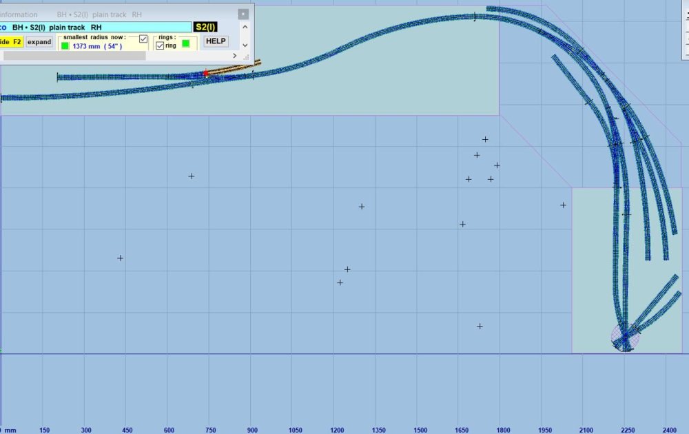

5 hours ago, Andy Cundick said:
 A point to watch with some of Ians designs is that when you go to build them you find everything is a bit on the tight side,many moons ago i built his "Etterick"  design but transplanted it to the Welsh borders as "Tallylyn Road"  and built to EM standars and ended up leaving out several features because there was not enough room.The basic concept was fine however and it saw many shows plus a feature in British Railway  Modelling,before age caught up with.Funnily enough i've just exhibited its successor which is a Scottish branch terminus.Lochty which was the terminus of the East Fife Central Railway operated by the North British.It was a line with great intentions but ran out of money and ended up finishing in field in the middle of nowhere.Post closure it was run for ten or so years as the Lochty Private Railway ,main rolling stock consisting of "Union of South Africa" and a Coronation observation coach,definitely a prototype for everything!.Andy
Hi Andy,
I think most track plans suffer from that. It is easy to get a bit optimistic about what can fit with a pen and paper. Cyril Freezer's plans being a case in point!
I always flesh my plans out first in planning software such as Anyrail. This allows a lot of quick adjustment.
Once I've proven the concept and got the layout roughed out I move over to Templot.
Once in Templot it is surprising what can achieved using bespoke geometry to ease curves and create a more sinuous line.
Edited by Angus
My planning is a bit more basic comprising of a sheet of ply 3 foot steel rule and a pencil.Andy

I can't remember who said it, but it is a truism that  on a good model you should be able to tell the period and the operating company without any rolling stock present.
It is easy to get this wrong, for example in my enthusiasm above I've noted the view of the Cahirciveen shed area stating I was just going to swap the corrugated shed for a stone MGWR one.
1154-2 GSWR Cahirciveen shed on Valentia branch Ireland (JW
The problem is that the majority of MGWR termini that had engine facilities had two road sheds. The exception being Ballaghaderreen and Kingscourt. The later looks to house two engines in a long single road shed rather use two roads; so if I want to create an MGWR atmosphere I should use a two road shed.
As there is also a lovely drawing of the attractive corrugated station building at Cahirciveen in the Valcencia Harbour book. It is tempting to use that, however the MGWR seems to have been quite generous in bestowing stone station structures onto its branch lines. So an alternative will be needed.
