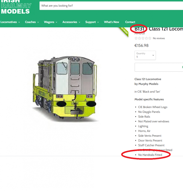

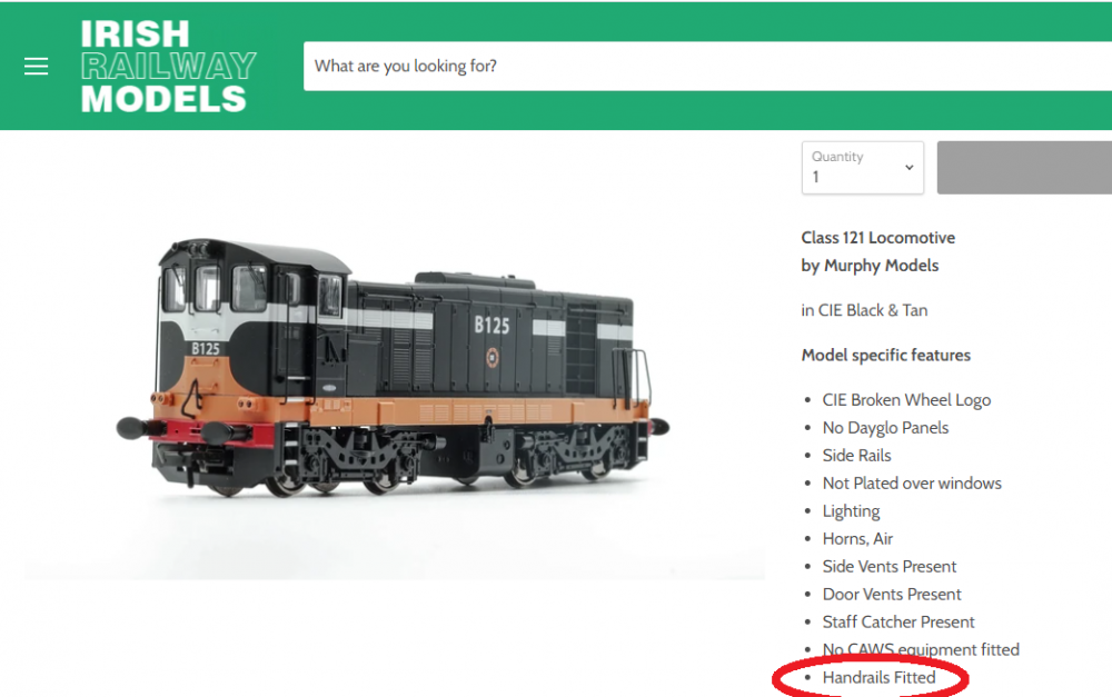

hello,

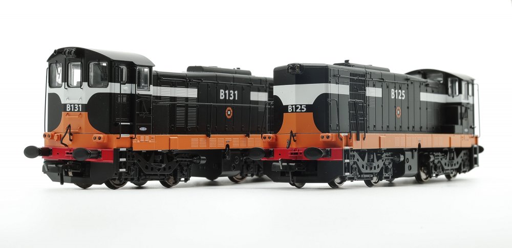

B125 shows with handrails and B131 without in the description but photos show it the other way around, which is correct?
Pictures tell a thousand stories, so would go with that!
They had started repainting them in black'n'tan as early as 1964, and therefore before they were all fitted with full-length handrails. Thus, it was possible to find black'n'tan ones both with and without full handrails. Same with the little sand-filler jobbies on the nose ends.
Thanks jhb, the pics could be of pre production models so wasn't sure which was correct.

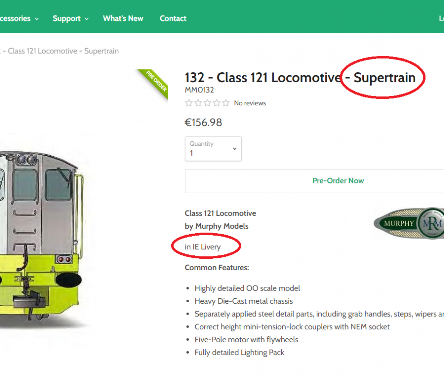

also, is 132 Supertrain or IE?
According to Hatton, 132 is in CIE Supertrain livery.
Stephen

All of the 121 class would have received Catwalk handrails in the early 1970’s , fitting them for MU(Multiple Unit) working would take longer B121 being first (1973) , B134 second (1974/75) B131 was fitted for MU in late 1975 so the model is spot on , B125 was not fitted for MU  working  while in Black and Tan , it was the last 121 fitted with MU equipment in 1978 and by that stage it  was in Supertrain livery so again the model is spot on .
While on the subject of handrails the 141, 181, and 071 class came built with EMD catwalk handrails , the catwalk handrails on the 121 were made in house by the staff at  Inchicore works so they are different  this is another fine detail that Paddy Murphy has got captured perfectly on these models  well done again Paddy .
