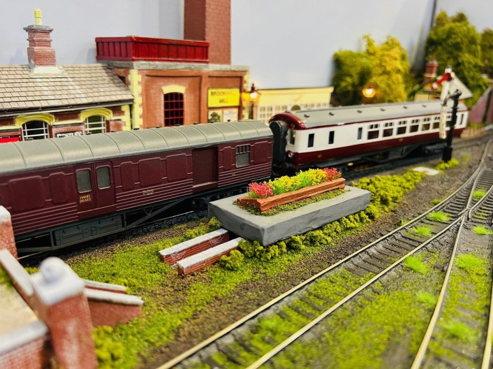

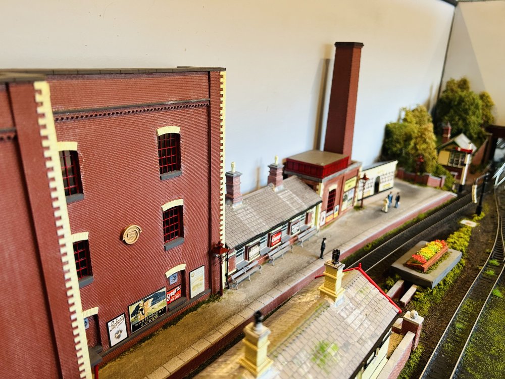

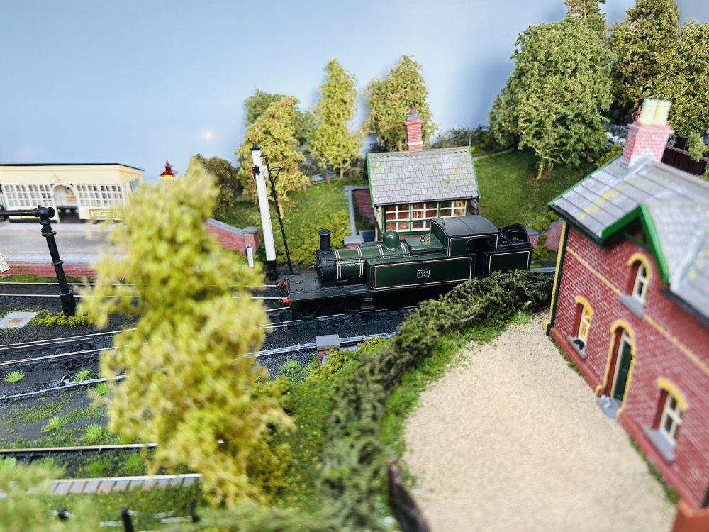

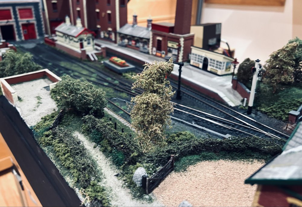

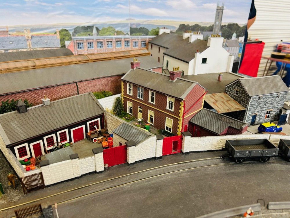

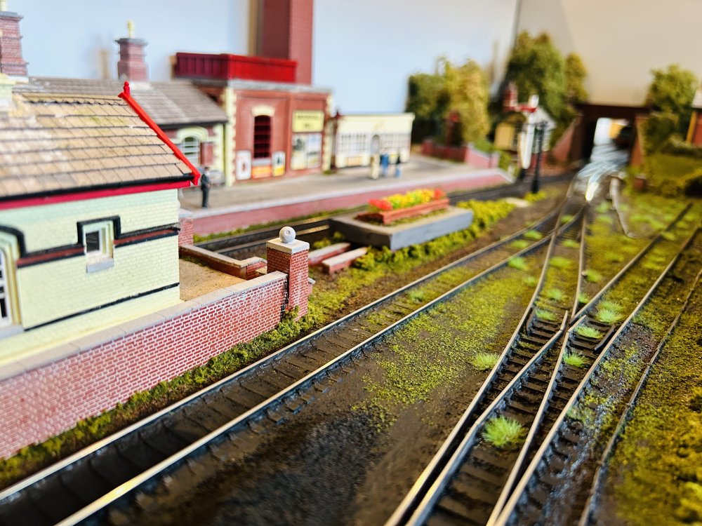

Currently working through a ‘snag’ list with the layout.  Surprising how many small things still need sorting…….
Drain covers - need to install along the road
Fix loose lights and reposition one light which is fouling the platform road
Water crane drain detail - need to paint the red bag and add more greenery and paint the drain a rust colour
Platform surface - needs weathered
Water tower copings - falling apart….need to make replacements from DAS clay
Lifebelts - need painting for the period
Signal box chimney - it’s wonky
General greenery ~ base of walls, on the buildings etc
Gun position copings - need DAS replacements
Level crossing rails - too high and some vans are riding up on these and then dropping down
Grateful for any more observations!

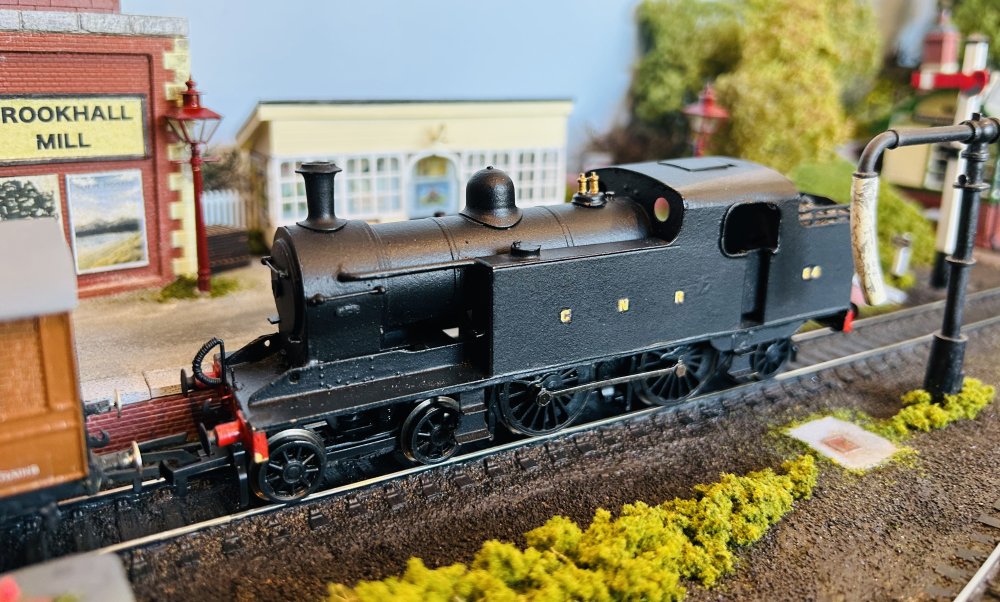

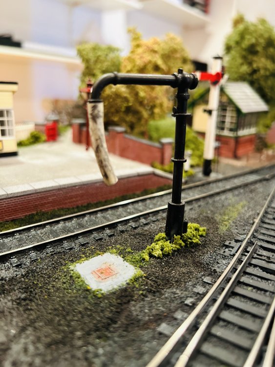

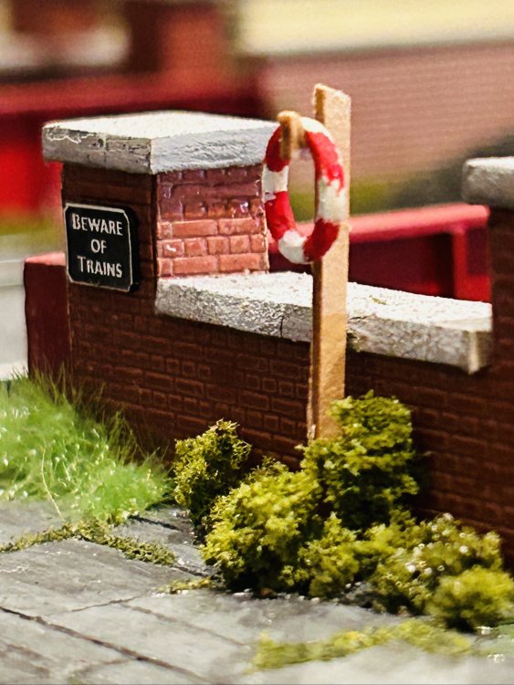

Working through my 'snag' list..... with thanks to @Galteemore and others for suggestions along the way.

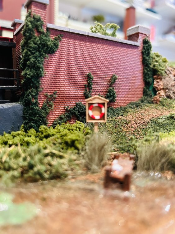

1.  The red water bag has been toned down and dirtied a bit, and the crane has a bit of greenery.  The drain is now also rusted.
2.  The lifebelts are now a more appropriate colour for the era. I tried to use masking tape to get sharp edges between the red and white, but the eyesight had other ideas.
Edited by Patrick Davey
  • Like 9

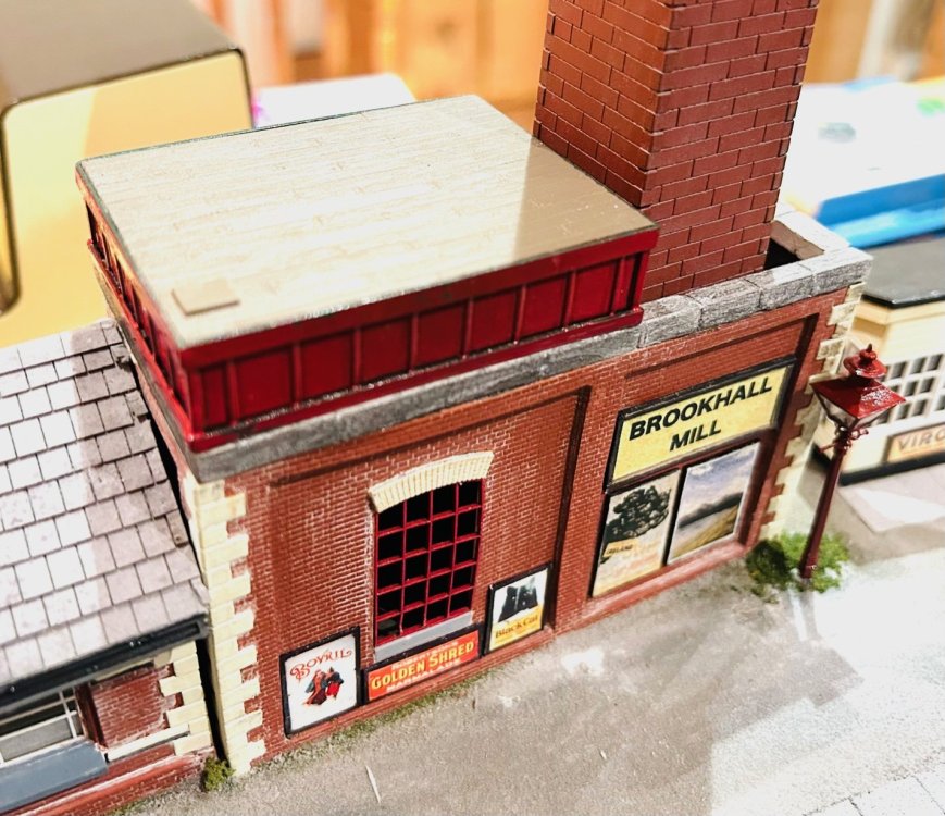

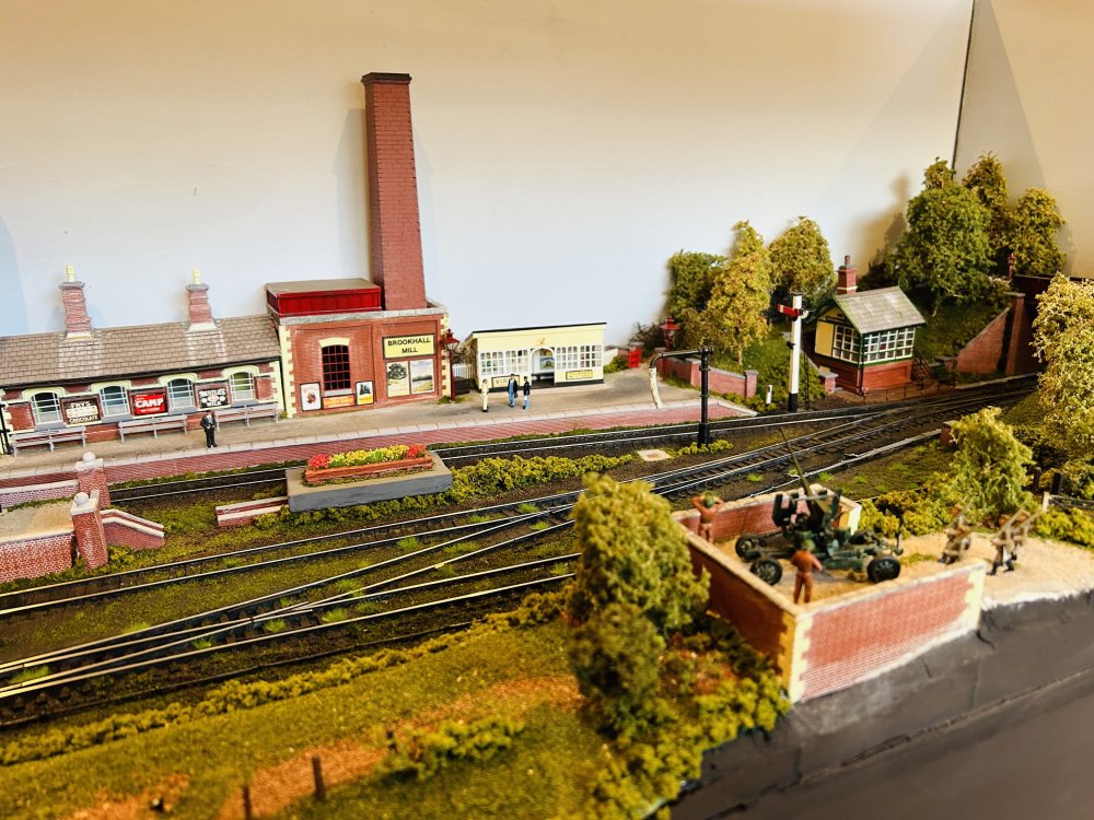

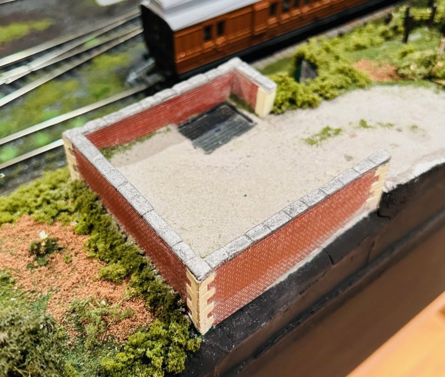

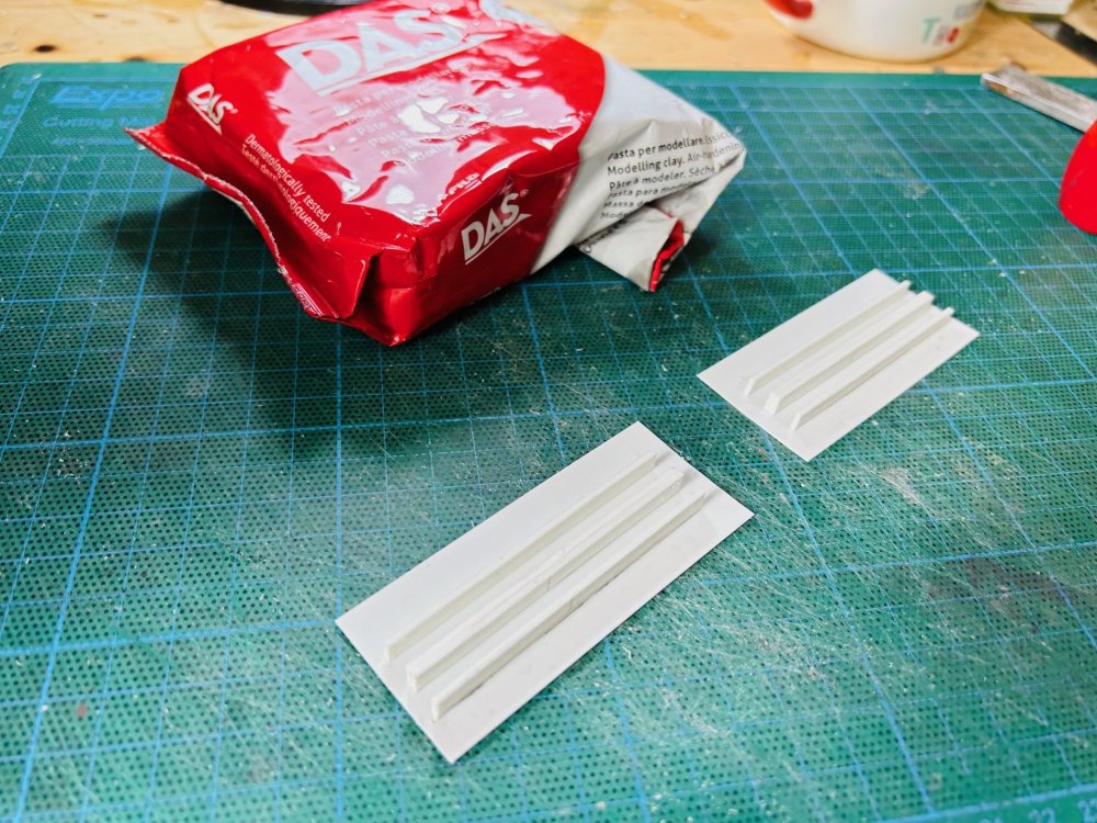

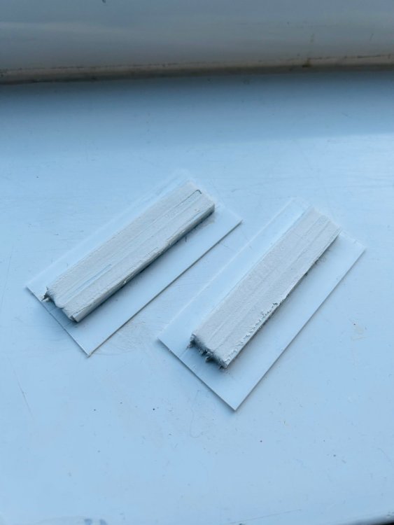

THE COPING STRATEGY
Nearly there with the 'snag' list before I can officially declare Brookhall Mill to be 'finished', if a layout can ever really be described as such.  One of the two remaining items on the list was to replace crumbling card coping stones: thin ones on the gun emplacement and thicker ones on the boiler house under the water tower.  The card was only crumbling because I didn't quite prepare it properly.
Anyway I wanted to use DAS clay to fabricate new coping stones.  DAS gives a really good 'stone'-like texture I think, so that was where I was going.....
The smaller ones for the gun emplacement were straightforward enough - DAS was rolled out to a thickness of around 2mm and once dry, appropriate lengths were trimmed off and shaped accordingly.
The thicker blocks for the boiler house were produced as follows:
1. Plasticard formers were assembled - careful measurement was needed to ensure consistency.
2. DAS was spread inside the formers and left to dry for a few days.
3. Once dry, the lengths of dried DAS were carefully removed from the formers then sanded and scribed to represent individual stone blocks.
4. The blocks were coloured using a HB pencil and glued in place.  I might add in some greenery for weeds later.
This is the gun emplacement with the DAS coping stones in place and coloured:
Good old DAS!
  • Like 10

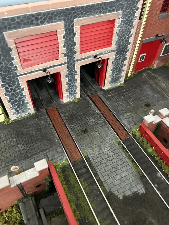

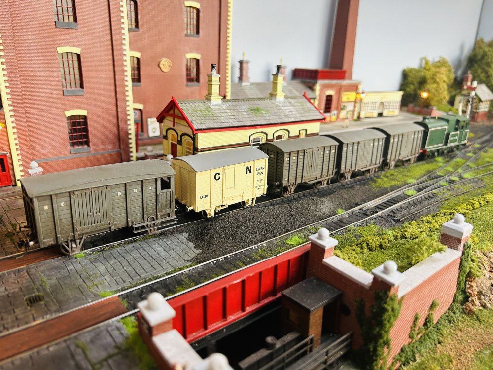

The last major item on the snag list - the inset track which crosses the access road to allow vans to be shunted into the mill.
I could for some reason never get this right - the check rails always sat too high and the vans would ride up over these on their way into the mill, so I have admitted defeat and applied timber inserts.
And they are actually timber - made from coffee stirrers!!
  • Like 9
So after almost three years, I think I can officially declare that Brookhall Mill is finally finished!!  With grateful thanks to everybody on this forum for all the support and encouragement along the way 🙏

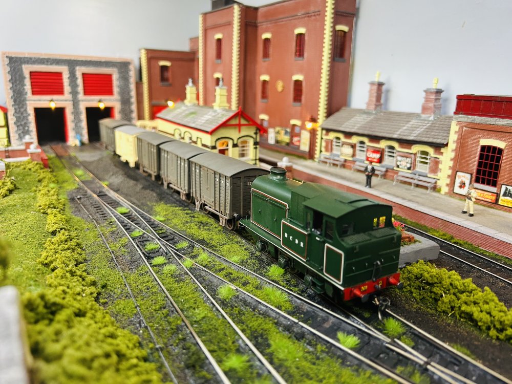

MR. WEAVER’S TRIP TO LOUGHAN QUAY
One afternoon in 1944, a BCDR train arrived at Brookhall, hauled by BCDR diesel No. 2.  The train was there to collect a shipment of linen for Loughan Quay near Dundrum.  The driver, Mr. Nixon, was a friend of Mr. Weaver’s from years earlier and soon an invitation had been issued to Mr. Weaver to have a cab ride in the little diesel, and enjoy some hospitality at Loughan Quay.  Mr. Weaver was very fond of No. 2 and immediately accepted Mr. Nixon’s invitation.  Soon the two old friends were making their leisurely way in the loco’s small cab along the Lagan Valley towards Belfast, before taking the Belfast Central line and then the BCDR mainline, passing through all the East Belfast suburban stations and eventually reaching Comber, where they had to wait for a few minutes to allow a Donaghadee train to enter the station.  Soon they were on their way again, passing Ballygowan, Saintfield and Ballynahinch Junction - this latter station was the diesel’s usual workplace but she was away from her regular duties this week and instead, a CIÉ 2-4-2t locomotive was working the Ballynahinch branch.  After passing Crossgar, Downpatrick Loop platform and Tullymurry, the train slowed for the junction for Loughan Quay, arriving shortly after.  Mr. Weaver certainly enjoyed the hospitality at Loughan and indeed he spend much time getting to know the locals.  Later on, Mr. Nixon and diesel No. 2 brought Mr. Weaver to Newcastle, just in time to join the final GNR departure to Belfast - Mr. Weaver alighted at Lisburn where a locomotive was waiting to bring him back up to Brookhall.
With very special thanks to Alan (Tullygrainey) for making all this possible, by letting me create this little story using his fantastic BCDR stock and also his stunning 'Loughan Quay' layout.

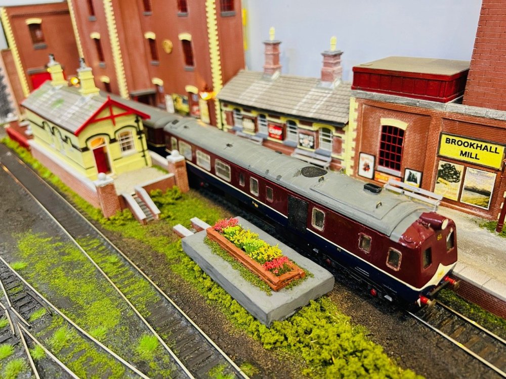

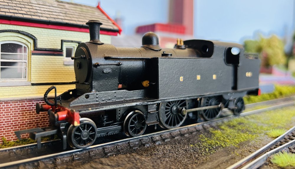

AN OLD FRIEND RETURNS!
Lots of excitement at the mill today as an old friend returned following a chassis upgrade, courtesy of Alan (Tullygrainey), a craftsman in brass!  This venerable lady started life as one of the excellent Studio Scale Models T2 brass kits over 30 years ago, built for me by a friend. The model spent most of the next few decades hiding away in my attic, but received an overhaul from Colm Flanagan a few years back when she became GNR No. 64.  Recently I decided to replace the chassis with one cannibalised from a Hornby Adams Radial tank and Alan very kindly carried out this work for me. Now No. 64 is working on the layout and is a perfect complement to the blue-liveried U class No. 205 ‘Down’.
With grateful thanks to Colm and Alan for bringing this beautiful model back to life for me 🙏

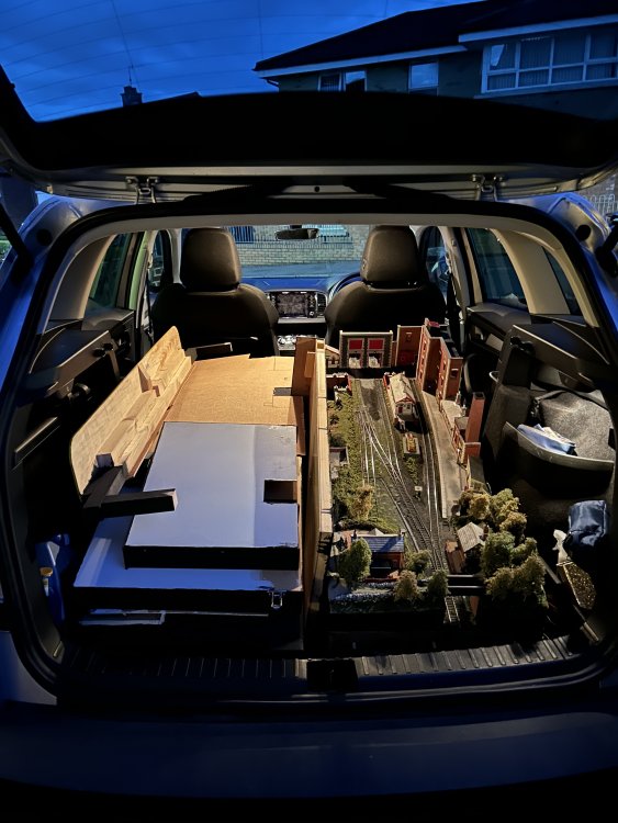

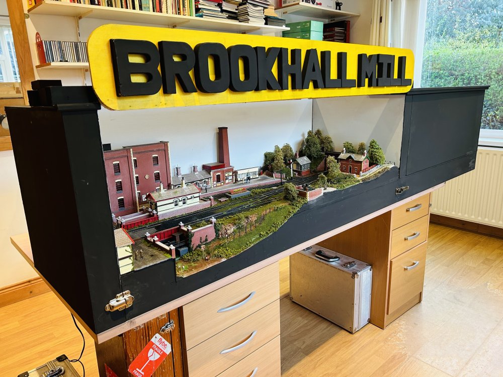

For the first time, Brookhall Mill has left the building!!  All packed up for its first outing tomorrow to the Ulster Model Railway Club show in Belfast.  Sleeping tonight with the window open, directly above the car…….
The workshop seems kinda empty now……
If you’re there tomorrow, come say hello 👋

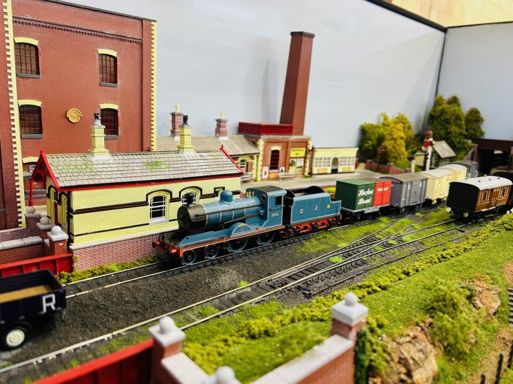

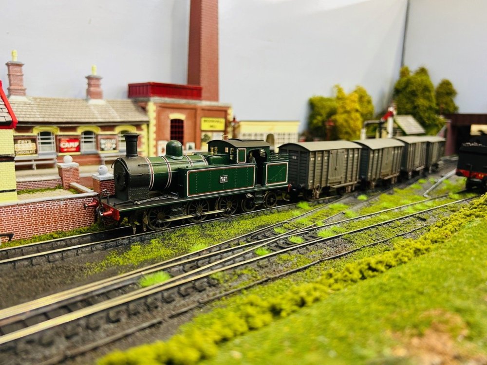

Fantastic day at the UMRC show!  Many thanks to everyone for the great organisation and hospitality!  A special word of thanks to Alan @Tullygrainey and Paul for helping out as 'The Brookhall Millers' 😂
Setting up before the show:
The GNR years:
Alan's amazing BCDR models:

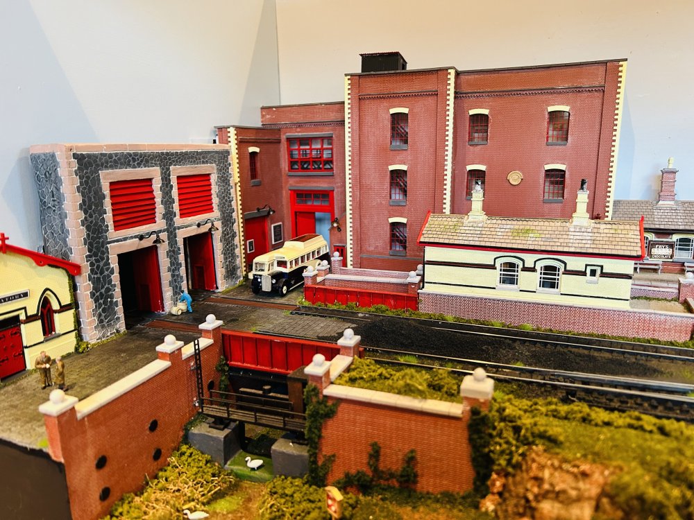

A Belfast Corporation bus pays a visit to the mill:
Just before the mill closed in 1975, a brand new NIR 80 class railcar paid a visit:

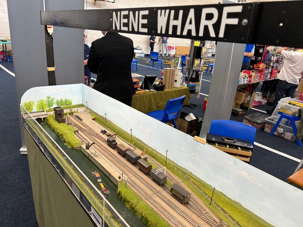

And the very charming 'Nene Wharf':
