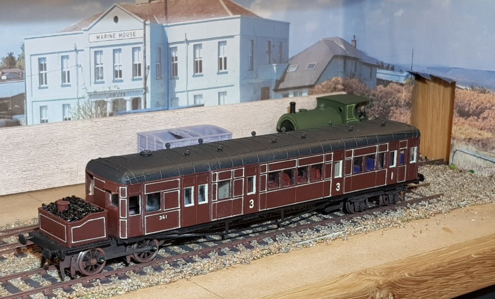

19 hours ago, Mike 84C said:
I fancied the Clayton railcar

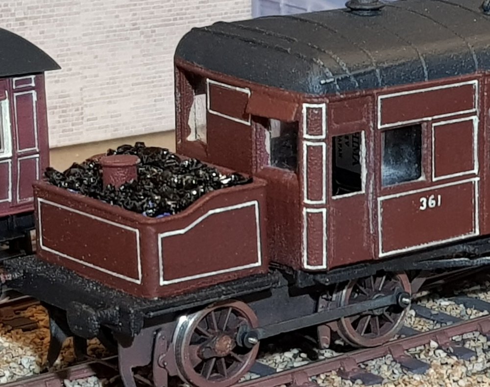

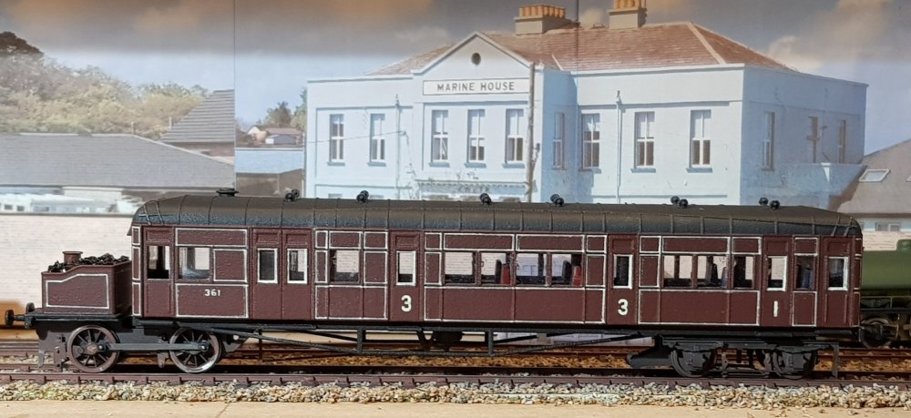

So did I, and as Andy noted, the surface finish was very dissappointing.
Basic airbrush primer (black) with two panels with various levels of surface cleaning - one using fine brass brush, second using light sand paper.  Surface is quite tough and difficult to sand back, so an alternate was needed.  The model cost €100 inclusive of shipping and I was not just going to throw it away.
I resorted to using a heavy automotive primer used to smooth out blemishies in car repairs, which was an improvment, but does not stand up to close scrutiny.
So, if I can avail of the 1m rule (rather than 2') I get a reasonable model I can live with.
Full lenght brass chassis with veritcal motor where the boiler would be in the prototype and brass bogie at the other end.  A 3D printed interior helped to give some internal detail.
Tthe poor surface finish makes lining quite difficult, but as noted above, at the 1m viewing distance is not too bad.
I need to add some handrails, door handles and steps which will help to finish this one out.  Some weathering would also help to mask some of the imperfections.
All in all a difficult model to work with due ot the very poor surface finish and I have been going back and forth with work on this one for some time now.  I made a concerted effort to bring this one to completion & feel I have a passable model that will work in with the other models on a layout.
Would I do it again - not a chance!!
Ken
  • Like 7
Link to comment
