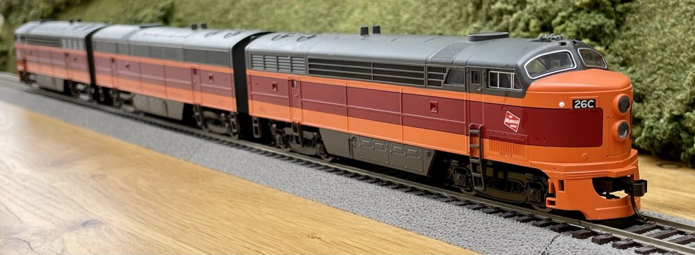

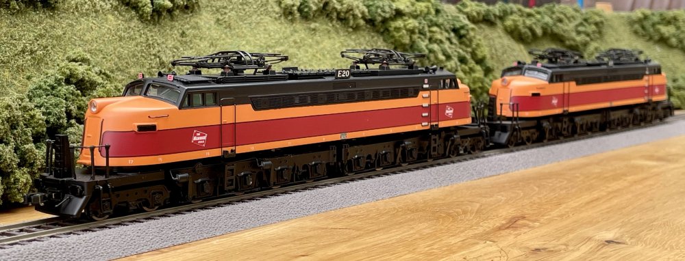

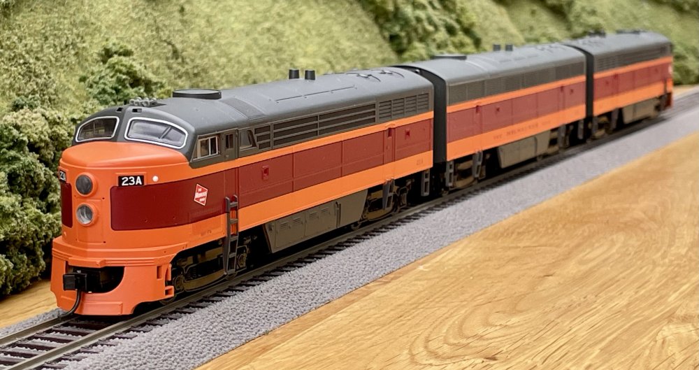

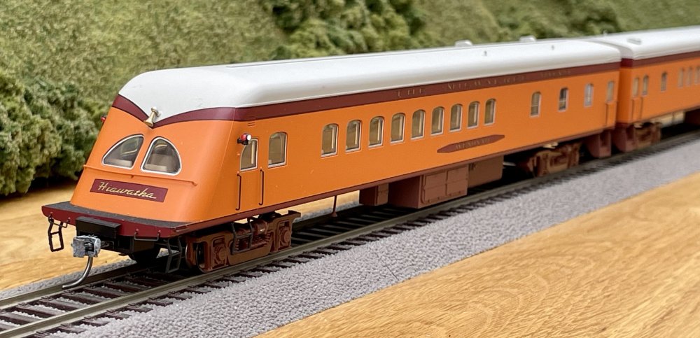

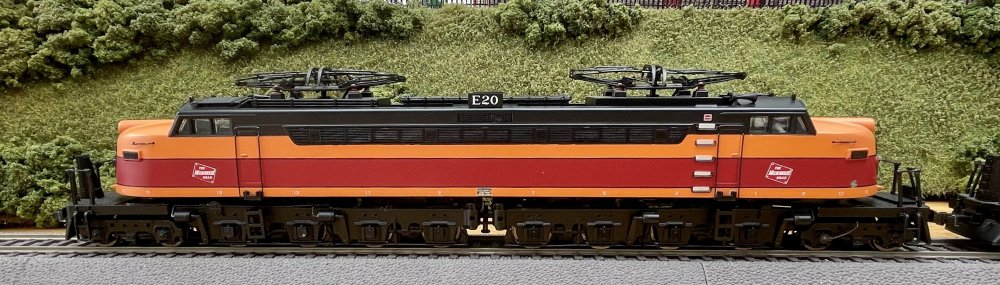

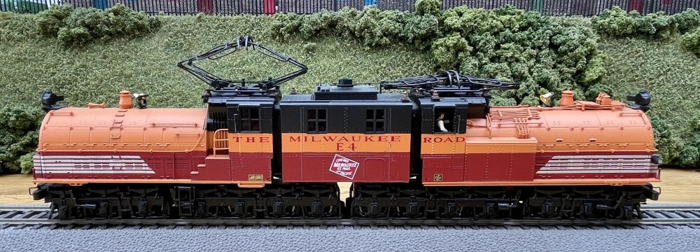

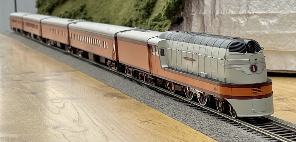

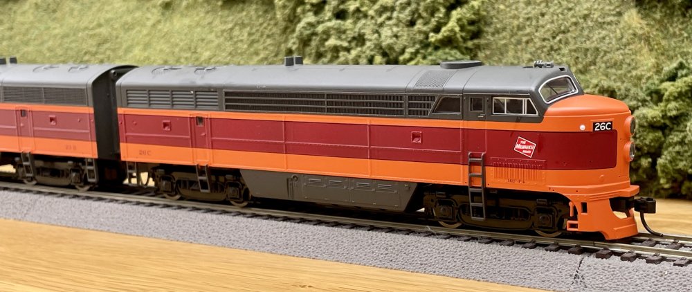

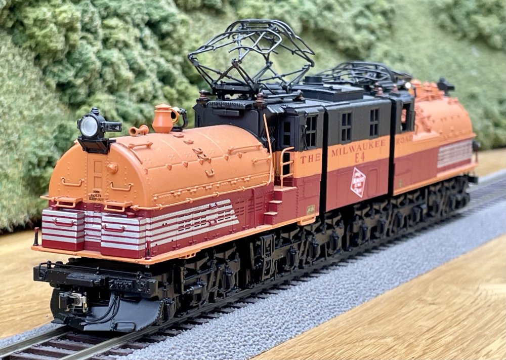

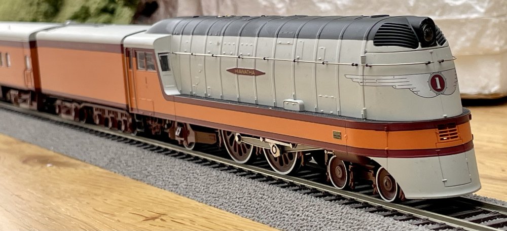

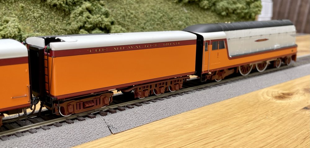

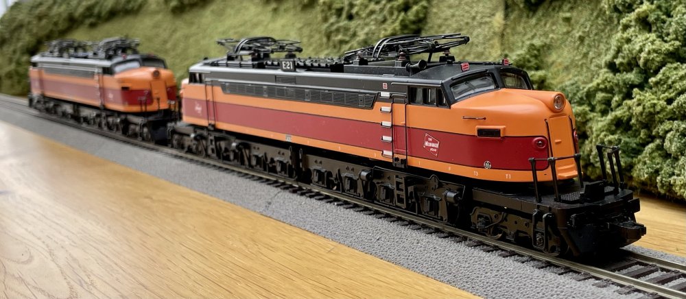

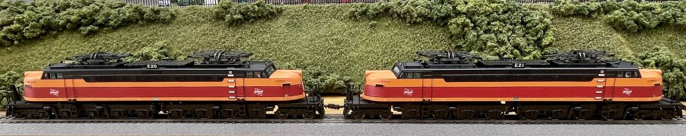

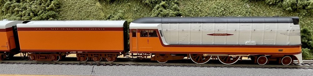

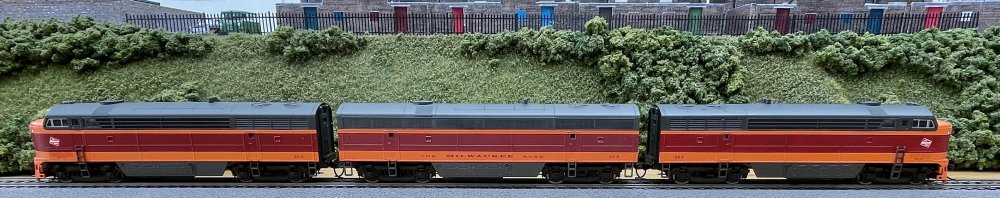

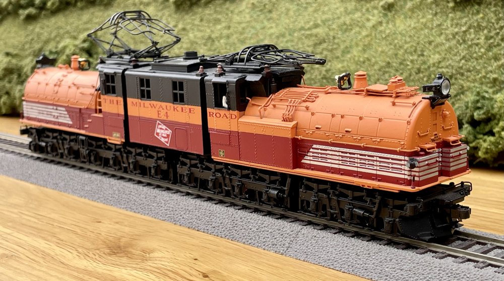

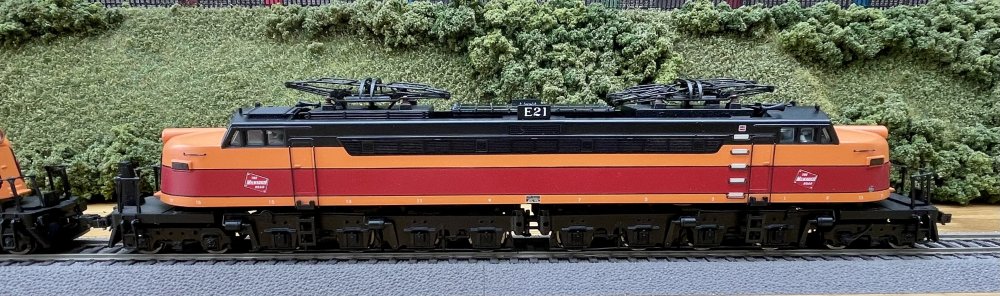

Hi Leslie.  You mentioned the Milwaukee Road…
Cheers
Darius
Edited by Darius43

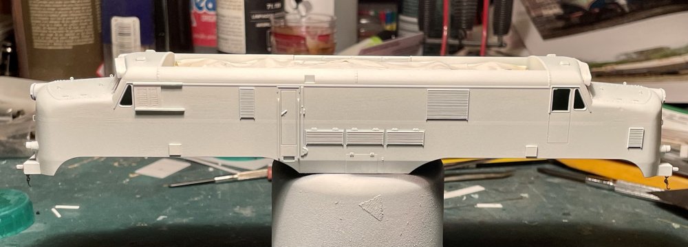

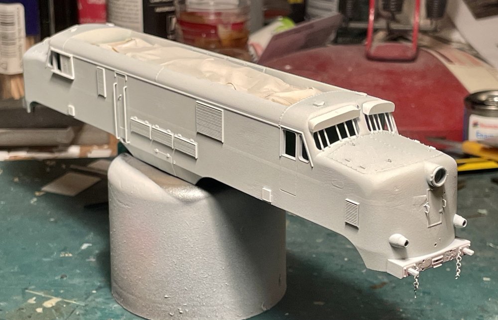

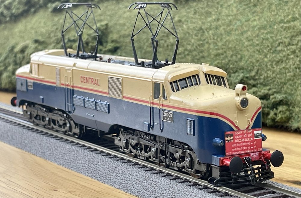

I have travelled by train several times between Mumbai and Pune and back on the Deccan Queen express.  The train used to be hauled by WCM1 electric locomotives that were built in the UK at the Vulcan Foundry and exported to India.
It would appear that similar locomotives were exported to Spain as witness this HO gauge model by Electrotren.

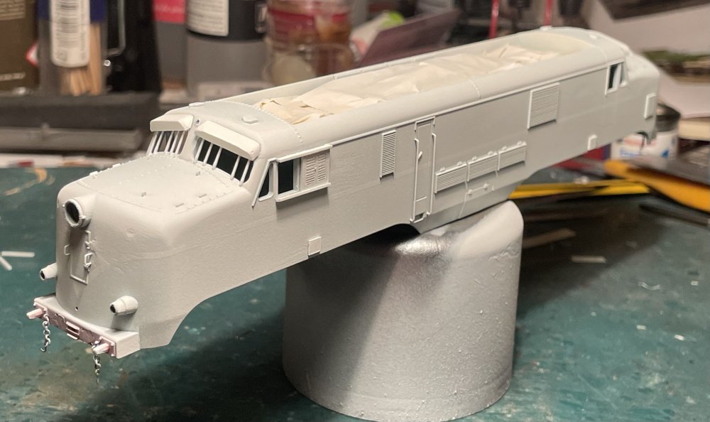

So hatched my plan to modify the Electrotren model to represent, as far as possible an Indian Railways WCM1.

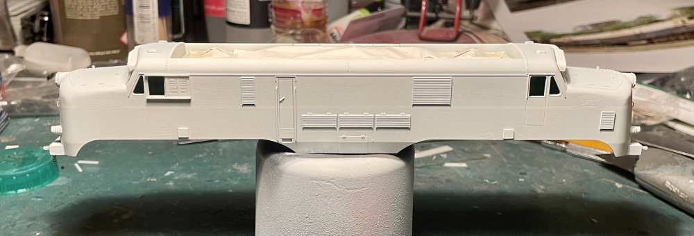

After removing the glazing etc. the redundant nose lights and jumper sockets were removed and filled.  Brass wire bars and shades were added to the cab windows and cab doors carefully scribed.
Primer on.

Thanks for that wonderful display of Milwaukee Road motive power! The "Bi-Polars" were remarkable looking beasts. Those early electrics were nothing if not the very manifestation of complexity. They must have costs ten times what a Choo choo would have cost!

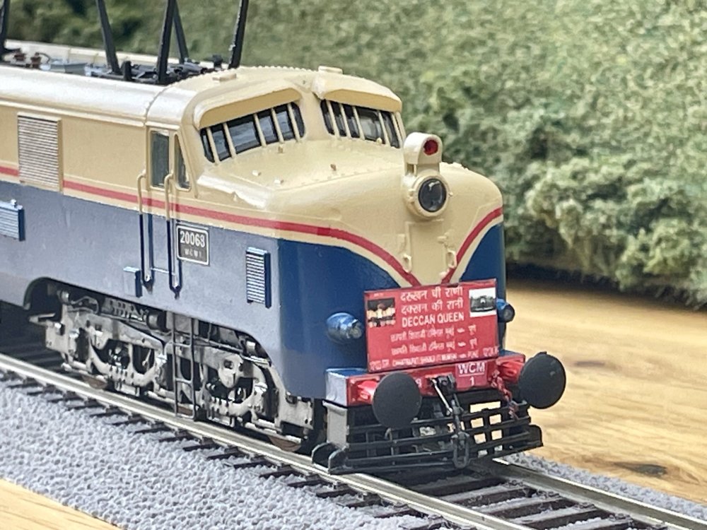

Bogie frames painted black and re fitted.  Cab glazing and headlight glazing re-fitted.  New round buffers fitted.  Body re-attached to chassis.
Awaiting decals and additional details.
Cheers
Darius
Cow catcher made from plasticard and fixed to the removable front valence that came with the model locomotive.
It’s almost brushing the tops of the rails so further modifications will be required.  I have a cunning plan…
Modified cow catcher fitted.
Cheers
Darius
Edited by Darius43
  • Like 8

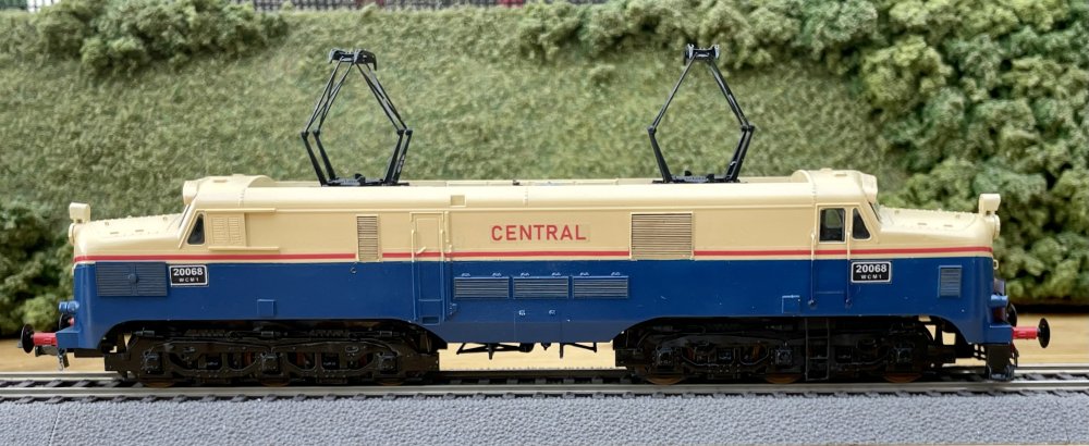

Calling this finished now - added buffer beam steps the the coupling end, bogie speedometers and light weathering to the chassis.
Cheers
Darius

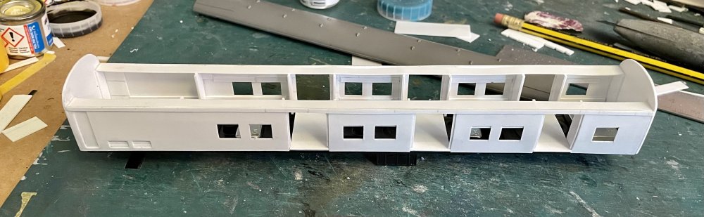

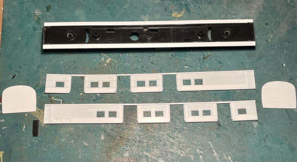

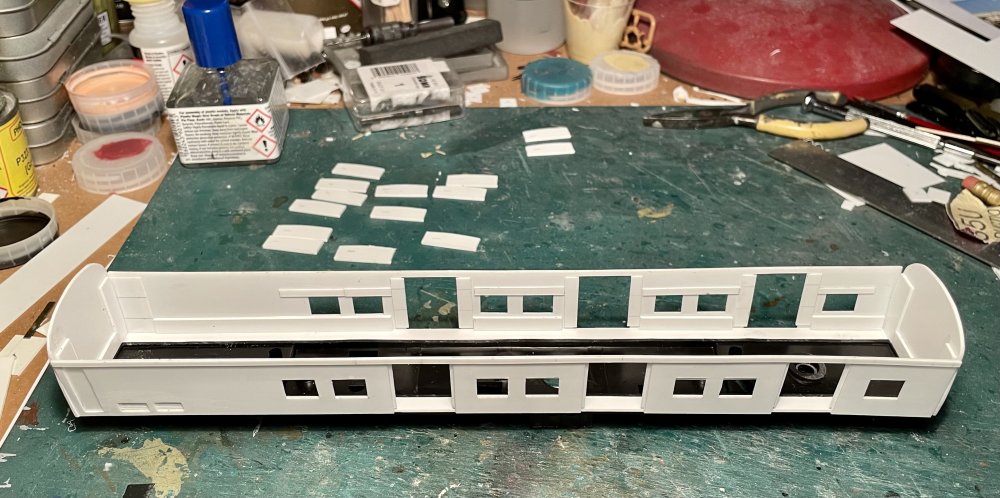

Made a start on an ICF coach for the Deccan Queen using plasticard sheets to build up the lower coach body.  It is designed to fit on a cut down Triang Mk1 coach chassis.
The coach sides will be thin plasticard with the windows cut out - similar to the Bombay Local.  An internal framework of plasticard provides strength and something for the coach sides to fix to.
The Triang coach roof is modified to fit.
The scale is approximately 1:87 HO to match the WCM1 loco recently converted from an Electrotren HO model.  I adjusted the coach sides slightly to match the Triang coach length.
I now have rather a lot of windows to cut out…
Cheers
Darius

What's the process for cutting out the windows?
Do you repeatedly score the same lines with a blade until you slice through?
Hi DJ.  I drill out the window corners with a smallish diameter bit in a pin vice (to create the curved corners) and then cut between them with a new/sharp blade.  I then clean the opening up with needle files.
Cheers
Darius
