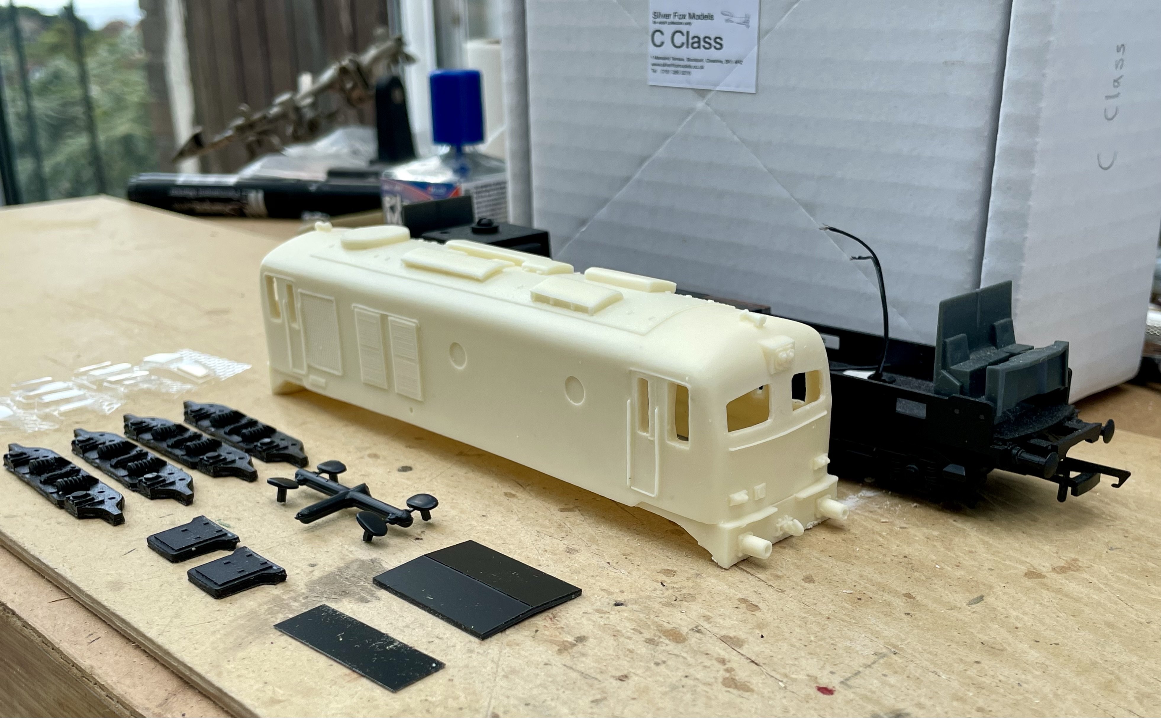

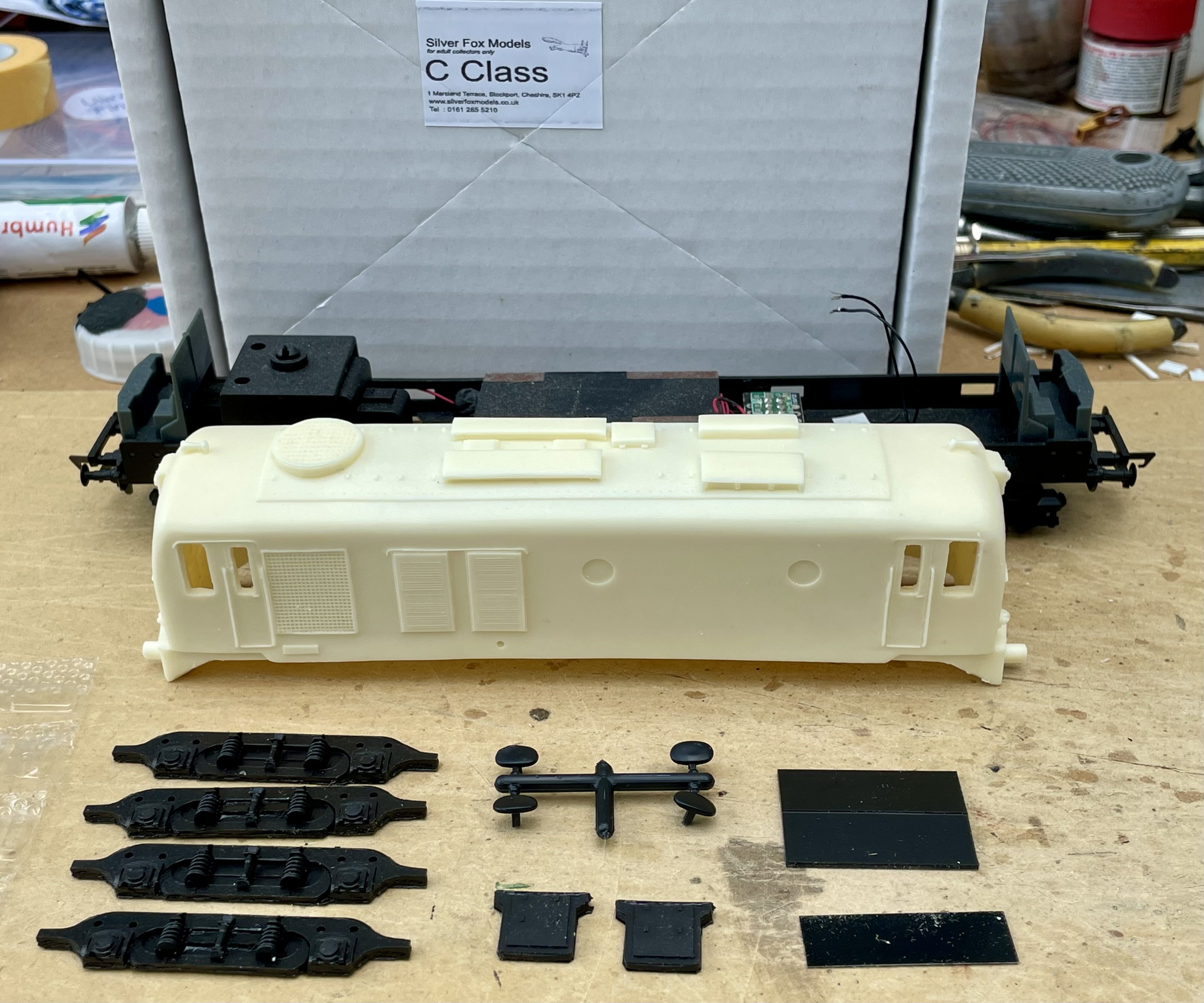

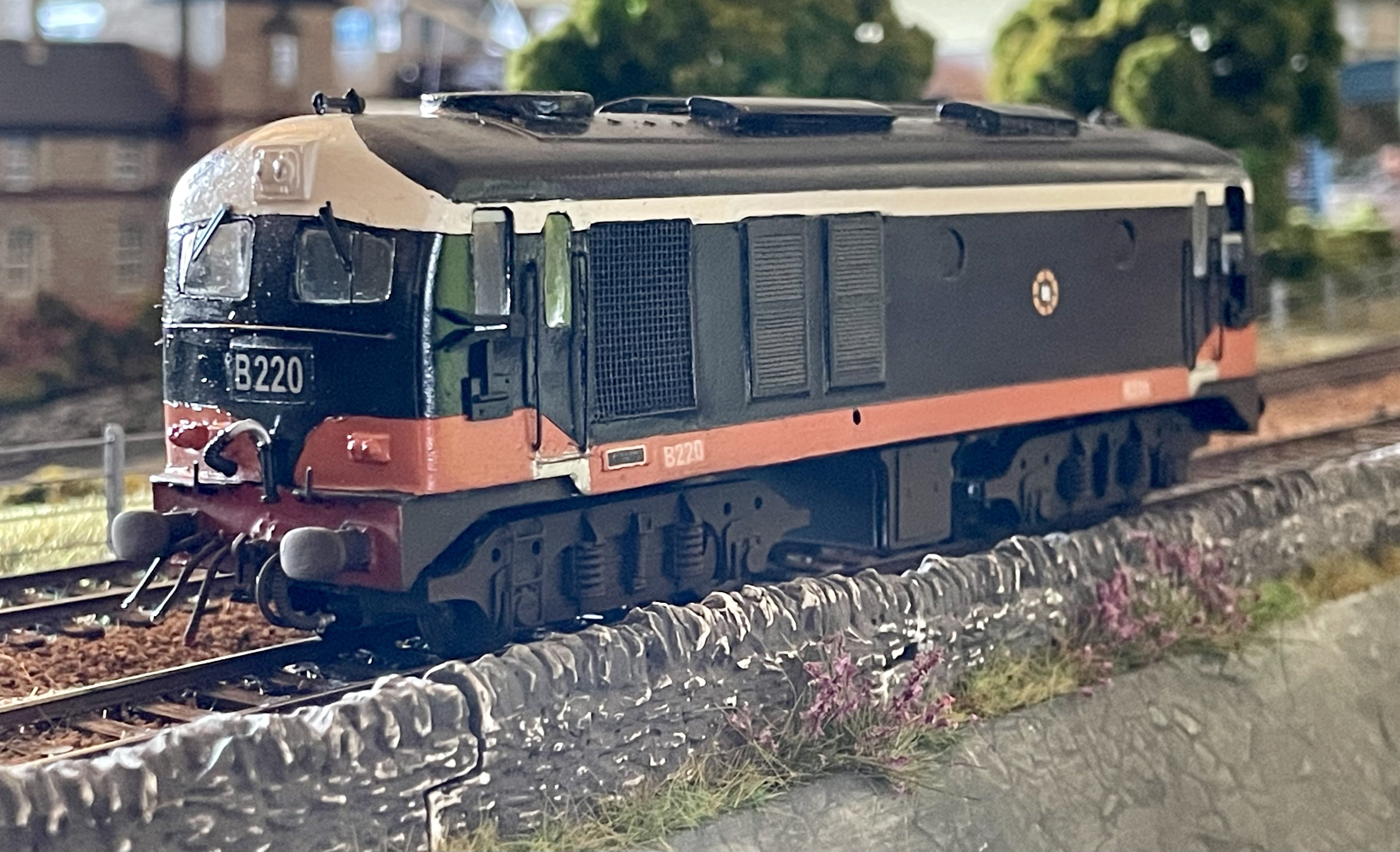

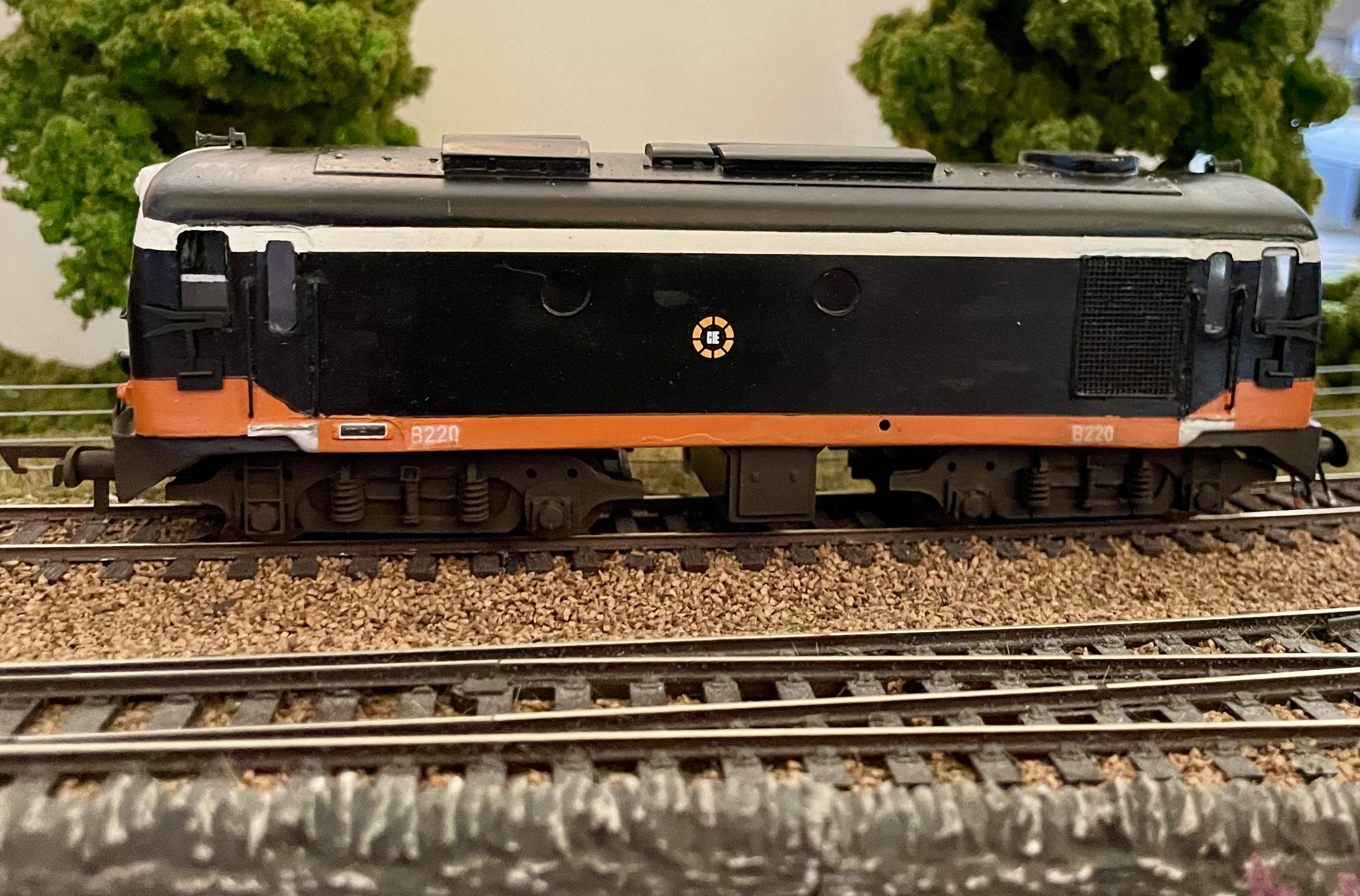

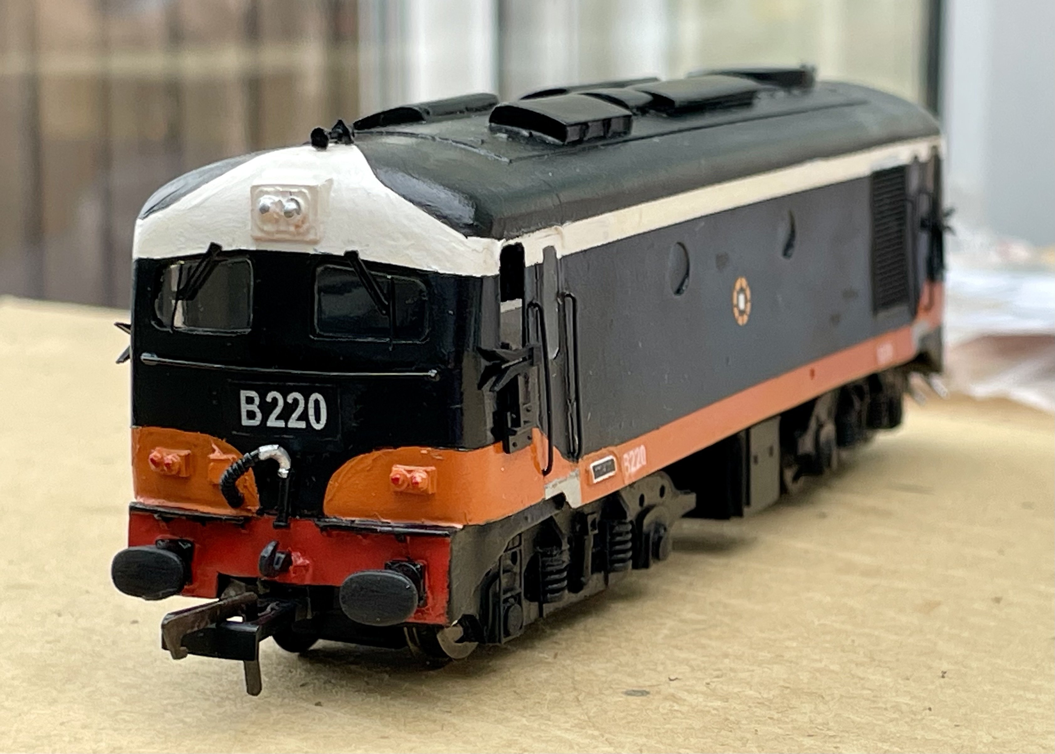

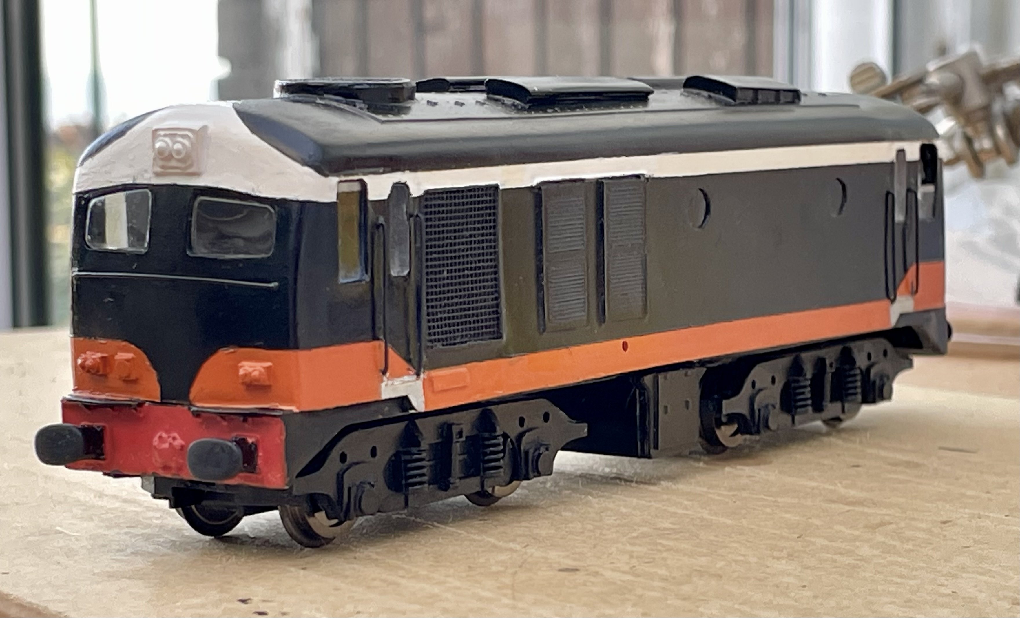

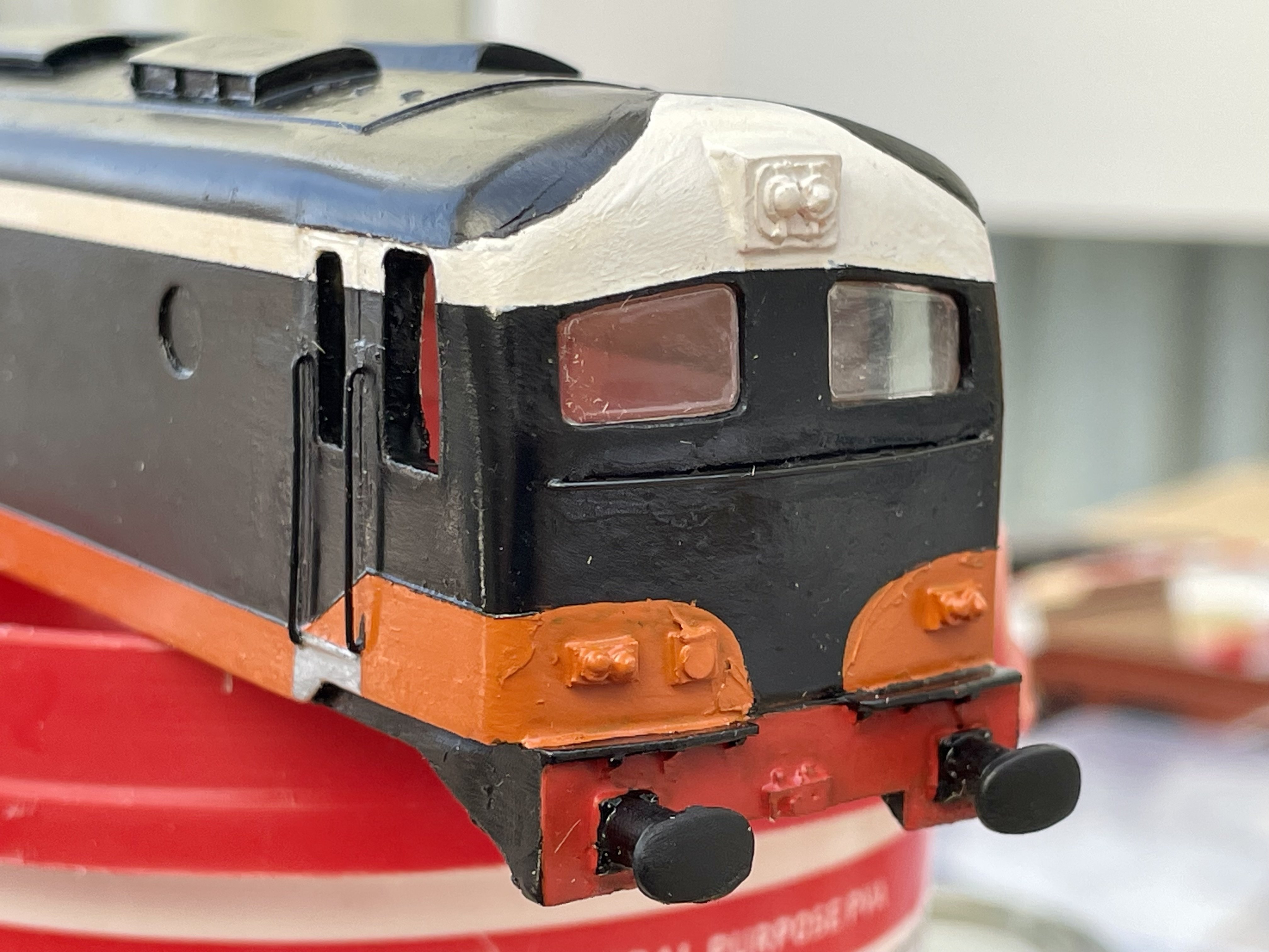

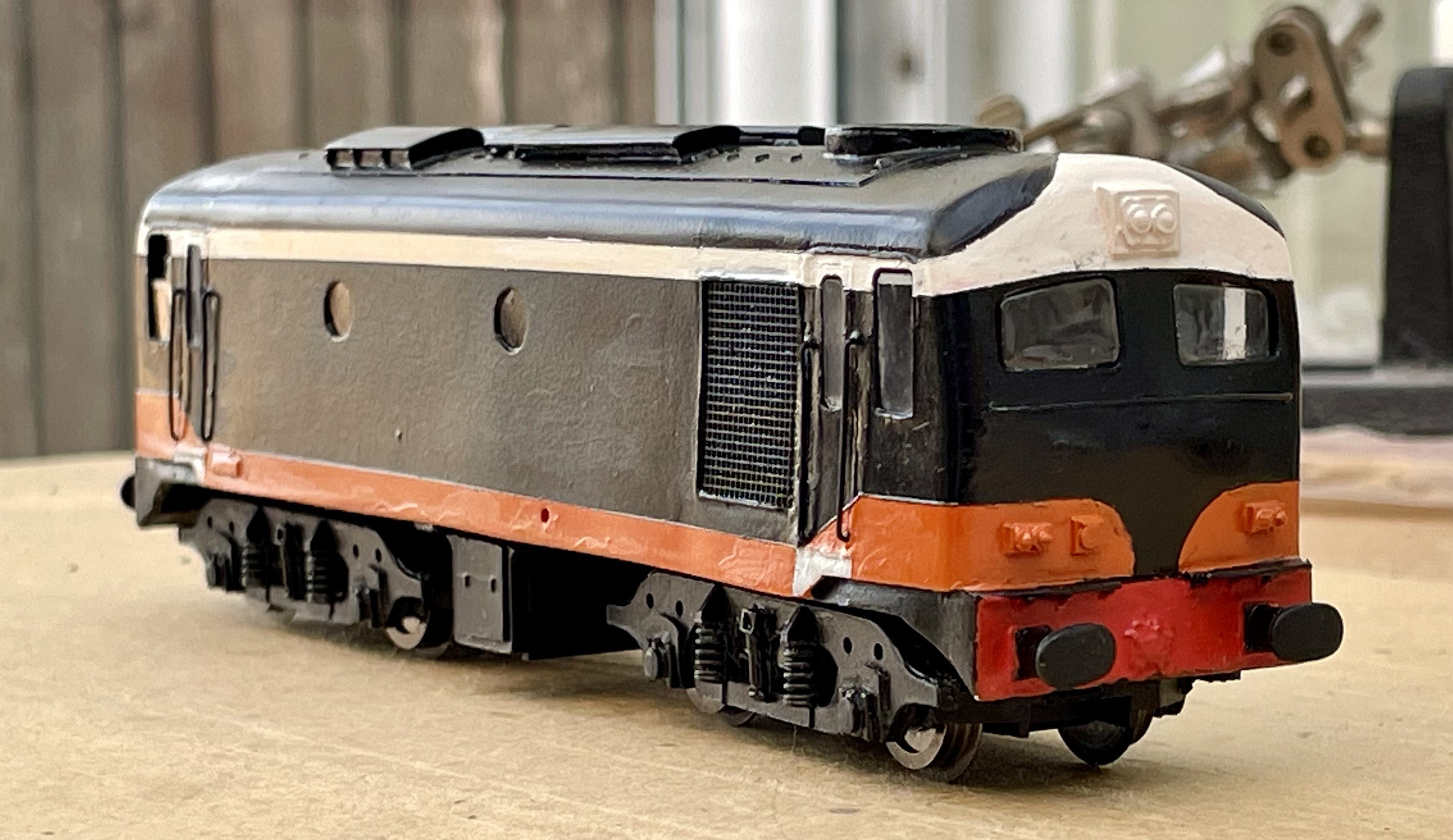

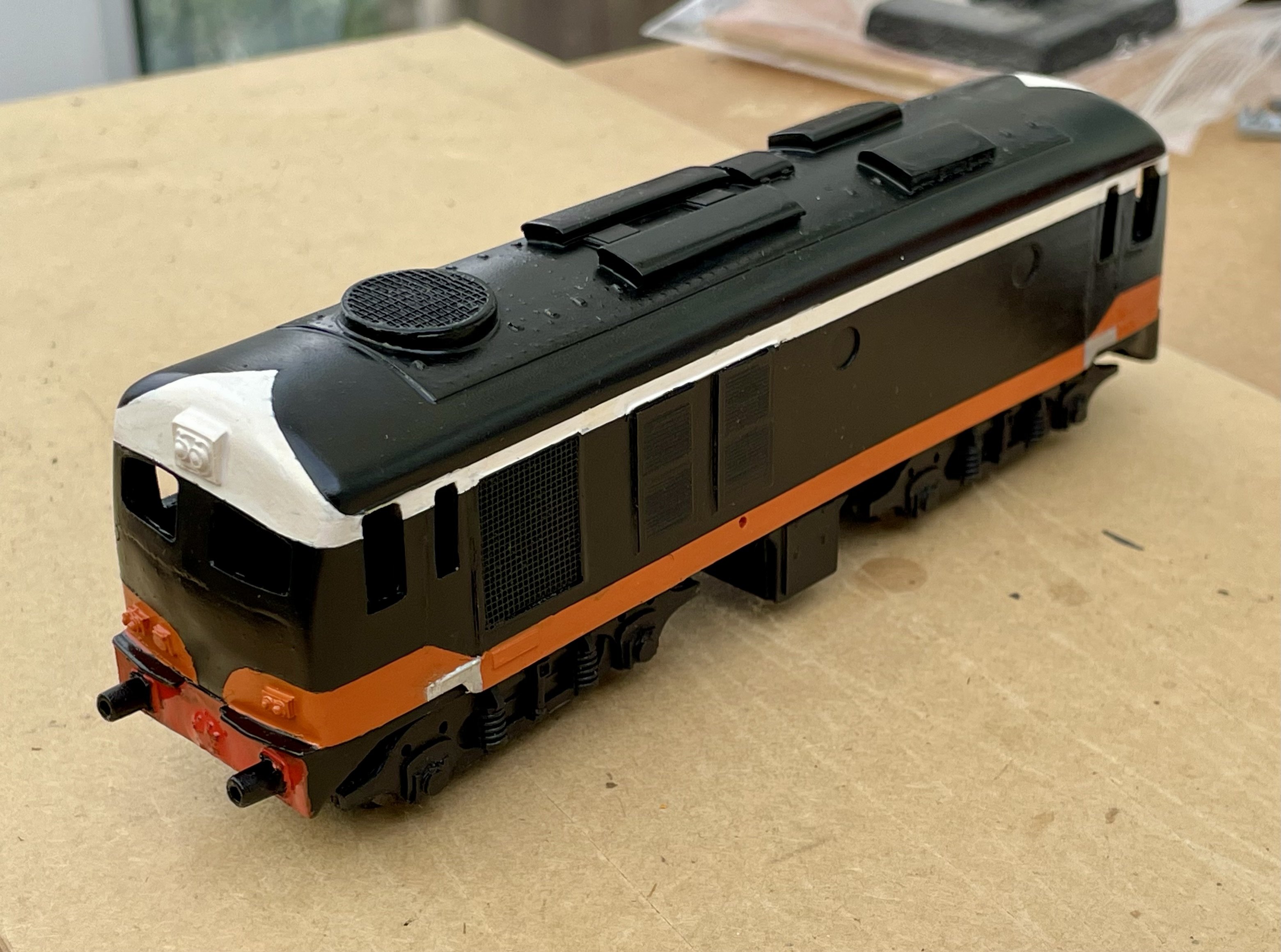

Back to Irish Railway Modelling, and the next project has arrived 😀
Plan is to finish it in Black & Tan livery.
B204 Connolly
Cheers
Darius
Edited by Darius43
  • Like 14

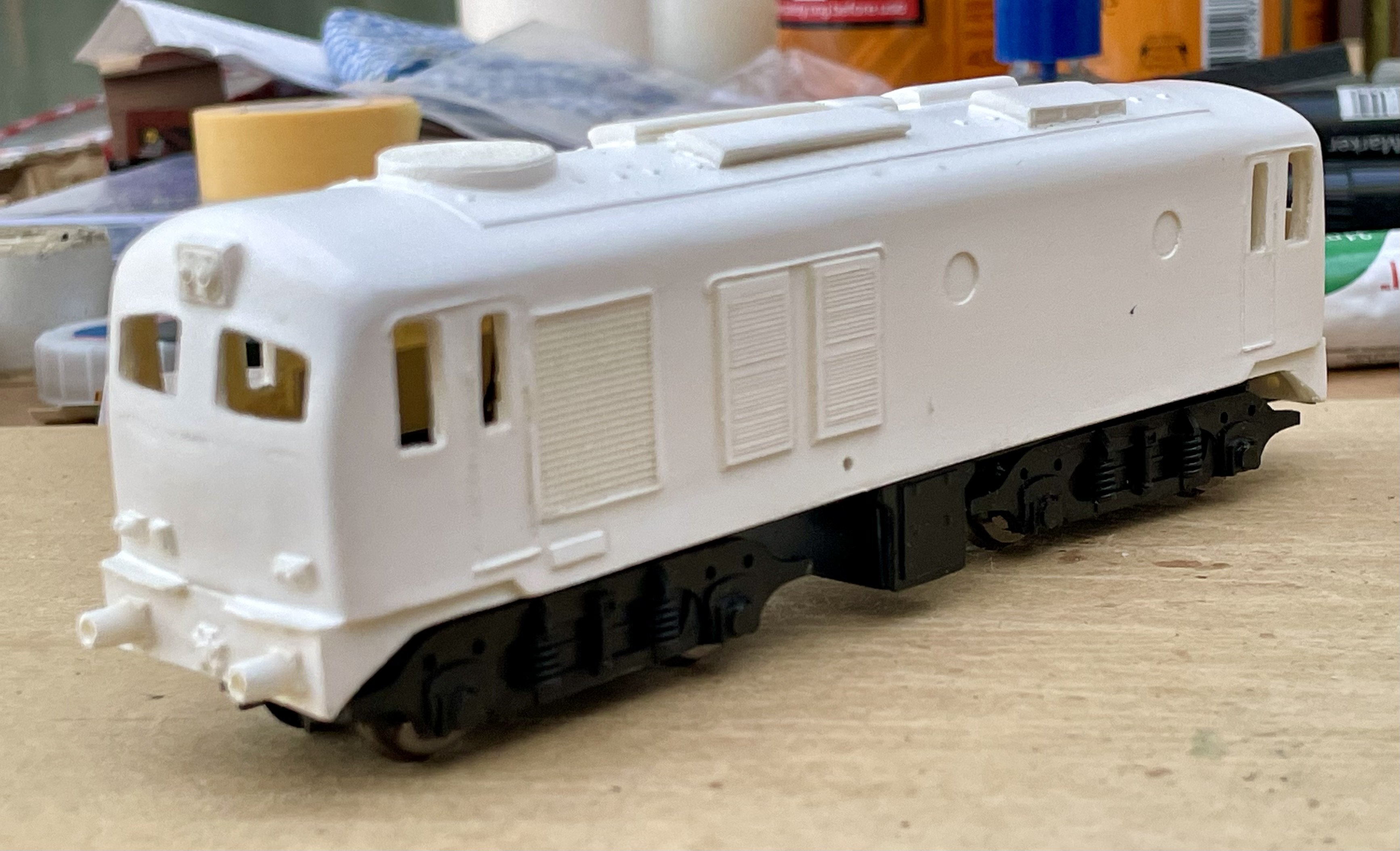

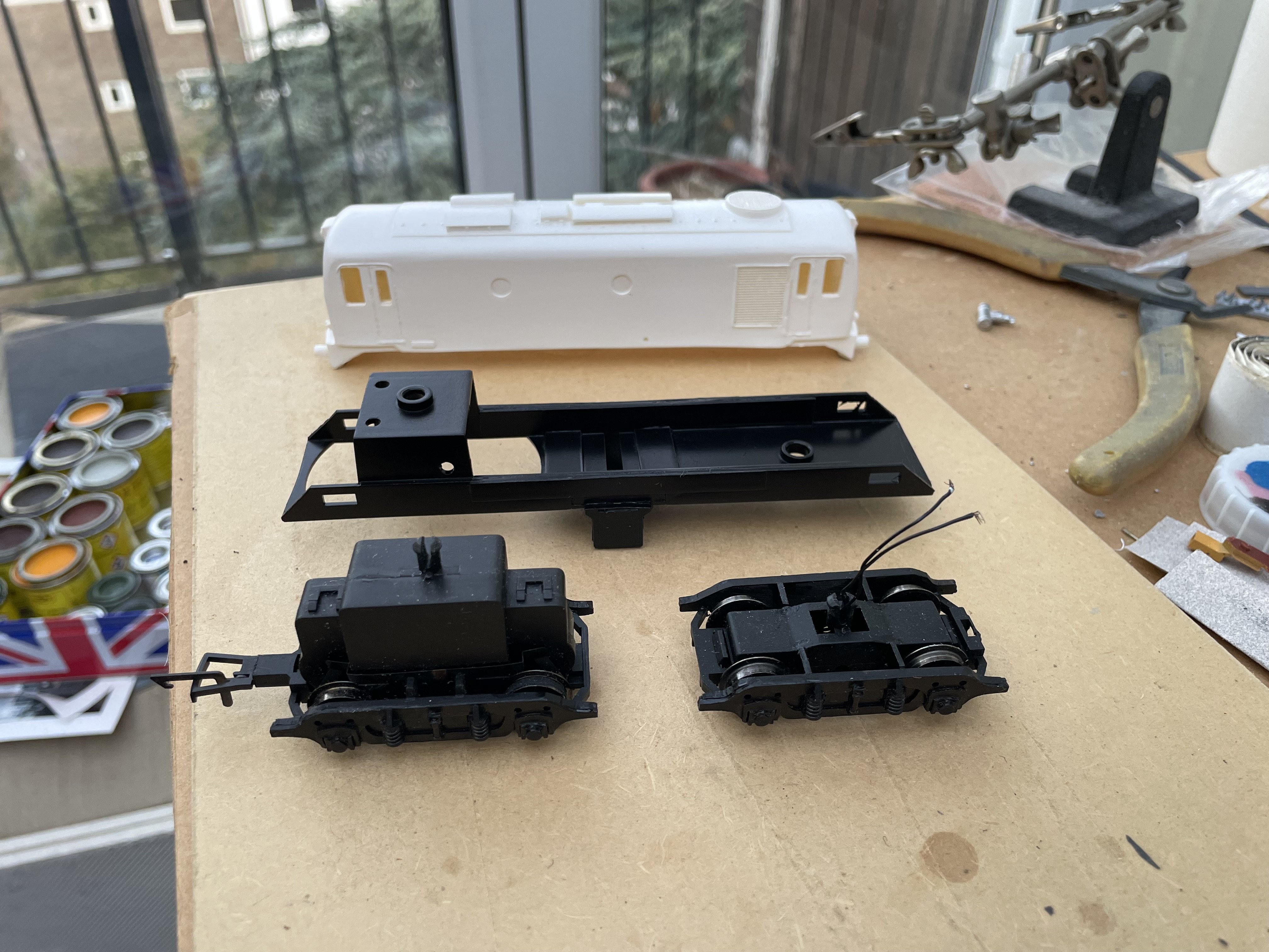

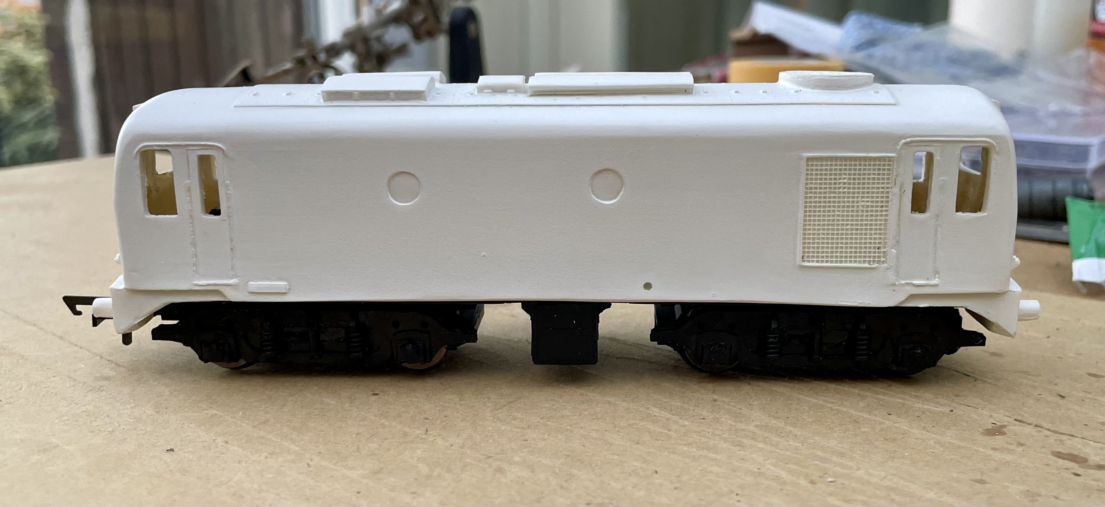

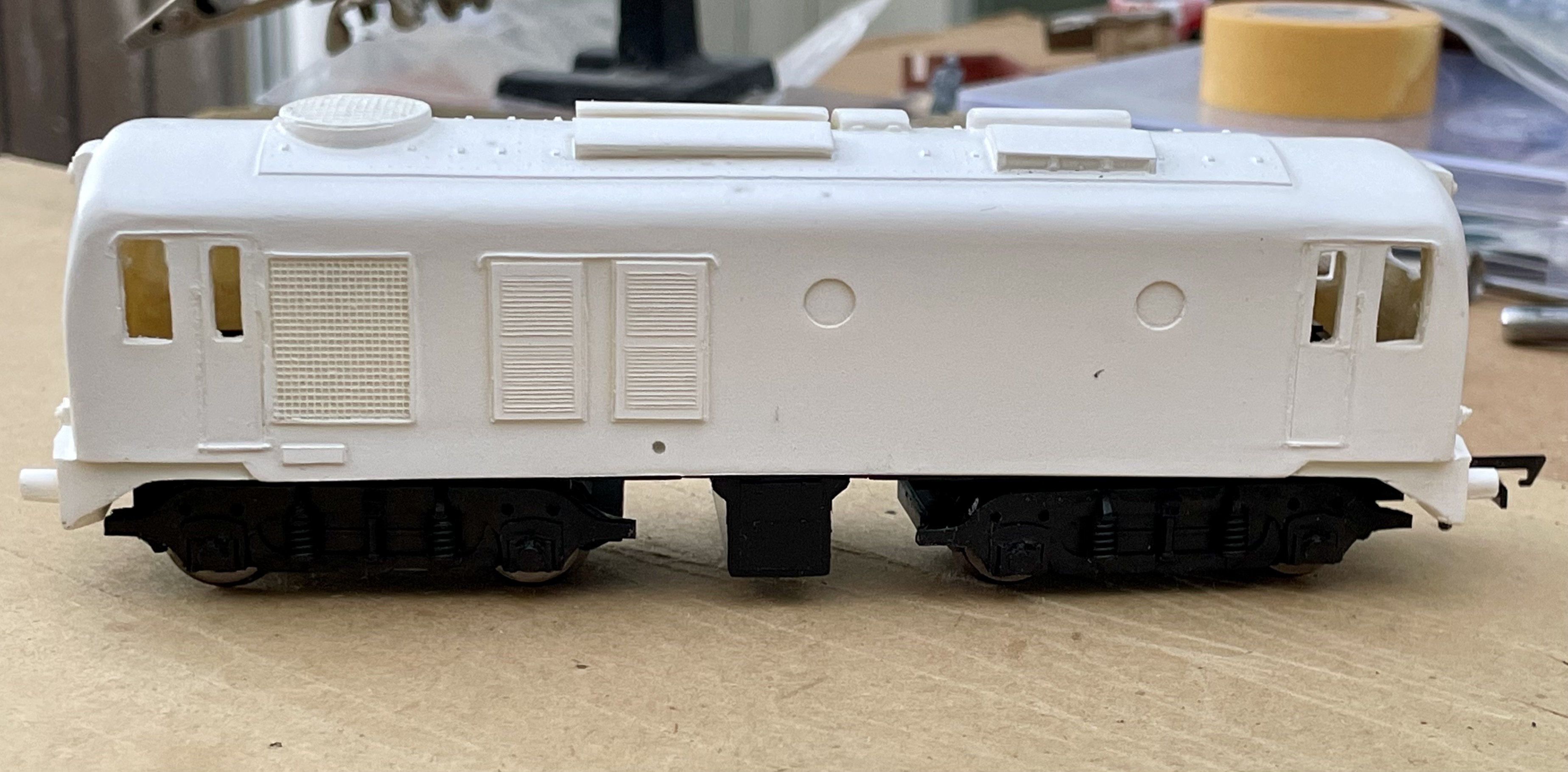

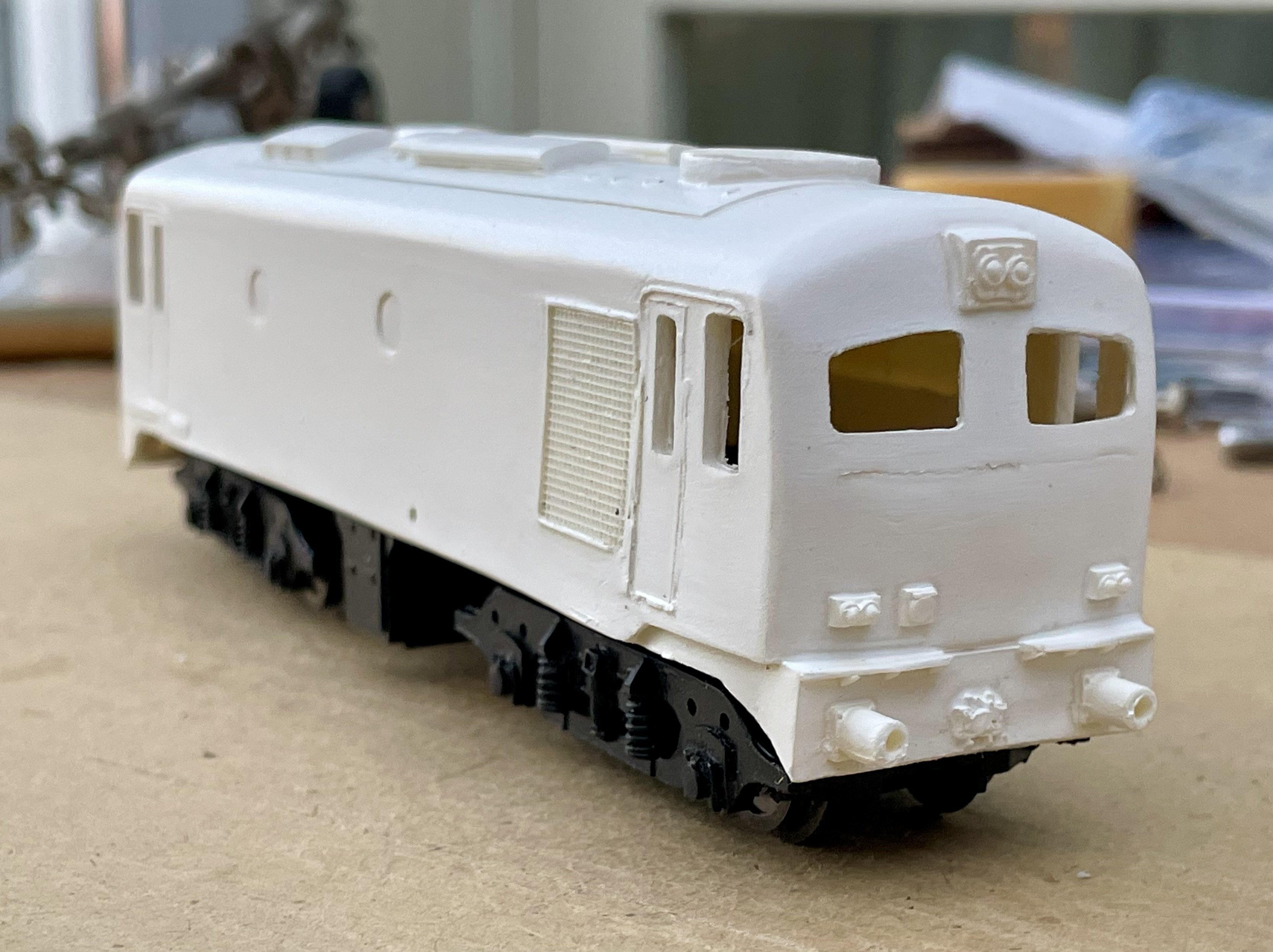

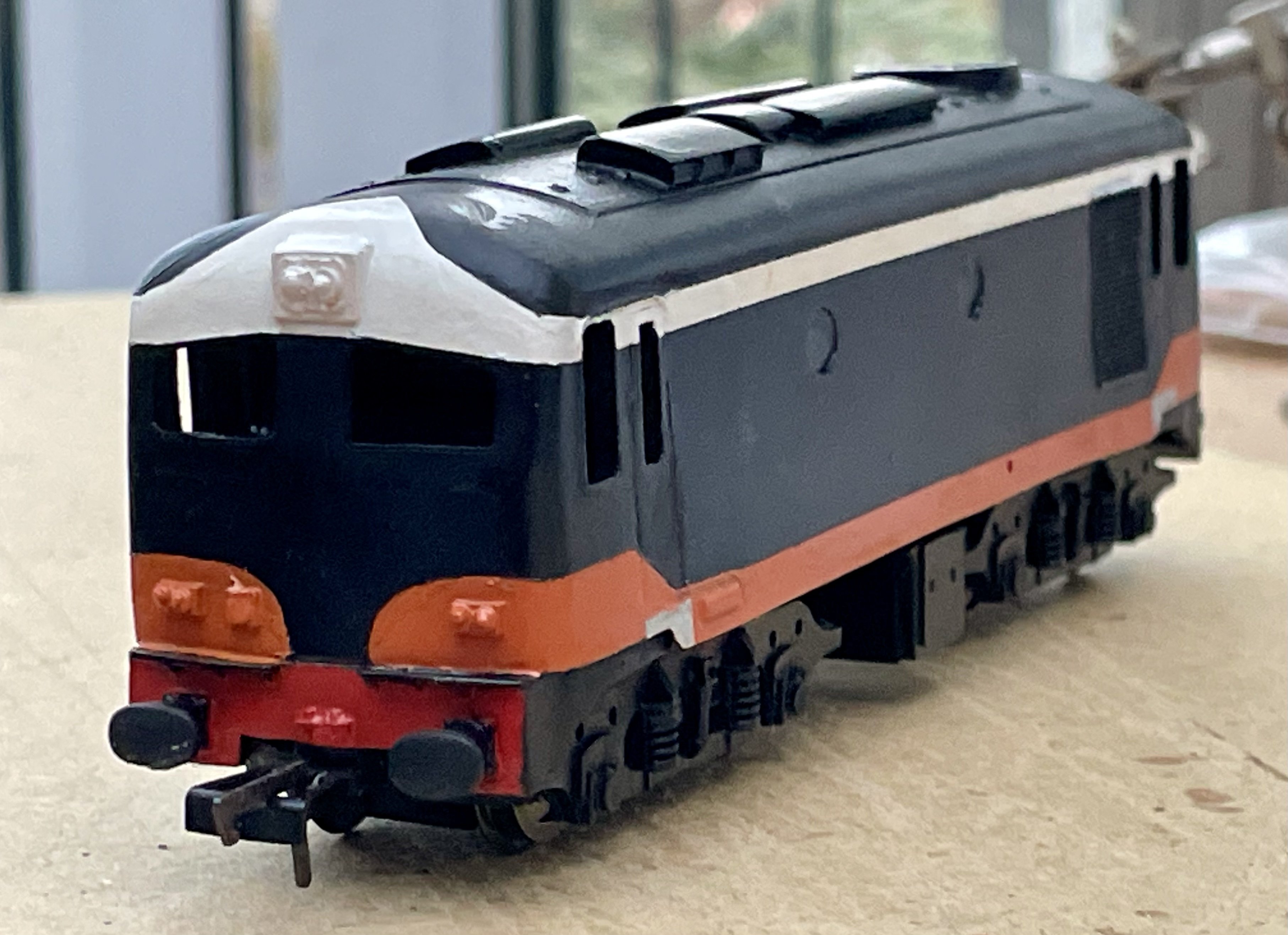

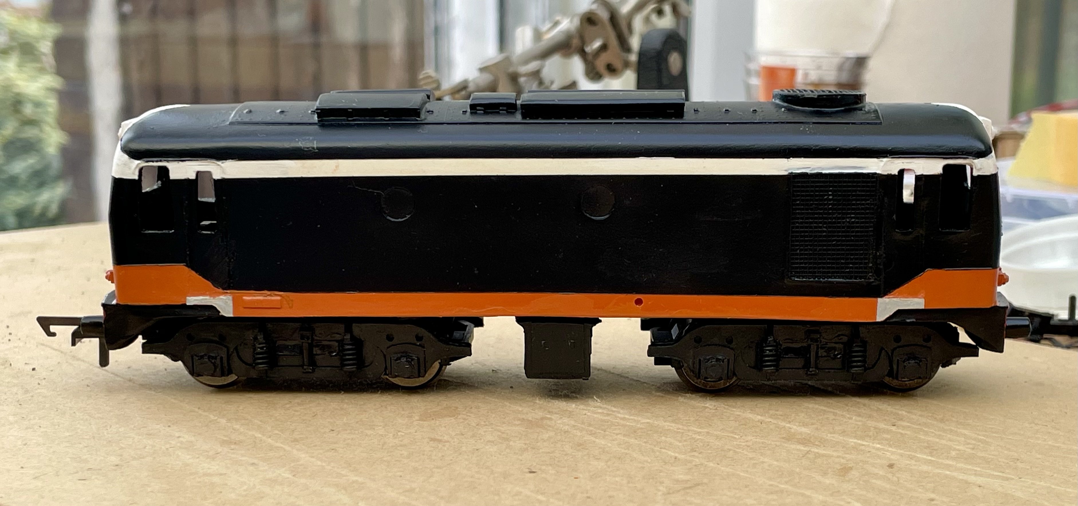

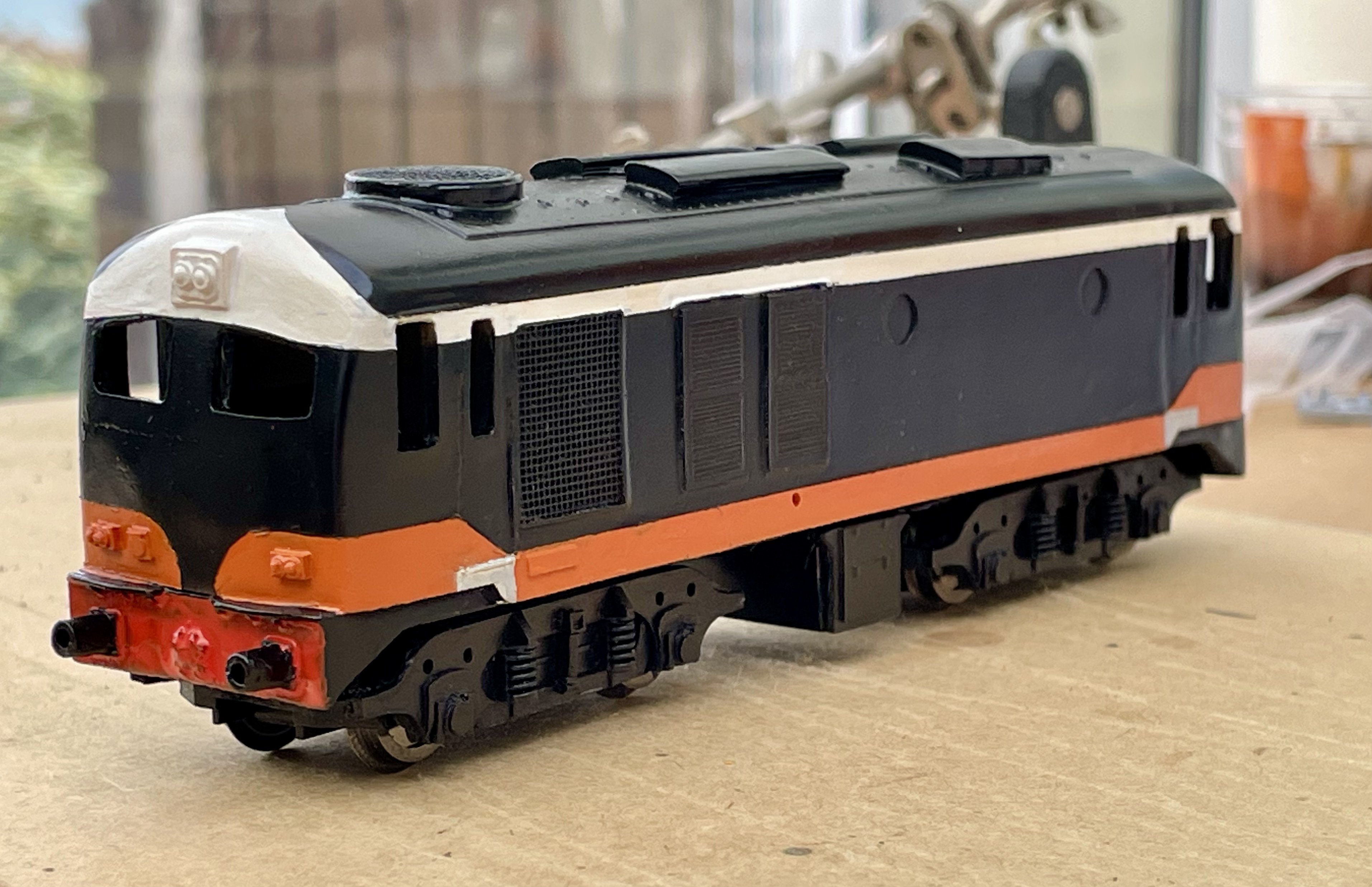

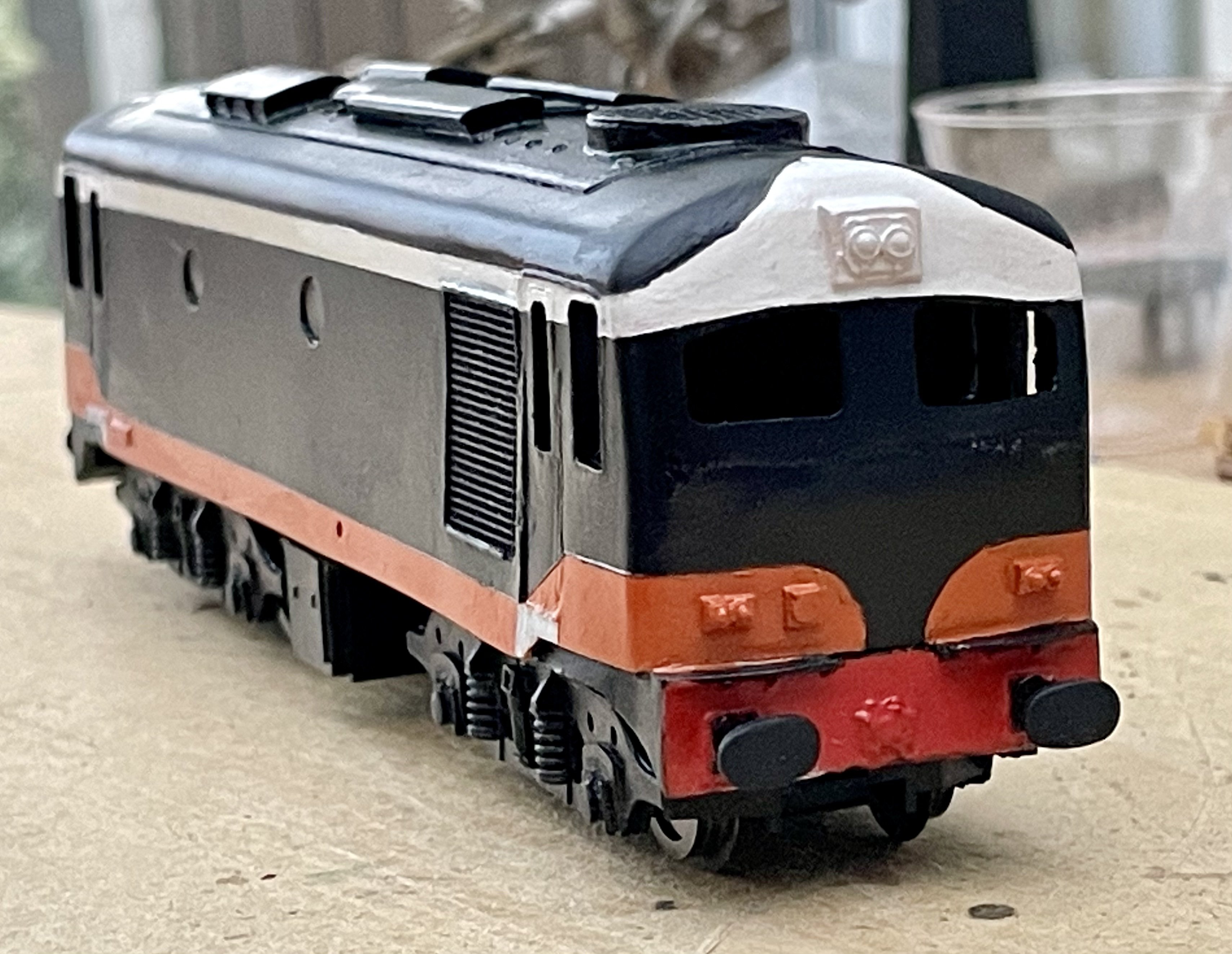

- Resin body cleaned up and sprayed with white primer.
- Hornby Class 73 chassis cut and shut to size with plasticard reinforcement.
- Sides cut from Hornby bogies and replacements grafted on.
Cheers
Darius
  • Like 8

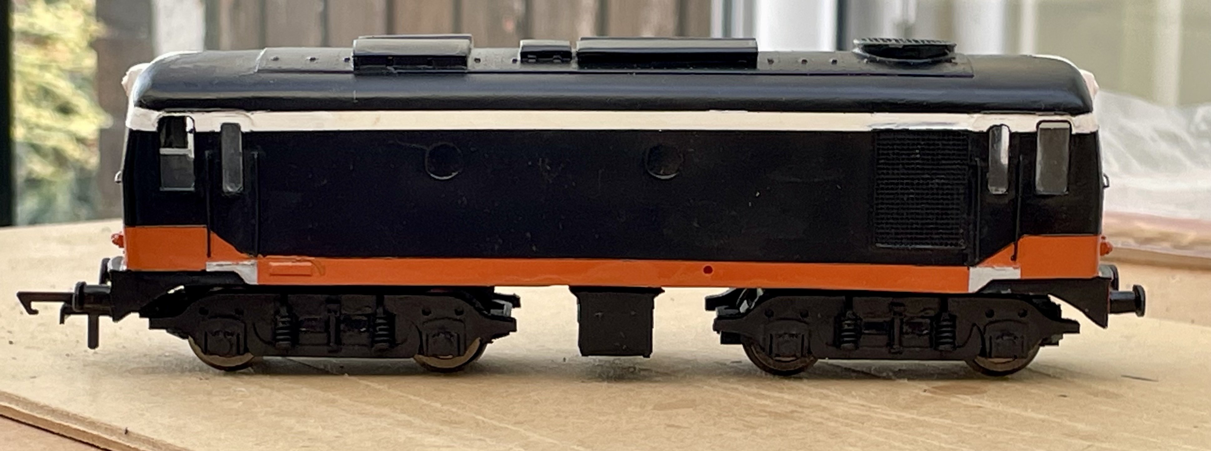

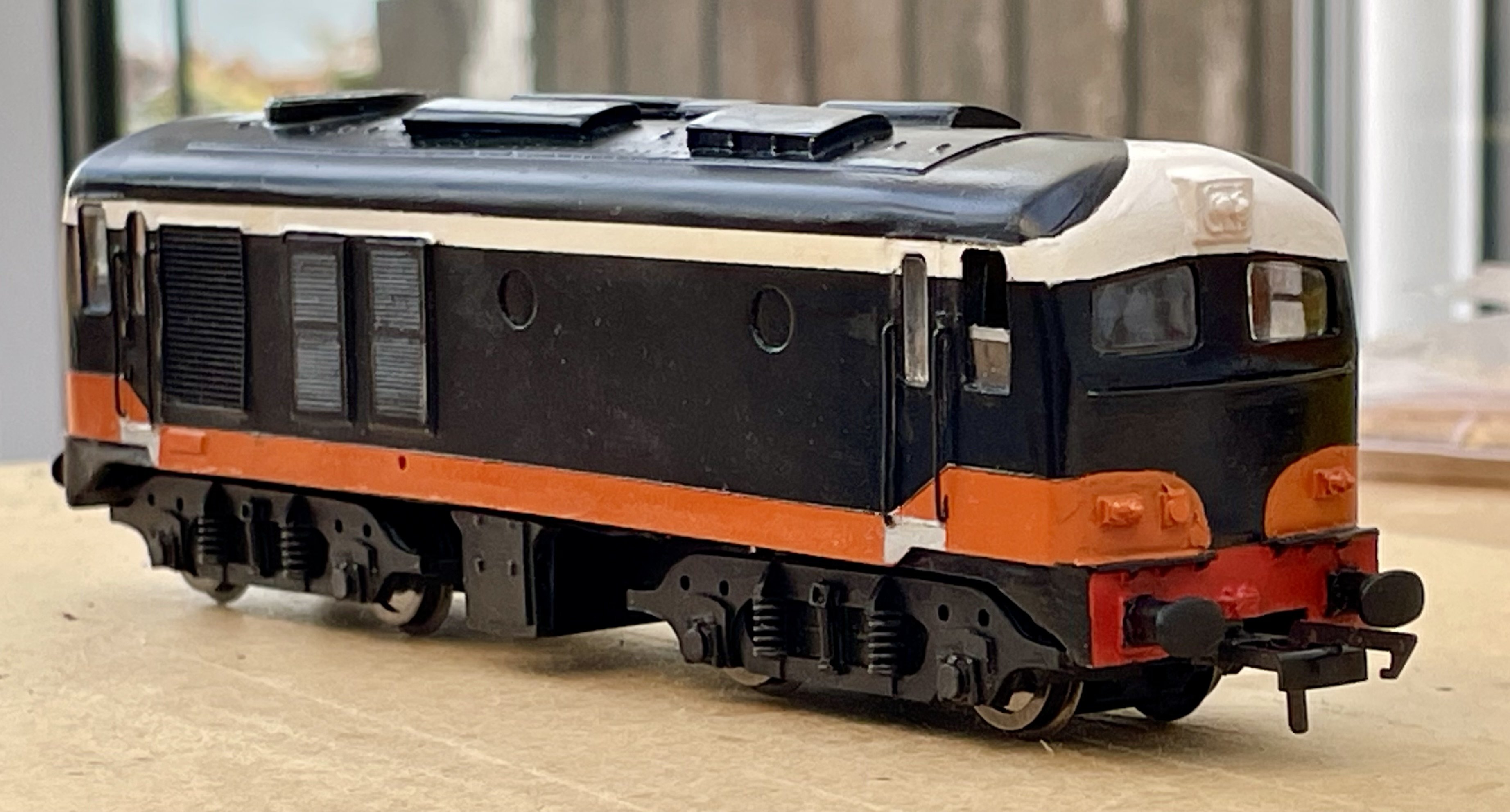

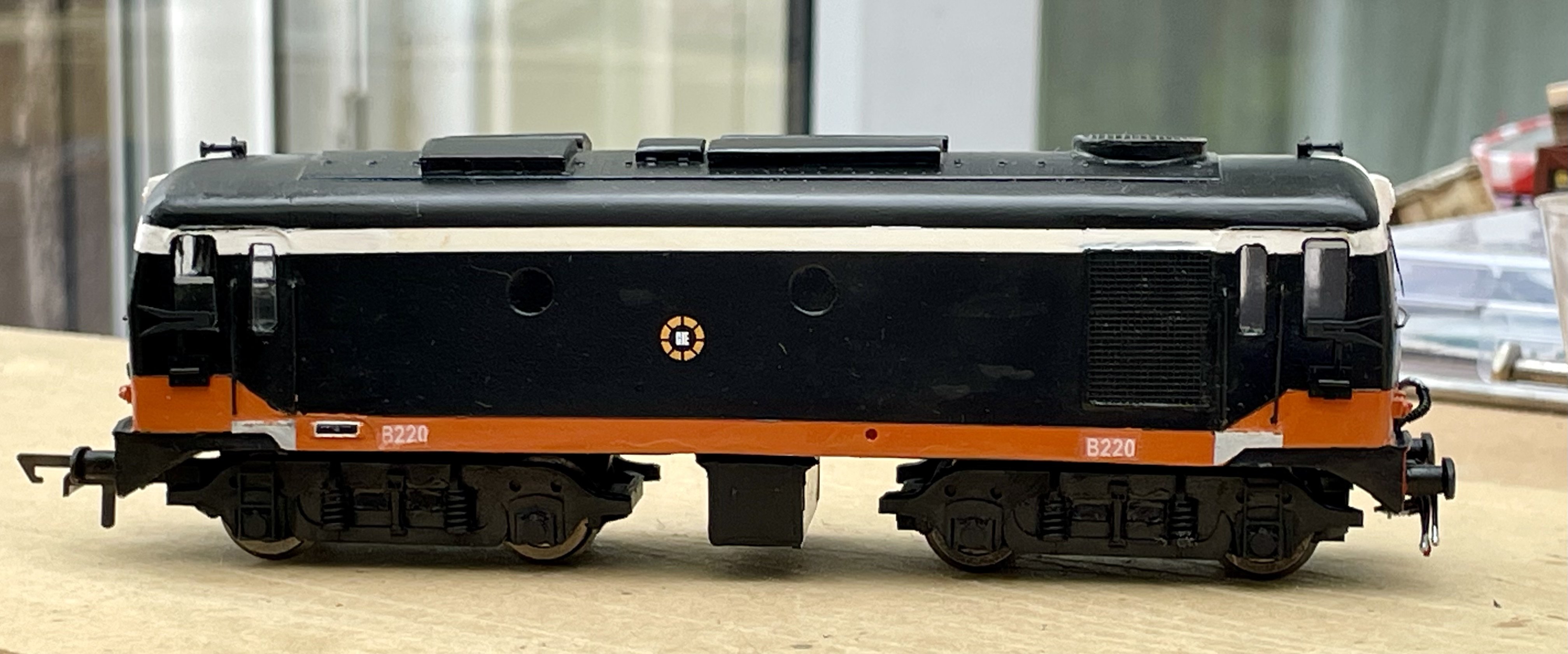

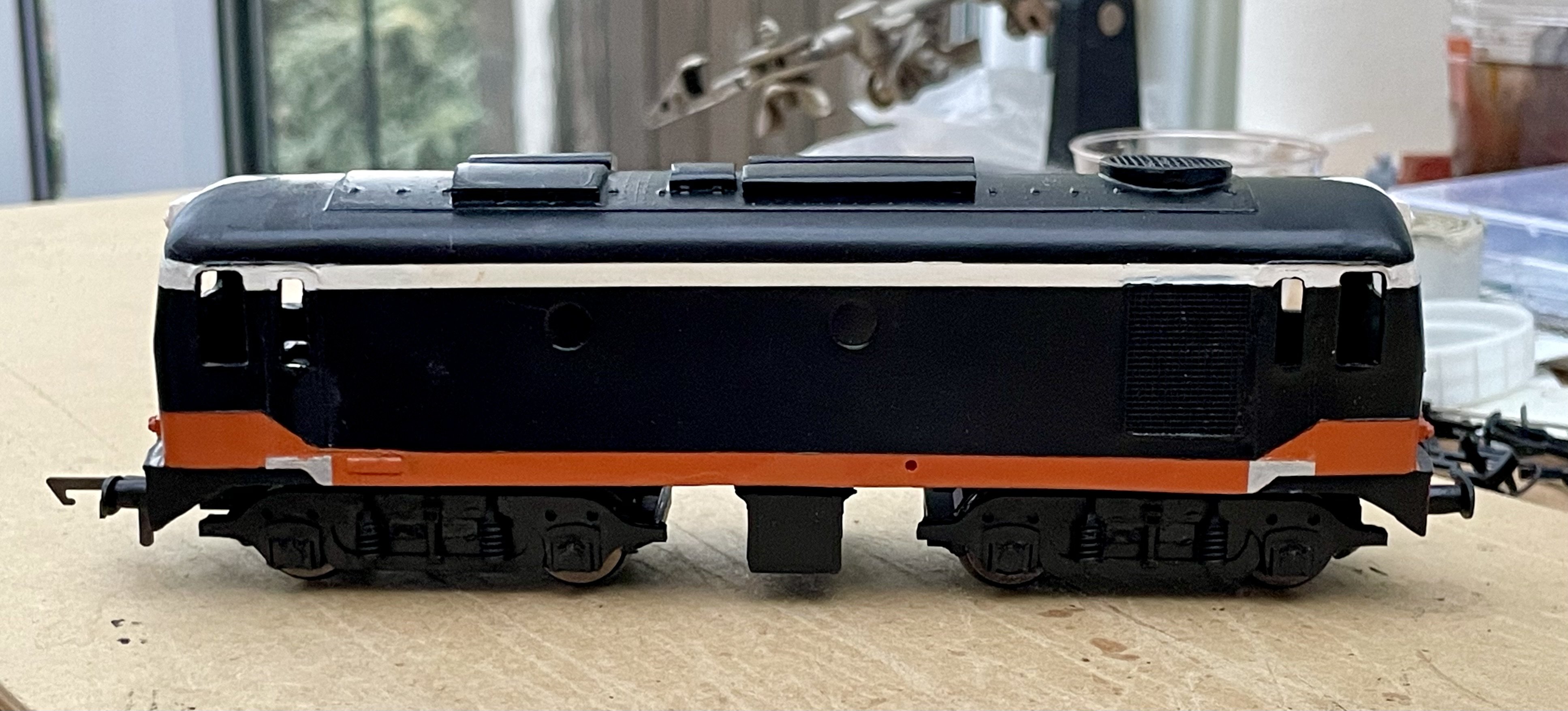

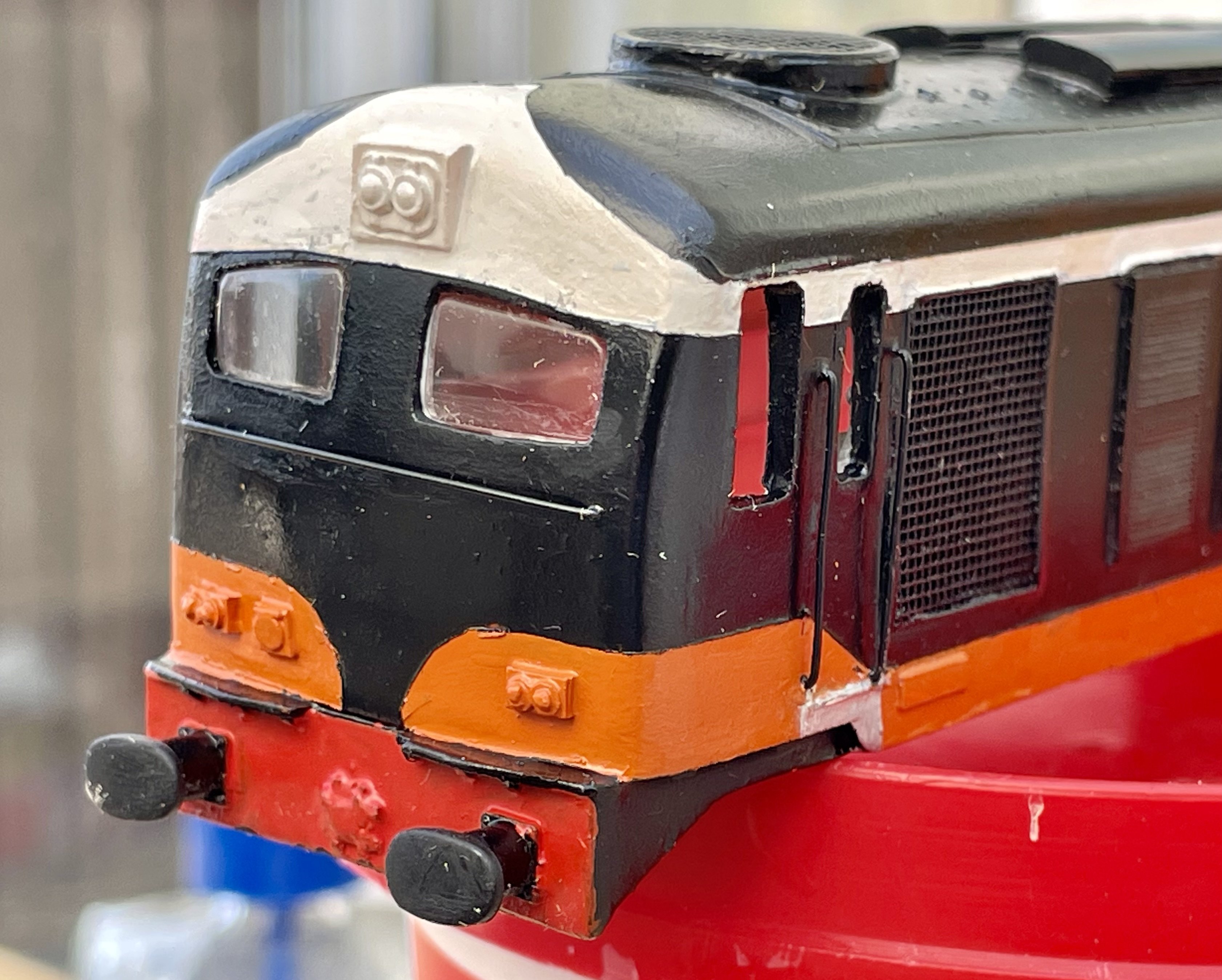

Phoenix “CIE Golden Brown” enamel airbrushed on.

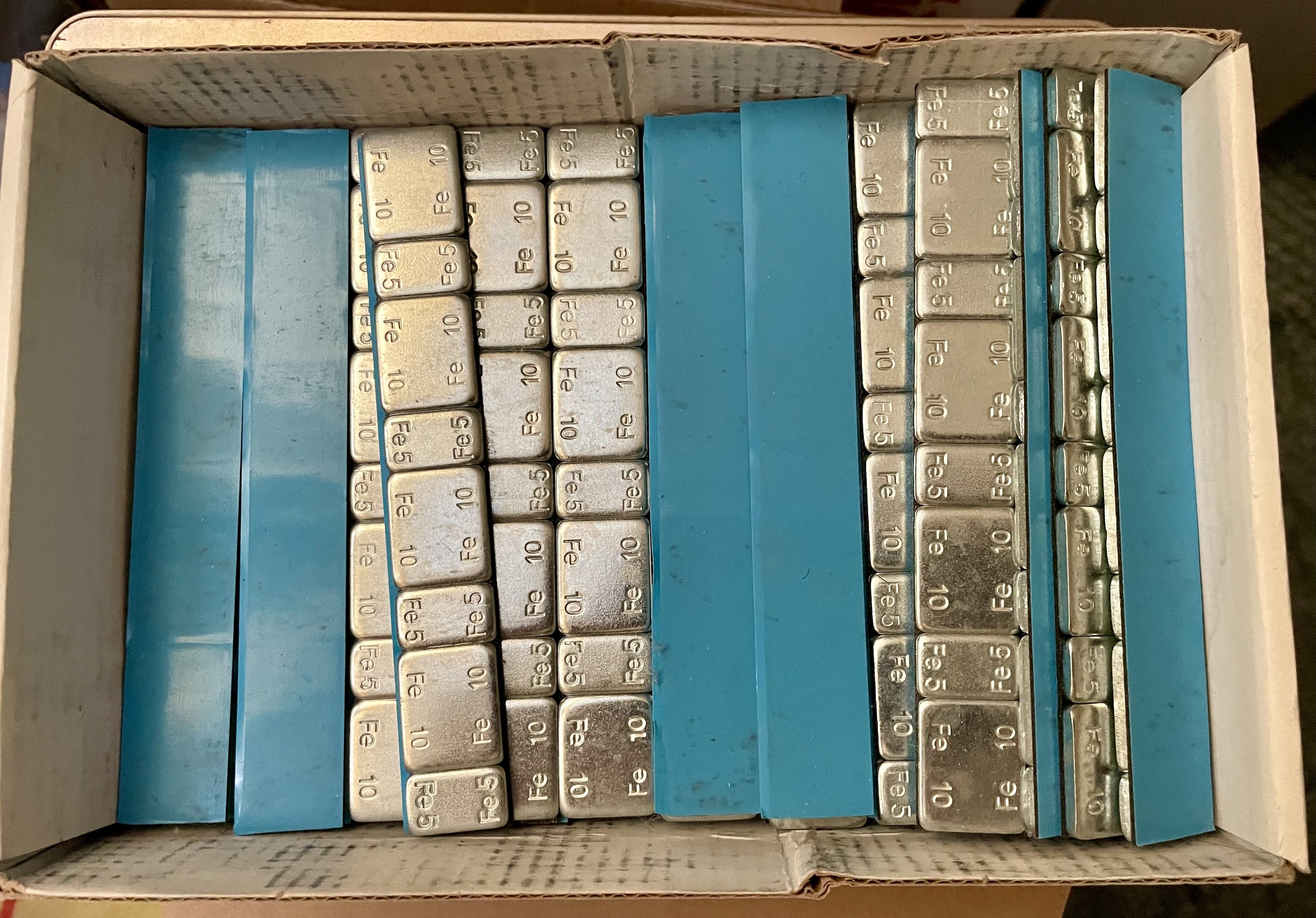

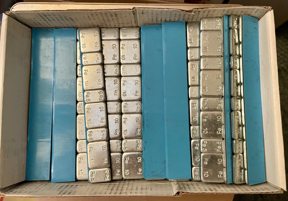

Self adhesive car wheel balancing weights fixed to chassis.   I got a big box full of these quite cheaply several years ago before they started being sold as single strips to railway modellers at exorbitant prices.
Cheers
Darius
  • Like 11
1 hour ago, Darius43 said:
Self adhesive car wheel balancing weights fixed to chassis.   I got a big box full of these quite cheaply several years ago before they started being sold as single strips to railway modellers at exorbitant prices....
I think you can still buy them cheaply in bulk from automotive sources / car parts suppliers.
  • Agree 1
40 minutes ago, Mike 84C said:
Befriend your local tyre dealer, the weights often get thrown away. the metal only discolours .
I’ve had this box of weights for about 10 years now and am just about half way through.
I think I’m good.
Cheers
Darius
  • Agree 1

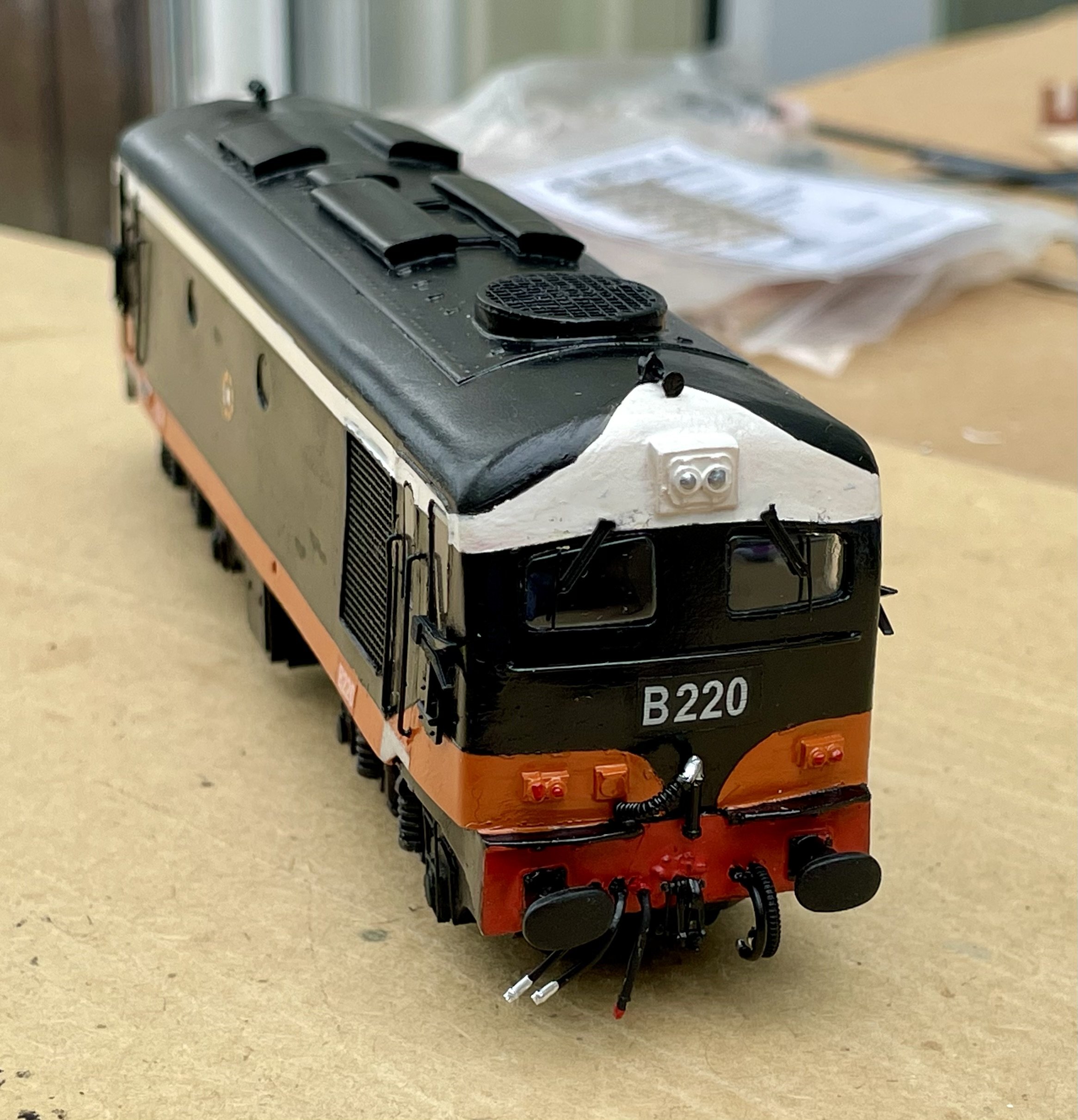

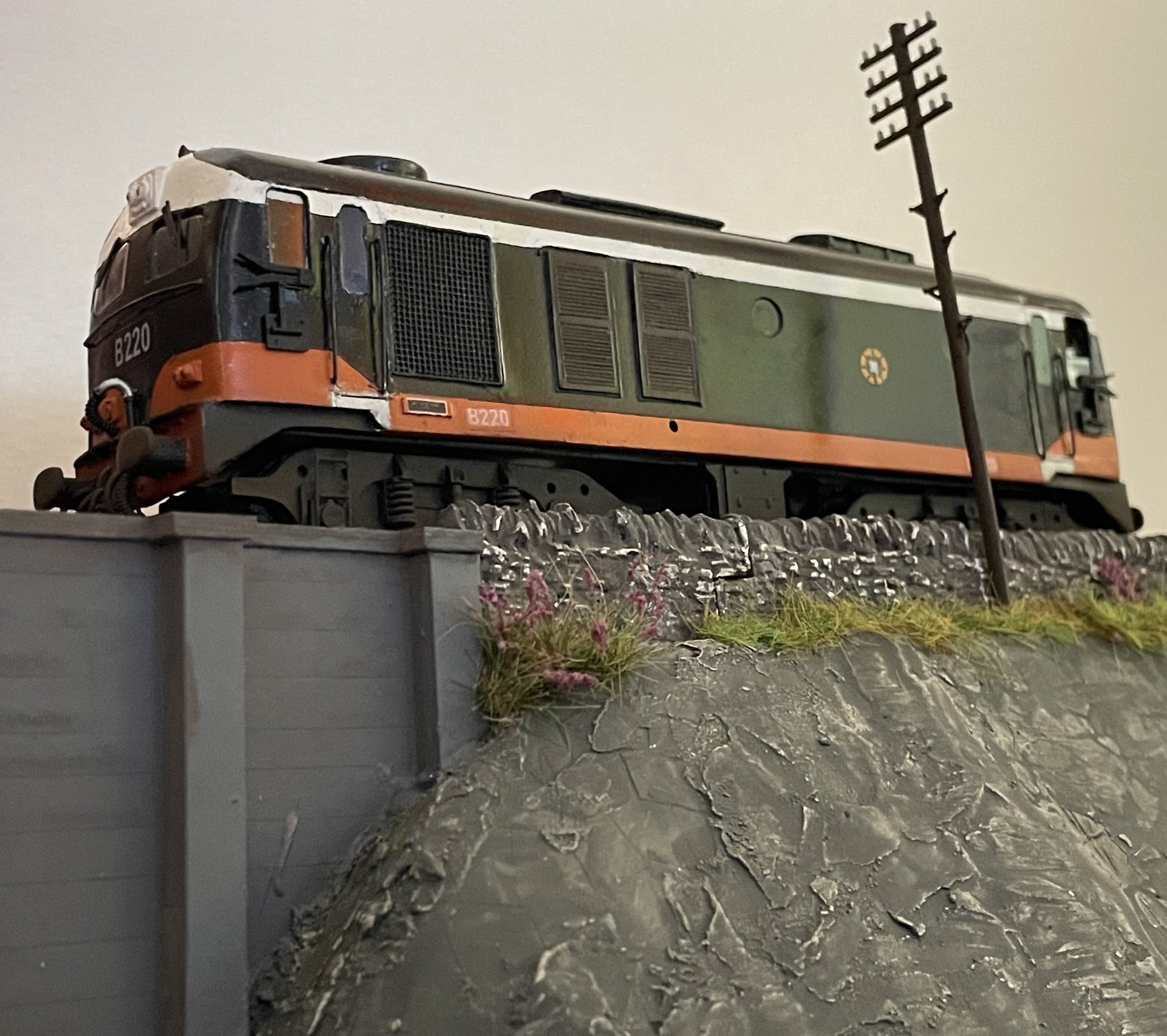

Not much progress today - modification of cab roof paintwork and buffers fitted.
Rear face of buffer headstock trimmed so that bogies can rotate freely.
Cheers
Darius
  • Like 6

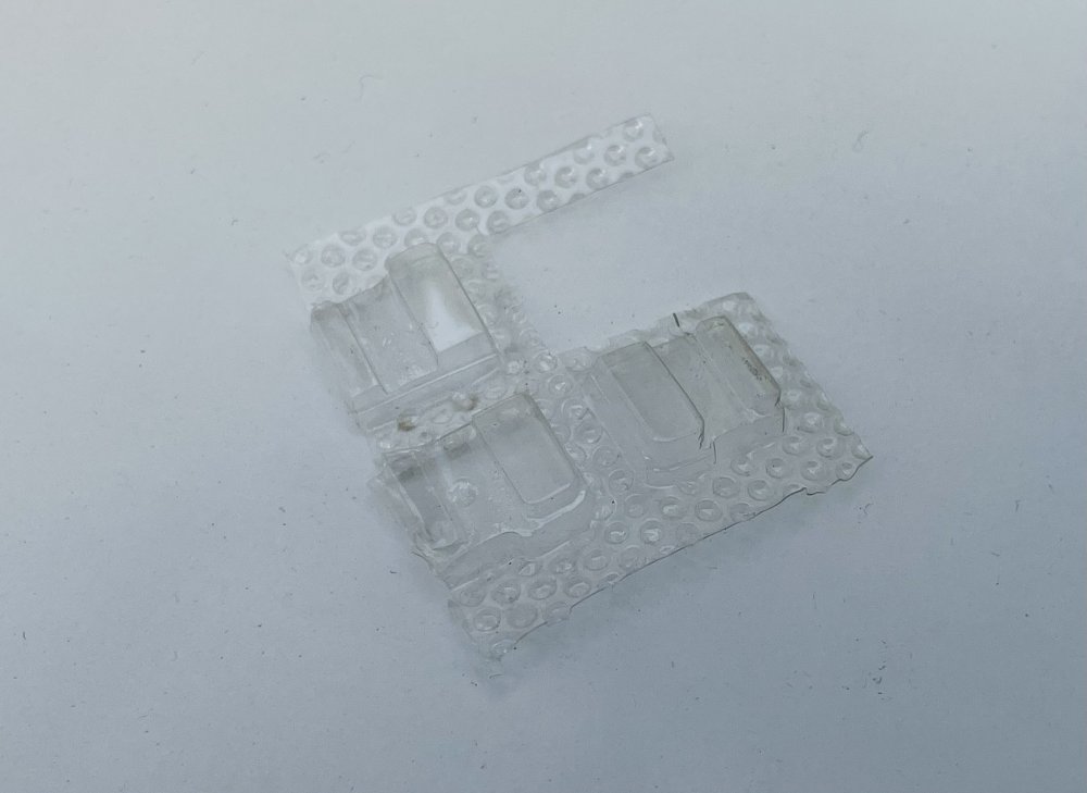

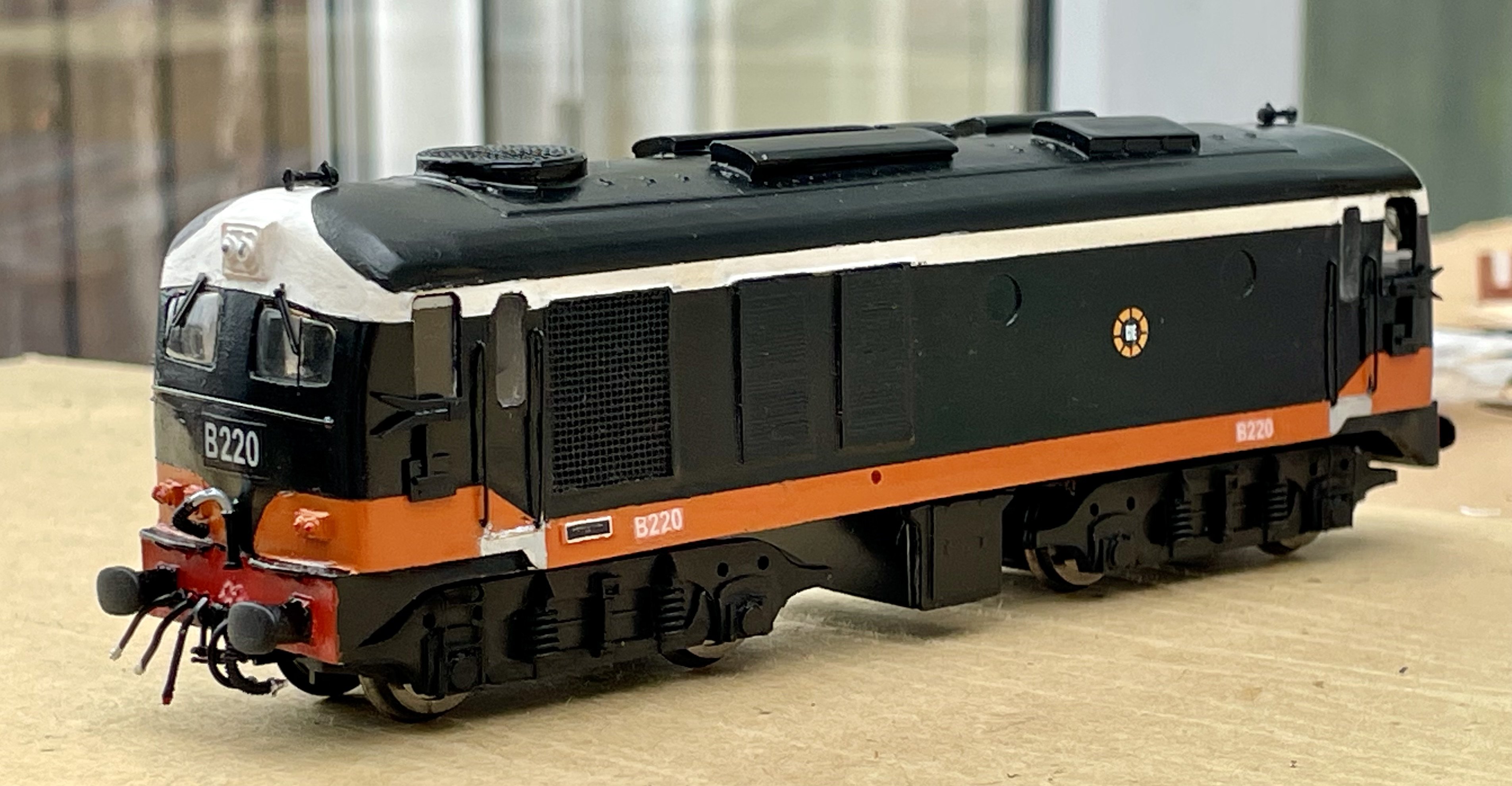

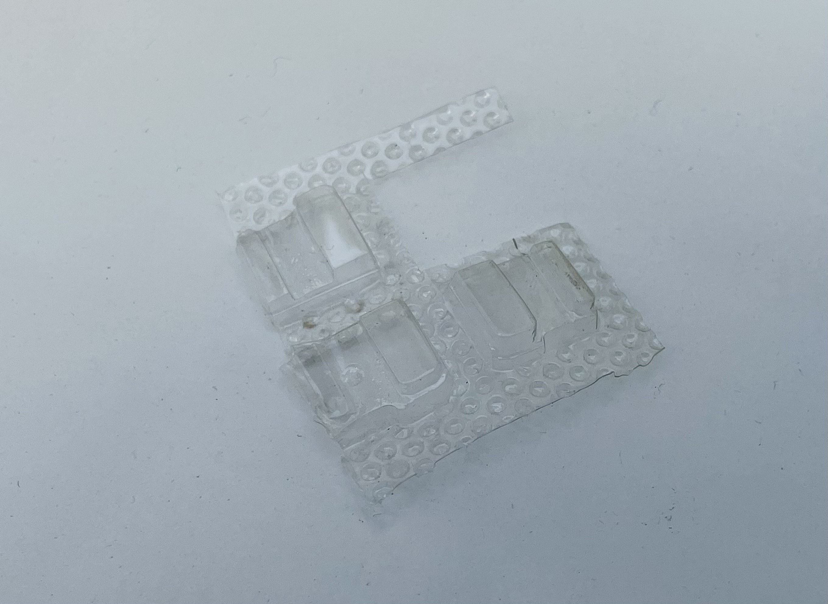

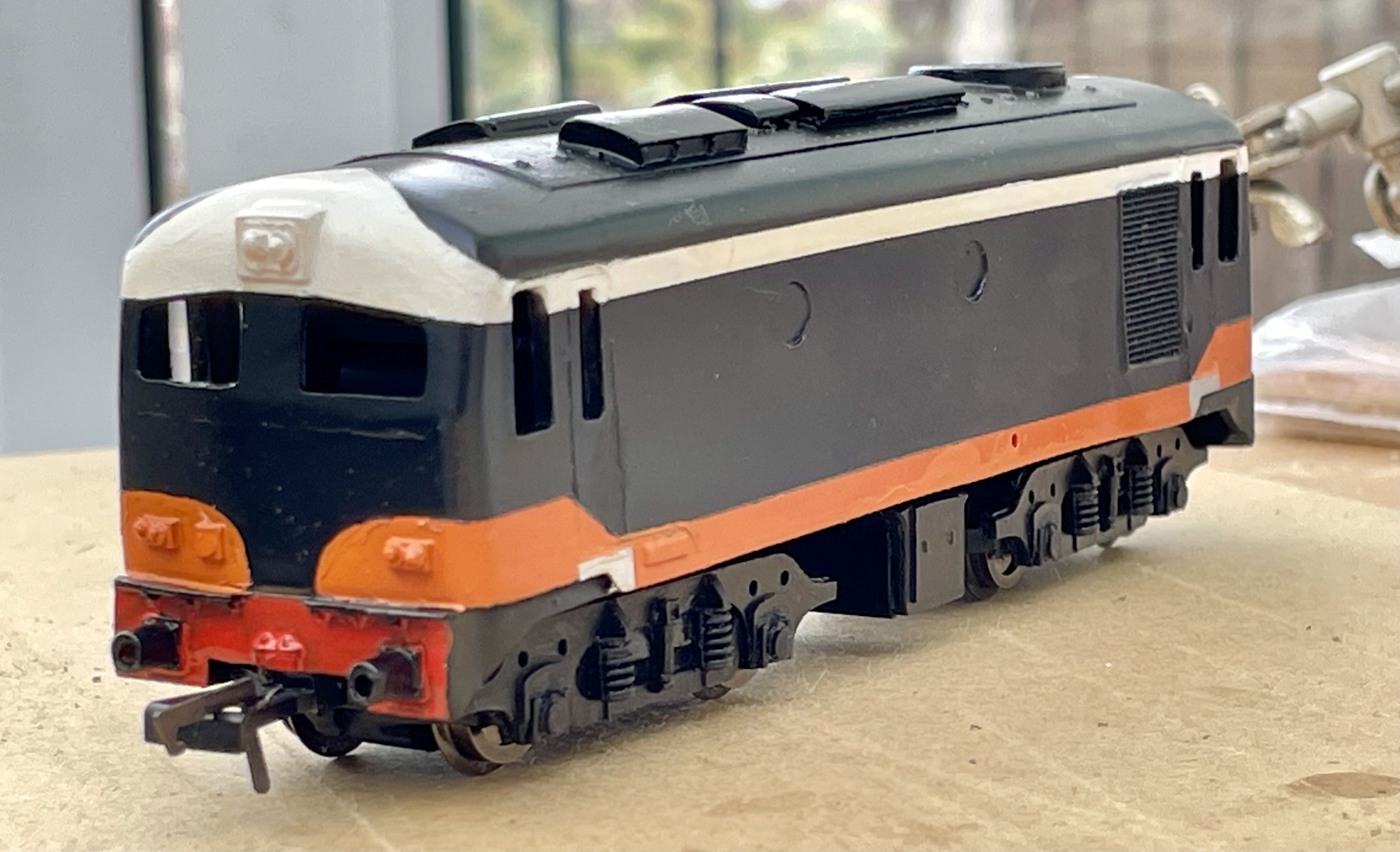

Silver Fox provides cab glazing in the form of a small clear vac-formed sheet.
Unfortunately the cabside windows don’t fit the openings in the body so are pretty useless.
The cab front glazing is a better fit but each window panel needs to be trimmed to fit as the inside surface of the body is quite rough.
Another issue is that the plastic used for the glazing can’t be stuck with poly cement, super glue or MEK - presumably Mr Silver Fox uses Copydex…
I used pva to set the cab windows as best as possible.
Cheers
Darius
  • Like 6
  • Agree 1
2 hours ago, Darius43 said:
.... - presumably Mr Silver Fox uses Copydex…
Copydex doesn't dry clear, if I remember correctly, but cures into a soft beige gum rubbery substance.
Microsol "Krystal Kleer" or similar will set clear. I've used it mostly for signal spectacle glass.
  • Agree 1
The pva has worked fine.  The main issue is that the inside surface of the bodyshell is rough and uneven so a snug fit of the glazing is difficult.
A coat of Pledge Clear seals everything in and cleans up the glazing.
Cheers
Darius

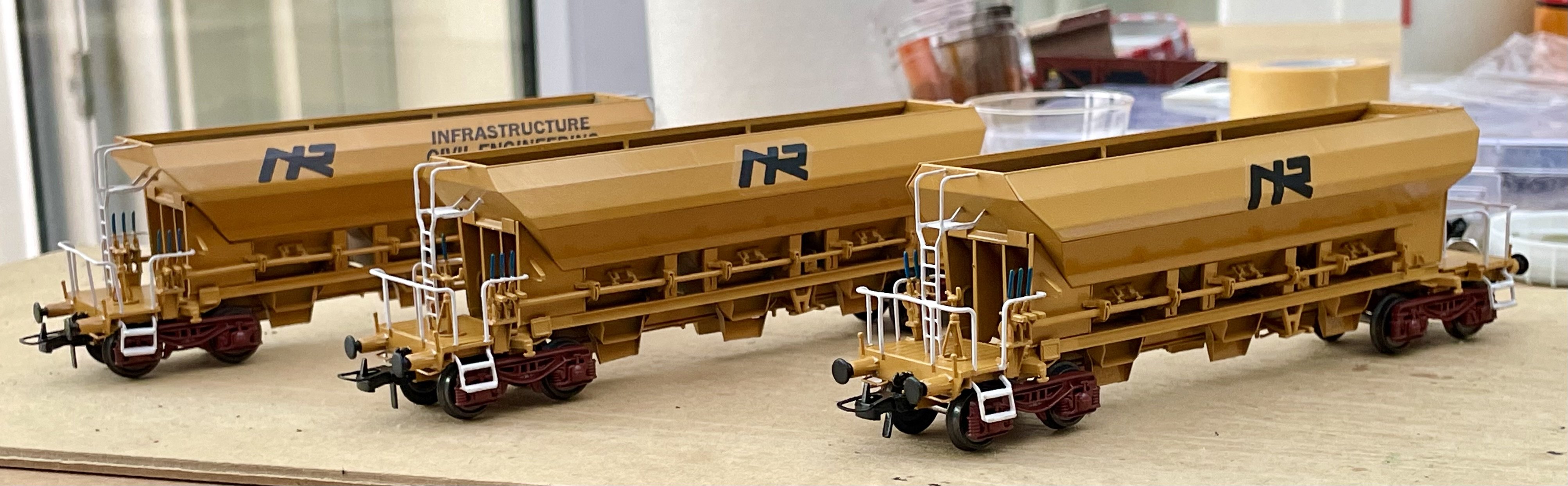

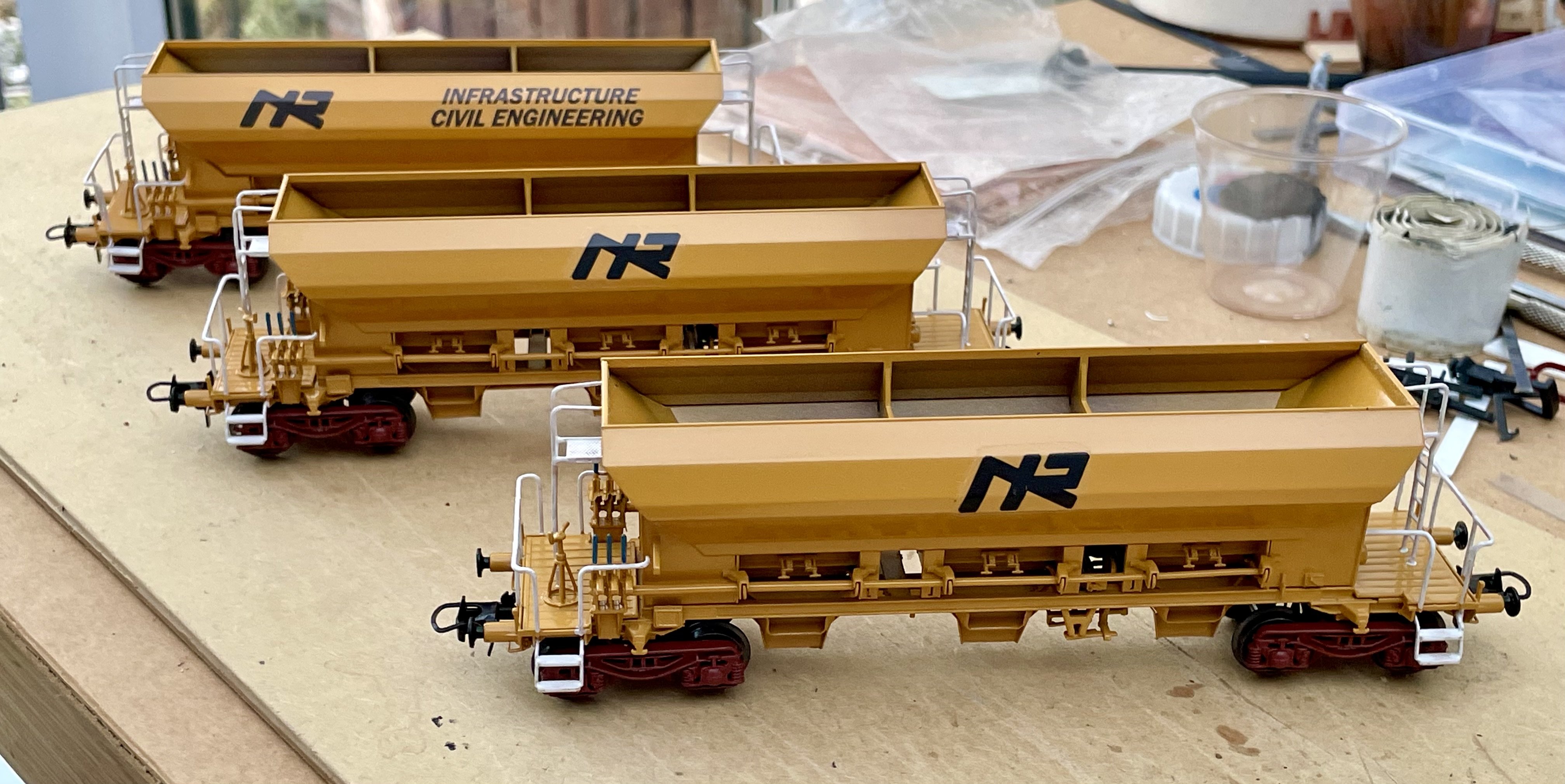

16 hours ago, Darius43 said:
Three more hopper wagons repainted and decals applied.
Cheers
Darius
Brilliant work Darius, I've really taken a shine to these wagons they do look the part.👍
