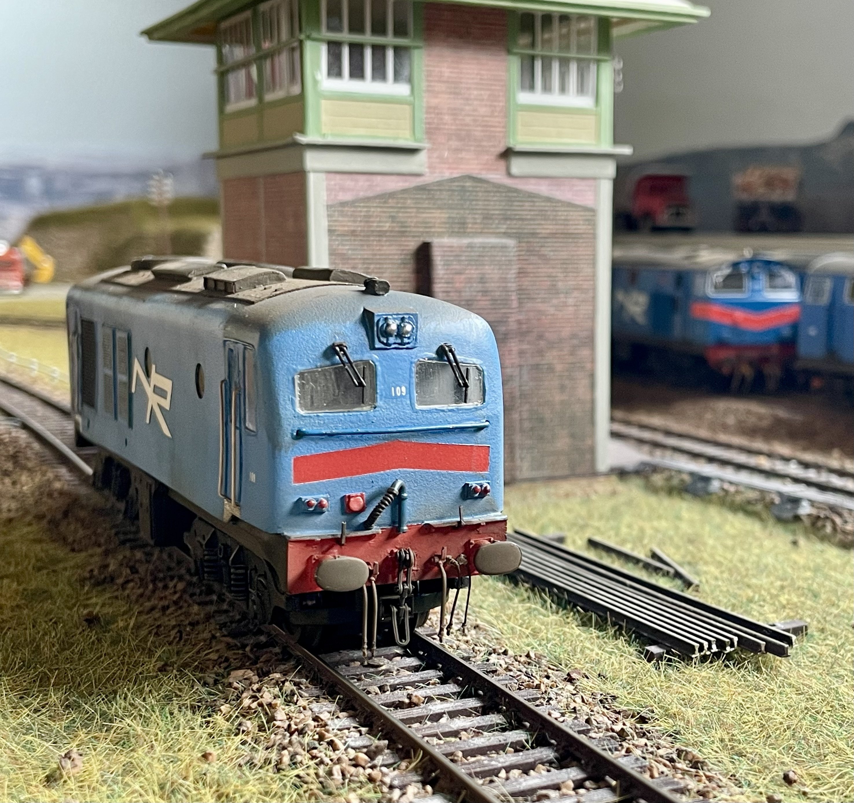

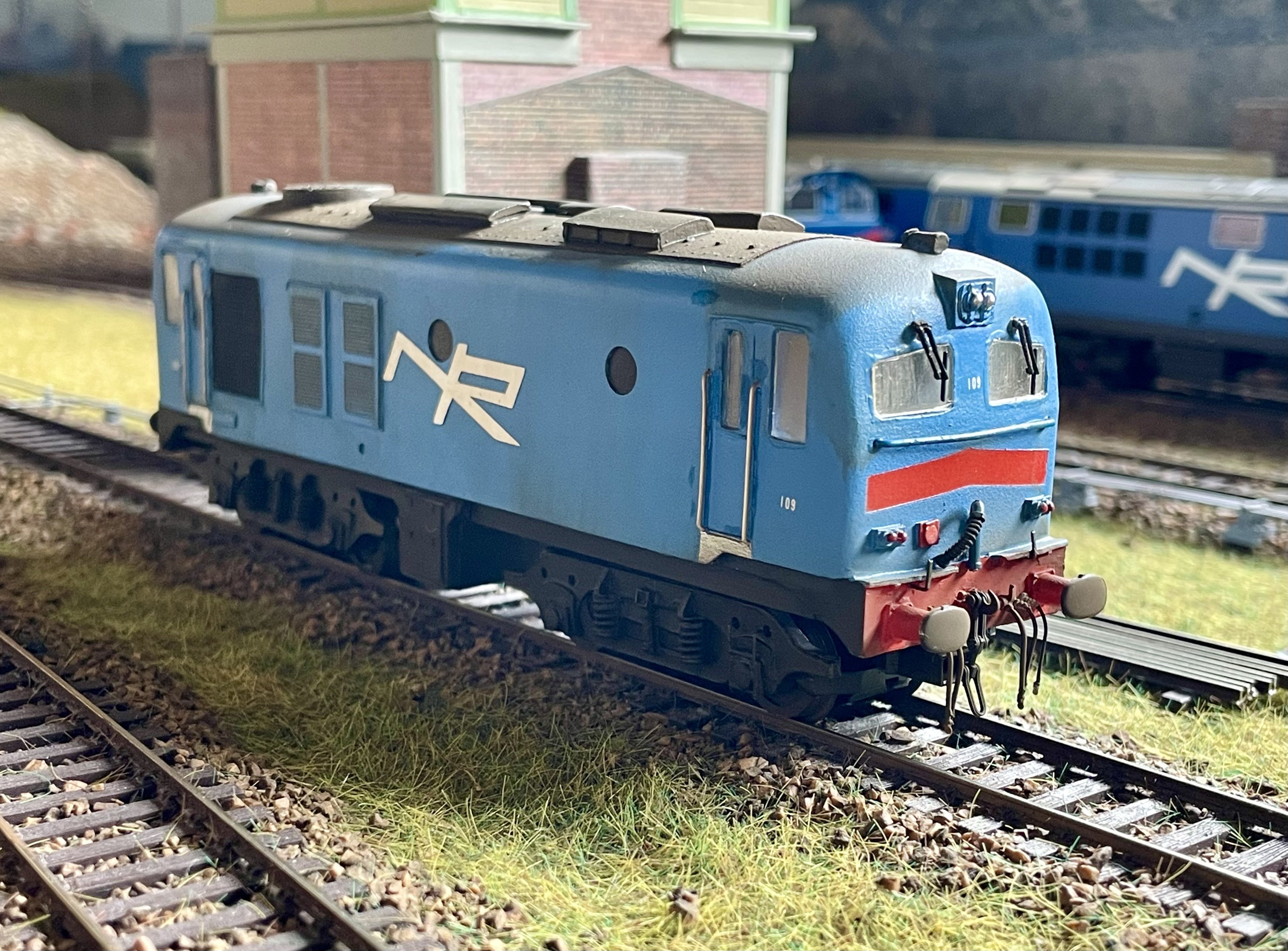

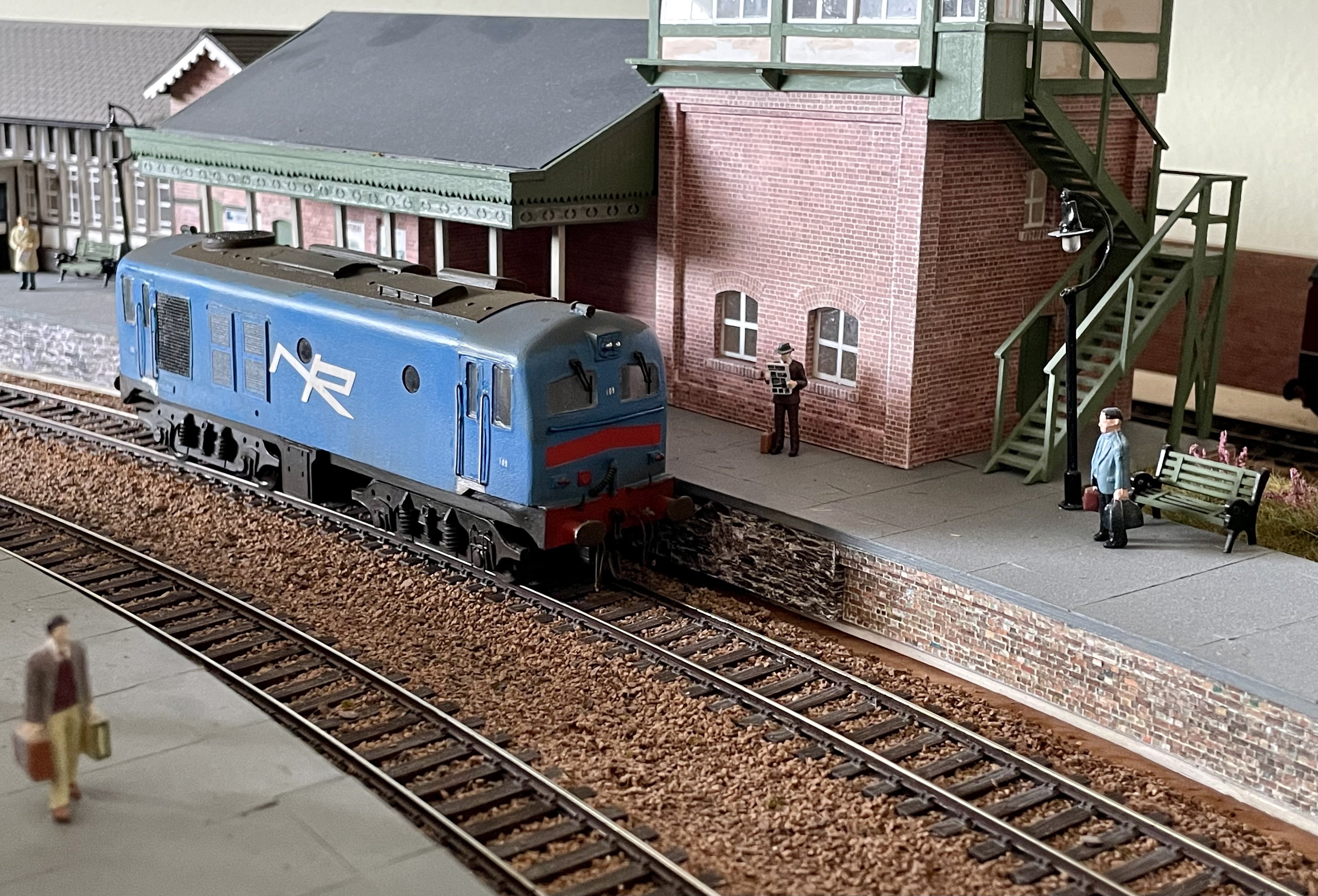

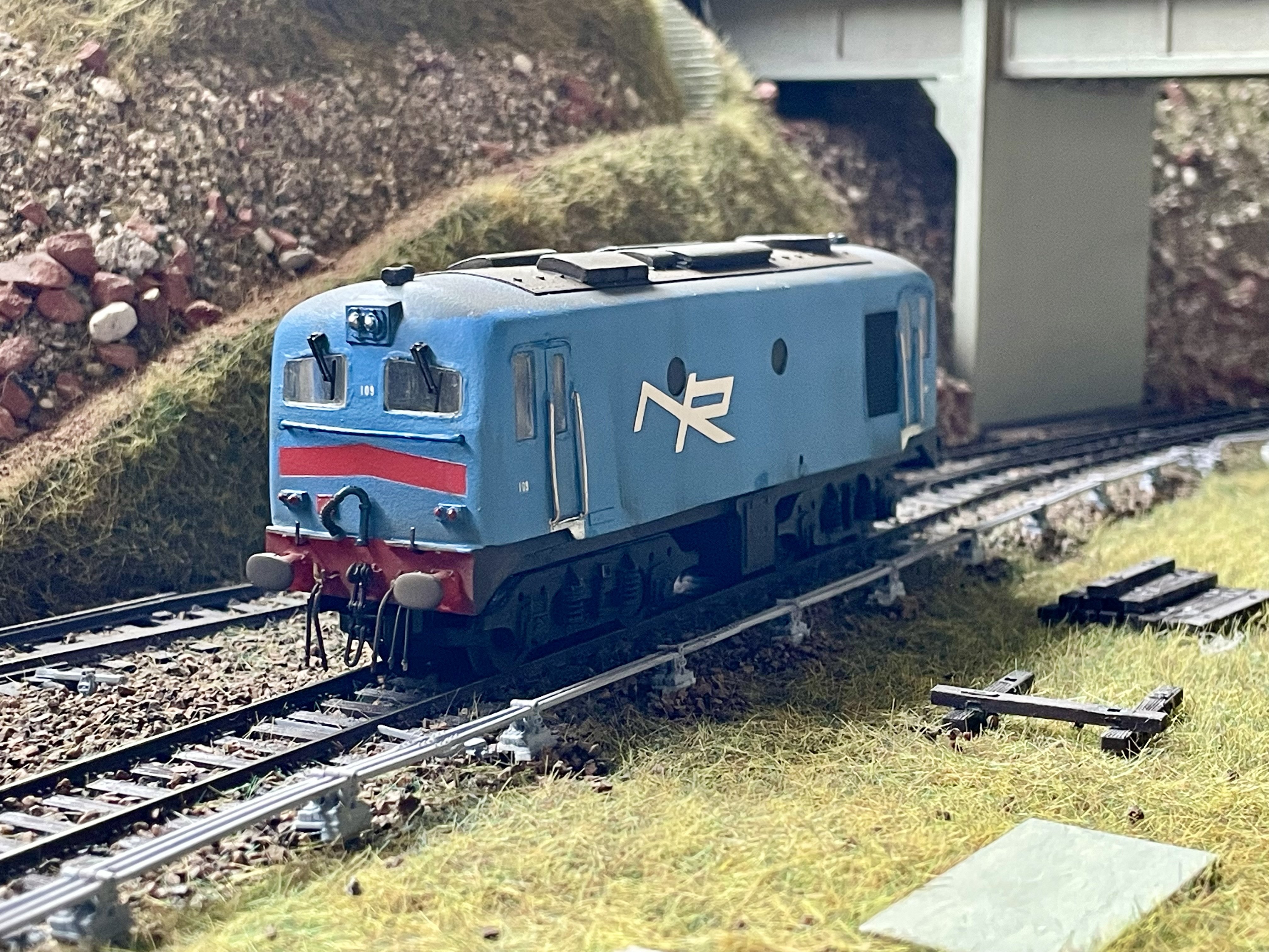

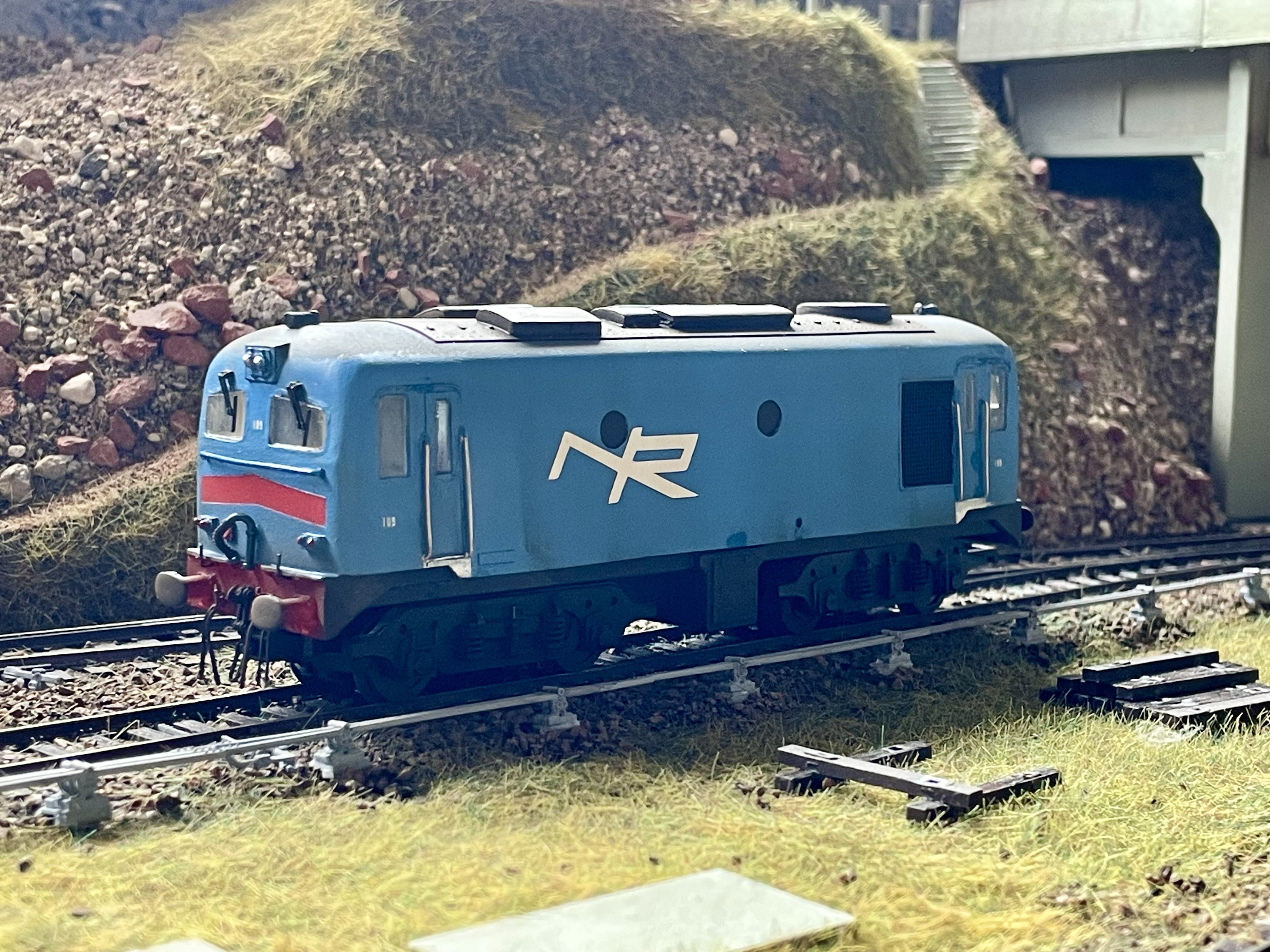

Much modified Silver Fox NIR MV Class.
Modifications include:-
- Separate wire cab front and door handrails.
- Lamp irons (staples).
- Buffer beam hosiery.
- Cab access ladders to bogies.
- Remove Copydex glue that Mr Silver Fox uses everywhere and use a proper adhesive.
- Chassis and body weathering.
Cheers
Darius

3 hours ago, Darius43 said:
.....- Remove Copydex glue that Mr Silver Fox uses everywhere and use a proper adhesive....
When you're paying that much for a Silver Fox model, the use of Copydex strikes me as daylight rubbery.
  • Funny 7

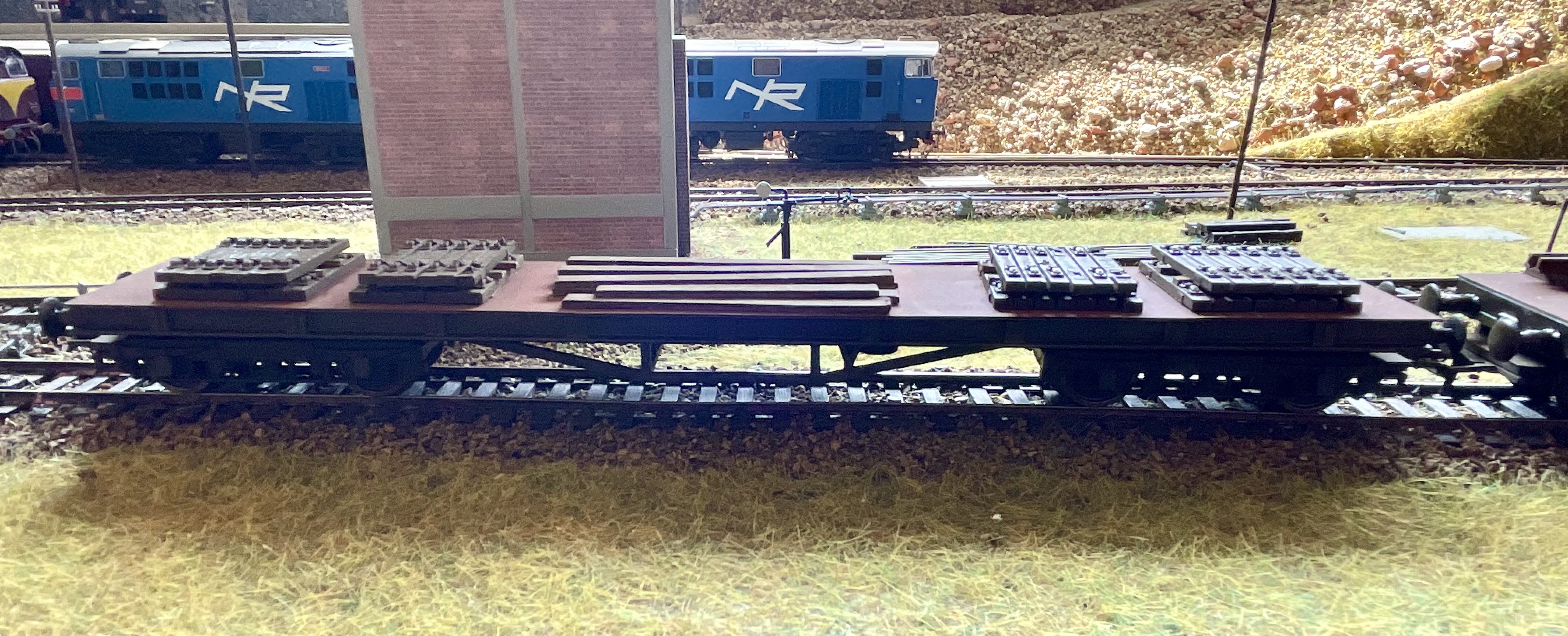

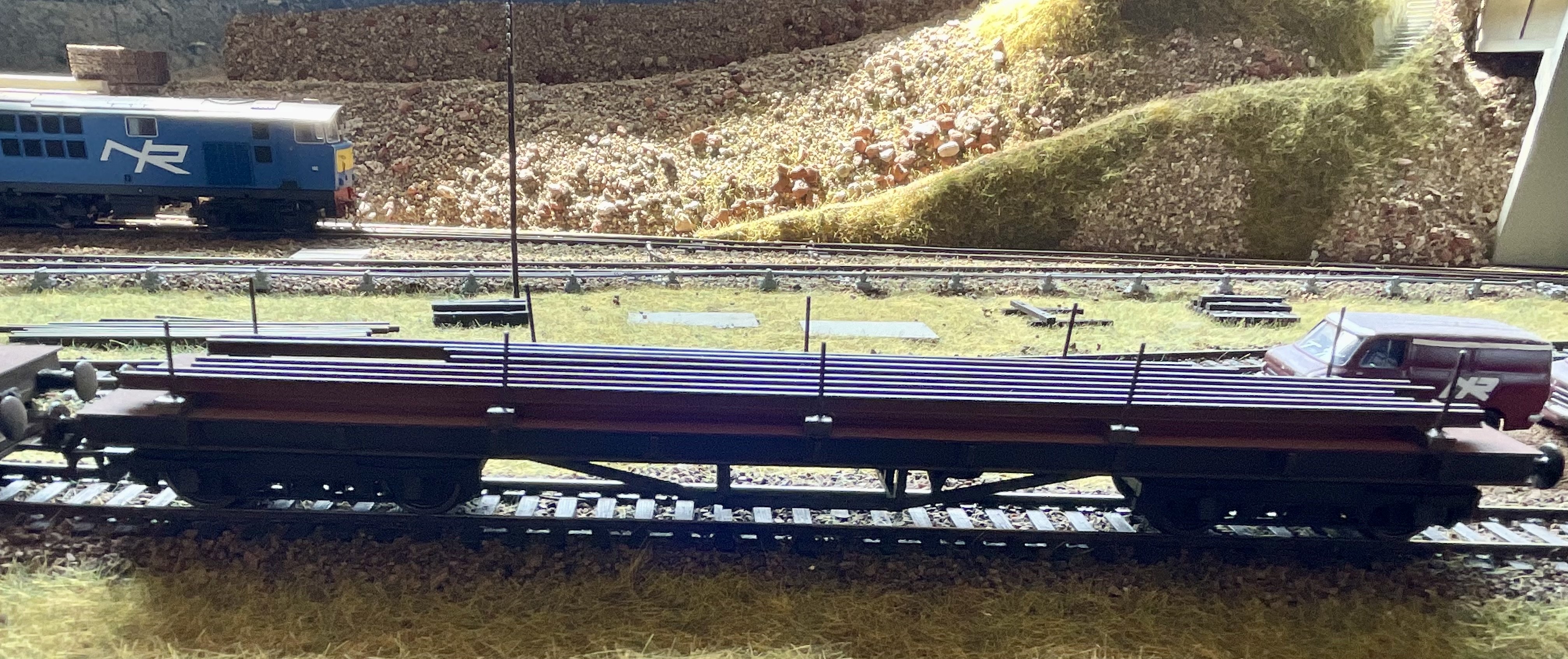

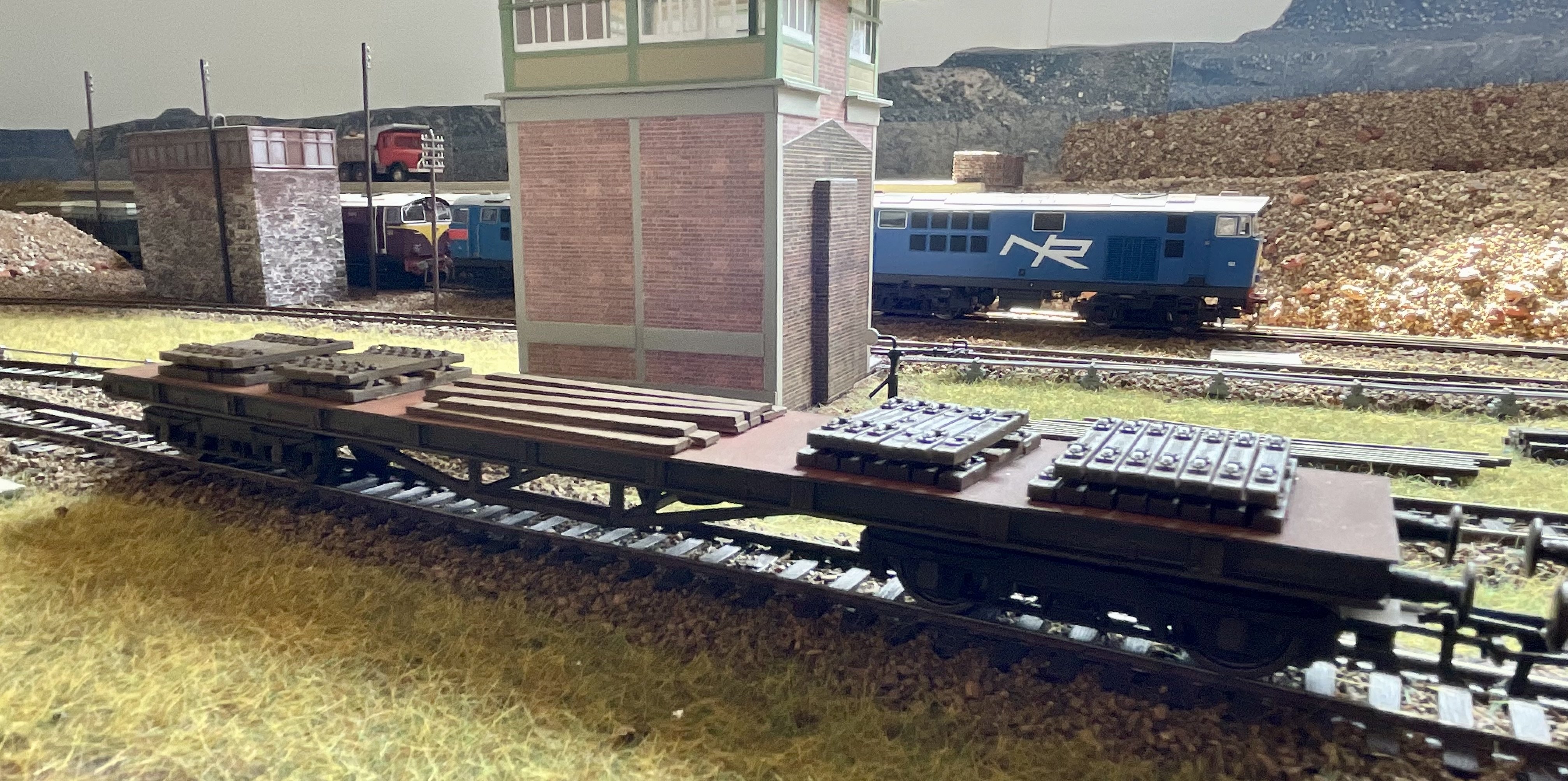

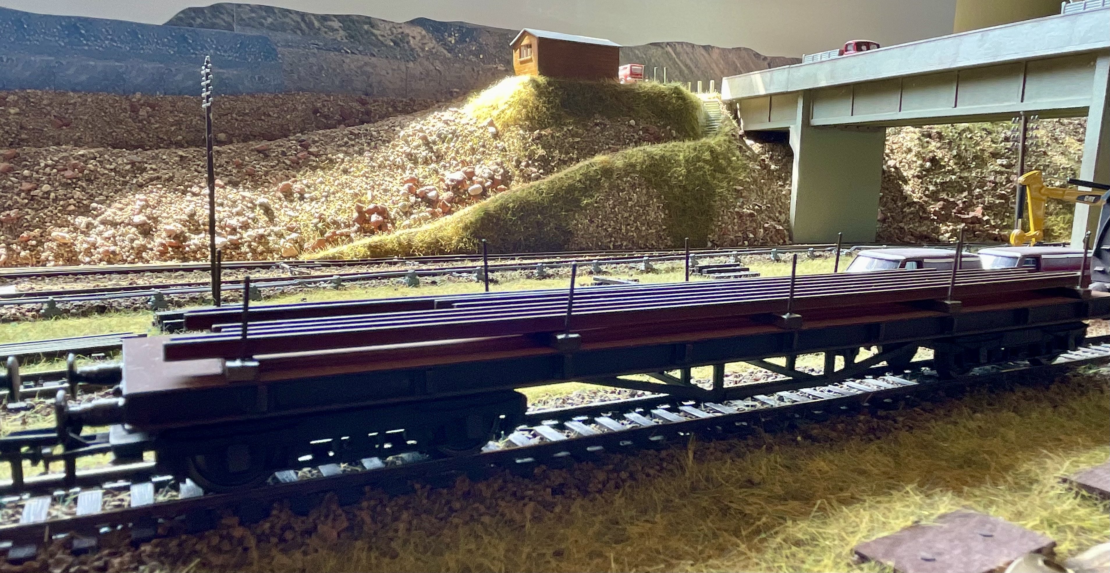

Bogie flat wagons made from spare Hornby LMS coach chassis, Bachmann LMS bogies, plasticard, card and wire.
The rails and sleepers are from gash code 100 track.
Cheers
Darius
  • Like 9

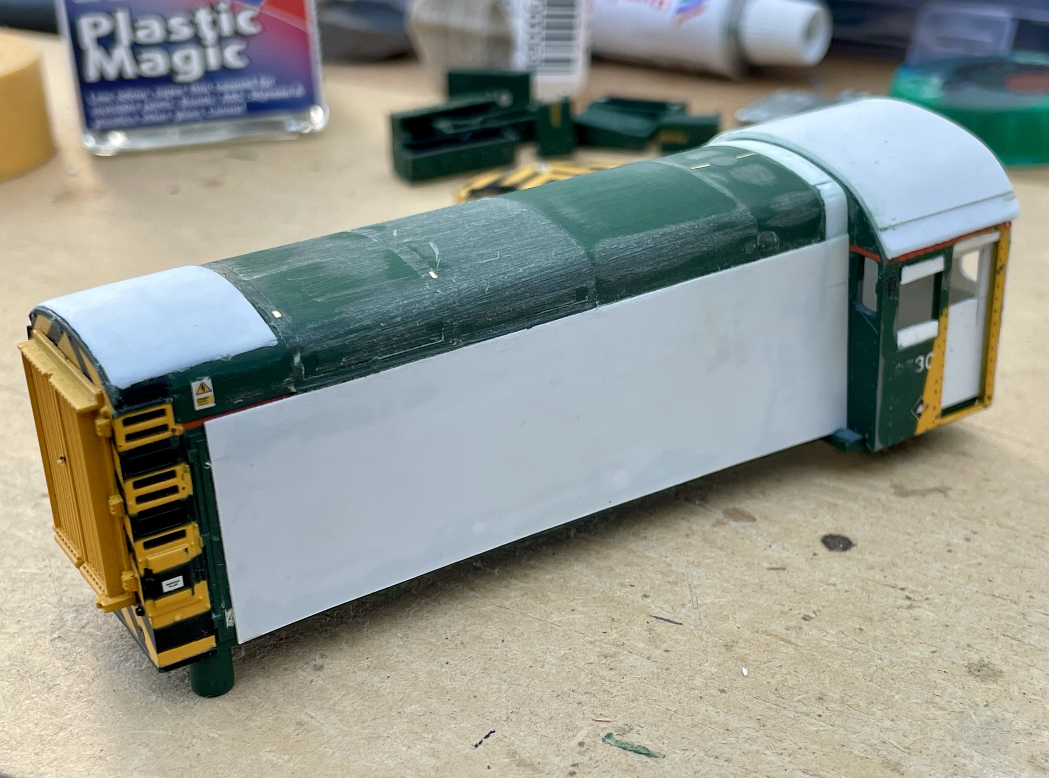

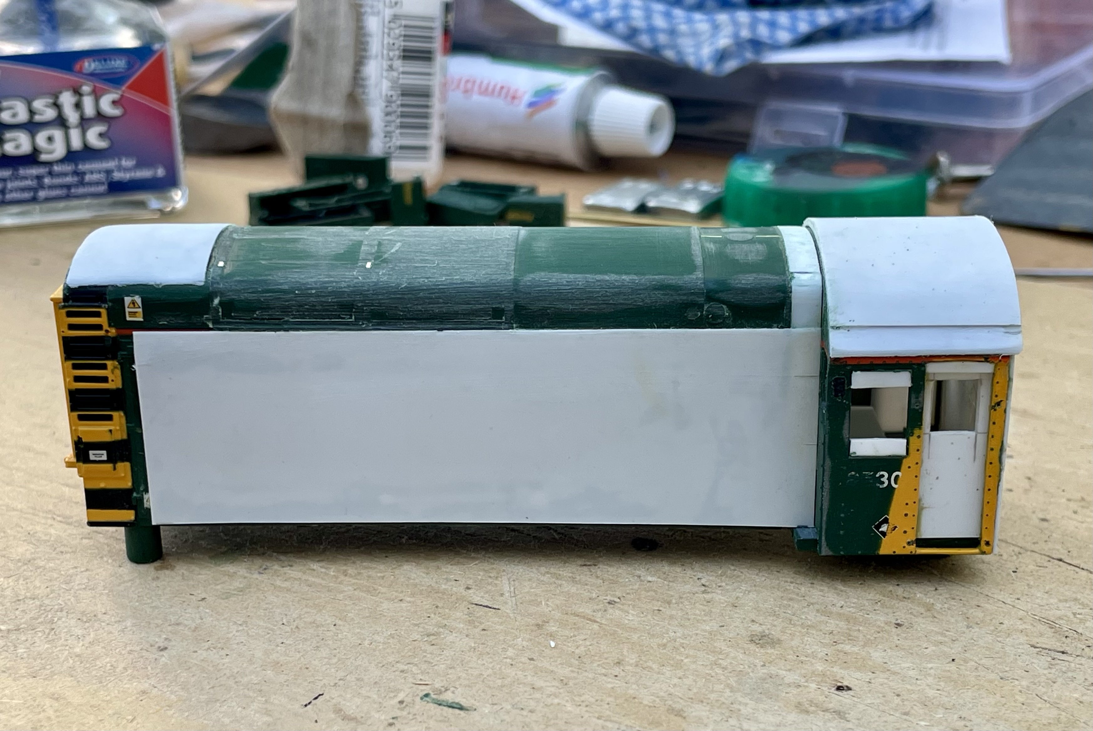

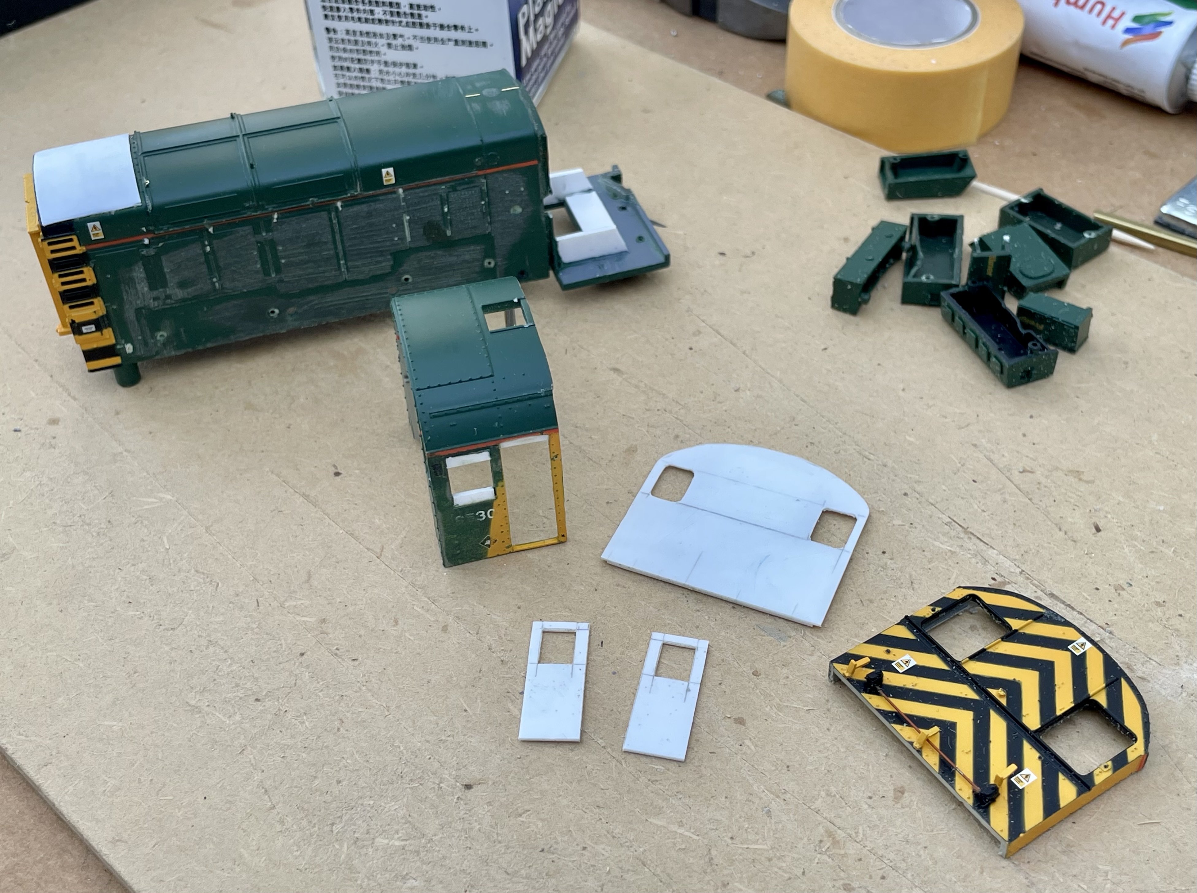

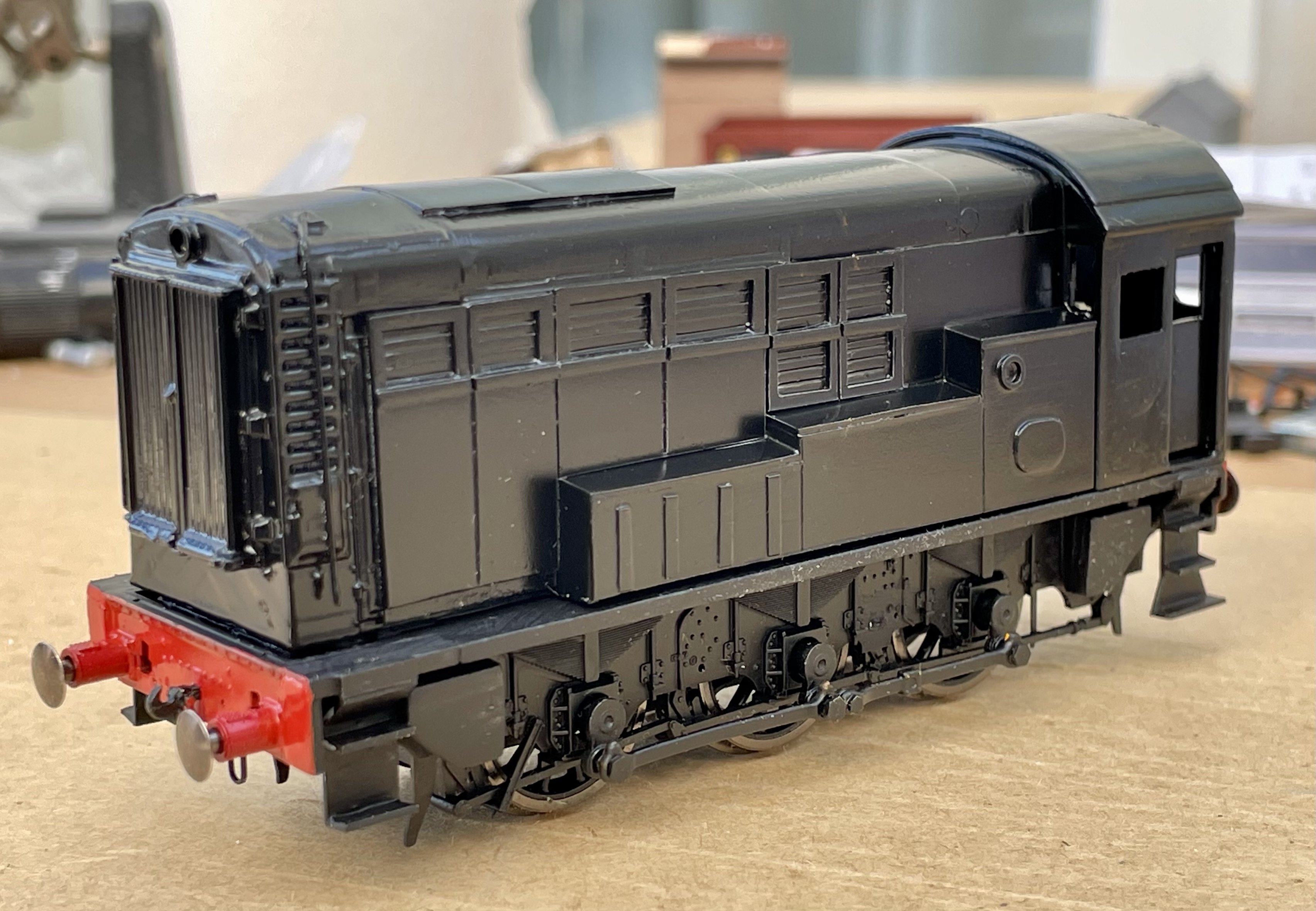

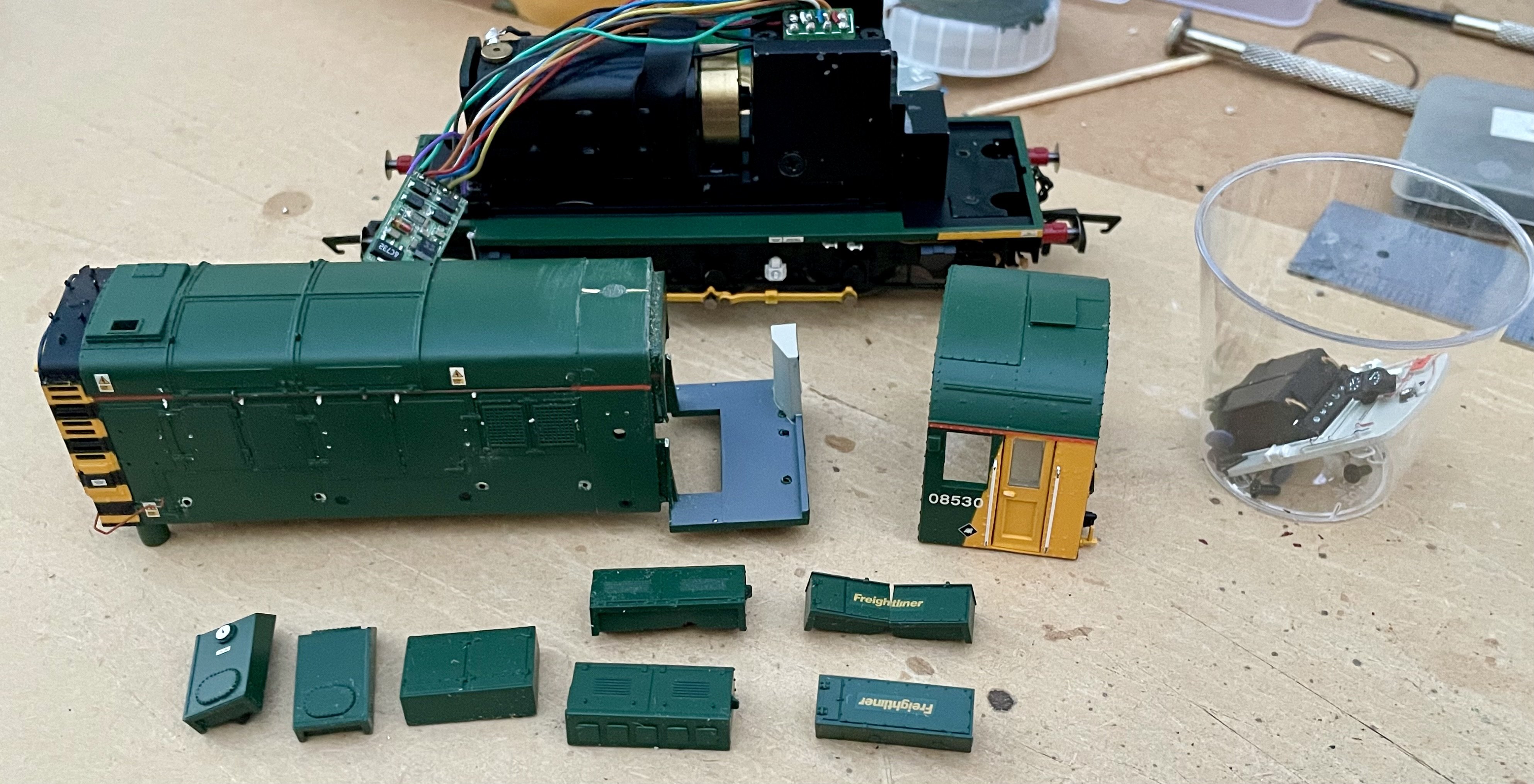

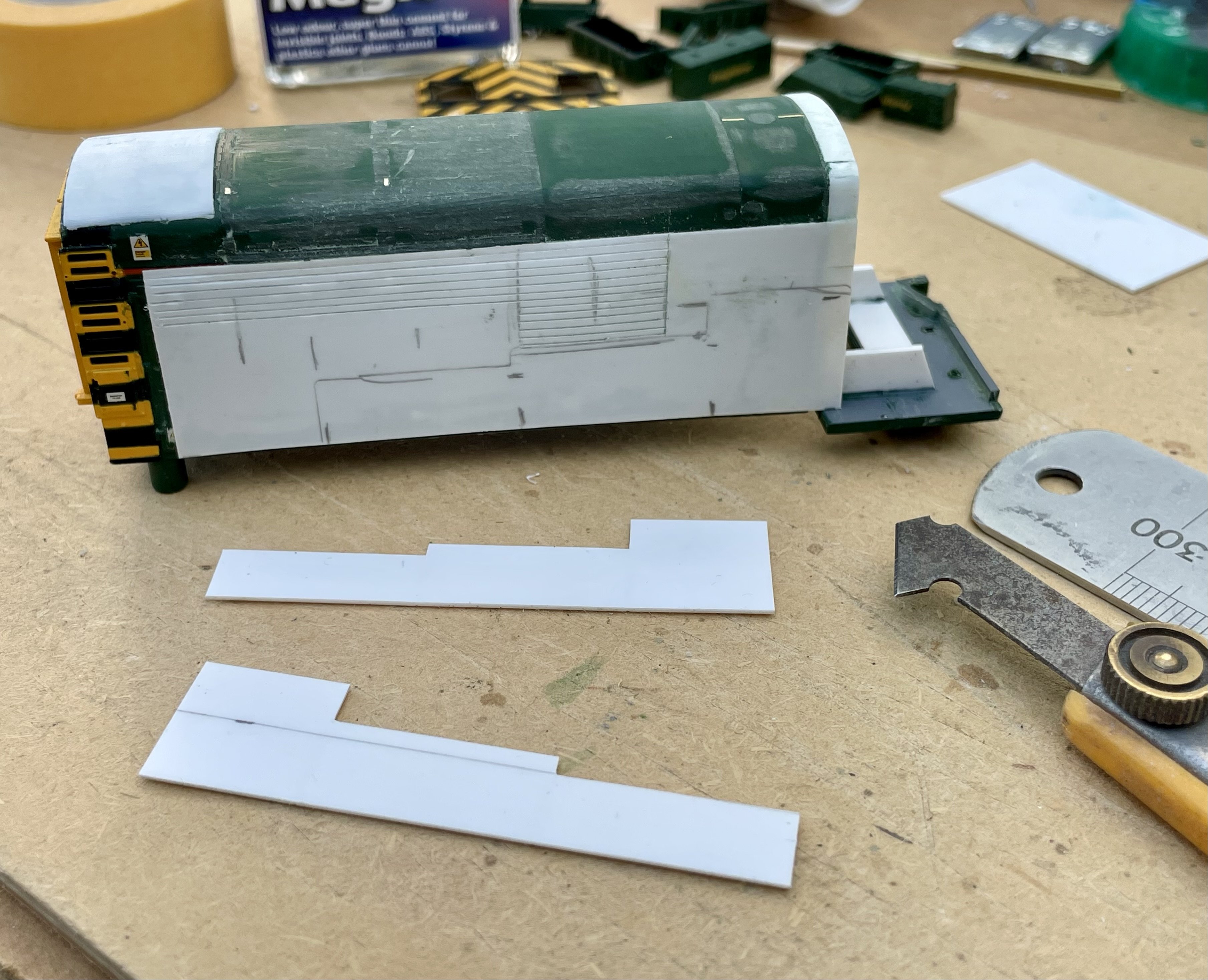

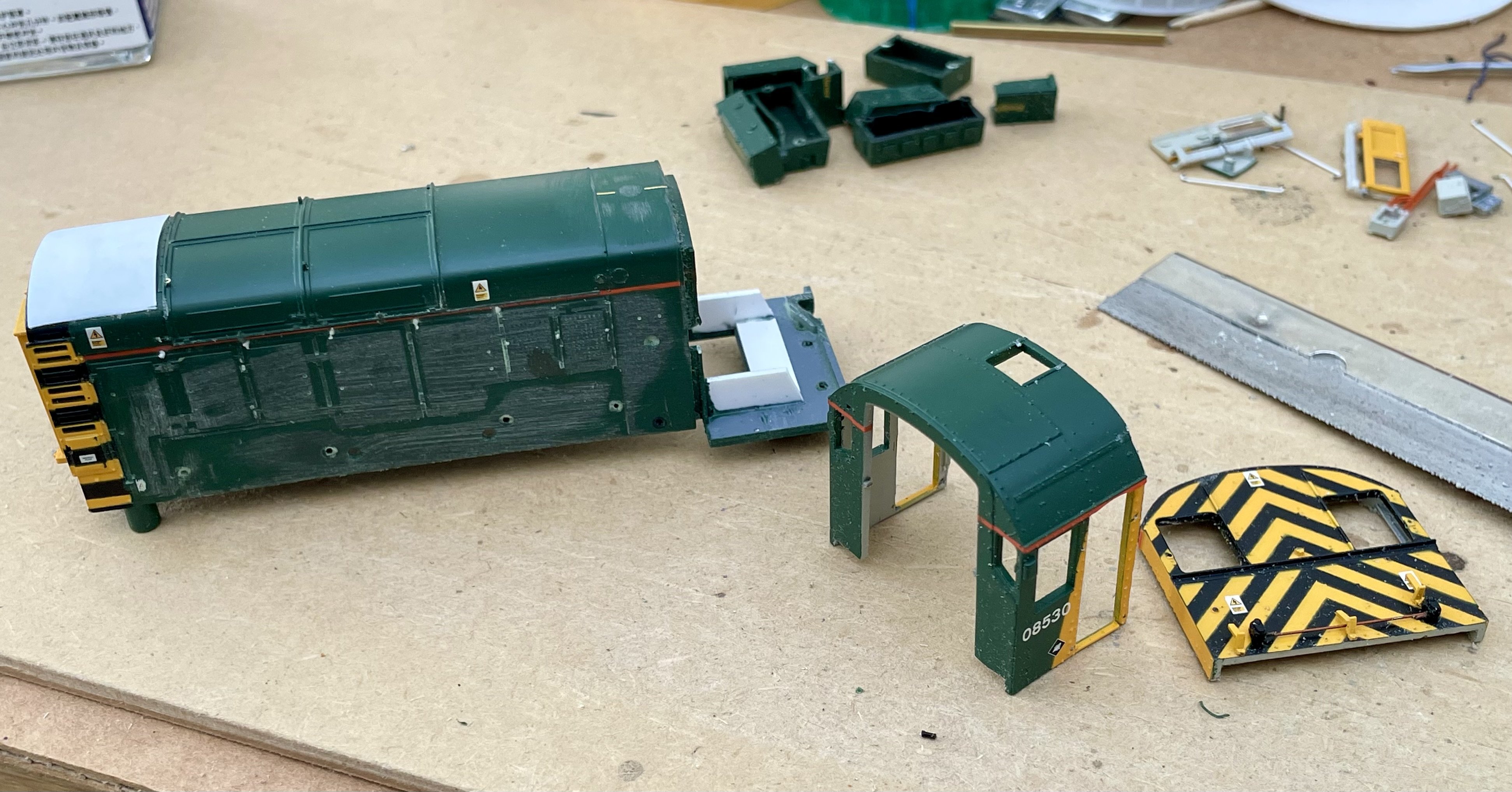

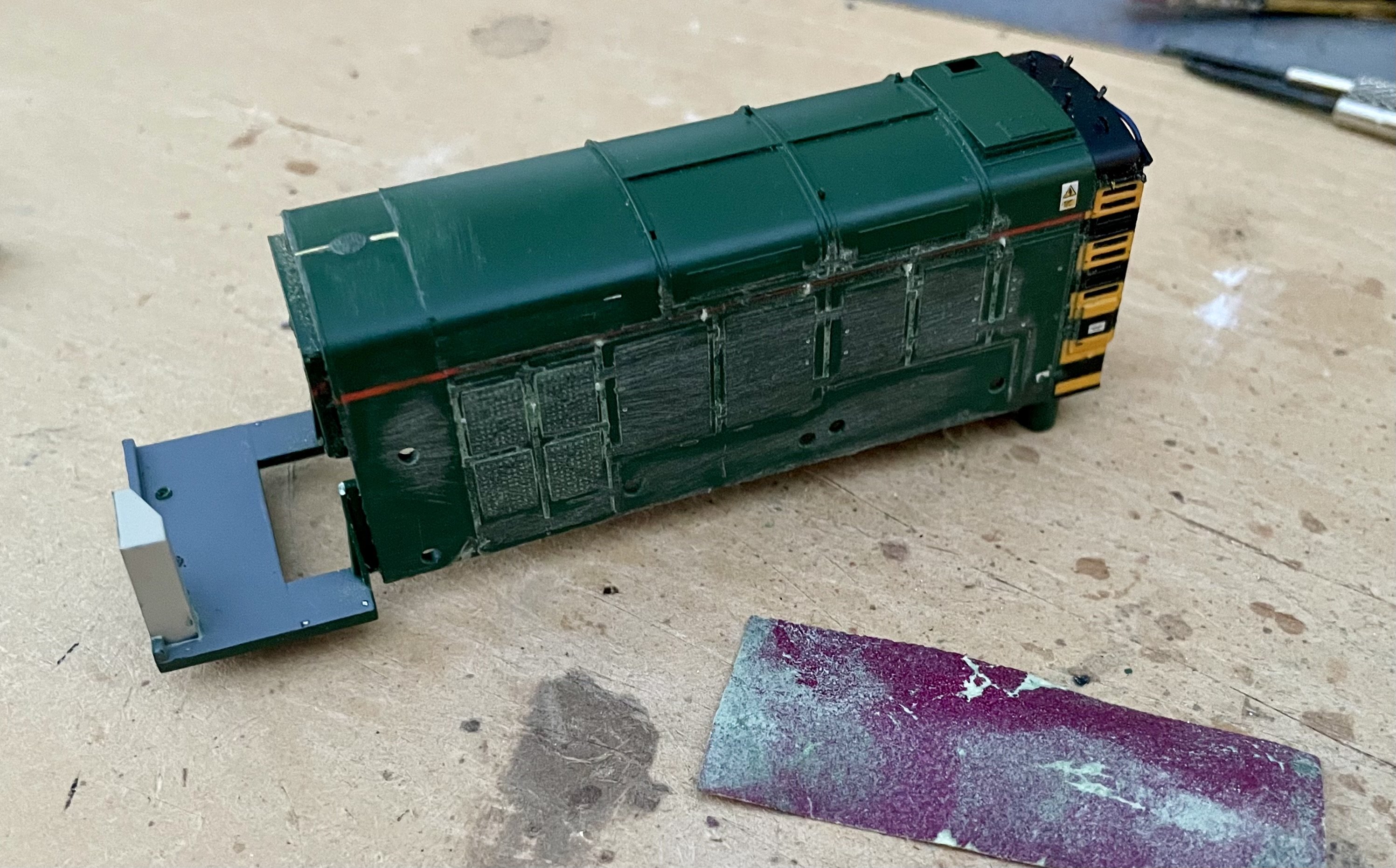

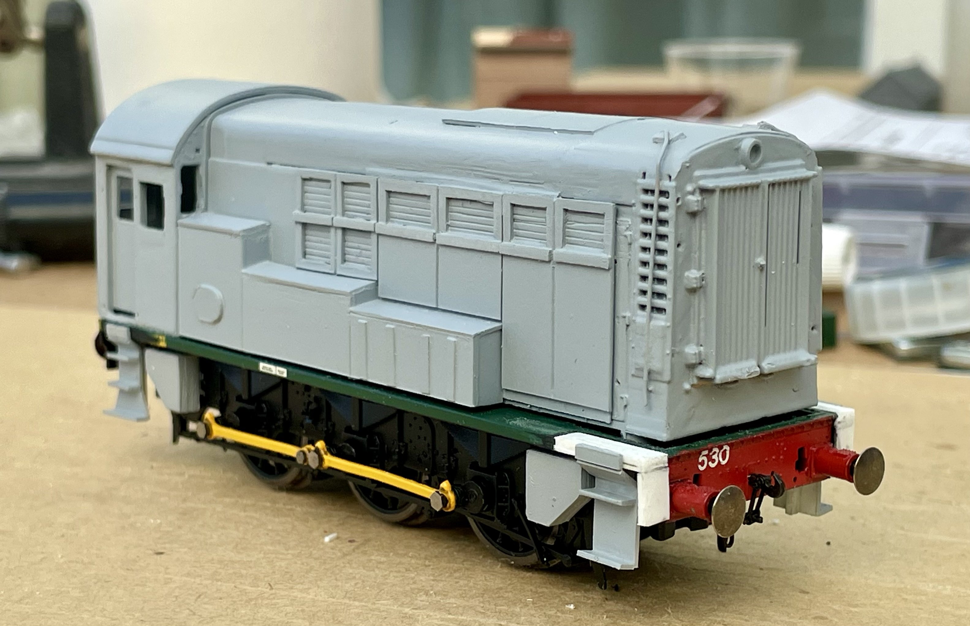

New project - conversion of a Hornby 08 into a D301 Class.
Body removed and disassembled.
Handrails and piping removed
Bodysides sanded smooth to accept a thin plasticard skin.
Next steps will be a new, shallower cab, new side boxes and louvered bodyside doors from plasticard.
I may salvage the Hornby cab roof
Cheers
Darius
  • Like 7
  • Informative 2

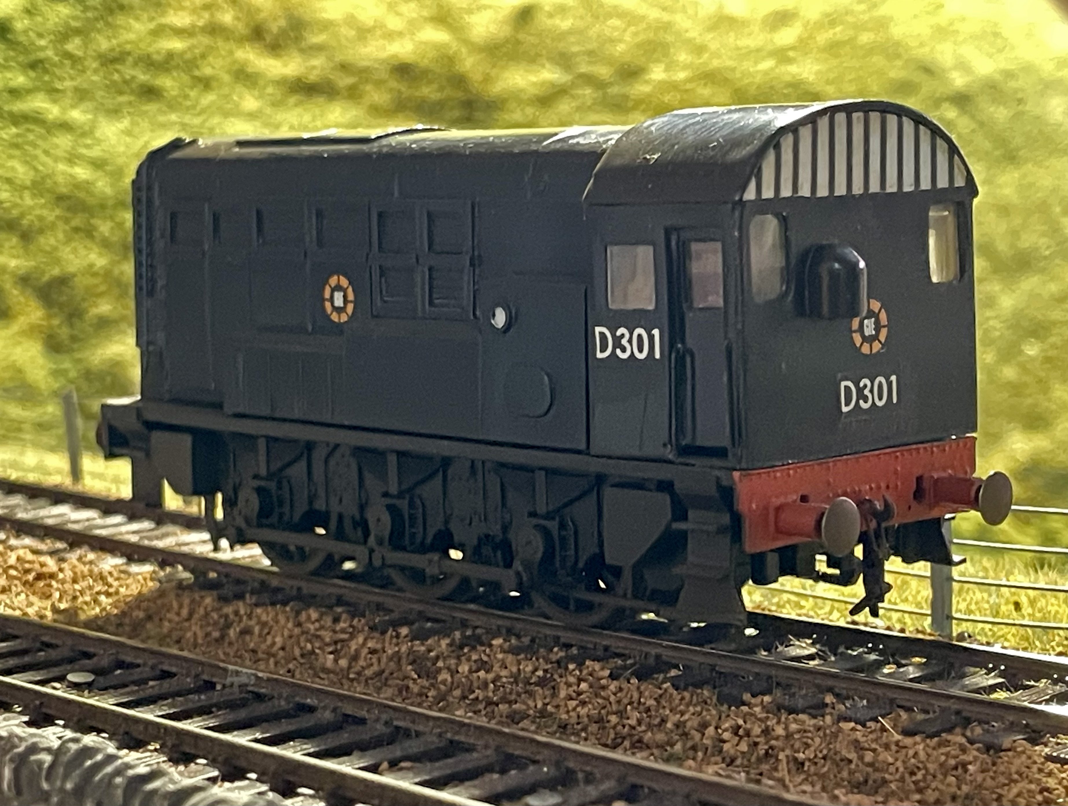

19 minutes ago, Horsetan said:
A single-arc roof cab is available on the Lima 08/09
Understood, but it seems a shame to cut up and waste most of a whole second loco just for the cab roof.  I’ll re-work the Hornby roof.
Cheers
Darius
The Lima body is mostly inaccurate in the bonnet/engine room area anyway (proportions are all wrong), and the roof and cab rear are some of the few parts that don't need much if any correction. You may also be able to salvage things like the side exhauster boxes, etc.

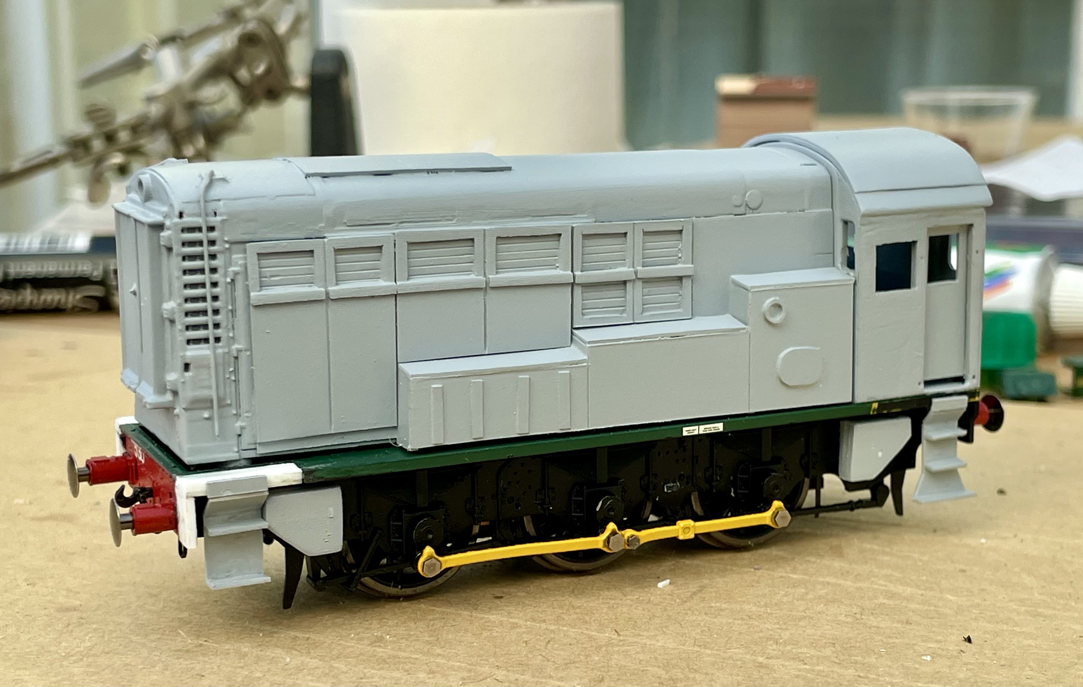

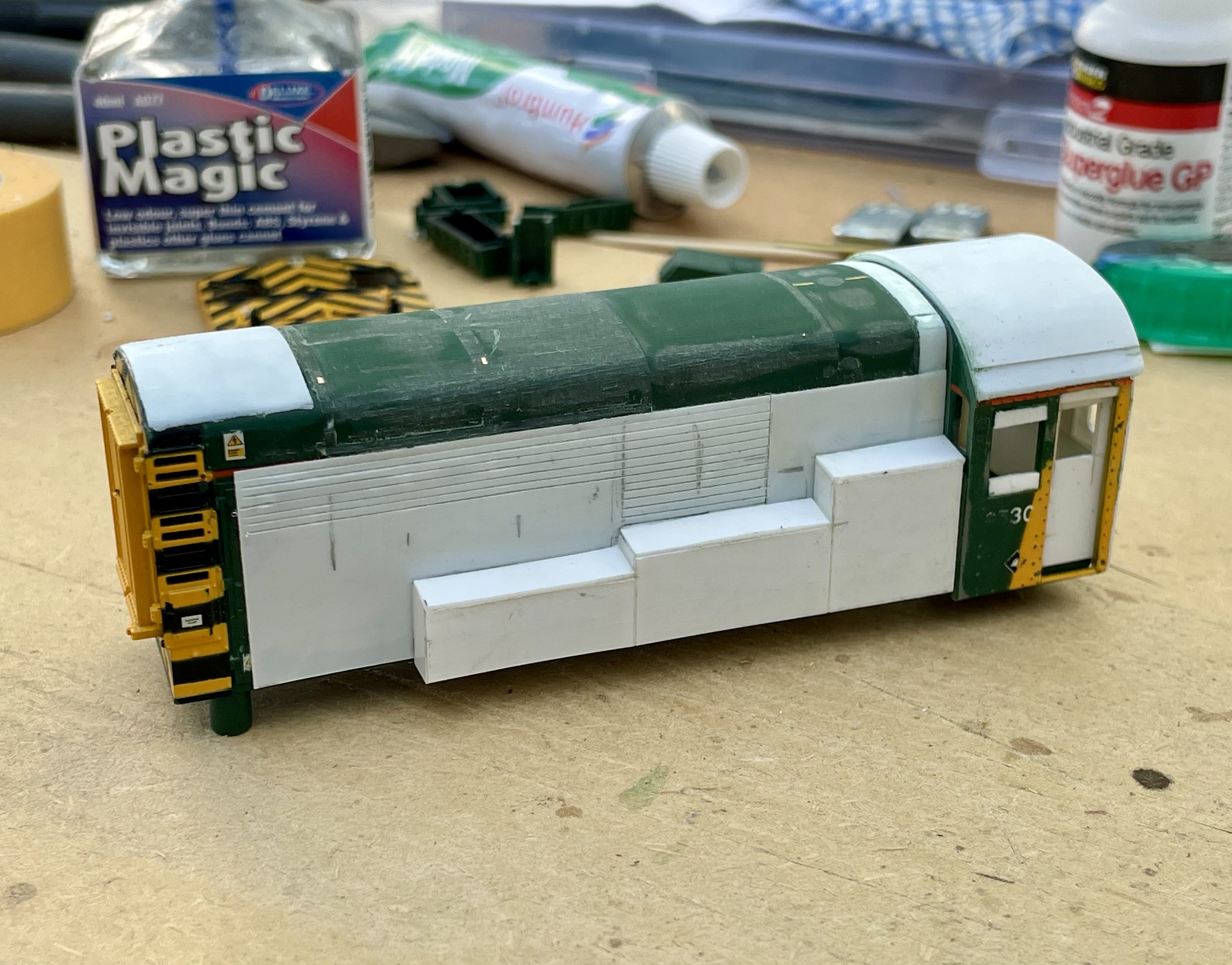

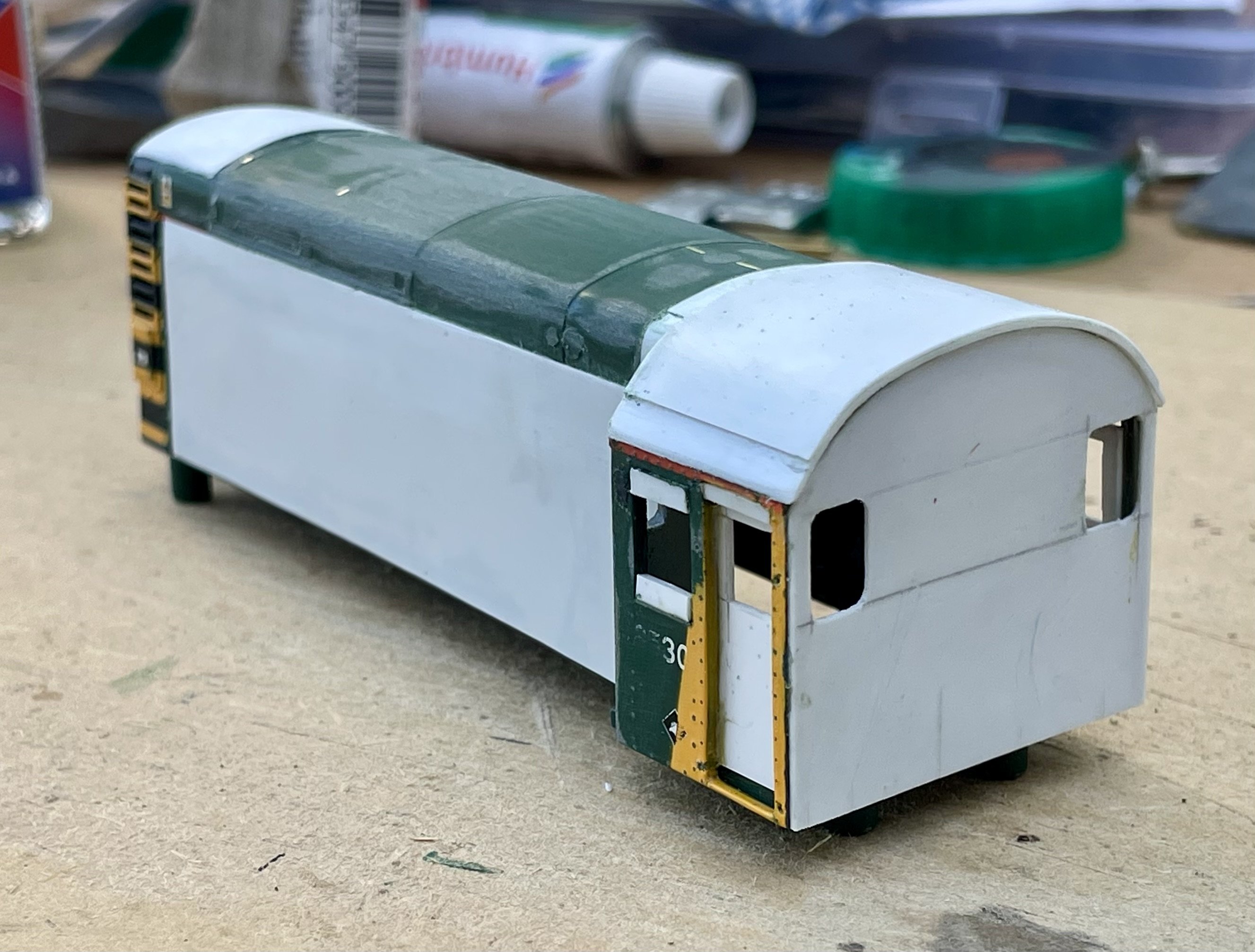

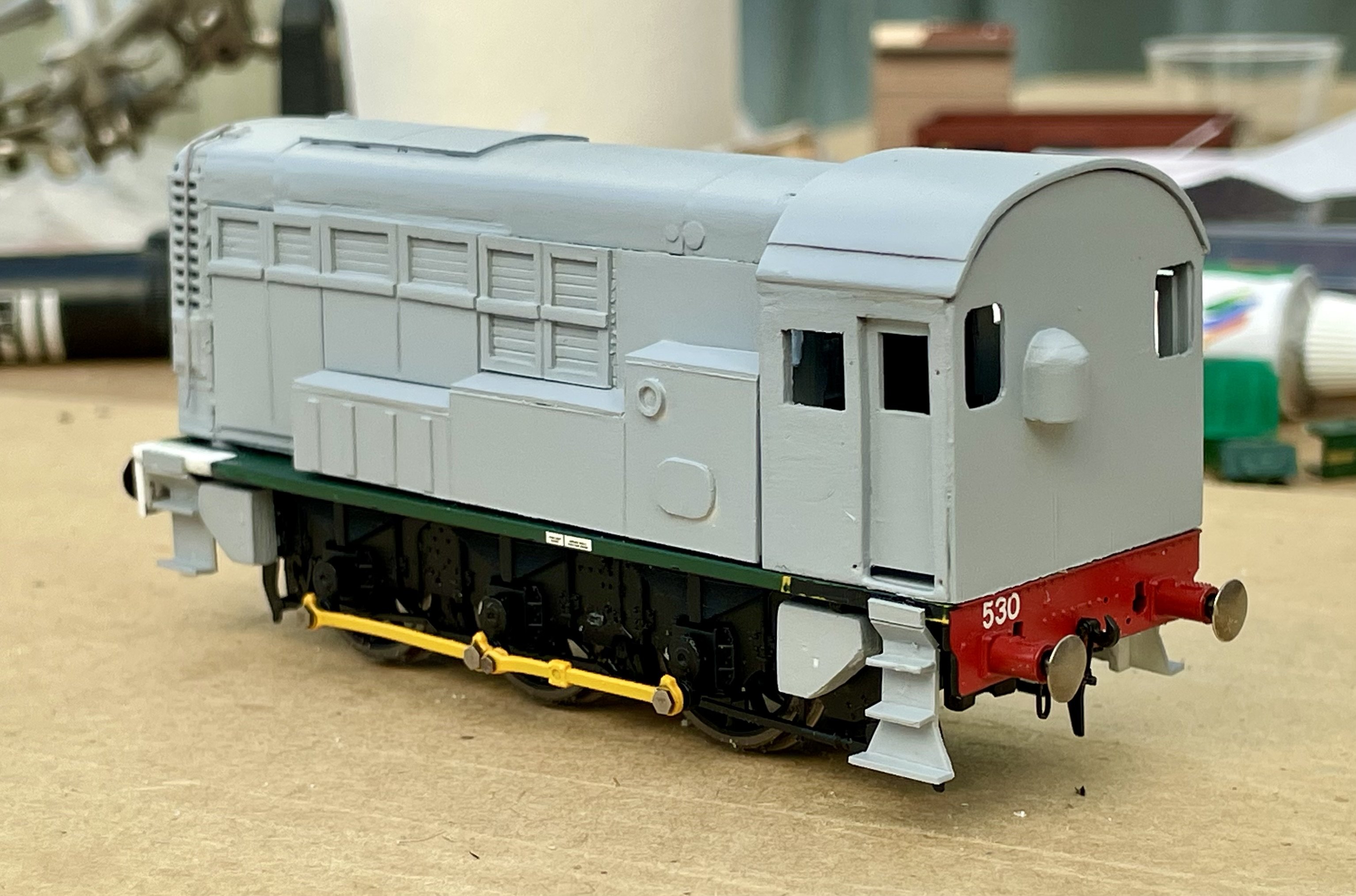

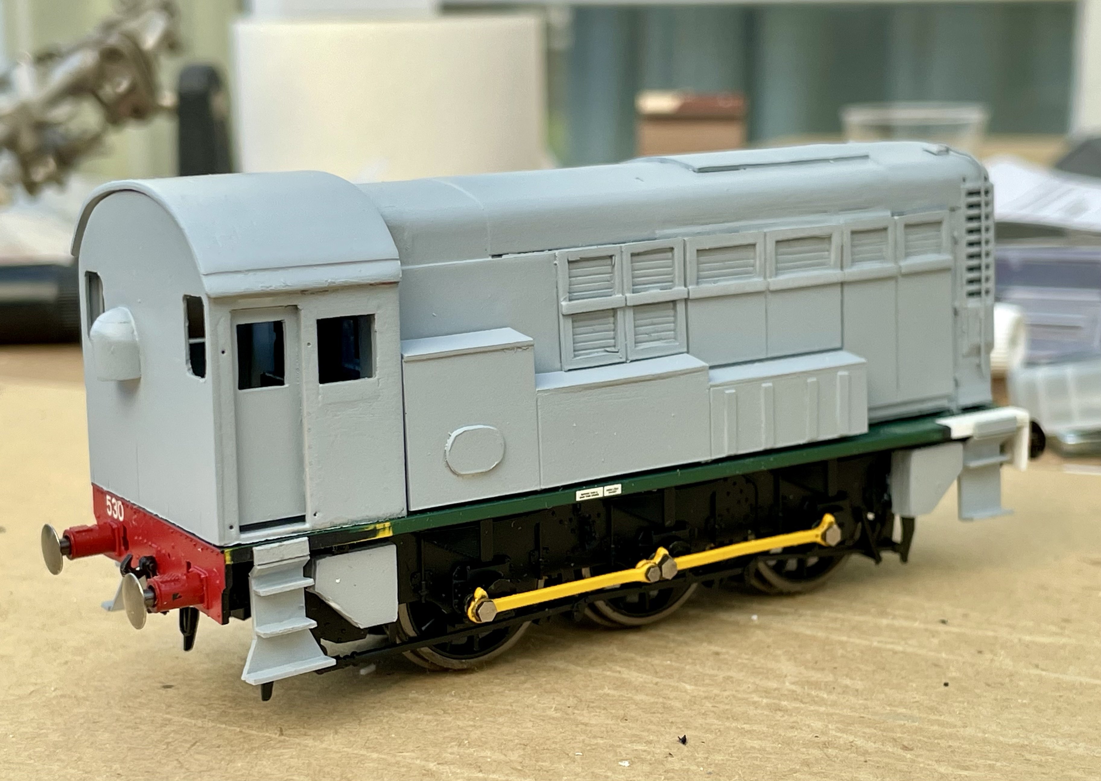

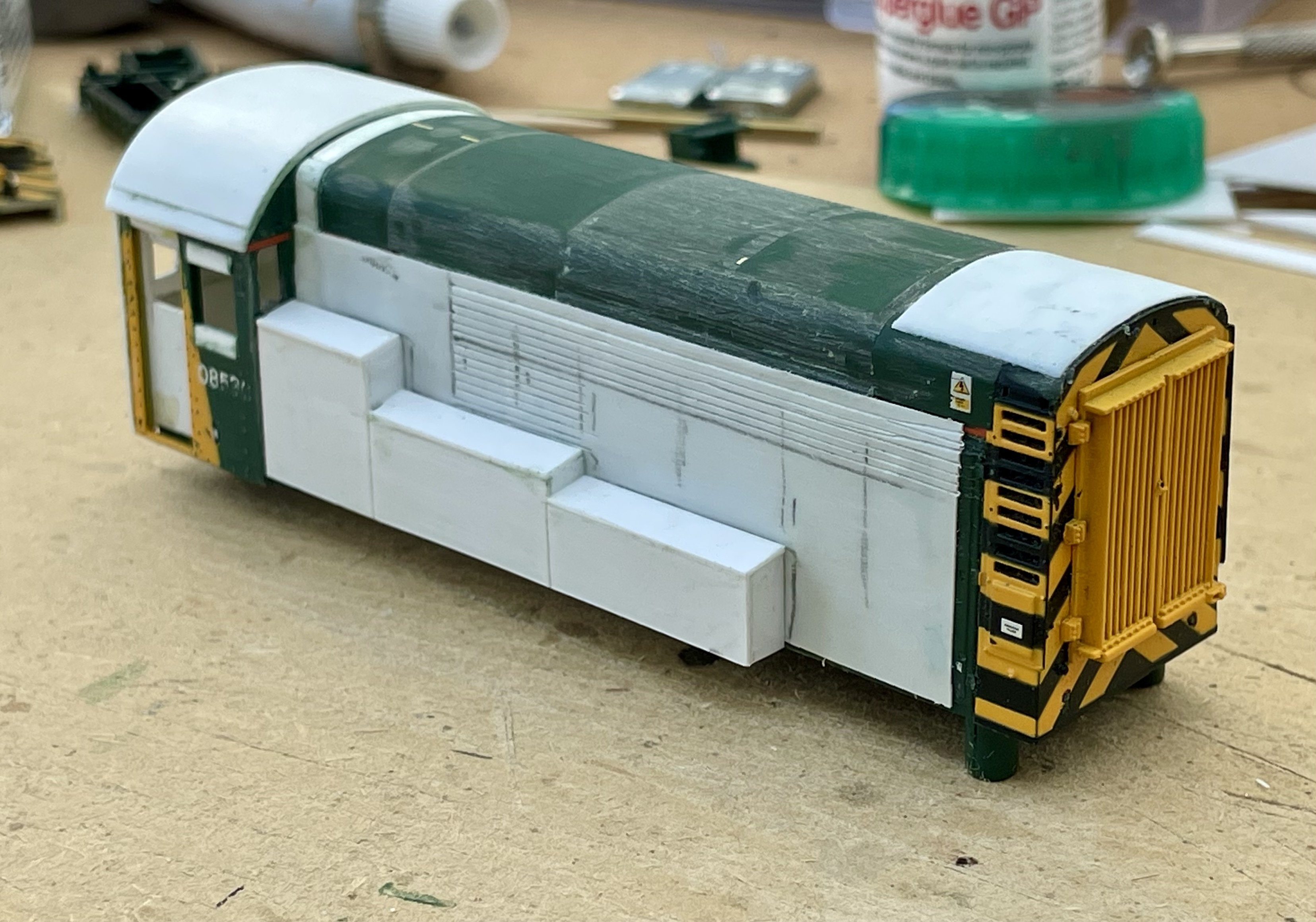

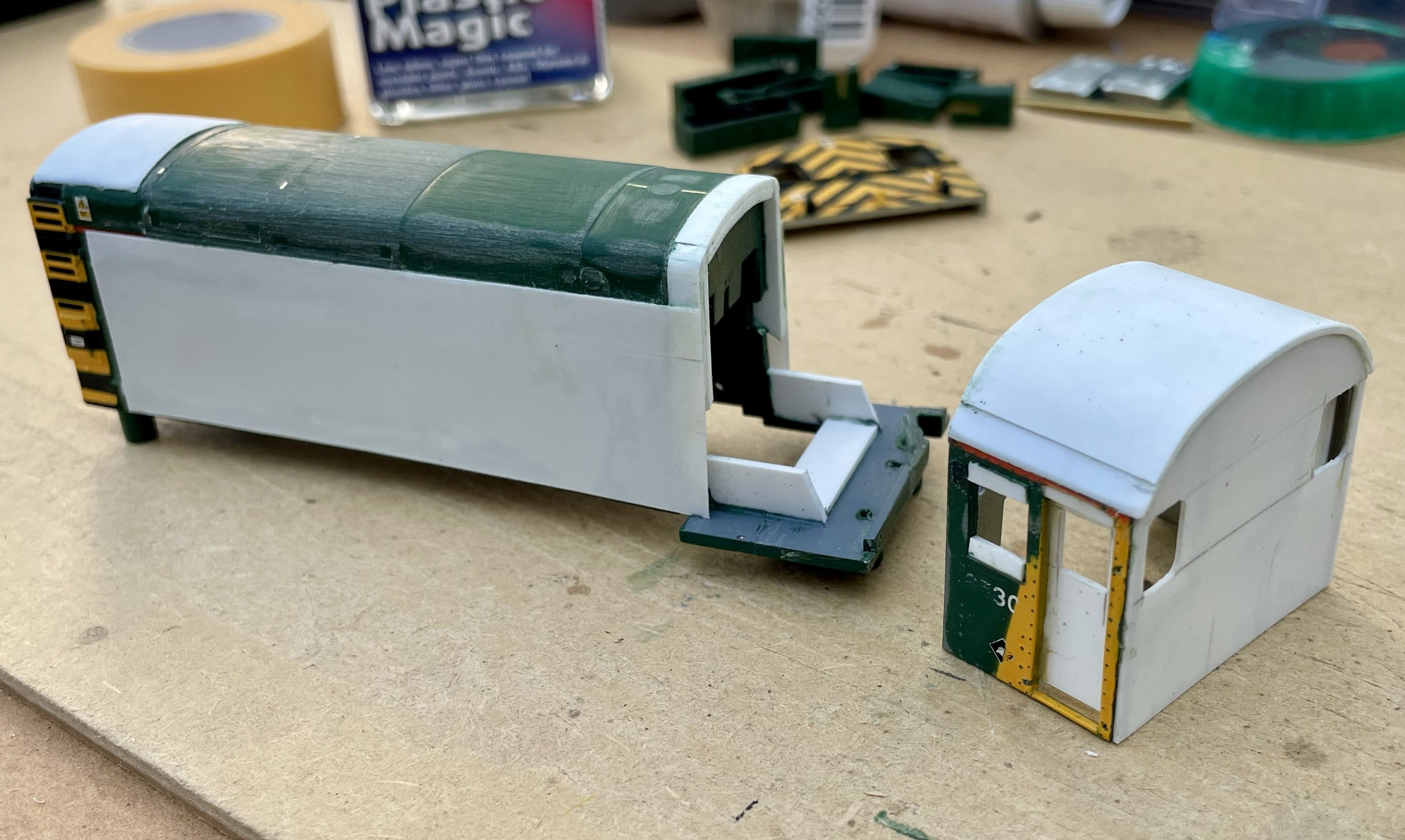

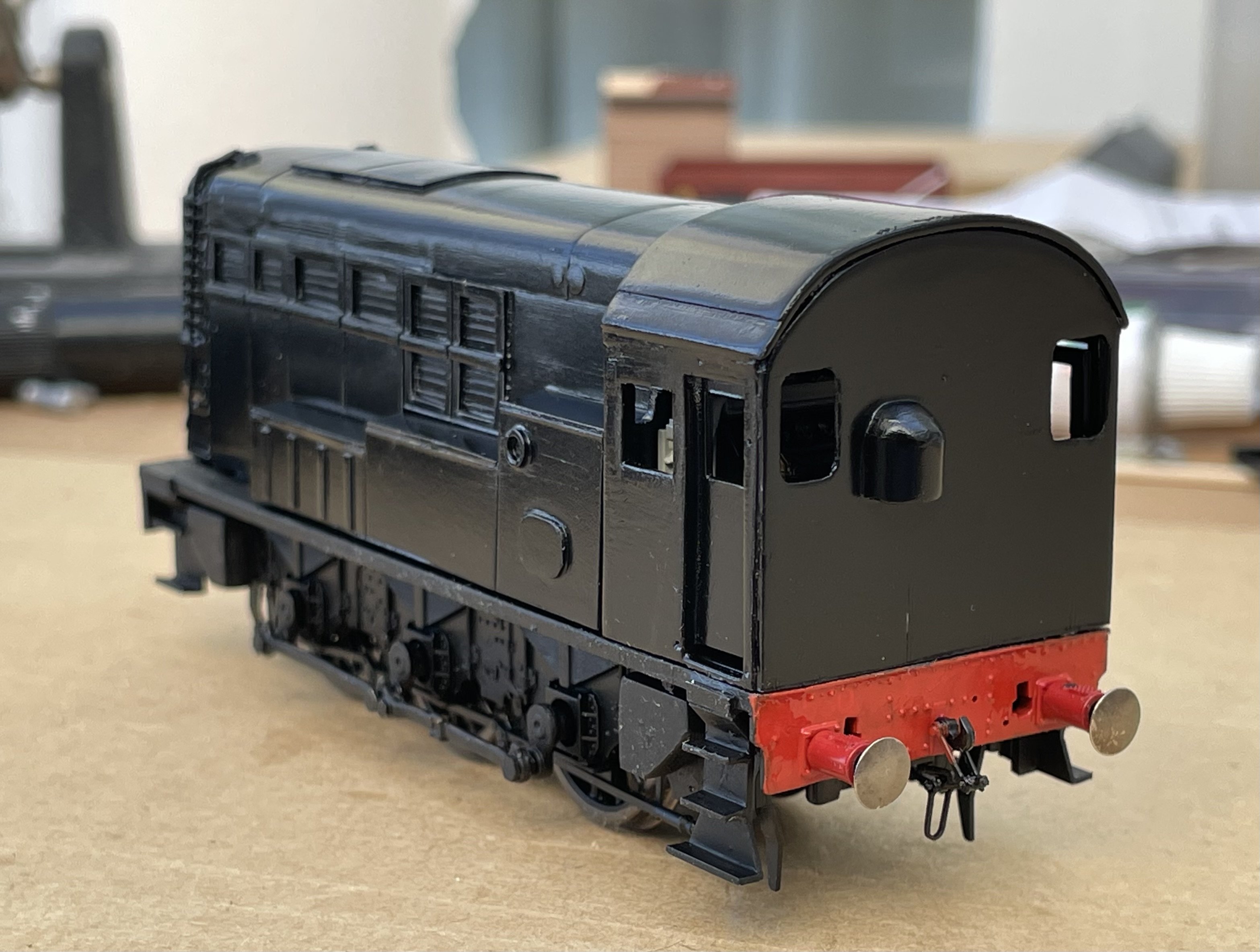

Further progress.
Cab truncated.
Bodyside skinned and cab modified.
Louvres scribed and side boxes added.
Cheers
Darius
  • Like 11

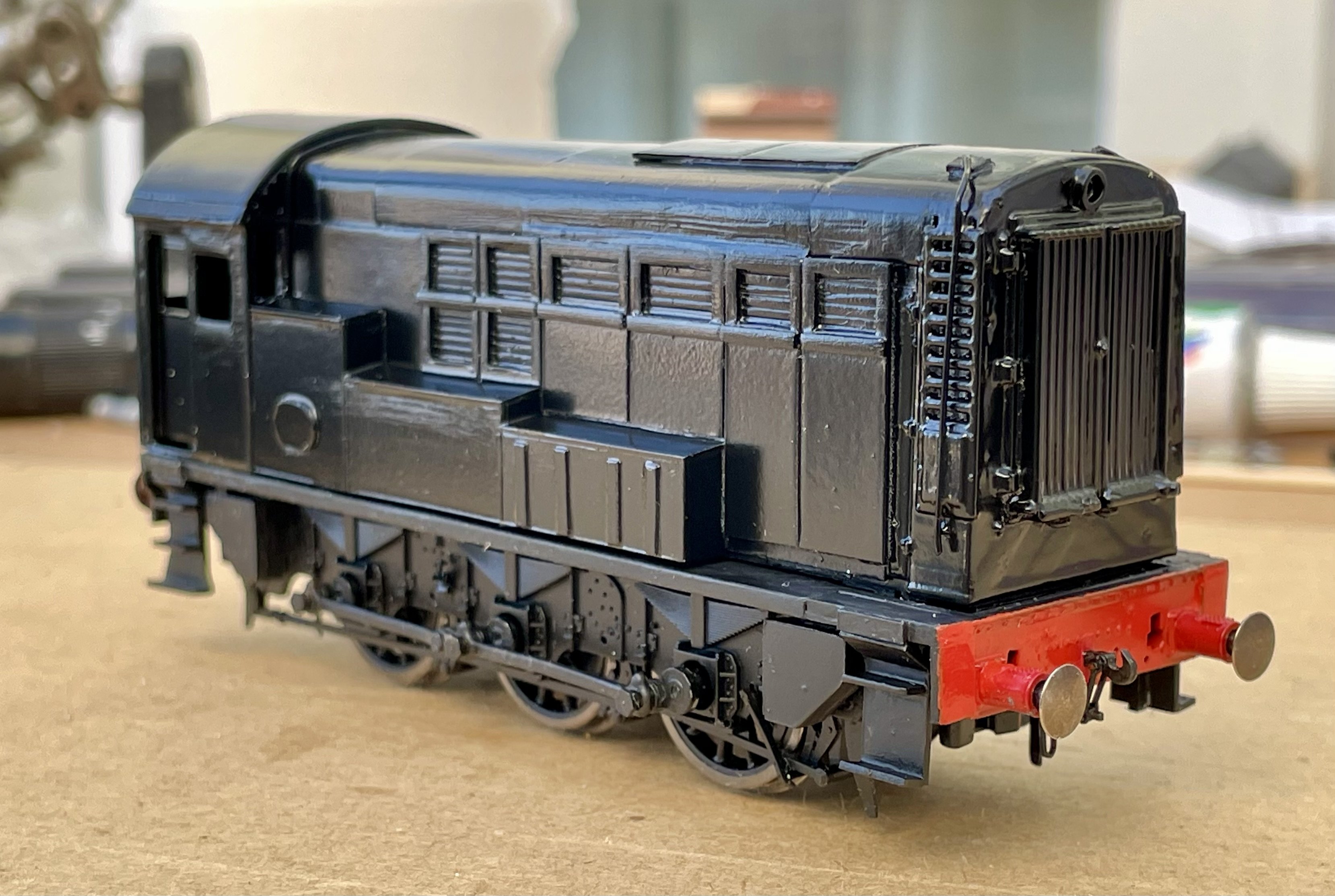

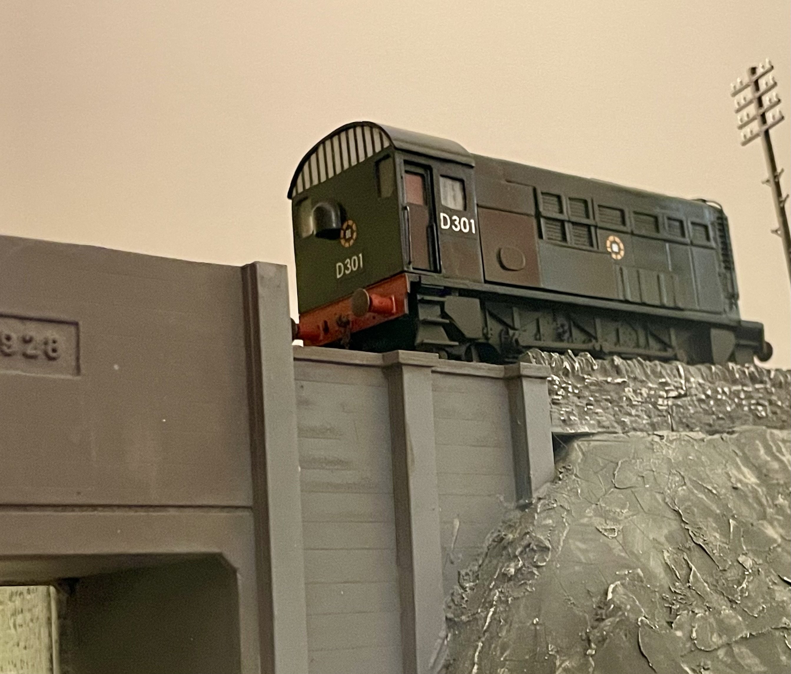

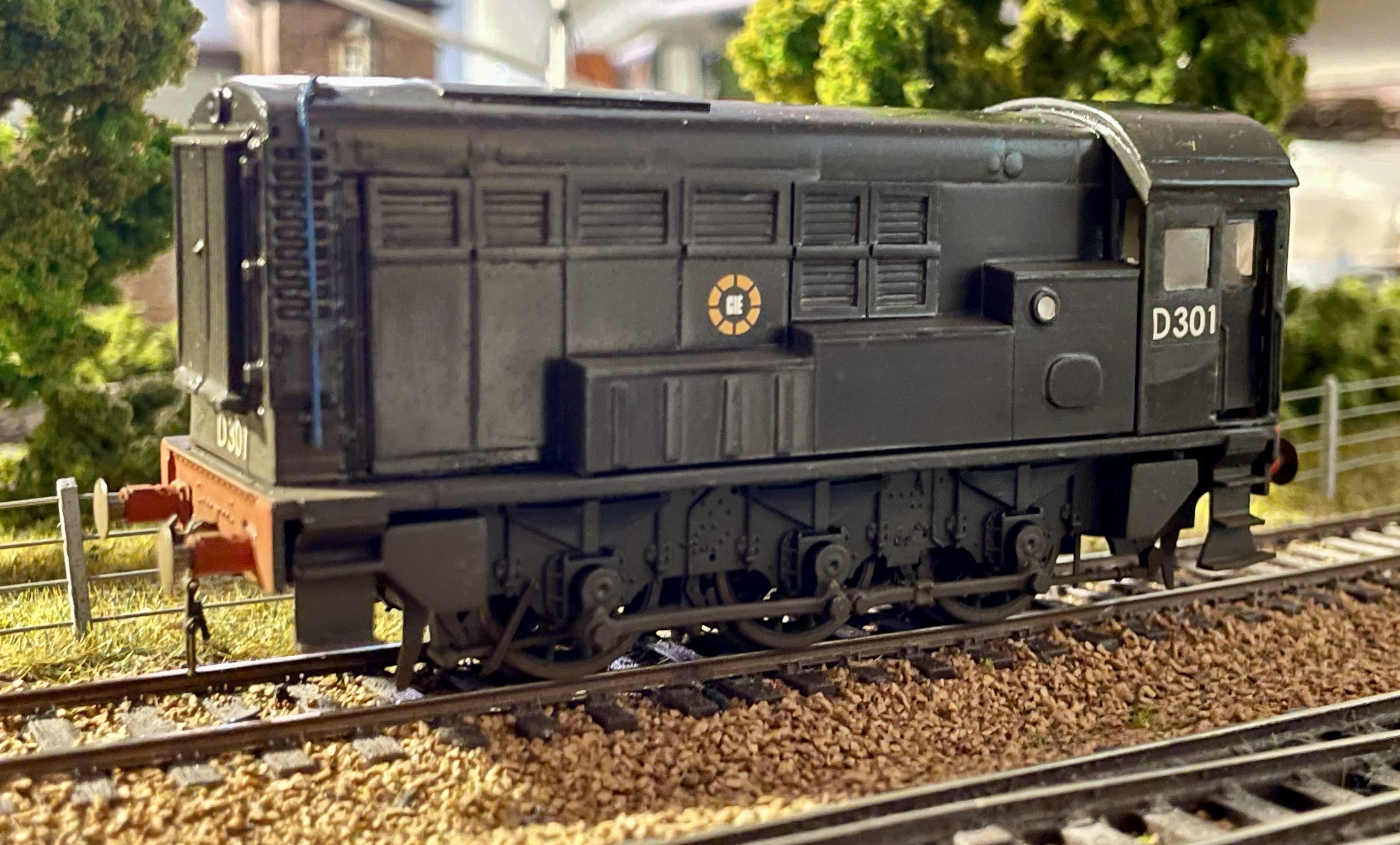

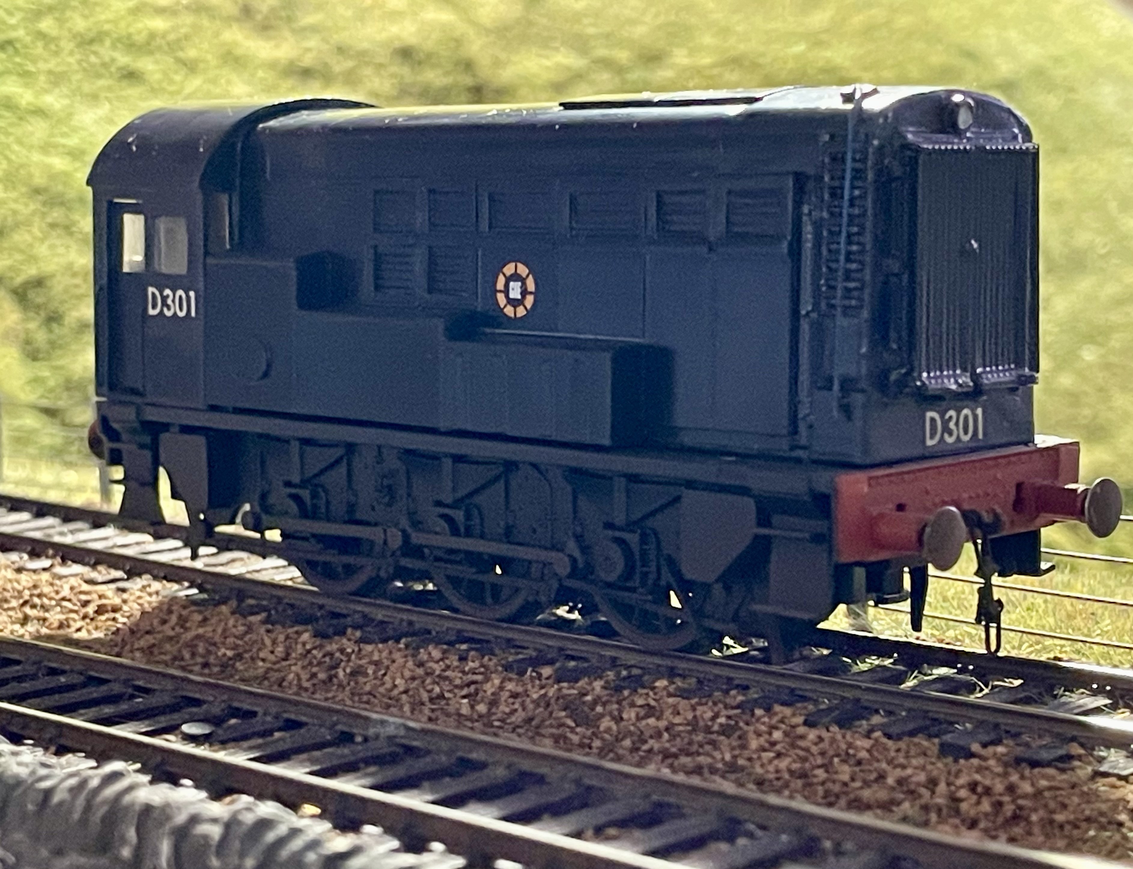

Now on the Whiterock roster.
I enjoyed this conversion so I’ve obtained another Hornby 08 - to become D304 in Black & Tan livery.
Cheers
Darius
Edited by Darius43

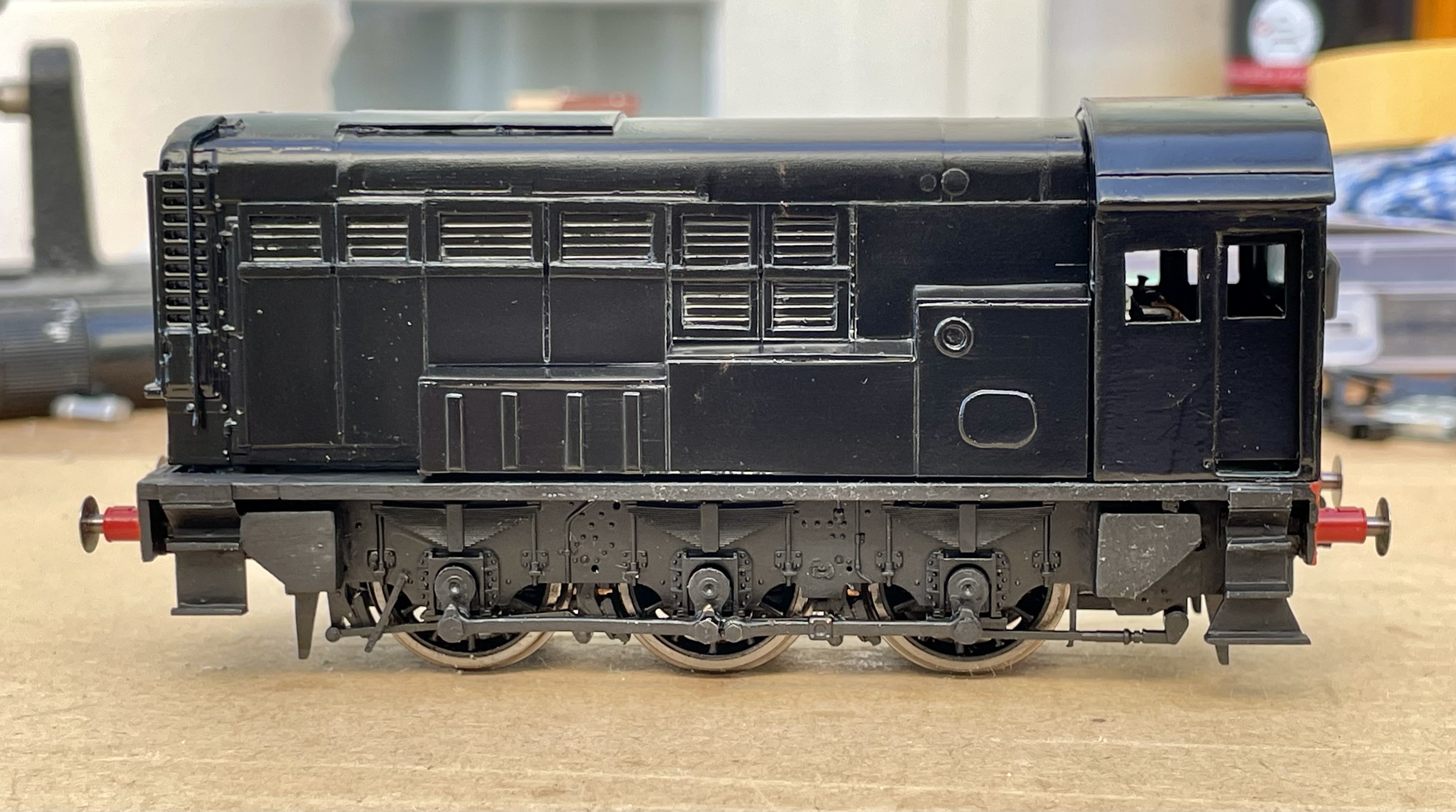

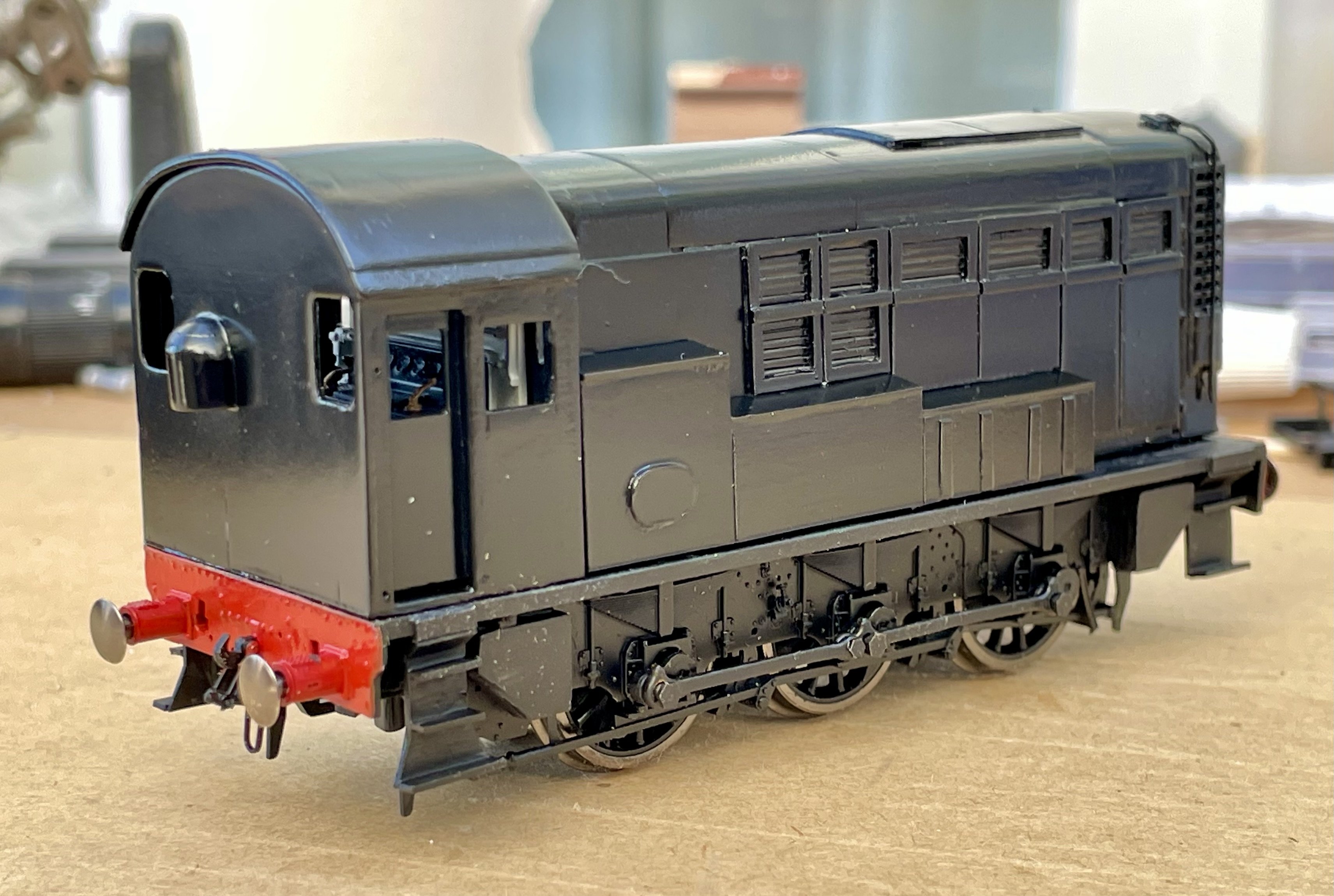

Very commendable, Darius. You're obviously staying in out of the sun!
How did you remove all those little boxes on each side of the bonnet - it looks like the sort of surgery I would run away from and just sloosh black paint over the standard 08 and apply a few transfers.
Rather you than me!
Compliments!
Hi Leslie.  On the Hornby 08 the boxes are separate parts so you can just prise them off.
Cheers
Darius
Edited by Darius43

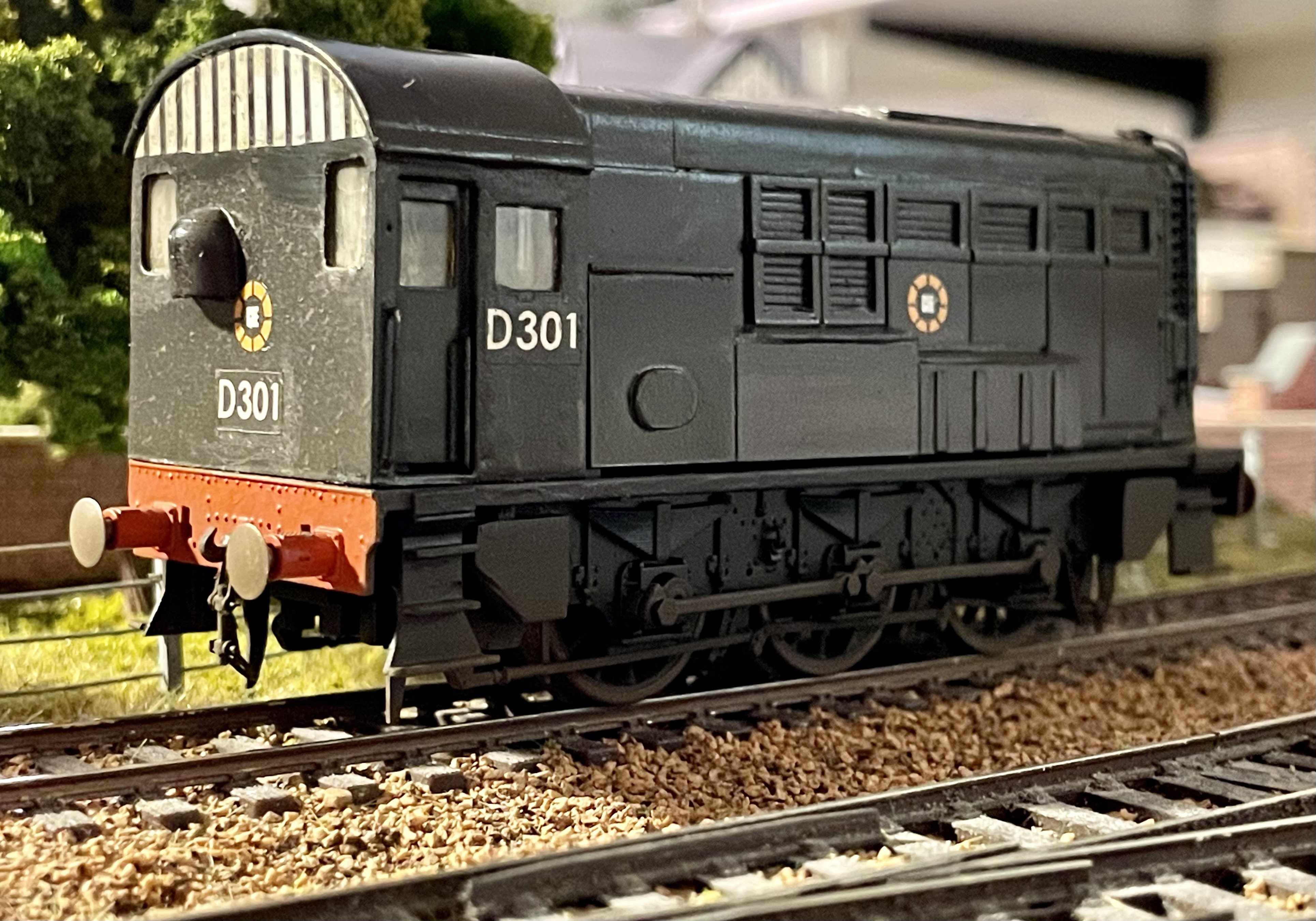

9 hours ago, Darius43 said:
Decals, glazing and weathering to finish.
Cheers
Darius
Outstanding work! Well done!

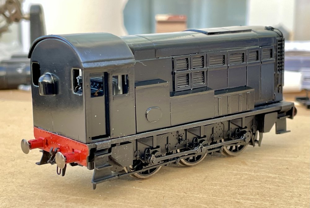

Rather you than me!
Compliments!
Was considering the “slosh” version myself, but it’s clearly very well worth the effort in doing it this way….
