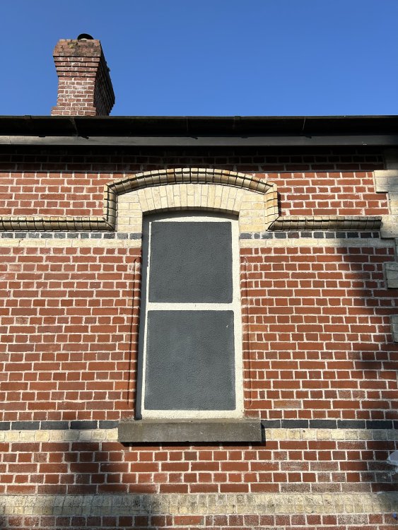

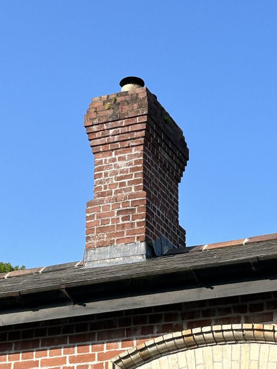

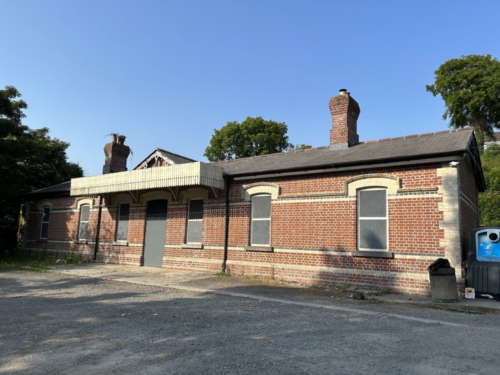

Patrick Davey Posted June 5, 2023 Author Posted June 5, 2023 (edited) Many thanks to Wilson Adams for these two great (but sad) views of Dunleer station, which will be the basis of Clogherhead station, the two locations being fairly close together in County Louth. Edited June 5, 2023 by Patrick Davey 7

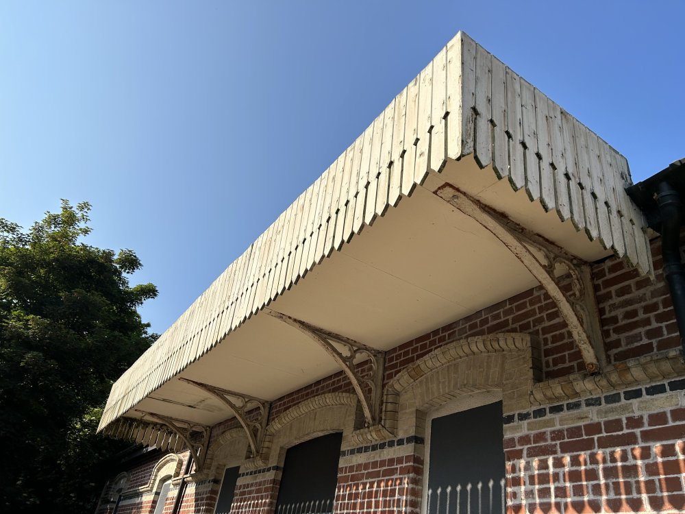

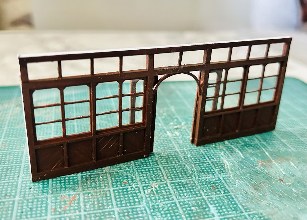

Patrick Davey Posted June 9, 2023 Author Posted June 9, 2023 Paid a quick visit to Dunleer station this evening for a photographic survey, nice to meet with Kevin Enright there as well, thanks for your company, Kevin, and for bringing your fabulous models for me to appreciate in person! I have also finished and glazed the wooden panel for the platform side of the building. 9

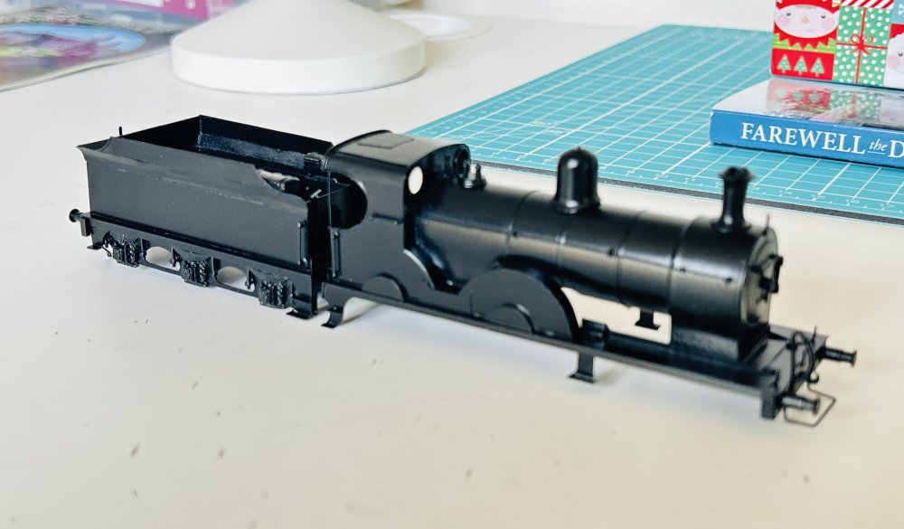

Patrick Davey Posted June 10, 2023 Author Posted June 10, 2023 Another significant development yesterday…….some shiny new equipment arrived! 7 1 1

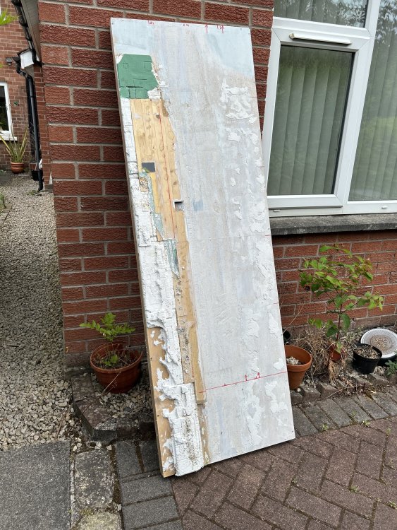

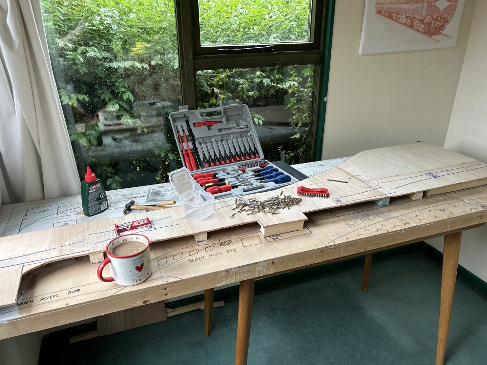

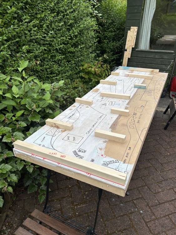

Patrick Davey Posted June 12, 2023 Author Posted June 12, 2023 BASEBOARD RECYCLING..... So the baseboard for Clogherhead was actually the original one which I built for Ballynahinch Junction back in 2008..... it must be of decent construction because it has survived 15 years in the temperature extremes of the attic...... I was dreading having to prepare it for this project but it all went without a hitch, previous installations of wood and polystyrene ceiling tile came away relatively easily then I was able to start laying out the track and mark the location of buildings etc. Once finalised, a raised plywood level will be added which will hold the track - the supports for this have been glued down and have been weighted until they set overnight. They will have plenty of time to set - more work travels for the foreseeable! 6

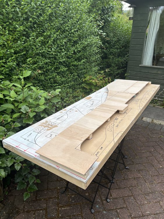

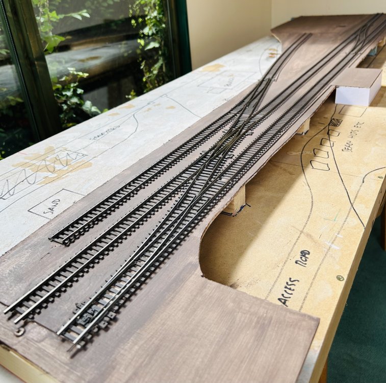

Patrick Davey Posted June 12, 2023 Author Posted June 12, 2023 (edited) Trackbed finalised - won't be glued down until provision has been made for my patented mechanical turnout operating system to be installed! The area to the right will be the beach, at a lower level, and the area to the left will be higher ground, but I will build this up using card, to reduce the overall weight. Edited June 12, 2023 by Patrick Davey 9 1

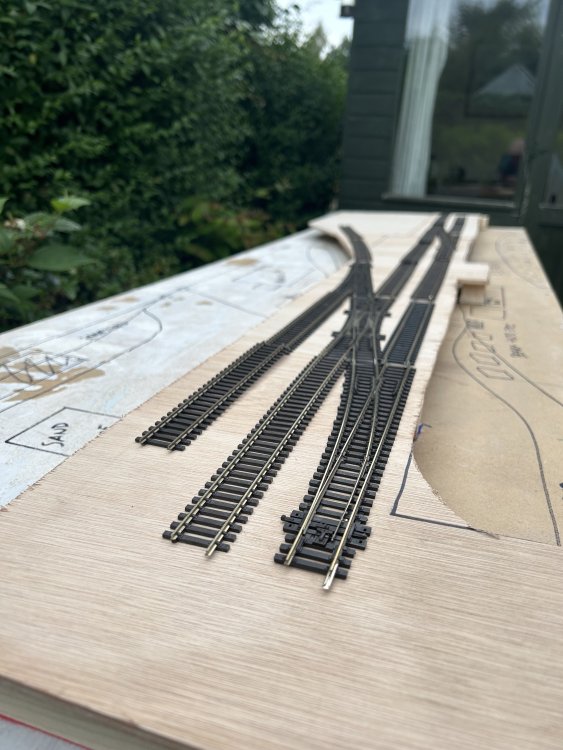

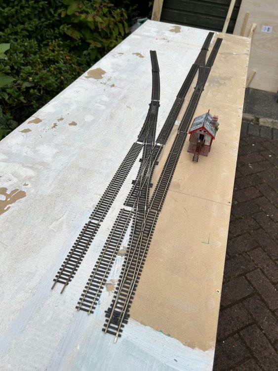

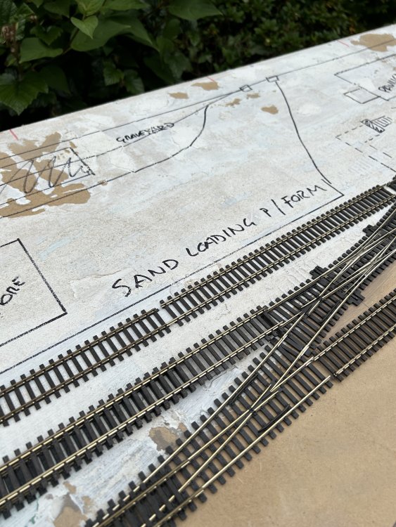

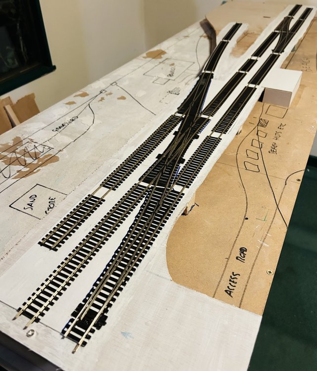

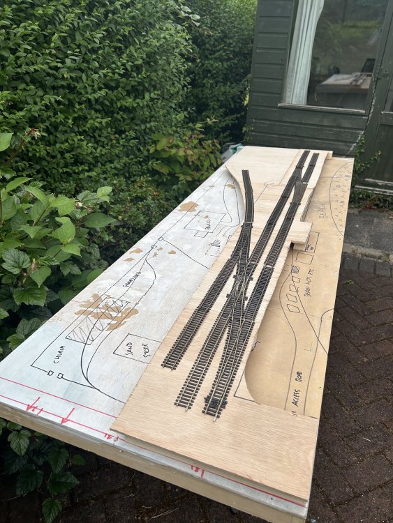

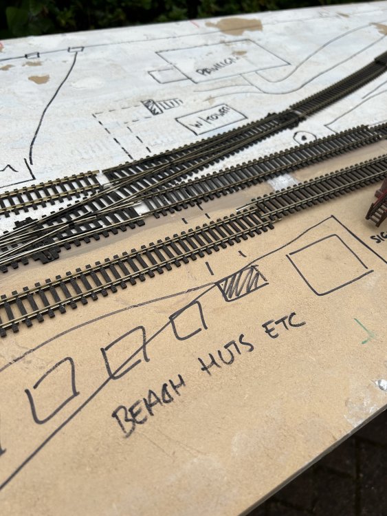

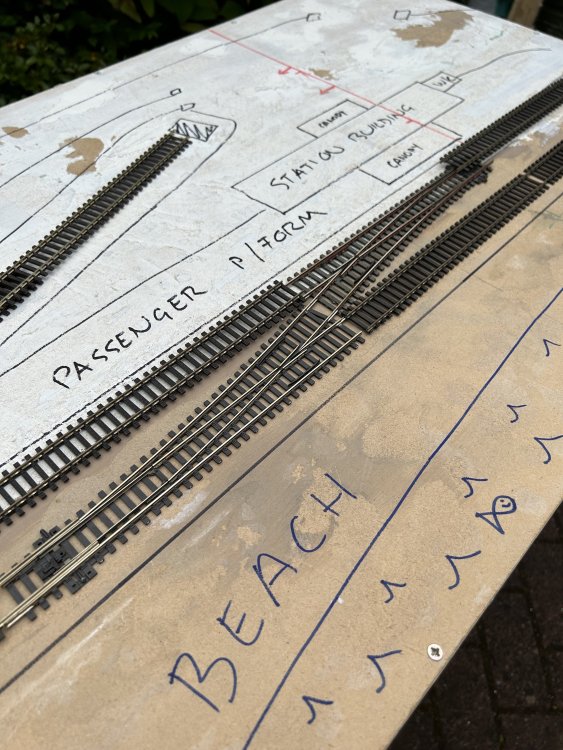

Patrick Davey Posted June 13, 2023 Author Posted June 13, 2023 Checking clearances on the trackplan. 5
Patrick Davey Posted June 13, 2023 Author Posted June 13, 2023 5 minutes ago, Sean said: Happy Fishes Hope I got the scales right........ 2

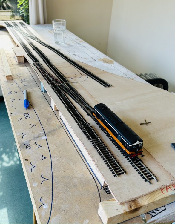

Patrick Davey Posted July 6, 2023 Author Posted July 6, 2023 (edited) That magical moment when you see a locomotive running on your freshly laid track plan, with no derailments! I had previously carried out a rolling test with a wagon, then I wired up some basic connections, and thankfully all is well with only one small glitch, which I think I should be able to rectify. Please excuse the sudden stop & start, but I needed three hands for this test! IMG_2154.MOV FullSizeRender.MOV Edited July 6, 2023 by Patrick Davey 3

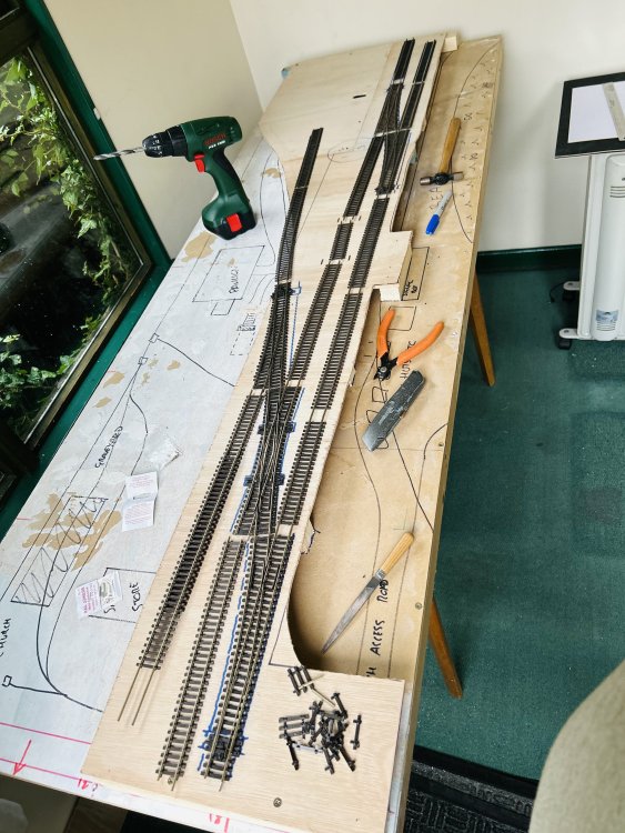

Patrick Davey Posted July 9, 2023 Author Posted July 9, 2023 (edited) Forgive me for interrupting what has become a highly entertaining comedy thread….. but I am pleased to report that this evening I have completed track laying and everything is working as it should, all turnouts are fully functional with no electrical issues to report. The track has been glued securely to the baseboard following sealing of this with a few coats of paint and final coat of neat PVA glue. I want to create a look of decay in a coastal context, so a bit of research will be done to get the right blend of colours. The look of the disused track on JB’s Dugort Harbour is exactly what I’m looking for. Next on the to-do list is the filling in of loose sleepers in the gaps and then applying a suitable base coat of paint to blend the whole lot together. I like David’s suggestion of using chinchilla dust, so I think I will go ahead and use that on the track, but I’m still holding onto the romantic notion of using actual sand from Clogherhead beach on the beach part of my layout, noting JB’s advice to boil this before bringing it anywhere near the layout. Edited July 9, 2023 by Patrick Davey 10

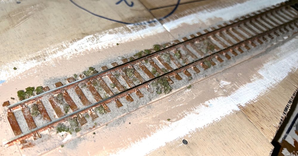

Patrick Davey Posted July 12, 2023 Author Posted July 12, 2023 Decided to have a go at a test section of track to see if I can get the weathered 'sandy' look. The sleepers look a bit too glossy and copper-y in this shot but overall I'm happy enough and have decided on the following approach, once I get the correct colours: 1. Light matt brown base colour over everything 2. Dry brush sleepers with a mix of grey and white to give the 'bleached' look 3. Paint the side of the rails a rust colour (specific tool ordered for that) 4. Add clumps of foliage 5. 'Ballast' with chinchilla dust so it looks like the foliage is growing out of the sand. The subject of rusty rails is an interesting one. I have observed the prototype closely and believe the following is true: * On active railway lines, the movement of trains throws up dirt etc which gives the sides of the rails a muddy brown colour * On lesser used lines, the lack of movement of trains allows the sides of the rails to assume the rusty colour I think! 6
Galteemore Posted July 12, 2023 Posted July 12, 2023 Looks good to me Patrick. Agreed - weathered wood needs shades of grey rather than brown. When you apply that treatment you may find that the brown on the railsides actually looks ok without further intervention. A dusting of talc will also help it all blend in together. 1
