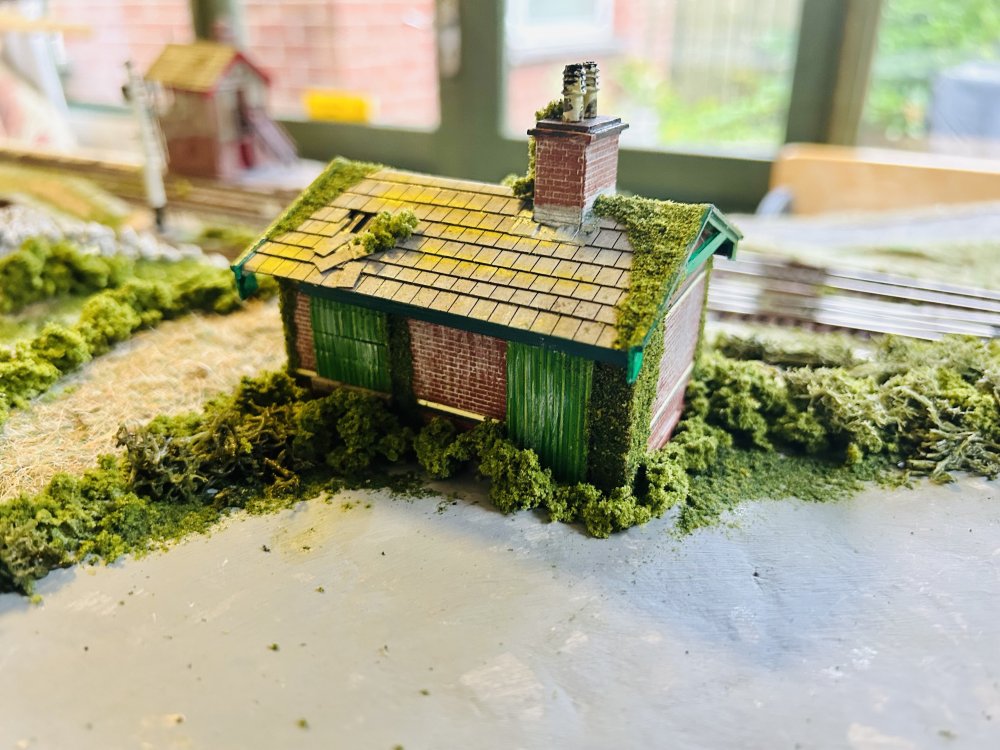

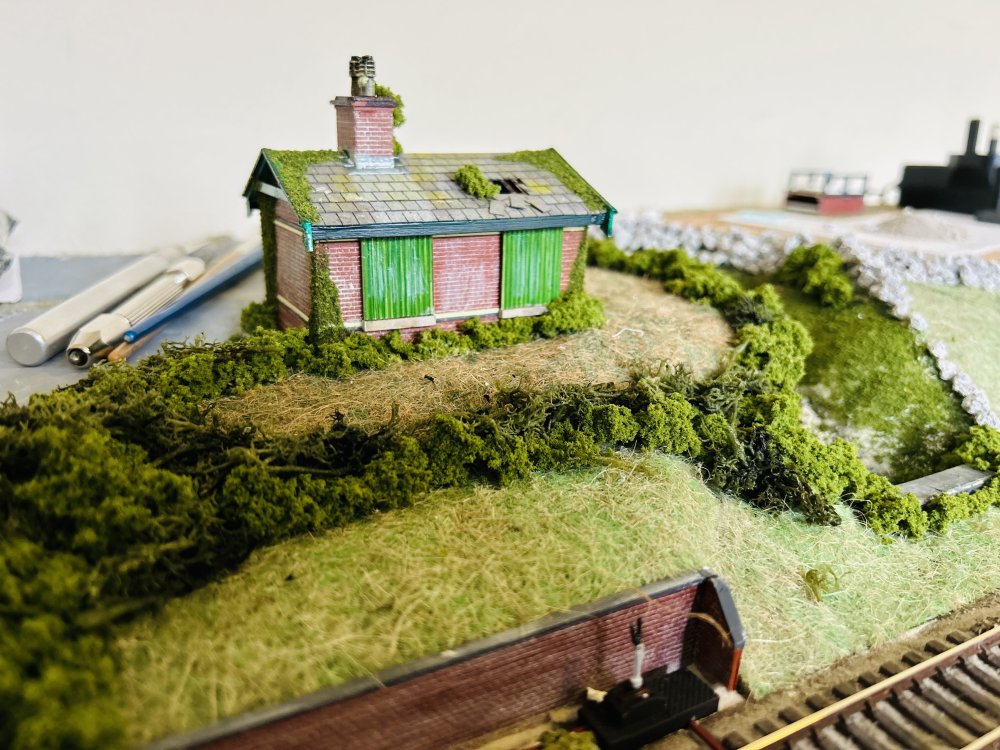

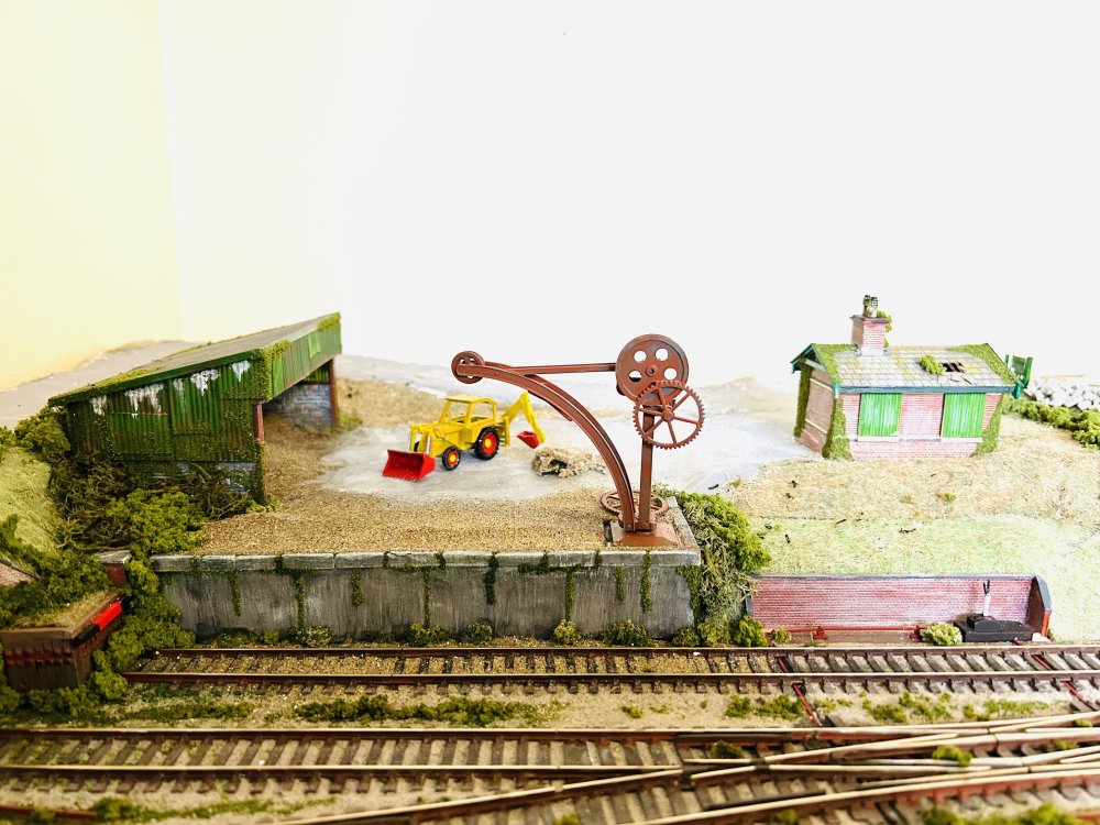

Patrick Davey Posted October 6, 2023 Author Share Posted October 6, 2023 Latest developments in Co. Louth….. The derelict office has now been bedded in with foliage: And I’m not sure about this one but I have had an old Ratio crane in the ‘to make’ box for a few years thinking it would find a place at Brookhall Mill but it never did so I fired it together for Clogherhead. The idea is that the GN experimented with specially constructed containers for easier loading and unloading of the sand but the system didn’t work….. not sure it looks right but maybe it’ll grow on me! It has been suitably rusted of course! 12 Quote Link to comment Share on other sites More sharing options...

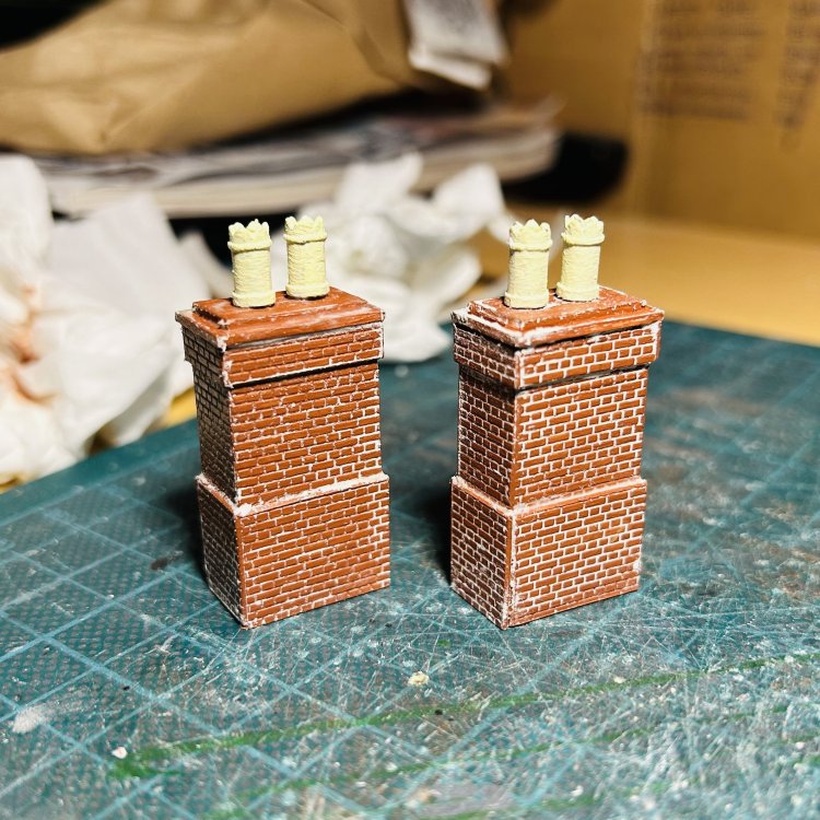

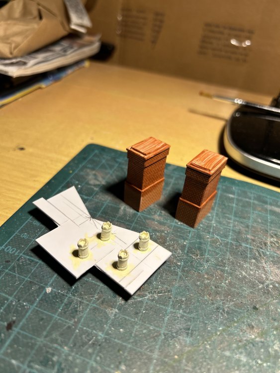

Patrick Davey Posted October 10, 2023 Author Share Posted October 10, 2023 Stacks of fun on the Clogherhead workbench this evening. Chimneys aren't my favourite thing to make because I invariably leave them to the end and then get really frustrated because they hold up the completion of the build, so this time I'm making them early on in the build. They are for the Clogherhead station building. 5 Quote Link to comment Share on other sites More sharing options...
Patrick Davey Posted October 11, 2023 Author Share Posted October 11, 2023 And we have chimneys 11 Quote Link to comment Share on other sites More sharing options...
David Holman Posted October 12, 2023 Share Posted October 12, 2023 Looking good - how has the brickwork been created/coloured? 1 Quote Link to comment Share on other sites More sharing options...
Patrick Davey Posted October 12, 2023 Author Share Posted October 12, 2023 8 hours ago, David Holman said: Looking good - how has the brickwork been created/coloured? Thanks David Embossed plasticard painted with Burnt Sienna acrylic then DAS clay applied for the pointing. The chimney pots are white metal castings. 2 1 1 Quote Link to comment Share on other sites More sharing options...

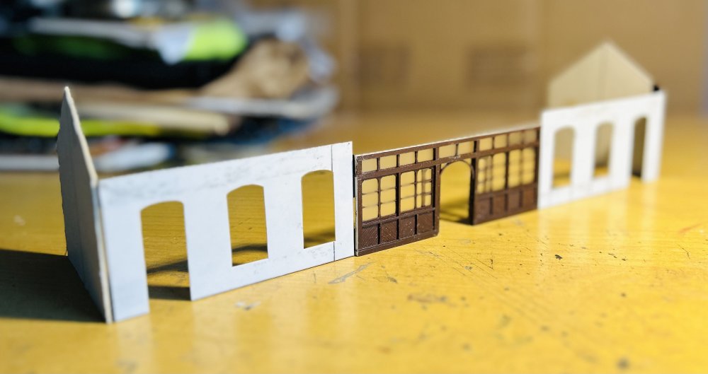

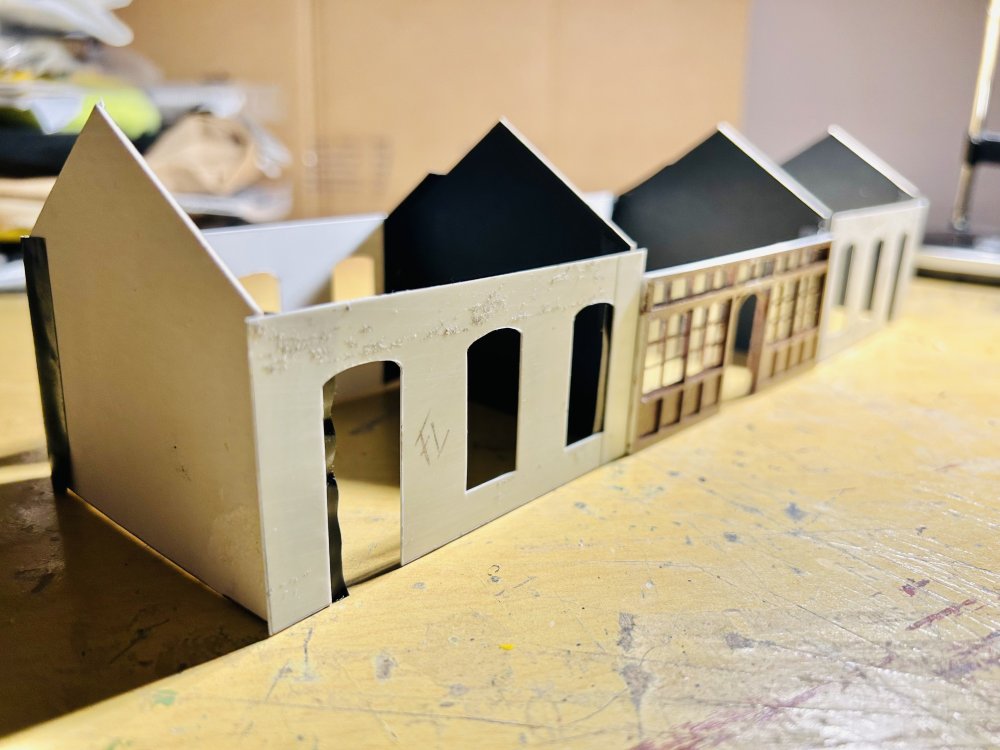

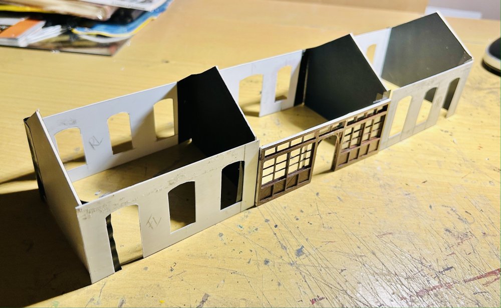

Patrick Davey Posted October 16, 2023 Author Share Posted October 16, 2023 (edited) Further progress this evening. The side with the glazed panel is the platform side and the panel itself will have a canopy above it. The forecourt side will have a smaller canopy above the door. I am also currently thinking how the internal layout will be arranged and also considering having part of the building derelict, in keeping with the overall theme of the layout. Edited October 16, 2023 by Patrick Davey 12 1 Quote Link to comment Share on other sites More sharing options...

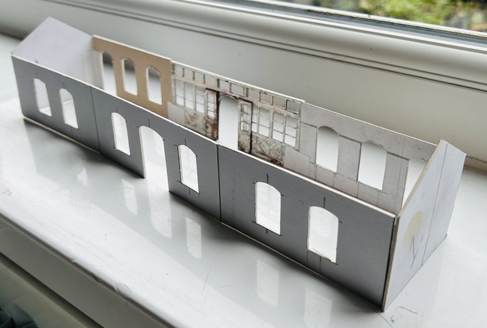

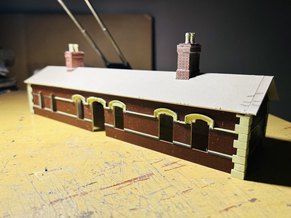

Patrick Davey Posted October 19, 2023 Author Share Posted October 19, 2023 I wasn't happy with the dimensions of the station building so I trimmed these a bit and removed two windows from the forecourt wall, which brings it in line with Dunleer. Much happier with the proportions now. 11 Quote Link to comment Share on other sites More sharing options...

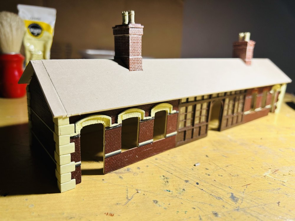

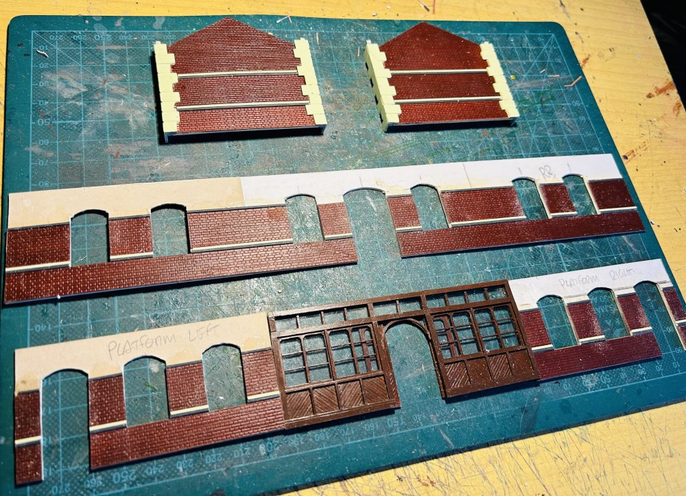

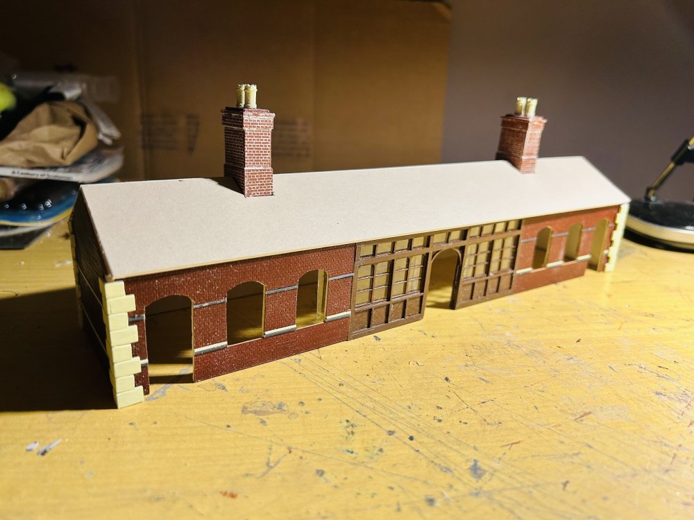

Patrick Davey Posted October 22, 2023 Author Share Posted October 22, 2023 Brickwork underway for Clogherhead station building. The GNR didn’t make it easy for future modellers, with their decorative brick arches, but I’m trying something new this time which might make it a bit easier…… or not…… 8 1 Quote Link to comment Share on other sites More sharing options...

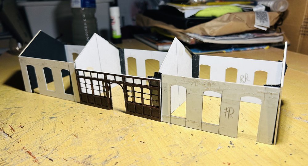

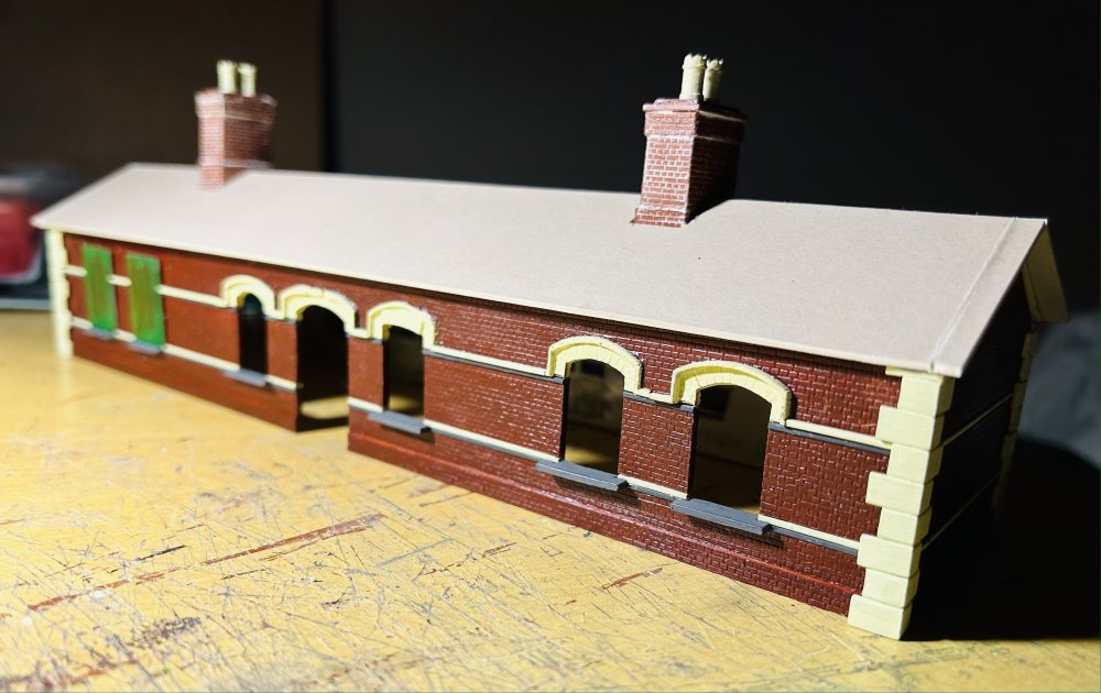

Patrick Davey Posted October 22, 2023 Author Share Posted October 22, 2023 Here we are at the close of business today, a rough idea of what the building will look like, it’s just loosely Sellotaped together with a makeshift roof. There will be a large canopy on this (platform) side and a smaller one on the other side, above the forecourt door. 9 7 Quote Link to comment Share on other sites More sharing options...
jhb171achill Posted October 22, 2023 Share Posted October 22, 2023 Now THAT is a work of art!!! How did you do the criss-cross timberwork in the middle section? 1 2 Quote Link to comment Share on other sites More sharing options...
Patrick Davey Posted October 22, 2023 Author Share Posted October 22, 2023 7 minutes ago, jhb171achill said: Now THAT is a work of art!!! How did you do the criss-cross timberwork in the middle section? Thanks JB! It was just achieved using lots of plasticard strips, time-consuming, but definitely worth it!! 3 1 Quote Link to comment Share on other sites More sharing options...
derek Posted October 22, 2023 Share Posted October 22, 2023 31 minutes ago, Patrick Davey said: Here we are at the close of business today, a rough idea of what the building will look like, it’s just loosely Sellotaped together with a makeshift roof. There will be a large canopy on this (platform) side and a smaller one on the other side, above the forecourt door. Sheesh! I have a vague idea what my new station is going to look like, and it aint anything like that beauty. I need to buck up my ideas 2 1 Quote Link to comment Share on other sites More sharing options...

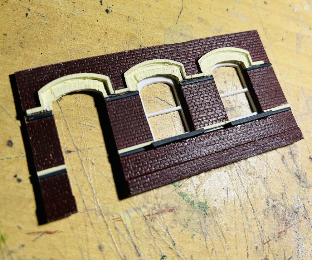

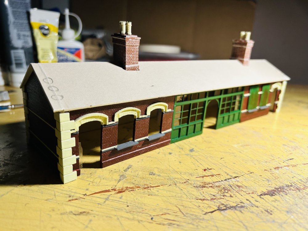

Patrick Davey Posted October 24, 2023 Author Share Posted October 24, 2023 (edited) A bit of work was done today on the window arches. I had these laser cut a while back, in thick card, and they do make the job a good bit easier. Window sills next then window frames. Not all the windows will be arched though as some will be boarded over. Edited October 24, 2023 by Patrick Davey 9 1 Quote Link to comment Share on other sites More sharing options...
Patrick Davey Posted October 27, 2023 Author Share Posted October 27, 2023 More work on decorating the walls of the station building today - the wooden glazed panel has been given a coat of CIÉ 1960s green (thanks @jhb171achill!), window sills have been added and the polychromatic brickwork has been tidied up. Next it'll be the window frames, then the walls can be assembled. 12 Quote Link to comment Share on other sites More sharing options...

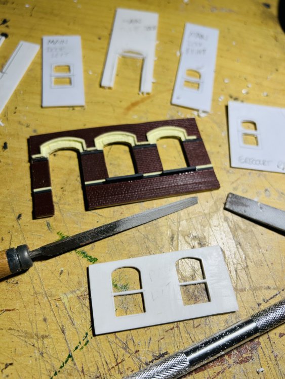

Patrick Davey Posted October 30, 2023 Author Share Posted October 30, 2023 Pane-ful work this evening, with lots of cutting and filing, cutting and filing, cutting and filing, cutting and…… 6 1 Quote Link to comment Share on other sites More sharing options...
Gabhal Luimnigh Posted October 30, 2023 Share Posted October 30, 2023 Fair dues Patrick, that takes patience. 1 Quote Link to comment Share on other sites More sharing options...
Tullygrainey Posted October 30, 2023 Share Posted October 30, 2023 Lovely stuff. Following this with interest Patrick. It's great to have a window on your work. 1 1 Quote Link to comment Share on other sites More sharing options...
Galteemore Posted October 30, 2023 Share Posted October 30, 2023 Well done - looks great. My eyes tend to glaze over doing work like that 2 Quote Link to comment Share on other sites More sharing options...
Noel Posted October 30, 2023 Share Posted October 30, 2023 Your end results make it work the cutting and filling and cutting and filling and cutting and filling and cutting and filling and the sanding. 1 Quote Link to comment Share on other sites More sharing options...

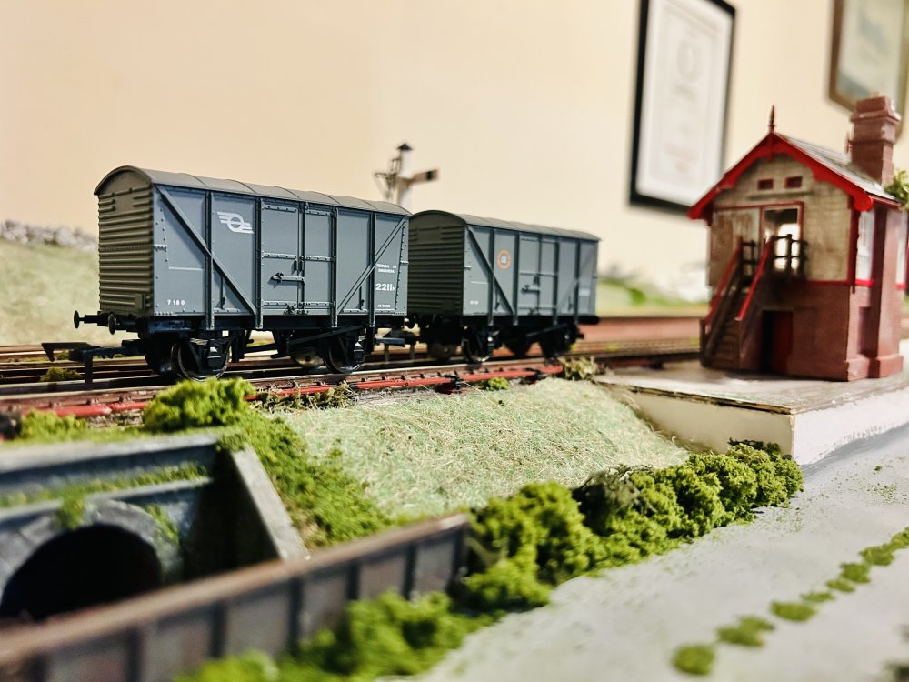

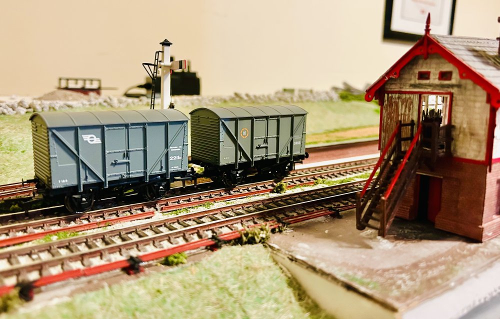

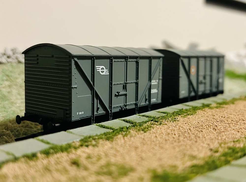

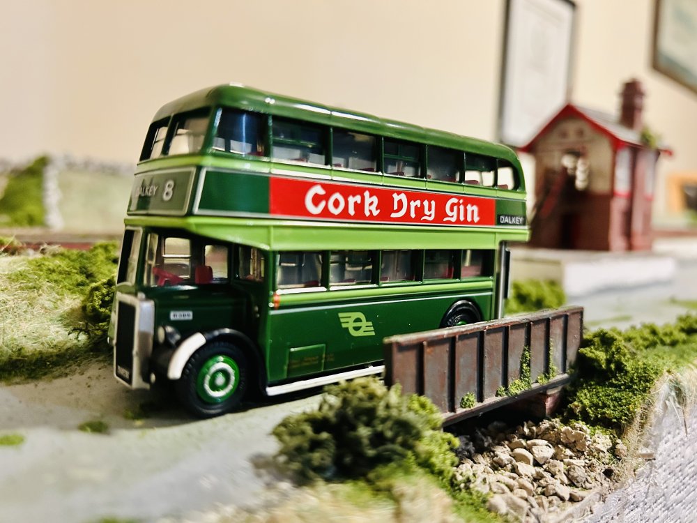

Patrick Davey Posted October 30, 2023 Author Share Posted October 30, 2023 (edited) Two of @leslie10646’s fantastic new cement vans looking right at home at Clogherhead, along with a CIÉ bus. Loved the show at Blackrock today - well done to all involved Edited October 30, 2023 by Patrick Davey 11 Quote Link to comment Share on other sites More sharing options...
DJ Dangerous Posted October 30, 2023 Share Posted October 30, 2023 The layout is out of this world, and the wagons and bus look right at home there! Any joy finding that Base Toys Leyland Comet that @Westcorkrailway saw? 1 Quote Link to comment Share on other sites More sharing options...
Patrick Davey Posted October 30, 2023 Author Share Posted October 30, 2023 (edited) 1 minute ago, DJ Dangerous said: The layout is out of this world, and the wagons and bus look right at home there! Any joy finding that Base Toys Leyland Comet that @Westcorkrailway saw? Very kind comments, thank you DJ! I checked every stand, it must’ve been snapped up or maybe I just missed it! Happy with the bus in the meantime! Great show all together Edited October 30, 2023 by Patrick Davey 1 Quote Link to comment Share on other sites More sharing options...
DJ Dangerous Posted October 30, 2023 Share Posted October 30, 2023 I'm sure another will come along eventually. The bus is fabulous, and @leslie10646¡s wagons are top notch! 1 Quote Link to comment Share on other sites More sharing options...
Westcorkrailway Posted October 30, 2023 Share Posted October 30, 2023 To be honest when I saw that lorry I was going to buy it on behalf of @Patrick Davey it only cost a few euro after all. But I was under the impression that he was there on the Saturday. Lesson learned for next time! 10 minutes ago, Patrick Davey said: Two of @leslie10646’s fantastic new cement vans looking right at home at Clogherhead, along with a CIÉ bus. Loved the show at Blackrock today - well done to all involved I’m in love with my van. I mean seriously there is nothing you can buy for 20 quid anymore. I’d be suprised if many of the broken wheel ones are left . 1 1 Quote Link to comment Share on other sites More sharing options...
Patrick Davey Posted October 30, 2023 Author Share Posted October 30, 2023 7 minutes ago, Westcorkrailway said: To be honest when I saw that lorry I was going to buy it on behalf of @Patrick Davey it only cost a few euro after all. But I was under the impression that he was there on the Saturday. Lesson learned for next time! I’m in love with my van. I mean seriously there is nothing you can buy for 20 quid anymore. I’d be suprised if many of the broken wheel ones are left . That’s a very kind thought thank you @Westcorkrailway 1 Quote Link to comment Share on other sites More sharing options...
