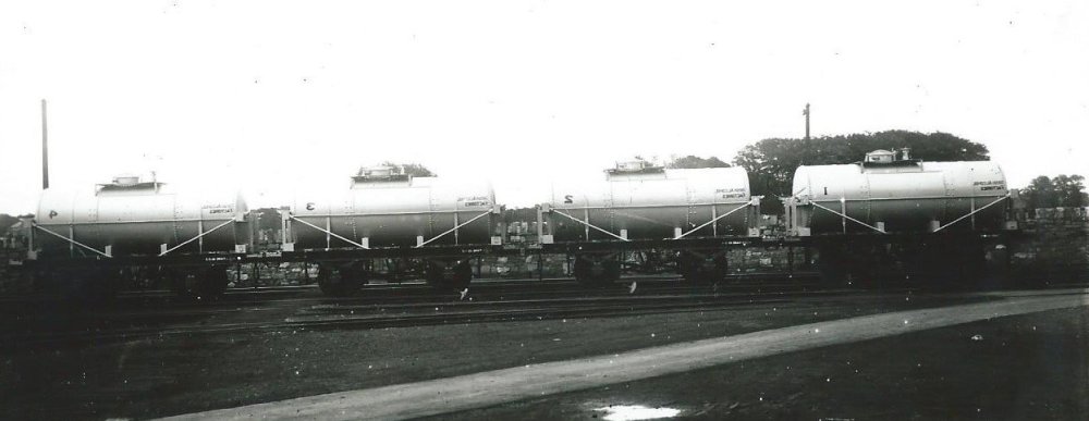

Mayner Posted October 10, 2023 Posted October 10, 2023 Most Irish tank wagons up to the mid 1960s were standard British RCH designs assembled by builders like Hurst Nelson and Charles Roberts not dissimilar to the Slaters O Gauge and Bachmann OO Gauge RCH wagons, the main physical difference between the Class A and B wagons was the discharge arrangement the Class A through a siphon pipe on top of the barrel and the B through a discharge pipe under the wagon operated by a hand wheel on the top! CIE started building 'modern" vacuum braked tank wagons in the early-mid 60s for Foynes-Drogheda & Limerick fuel oil traffic for Cement Limited and later built small batches of tank wagons in the early 70s for Burmah (6 wagons) possibly general use and fuel oil traffic to loco depots and bus garages. The ESSO wagons were owned by ESSO Teo and were re-gauged type A & B Charles Roberts built ESSO tank wagons dating from the late 50s made redundant by the introduction of larger air braked wagons. The majority of the older tank wagons were dumped/stored in the Sherriff St/East Wall Yard until the yard was cleared out during the early 2000s. One interesting group of wagons similar to the Dapol Type A anchor mounted wagons formerly owned by Caltex/Texaco that were used on North Wall-Inchacore fuel trains into the late 70s early 80s. Originally branded CALTEX they were re-branded TEXACO and ended up with the CALTEX lettering "grinning" through the paintwork an interesting lettering/weathering challenge. Not great photos taken late afternoon late 90sThe Irish Shell Wagon is a late 1920s RCH Type A with silver body and red solebars 113 is one of the Anchor mounted Caltex wagons re-branded as Texaco. The Caltex wagon in the bottom photo is an older anchor mounted Class A design with a rivet3ed tank barrel possibly dating from the 1940s Type A tank wagons originally had a horizontal orange? strip at mode barrel and black solebars, later changed to red solebars! 1 2

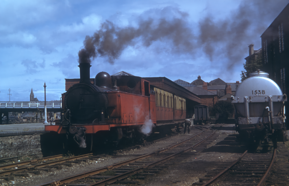

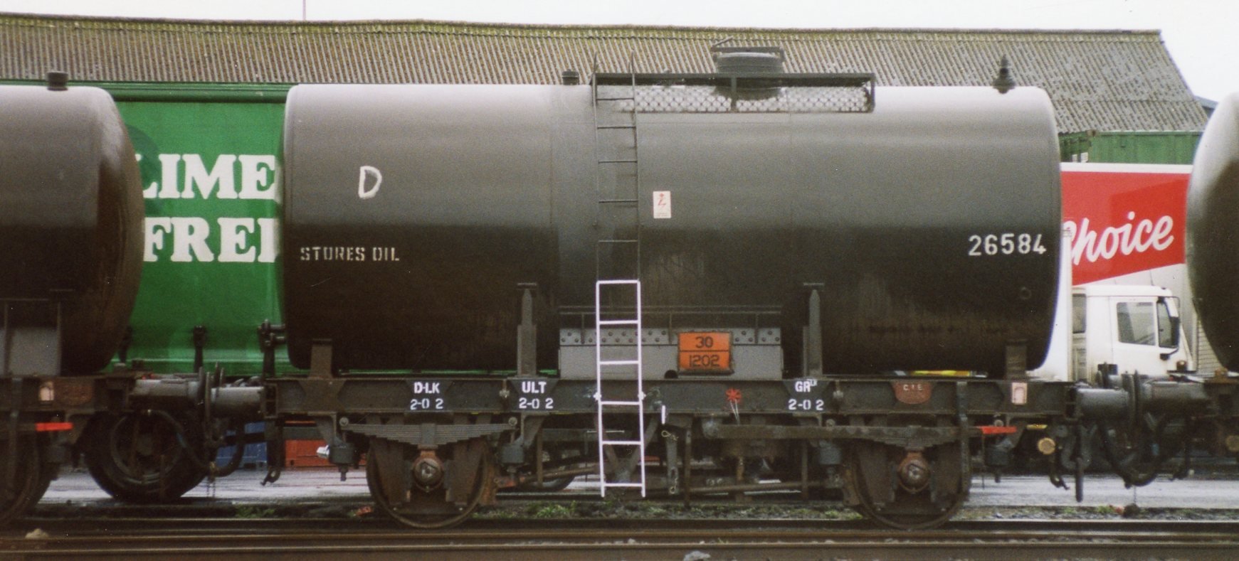

Joe Keegan Posted October 10, 2023 Posted October 10, 2023 15 minutes ago, warb said: Photo taken at Inchicore works ?
exciecoachbuilder Posted October 10, 2023 Posted October 10, 2023 3 hours ago, Joe Keegan said: Photo taken at Inchicore works ? Yep, at the side of the running shed in Inchicore works.
exciecoachbuilder Posted October 10, 2023 Posted October 10, 2023 15 minutes ago, exciecoachbuilder said: Yep, at the side of the running shed in Inchicore works. For the life of me, I can't remember what the ULT maintenance abbreviation stenciled onto the side of the chassis means? ( It was stenciled onto both carriages and wagons).But what I can see from the photo, January 1975 was the last time the wagon got its "ULT maintenance"?
RobertRoche Posted October 10, 2023 Posted October 10, 2023 4 hours ago, exciecoachbuilder said: For the life of me, I can't remember what the ULT maintenance abbreviation stenciled onto the side of the chassis means? ( It was stenciled onto both carriages and wagons).But what I can see from the photo, January 1975 was the last time the wagon got its "ULT maintenance"? I asked that question before and got the following answer: 1 1

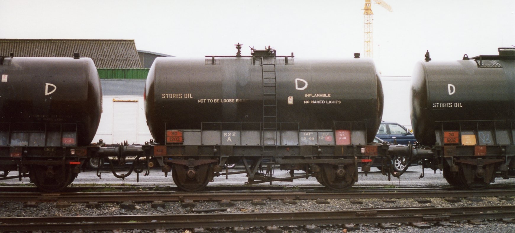

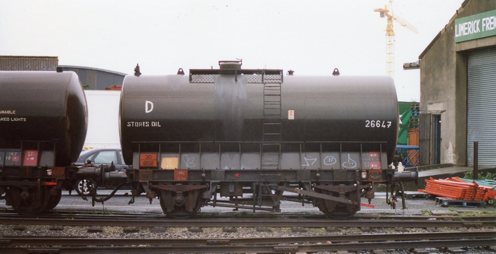

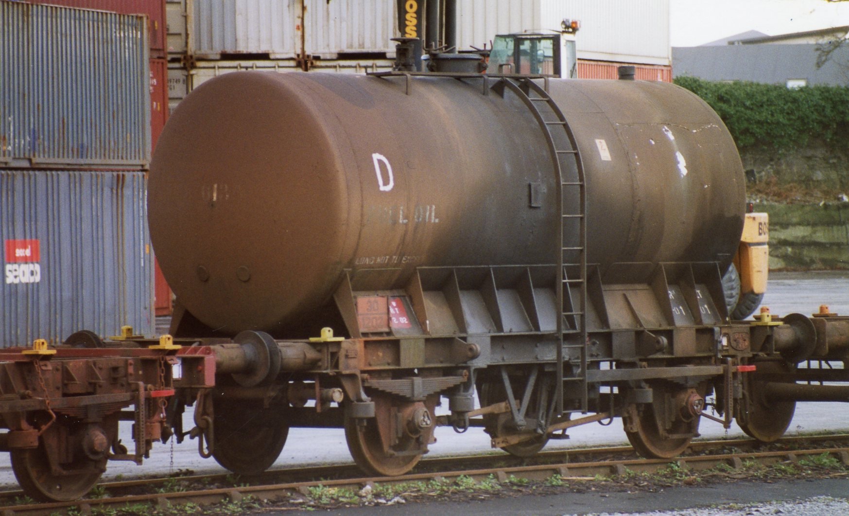

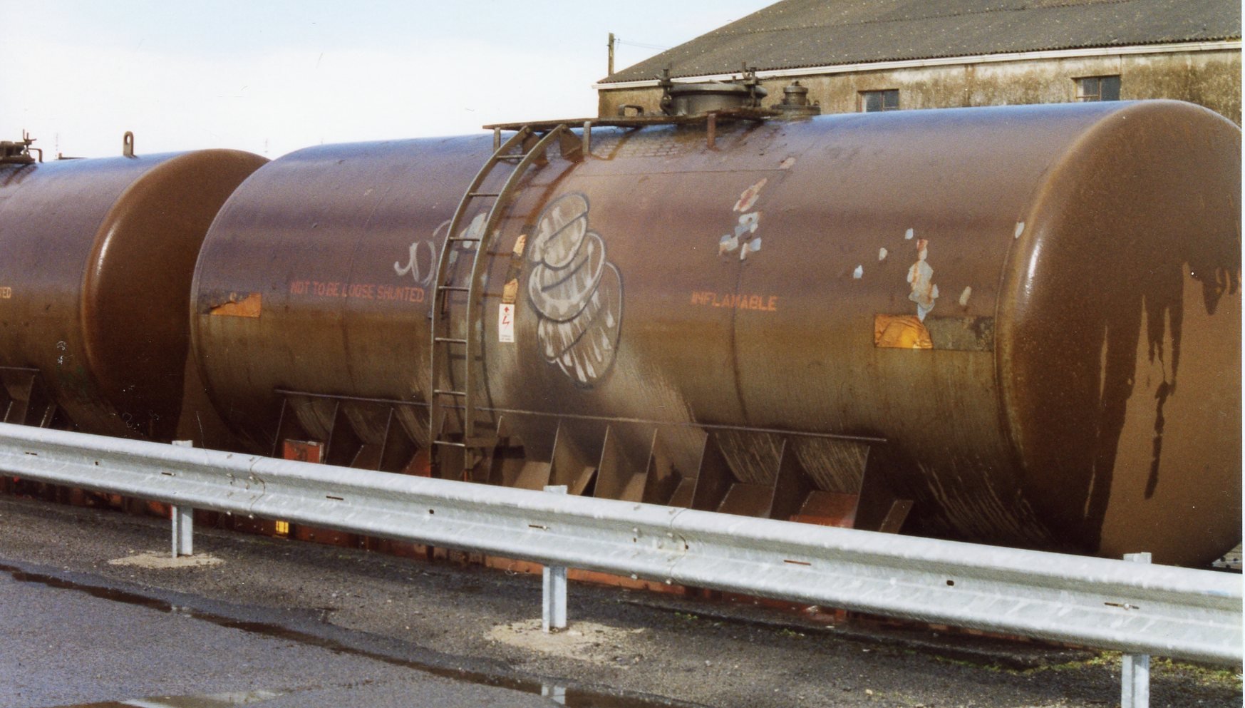

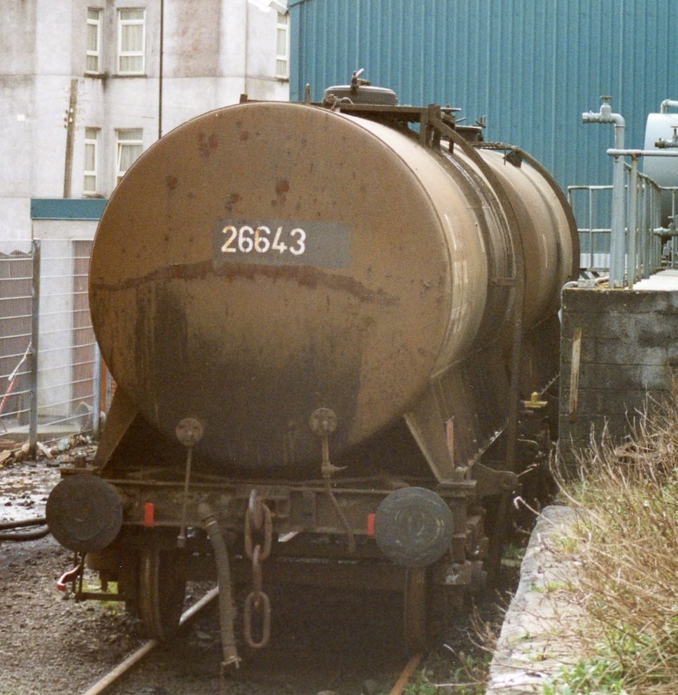

Railtank Posted December 10 Posted December 10 On 10/10/2023 at 3:23 PM, WRENNEIRE said: Is this tank now preserved somewhere? Spent many years at Colbert, very nice with its triple chambers. Seems to be the sole survivor of a mysterious fleet which are avoiding all my research attempts! 1

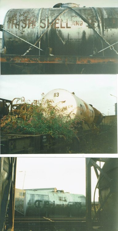

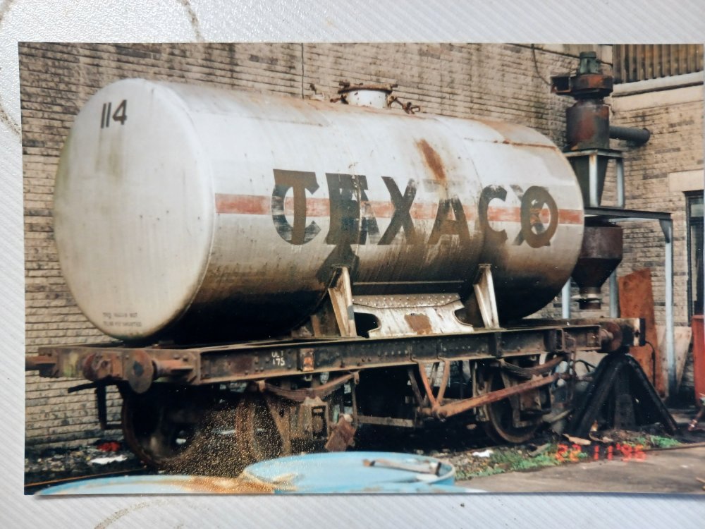

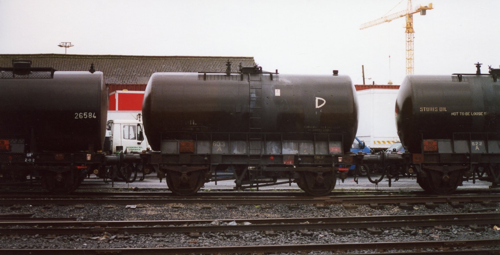

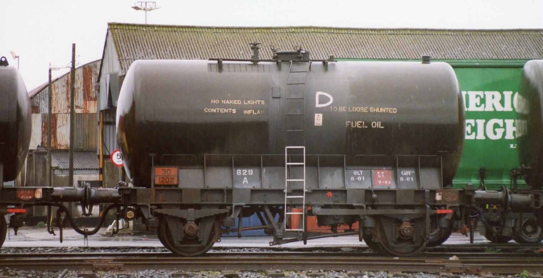

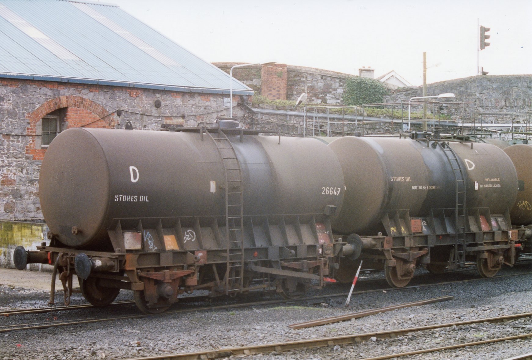

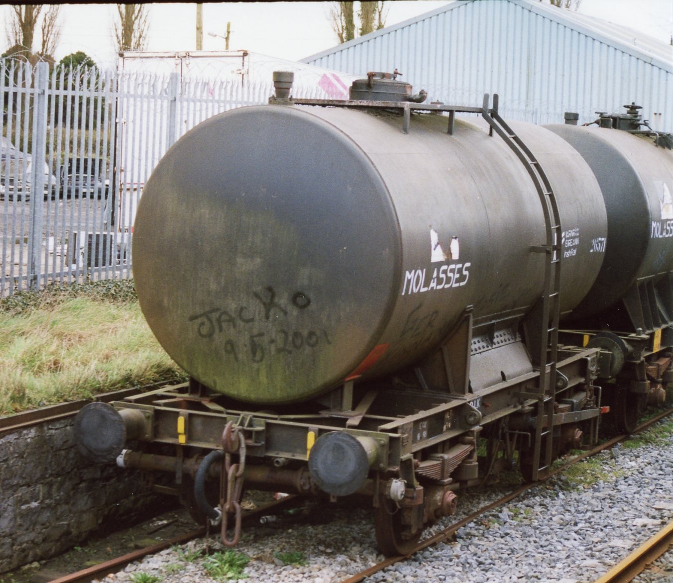

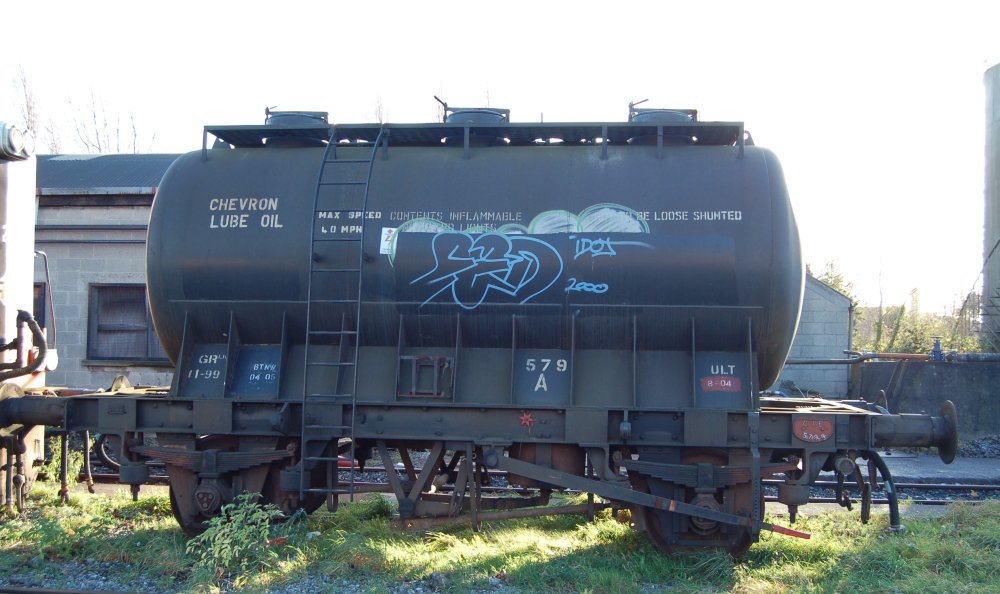

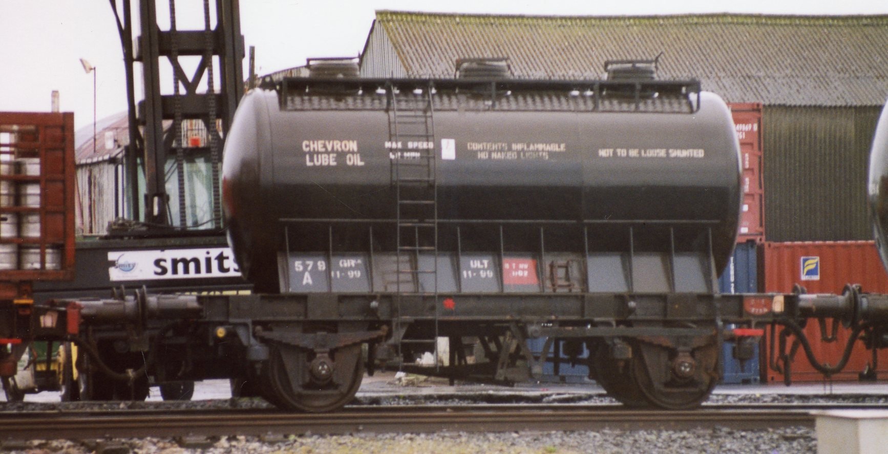

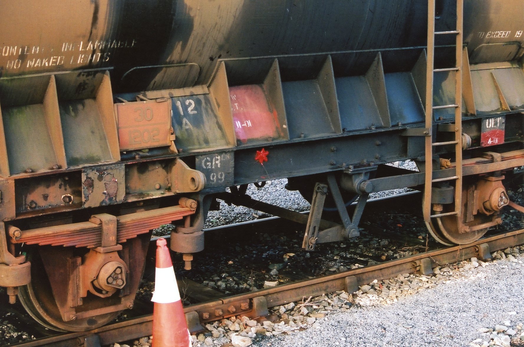

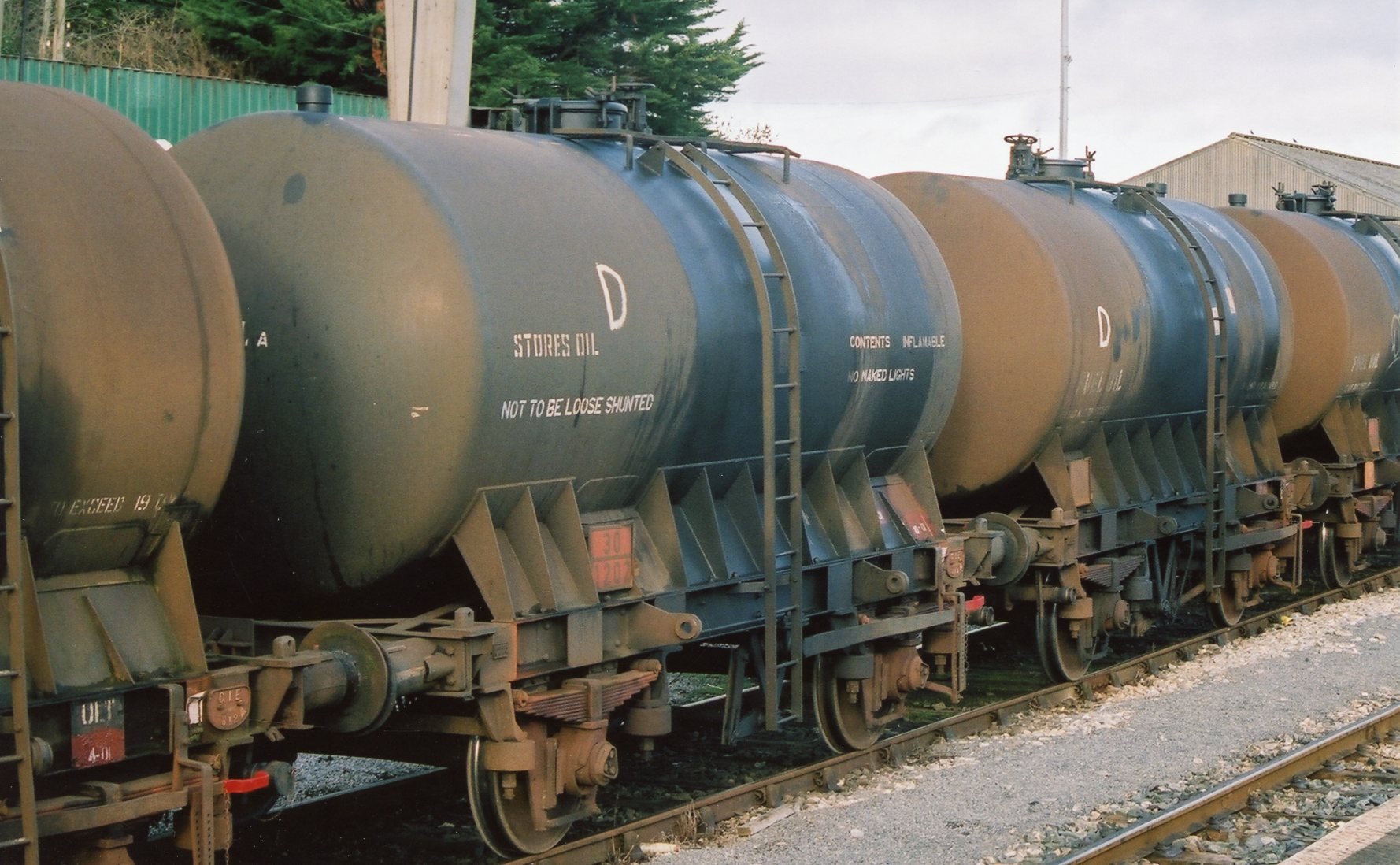

Mol_PMB Posted December 11 Posted December 11 23 hours ago, Railtank said: Is this tank now preserved somewhere? Spent many years at Colbert, very nice with its triple chambers. Seems to be the sole survivor of a mysterious fleet which are avoiding all my research attempts! I've no idea if it was preserved, or indeed still in use. I don't know if these photos are any use for your research attempts - one slightly blurred photo of the same vehicle, and several other tanks showing the variety used by IE around the year 2000. Hopefully something of use here. 1 1

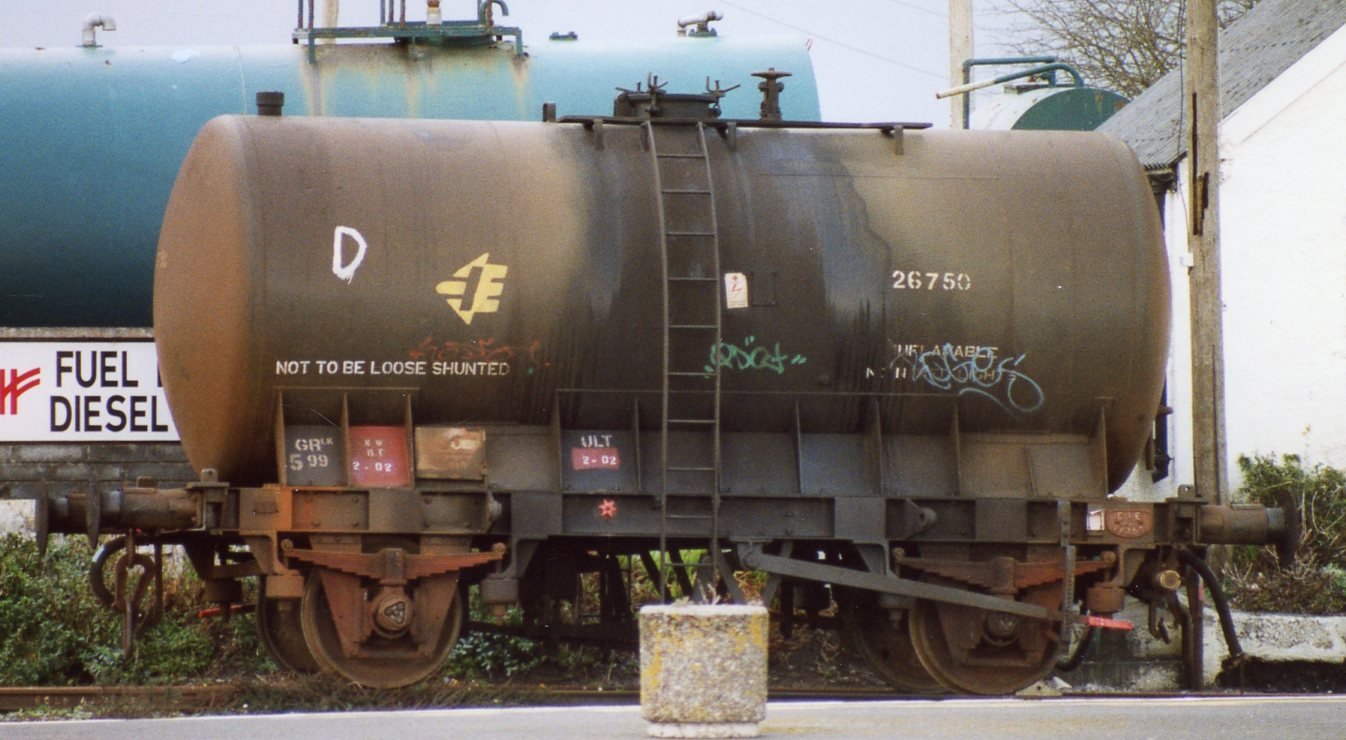

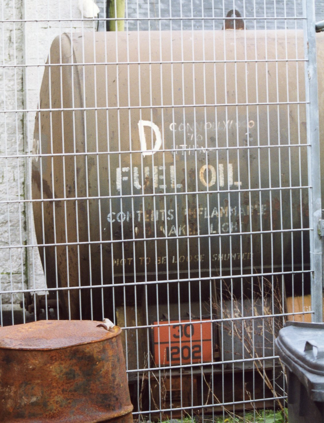

Westcorkrailway Posted December 11 Posted December 11 9 minutes ago, Mol_PMB said: I've no idea if it was preserved, 2 in maam cross 2 1
bufferstop Posted December 11 Posted December 11 On 10/12/2025 at 10:01 AM, Railtank said: Is this tank now preserved somewhere? Spent many years at Colbert, very nice with its triple chambers. Seems to be the sole survivor of a mysterious fleet which are avoiding all my research attempts! This is still In Limerick. It's been noted. 1 2
Railtank Posted December 11 Posted December 11 Excellent very worthy for preservation. Here we go again 9 hours ago, Mol_PMB said: I've no idea if it was preserved, or indeed still in use. I don't know if these photos are any use for your research attempts - one slightly blurred photo of the same vehicle, and several other tanks showing the variety used by IE around the year 2000. Hopefully something of use here. Superb pictures many thanks for sharing. I’ll drop you a PM if that’s ok ? 1
