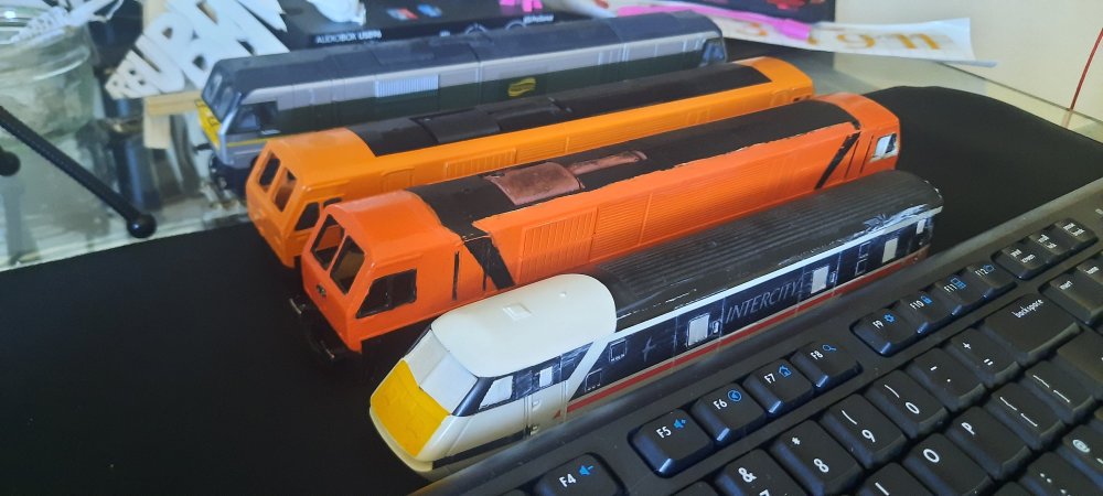

Recently purchased two second hand MIR resin class 201 locomotive bodyshells which are partly painted & i would like to get them painted sometime.
Is there a way that you would recommend to remove the paint without damaging the resin?

Got the Green Stuff World paint remover & put in a tub with the 201....
Seems to have worked well after 30mins or so, with assistance from a new battery toothbrush.
No damage to the resin from what i can tell.
Note to self, get bigger tub.
Have rinsed the paint remover off with water & will work on it on Wednesday as its going take a bit!
If you plan on doing this, ensure you've got a room with an extractor or an open window, such as a utility room or bathroom,  as the paint remover stinks! - and thats coming from a person with little to next to no sense of smell.
