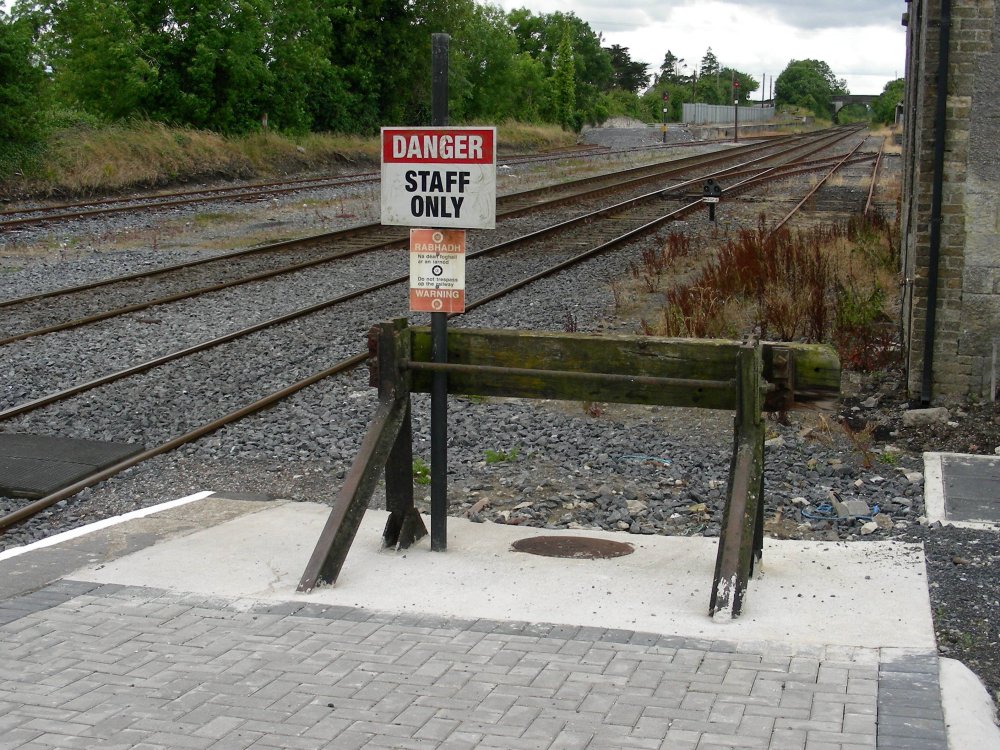

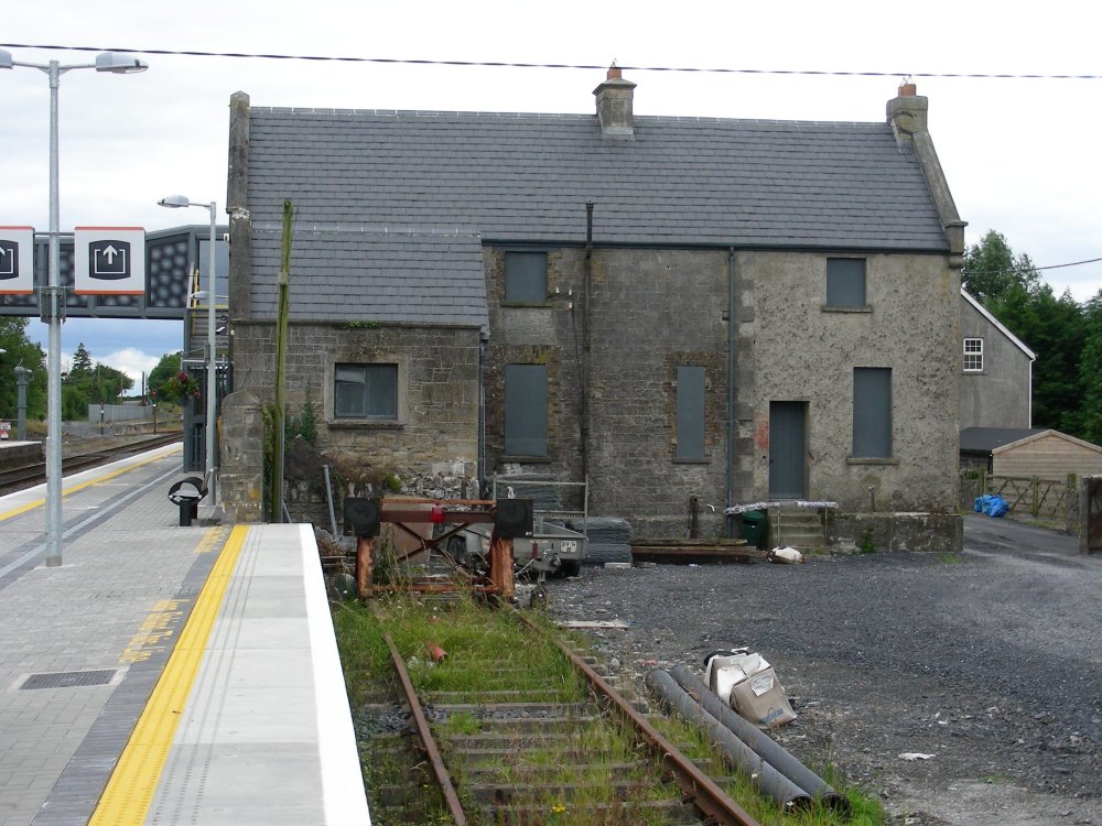

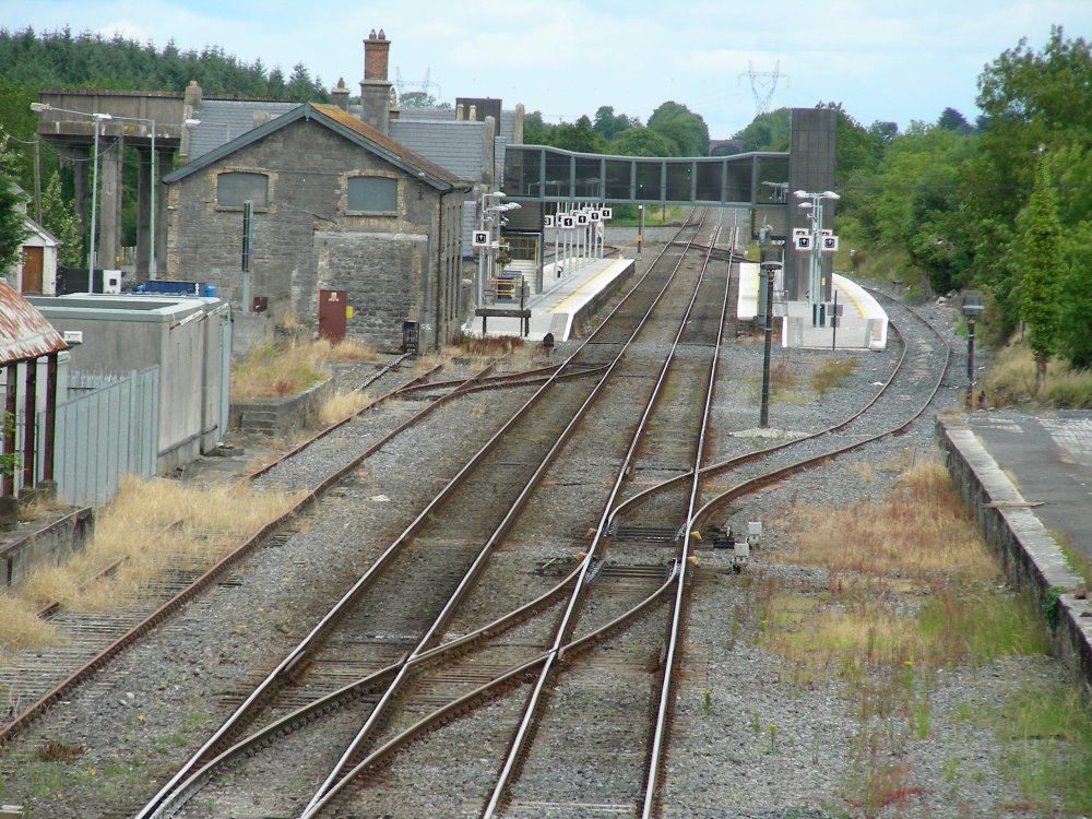

LNERW1 Posted December 6, 2024 Author Posted December 6, 2024 On a more serious note, would anyone have any good pictures of track that isn’t quite overgrown but has grass between the rails- somewhat like an unintentional equivalent of this: I think I’ve seen a picture of an IRRS special at a station with such track on@Irishswissernie’s Flickr page but I only thought today to look at doing something like it after looking at @Galteemore’s Rosses Point thread and seeing the brilliant ash (I think) ballasting. Even if it is my first layout I do want this to look good and I thought something like that, but a little less comprehensive, would look good for the layout. TIA. LNERW1 2 Quote

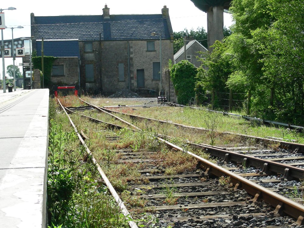

Broithe Posted December 6, 2024 Posted December 6, 2024 15 minutes ago, LNERW1 said: On a more serious note, would anyone have any good pictures of track that isn’t quite overgrown but has grass between the rails- somewhat like an unintentional equivalent of this: I think I’ve seen a picture of an IRRS special at a station with such track on@Irishswissernie’s Flickr page but I only thought today to look at doing something like it after looking at @Galteemore’s Rosses Point thread and seeing the brilliant ash (I think) ballasting. Even if it is my first layout I do want this to look good and I thought something like that, but a little less comprehensive, would look good for the layout. TIA. LNERW1 Ballybrophy in 2008..? Quote

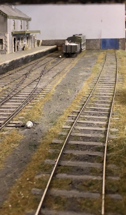

Galteemore Posted December 6, 2024 Posted December 6, 2024 Cheers W1. Looks like ash but it’s actually DAS clay. Google Chris Nevard and ash ballast to get technique. 3 Quote
LNERW1 Posted December 6, 2024 Author Posted December 6, 2024 (edited) 4 minutes ago, Broithe said: Ballybrophy in 2008..? Actually that’s a lot closer to what I’m going for than the picture I put up tbh, thanks a lot! 3 minutes ago, Galteemore said: Cheers W1. Looks like ash but it’s actually DAS clay. Google Chris Nevard and ash ballast to get technique. As much as I did say I wanted it to look good, I wouldn’t be confident making something that good with just DAS clay. Maybe in future. Thanks very much lads, very helpful contributions- and quick! Edited December 6, 2024 by LNERW1 1 1 Quote

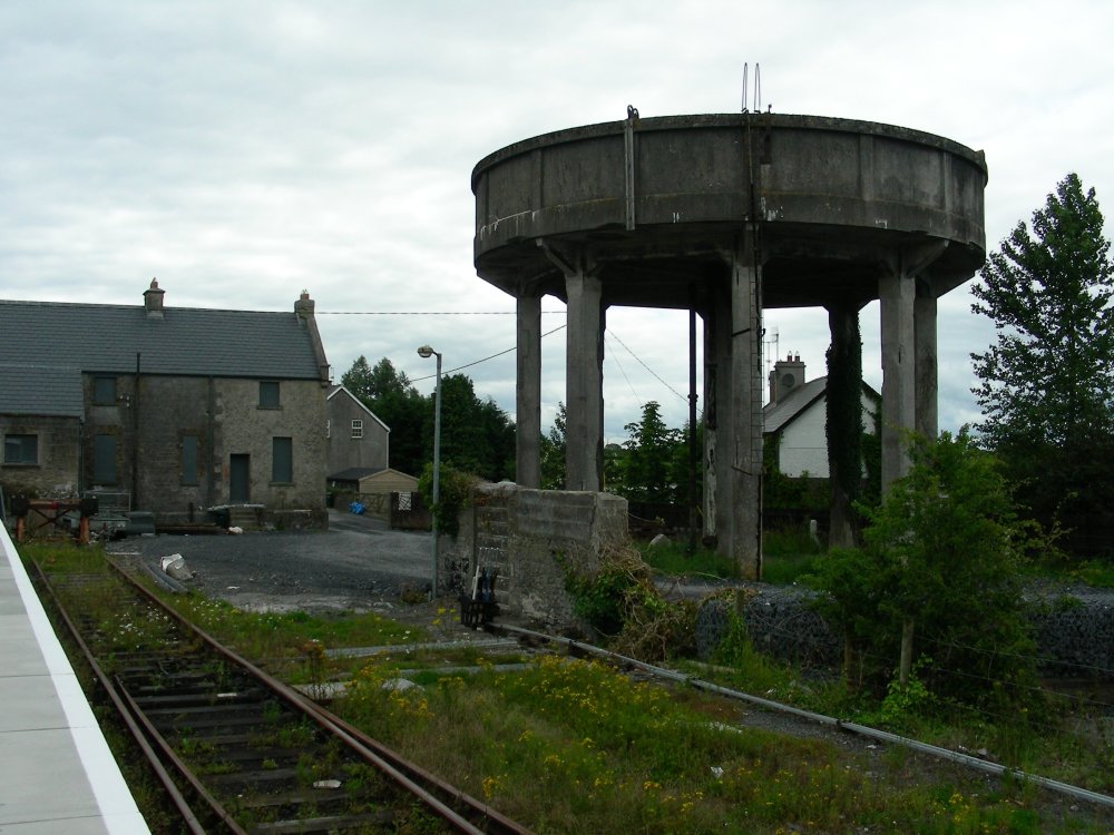

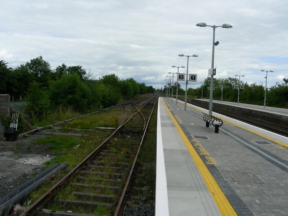

Broithe Posted December 6, 2024 Posted December 6, 2024 (edited) 1 hour ago, LNERW1 said: Actually that’s a lot closer to what I’m going for than the picture I put up tbh, thanks a lot! Ah, this is 2012. . And this is the old sidings, but the weedkiller got there first - 2008 Edited December 6, 2024 by Broithe 2 Quote

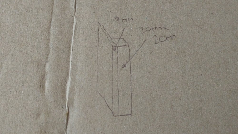

DJ Dangerous Posted December 7, 2024 Posted December 7, 2024 (edited) You could also run additional 20mm x 20mm beams (called batons?) along the baseboard, just inside where the 9mm side panels will run. The 20mm x 20mm would be strong enough to glue and screw in place, and you could then glue the 9mm to the baseboard, while also gluing and screwing it laterally to the 20mm x 20mm, giving strength, rigidity, and holding the "floppy" sides in place. A cheaper and easier way of salvaging your work, I'd say, rather than starting over, which you’re probably thinking about. Adding lateral bracing beams and painting with some sort of cheap primer will still be required. Rough diagram: Edited December 7, 2024 by DJ Dangerous Wasn’t finished typing! 1 1 Quote

LNERW1 Posted December 7, 2024 Author Posted December 7, 2024 17 hours ago, DJ Dangerous said: 9mm wide is probably too thin to put a screw into without splitting it. You'll need a good few 439mm cross-members. I put blocks at the corners to screw all three boards into, as 9mm is indeed to small to screw into without splitting. 2 Quote
DJ Dangerous Posted December 7, 2024 Posted December 7, 2024 4 hours ago, LNERW1 said: I put blocks at the corners to screw all three boards into, as 9mm is indeed to small to screw into without splitting. Well, I'd look at running batons the length of the board, too, as per previous post. Quote

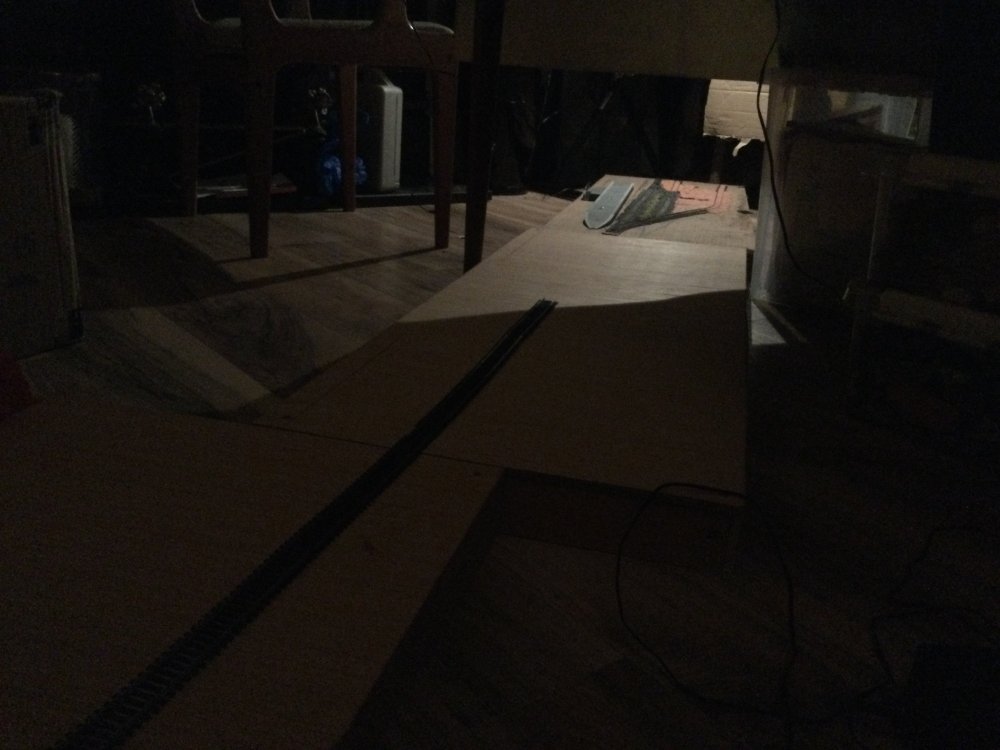

LNERW1 Posted December 10, 2024 Author Posted December 10, 2024 (edited) Loosely laying out a longer stretch of track so I can have a go at properly running Ardree Quay. A little trouble has been had with power tracks and clips- all a temporary arrangement so no soldering- but otherwise no real problems. I need to have a look at buying some track so I can get cracking with the fiddle yard but I’m quite hopeful I’ll get some proper work done by Christmas. Happy modelling, LNERW1. PS sorry for the shite photo, phone was dead so had to use an iPad with no camera flash, in the room with the worst lighting in the house. Edited December 10, 2024 by LNERW1 1 Quote
