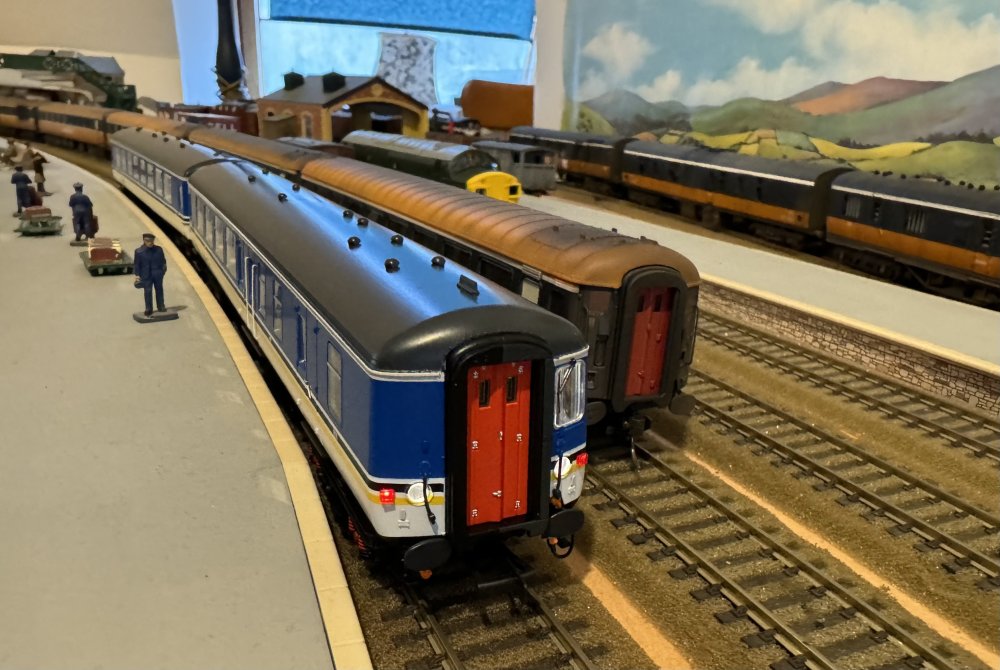

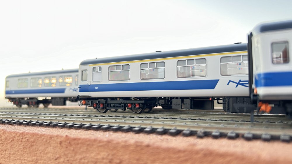

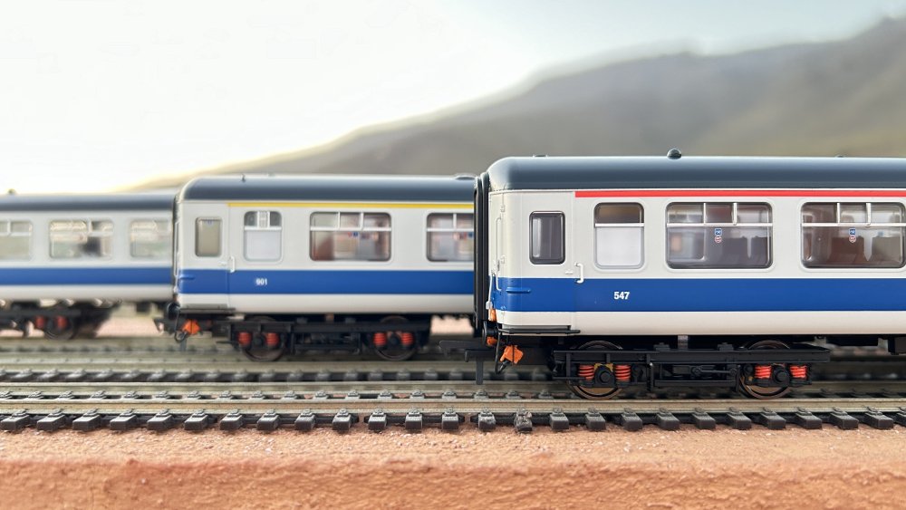

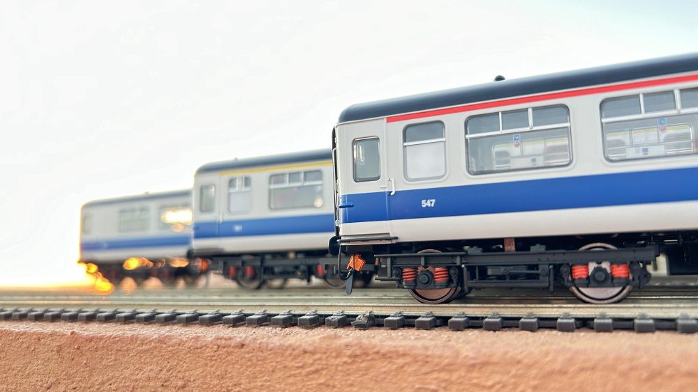

Seriously impressed with these coaches. Magnificent, not my era or region, but they ran in Ireland so had to get a rake. Stunning models. Took them for a test run yesterday, the DVT because it needs a decoder to run on DCC or it buzzes. Support helped me understand their guidance. Will have to put passenger inside and do a little mild weathering. Time travel on the main layout yesterday. Detail is sublime.

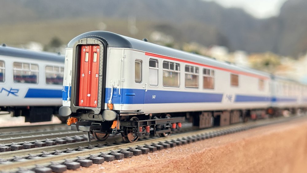

The NIR mk2 DVT needs a decoder if placed on DCC track (ie to get rid of the short and buzzing noise). So fitted a Lenz decoder to the driving trailer yesterday. Easy to get the body off following the instructions. To safely remove the blanking plate and insert the 21pin decoder in I removed the roof level PCB (easy 2 screws). Then popped it on the test track to give the decoder address 916. Body cable easily unplugs from the PCB. Easy Peasy. Magic wand works to turn the main coach interior lights on and off but not the front end of the coach since decoder fitted. I can't figure out which functions switch the other lights on or off other than the usual F0 for the running lights which alternate between white and red based on direction chosen. Very nicely engineered model. It would have been nice if the interior lights worked out of the box on DCC track without opening up the body to fit a decoder. The interior lights in other coaches and my other two sets work fine on DCC track out of the box using just the magic wand.  Will have fun with these when I've completed the respray of IR 085 into NIR 112 livery. Happy days.

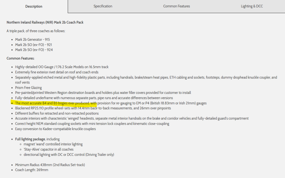

Branching off from that question, let's say somebody bought a pack of NIR coaches, doesn't bother requesting the correct bogies for them, then sells them on.
Will the subsequent buyer be entitled to free replacement bogies, or have to buy them?
Has anybody tried retrofitting the new IRM bogies onto a Murphy Models Mk2D coach?
And has anybody tried swapping out the narrow gauge British bogies on the IRM NIR coaches for the Irish gauge ones?

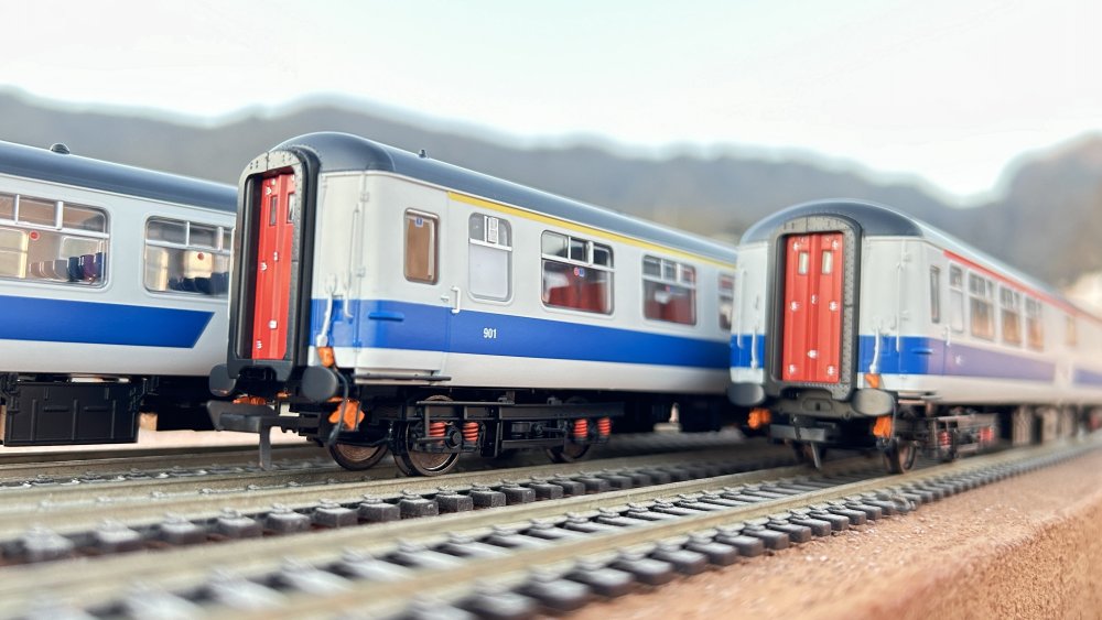

Dual-posting here in both of the current IRM NIR Mk2BC threads, so apologies in advance for that, but it's the only way to get around the thread-duplication right now.
My replacement Irish gauge bogies arrived with @murphaph last week.
@Garfield was incredibly fast at getting them shipped, like, I think they shipped within a day of us speaking to confirm the quantity.
Long story, but my coaches had to ship to @murphaph rather than me, so it made sense to send the bogies there - plus nobody knows how the dreaded pencil pushers in Madrid would react to a zero-value shipment, dun dun duuuuunnnnn!

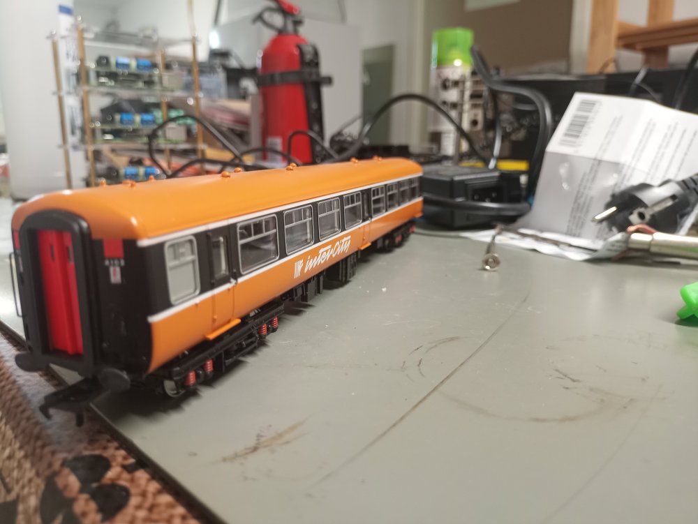

While fitting the bogies to the coaches for me, @murphaph sat one of the older Bachmann coaches on top of two, just for fun.
Note, these aren't fitted to the coach, they're just sitting loosely underneath, but give an idea as to how the coaches would look when retro-fitted.
The Irish gauge bogies are available to buy from IRM at €20 per pair for retro-fitting, here:
https://irishrailwaymodels.com/collections/accessories/products/53-b4-bogie-pack-black
Have to say, they look absolutely savage sitting under that coach!
