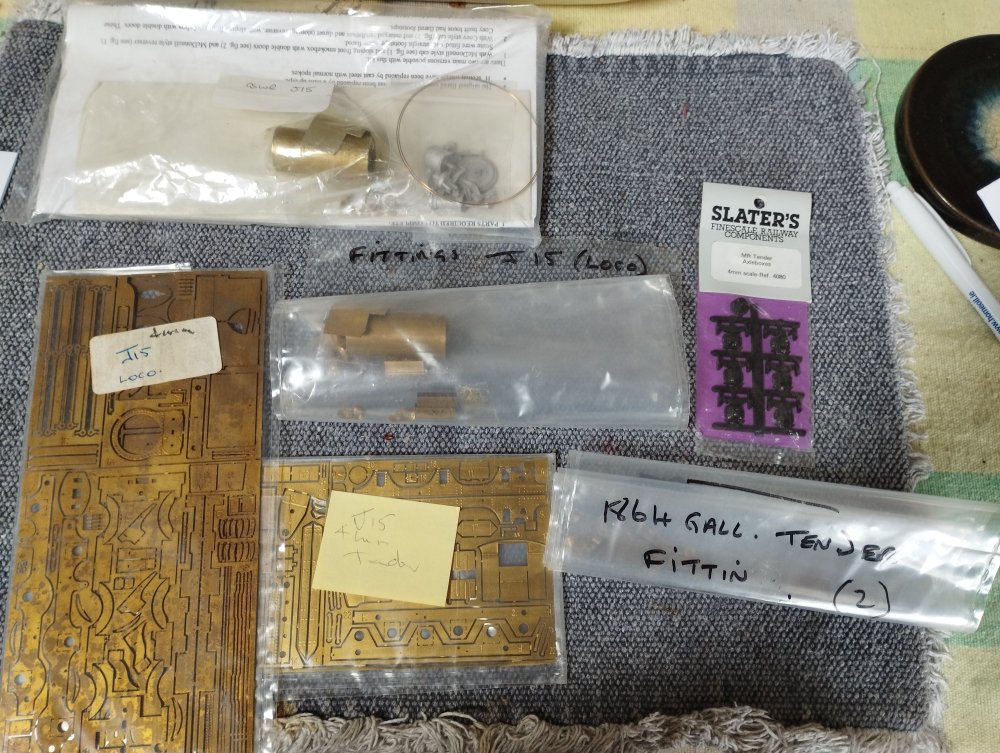

Gabhal Luimnigh Posted Thursday at 16:26 Author Share Posted Thursday at 16:26 Well just because I know a man! This bundle of tricks arrived in the post today, I'm delighted but I have no intention of opening any of the packets yet, I will get a nice little wagon or coach to assemble first, plenty time for practice. 7 2 Quote Link to comment Share on other sites More sharing options...

Horsetan Posted Friday at 10:38 Share Posted Friday at 10:38 18 hours ago, Gabhal Luimnigh said: Well just because I know a man! This bundle of tricks arrived in the post today, I'm delighted but I have no intention of opening any of the packets yet, I will get a nice little wagon or coach to assemble first, plenty time for practice. Two boilers? Will you be squeezing two J15s out of that lot? 2 Quote Link to comment Share on other sites More sharing options...
Gabhal Luimnigh Posted Friday at 11:02 Author Share Posted Friday at 11:02 22 minutes ago, Horsetan said: Two boilers? Will you be squeezing two J15s out of that lot? I seem to have the most of two locos but if I can get one made eventually then I'll be happy 1 Quote Link to comment Share on other sites More sharing options...
Broithe Posted Friday at 11:25 Share Posted Friday at 11:25 45 minutes ago, Horsetan said: Two boilers? Will you be squeezing two J15s out of that lot? It's for the Lartigue option. 3 Quote Link to comment Share on other sites More sharing options...

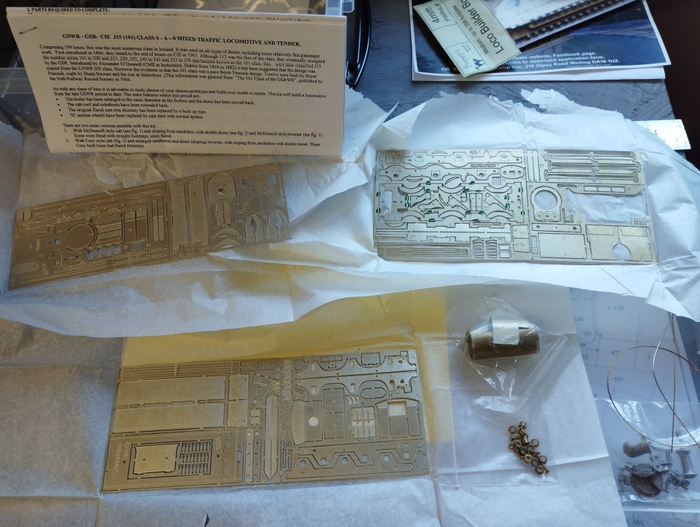

Mayner Posted Friday at 11:56 Share Posted Friday at 11:56 19 hours ago, Gabhal Luimnigh said: Well just because I know a man! This bundle of tricks arrived in the post today, I'm delighted but I have no intention of opening any of the packets yet, I will get a nice little wagon or coach to assemble first, plenty time for practice. Possibly two kits the original 1985 TMD and Studio Scale Models (Paul Greene) versions. I have built both the TMD and SSM versions of the J15 Kit durin the past 30 years. The original TMD kit was etched brass, with square section frame spacers , brass tube boiler, turned brass chimney and dome and Slaters tender axleguards and springs. The SSM version was in etched nickel silver, boiler rolled from brass sheet, whitemetal castings including boiler fittings, smokebox door, tender axleguards and springs. What's in the unopened bag between the castings, pre-formed boiler-firebox and instructions? Reminds me of the time about 20 years ago I bought what I thought were 6 part and unbuilt TMD kits at a UK exhibition and found that I had actually acquired 7 kits. 1 Quote Link to comment Share on other sites More sharing options...
Horsetan Posted Friday at 12:25 Share Posted Friday at 12:25 25 minutes ago, Mayner said: Possibly two kits the original 1985 TMD and Studio Scale Models (Paul Greene) versions. I have built both the TMD and SSM versions of the J15 Kit durin the past 30 years. Quite funny how there's two generations of the same kit. Same thing with the J26 / E tank. There are two versions of the chassis - original brass, and later n/s - and some chassis parts from one cannot fit the other, due to the wheelbases coming out slightly different. 1 Quote Link to comment Share on other sites More sharing options...
Gabhal Luimnigh Posted Friday at 12:58 Author Share Posted Friday at 12:58 1 hour ago, Mayner said: Possibly two kits the original 1985 TMD and Studio Scale Models (Paul Greene) versions. I have built both the TMD and SSM versions of the J15 Kit durin the past 30 years. The original TMD kit was etched brass, with square section frame spacers , brass tube boiler, turned brass chimney and dome and Slaters tender axleguards and springs. The SSM version was in etched nickel silver, boiler rolled from brass sheet, whitemetal castings including boiler fittings, smokebox door, tender axleguards and springs. What's in the unopened bag between the castings, pre-formed boiler-firebox and instructions? Reminds me of the time about 20 years ago I bought what I thought were 6 part and unbuilt TMD kits at a UK exhibition and found that I had actually acquired 7 kits. I haven't opened the bag yet but I will Quote Link to comment Share on other sites More sharing options...
Gabhal Luimnigh Posted Friday at 16:37 Author Share Posted Friday at 16:37 4 hours ago, Mayner said: Possibly two kits the original 1985 TMD and Studio Scale Models (Paul Greene) versions. I have built both the TMD and SSM versions of the J15 Kit durin the past 30 years. The original TMD kit was etched brass, with square section frame spacers , brass tube boiler, turned brass chimney and dome and Slaters tender axleguards and springs. The SSM version was in etched nickel silver, boiler rolled from brass sheet, whitemetal castings including boiler fittings, smokebox door, tender axleguards and springs. What's in the unopened bag between the castings, pre-formed boiler-firebox and instructions? Reminds me of the time about 20 years ago I bought what I thought were 6 part and unbuilt TMD kits at a UK exhibition and found that I had actually acquired 7 kits. Bag opened John, it's TDM 2 Quote Link to comment Share on other sites More sharing options...
Horsetan Posted Friday at 17:40 Share Posted Friday at 17:40 1 hour ago, Gabhal Luimnigh said: Bag opened John, it's TDM The light makes it look nickel-silver, and the instructions look like the later ones. SSM rather than TMD? Quote Link to comment Share on other sites More sharing options...
