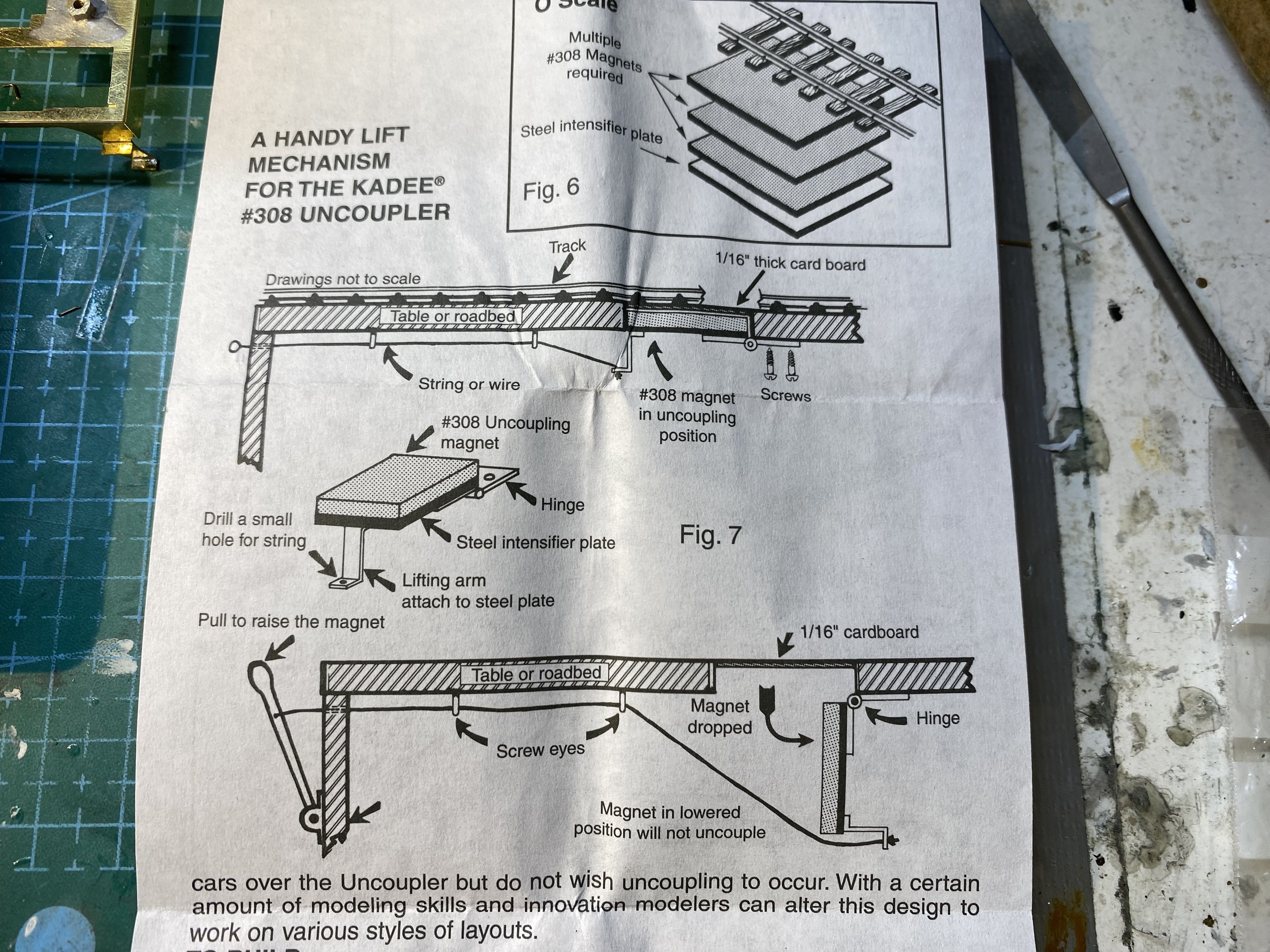

Maybe having fixed magnet positions isn't the solution. How about a magnet mounted on a handheld spade-type device that you slip under the couplings only when you need it?
Kadee actually include this Heath Robinson contrivance in the instruction sheet for their under track magnets

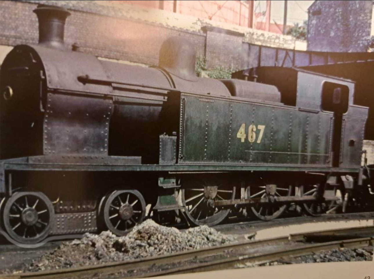

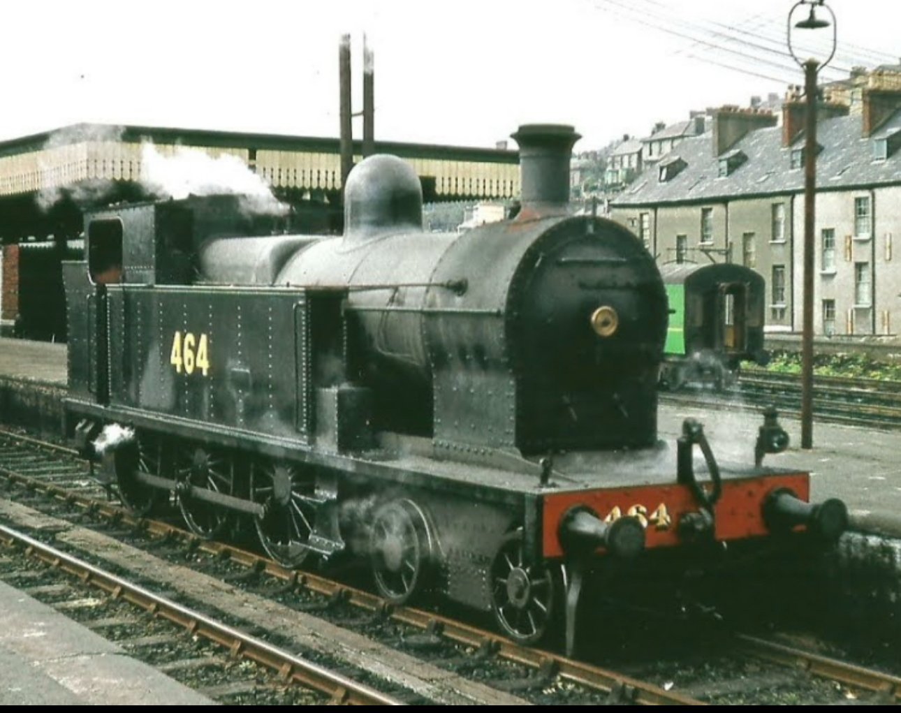

Same with the famous 1961 West Cork tour with a spotless “Bandon Tank” No. 464.
Convential wisdom (and my opinion for a long time) was that it was black.
However, I’ve seen two photos of it that day and shortly after, which certainly appear to show it as dark grey. So I’m unsure; I would certainly not take it as definite that it was repainted in black, but it could have been.
it must be remembered that cleaning was done with oily rags. Dust and dirt stick to oil, so polishing if a very dark grey could very easily look black, especially in the colour emulsions used in camera films almost seventy years ago.
I will always paint 464 Satin Black as that’s how it looked, and Infairness it fooled pretty much everybody into believing it was black that day. So eyewitness accounts and photos would say so
However Upton closer inspection, it probobly was Grey underneath all that. Problem is though. Is it more accurate to paint it the colour it was underneath the dirt or the livery it actually presented itself in. Usually I’m not a weathering guy but in the case of Late CIE steam is it just as inaccurate to turn these locos out in Grey as is black?
some IRRS views. The 17/03/1961. Under the spring sun from some angles, you can see grey

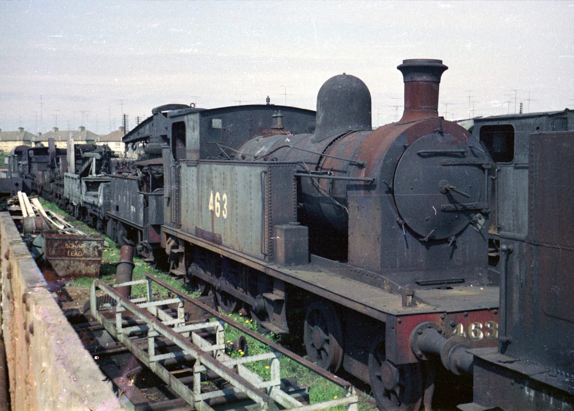

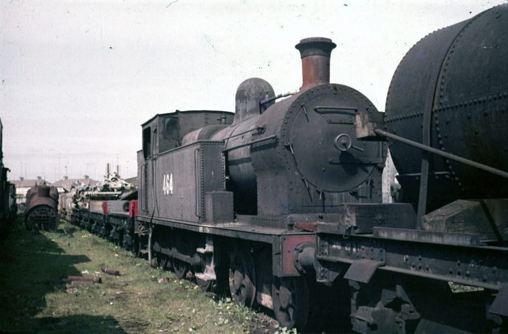

464 was also involved in another IRRS special later that year. Again the extreme sun reveals an interesting shade
https://flic.kr/p/2psSoBp
It’s seen here about 1962. Boiler looks more grey!
It sat around in inchicore for about 3 years post withdrawal. By which stage the dirt seems to have been removed by the elements . 463 which was grey and has weathered to the same colour proved the theory.
However. Im still looking for the holy grail. As at least 1, possibly 2 Bandon tanks were painted Green in Dublin. I’ve yet to see a photo that shows this livery aside from this very weathered look at 467 at Albert quay in the 1950sIMG_4146.thumb.jpeg.f5b7a6efbe95e9a0d6ff05301282f121.jpeg
