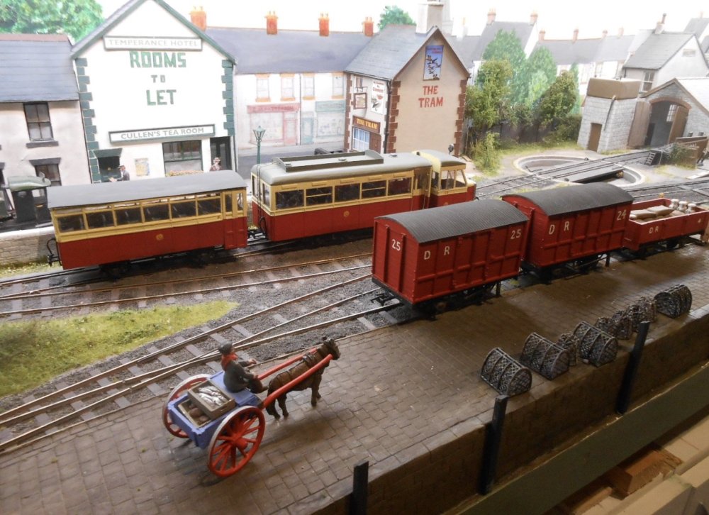

David Holman Posted December 22, 2024 Author Posted December 22, 2024 (edited) Having cleared the scenics on the front edge of the baseboard, a thin layer of DAS was applied and then once dry, the laborious process of scribing in all the stones began. Decided to use small setts for the road surfaces [including the tramway section leading off scene under the new warehouse bridge. It turned out to be not as tedious as I'd thought: scribing straight lines for one axis and then doing the individual setts by hand, including rounding the edges and ensuring there was a decent amount of mortar space between each one. I was a bit concerned about the painting, because photos often show a wide range of colours and I really didn't fancy having to pick out individual setts with a small brush... Began with a wash of a fairly light stone colour, using acrylics, then, once dry went over this with a wash of dark grey, which toned down the top colour and went nicely into the mortar lines. Then remembered my [many] crayons - pastels, various pencil ones and, in particular, a set of much prized Berol Karismas. These are water colour pencils and can be blended nicely with each other. So, using various shades from yellow to brown, it was a much simpler matter to touch in various setts with these, rather than using a paint brush. Further titivation is needed, but am quite pleased with the effect thus far, as shown below. Only this corner has made significant progress, but have also scribed in the larger stone blocks on the quayside itself, which now await painting. Meanwhile, couldn't resist doing a few trial scenes with the initial corner. I've added a few weeds along the base of the warehouse and posed the lorry and donkey cart for effect too. The main action on this section will be either Phoenix transferring wagons to/from the off scene goods yard and tramway traffic, so there are also a few posed shots of this too. Edited December 22, 2024 by David Holman 15 2
Tullygrainey Posted December 22, 2024 Posted December 22, 2024 Beautiful. The colours of the square setts are spot on 1 1 1
GSR 800 Posted December 22, 2024 Posted December 22, 2024 David this is absolutely fabulous. Phoenix coming out between the buildings is a wonderful shot on a brilliant layout. 1

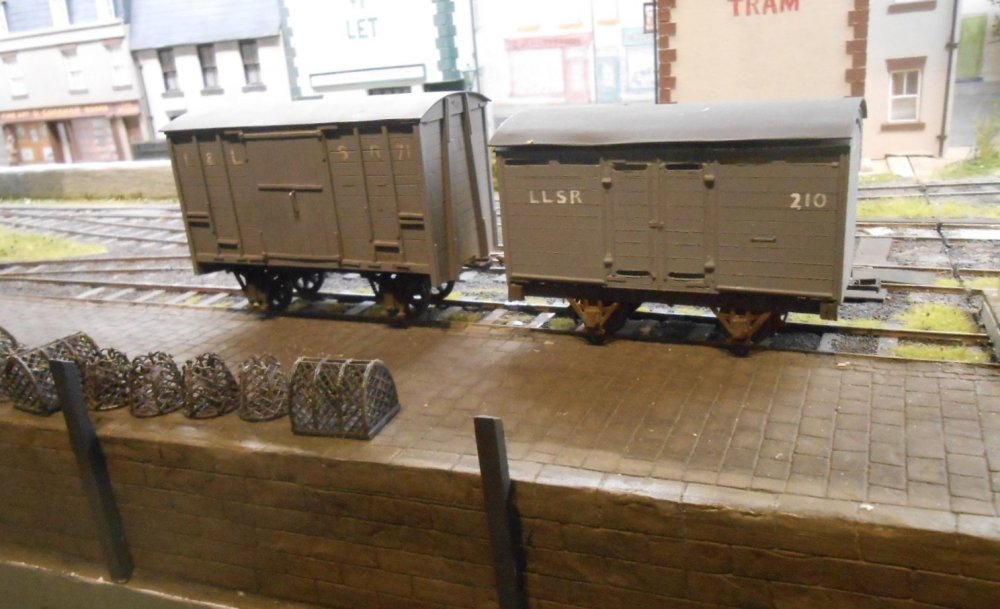

David Holman Posted December 29, 2024 Author Posted December 29, 2024 The structural work for the quayside is now largely complete, though much titivation and detailing is still required and orders are going in for some fish boxes [Langley] and some rather nice 3D printed lobster/crab pots I've found on the web. Maybe a couple of figures and some luggage too, while fencing along the back of the tram platform is also needed. The latter has been made from basswood, scored to represent planking, while more basswood strip has been used to make the large posts protecting the quay wall. Am tempted by the Langley fishing boat, though this would need a baseboard extension to sit on and at nearly £150 ain't cheap, so this is in the maybe file at the moment. Over Christmas, had to content myself with drawing out some coaches and a wagon on to plastic sheet. We were away at my mother's and it was suggested that taking the soldering iron, solvents etc might not be a good idea. Can't think why... Anyway, at least now have some basic 'kits' that can be made up when the Muse takes me: two Schull & Skibbereen 4 wheel tram coaches, a Swilly Brake 3rd, also a bogie fish van, plus one of the Donegal red wagons. The latter has already been made up and awaits painting. 14 1

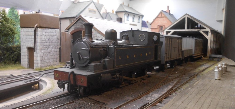

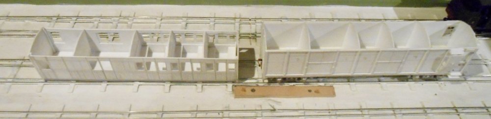

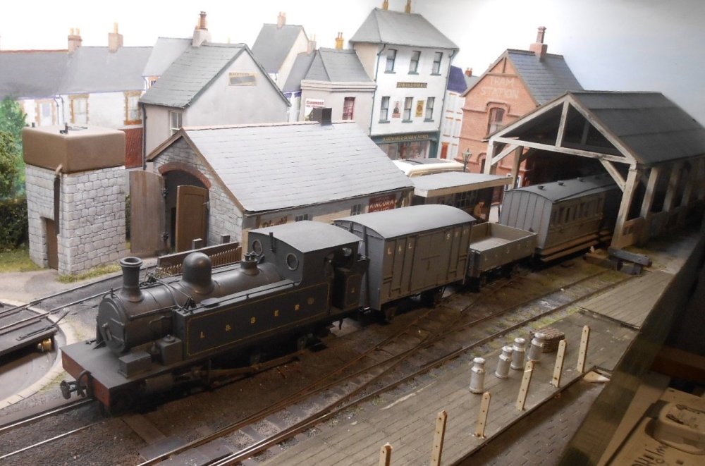

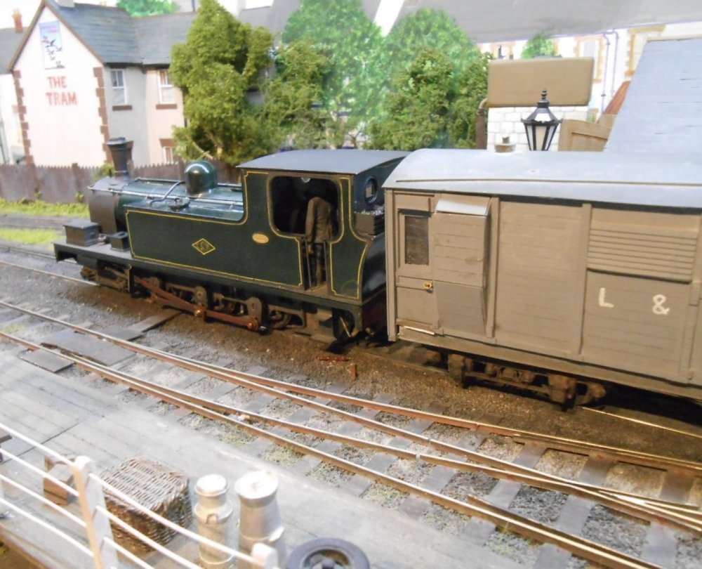

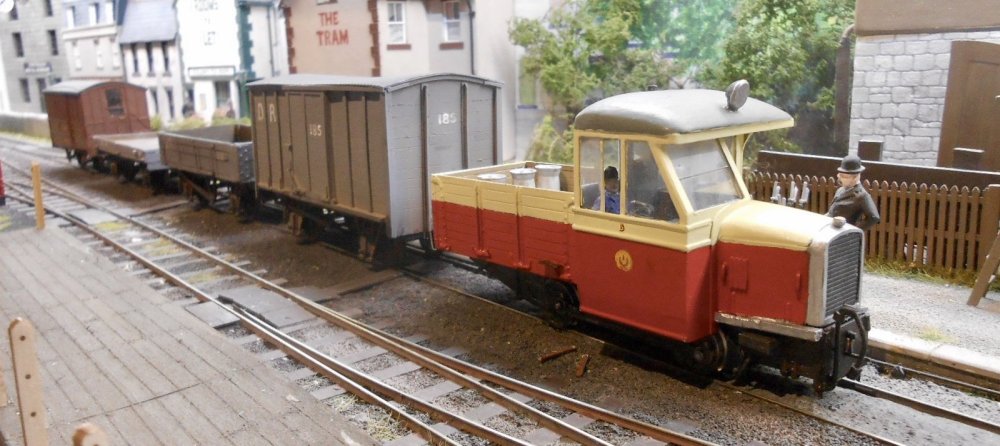

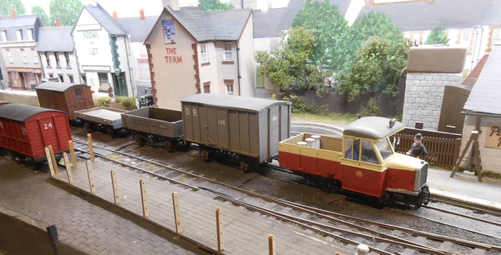

David Holman Posted January 24 Author Posted January 24 Have at last equipped all my new stock with couplings, so thought a few photos might be of interest. Whenever I build a layout, I usually have a very specific idea of the trains I want to depict and run and Swillybegs is no exception. For The Londonderry & Lough Swilly, there are two trains. Firstly a Barclay 4-6-0T and a short mixed train. It is made of two/three wagons and a brake third coach for the guard & occasional passengers. There are a couple of 'spare' wagons [one of which is a former CVR butter van] which are exchanged as part of the shunting moves. The second Swilly train is yet to be built, though have made a start on a bogie fish van & another brake third, which will be pulled by a Kerr Stuart 4-6-2T. Swilly traffic would not be complete without a bus service and this Corgi Class lurks outside the station, waiting to be relettered. For the Donegal, it is all internal combustion, starting with Railcar 10 [ex CVR] and a trailer. A second railcar [No 7 or 8] will have three 'red wagons' to play with. Freight will be handle by the ex CVR 'Unit', with Phoenix doing the shunting, to and from the off scene goods yard. Trains are just 'posed' at the moment. One of my next jobs is to get things up and running again, so I can properly test those new couplings. When that will be I have no idea. One of the joys of layout building is that you can go where the Muse takes you! 14 2
Mol_PMB Posted January 24 Posted January 24 Very nice indeed! Superb rolling stock and layout atmosphere. 1 1
Galteemore Posted January 25 Posted January 25 Looks absolutely fabulous. I was a little troubled at the start of this project at the thought that we would never see the little CVR tanks again. But the transformation into Swillybegs has actually included them and introduced a whole new cast of characters. Really exciting to see it developing. 1 2

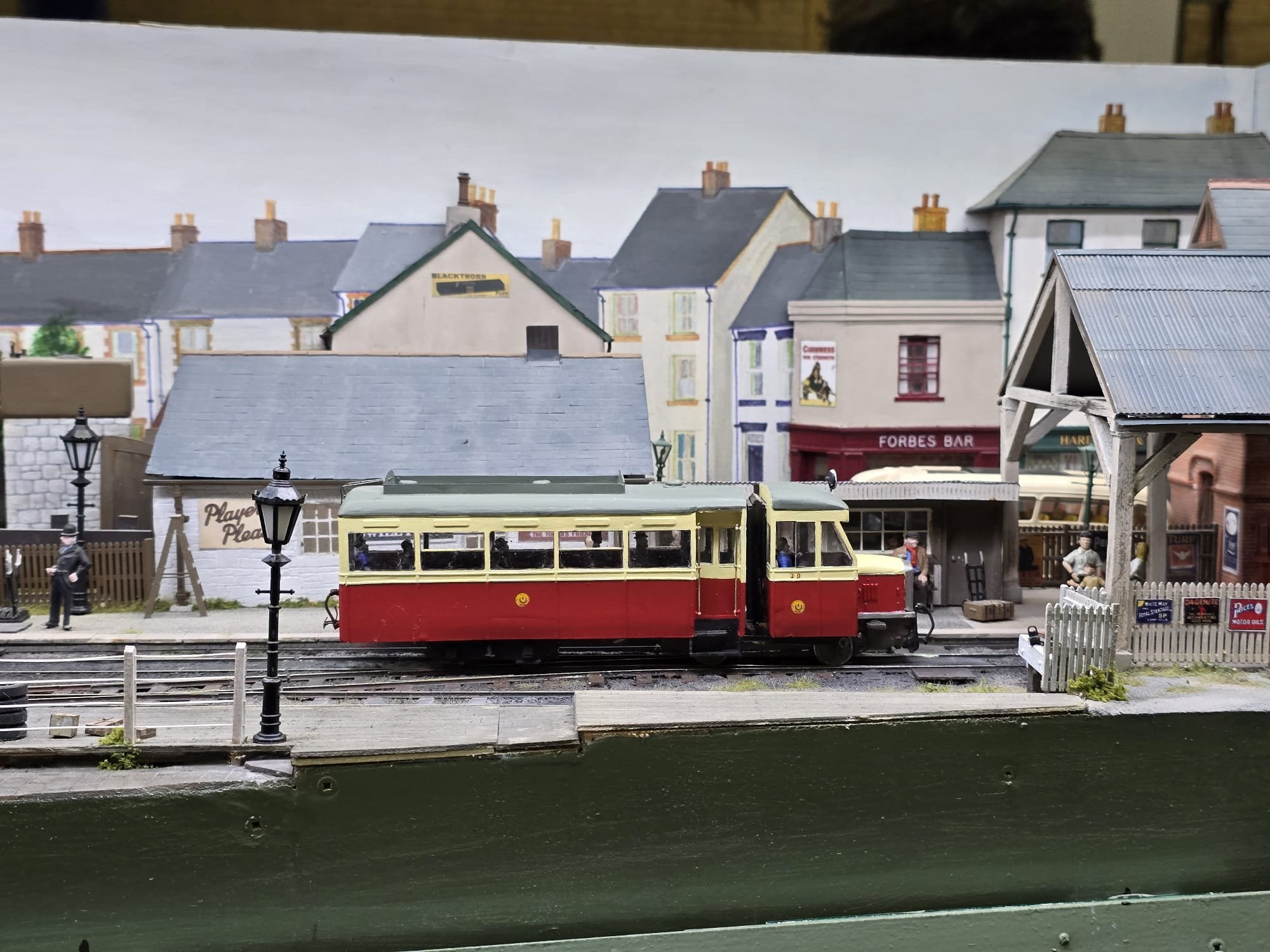

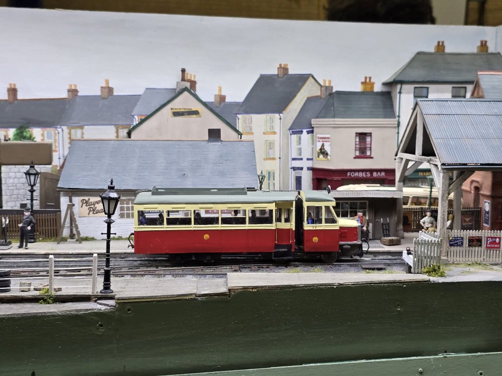

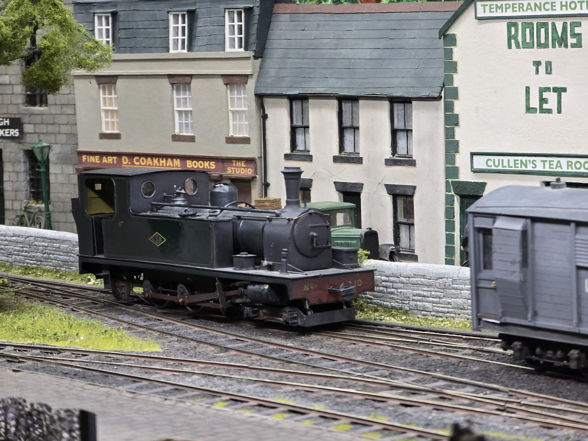

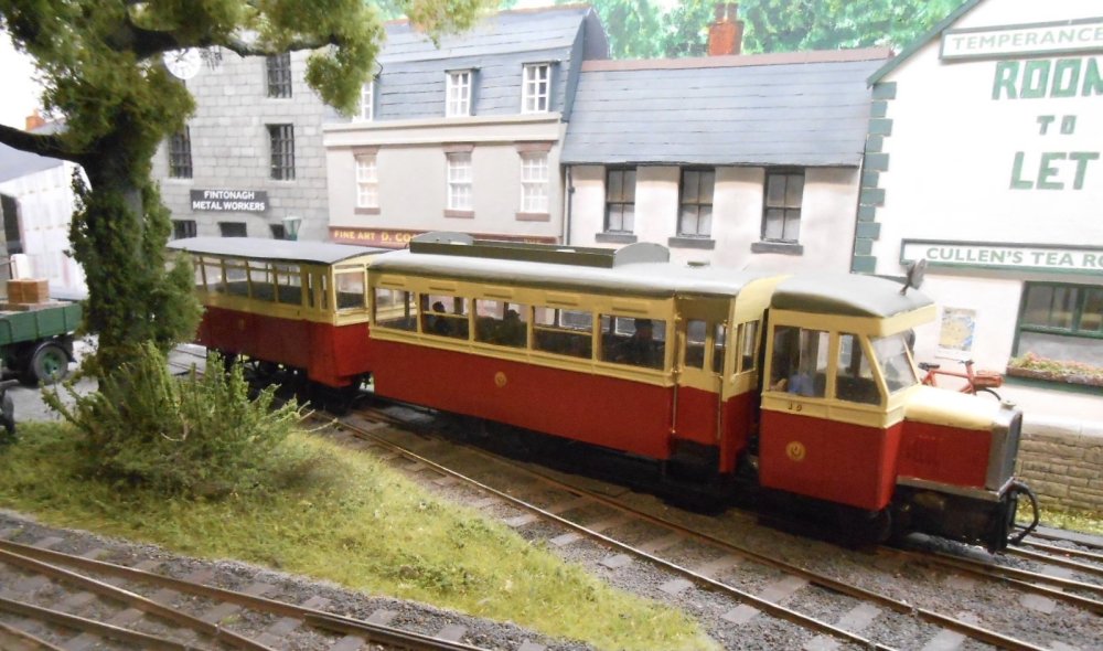

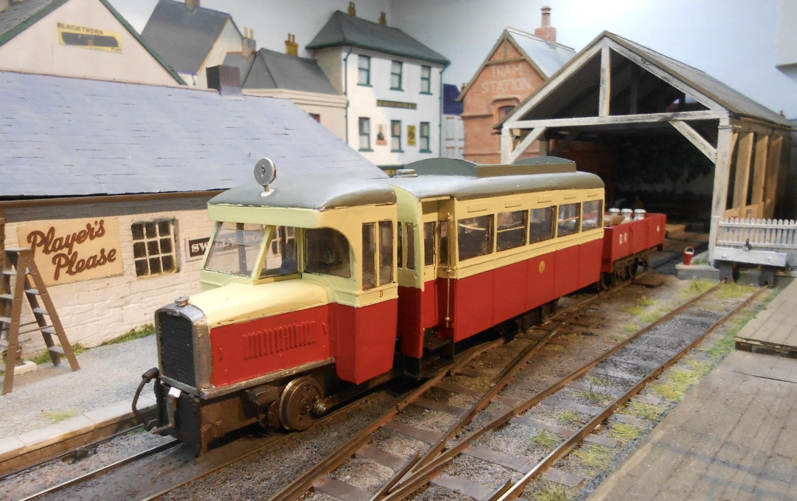

David Holman Posted November 2 Author Posted November 2 With Swillybegs rehearsals proceeding a pace, thought it time to review the stock and trains that make up the 'new' layout. Fintonagh's last show was over three years ago, so perhaps not surprising that some of the locos needed a bit of attention. Railcar 10 - seemed decidedly sticky and had needed a new [High Level] motor gearbox after its Mashima failed. However, a general clean up and adjustment of pick ups soon had it running smoothly again and it copes well with its new trailer. The Unit - leads the goods train. One wagon shorter than Fintonagh as the new Donegal wagons are longer and bigger that the Clogher ones. Phoenix - has two shunting jobs, the first sorting out the goods, while the Unit rests on the turntable. Phoenix arrives with a single wagon from the front siding, pushes this up to the brake van of the goods and then moves both of them to the train shed. It then runs round and collects a wagon from the front of the out going train, before retiring off scene. In this way Donegal wagons are rotated on successive moves. After turning, the Unit returns to its train, ready for departure. West Donegal Tram - my repurposing of the Clogher Valley 0-4-2Ts. One works the tram, while the other acts as a spare loco, though both are decent runners. The tram comprises three 4 wheel coaches based on Schull & Skibbereen ones. It runs into the front tram platform. After the loco runs round and is turned, it returns whence it came. The Swilly trains The two new locos have caused me a fair amount of grief, but at long last I think I might be getting there. Both have what appeared to be free running chassis, but both stubbornly refused to run well on the track. Thought I'd solved the Barclay 4-6-0Ts problems when I found that two of the outside cranks had worked loose, destroying the quartering in the process. So, the motion was once again dismantled and Loctite 635 used to [hopefully] secure everything. Again. However, running was still erratic and likewise the Kerr Stuart 4-6-2T. The latter is currently running as a 4-6-0T after I removed the rear pony because it kept derailing. This improved things, but still not enough. Salvation came when I realised that both locos were actually not balanced and had too much weight at the cab end, despite both having their tanks packed with lead. Removing the bodies [yet again] and putting heavy brass weights on each end of the chassis suddenly made running much smoother. So, adding a fair bit of weight inside both boilers has made for well balanced locos which now run well. Sigh... Swilly Fish - the 4-6-2T heads this. Just a bogie brake third and a bogie fish van. A simple move: train arrives, loco runs round, turns on the 'table and departs. Swilly Mixed - this move is more involved and suggests that, with their Joint line to Swillybegs, the Donegal and Lough Swilly are co-operating a bit more. The Barclay 4-6-0T arrives with its brake third and two vans, then retires to the turntable. Phoenix now does the shunting, bringing in a new van and removing one from the incoming train. These vans are a mixture of Swilly and Donegal, with the shunting moves similar to the ones on the goods. So, there we are & hopefully ready for Tolworth next weekend. Wish me luck! 12 5
Mol_PMB Posted November 2 Posted November 2 They all look amazing, and it sounds like the fettling you’ve done should ensure smooth running. Good luck! 1 1

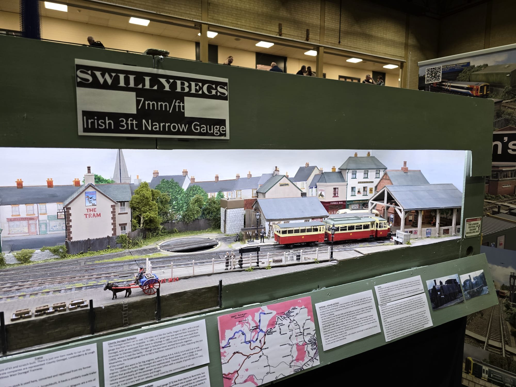

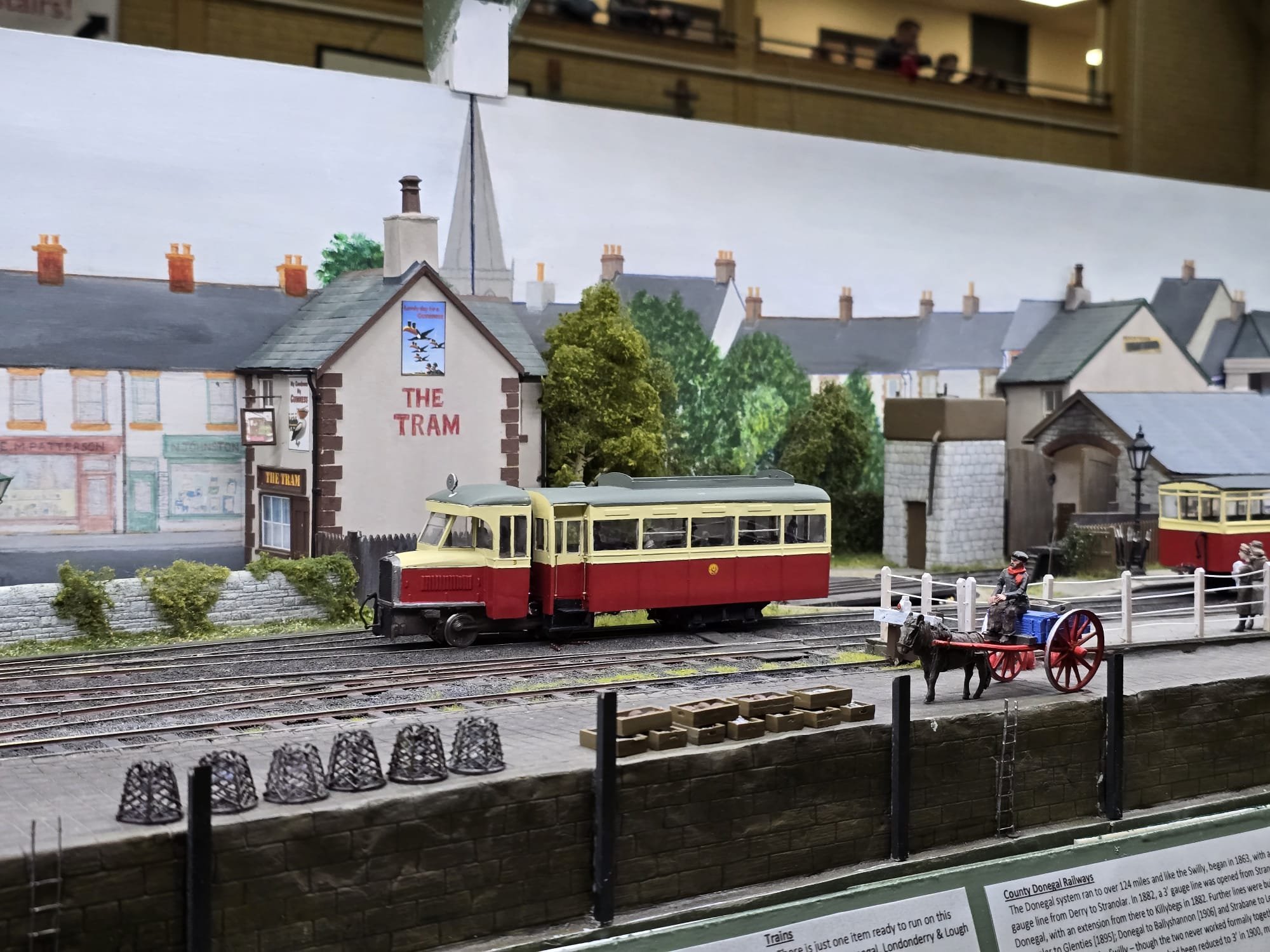

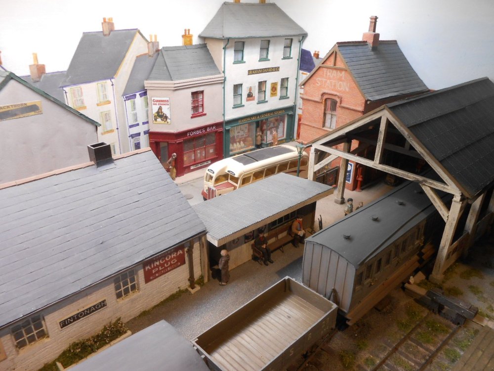

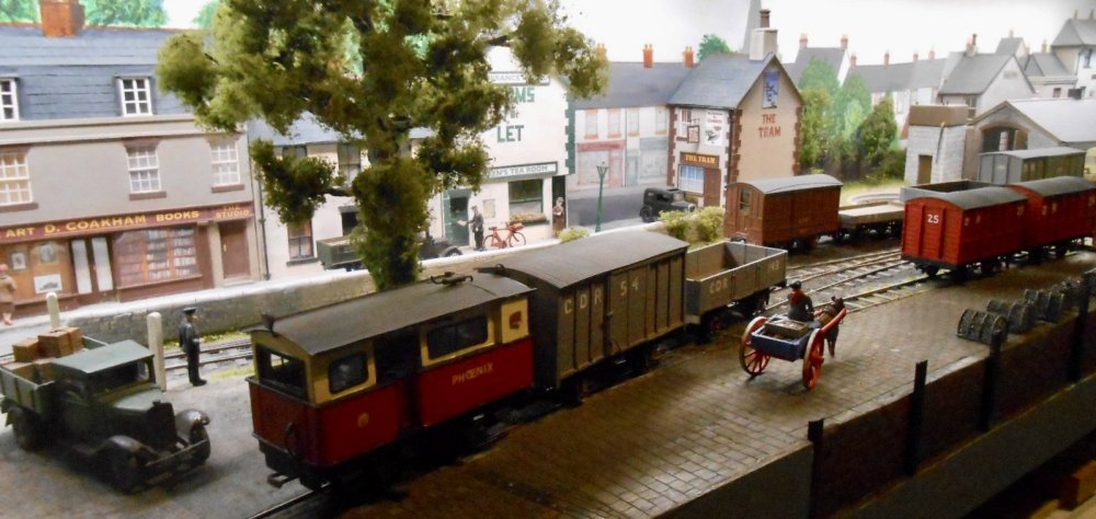

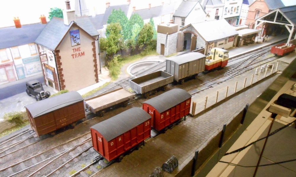

Mol_PMB Posted November 10 Posted November 10 One of my friends was at the Tolworth show and sent me these photos of his favourite layout there… One of the things that strikes me from these pics is how well the town backdrop works, from a range of different viewing angles. The perspective and merging the 3D into the 2D seems very natural. I expect a lot of thought went into that, and the result is excellent. 8 4
David Holman Posted November 10 Author Posted November 10 Thankyou kind sir! And you are right about the composition - one of my better efforts, with much down to John Ahern's 'Model Building Construction' which must be over 70 years old now. That said, rules about perspective don't change... Tolworth was a useful learning experience. Not 100% good by any means, but one that helped me with a range of issues which only come up with two days of intense operating in the public glare. Given it is over three years since the layout was last exhibited, it stood up very well. The two scenic boards are only 6" shorter than NPQ's but it is amazing how much extra space that allows in the car, while it has always been an easy layout to transport, set up & so on. The main issues were with stock, much of which hadn't turned a wheel in all that time - apart from practicing at home of course. The former Clogher Valley stuff was generally ok, though looks like Phoenix needs new pick ups. However, the two Swilly locos continued to have teething problems - this time with the front bogies, though after some more fettling on Sunday morning, they worked well for the rest of the day. The other area was with the DG couplings, where a few more adjustments are needed, hence the request in the Information thread on the Forum, but they are certainly worth persevering with. 4
leslie10646 Posted November 10 Posted November 10 Grovelling apologies for not turning up at Tolworth: Reading to Kingston seemed a county too many (or something). It DOES look magnificent and I compliment you on the "housing" and excellent lighting - can we have a photo taken towards the Sun to see how you have illuminated the scene, which is obviously on a very nice day in Summer!
David Holman Posted November 10 Author Posted November 10 LEDs, Leslie. One strip just inside the helmet and another centrally. Northport Quay has the same. 1 1
leslie10646 Posted November 10 Posted November 10 It certainly works, David. The "other" David used these on the two scenaria which I now own and it's equally effective there. I can see the Portadown Jct fluorescent tubes disappearing ......... But first, there's an engine shed to illuminate the "David" way! Sorry not to have put up photos of my latest acquisition, but I'm busy trying to sell the boxes of books which surround it. More on that shortly. 2
