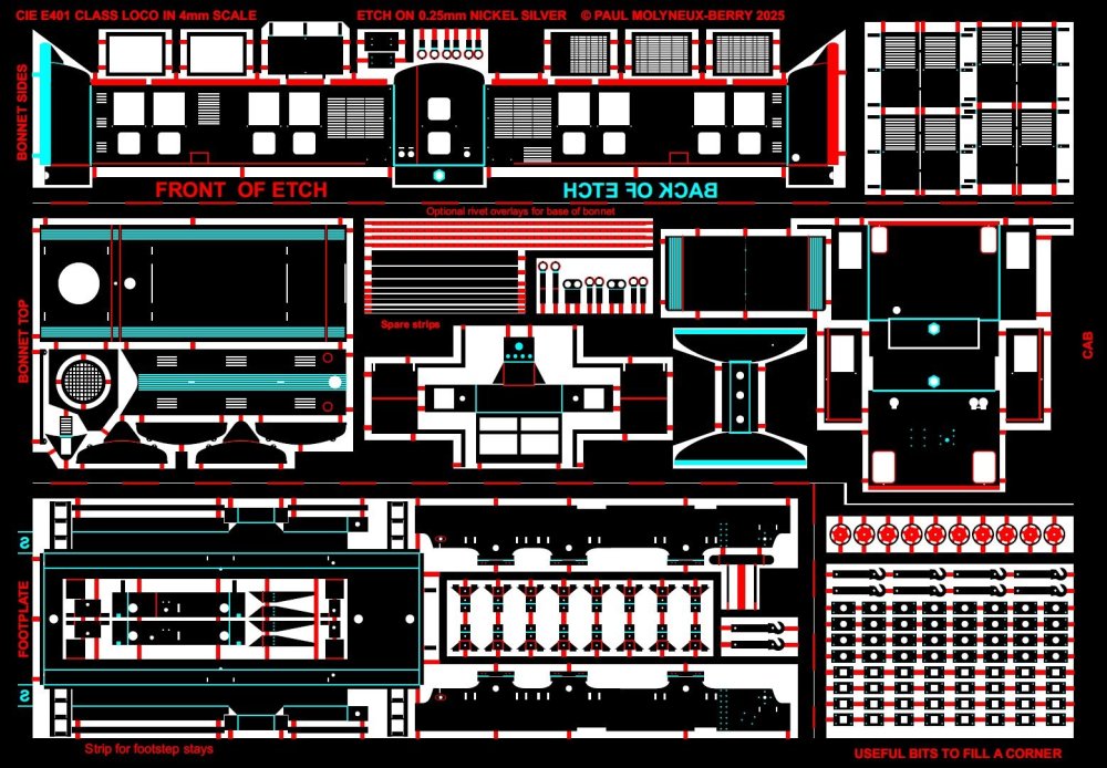

Mol_PMB Posted January 27 Posted January 27 You may have seen over on my other thread that I’ve been designing an etched ‘kit’ for an E401 class shunter in 4mm scale. I’ll document the build in this dedicated thread so that it’s self-contained and easier to find in future. I've chosen this prototype partly because I like them and there is no kit option presently available and partly because, with none surviving, I suspect they will be a less appealing prototype for IRM to make. They're not the prettiest locos either, but as the largest class of 5'3" gauge shunters in Ireland they played an important part in railway history. I've based my artwork on this official drawing, which is fairly well dimensioned and having checked them all it seems to be drawn to scale. I've also reviewed over 100 photos to work out the details not shown on the drawing, and where necessary I've scaled dimensions off the photos. So I can't claim perfection but the main dimensions are correct and we'll see in the test build whether it looks 'right'. I have designed this model for myself, it’s not intended as a commercial venture. However, I could also make the etches available to others who would like to build one. This thread could also act as a set of instructions and will give forum members an idea of what’s involved in the construction. I could also consider a 7mm scale version - I've already had one expression of interest in that and I quite fancy a big one myself. For starters, here's the etch artwork that I've sent off to be made. I should be receiving the trial etch early next week: This is just the bodywork and the 'functional' chassis will be a separate etch in a thicker material. There were 19 locos in the E401 class, built at Inchicore in 1957-1958. Most survived into the 1970s but only a handful beyond 1975, and the last one was withdrawn in 1979. The locos were all painted silver when new. From 1962, some received black and tan livery (without roundel); I think these were E402/403/405/406/412/415/419. Locos repainted from 1964 received black livery (with roundel) and this remained in use until the end. However, a few locos retained black and tan livery, and the regular Heuston pilot E402 was repainted in black and tan (with roundel) at some stage in the late 1960s and carried that livery until withdrawn in 1975. E412 also carried black and tan until at least 1975. They were primarily used around Inchicore / Heuston / North Wall, but some ventured further afield including E414 based in Cork for some time, E410 trialled at Fenit and on the CBSCR, and another on the Harcourt Street-Bray line. Latterly their main duties were North Wall to Islandbridge transfer freights, and Heuston pilots. On the challenging route from North Wall to Islandbridge, they were thrashed mercilessly and when the 400hp E class were finally replaced with 141s, the permitted train load was reduced for a loco with more than twice the power! The etch provides for several detail options to cover most of the class over their lifetime. The major visible variations are: Radiator side grilles (several variants) Small grille/panel below radiator grille on LHS (several variants) Removal of exhaust/silencer cowl on locos still in use in the mid-late 1970s Addition of emergency vacuum brake dump valve on cab backon locos still in use in the mid-late 1970s Having looked at a lot of photos of these locos and the E421s, I've come to the conclusion that there are hardly any common features between these two outwardly-similar classes. If this project works out well I could consider doing an E421 as a follow-up if it doesn't feature in IRM's plans. However, it would be almost starting from scratch rather than a few minor tweaks. Anyway, once the etch turns up next week, watch this space... Mol 14 3

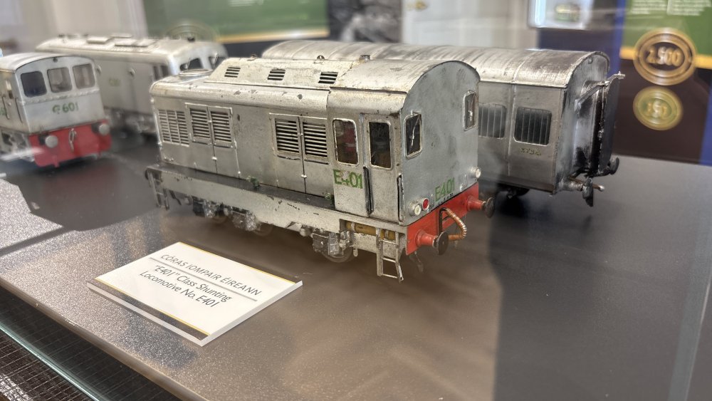

Mol_PMB Posted January 28 Author Posted January 28 Thanks for all the interest and support. In doing my research I was particularly inspired by these two photos in the Transport Treasury collection, which are very clear, sharp and well-lit photos of clean locos, and show the typical late 1950s silver, and late 1960s black condition: The Transport Treasury | 1001-1997 The Transport Treasury | Ireland For the cab end, and the third livery option, this shot by Jonathan Allen is also very clear: E402 - Inchicore | 1972 and E402 has moved to Inchicore. She… | Flickr There are quite a lot of photos of them after withdrawal at Mullingar, but often with parts missing, so they have to be interpreted carefully! In this photo again by Jonathan Allen we can see E403 and E408 with their final modifications - removal of the exhaust/silencer cowl and the addition of the vacuum brake dump valve pipework on the back of the cab: E403 - Mullingar | The IRRS special made a brief lunch stop … | Flickr In due course I'll post much longer list of Flickr photo links, which are very useful but many of them aren't so clear. 2

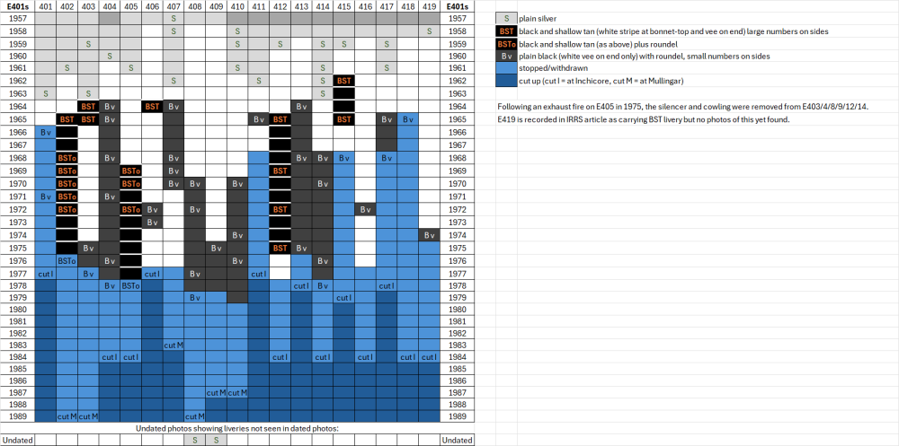

Mol_PMB Posted January 29 Author Posted January 29 While I'm waiting for the etch to be produced, I've been updating my livery matrix and photo lists. Here's the livery matrix for the E401 class: The liveries carried were: Silver, with large green numerals on cabsides and both ends, no snail, red bufferbeams. Black and tan, without roundel, white vee on ends and white stripe at bonnet-top, large numerals on cabsides and both ends, red bufferbeams. Black, with roundel on bonnet sides, white vee on ends, small numerals on side of cab and bonnet, large numerals on ends, red bufferbeams, colour-coded pipework Black and tan, as (2) but with roundel It appears that none were painted green. Also, attached to this thread, is an Excel spreadsheet containing links/references to over 100 photos of the E401 class, including all class members. The dates range from construction (alongside CC1) in the 1950s to destruction by gas-axe in the 1980s. Despite that range and the quantity of photos, some of the class were very camera-shy. I expect that some locos spent long periods out of use, before they were officially stopped. E401_photolist.xlsx
jhb171achill Posted January 29 Posted January 29 6 minutes ago, Mol_PMB said: It appears that none were painted green. E401_photolist.xlsx 21.56 kB · 0 downloads Correct. The only smaller diesels ever to be green were the original trio of G601 class (lighter green only) and the D class (lined dark green when new, lighter green later). The G611s and E421s were black / black’n’tan from new. 1
Mol_PMB Posted January 29 Author Posted January 29 3 minutes ago, jhb171achill said: Correct. The only smaller diesels ever to be green were the original trio of G601 class (lighter green only) and the D class (lined dark green when new, lighter green later). The G611s and E421s were black / black’n’tan from new. G611s arrived in green but were painted BnT before entering service?
jhb171achill Posted January 29 Posted January 29 5 minutes ago, Mol_PMB said: G611s arrived in green but were painted BnT before entering service? Correct. Never turned a wheel in green.

Mol_PMB Posted January 30 Author Posted January 30 Today's progress has been an email discussion with Iain at 4Dmodelshop to perfect the artwork - a few extra tabs needed to maintain structural integrity of the etch, and a couple of holes changed to half-etch again to strengthen the etch in production. Iain's really good with this - as ever there's a balance between how many tabs are needed for production purposes, vs how many need to be cut and filed back in building the model. I have also placed some orders for the fairly small number of parts that can't be etched, as follows: Horns and windscreen wipers from A1 models Axlebox castings, handrail knobs, various bearings from Wizard models A selection of gears, gearboxes, motors and suspension parts from High Level models Buffers from Sutton Loco Works (it's really hard to find good large 4mm scale buffers these days - they're out of stock everywhere) I'm hoping that with some parts in front of me, I'll be able to finalise the chassis design. I think I've nearly mastered the 21mm gauge version (which is the one I want) but I appreciate the need to find an OO gauge solution too. I still need to source some 2mm diameter axle material, and probably some wheels too, though they can be standard wagon wheels. It's probably way too early to think about paint and transfers! I think I am going to start by building the trial etch as a silver one in original condition, probably E410 although E414 is also appealing. If I need to do some revisions and test-build again, I may do a black one, possibly go to the other end of their life and implement the mid-1970s modifications. 1
Mol_PMB Posted January 30 Author Posted January 30 Talking of the mid-1970s modifications, the externally visible ones were the removal of the exhaust/silencer and its cowl, and the fitting of the emergency vacuum brake dump valve pipework on the back of the cab. These mods were only applied to the locos still in traffic at the time (E403/4/8/9/12/14 but not E410), and photos of them in use with these mods are very hard to find. There aren't even that many photos of them after withdrawal. The best view post-withdrawal is this photo on Flickr by Jonathan Allen, showing E403 and E408 with the pipes on the cab back and the exhaust cowl removed: Murray Liston took a similar view from a slightly higher angle: From the IRRS archive, here's E408 in use at Heuston with the vac dump valve pipework just visible: https://www.flickr.com/photos/irishrailwayarchive/53511291856/ And from Jonathan Allen again, E413 with the exhaust cowl removed, at Inchicore. Interestingly E413 isn't on the list of locos with this modification, and may never have re-entered traffic? Here's E412 with the exhaust cowl removed, and still in use: https://www.flickr.com/photos/irishrailwayarchive/53511278573 There are several more photos of E403 as well: https://www.flickr.com/photos/irishrailwayarchive/53569588917/ https://www.flickr.com/photos/irishrailwayarchive/53509328774/ https://www.flickr.com/photos/irishrailwayarchive/53570446021/ https://www.flickr.com/photos/irishrailwayarchive/53511614884/ And this of E414: https://www.geograph.ie/photo/2856680 If anyone can point me towards more photos of the modified locos I'd be really pleased to see them. Especially a better view of the pipes on the back of the cab, or the cropped exhaust outlet on the bonnet top. 3 1

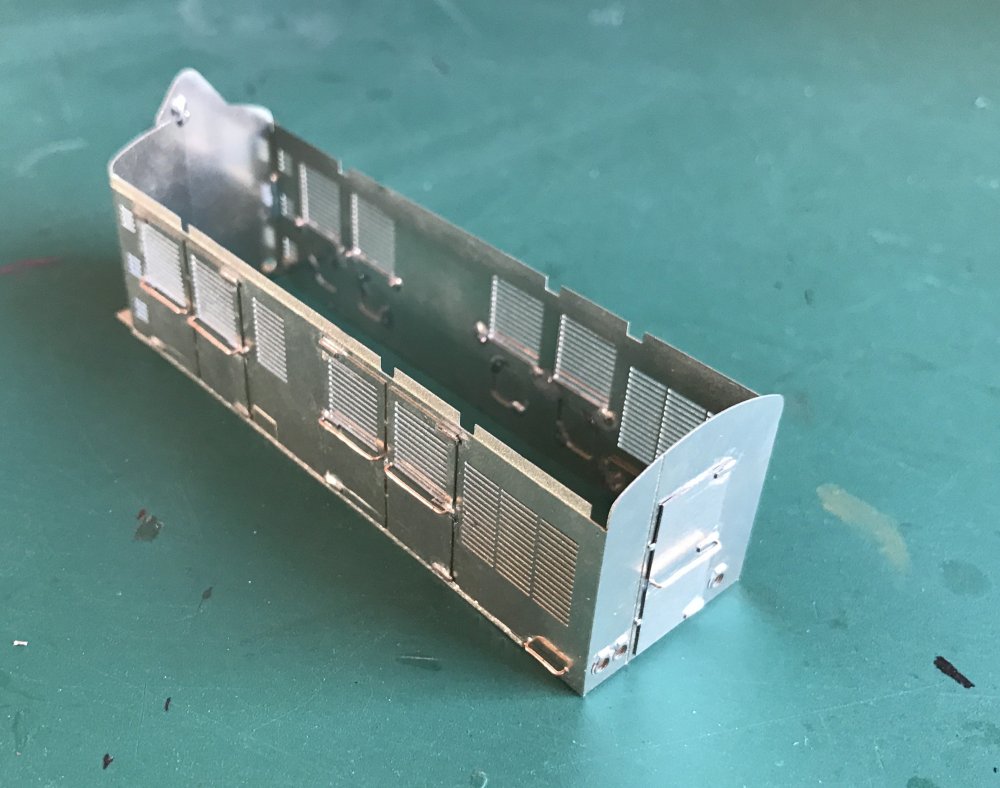

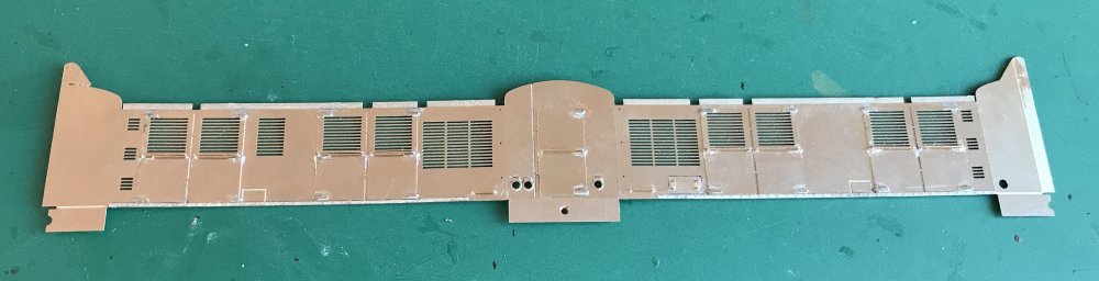

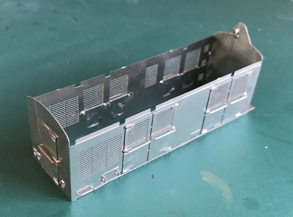

Mol_PMB Posted February 6 Author Posted February 6 The postie turned up at 0945 this morning and I got stuck in straight away. Not too many challenges so far; 3 hours work has completed the first subassembly - the bonnet sides and ends. Outside, with the doors, handrails and headlights added: Inside: not so pretty, but it's designed for most of the soldering to be done from the inside: Folded up and tacked, the RHS: And the LHS: Step-by-step instructions to follow, but I'm going to have lunch and do the bonnet top first. 12

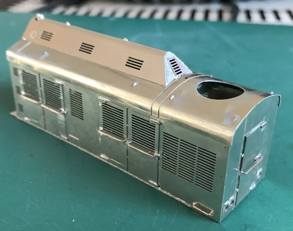

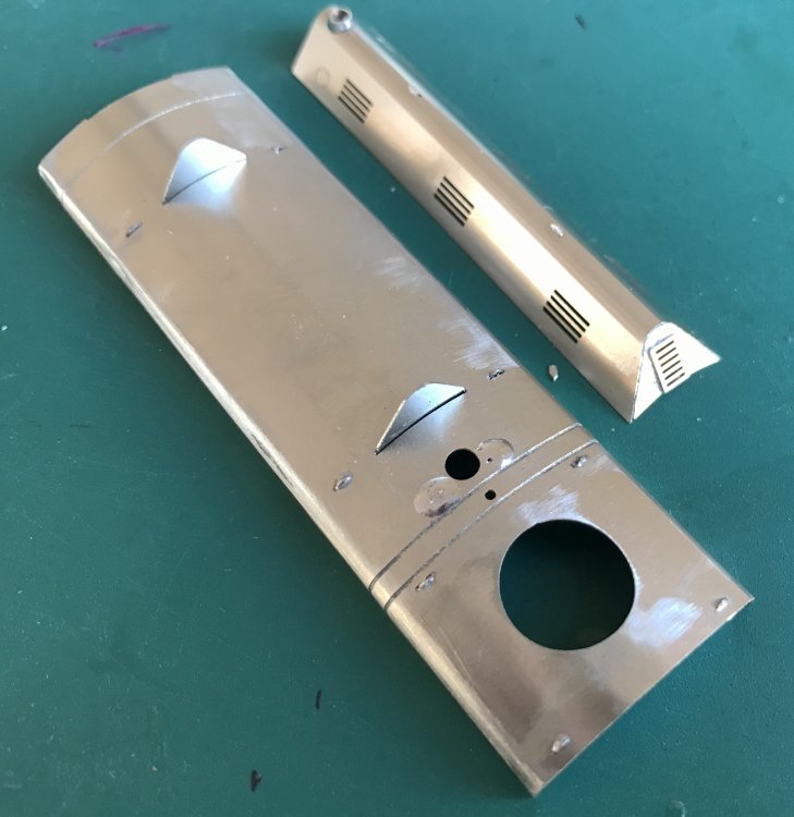

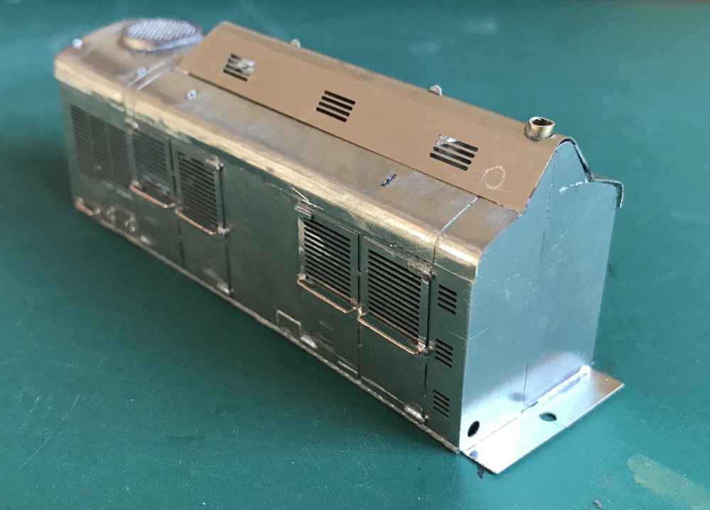

Mol_PMB Posted February 6 Author Posted February 6 Another 3 hours work and I have completed the second subassembly, and fixed it to the first. Bonnet top and exhaust cowl. They were soldered together after this photo: One of several trial fits onto the bonnet: Radiator fan grille added, bonnet top soldered onto bonnet sides and front: A bit more cleaning up done round the edges: I'll take a fresh look tomorrow and see if any more bits need scraping or filling. Then there are few fiddly details to add, like the water filler and breather pipes, and the bonnet unit will be complete. 13 2
RedRich Posted February 6 Posted February 6 Excellent work and a very well thought out kit. There is something about a brass or nickle silver model that looks amazing, it almost seems a shame to paint it. 1 1 1
Mol_PMB Posted February 6 Author Posted February 6 1 minute ago, RedRich said: Excellent work and a very well thought out kit. There is something about a brass or nickle silver model that looks amazing, it almost seems a shame to paint it. Thanks! This is the first complete loco kit I've designed, though I've done quite a few wagons and some loco conversion bits. I've built some good etched kits, and some very bad ones, so in designing this I've tried to copy all the good ideas and avoid the bad ones. We'll see how that works out in due course... When complete, this one will be painted silver as E410. I may well do a black one as well. 3 1

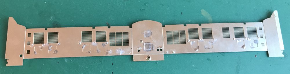

Mol_PMB Posted February 6 Author Posted February 6 Attached are the instructions for the bonnet sides and ends. This should give you an idea of what's involved in building it. My next task is the instructions for the bonnet top. Making an E401 - the bonnet sides and ends.pdf 2 1
