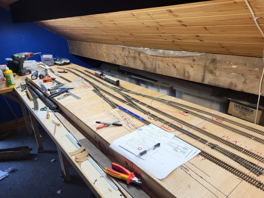

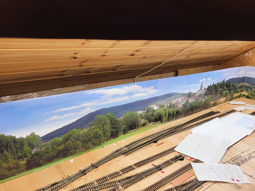

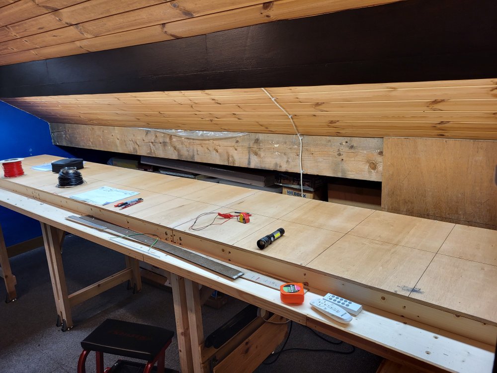

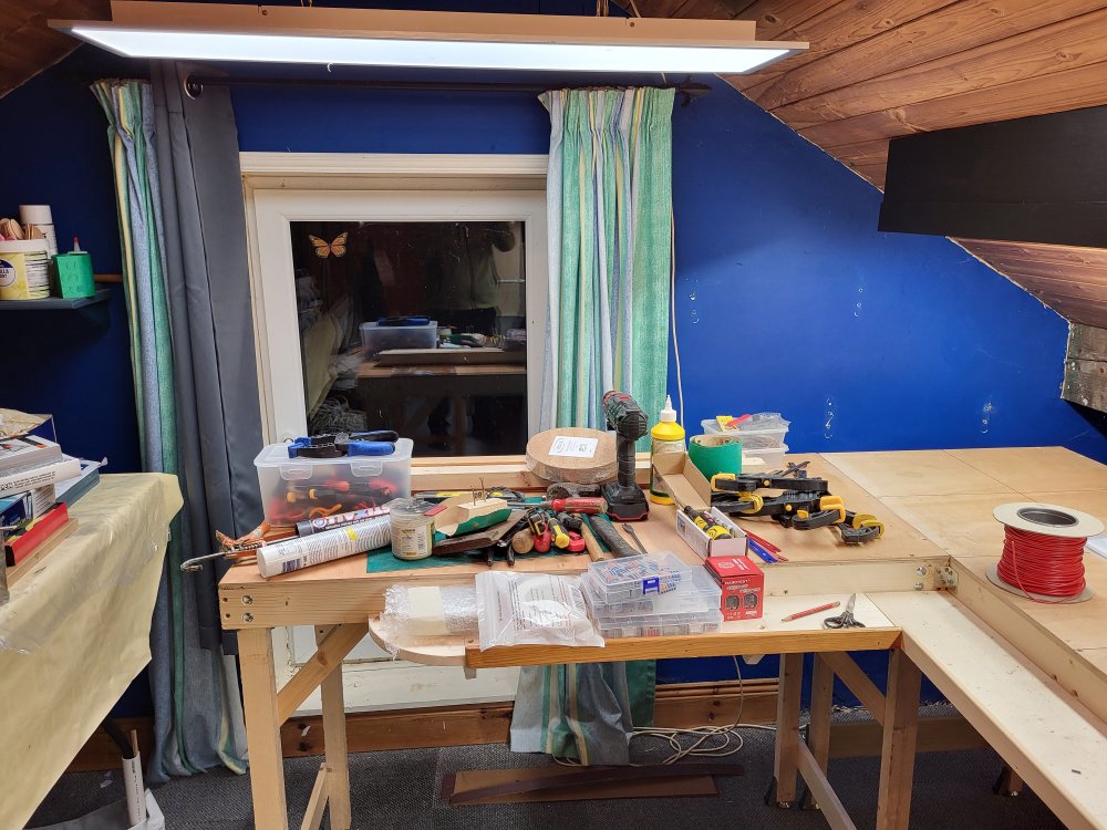

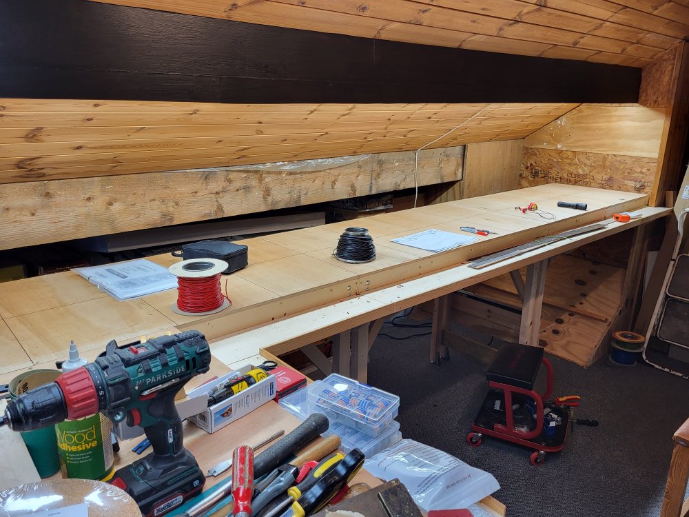

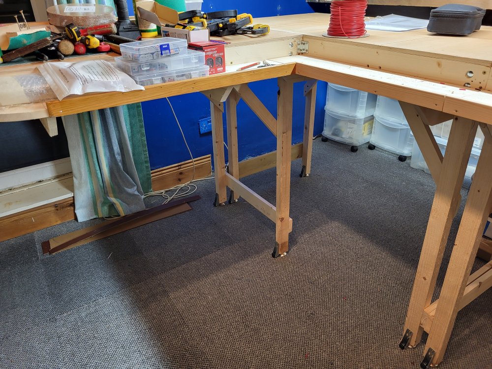

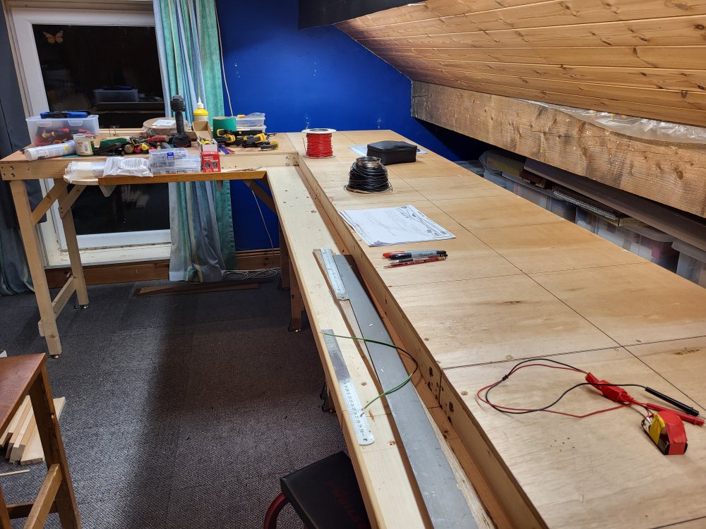

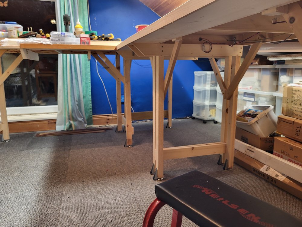

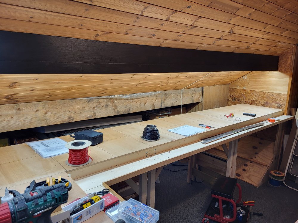

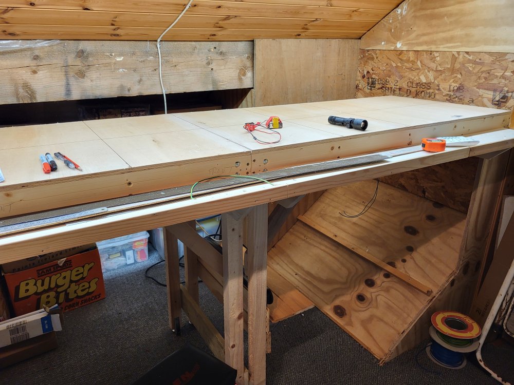

amdaley Posted April 30, 2025 Posted April 30, 2025 What do you do when you have too much stock ? Build another layout of courseย Not content with my main layout downstairs I decided to build another one in a loft bedroom.ย It will be L shaped 12 ft x 9 ft & I decided to call it Mill Road because I couldn't think of anything elseย ย . It is built in modular form so that it can be taken down & moved if the need ever arises. Baseboards are 24" deep so easy to reach the back if needed. Fortunately I have a very understanding wife & it keeps me out of trouble, well most of the time anyway. Here are some early photos. I'll post more on a regular basis. The framework is 3" x 1" with 9mm ply for the top. The legs are 2" x 2". Tony. 12

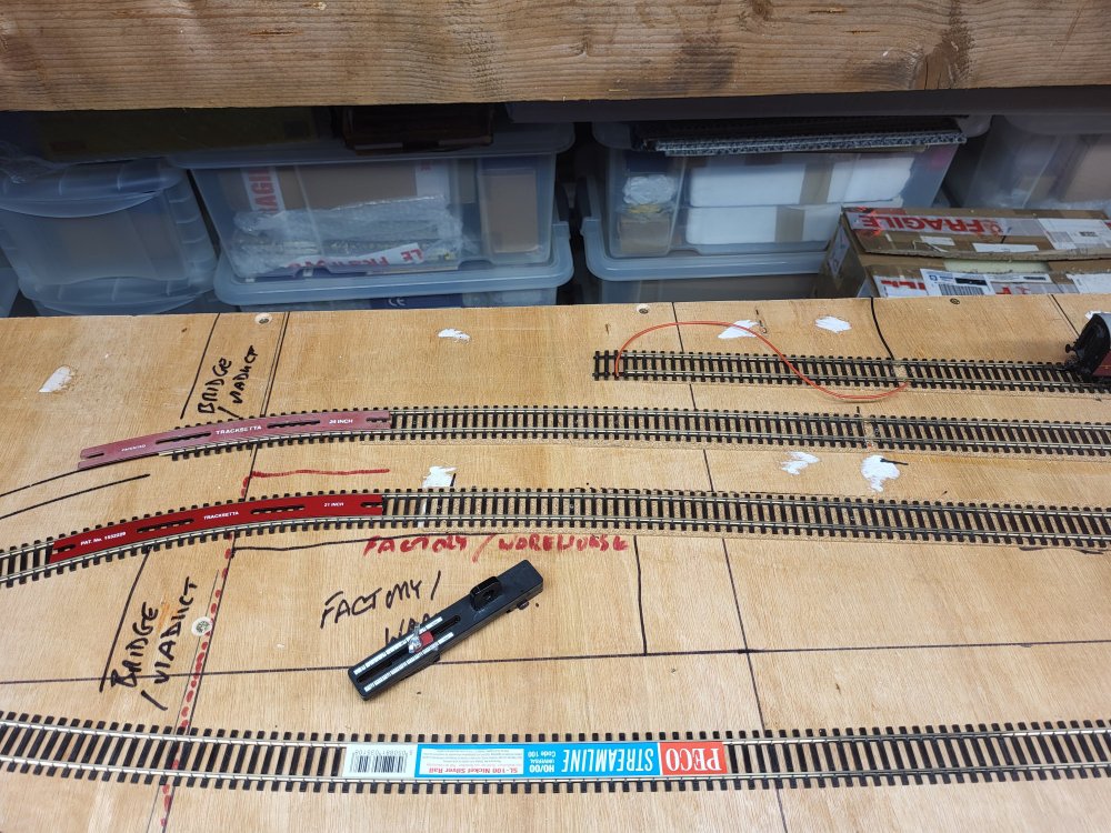

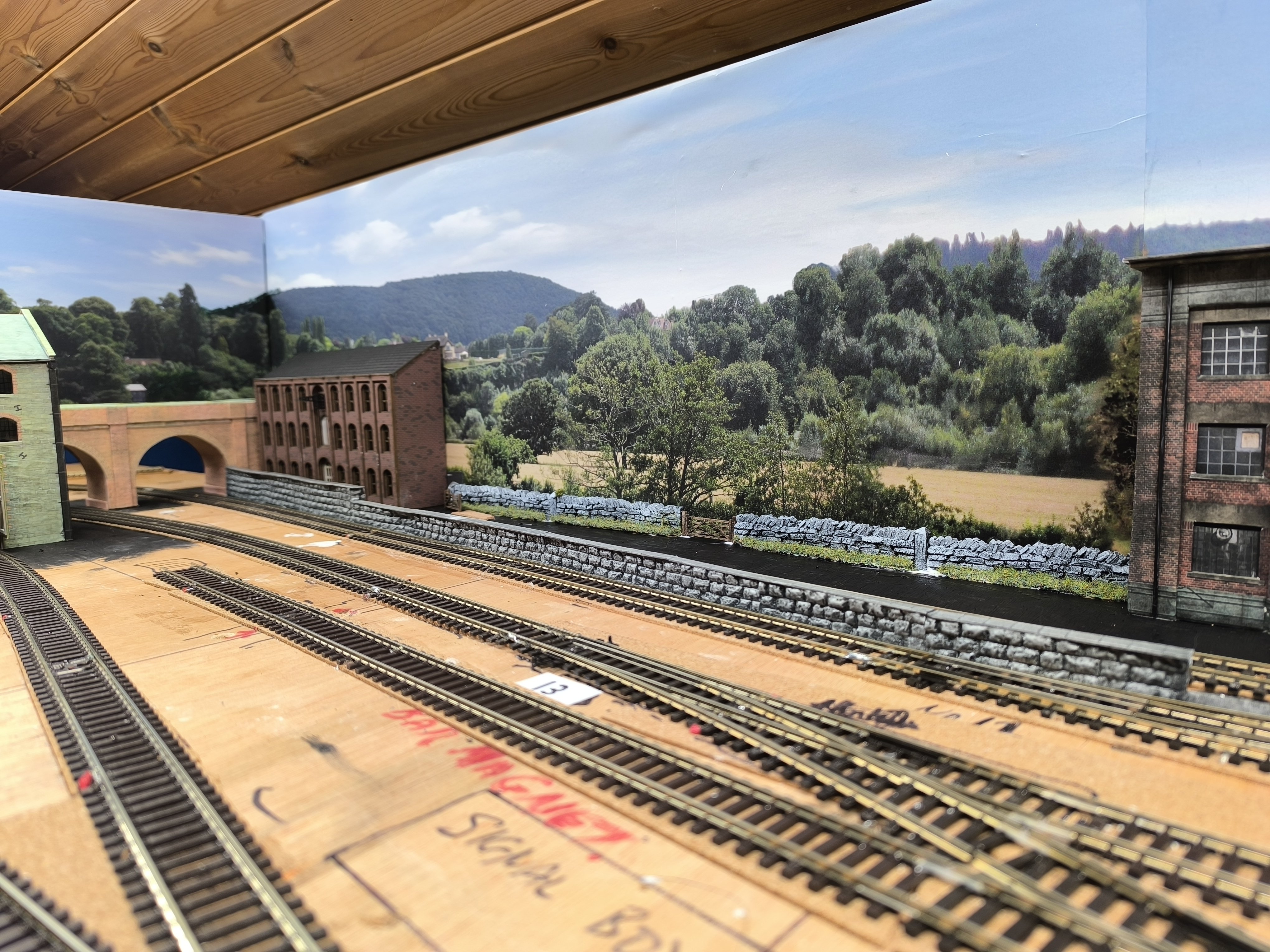

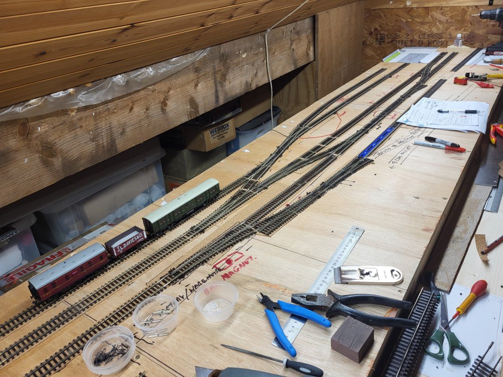

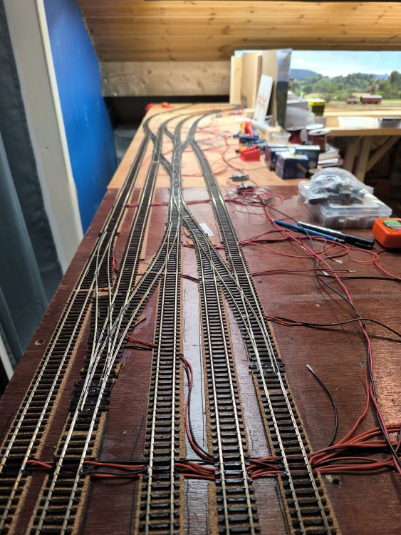

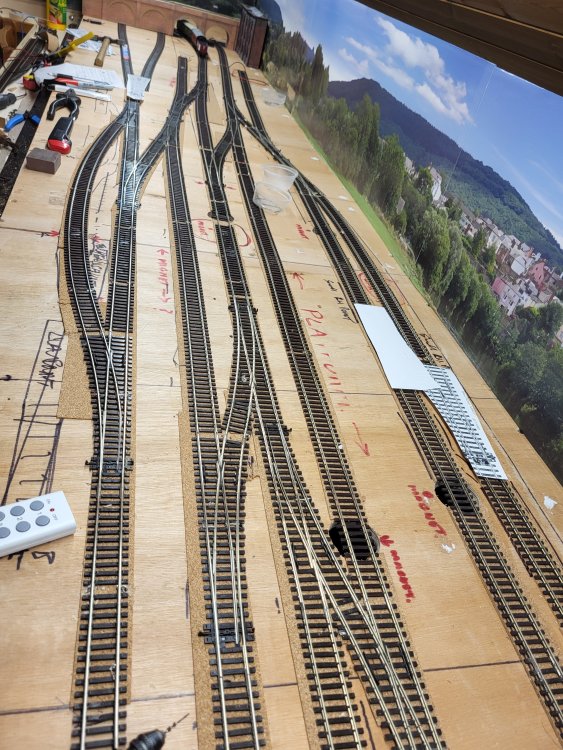

amdaley Posted May 6, 2025 Author Posted May 6, 2025 (edited) More photos of some track progress. ย Edited May 6, 2025 by amdaley 4

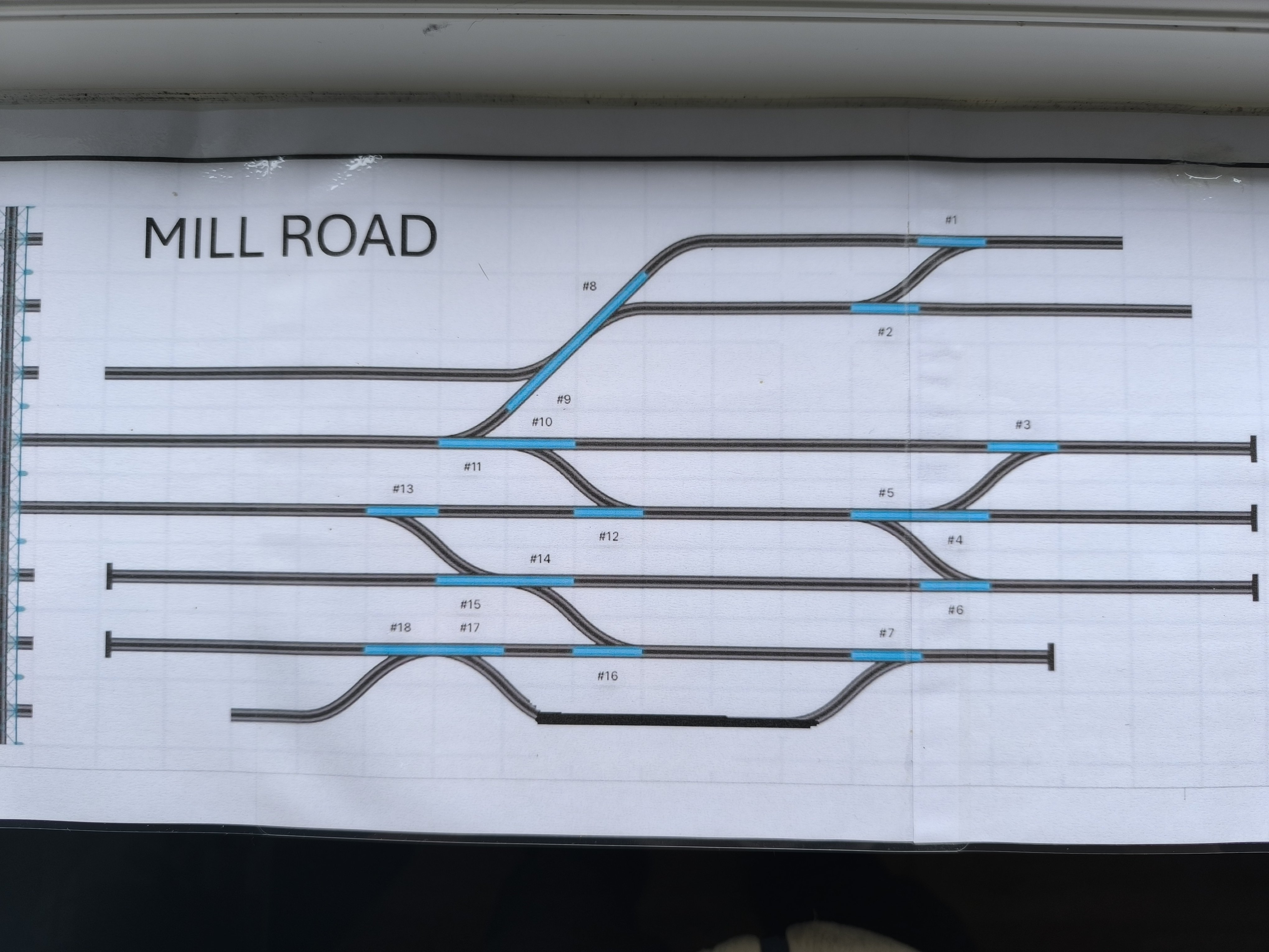

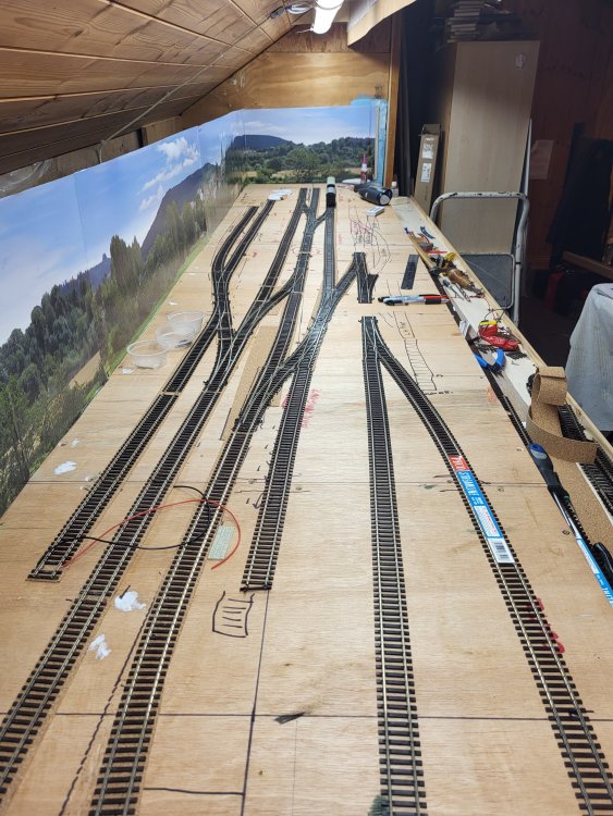

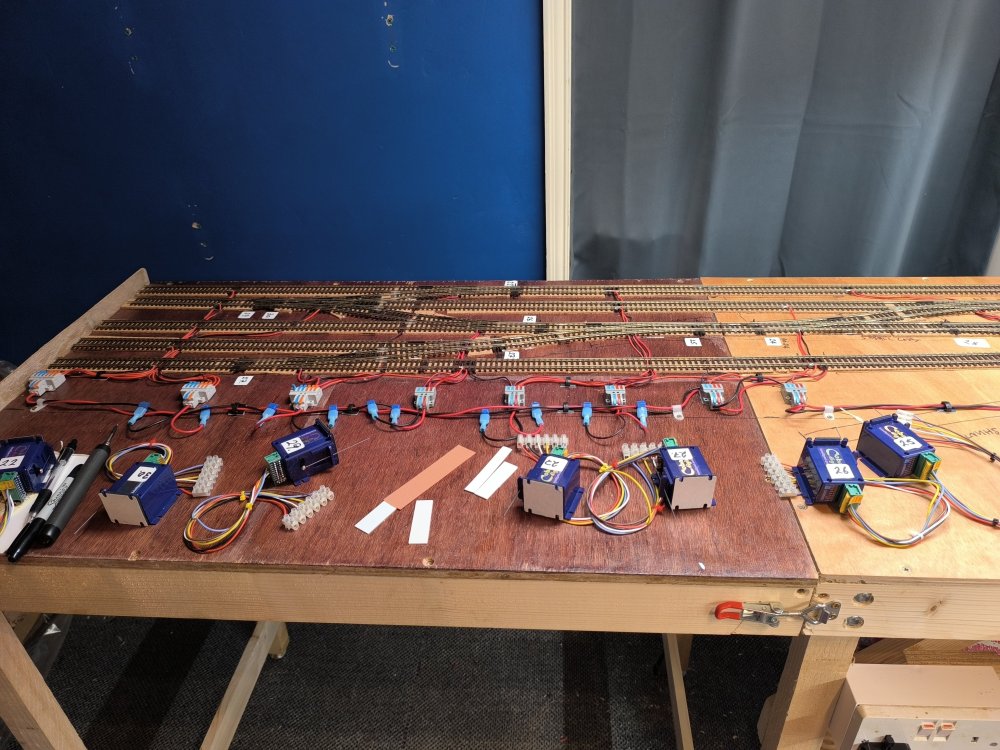

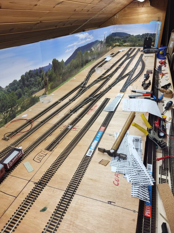

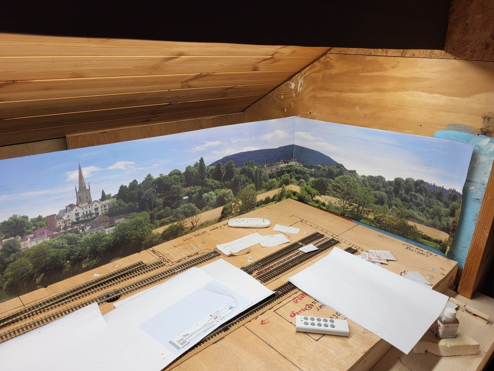

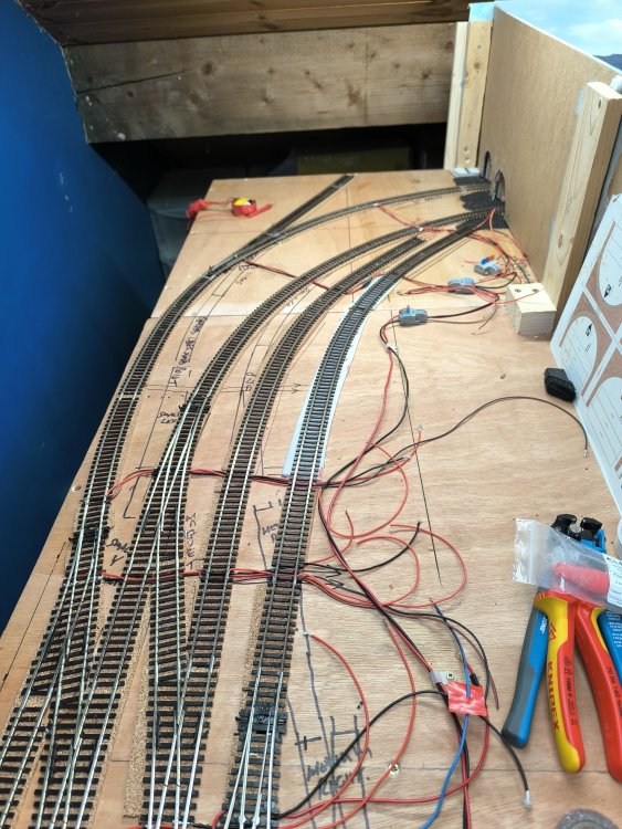

amdaley Posted May 12, 2025 Author Posted May 12, 2025 (edited) Progress continues. ย ย ย Scenic side track plan complete. ย ย ย Track has been connected & tested. Point motors are a mixture of Tortoise, MTB Mp4's & Ip Digital's. I used a Roco 108836 accessory decoder for the Tortoise & MTB point motors. The Ip Digital have built in accessory decoders. The command station in a Roco Z21. Next up is track laying in the fiddle yard. Tony. Edited May 12, 2025 by amdaley 10
west_clare_wanderer Posted May 17, 2025 Posted May 17, 2025 You've got a fantastic space to work in there Tony. I'm going to enjoy following this. Where/when is the layout set? It looks like you have come up with a track trackplan with lots of operating potential.ย Keep on sharing! 1 1
amdaley Posted May 17, 2025 Author Posted May 17, 2025 6 hours ago, west_clare_wanderer said: You've got a fantastic space to work in there Tony. I'm going to enjoy following this. Where/when is the layout set? It looks like you have come up with a track trackplan with lots of operating potential.ย Keep on sharing! Not set in any particular area or time frame. It's a bit of a rule one layout. Any big four British steam or early diesel, even pre grouping but nothing modern I have another larger layout as well but I wanted to do something new & different. I've never built an end to end layout before. It's more about the building rather than operating with me. I'll put up more photos as I go along. If anyone has any questions just ask awayย Tony. 2 1

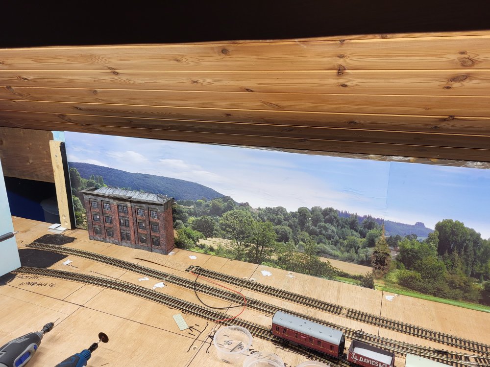

amdaley Posted May 20, 2025 Author Posted May 20, 2025 (edited) First loco test & a little shunting. VID_20241204_181643.mp4 ย VID_20241209_112640.mp4 ย Fiddle yard track is down but needs to be wired up. ย ย Edited May 20, 2025 by amdaley 6
Georgeconna Posted May 20, 2025 Posted May 20, 2025 (edited) Nice set up, Is that the Heljan Class 11. Nice sound out of it when compare to the Hornby one I have. Edited May 20, 2025 by Georgeconna 1
amdaley Posted May 20, 2025 Author Posted May 20, 2025 Yes I got this one from Model Rail. It has a Loksound 5 micro decoder with upgraded speaker & a small stay alive fitted. 1

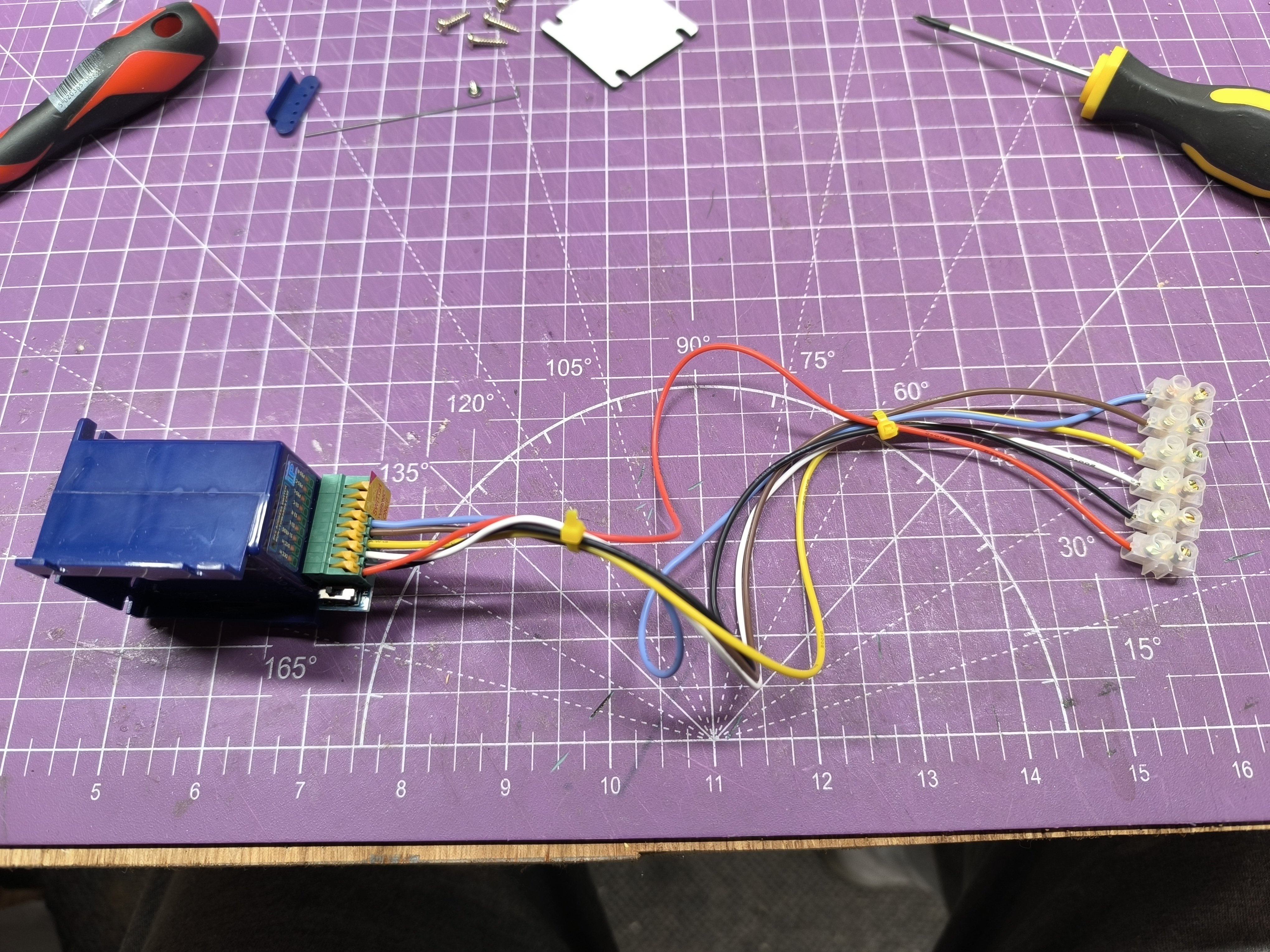

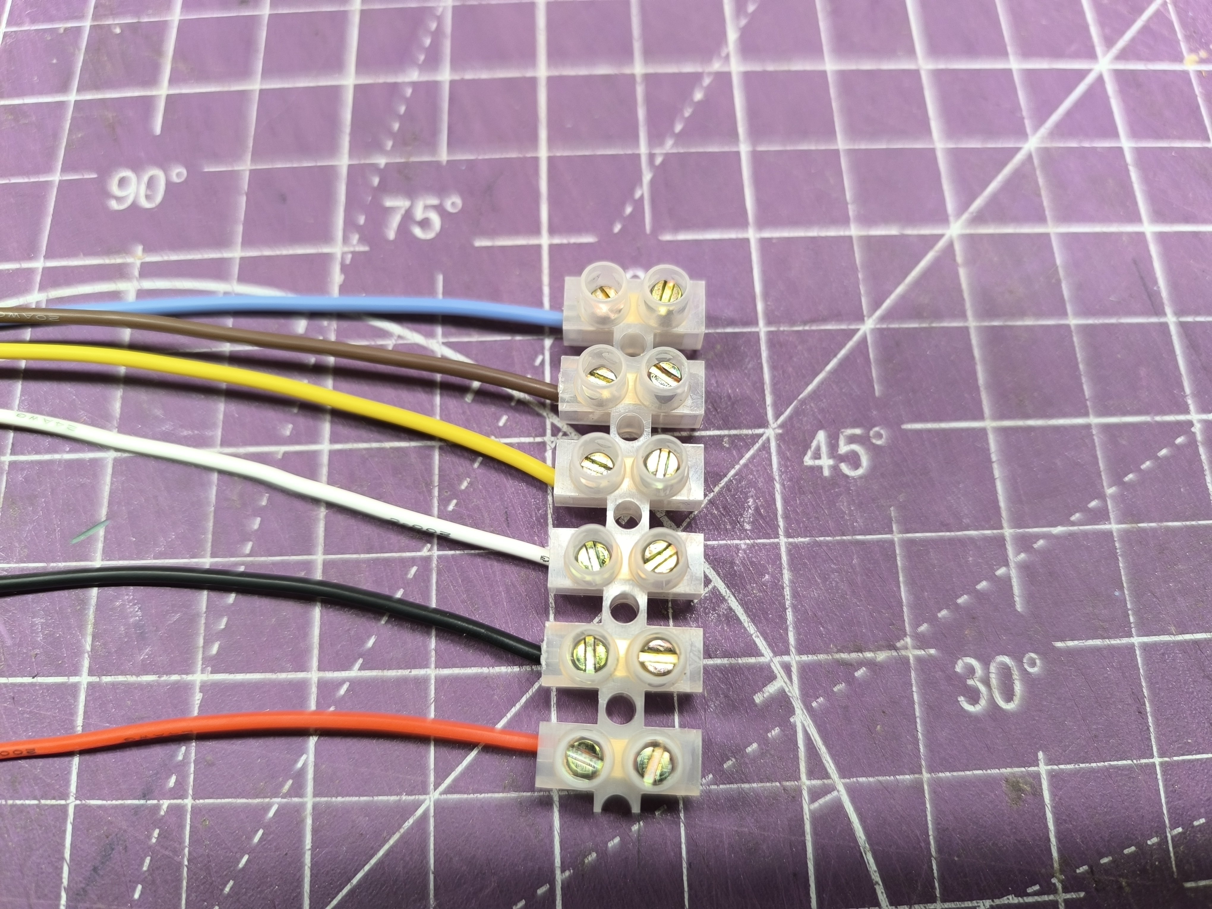

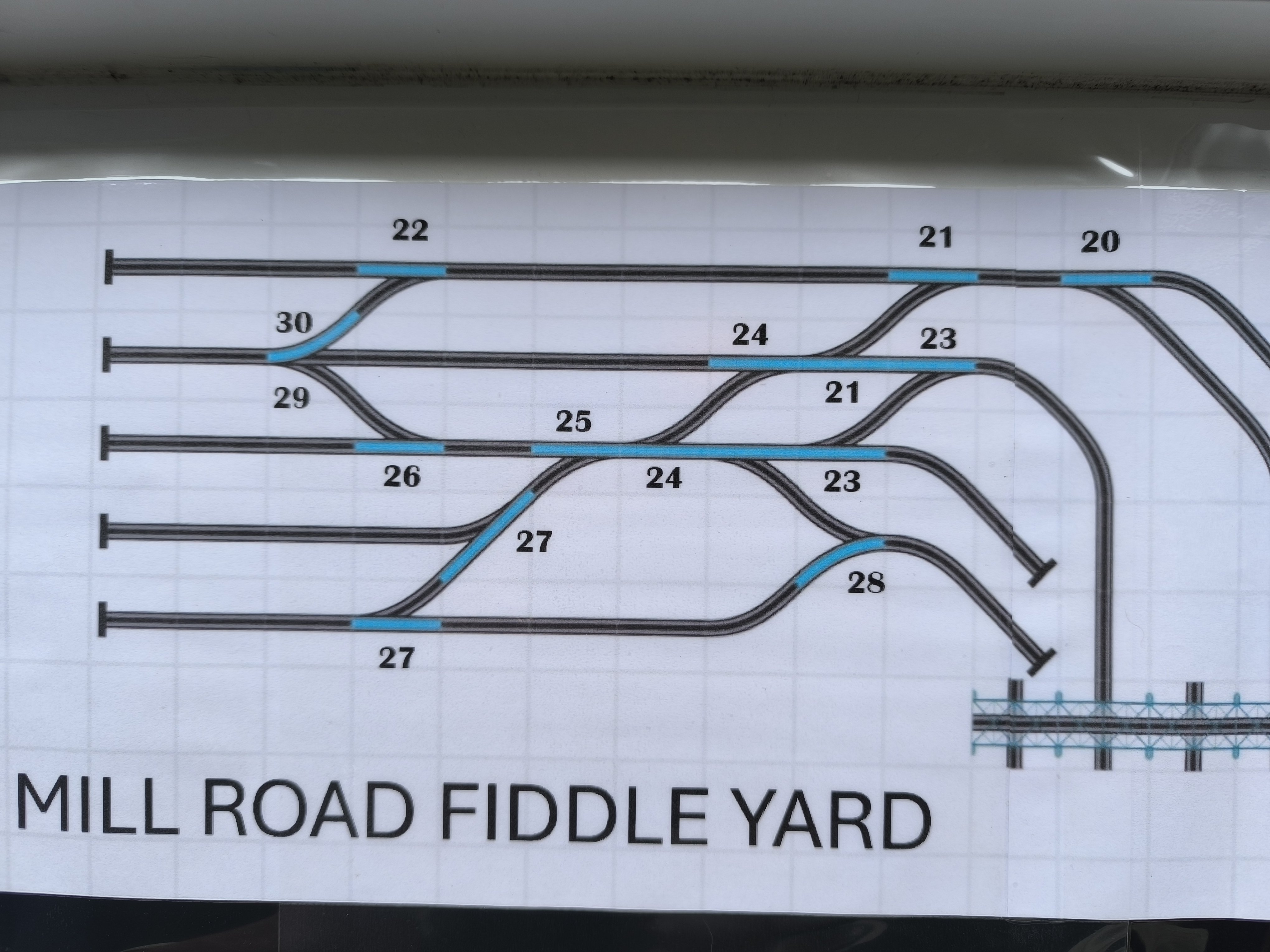

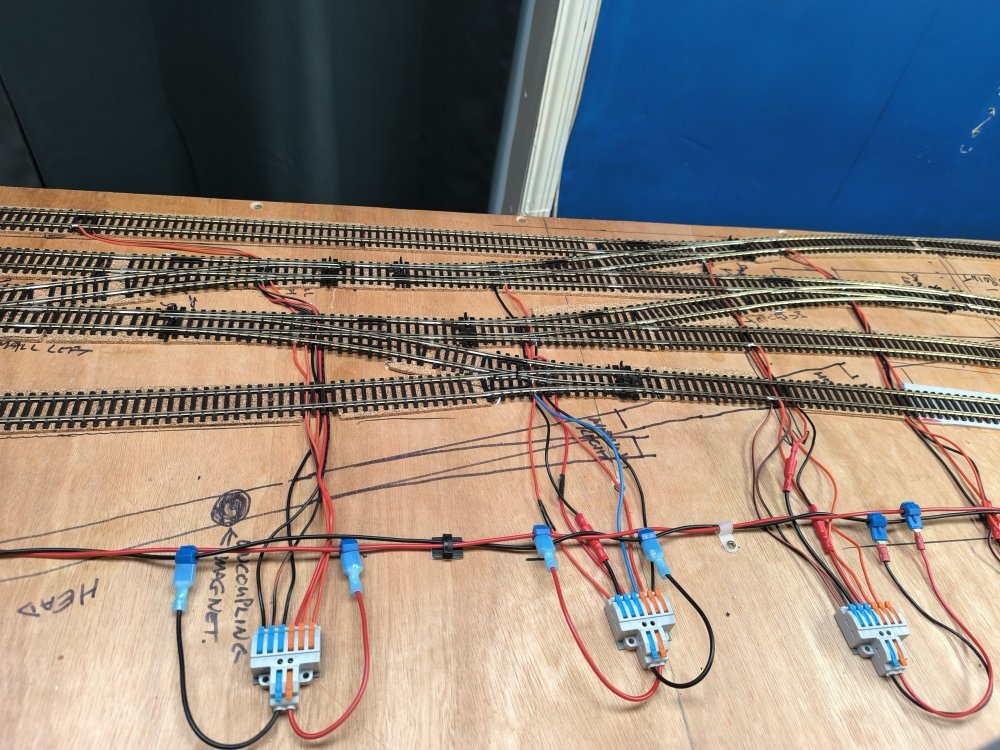

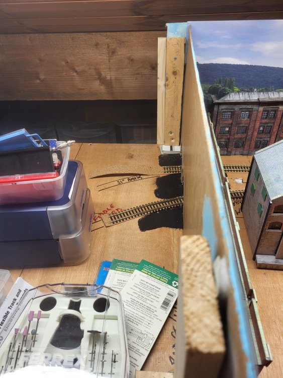

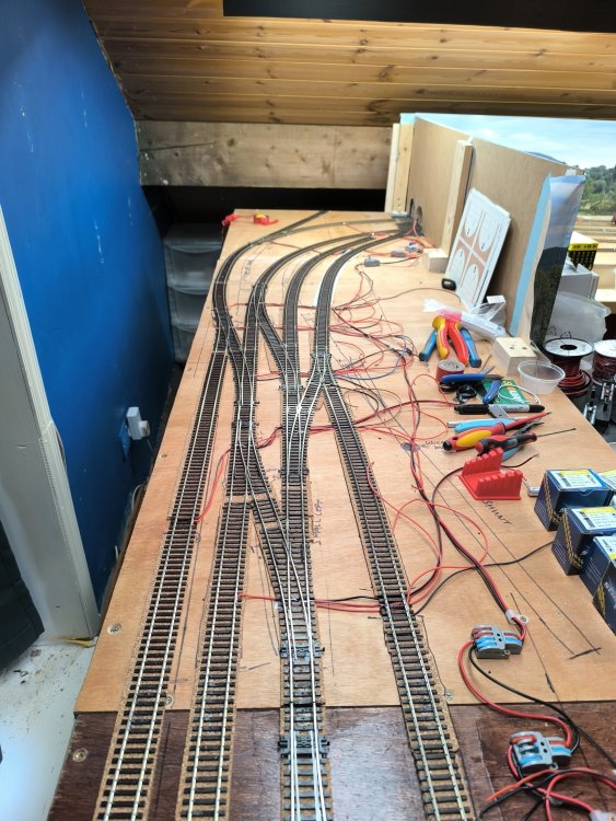

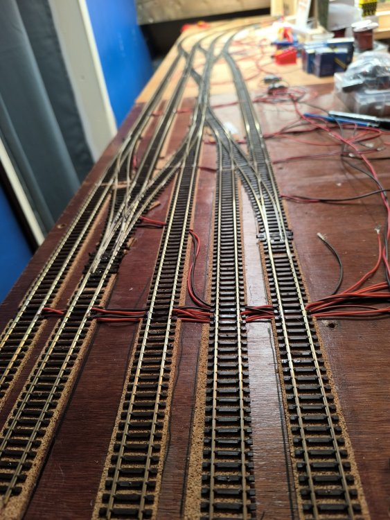

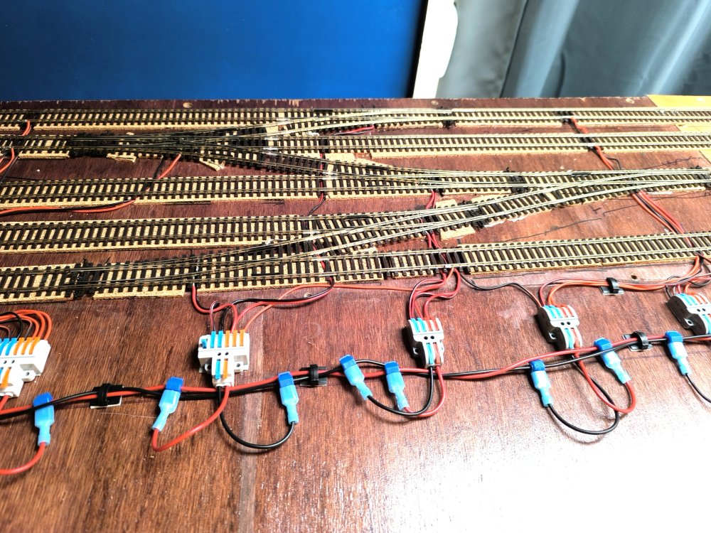

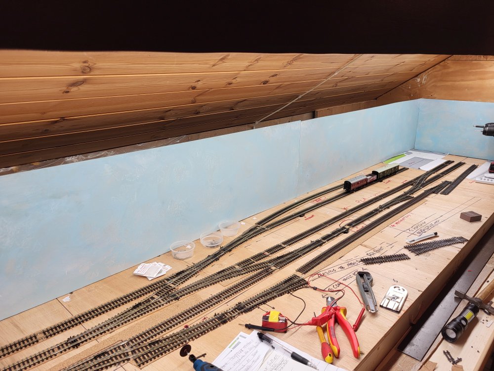

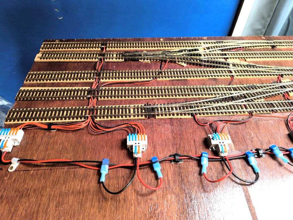

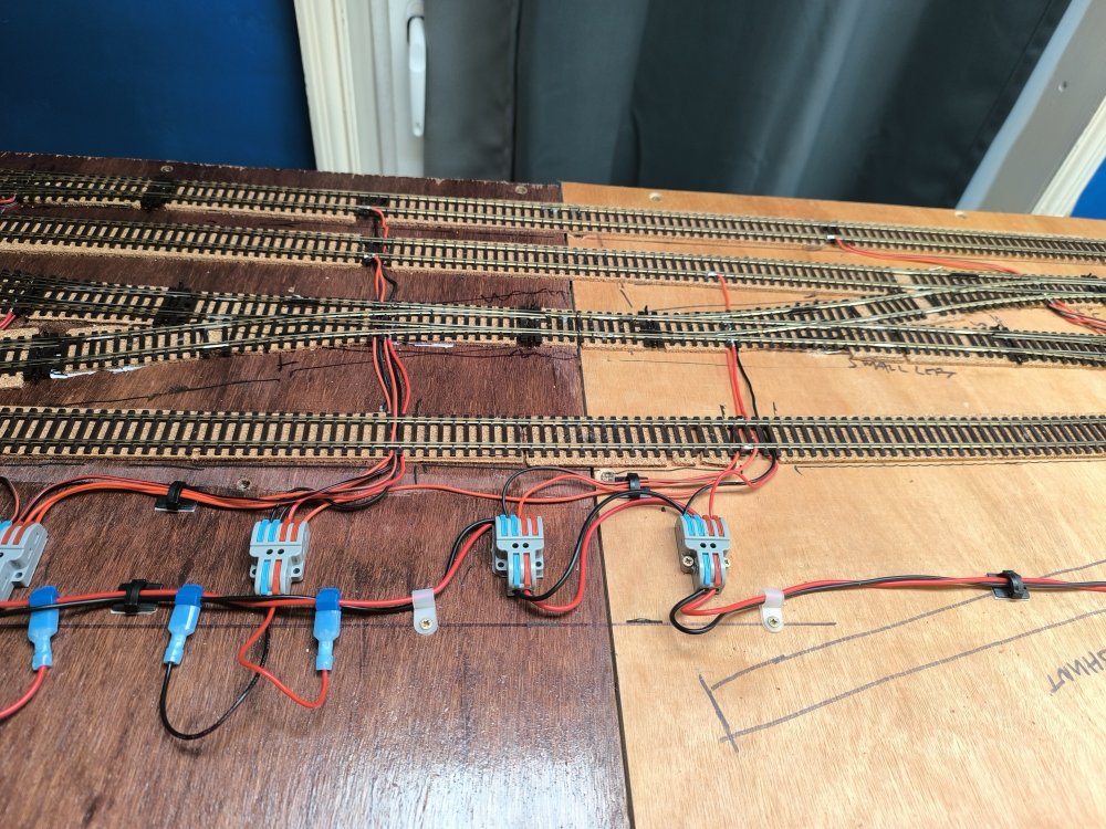

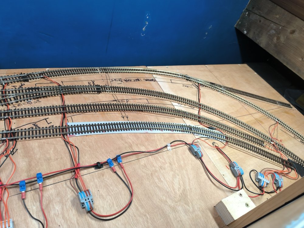

amdaley Posted May 26, 2025 Author Posted May 26, 2025 (edited) Fiddle yard is now wired up & tested. Next job is to prepare Ip Digital point motors before installing them so updates may not happen for a while. There's a total of 38 point motors on the layoutย I usually wire & setup the point motors before I install them on the layout. Makes it much easier to wire them into the system. If anyone is interested in how I prepare them let me know & I will post pictures or maybe even make some sort of video, although I can promise it won't win any academy awardsย ย I will try though. Here are photos of the fiddle yard wired up. I have wired it on the baseboard top surface as it's easier than trying to fiddle about under the layout. ย Edited May 26, 2025 by amdaley 4 1

amdaley Posted May 27, 2025 Author Posted May 27, 2025 3 hours ago, Colin_McLeod said: Very neat wiring Tony.ย Not a piece of spaghetti to be seen.ย You haven't seen the rest of it 2

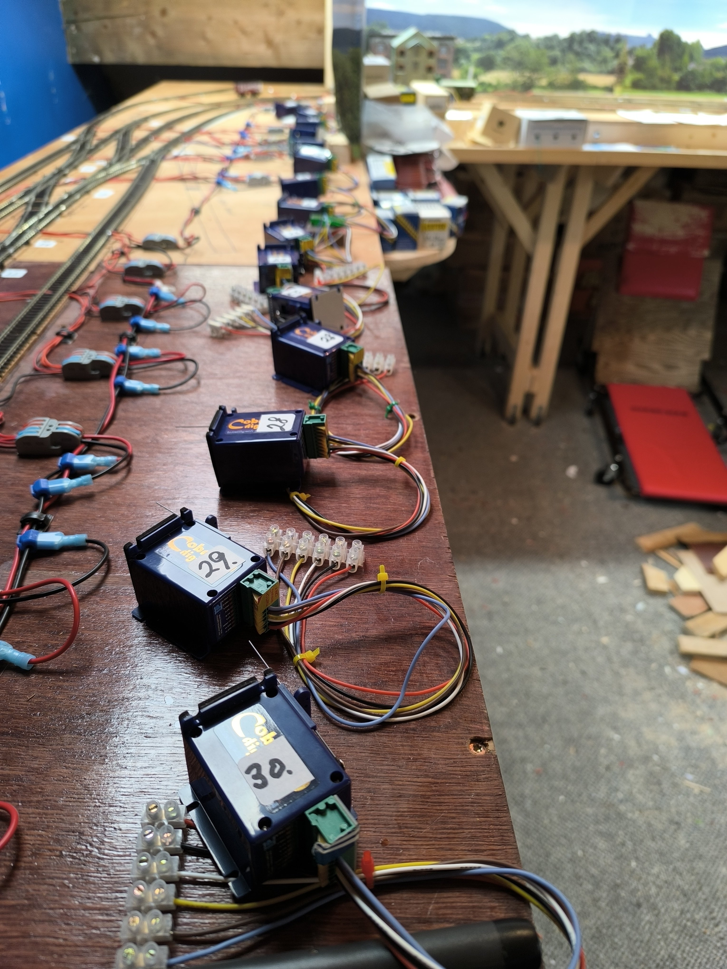

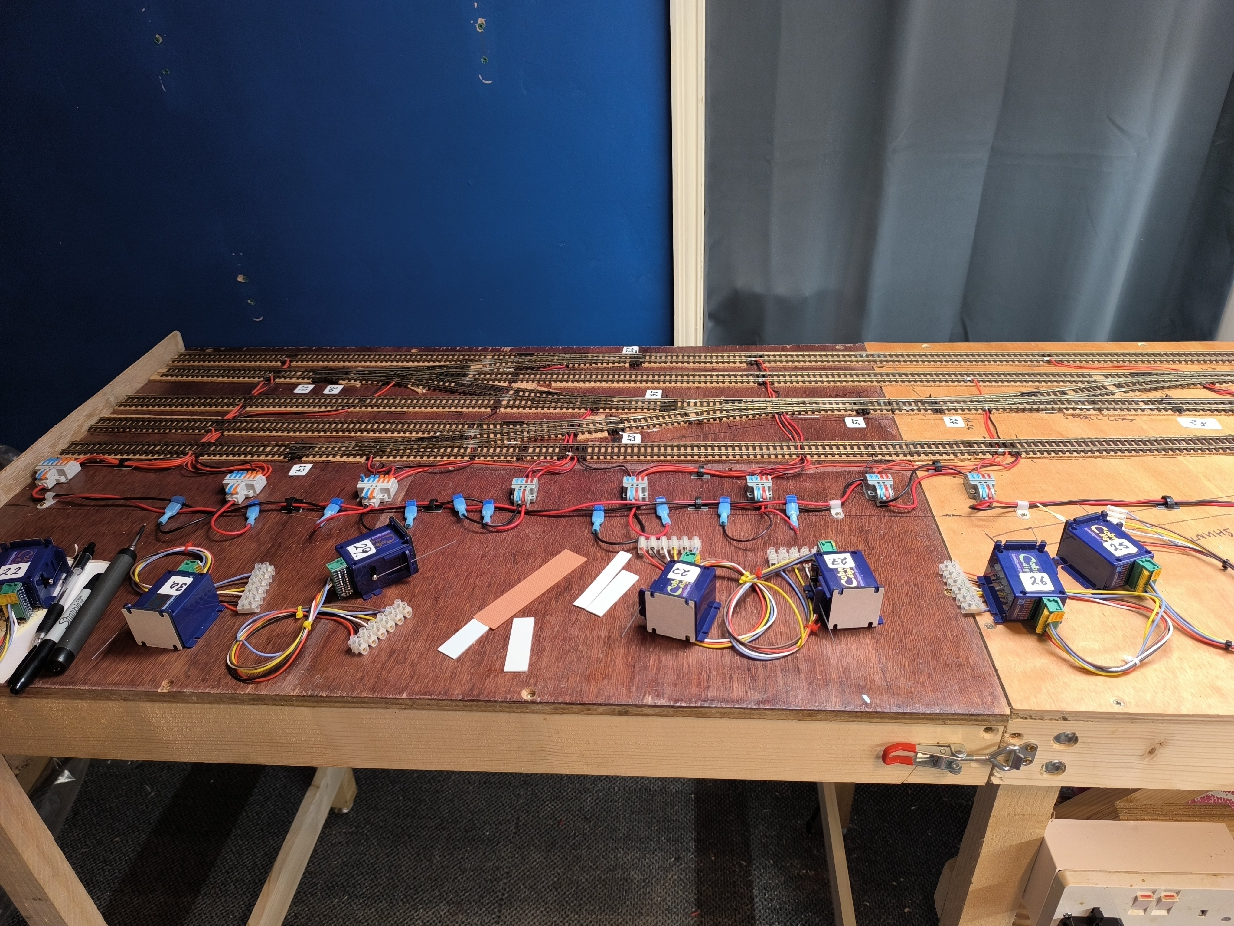

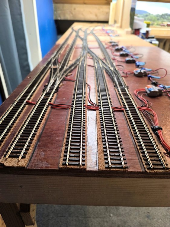

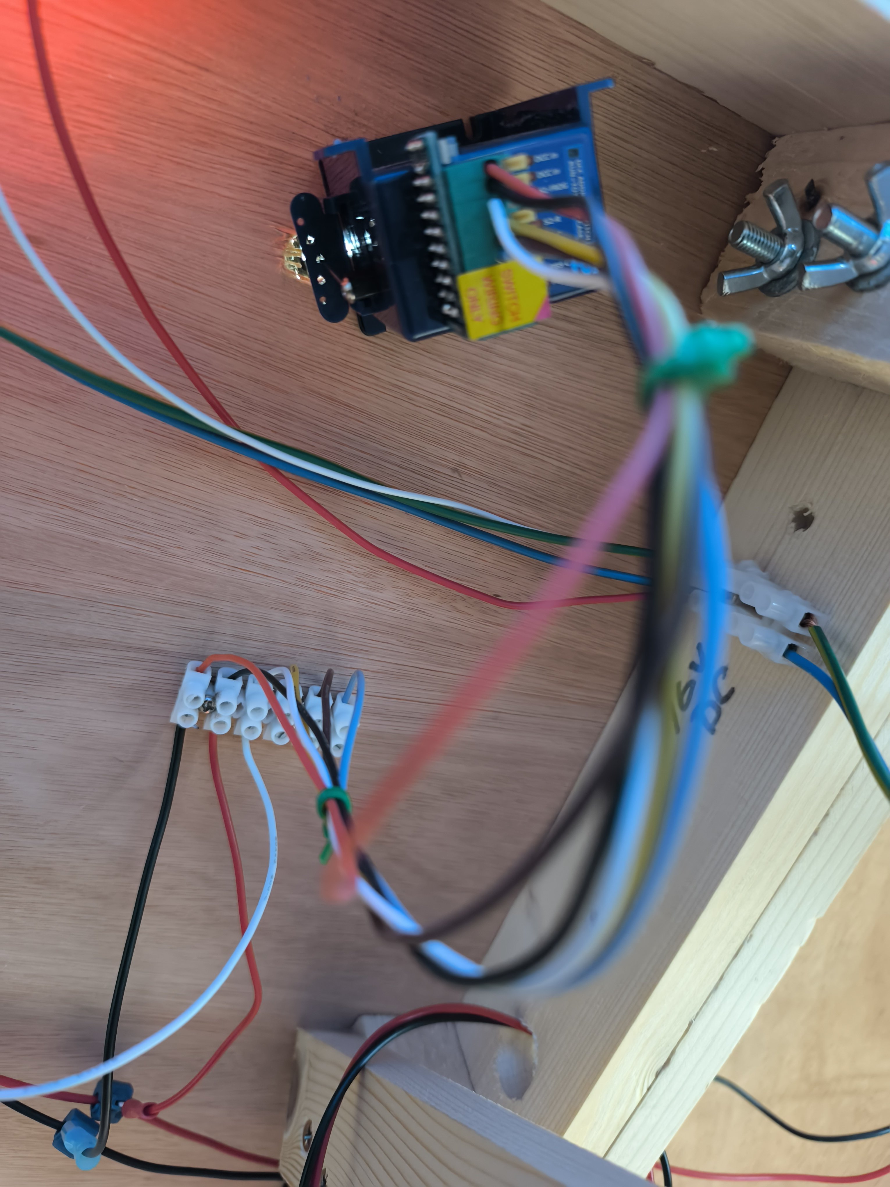

amdaley Posted June 1, 2025 Author Posted June 1, 2025 Fiddle yard points all wired up ready for fitting. One has been fitted. Only 13 more to goย ย ย 7

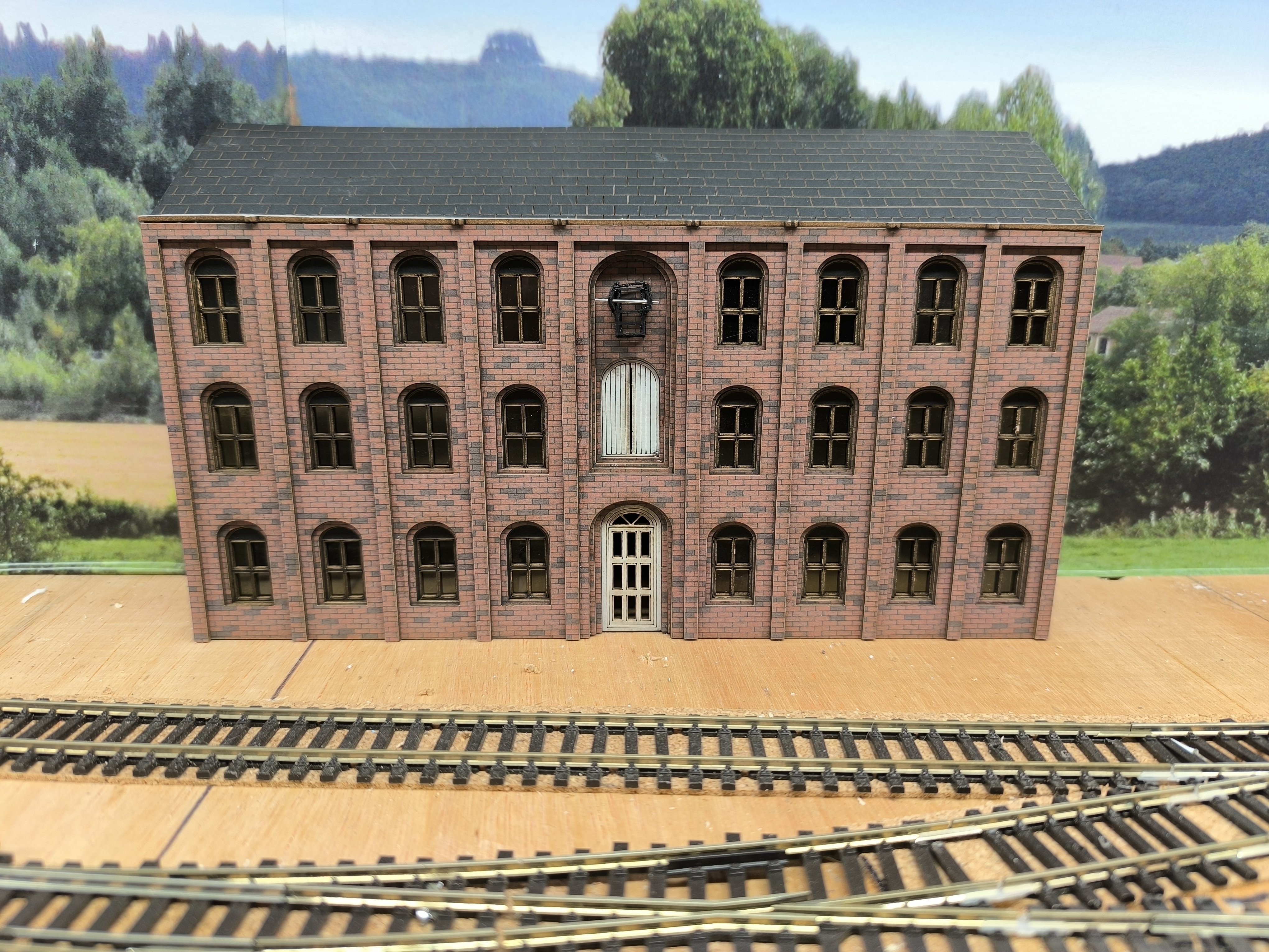

amdaley Posted July 10, 2025 Author Posted July 10, 2025 (edited) Not much happening at the moment. I'm busy with other things. I've installed some Ip Digital switch machines on the fiddle yard. Still have about seven to go. I did however make up a Modelux Victorian Warehouse. Still not sure where to put it though ? ย Edited July 10, 2025 by amdaley 7 1

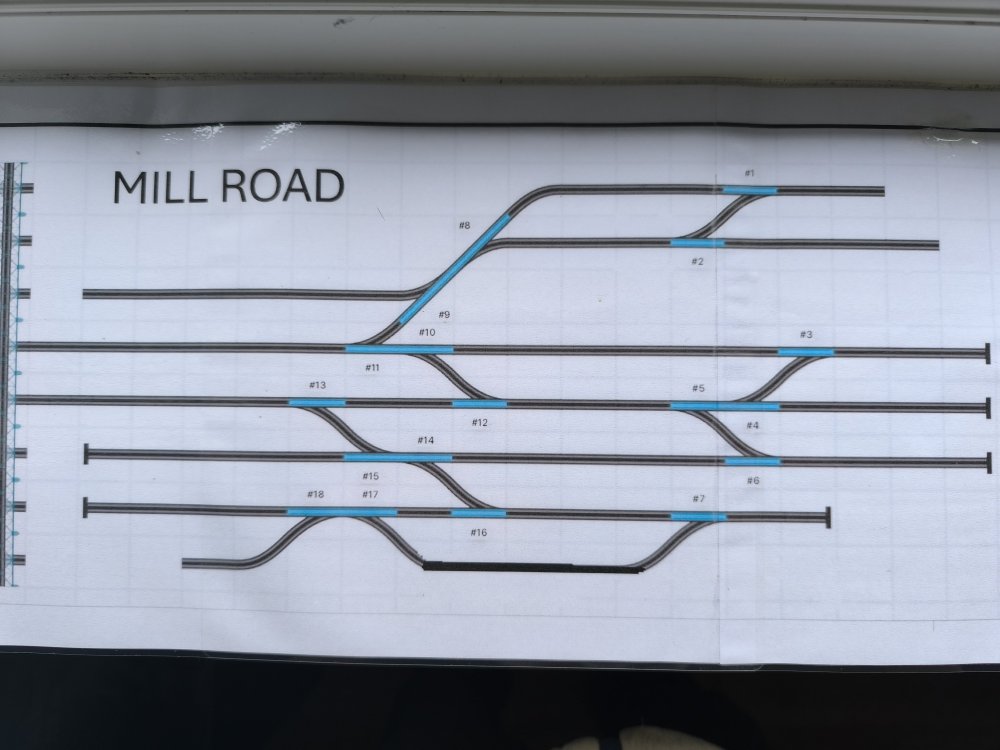

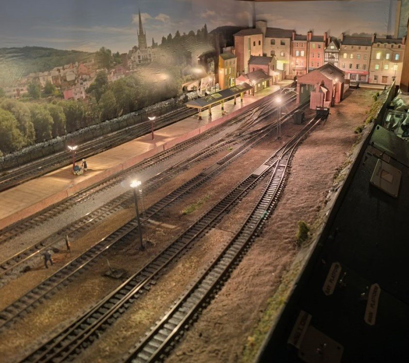

amdaley Posted July 28, 2025 Author Posted July 28, 2025 A little progress. I still haven't fitted the rest of the fiddle yard point motors but I did make up a couple of control panels. I hope to get the rest of the point motors fitted when I get a chance. ย 9 1
David Holman Posted July 29, 2025 Posted July 29, 2025 Wouldn't call those control panels "a little progress"! Looks like a lot of very neat work to me. 1 1

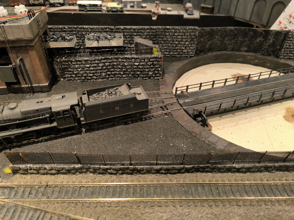

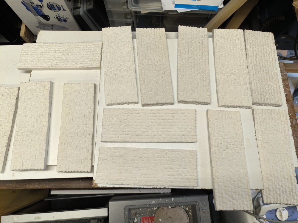

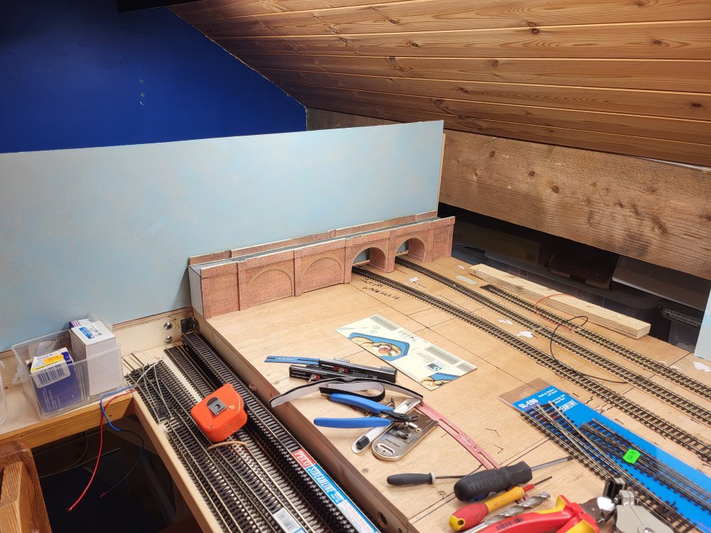

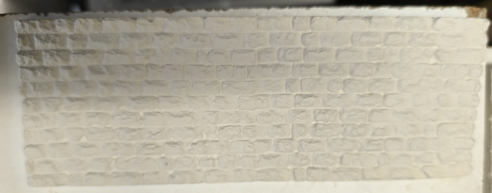

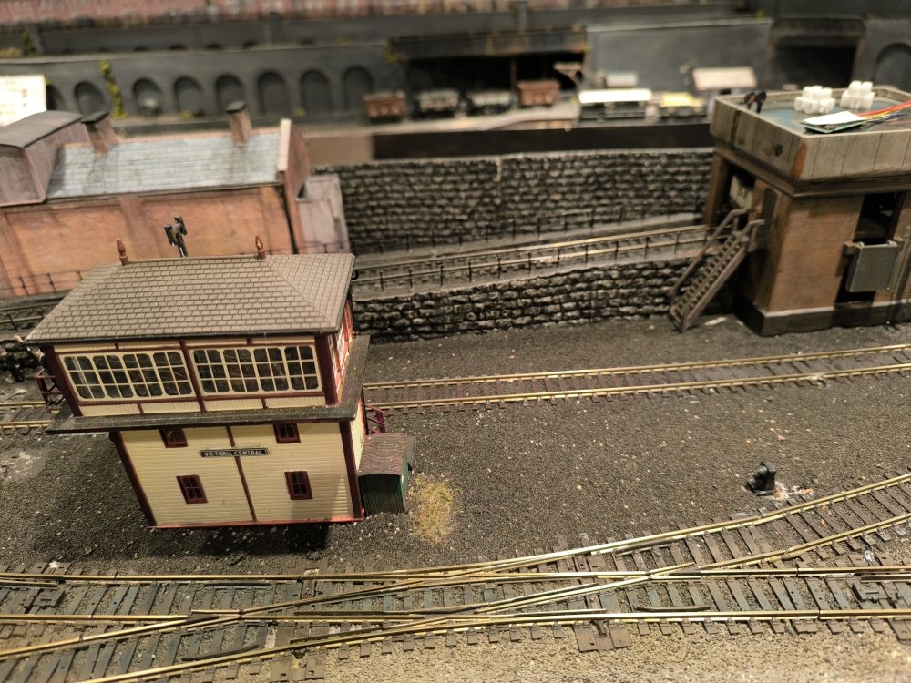

amdaley Posted August 3, 2025 Author Posted August 3, 2025 This weeks progress. Fitted a few more of the fiddle yard point motors. Only four left now to be fitted. Did some wall castings for the new layout. When dried out they can be cut to the required height & length. When finished painting they will look like the examples below from my other layout. ย 5

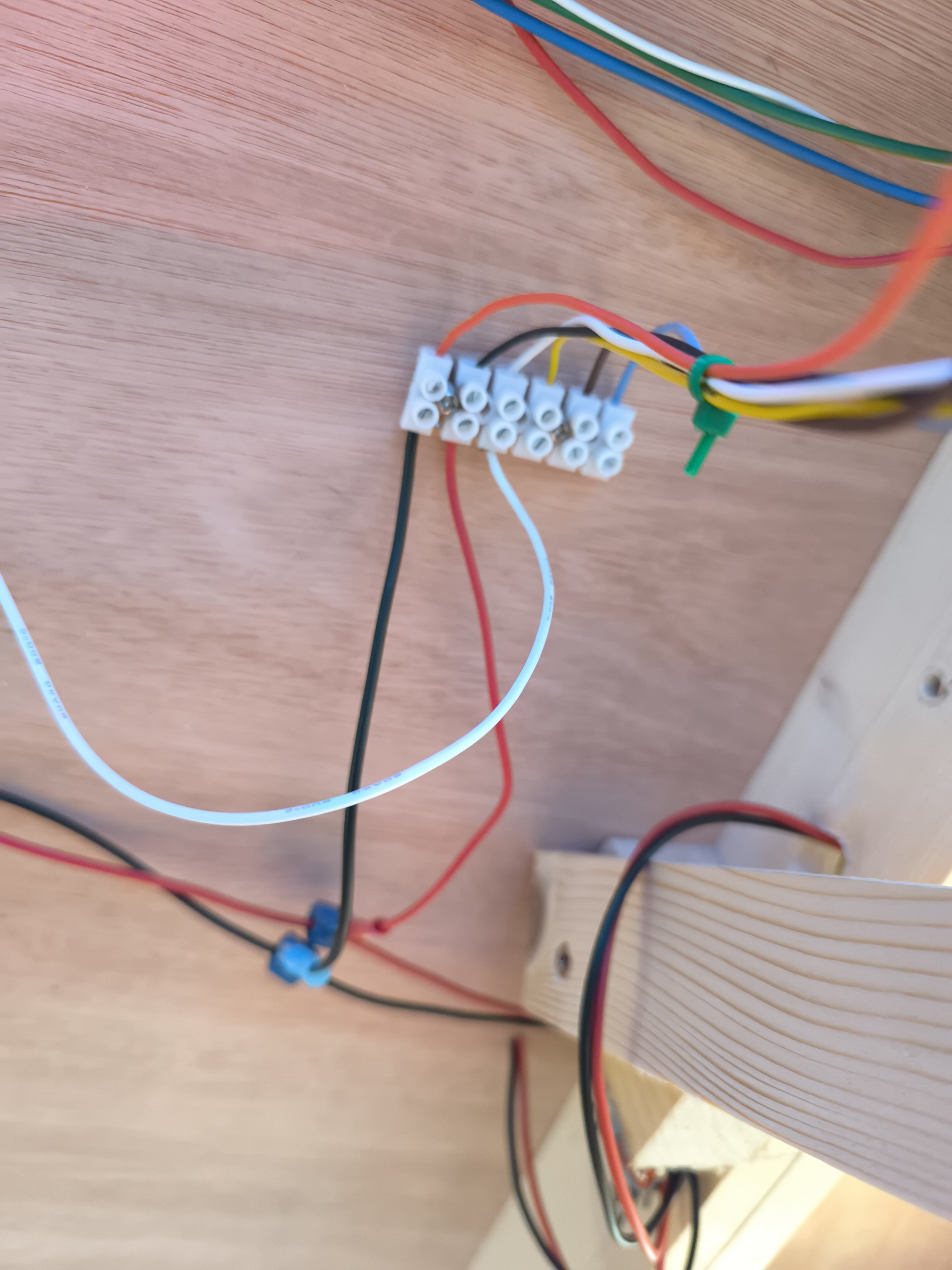

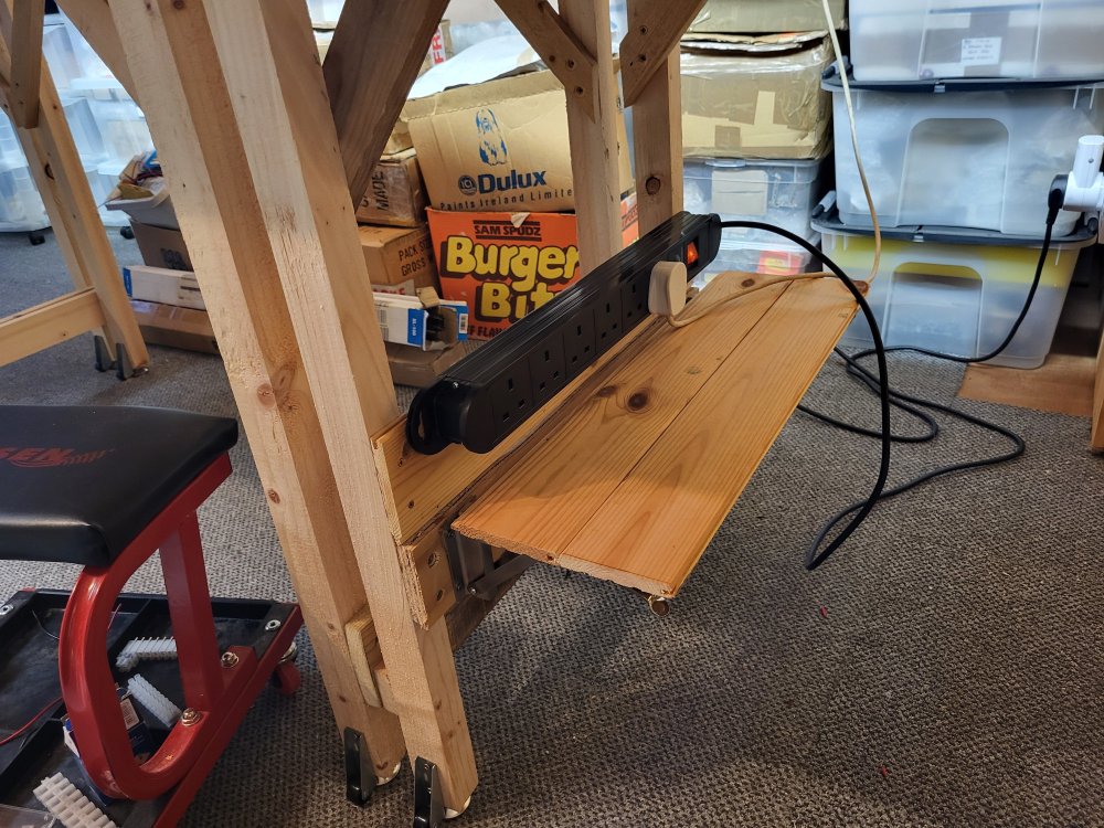

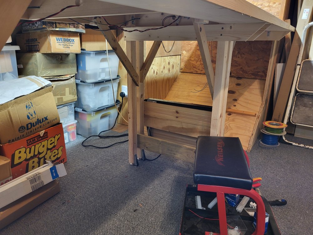

amdaley Posted August 19, 2025 Author Posted August 19, 2025 Nothing visible to report. Most of the work has been under the benchwork. I've installed an Accessory bus as its good to be able to change points if I get a short on the track & be able to fit other accessories without worrying about running out of power etc. Justย waiting for a Roco booster to arrive from Germany. It's coming by GLS but where I live GLS usually pass on any packages to a local courier so that would add extra time to the journey. ย In the meantime I've installed the Accessory bus & connected all point motors up to it. I've tested for shorts or any cross wiring & haven't found any. I connected up the DCC bus to the Z21 to make sure the supply to the track was ok. The frogs were dead which puzzled me until I realised that I had disconnected the point motors so of course the frogs were deadย ย Those of you who haven't yet reached over 70 don't laugh because it's coming for you tooย I looped the Accessory bus into the Dcc bus to test the point motors & everything works as expected. Tidied up some of the wiring & a few other bits so just waiting for the booster to arrive now in the next couple of days, hopefully. Once that's fitted I'll construct a few buildings & do a bit of scenic work. Tony. 2

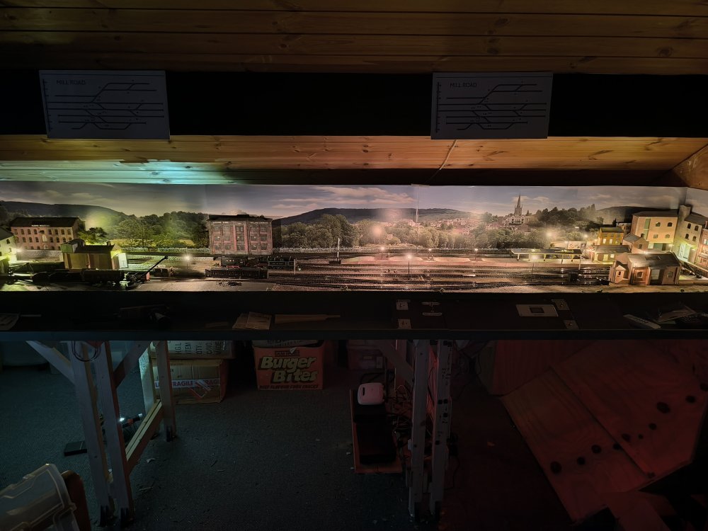

amdaley Posted September 10, 2025 Author Posted September 10, 2025 Suffering from sciatica at the moment so work on the layout is restricted. I did manage to construct a Mimic display panel for the fiddle yard so I can see the position of the points from the other end of the layout. Tony. ย 5

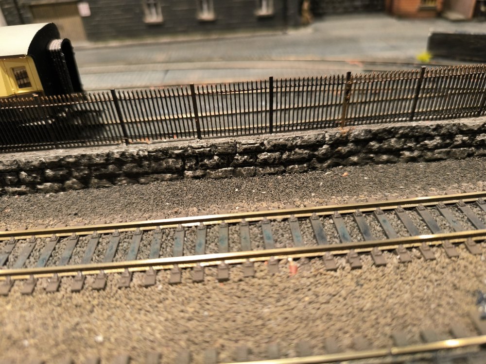

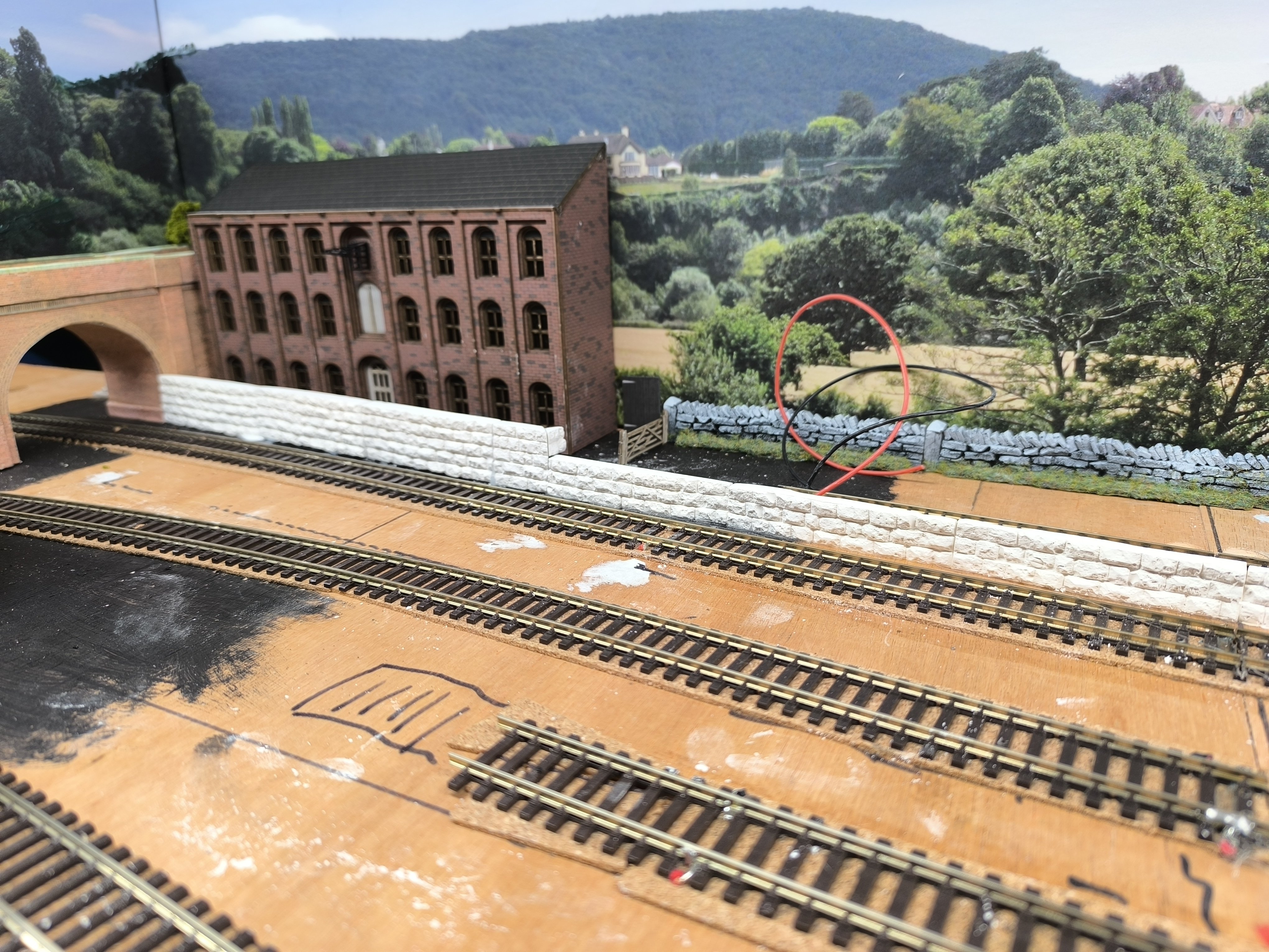

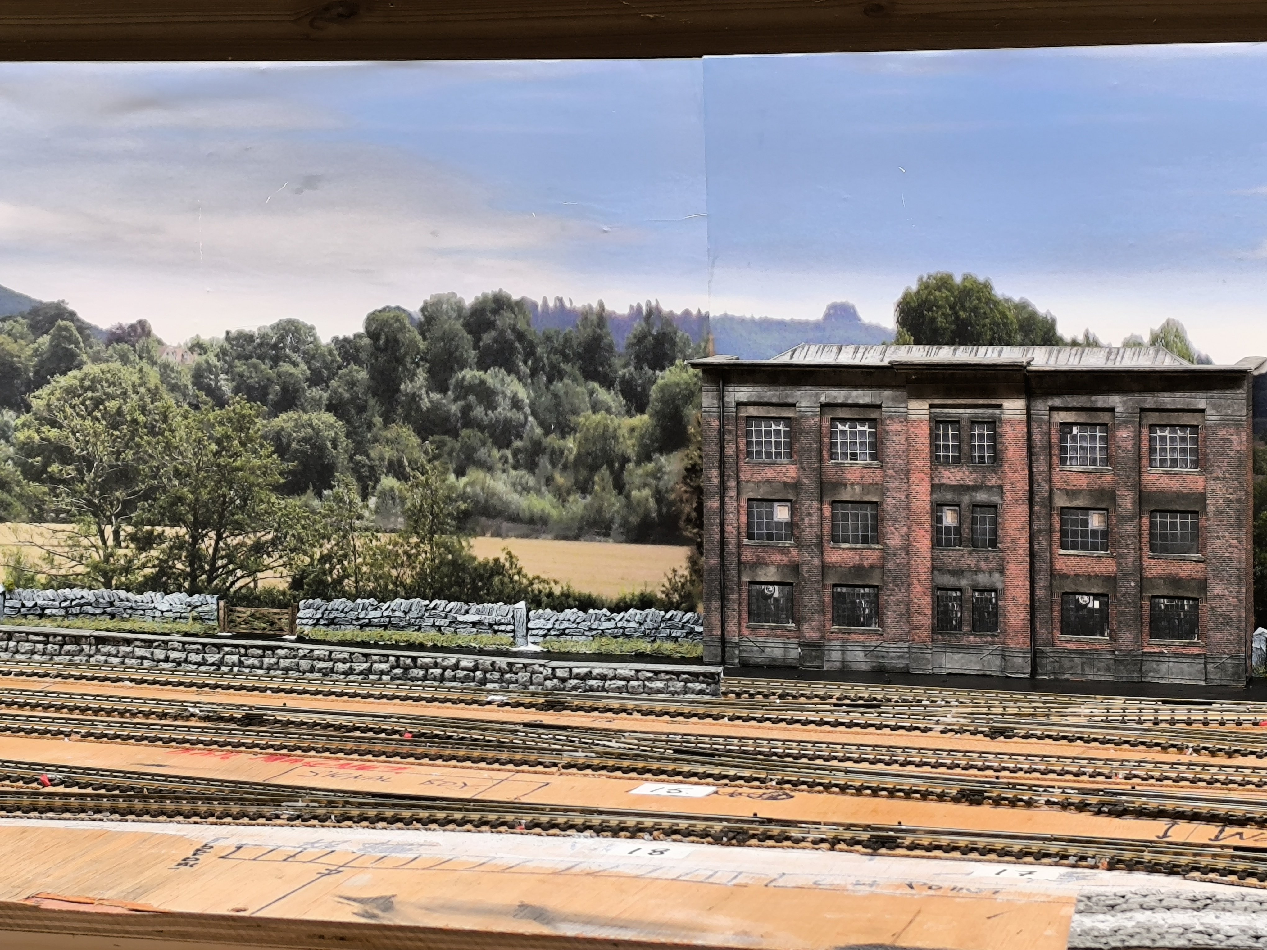

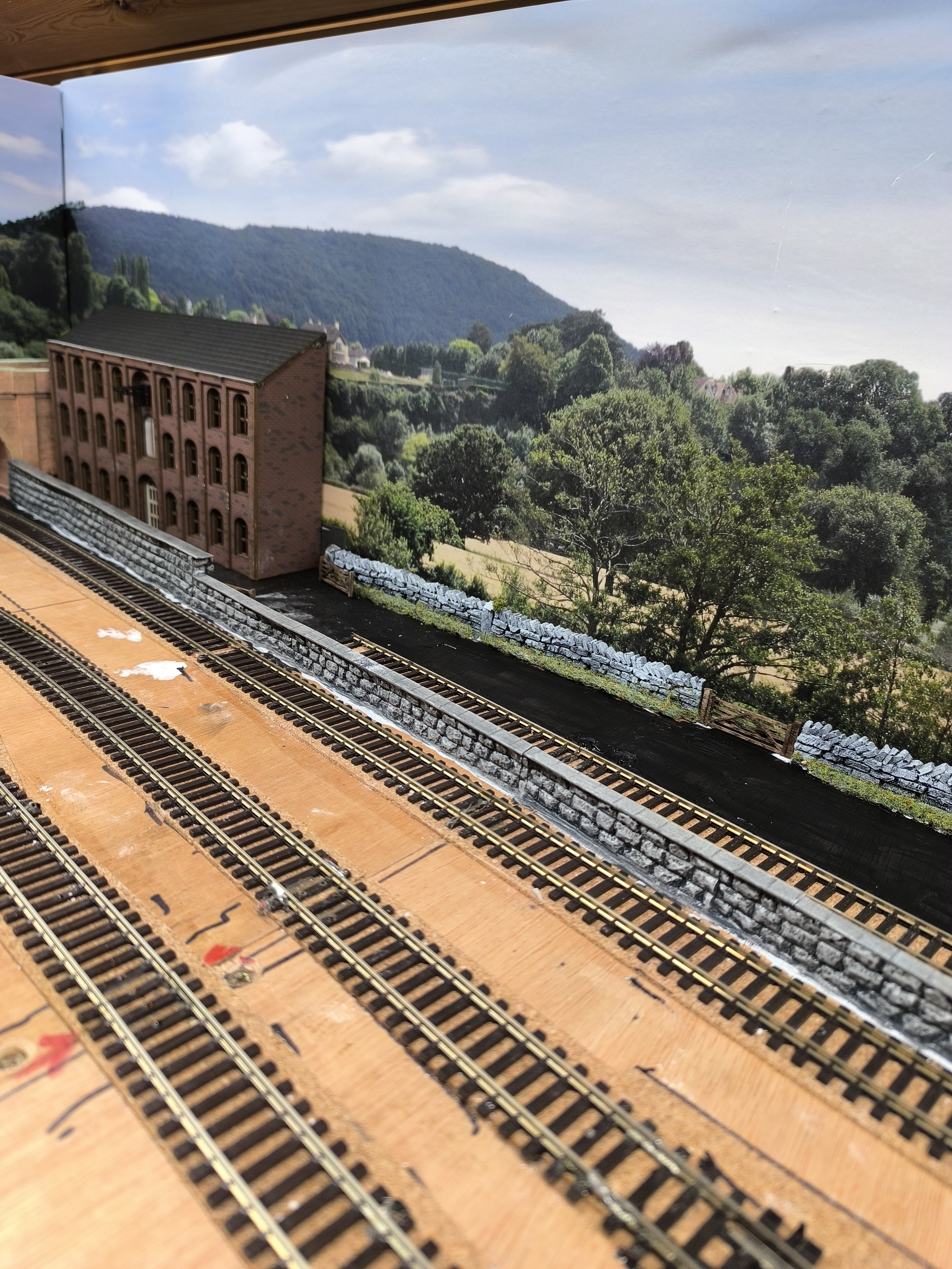

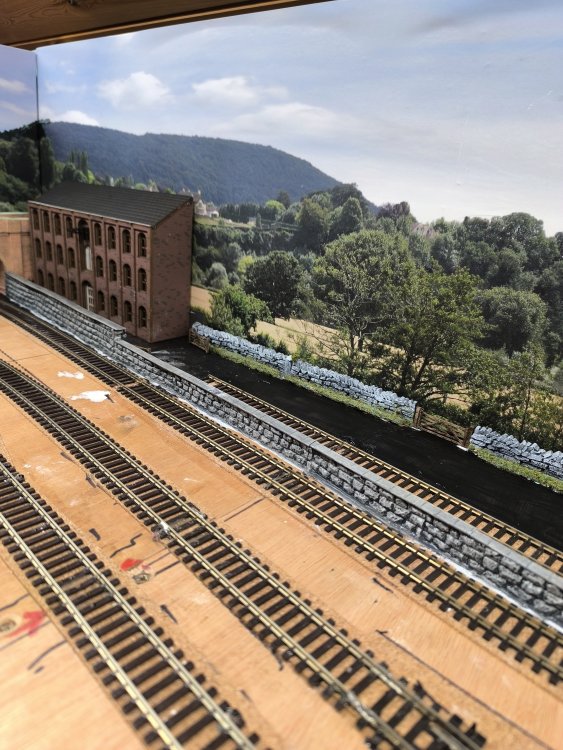

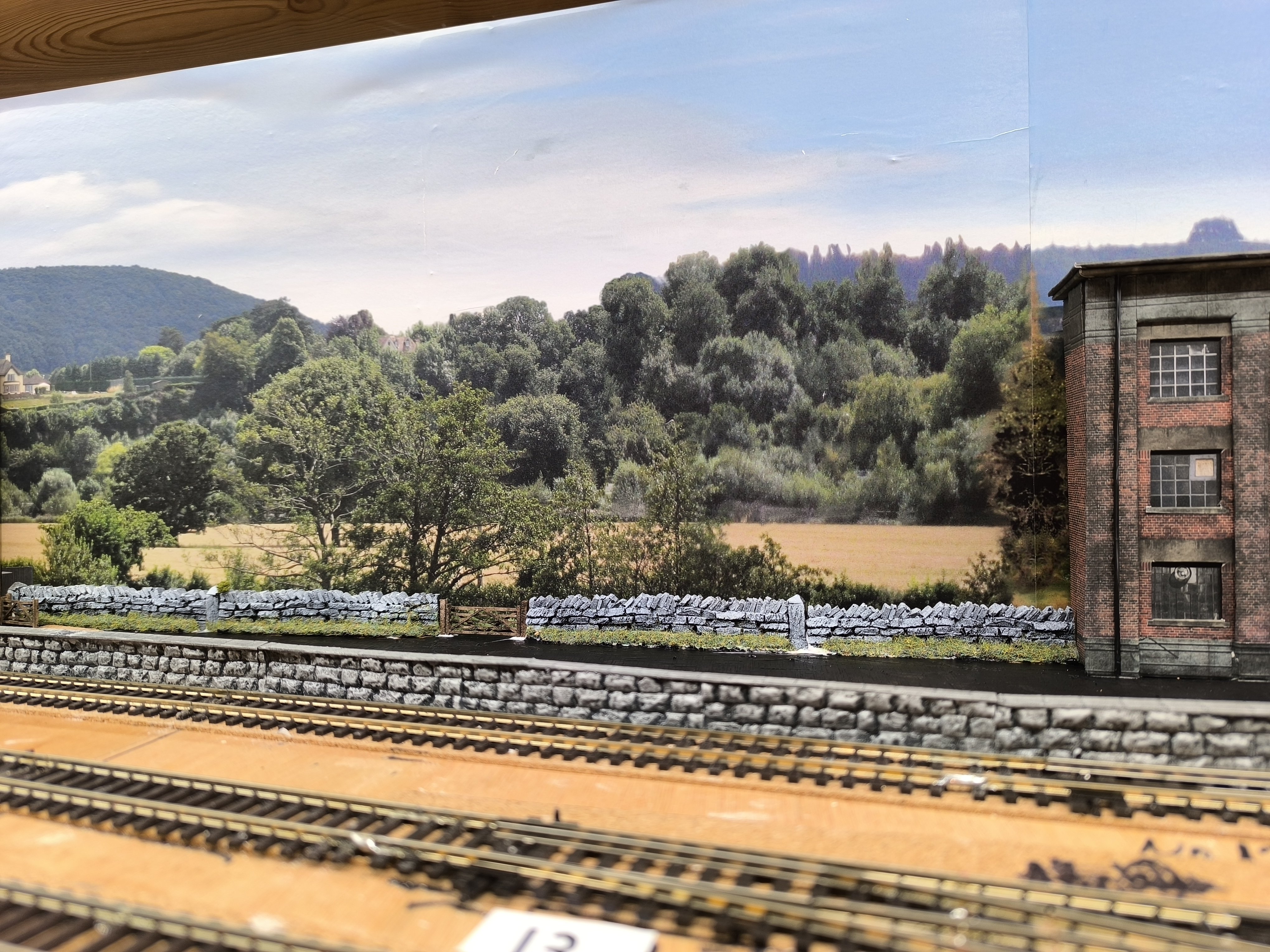

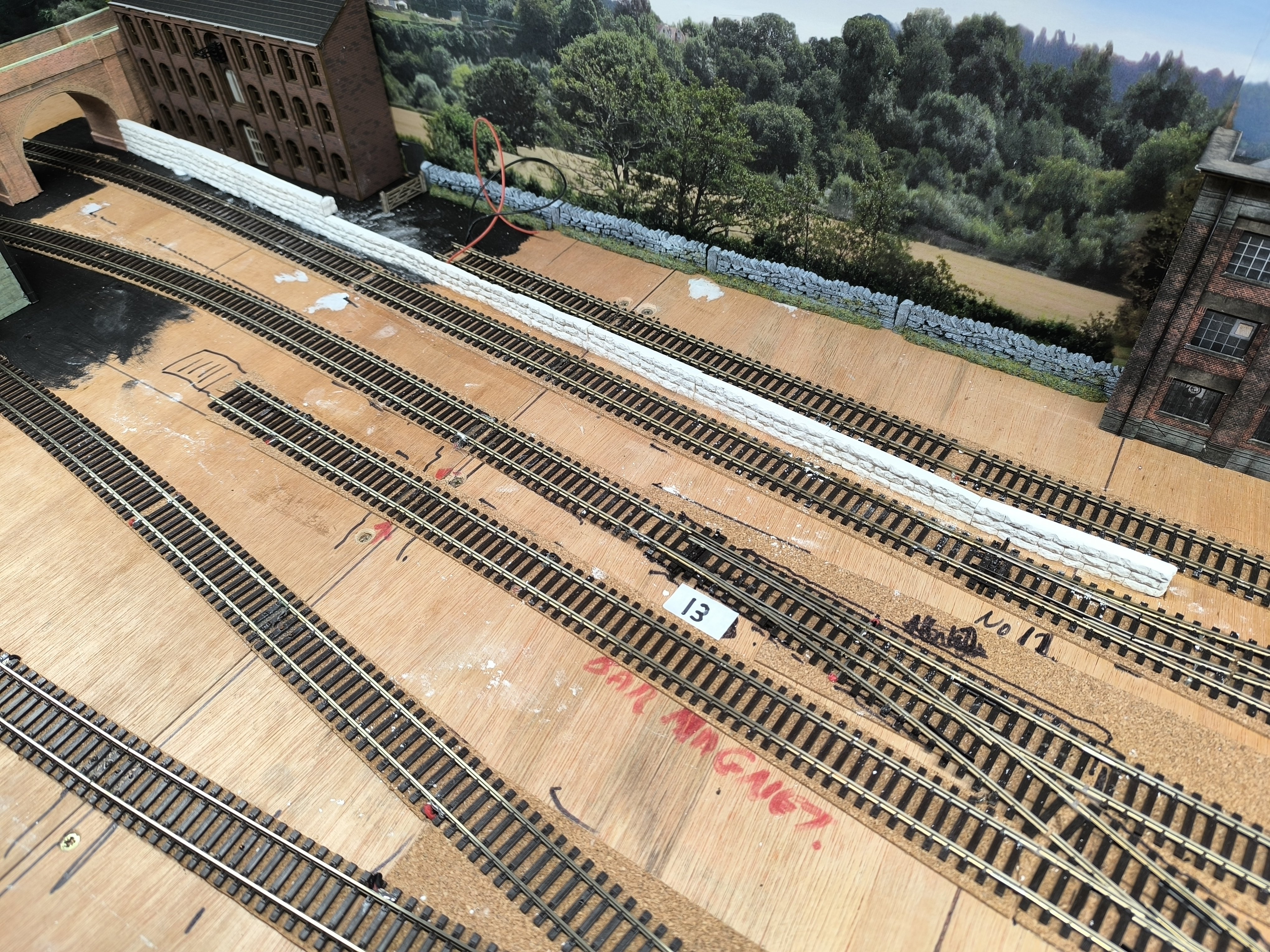

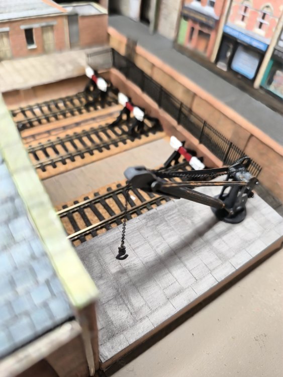

amdaley Posted October 1, 2025 Author Posted October 1, 2025 (edited) The Sciatica is improving slowly but its a bloody painful thing. I've used some of the wall panels I cast earlier to do some scenic work. Here is the walling I installed before any painting. ย And here it is after I'd done some painting work on it. I may put some railings on the lower walls. I'll decide later. The walls at the back are Javis Dry stone roadside walls which I left a little proud of the backscene to give a bit more depth. I'll do some more when time permits. Tony. Edited October 1, 2025 by amdaley 12
Flying Snail Posted October 2, 2025 Posted October 2, 2025 11 hours ago, amdaley said: The walls at the back are Javis Dry stone roadside walls which I left a little proud of the backscene to give a bit more depth. It's really effective - you can see the effect through the pictures 1

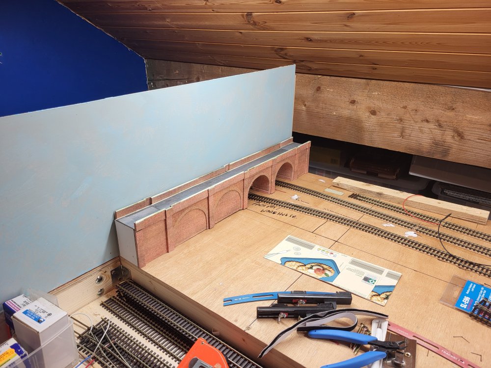

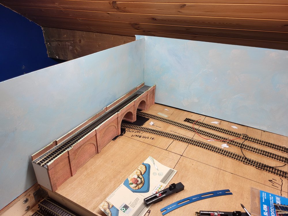

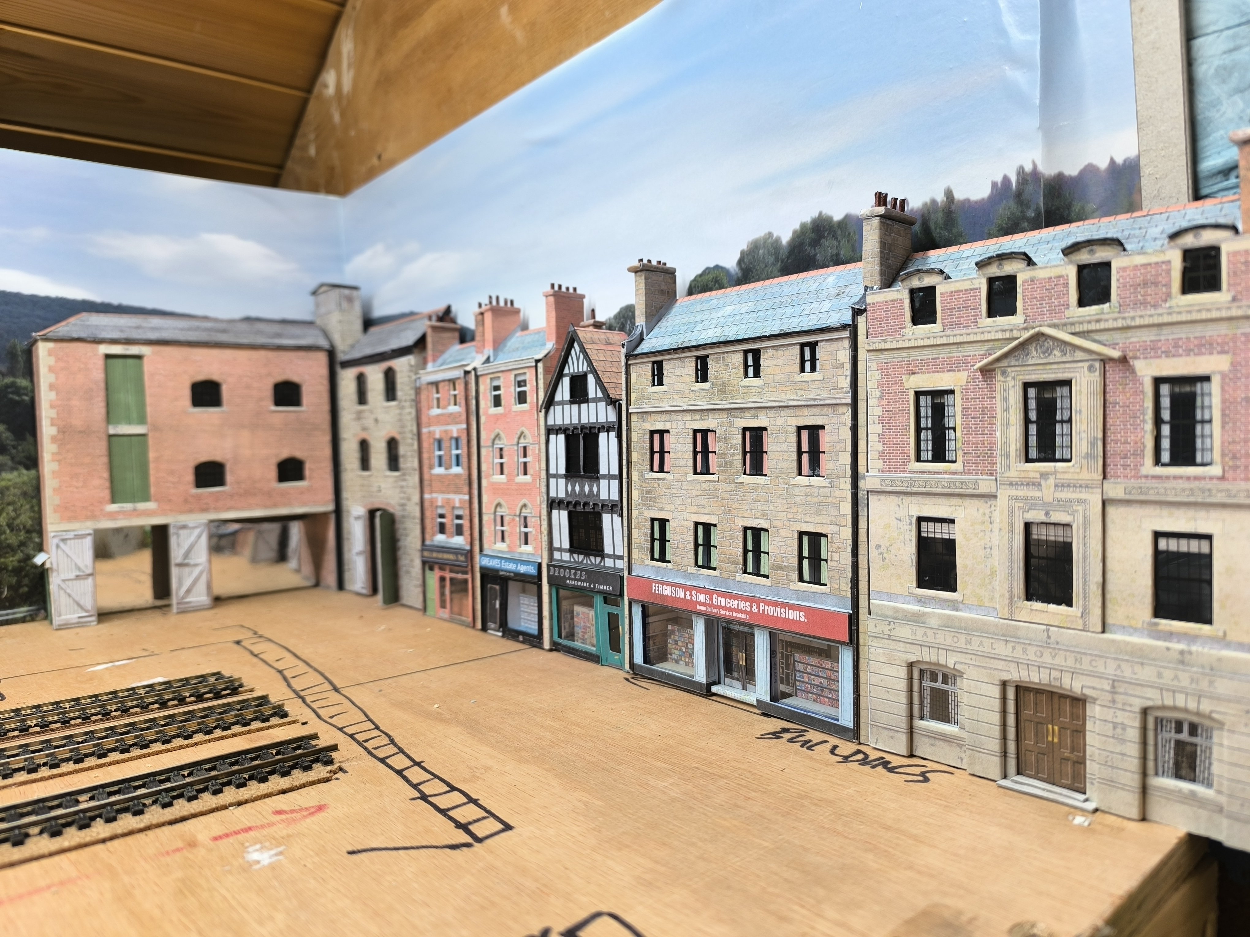

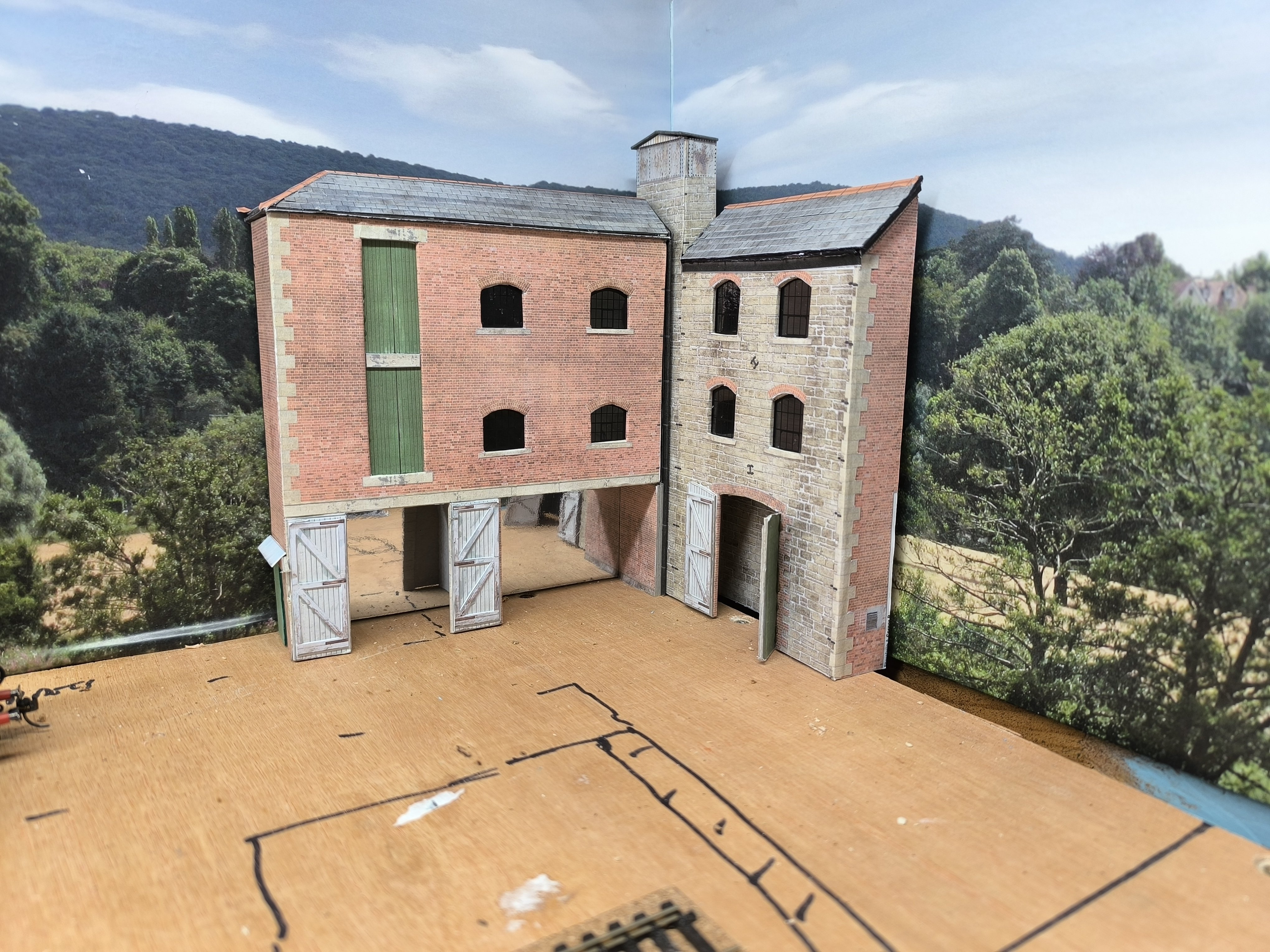

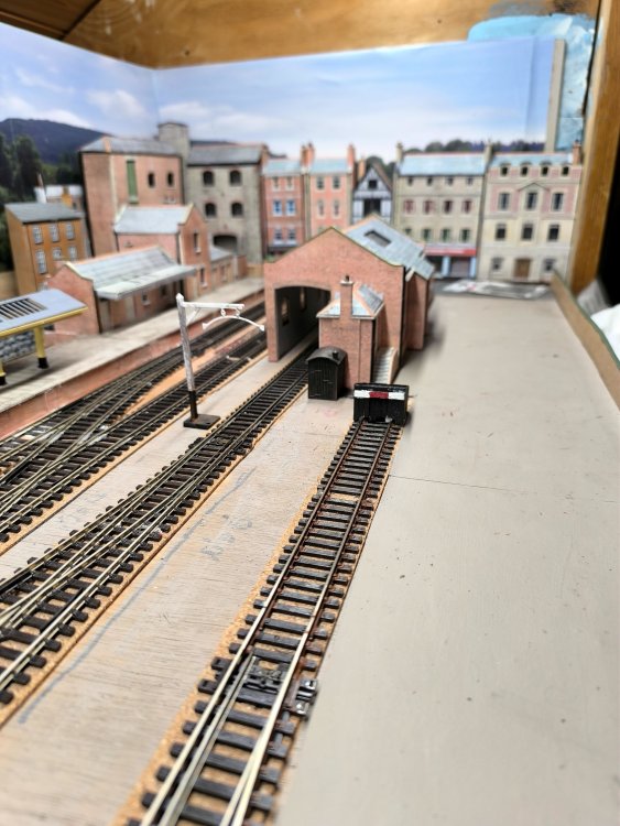

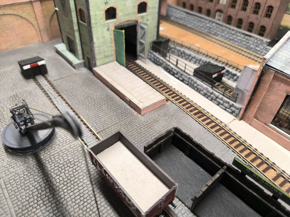

amdaley Posted October 25, 2025 Author Posted October 25, 2025 A couple of buildings from the Scalescenes Box file layout reworked & repurposed to fill a corner.ย 9

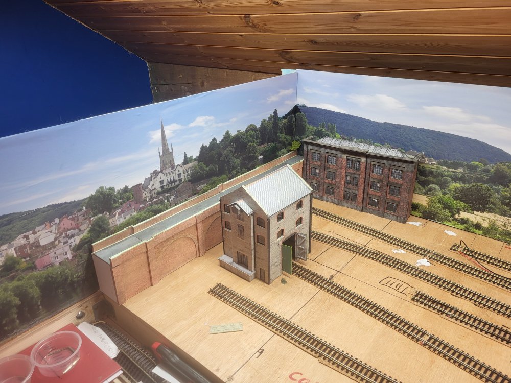

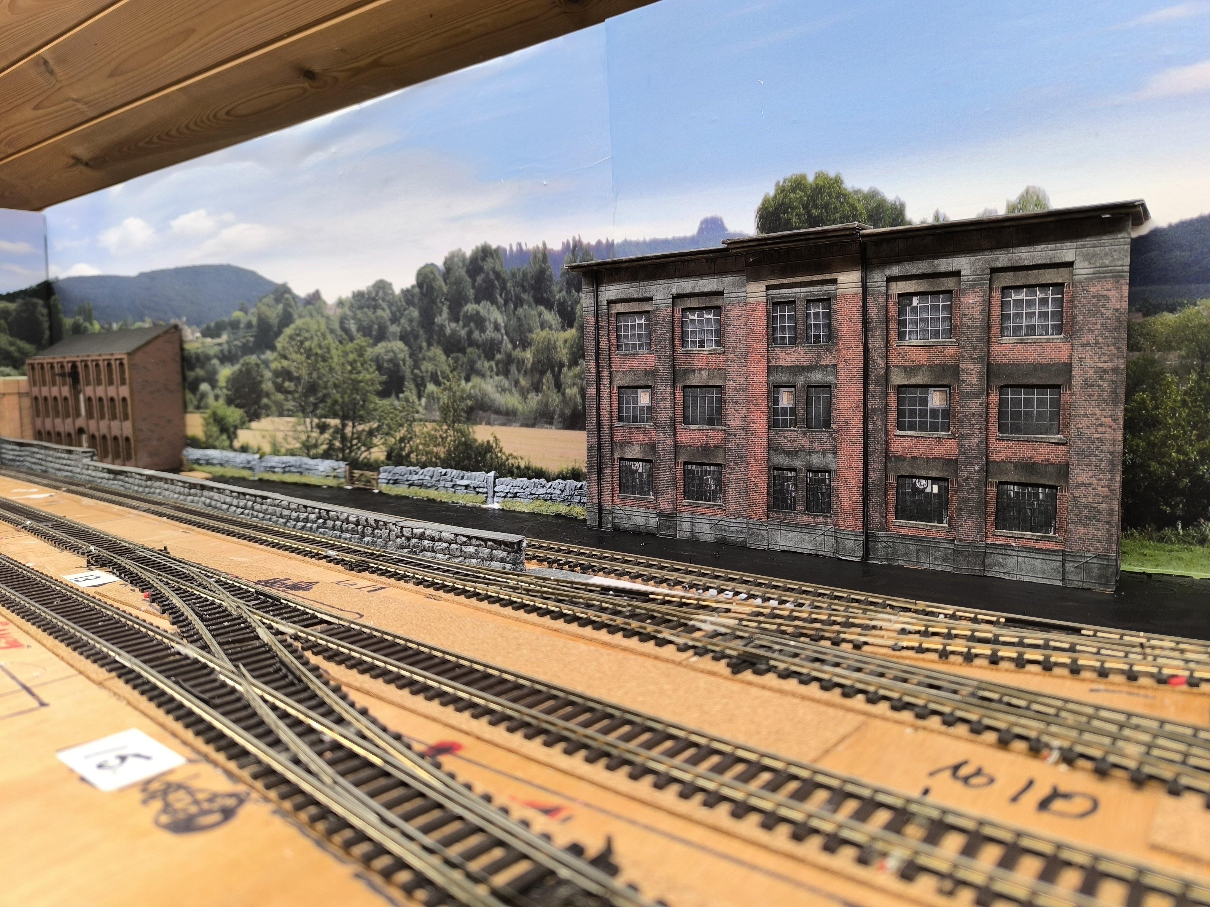

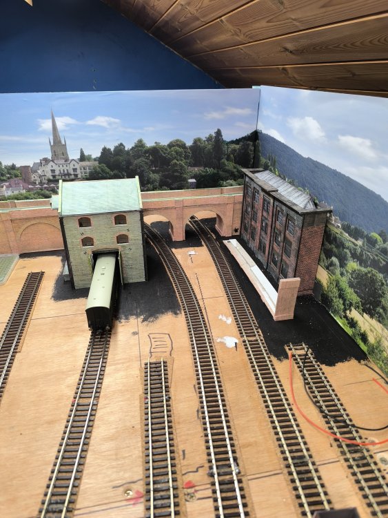

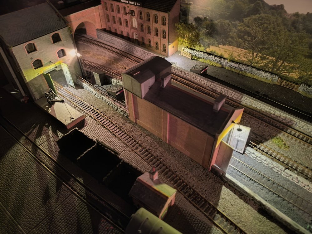

amdaley Posted November 23, 2025 Author Posted November 23, 2025 End wall buildings now in place. Back wall is next. ย 10 1
Flying Snail Posted November 23, 2025 Posted November 23, 2025 The buildings are really good. lots of good detail in there! 1
Patrick Davey Posted November 23, 2025 Posted November 23, 2025 Superb! Great blend of the buildings, very realistic 1
