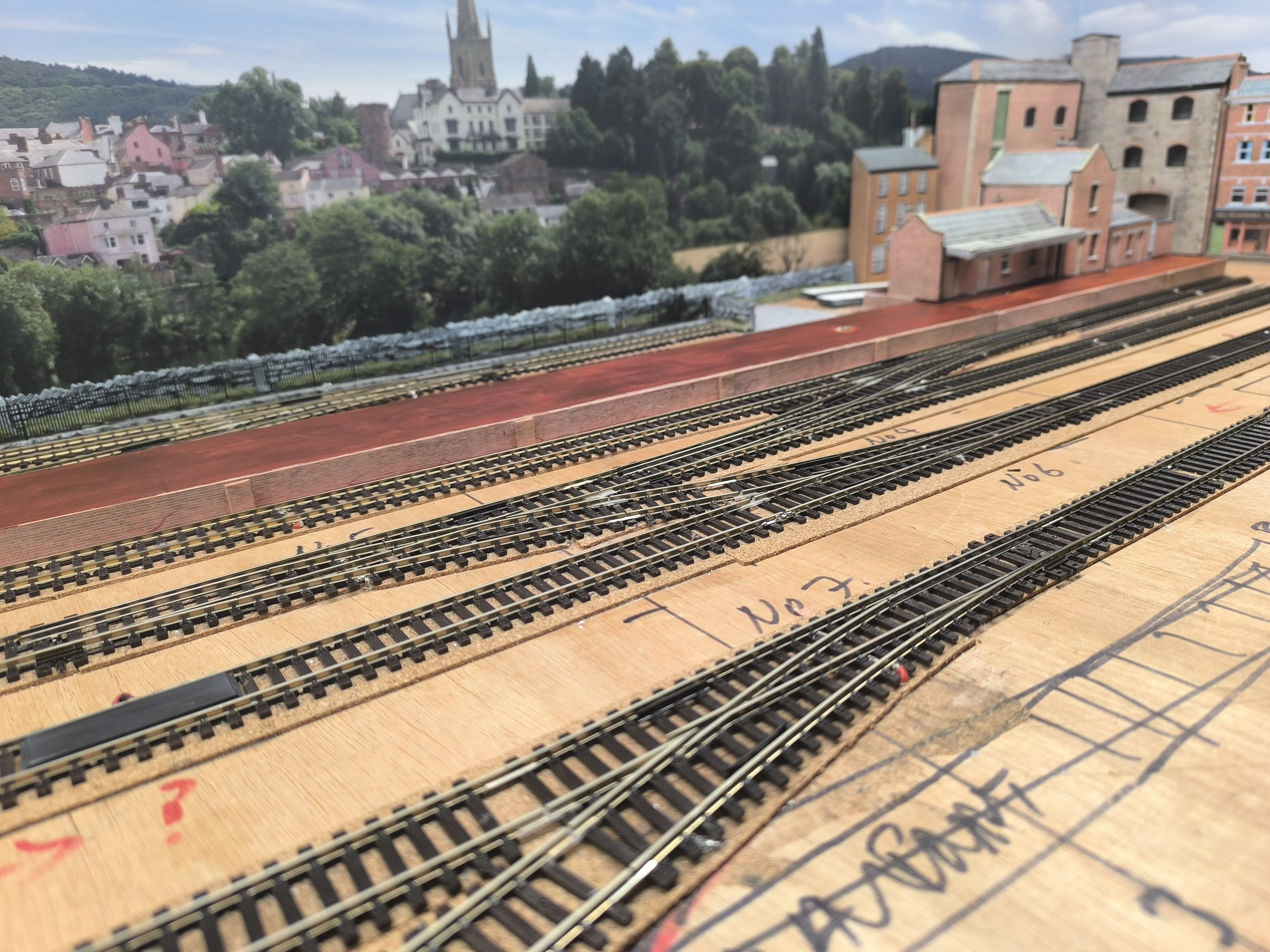

IMG_20251204_231313.thumb.jpg.f524a658588d63572f76bbd320f007c1.jpgI was supposed to do some electrical work under the layout but gave into temptation & did some scenery work instead.
Here are a few photos of work done to the back wall & right hand end of the layout.
Electrical work is definitely next on the list.

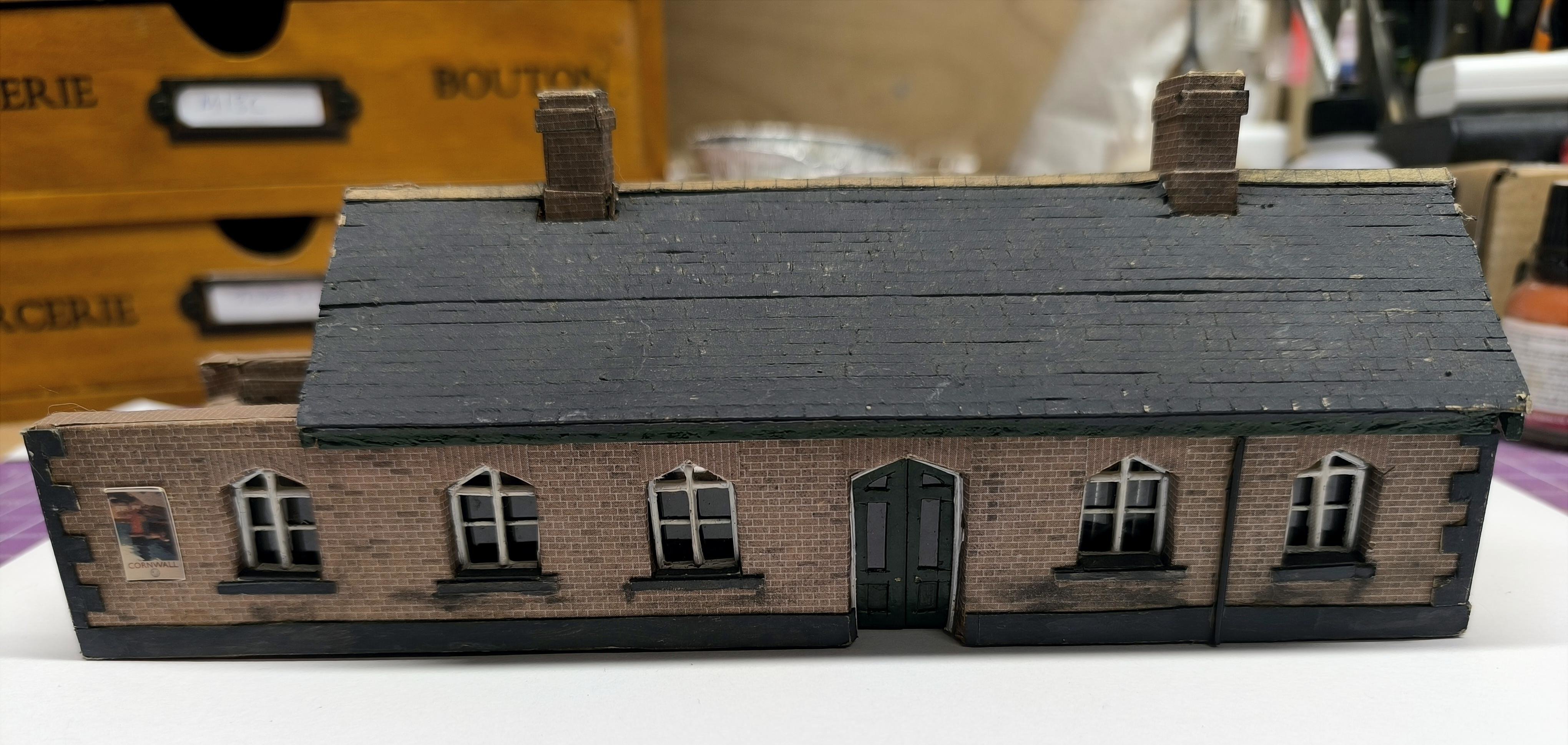

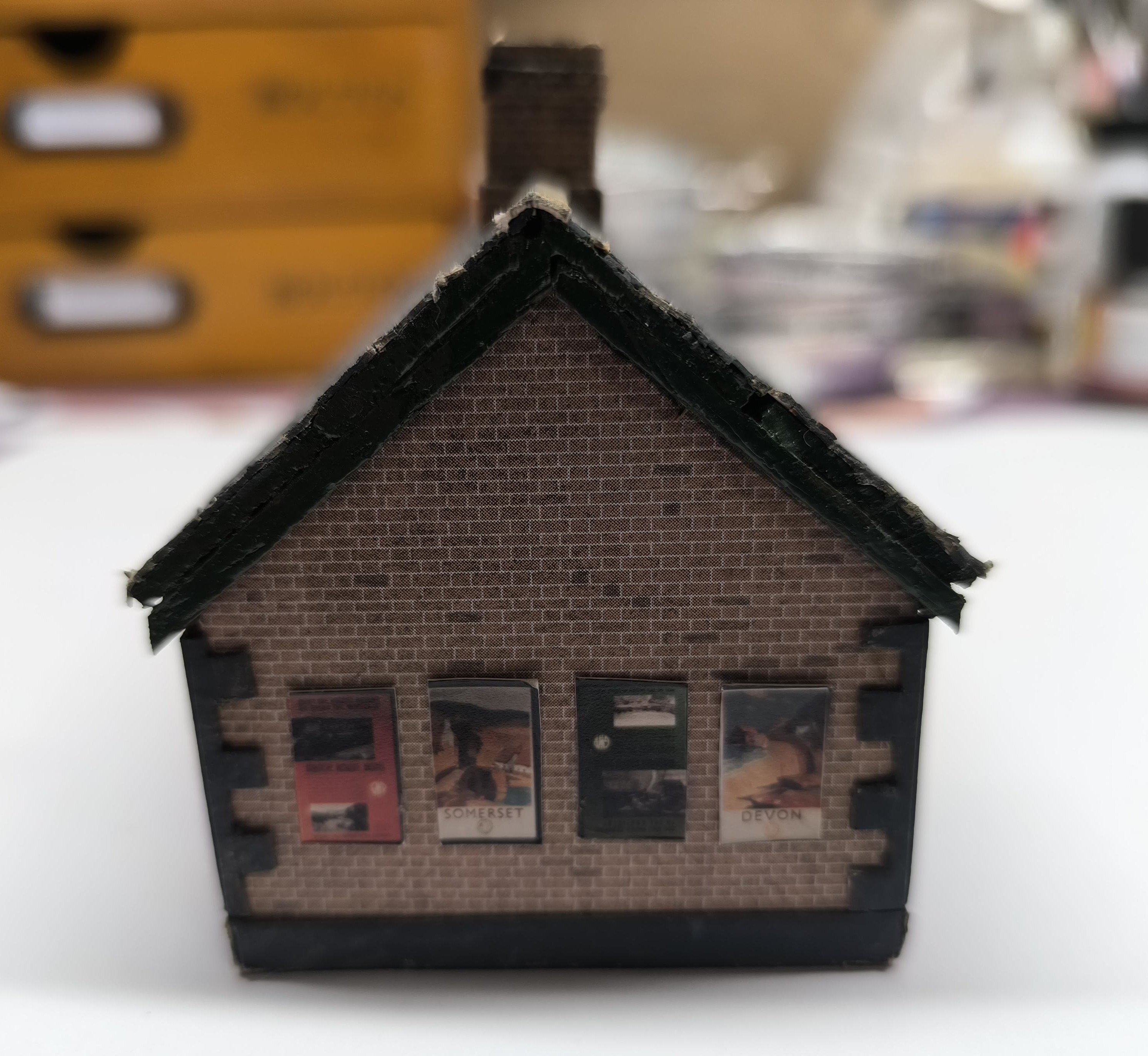

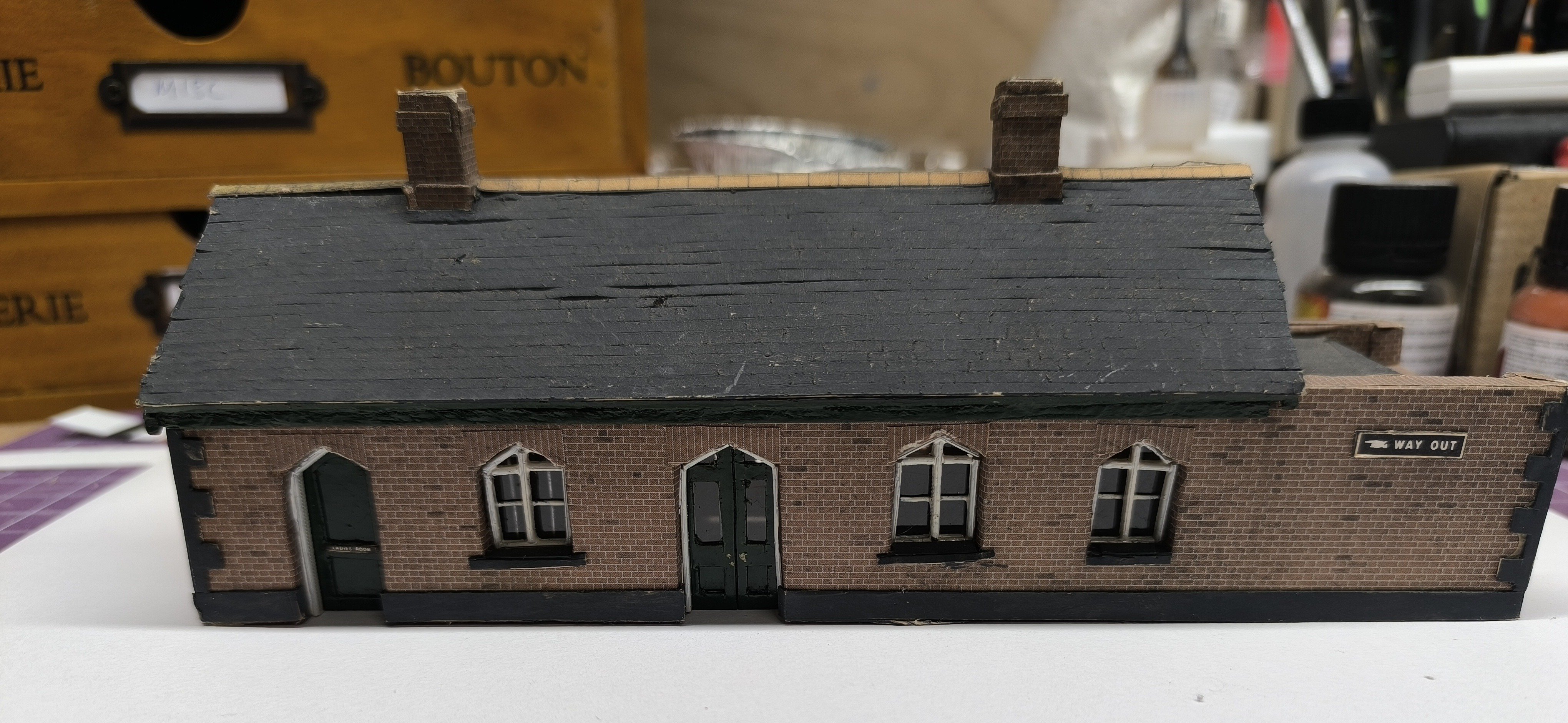

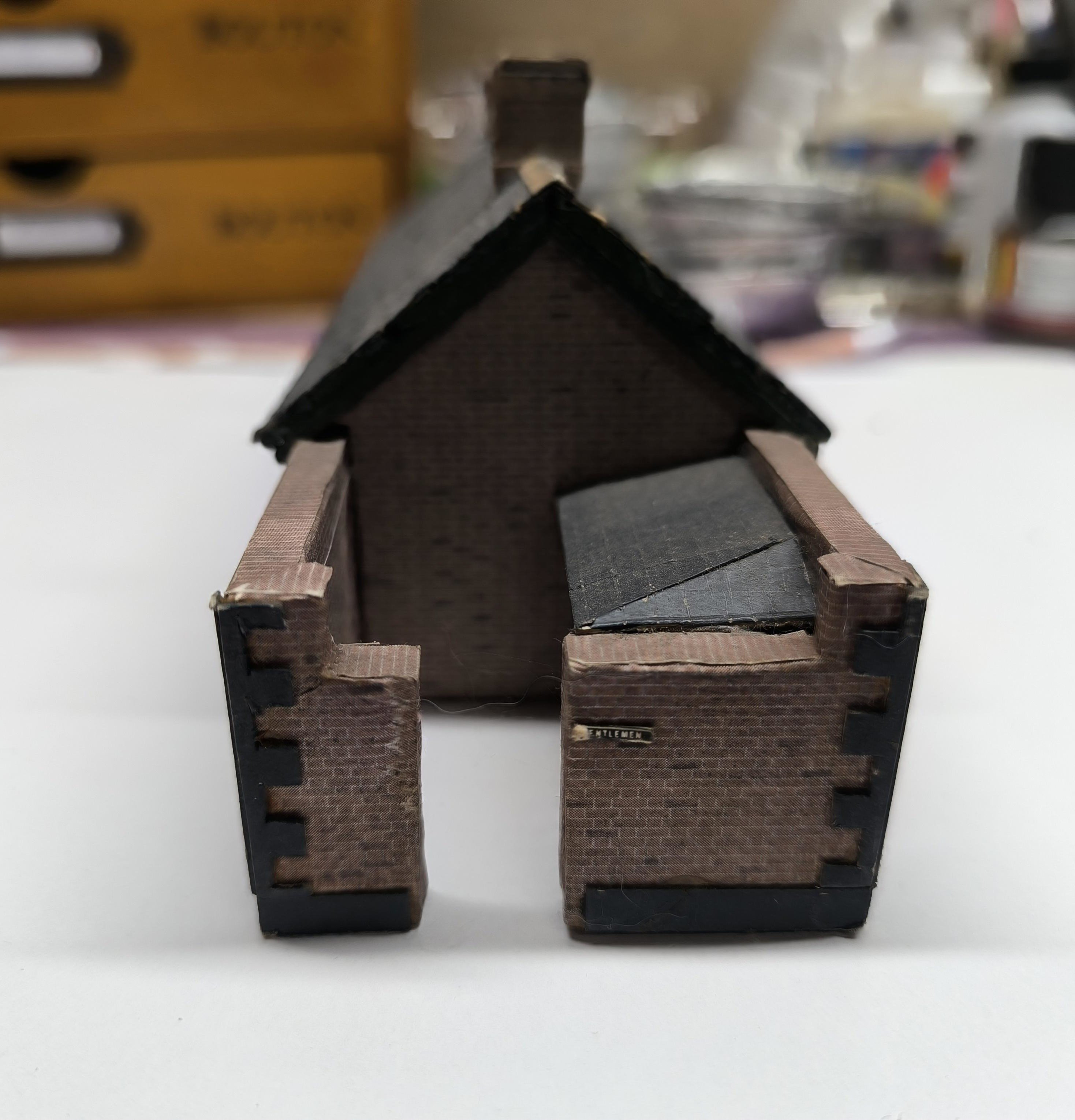

All electrical work is finished (I hope) so I started on the station buildings.
There will have to be platforms of course 🙂

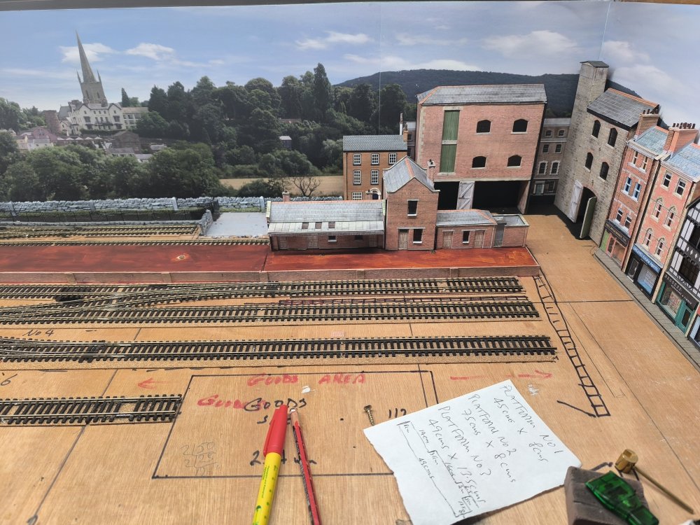

Platform made. Still needs surfacing but at least a start.
Next up is the goods shed.

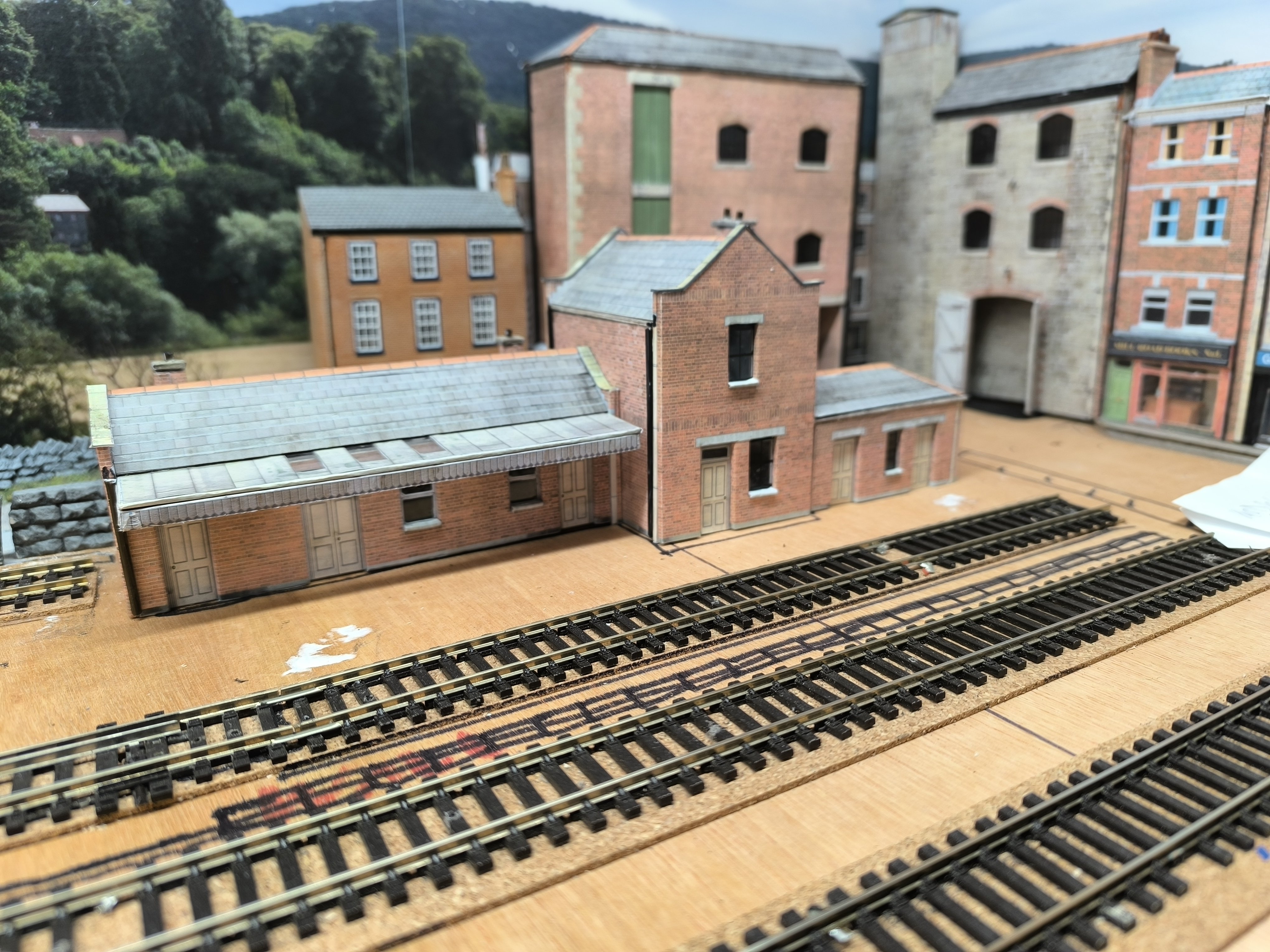

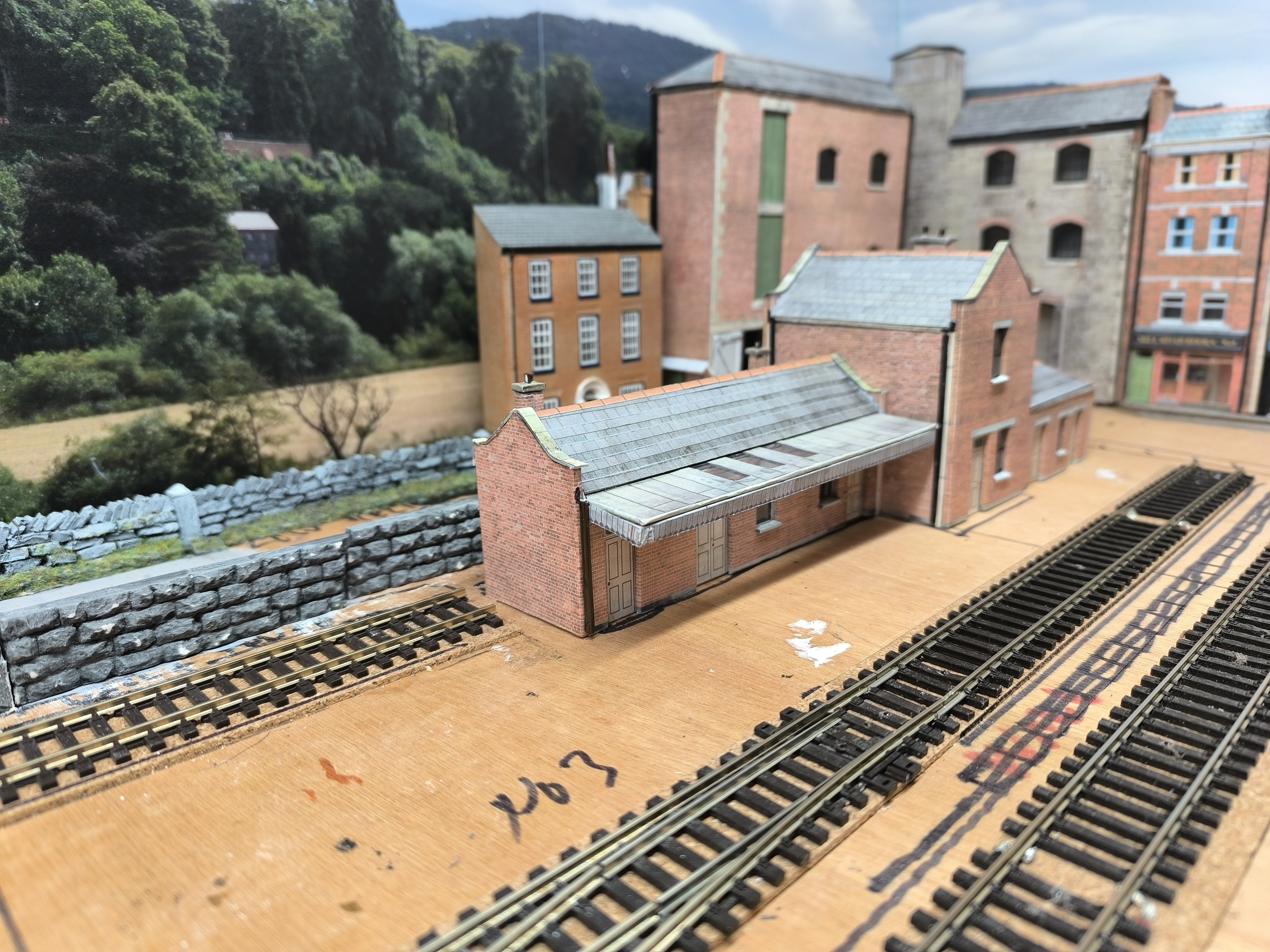

Have you made any progress ?

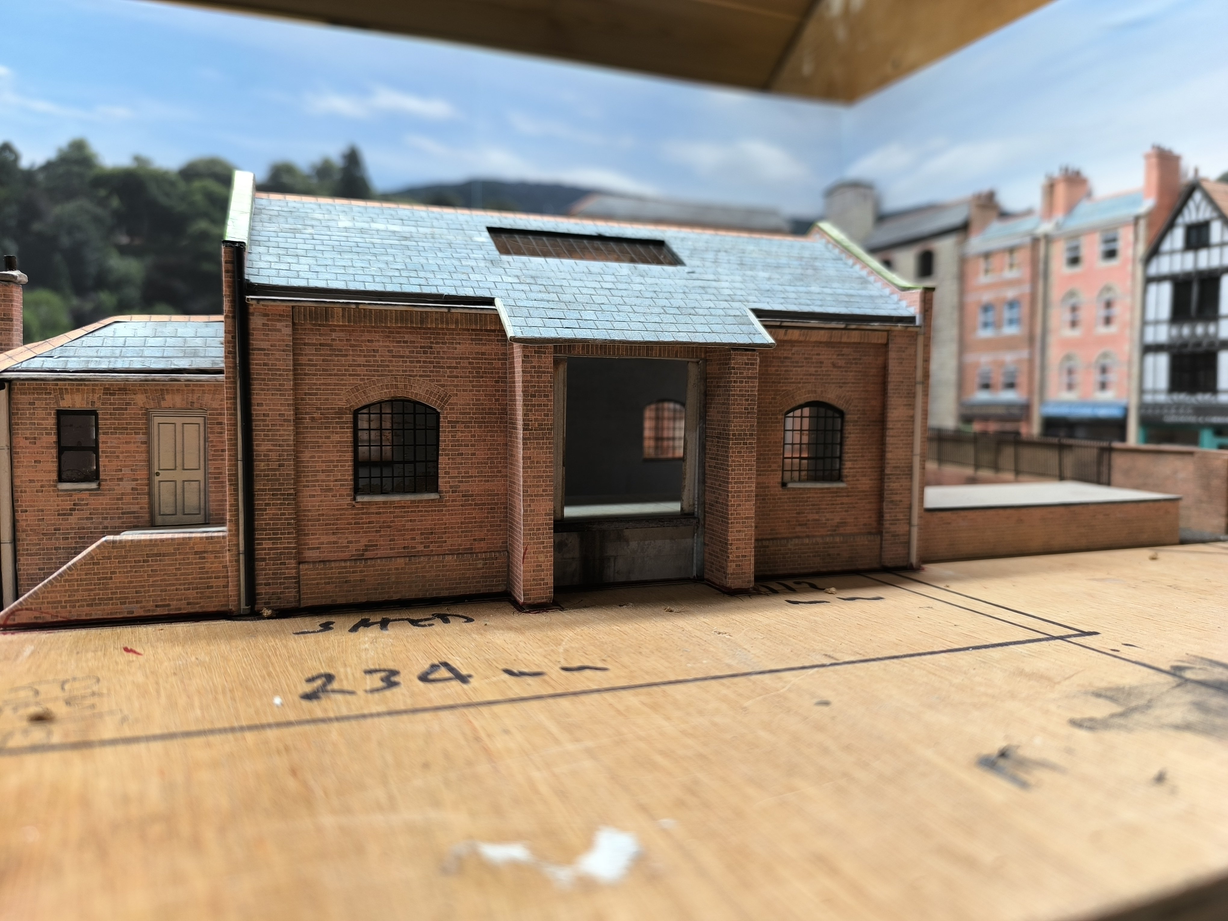

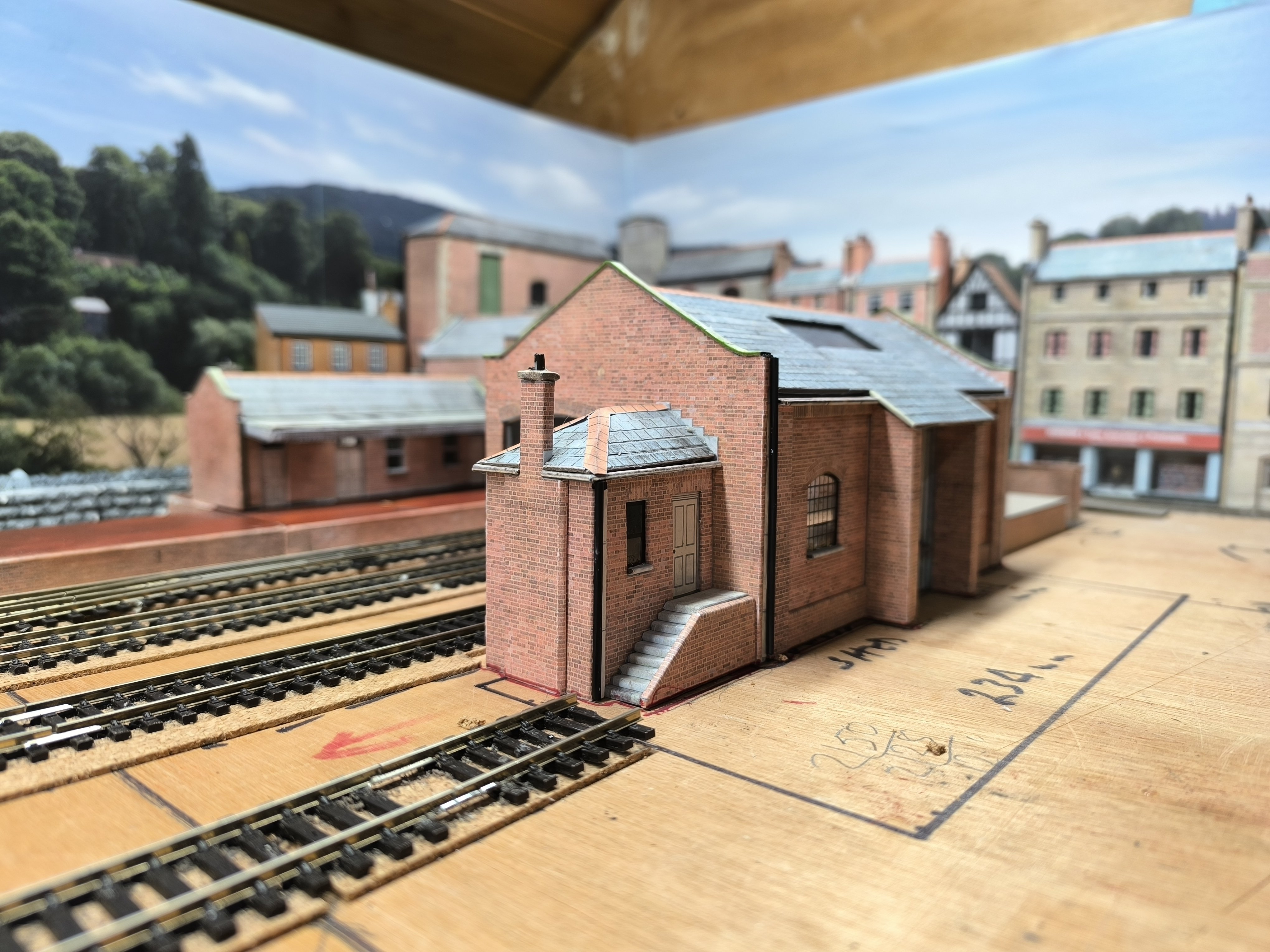

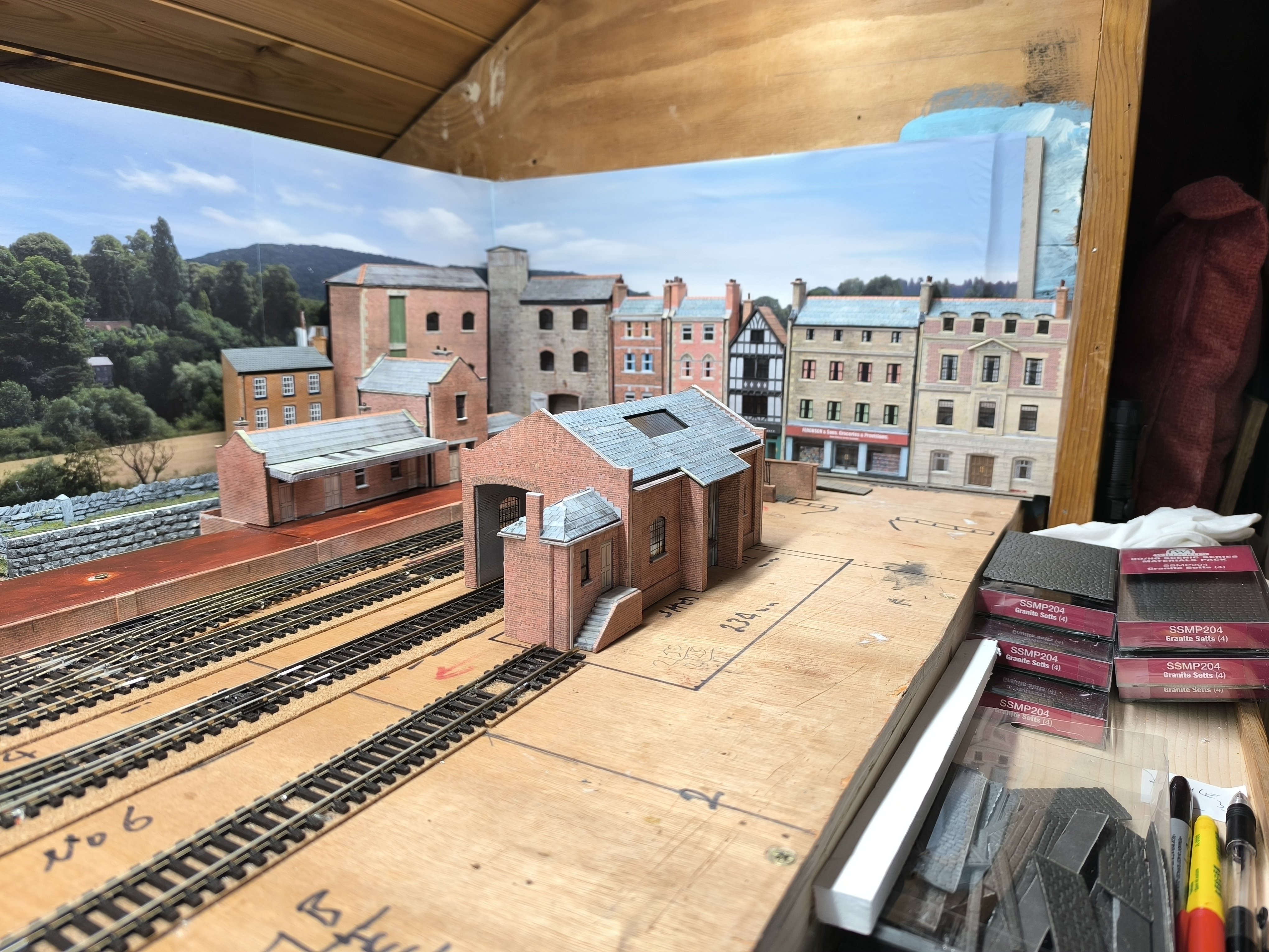

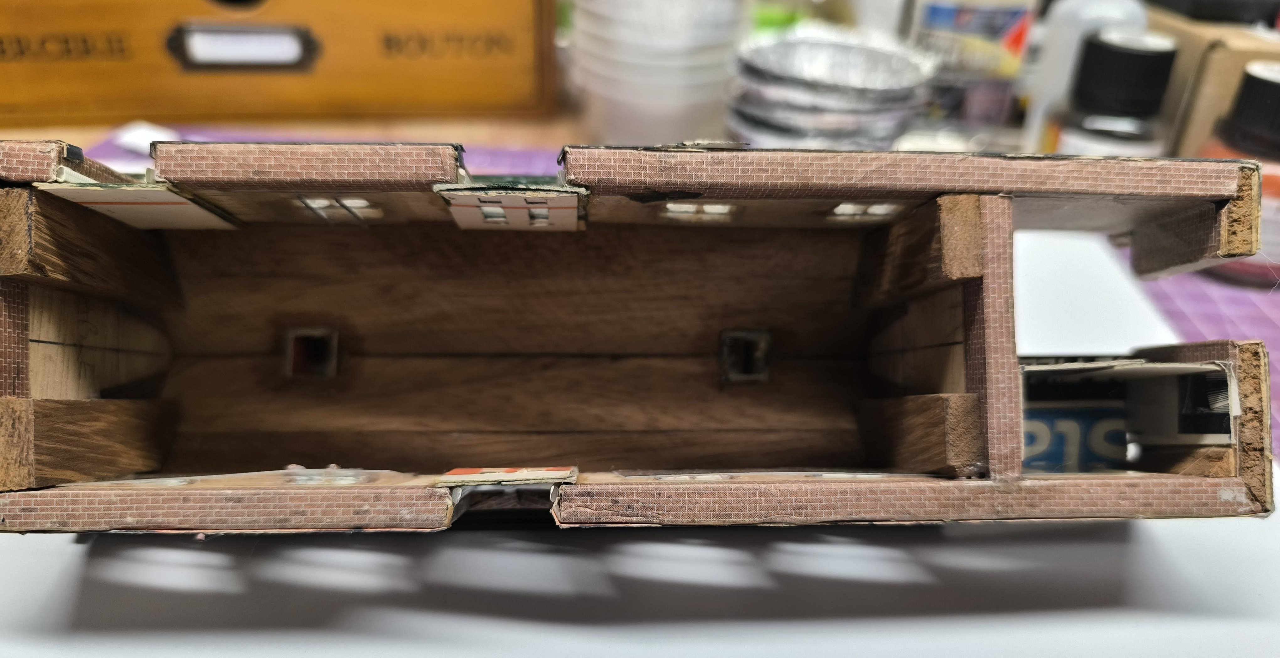

Goods shed is built. None of the buildings are fixed in place so can still be adjusted.
I think I'll do a small engine shed next.
IMG_20260218_175619.thumb.jpg.d232a45f71f80495eedeb76b6449a47e.jpgIMG_20260219_185346.thumb.jpg.25401bbf6293a2732eaff250403d14cb.jpgIMG_20260219_185355.thumb.jpg.54ea7aac691da627c0f43b9b3cbf642b.jpgIMG_20260219_185447.thumb.jpg.10ca3c7c32bb15bc8578b1aec39ea1d2.jpg
  • Like 18

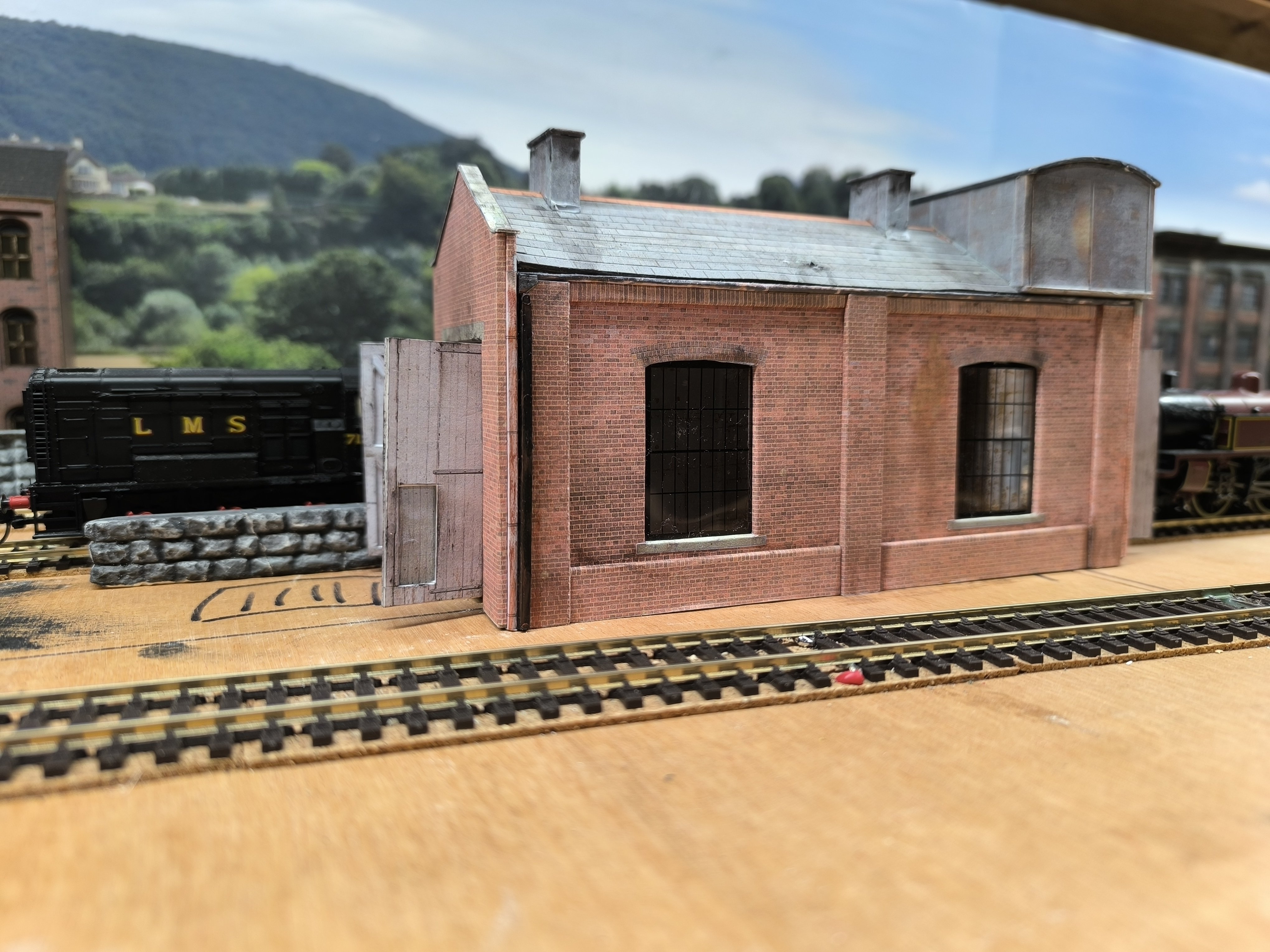

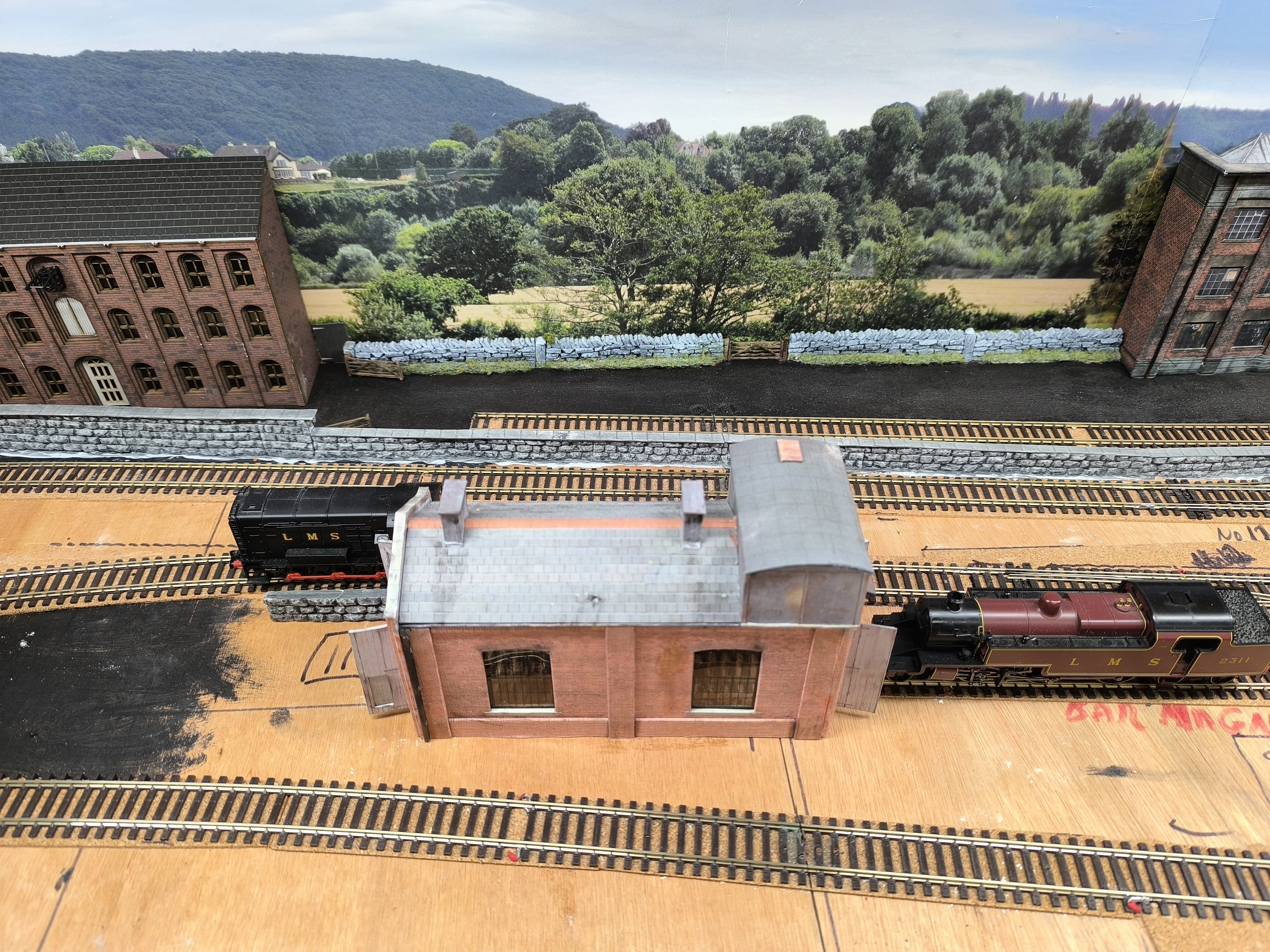

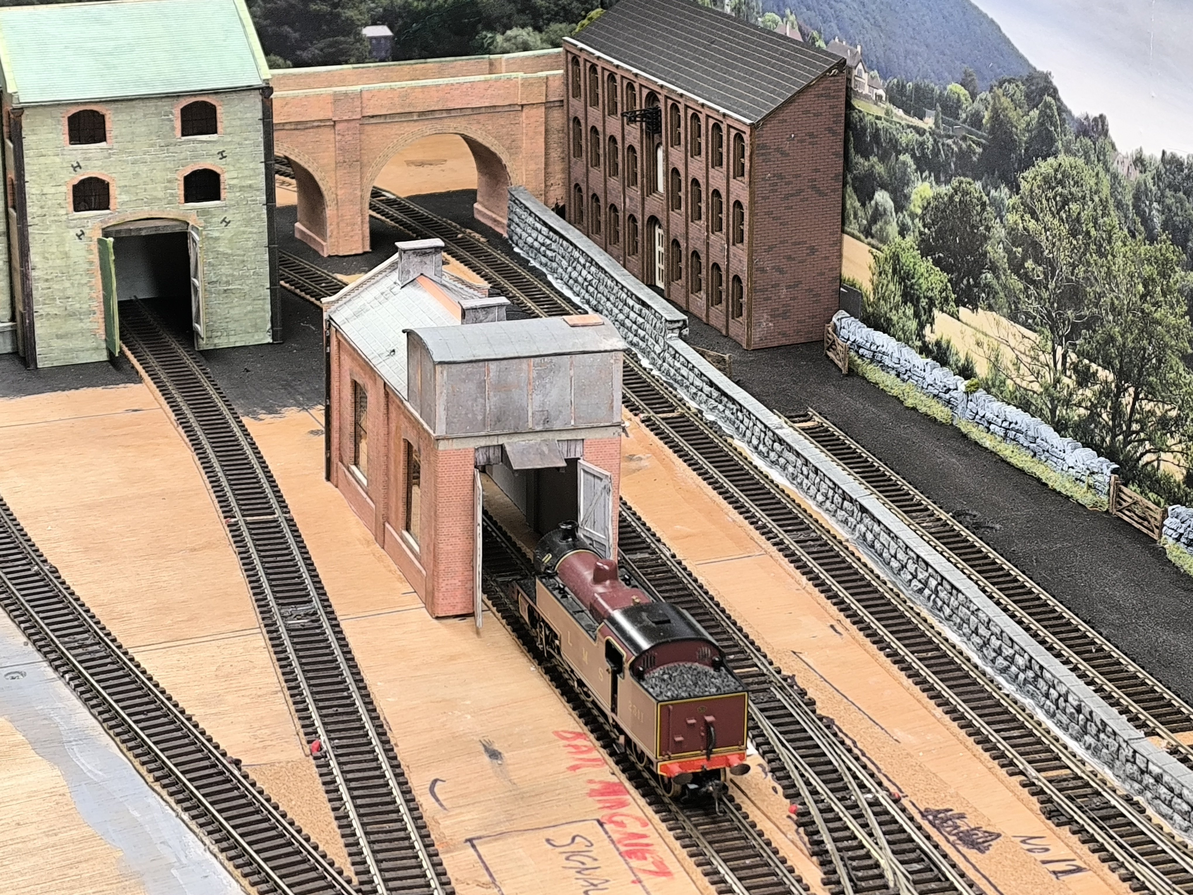

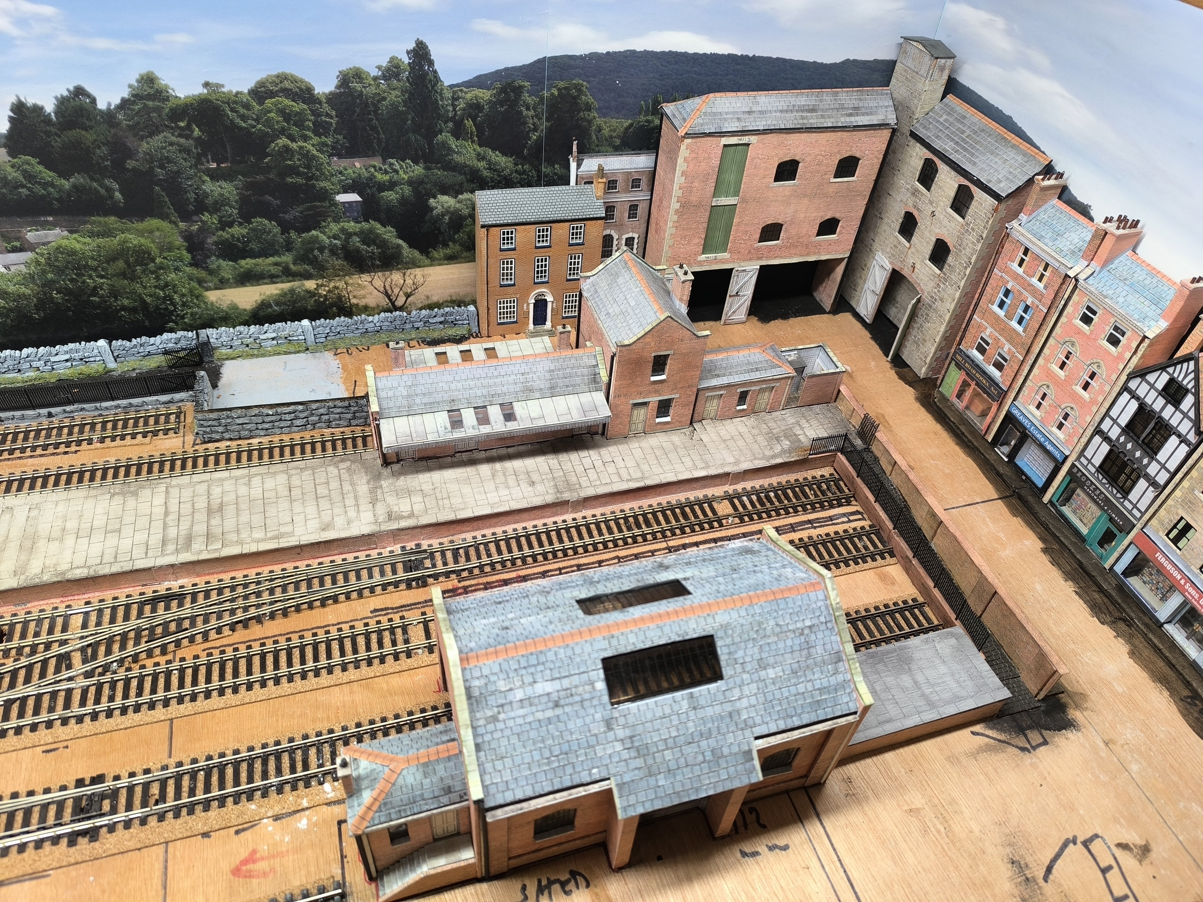

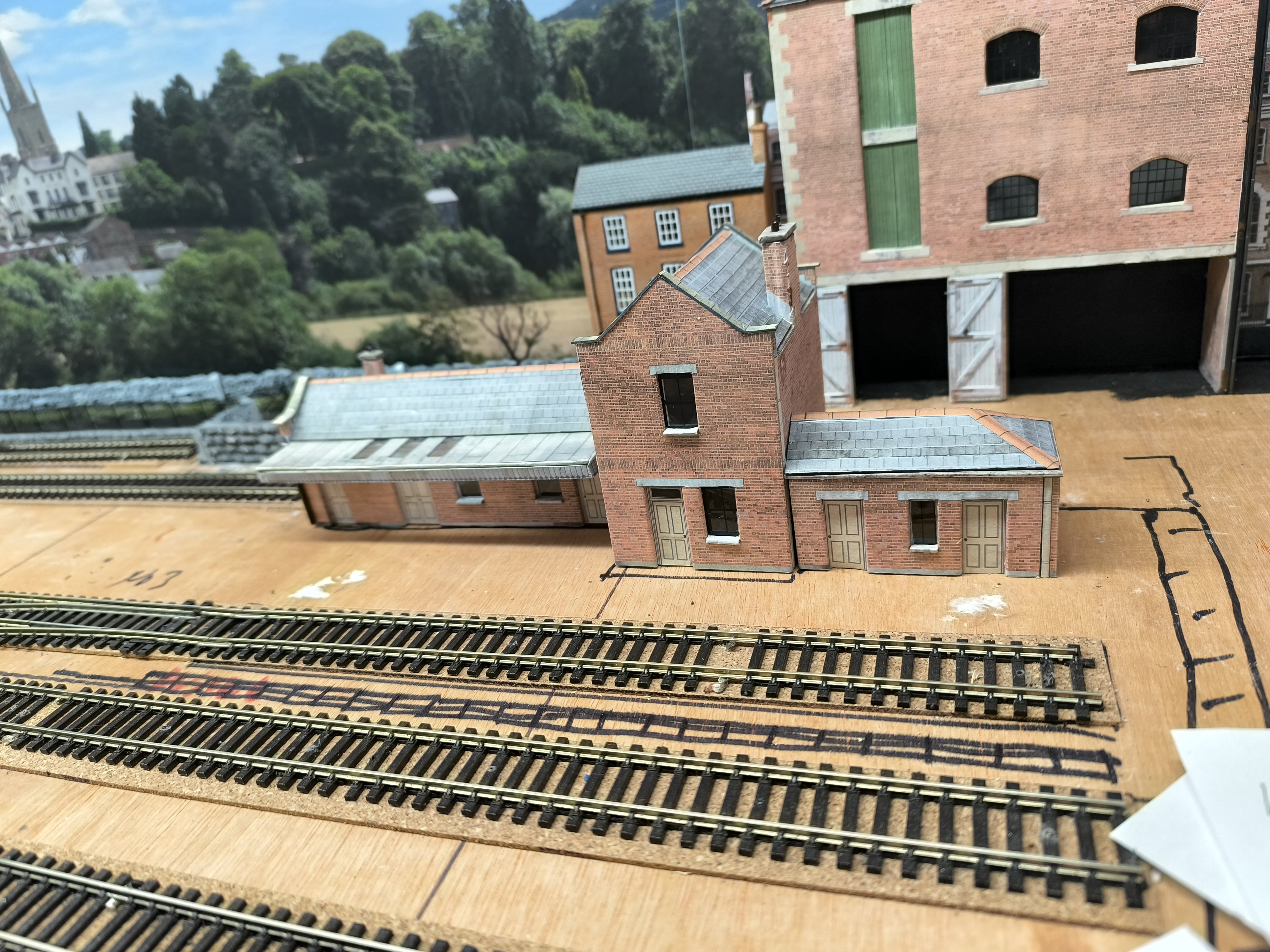

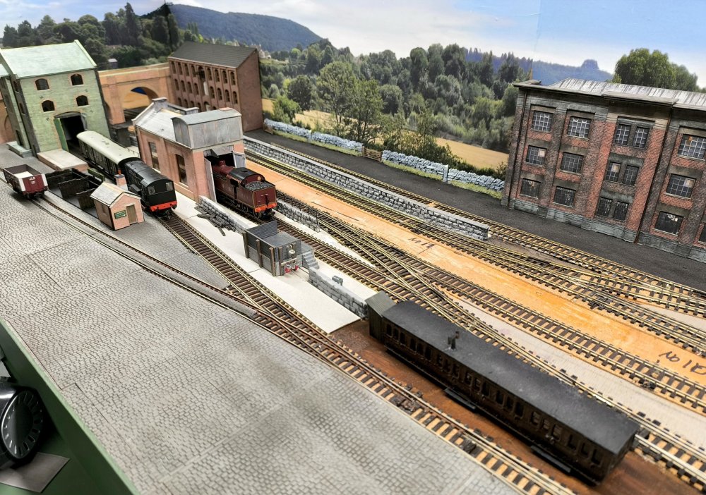

A further bit of progress.
Finished & positioned a small engine shed.
Next job is surface the platforms. Not sure whether I will slab or tarmac them ?
IMG_20260309_205337.thumb.jpg.fd9a5618fdacd9eae96e7b5963c951f5.jpgIMG_20260309_205342.thumb.jpg.123c29e5269dbd60d214fdee2753570f.jpgIMG_20260309_205440.thumb.jpg.1b3c410a853a318ad86dfb358a0a7666.jpg

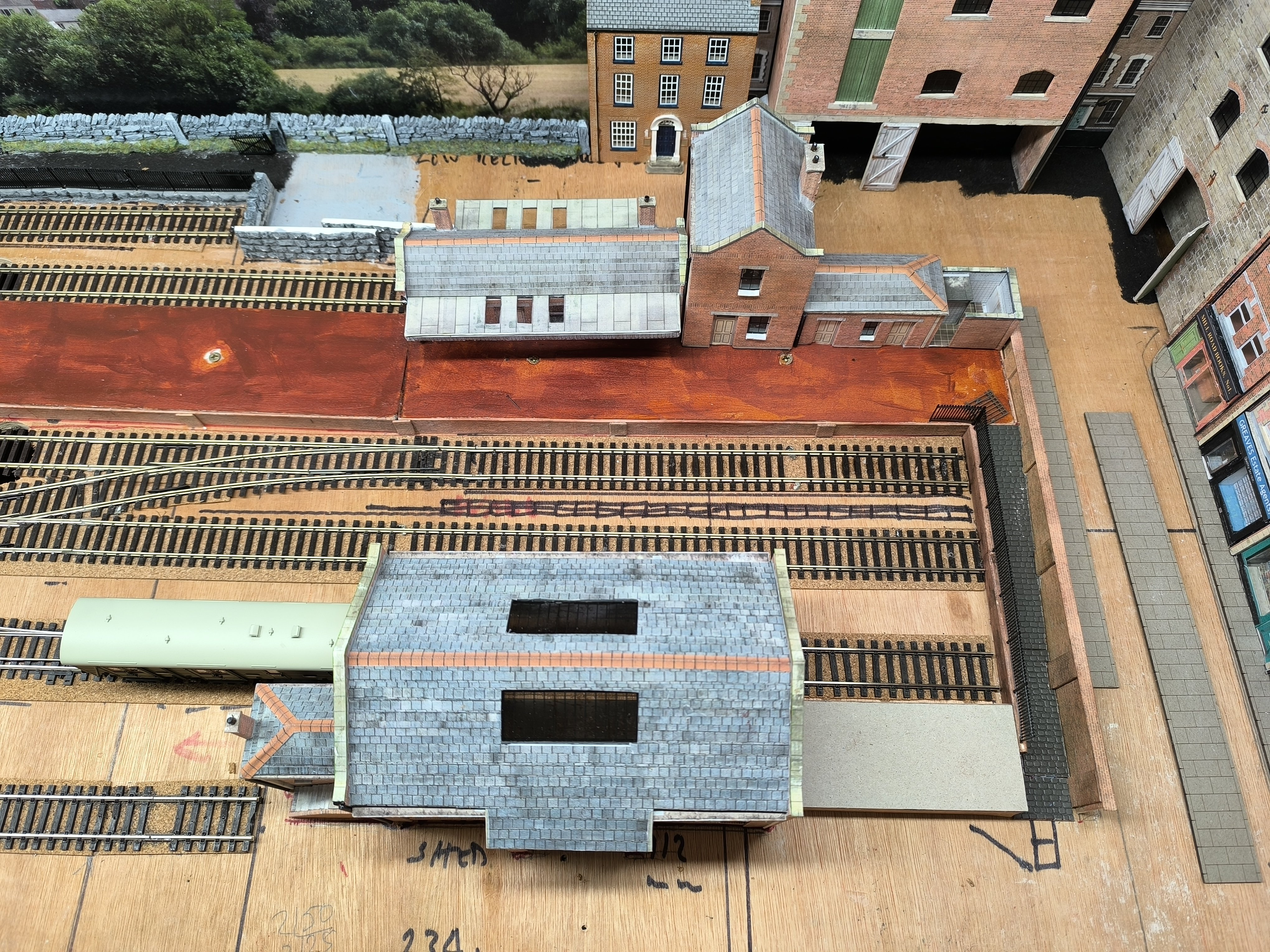

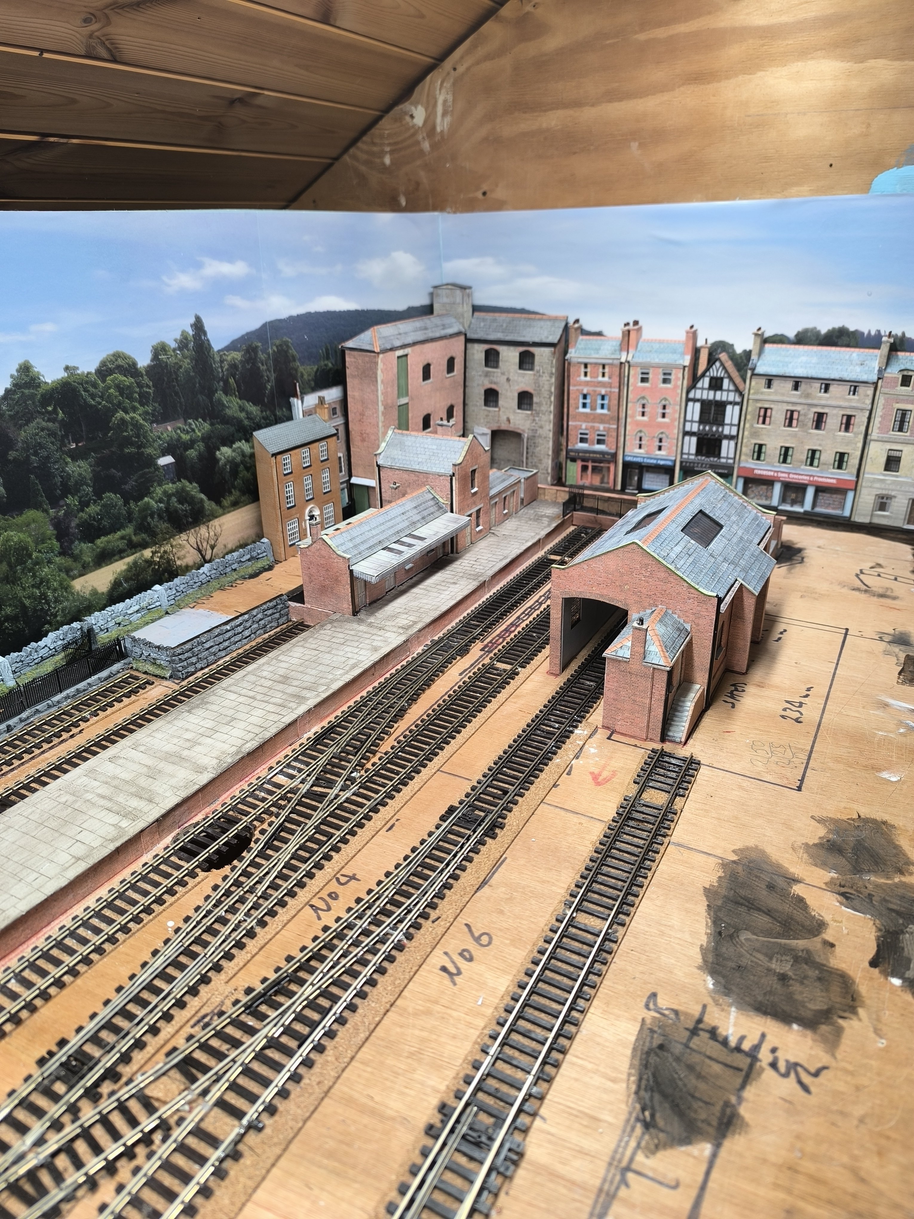

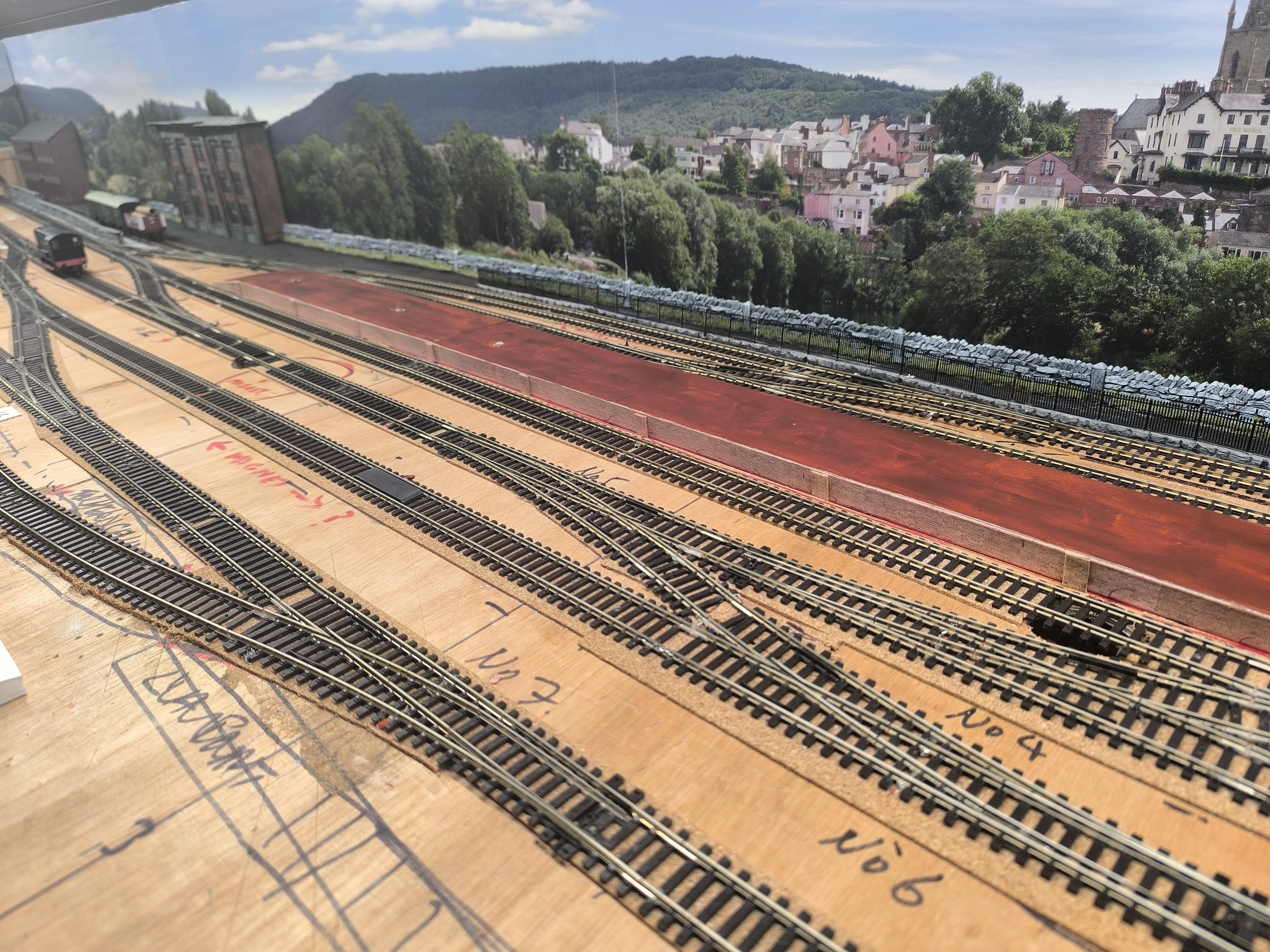

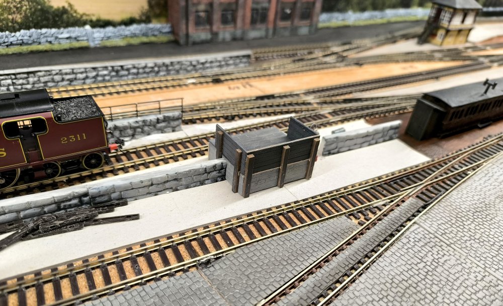

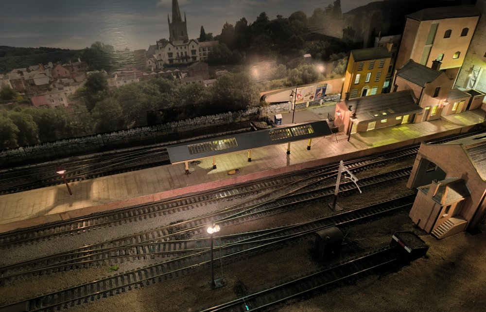

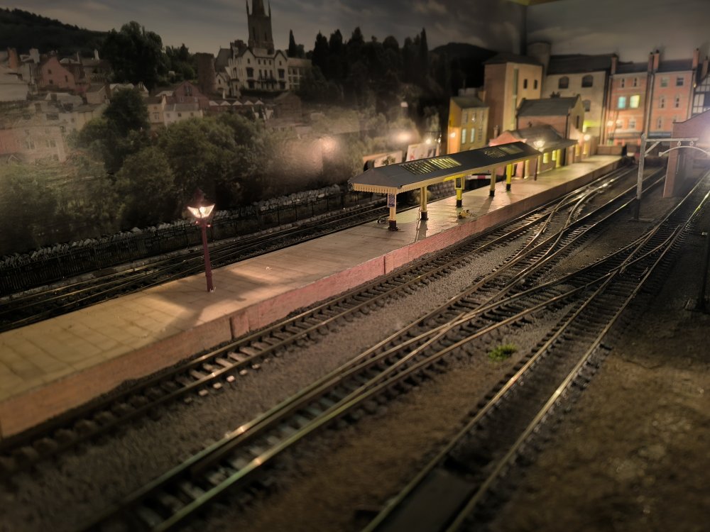

Not much happening of late due to the holiday & other house commitments but the platforms have been slabbed & painted.
  • Like 16
  • Agree 1
1 hour ago, Anders112 said:
Well done @amdaleyplatforms look great 👏🏻how did you go about slabbing them ?
40 thou plasticard scribed 12mm x 8mm & cut into strips
Tony

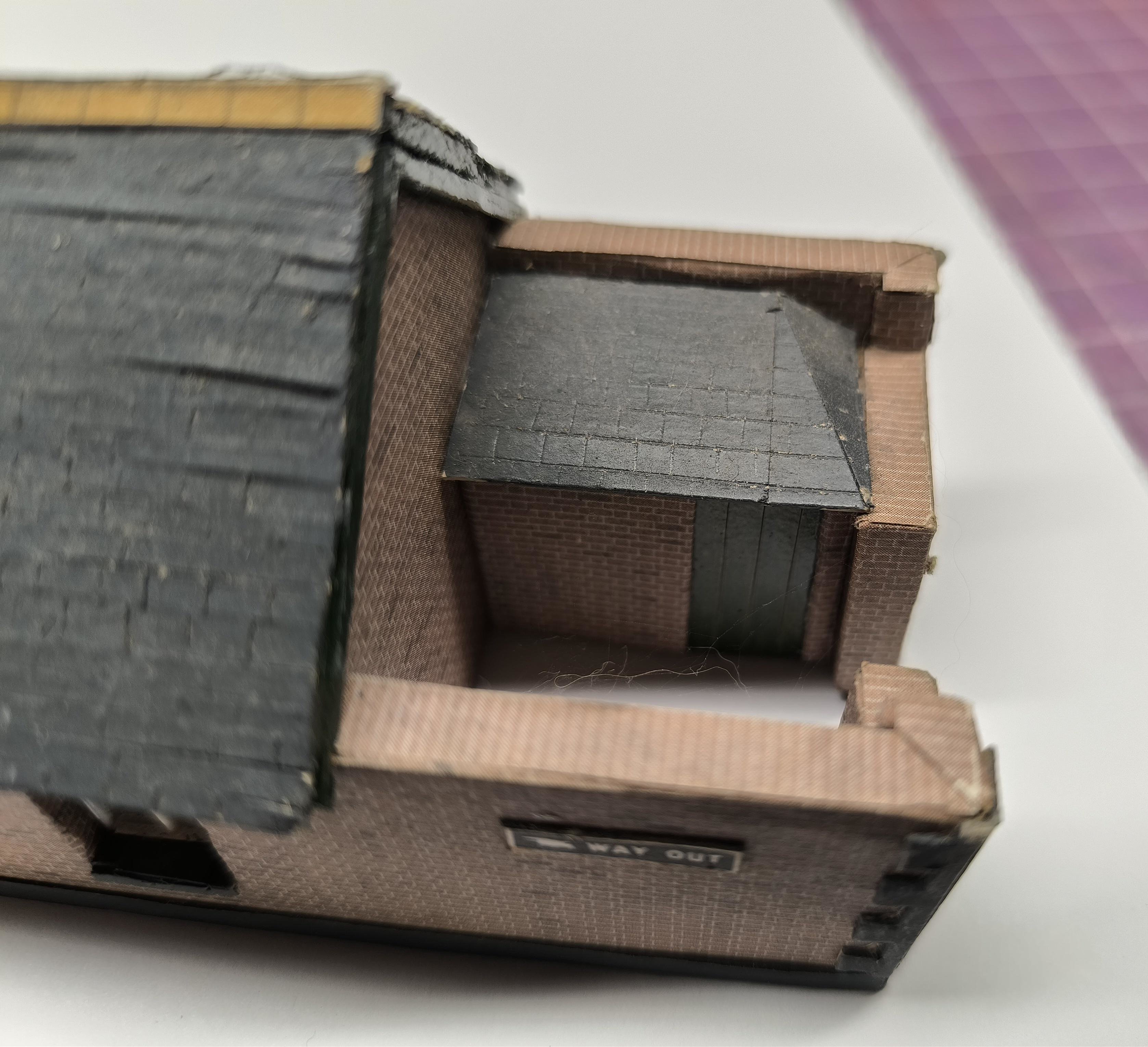

Speaking of Peter Denny, here are some photos of a station building I made from scratch over fifty years ago when i was much younger 😊 I based it on a plan i saw in Railway Modeller at the time. It was in the late sixties or early 1970's.
Nowadays everyone uses plastic card. back then I used timber covered in brick paper with the windows & doors painted & made from plastic strip I cut from some packaging I think ?
I know it has nothing to do with Mill Road but someone might be interested.
Tony.

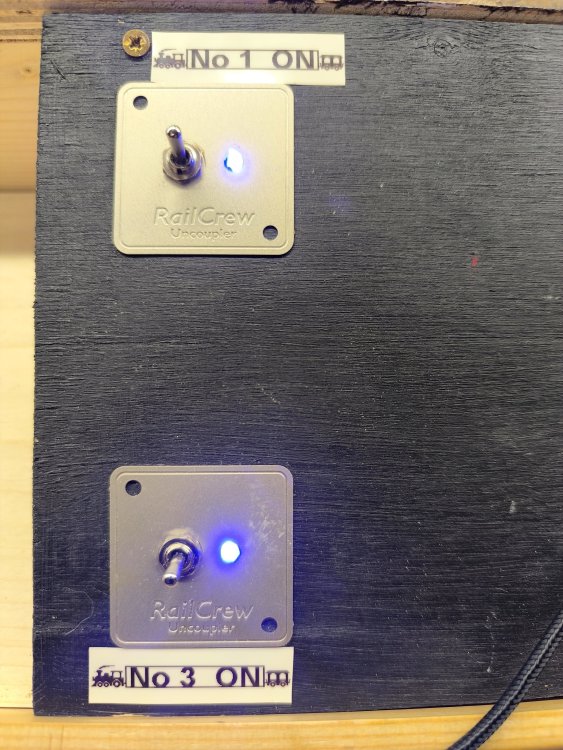

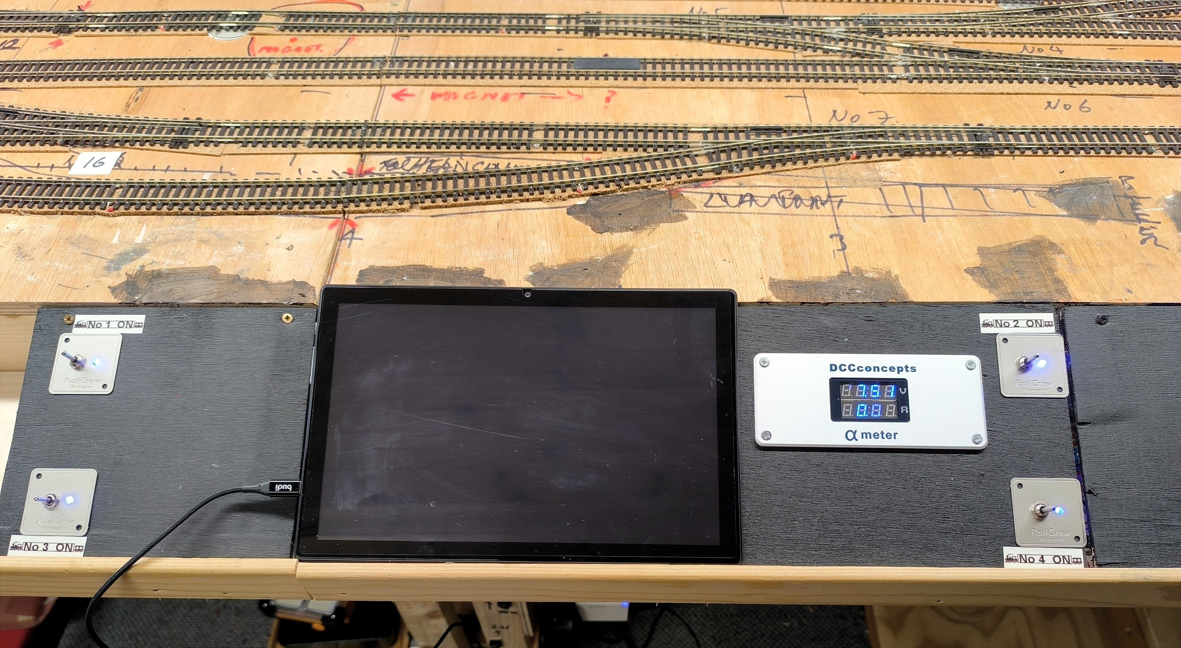

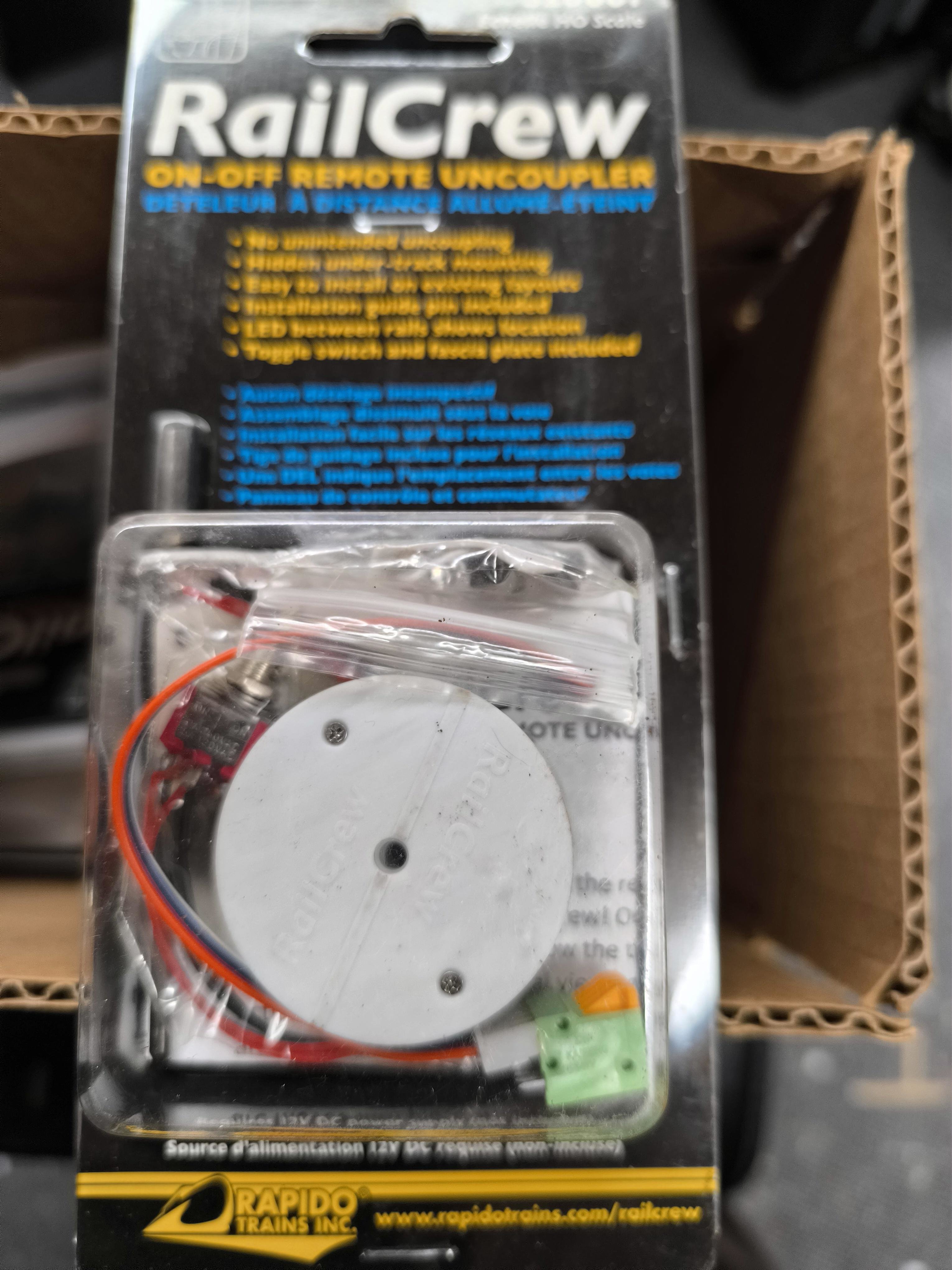

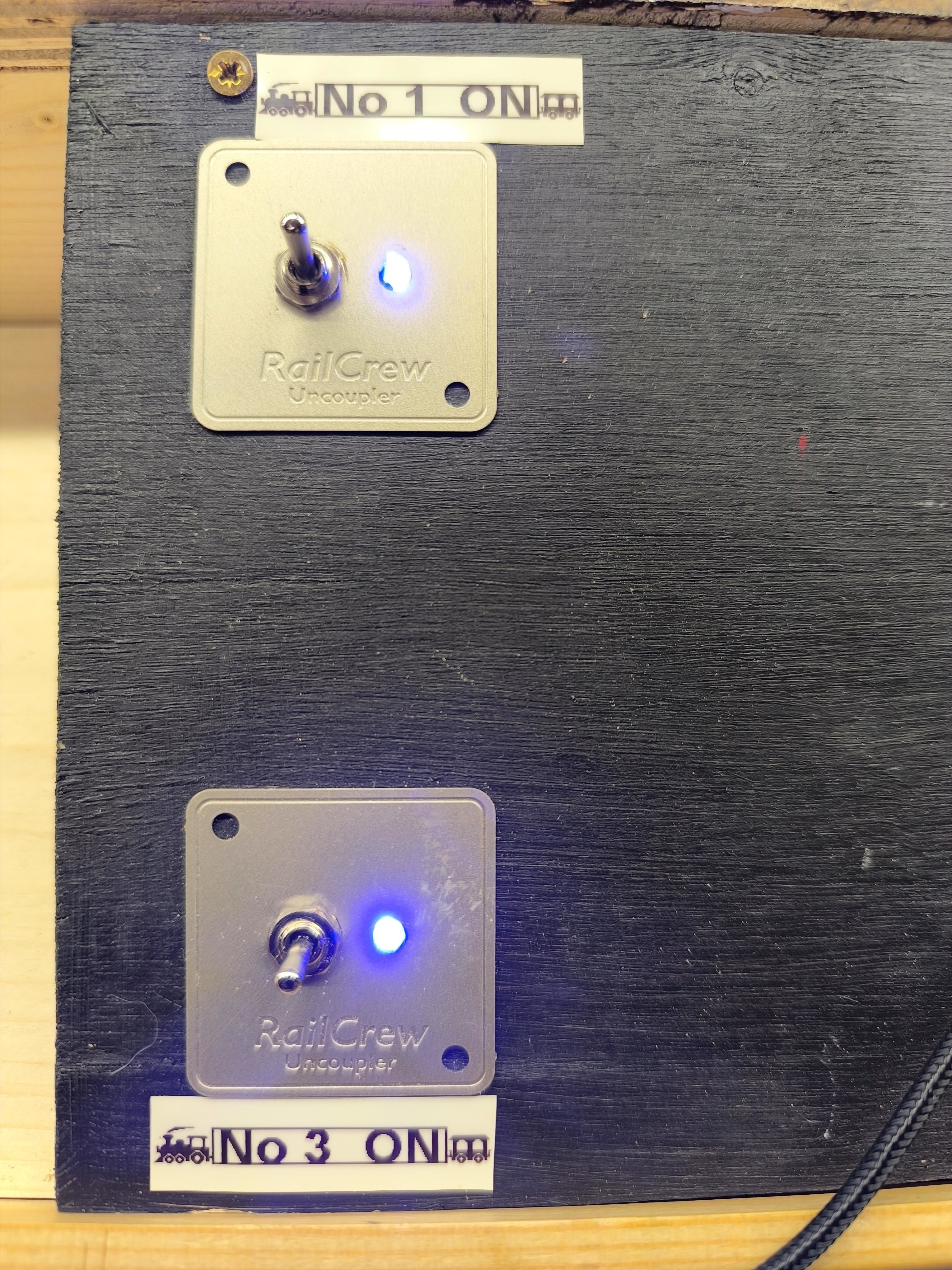

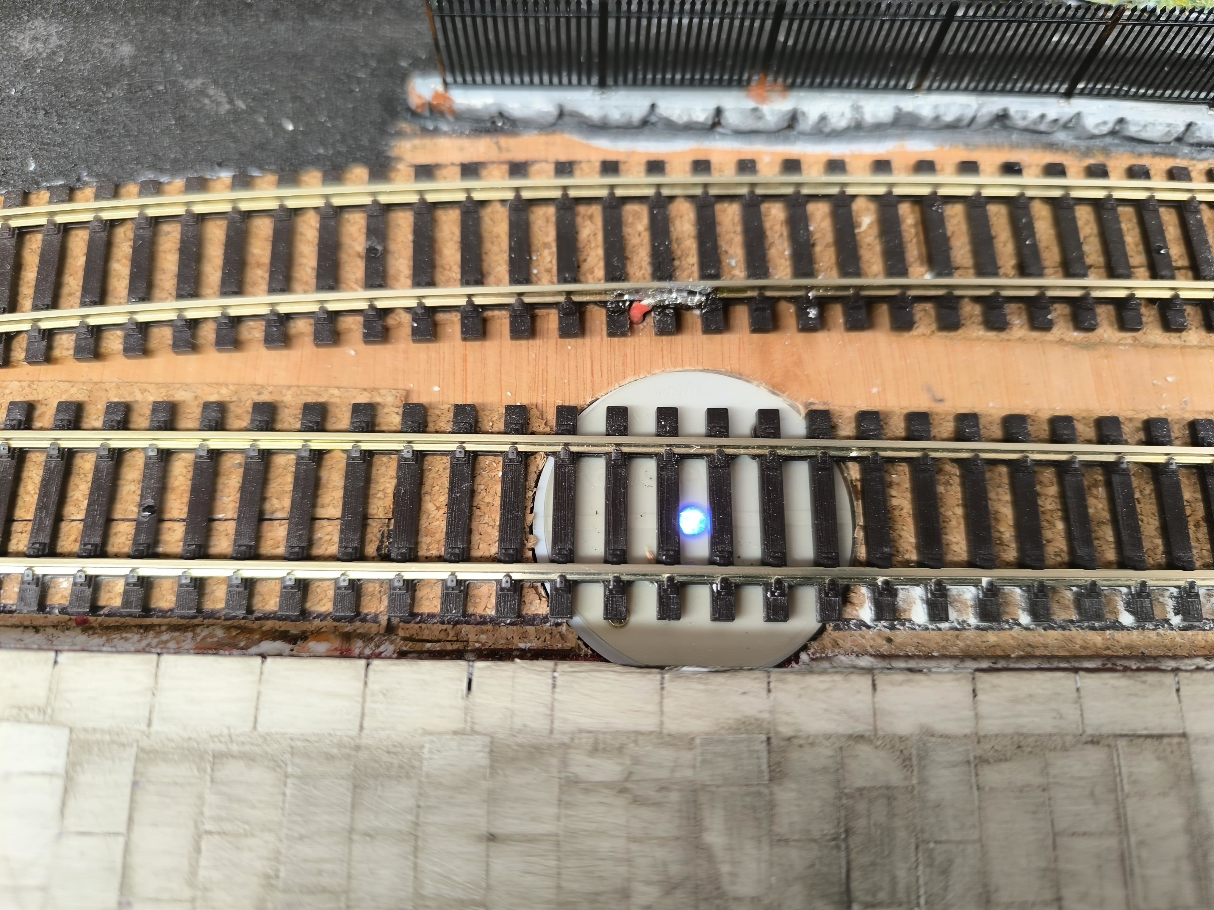

I have been installing these Rapido Railcrew magnetic uncouplers for use with Kadee couplings. They are very affective.
They come with everything needed & run off 12 volts DC.
This is what they look like when installed.
This is what the control panel end of the uncouplers look like.
Edited by amdaley
  • Informative 4
@amdaley - I can see that you had to leave room in your cork ballast for the uncoupler disc.
Did you have to cut a hole in the baseboard as well or was the depth of "ballast" enough to sink it under the track?
Thanks for sharing, an interesting method.
I just used the cork as an underlay. The track is yet to be ballasted.
You cut a hole in the baseboard & the uncoupler fits from underneath. I used a hole saw.
It's easier if you fit the uncouplers before laying the track but its possible with care to fit them after the track has been laid.
4 hours ago, amdaley said:
 I used a hole saw.
With GREAT care I would think 🥴
Yes, great care but possible because I've done it.

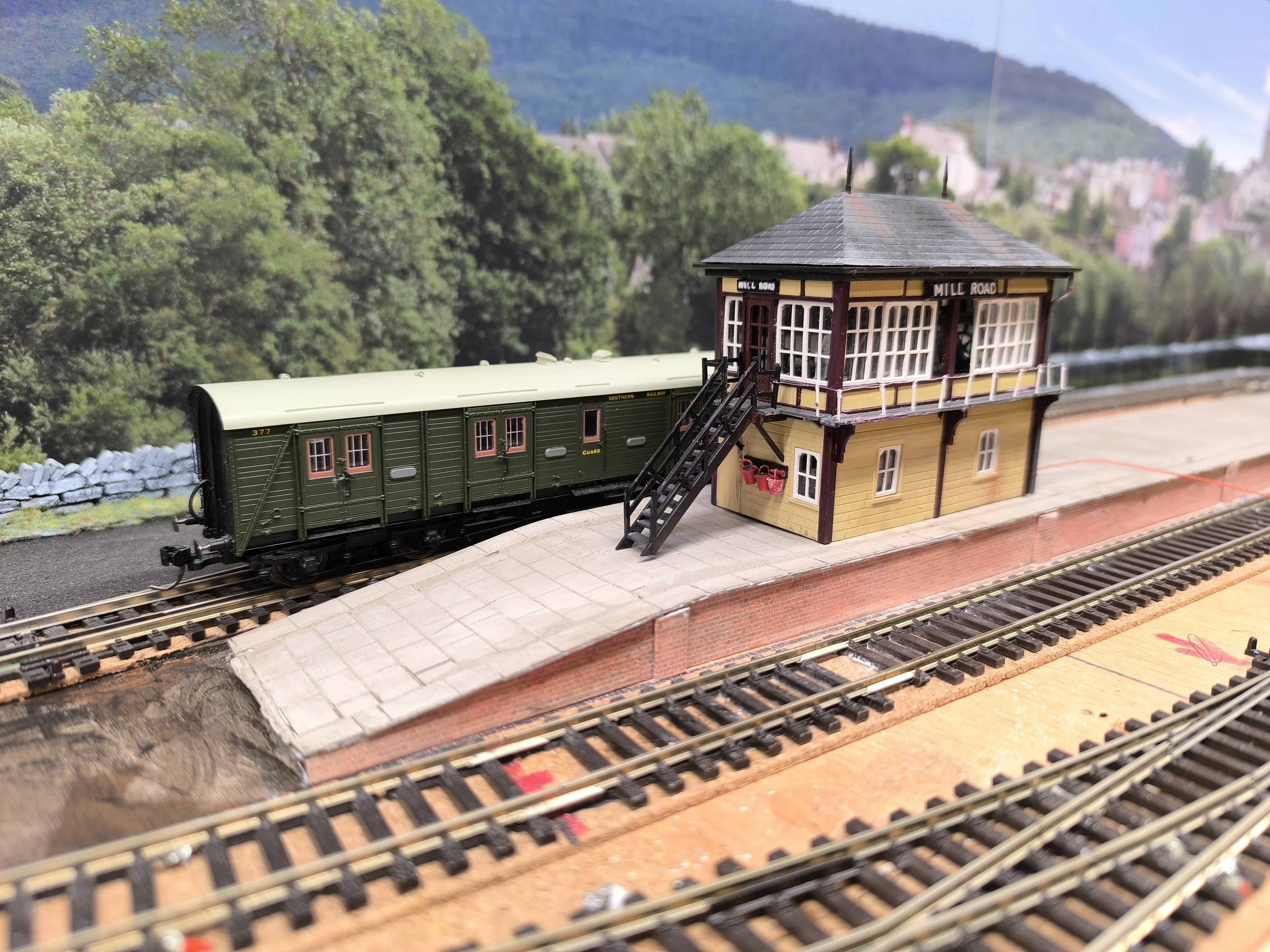

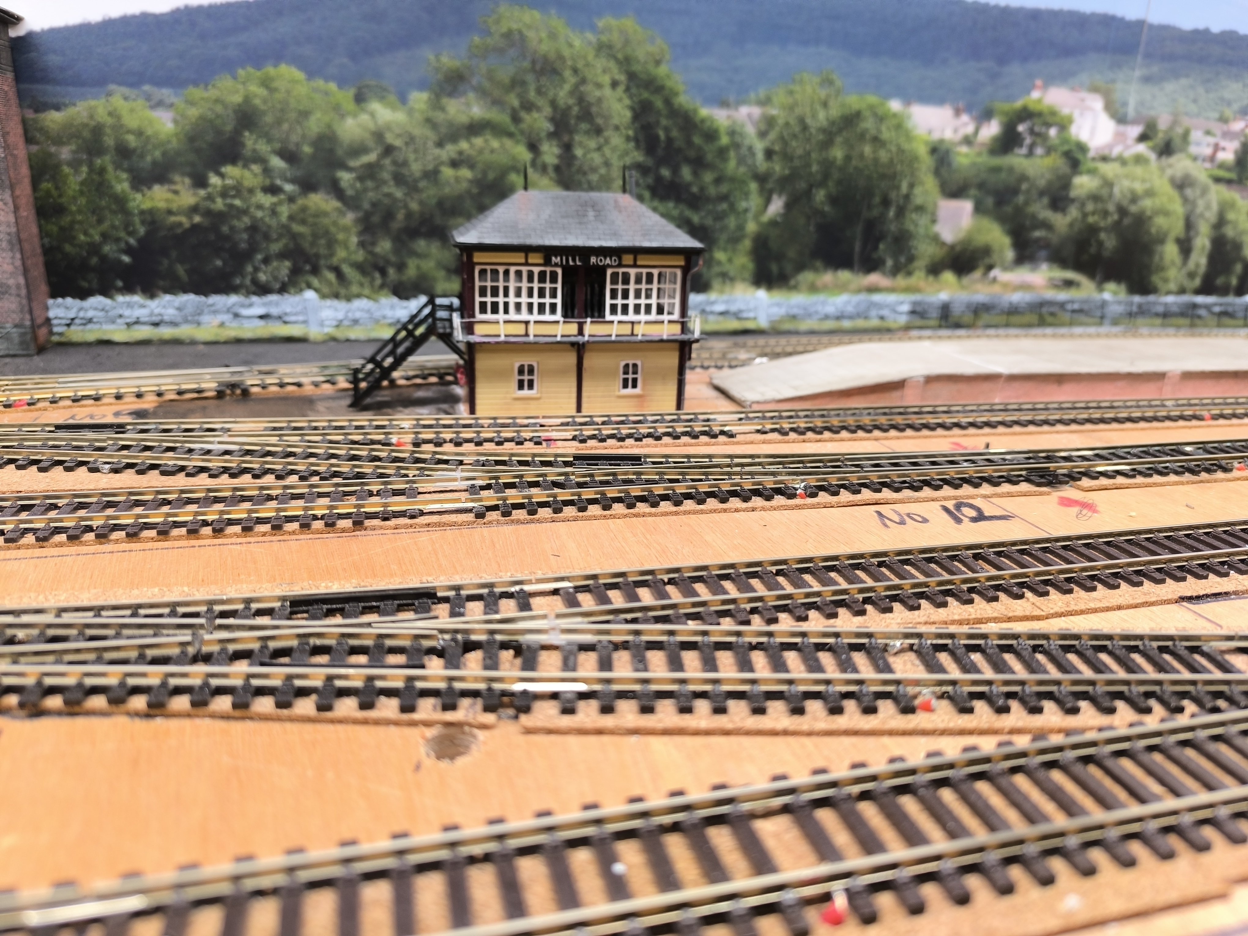

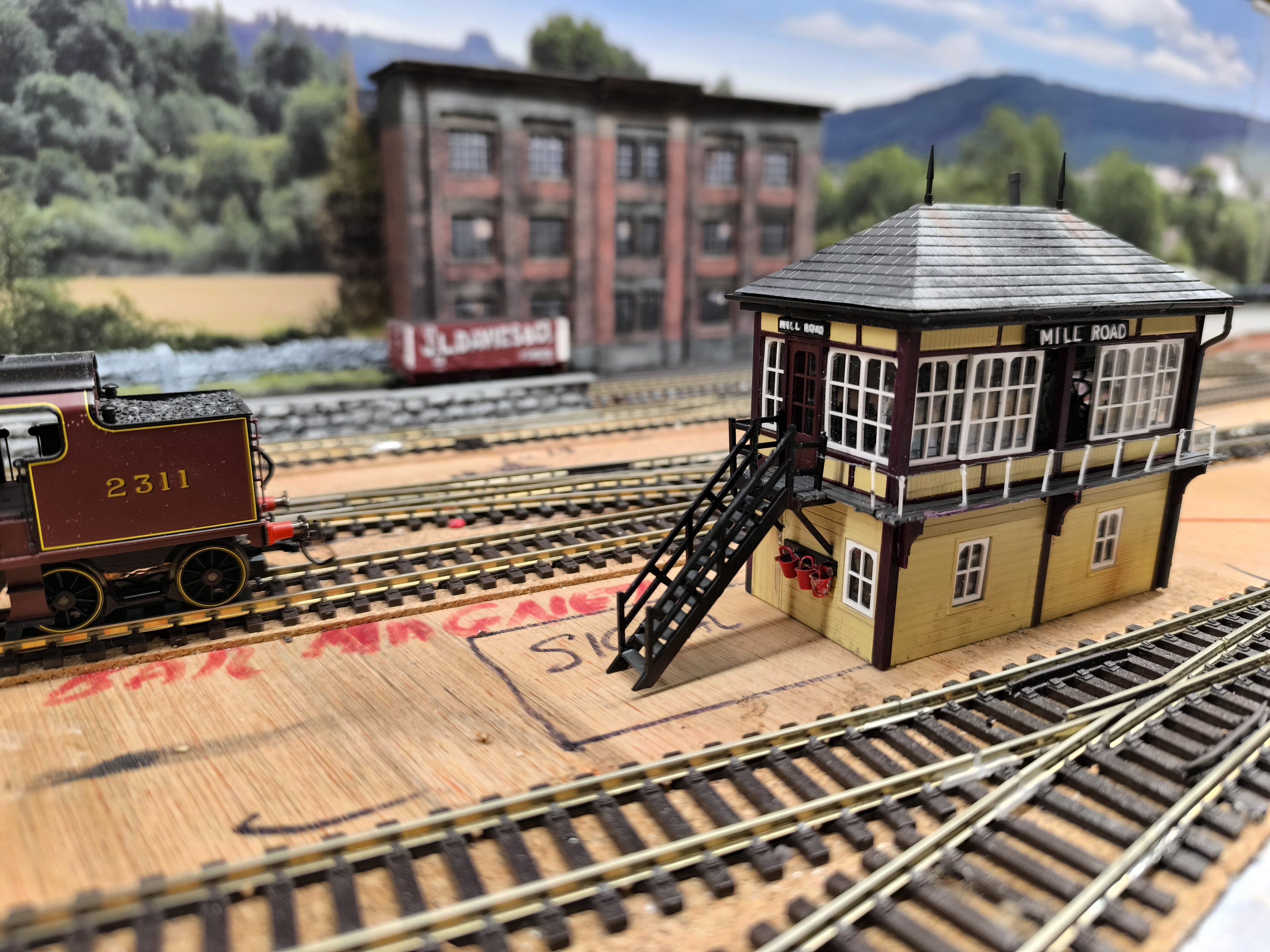

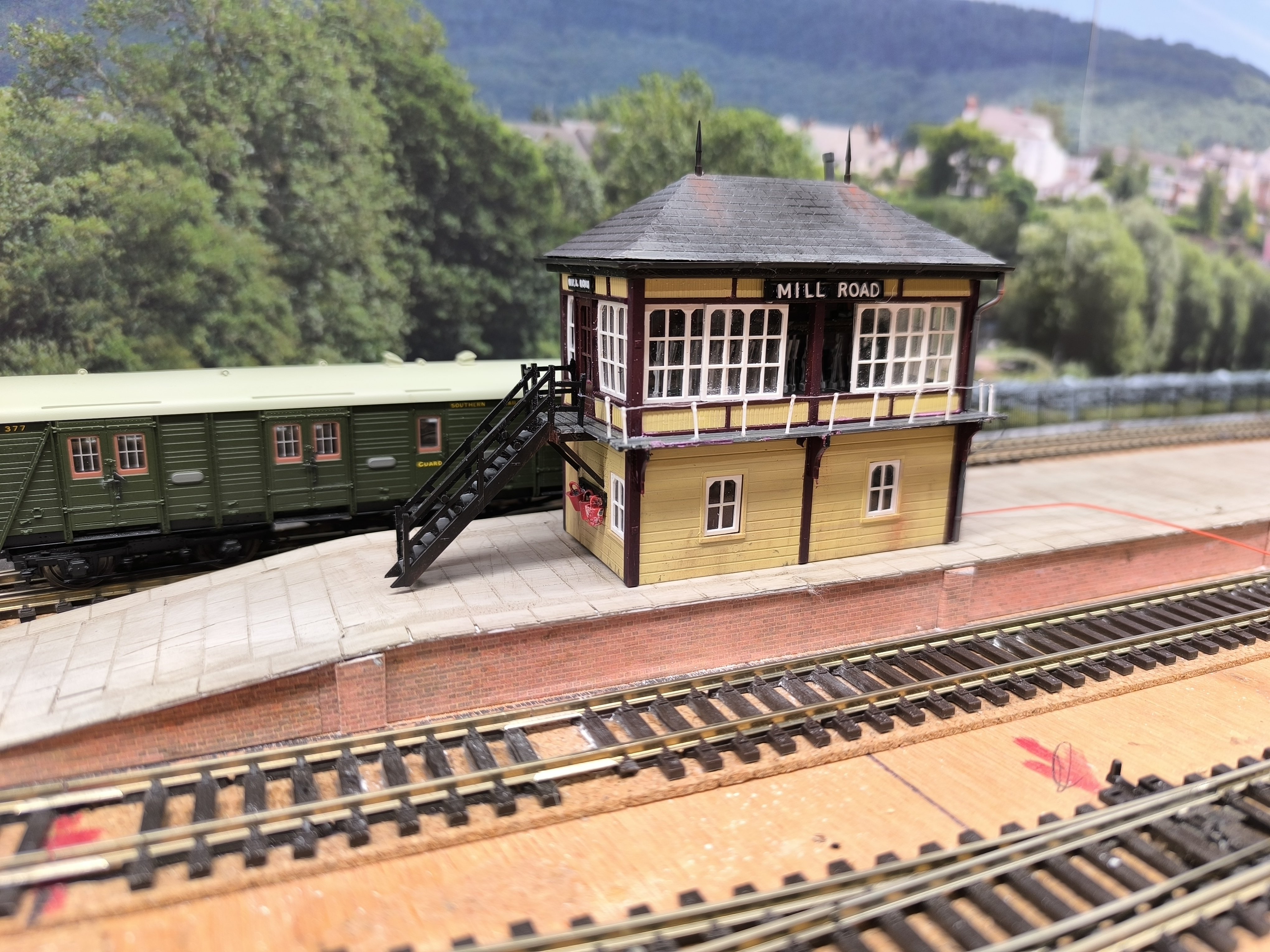

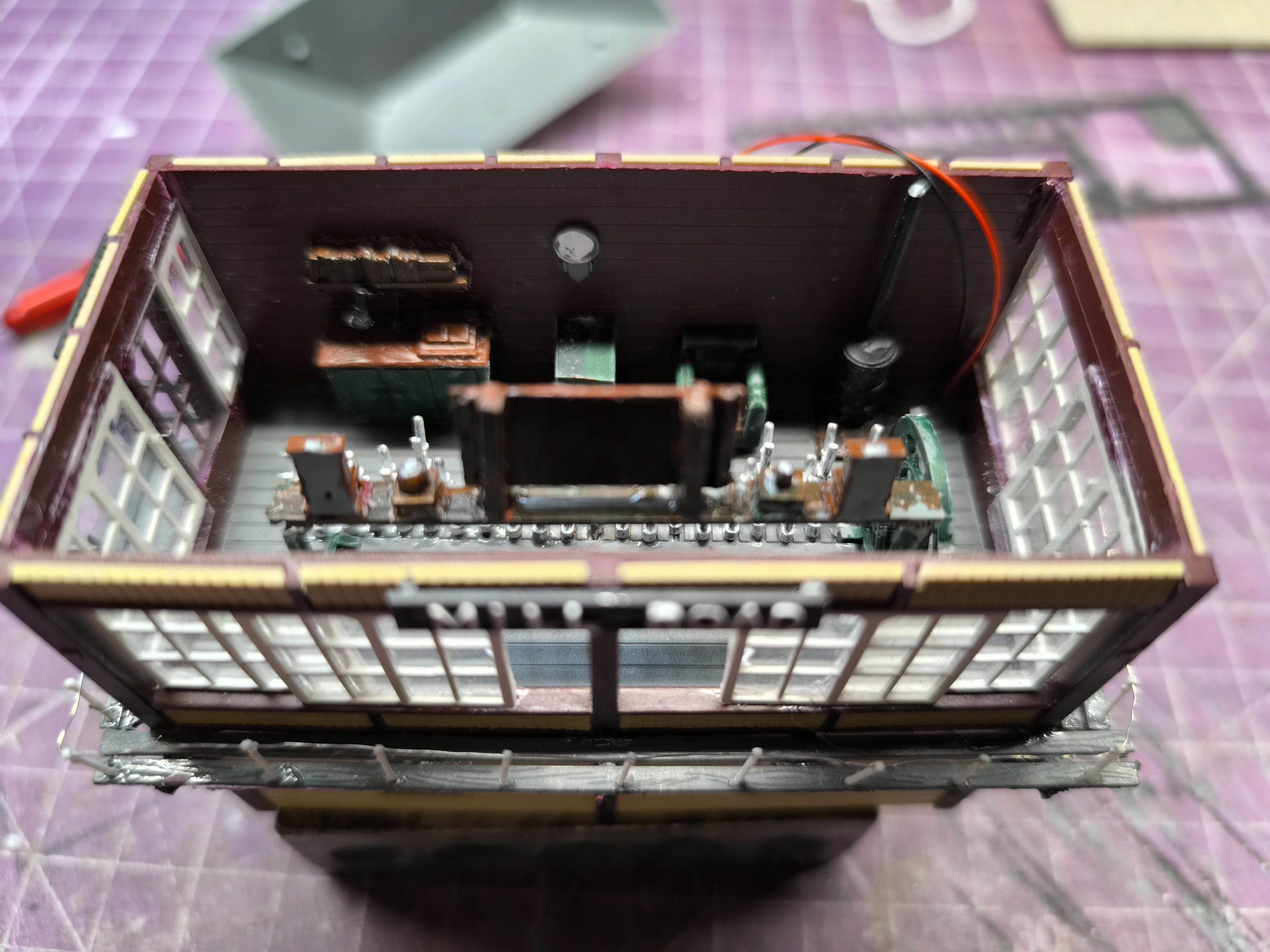

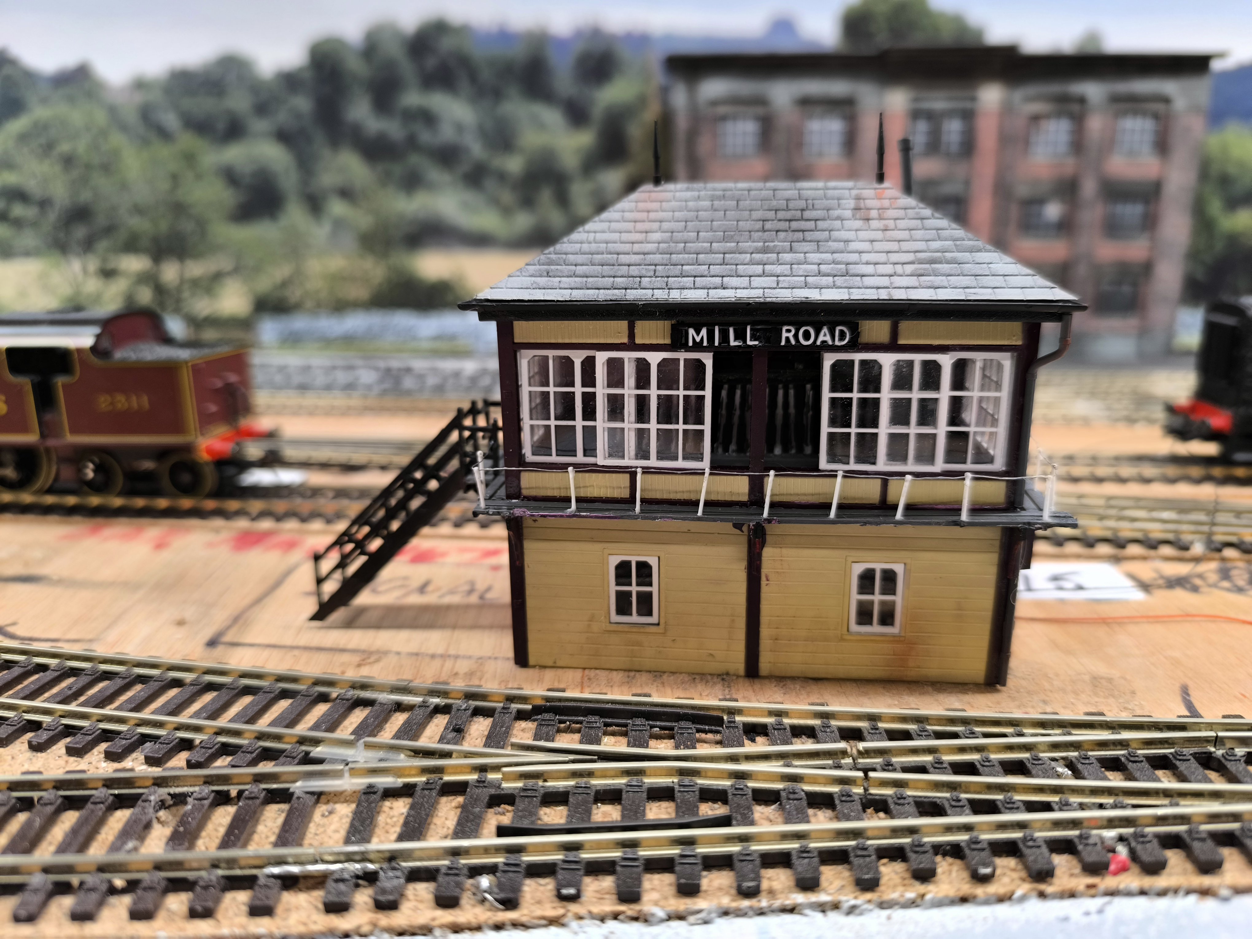

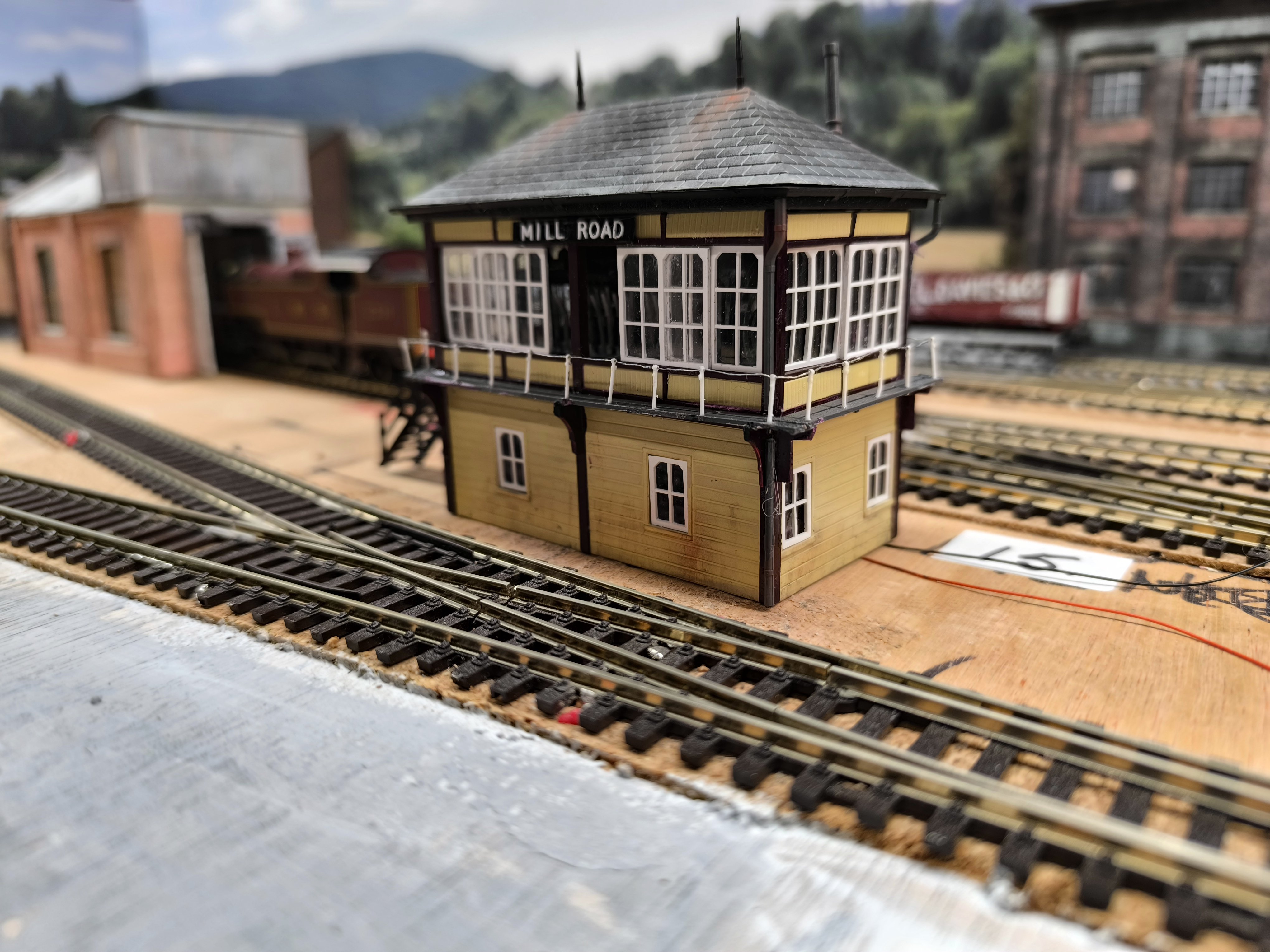

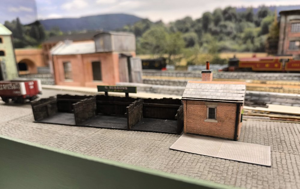

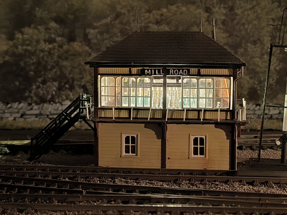

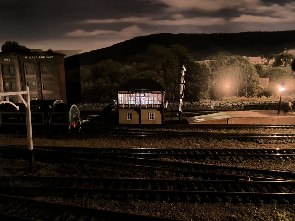

Signal Box has been built.
I've also fitted an interior & lights.
Built from a Ratio kit with added interior details & lights.
  • Like 17
On 21/5/2026 at 6:01 PM, Georgeconna said:
Looks great, They make fine kits.
They do indeed Norman.
Some of the details are a little delicate so a couple of changes had to be made.
With a little patience you can make a very passible model.
Tony.

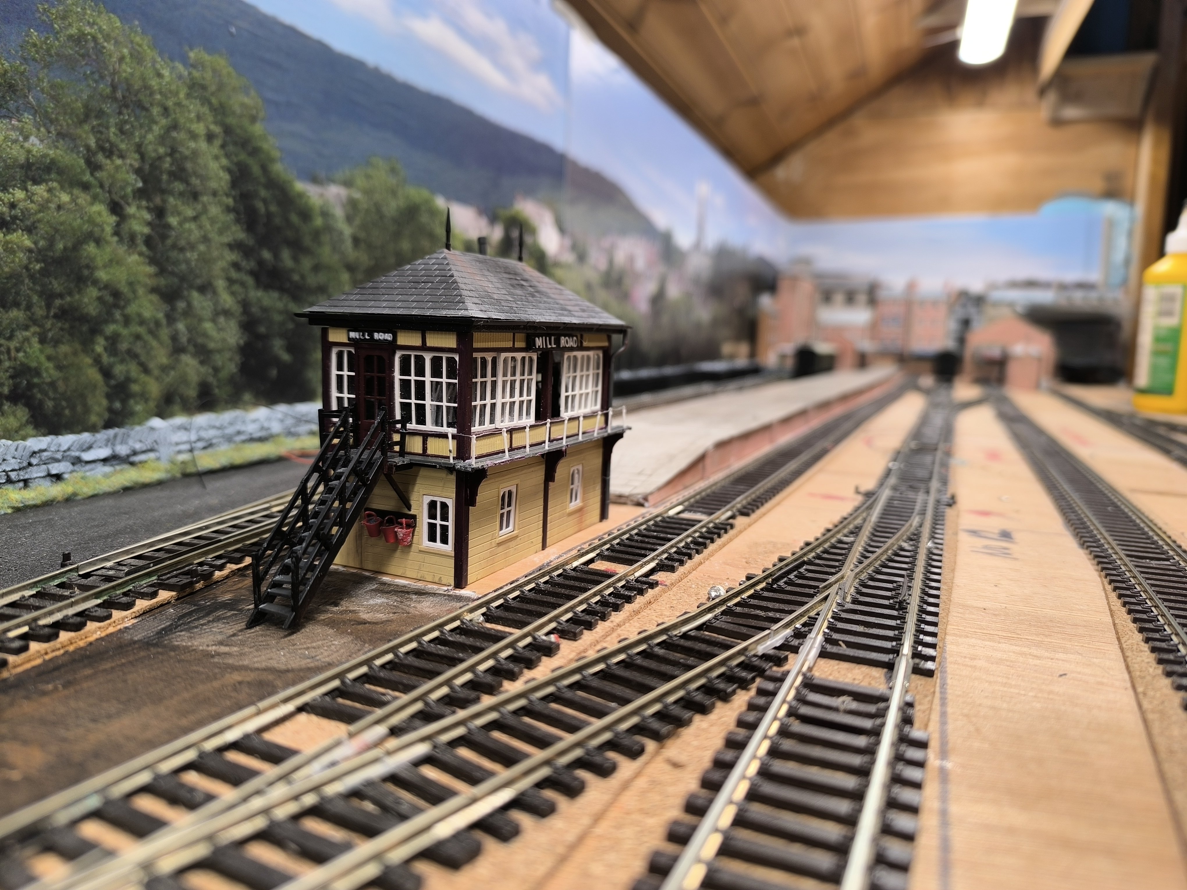

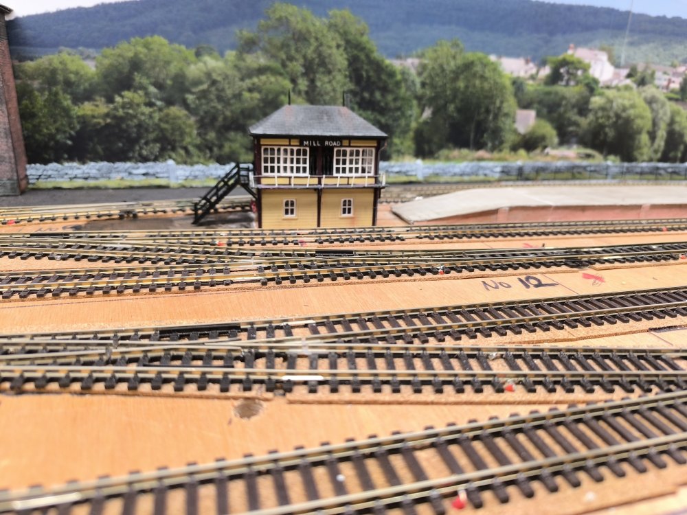

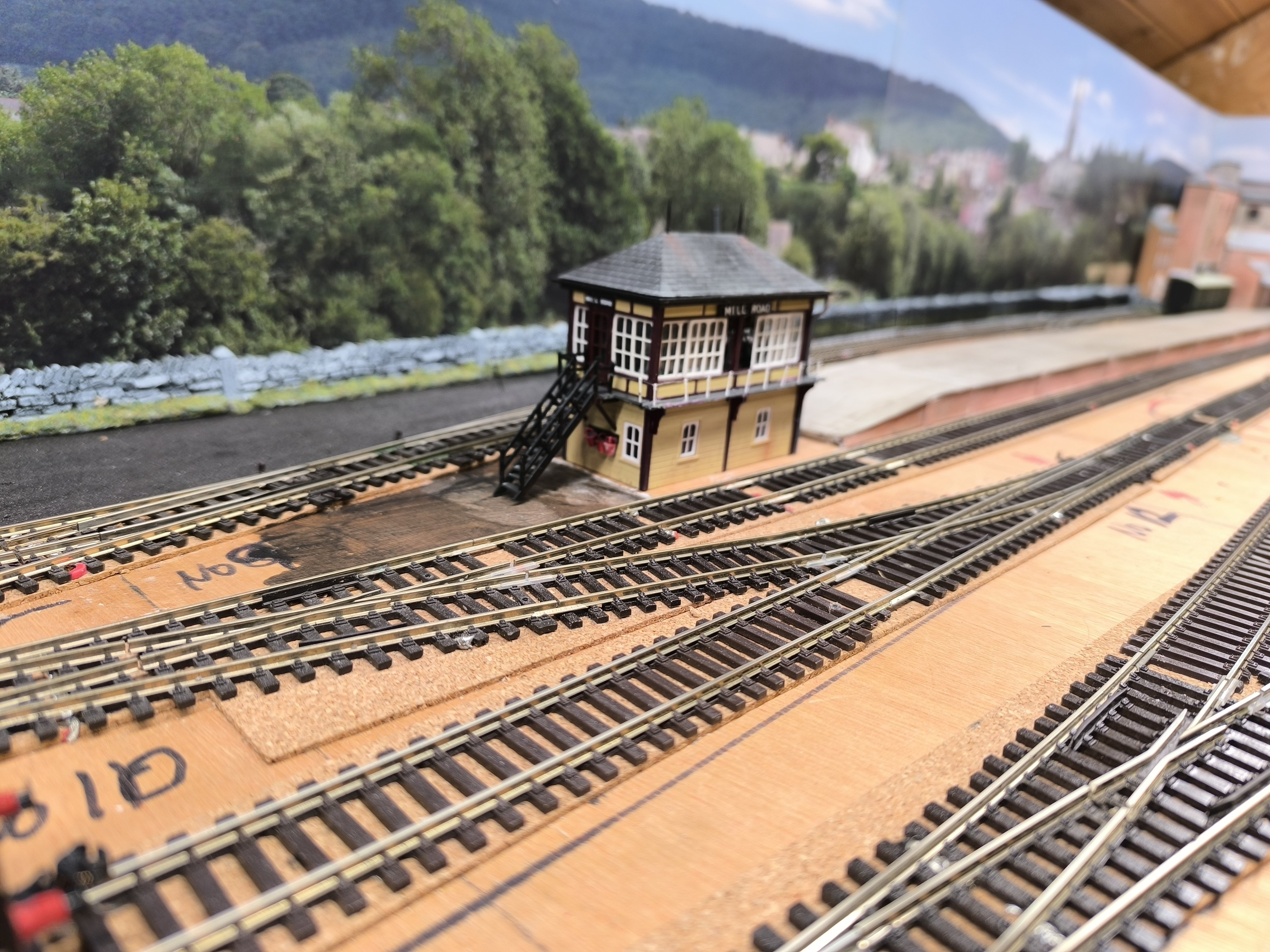

I had difficulty in deciding where to place the signal box.
Where I wanted to put it would have meant that to face the main point work of the station would have meant that the front of the box would be facing the back of the layout which wouldn't be ideal.
If I wanted to see the main features of the box & have the box facing the main point work of the station the only suitable place would be the end of the platform.
The box was too tall to be placed on the end of the platform so I shortened the platform & the box now sits at the end of the platform.
Edited by amdaley
  • Like 9

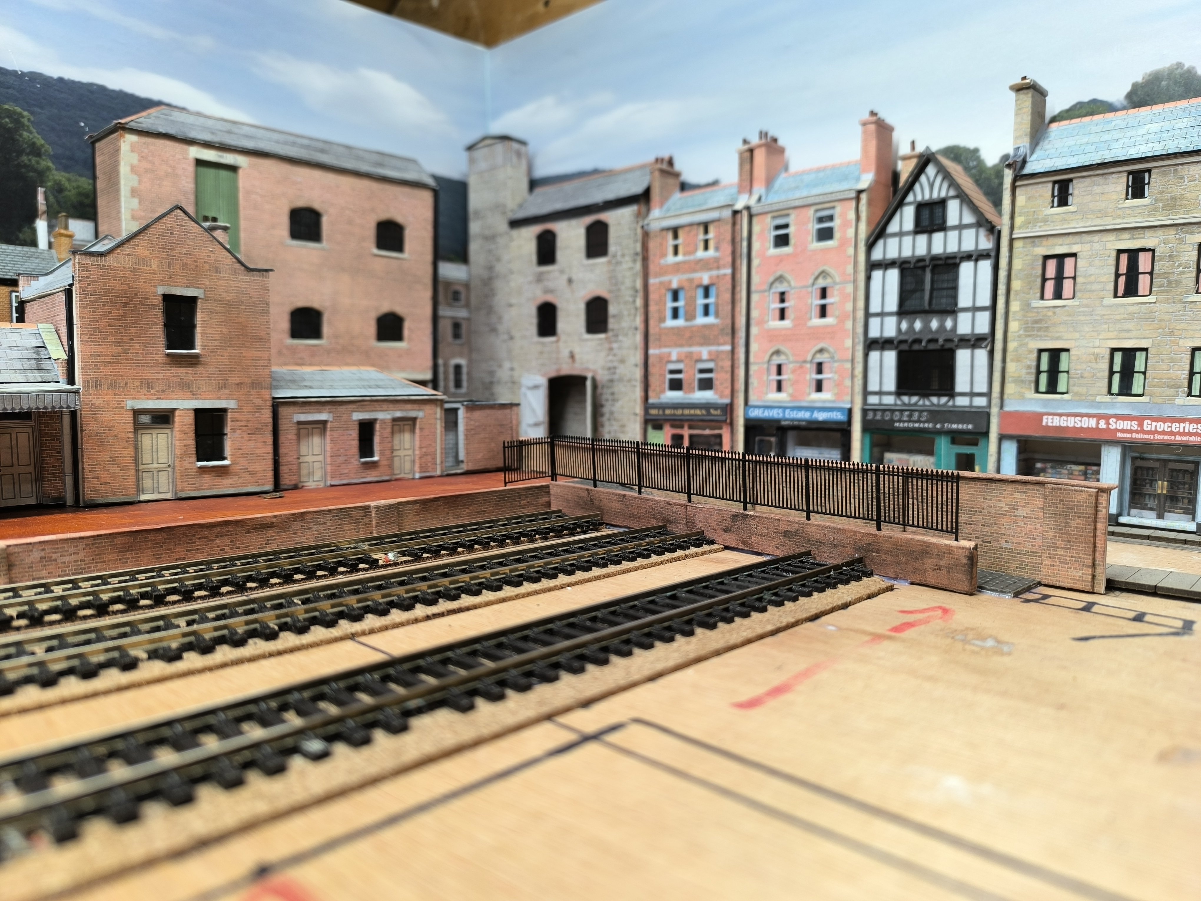

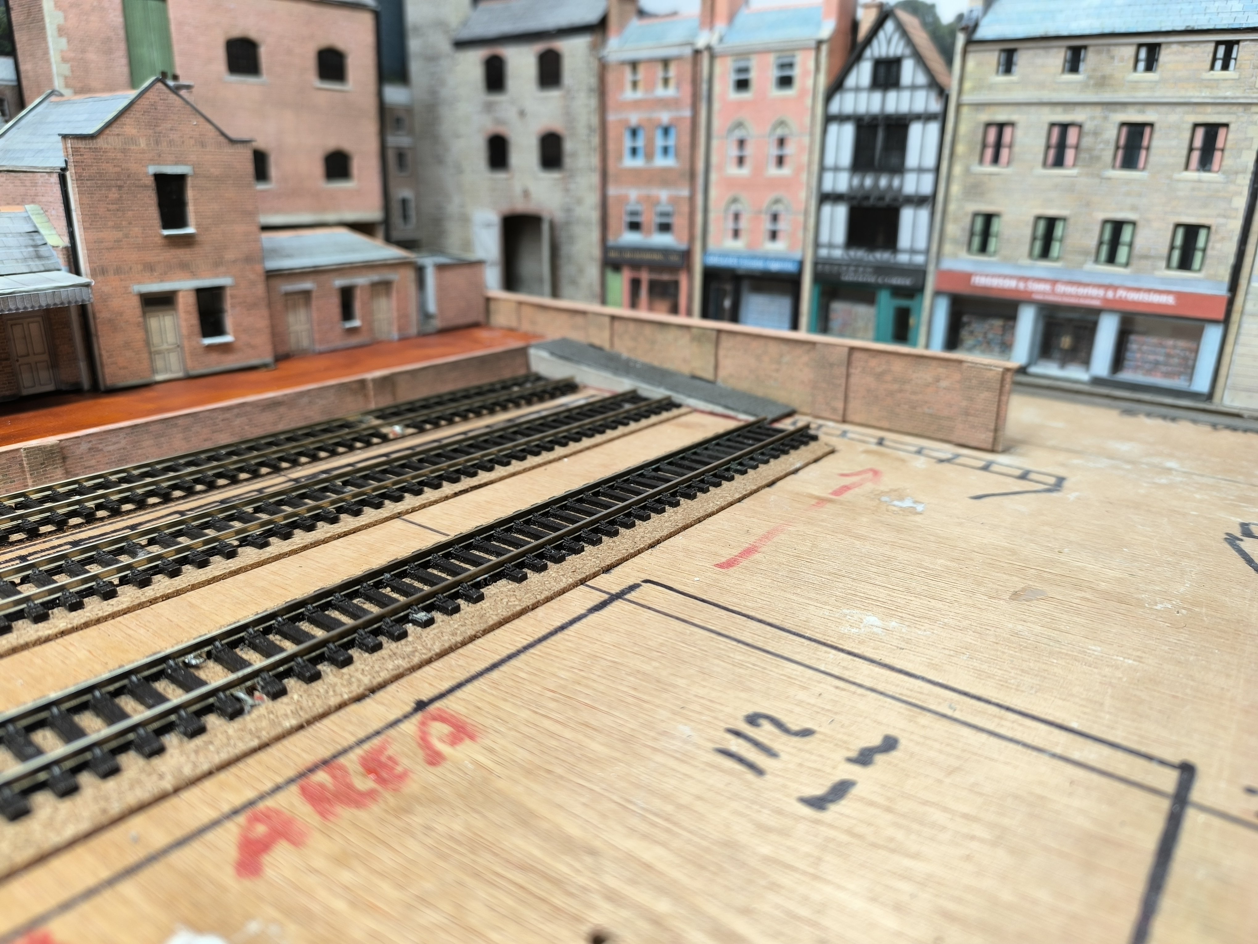

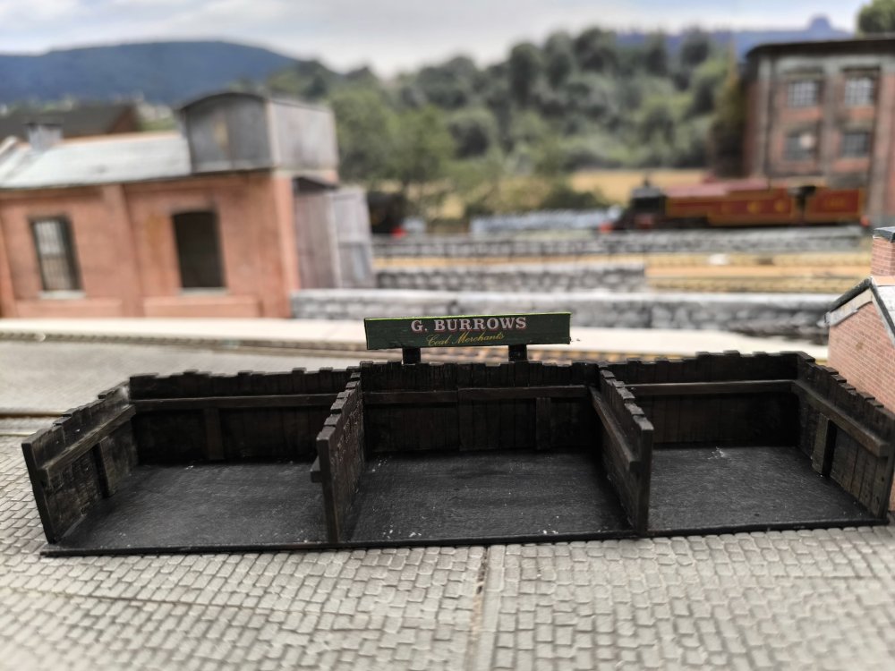

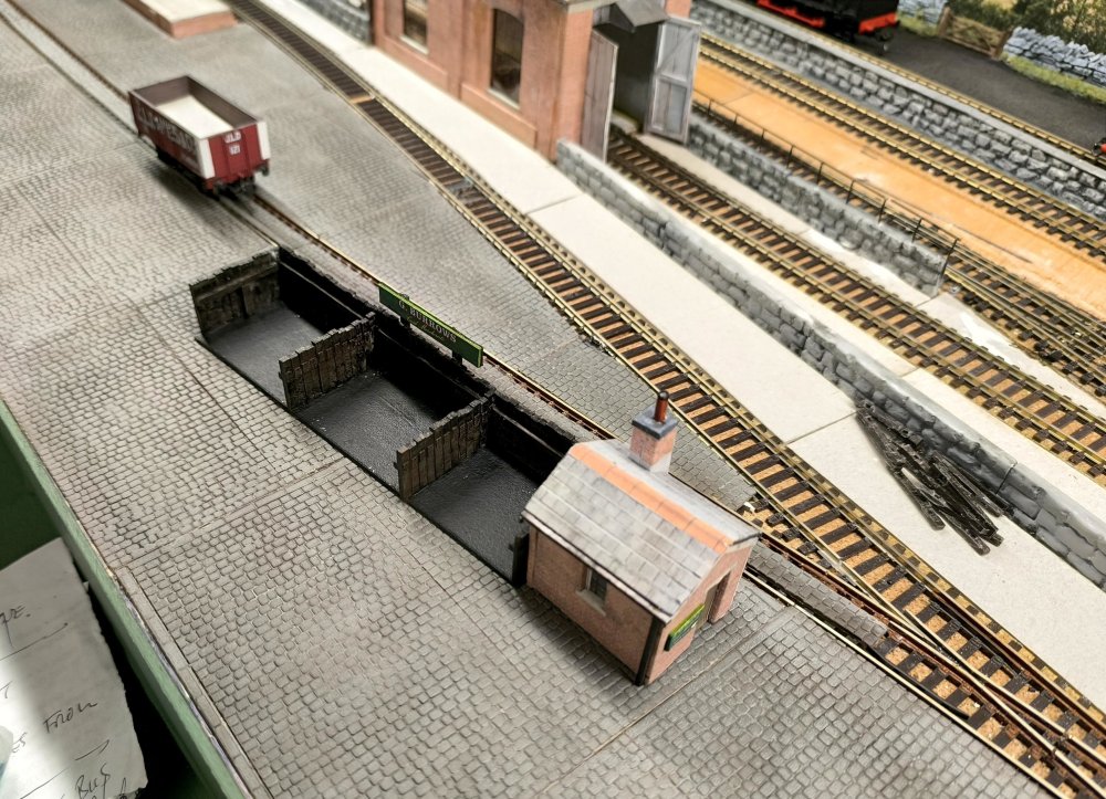

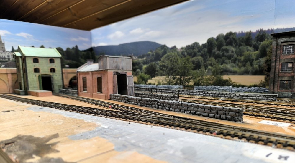

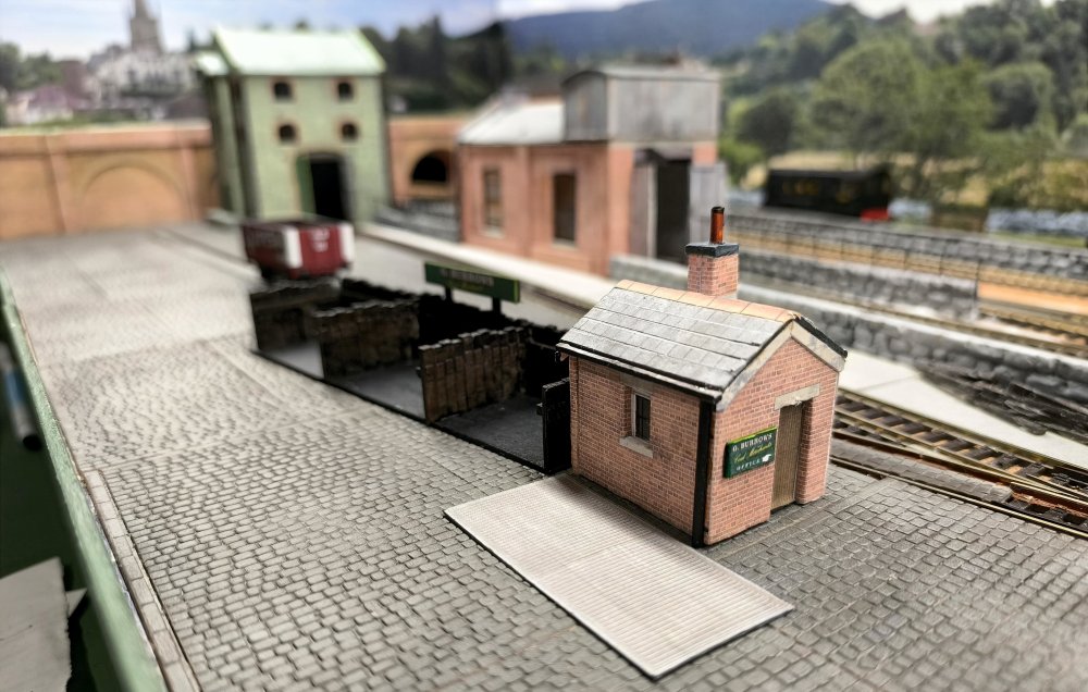

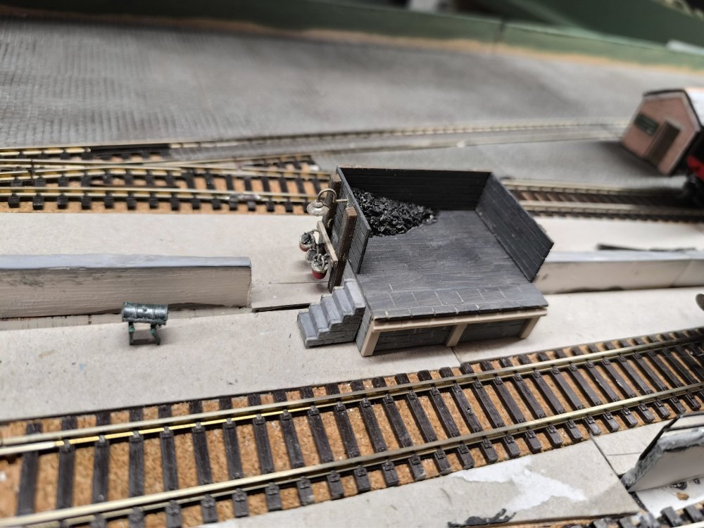

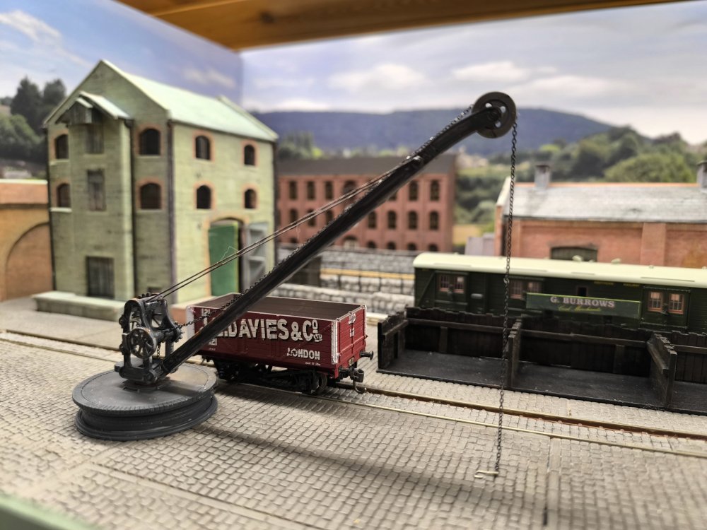

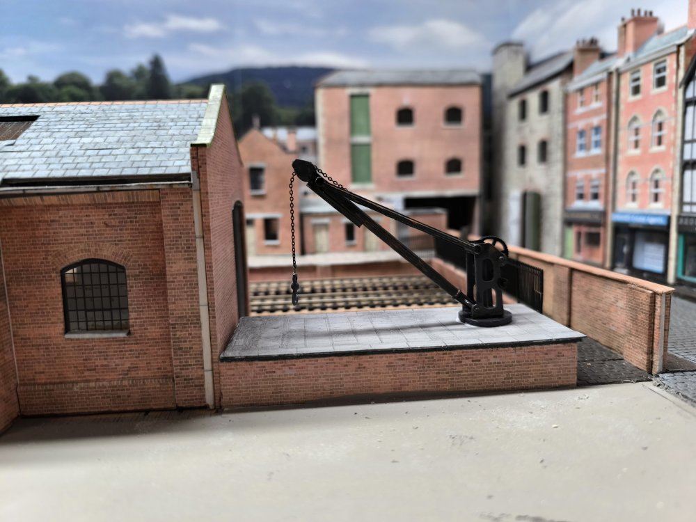

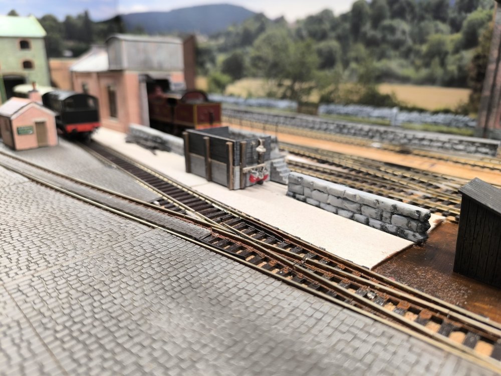

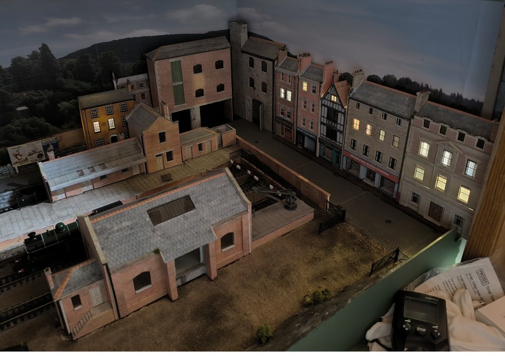

Small update.
I've finished some walls & railings around the warehouse & engine shed area.
The next job will be to do groundworks around this area. I will have to raise the level of the ground to track level so I will use some 2mm card to being up the level before I put down some cobble sheets.
