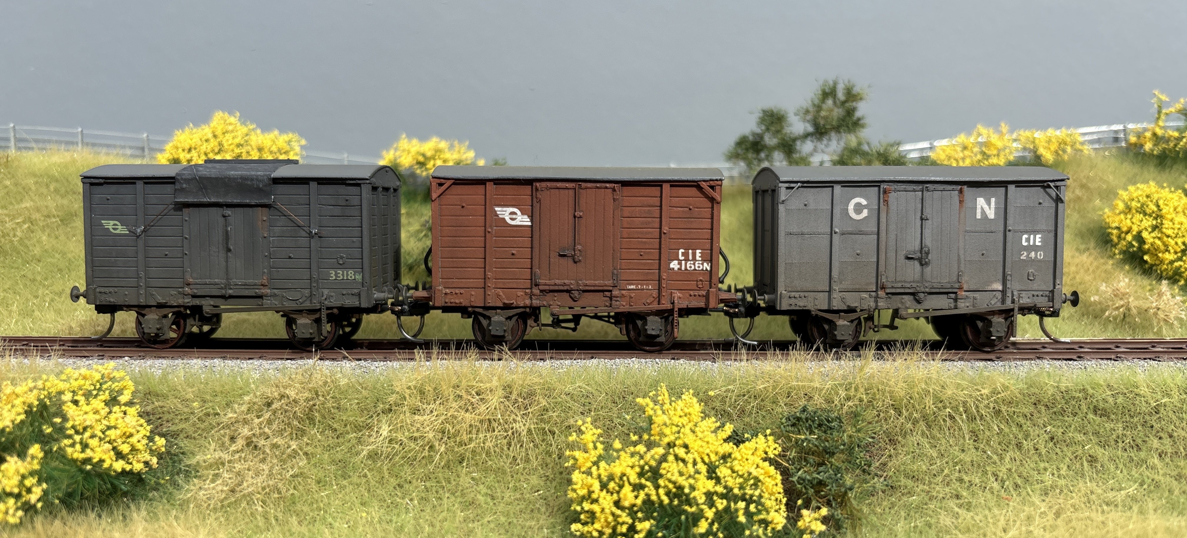

Ironroad Posted Wednesday at 15:05 Posted Wednesday at 15:05 This from Mayner (John Mayner-JMDesigns) would probably fit the bill very nicely but I don't know if he is still producing them. 1 1 1
Mol_PMB Posted Wednesday at 15:43 Posted Wednesday at 15:43 @Mayner's 3D-printed wagons are excellent and include some suitable for your proposed period, but may no longer be available. If you have a bit of experience of kit-building, then the resin-cast kits for GNR goods vans from @leslie10646 can also be built as GSR or MGWR variants and would fit the bill very well. But again, I'm not sure whether they are still readily available. @Bob49 produces simple 3D-printed kits for GNR 4-plank and 6-plank opens which can also be completed as GSR or MGWR variants: It all depends on how accurate you want to be. At first glance some of the wagons above look very similar to 1930s era British wagons which are widely available RTR and could be repainted into GSR livery quite easily. Lots of goods vans is really what you need, and there was a fair variety. Although this photo of Ernie's is from the 1960s, many of the vans in that train on the right are from the 1930s or earlier: 1 1

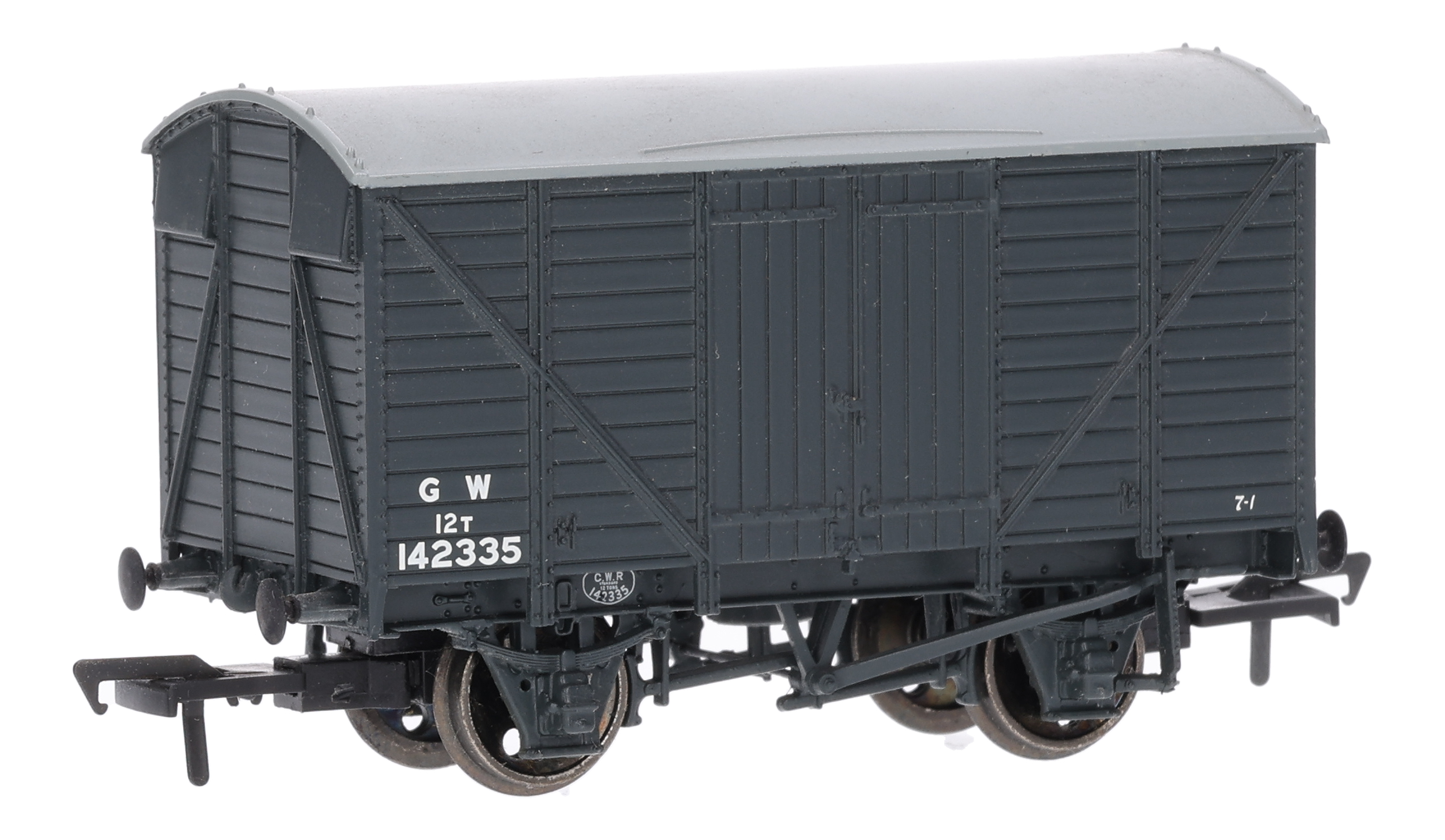

Mol_PMB Posted Wednesday at 20:07 Posted Wednesday at 20:07 This is a Bachmann GWR goods van which bears a pretty good resemblance to some built by the GSWR just prior to being grouped into the GSR. The ends and the brake gear are a bit different, but put some GS transfers on the side it wouldn't look out of place. 4

leslie10646 Posted Wednesday at 22:28 Posted Wednesday at 22:28 6 hours ago, Mol_PMB said: @Mayner's 3D-printed wagons are excellent and include some suitable for your proposed period, but may no longer be available. If you have a bit of experience of kit-building, then the resin-cast kits for GNR goods vans from @leslie10646 can also be built as GSR or MGWR variants and would fit the bill very well. But again, I'm not sure whether they are still readily available. Just to say that my GNR vans ARE still available. I should have a supply at Blackrock in a month's time. 5

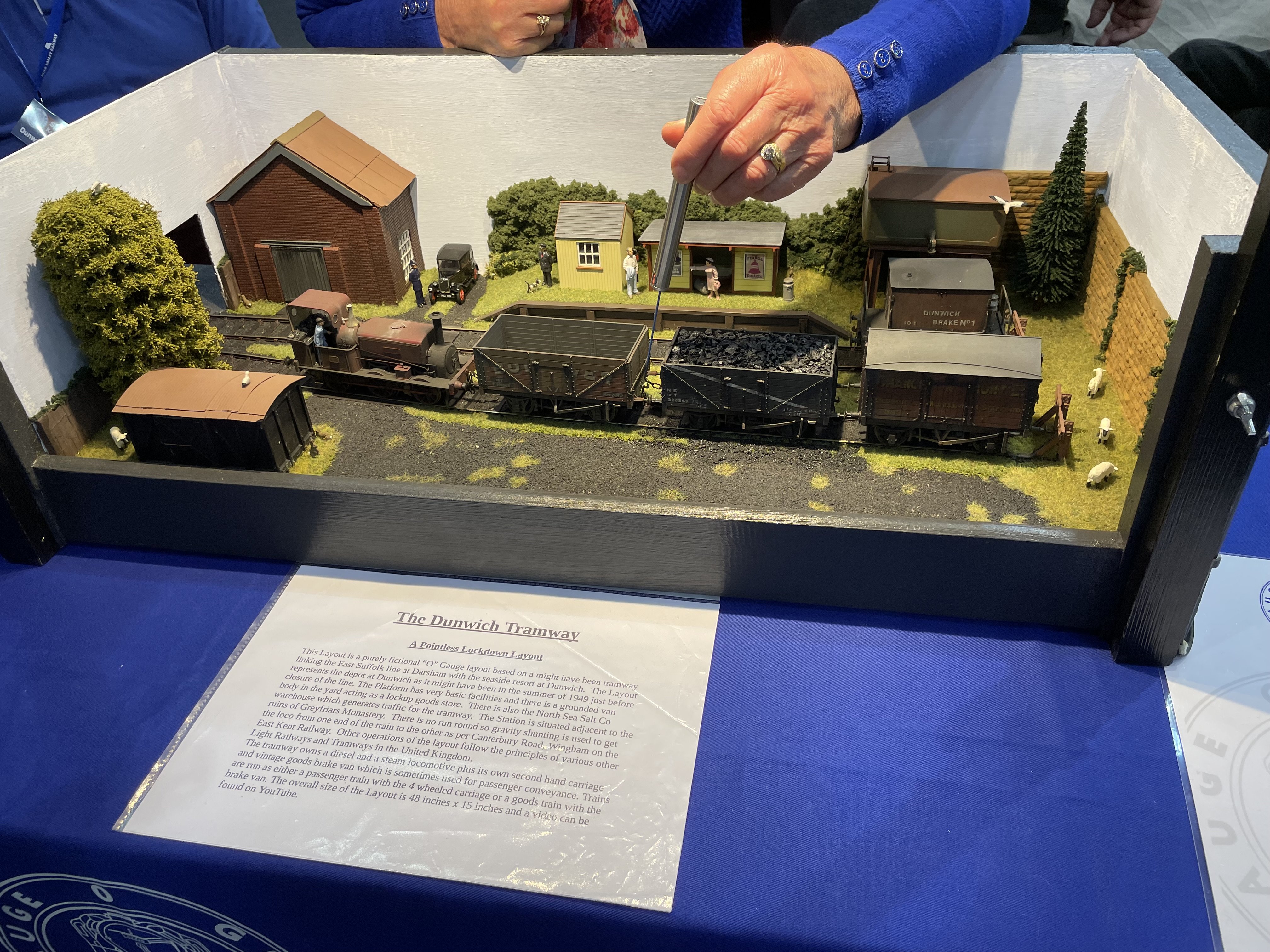

Northroader Posted Thursday at 09:58 Posted Thursday at 09:58 (edited) If you’re after ideas for a small industrial layout, you can do something boxfile size, which keep costs right down, trackwork and rolling stock, but give you some operating fun, until you want to upsize, or maybe build another. Useful ideas in here: https://micromodelrailwaydispatch.com A good example by a fine modeller on this site: Edited Thursday at 10:12 by Northroader 2 1

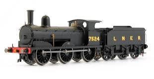

jhb171achill Posted Thursday at 16:57 Posted Thursday at 16:57 I'm a bit late to this party, but here goes: 1. I agree there is no model remotely like "Sambo", but I actually doubt it did go to the mills - I think it was confined to Inchicore Works. I'd be interested to know if it definitely did ever go anywhere else. 2. 00 Works J15, yes. LNER 0.6.0, yes. In the latter case, repainted grey. If you are in GSR times, no black locos and no green ones - every single loco they posessed was plain grey all over, no flying snails either - they only came with CIE in 1945. Cast cabside numberplates, no painted numbers (apart from a handful of suburban passenger tanks). 3. Small industrial-type loco, certainly - I had thought of that too. There were an extremely small number of things like that in reality - Allmans Distillery, Bandon, for one. The little engine of that line ended up being bought by the GSR who slapped a standard numberplate on it, but never repainted it, so it ended its days in barely recognisable badly faded delivery-colour manufacturer's green. (An exception to the grey rule!). 4. Wagons - yes, leslie's are the best option. CIE "H" vans, nice as they are, far too late for GSR era. I have three of the SSM ones - they would be fine, in reality. Overall, I think your era is an excellent one and a great way to start. 1

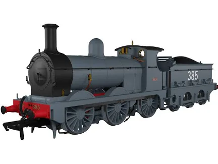

Galteemore Posted Thursday at 17:25 Posted Thursday at 17:25 (edited) Rapido SECR 0-6-0 in grey might work - only need repaint smokebox ! Edited Thursday at 17:27 by Galteemore 1

jhb171achill Posted Thursday at 19:54 Posted Thursday at 19:54 47 minutes ago, Wheelslip said: Thanks @Galteemore! Also, seek out WRENNEIRE of this parish. He can help you with just about any model under the sun. 2 hours ago, Galteemore said: Rapido SECR 0-6-0 in grey might work - only need repaint smokebox ! A bit more than that - grey far too light, and black roof and number on tender need to go too. Easy, though - simply repaint the entire thing, bar the red buffer beams, in a dark grey and put cabside number PLATES on, and hey presto - GSR.
