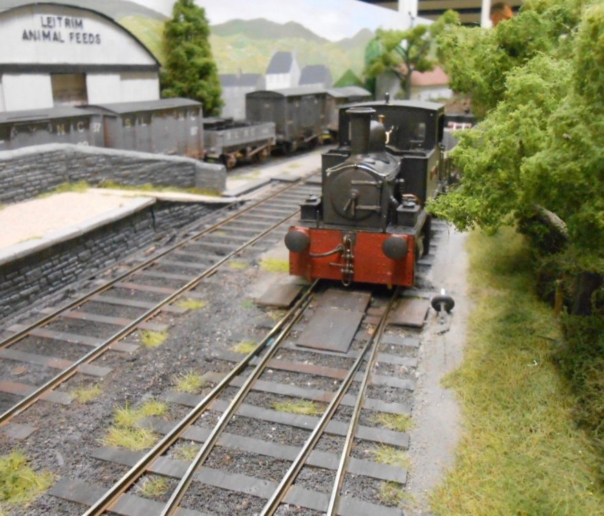

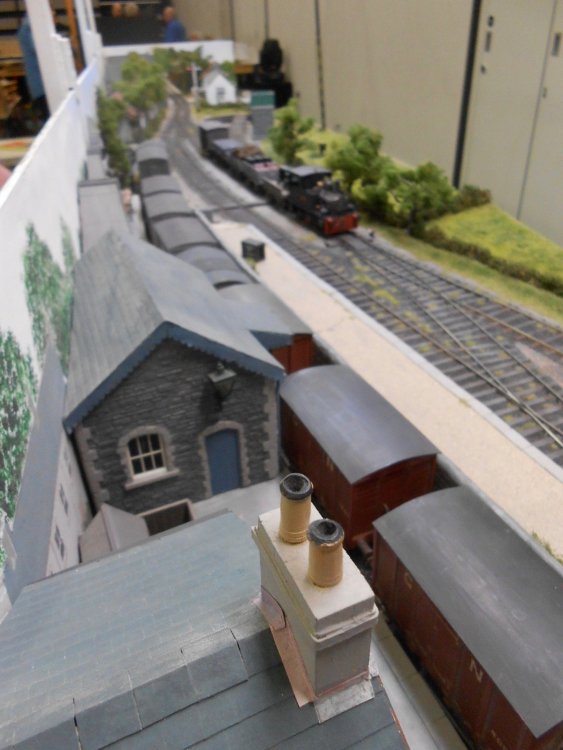

David Holman Posted May 23, 2014 Author Posted May 23, 2014 Turned the layout round recently, so I could do operating practice from behind - the way when it is exhibited. Discovered that there were a few areas that needed tidying up, not least that the rails were still shiny from this side. So, out came the rust coloured paint, along with a bit of track colour to touch up bare patches on the sleepers. Thought it then worthwhile to take a few pictures, as this viewpoint is not one that folk will see at a show. The downside is there is no backscene to frame the view. Also, Fermanagh has been receiving attention. The gearbox I used was not working well - the frames were too flimsy and the main gear too narrow. Replaced it with a Branchlines one. These are so much more robust and also really well etched. Just solder in the bearings and fold up the sides & it is complete. Fermanagh already runs more smoothly, which can only improve with a bit more running in on the rolling road. 1 Quote

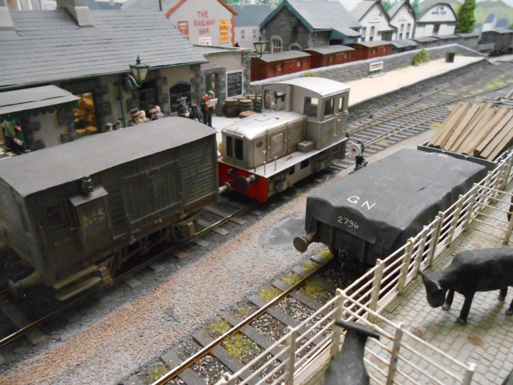

David Holman Posted June 3, 2014 Author Posted June 3, 2014 The layout is now about as finished as it can be for its debut, so here are pictures of the sequence of trains I'll be running. They are intended to reflect those of the real SLNCR. First up is the mixed train, Fermanagh, coach 9 & a couple of wagons. First job is to turn the loco, then move the brake to the stop blocks. After, in best Sligo style, the coach and wagons shunt the goods siding & all is made ready for departure. Next up is the railcar - a simple operation, out and back is all that is required. After comes the J26 and loaded coal wagons, down from the mines above Derreenavoggy. Arrive in the loop, move the brake to the platform [the intention is to eventually have a small group of miners here, looking like they are coming off shift], then away again. no turntable for the tank. We then have the railbus, which certainly needs turning & finally, Hazlewood and the goods. After turning, the loco shunts the cattle dock and goods siding, before departing with its small string of wagons. Too many pics, so will add the goods in a moment Turn the fiddle yard and start again... 1 Quote

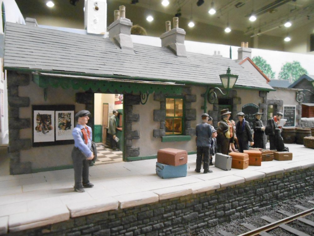

David Holman Posted June 13, 2014 Author Posted June 13, 2014 After around three years of planning and construction, Arigna Town is at last out in the public domain. Chatham Club members assembled from 7am this morning to begin setting up the exhibition halls, beginning with marking out the 100+ stands, while the sparkies began adding the same number of power points. A huge number of tables and chairs then needed setting out for exhibitors and the public - all in time for the first arrivals early in the afternoon. After setting up the new club's 0 gauge circular layout [only at the 'test track stage at present], I went home to get Arigna Town, which was fully set up by late afternoon. The photos show the layout in its full presentation mode, complete with pelmet and fascias, both of which include constructional and prototype information. Should any of you make it to the show - please come and say hello! 1 Quote
