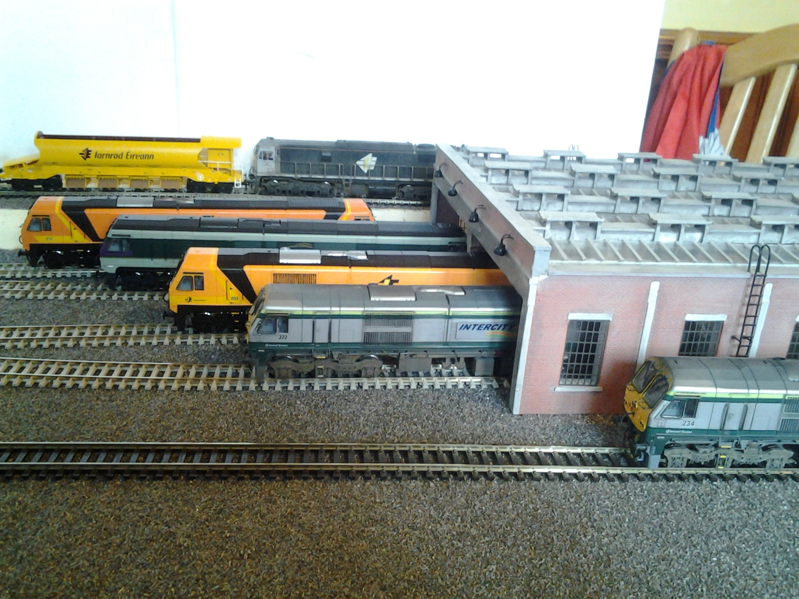

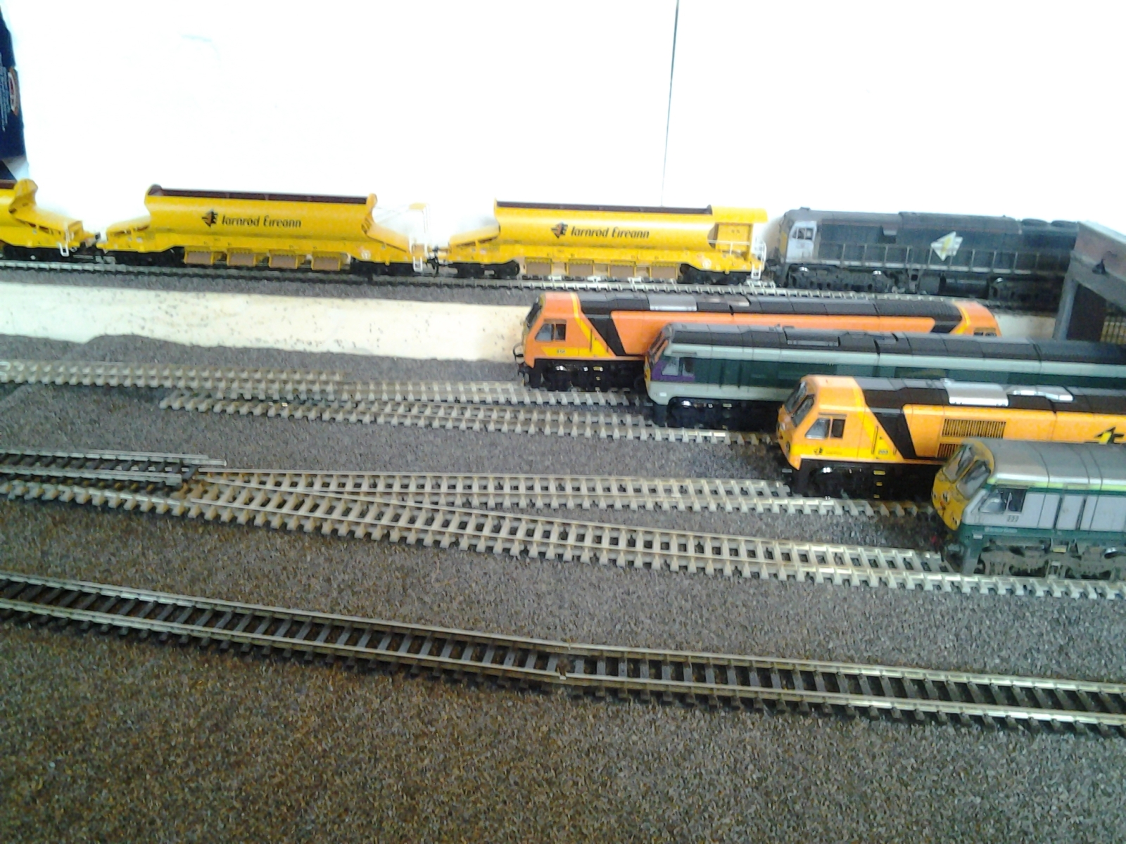

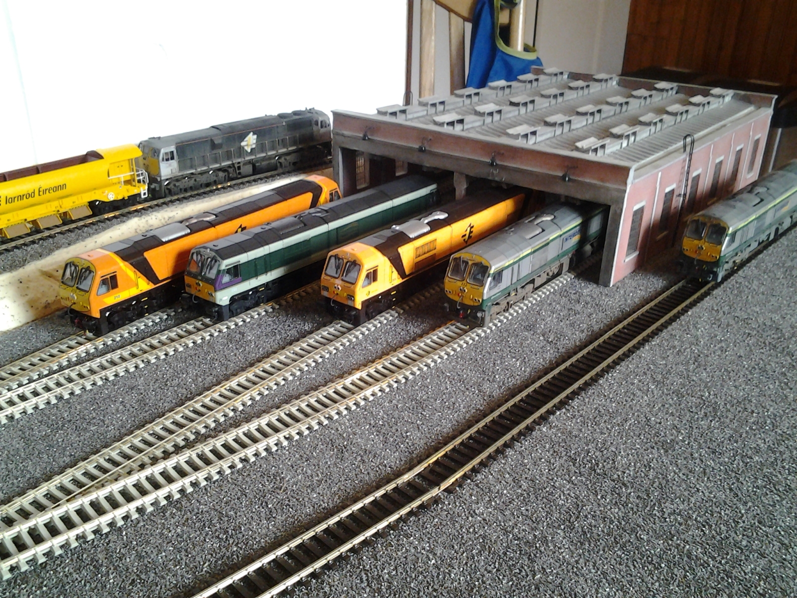

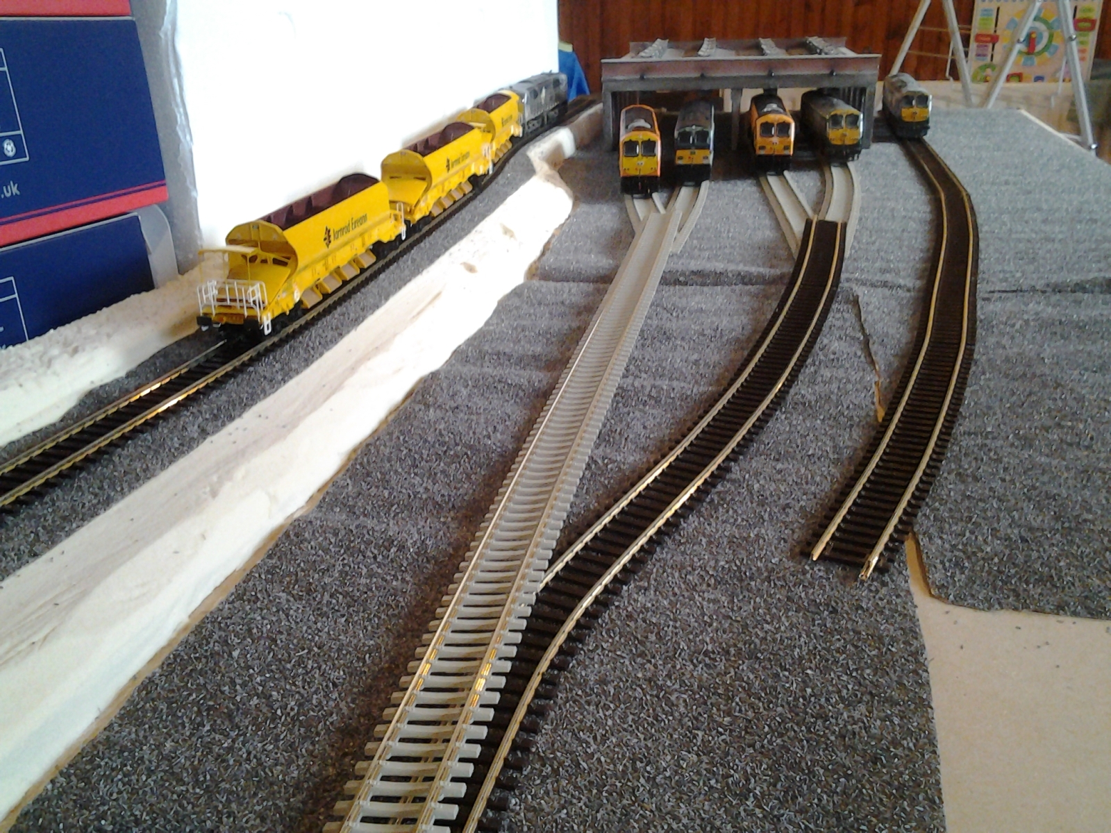

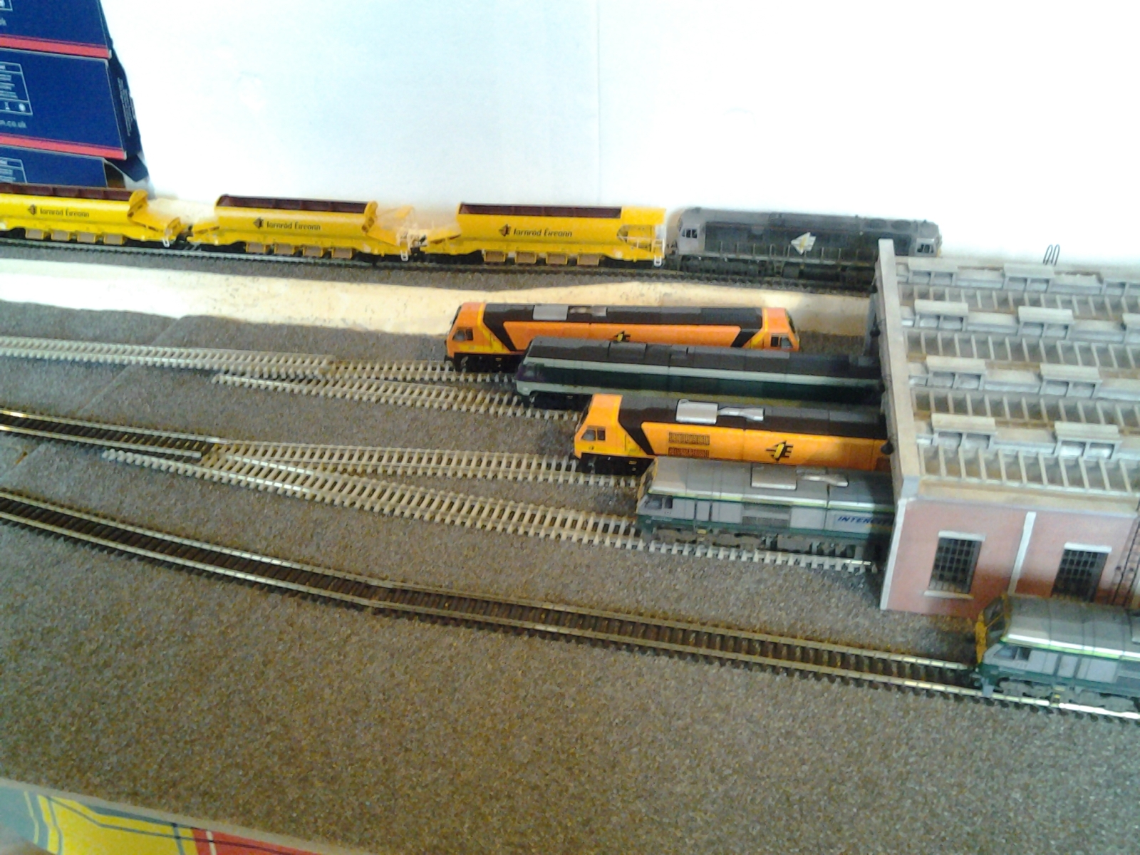

rebelred Posted October 26, 2014 Posted October 26, 2014 (edited) With the missus & Kids away for the weekend I started this new project.After hunting down this Loco Shed for so long I didn't want to leave it gathering dust in a box so decided to do a modular layout & the plan is to wire it up so i can move the Loco's in & out of the shed using a 'shuttle' system. The tracks are just laid down loose so i know what type of points & curves i need.i also need more Ballast mat so i just have a few smaller pieces down loose to give me an idea. im not really sure what to do with the right hand side of the Loco shed where the '5th' road is, maybe a freight yard or put down a road instead of track??? any suggestions i'd welcome. My next step is finish the ballast & buy all the tracks/points that are needed then tackle the ditches.I plan to put a hut beside the Loco shed besides the 1st road going flush with the ditch & put a stone wall on the flat part of the ditch beside the hut. I want to do a concrete floor in the loco shed but was wondering what the best material to use for this effect? Also the 201 class Locos don't fit in to the shed whereas the 071/141/181 locos do so i'm gonna haft to raise the shed doh! as I said any sugestions, tips are very welcome, hope i'm doing it right!!! : Edited October 26, 2014 by rebelred spelling
aclass007 Posted October 26, 2014 Posted October 26, 2014 I think I'd run track down the outside of the shed, just like you have done there. It would be usual to see a loco parked along side a shed in real life, again just like you've done there. Also, the extra track would be useful to have when shunting or moving locos around. You could always run something into it out of the way. Looking at the pics, the 201's seem to fit fine under the shed as it is. If you intend to put a concrete floor in, I'd put the concrete between the tracks as opposed to putting the track on top of the concrete floor. That would keep the height down, and be more realistic too.
Riversuir226 Posted October 26, 2014 Posted October 26, 2014 Really like the plan, for the concrete floor id use polyfilla and id also have a peco inspection pit on one or more roads . Polyfila could be used on top of regular track up to rail height. I like the idea of having a line outside of the shed and the shed really is an excellent focal point. Nice collection of 201's:tumbsup:
aclass007 Posted October 26, 2014 Posted October 26, 2014 It might also be worth adding some OO gauge oil barrels, skips, bins and such around the shed to add some realism.....
rebelred Posted October 26, 2014 Author Posted October 26, 2014 Thanks for the feedback guys, Better add Polyfilla to the shopping list!! inside the shed are extractor fans hanging from the ceiling & they are catching the 201's just where the roof grate is, a mm or so is all i'd need to raise it by, as i said the 071's fit perfectly underneath. Thanks lads.
Riversuir226 Posted October 26, 2014 Posted October 26, 2014 (edited) Raise the edges of the building with balsa or plasticard would be the best way id say What track code are you using? Edited October 26, 2014 by Riversuir226
Dave Posted October 26, 2014 Posted October 26, 2014 Looks great, are you planning to make the modules portable? If so you could make them to the spec on the modular layout section http://irishrailwaymodelling.com/showthread.php/2465-Modular-OO-Layouts
DiveController Posted October 26, 2014 Posted October 26, 2014 Raise the edges of the building with balsa or plasticard would be the best way id say What track code are you using? You could make a foundation slab with the polyfilla large enough to be the floor and a peripheral foundation for the shed itself to raise it back to rail height. I suspect that this will provide enough clearance for the 201s. The slab foundation will look well with the face of the shed which appears to resemble concrete and the side which is brick could be painted as a plinth, disguised with brick plasticard, shielded with ballast along the side tapering from the shed to road 5, or weeds and 'scrubby plants'.
rebelred Posted October 26, 2014 Author Posted October 26, 2014 Will try that DiveController, Thanks!, im using Peco Code 100 Tom as my Track, need to get the matching points now to sort the trackwork out.

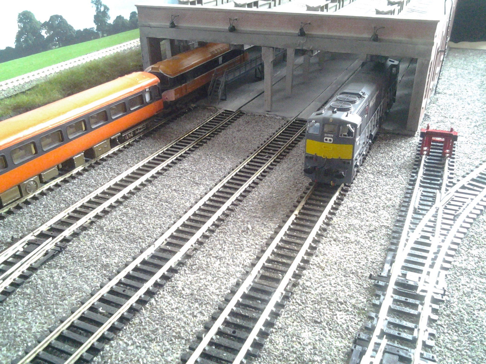

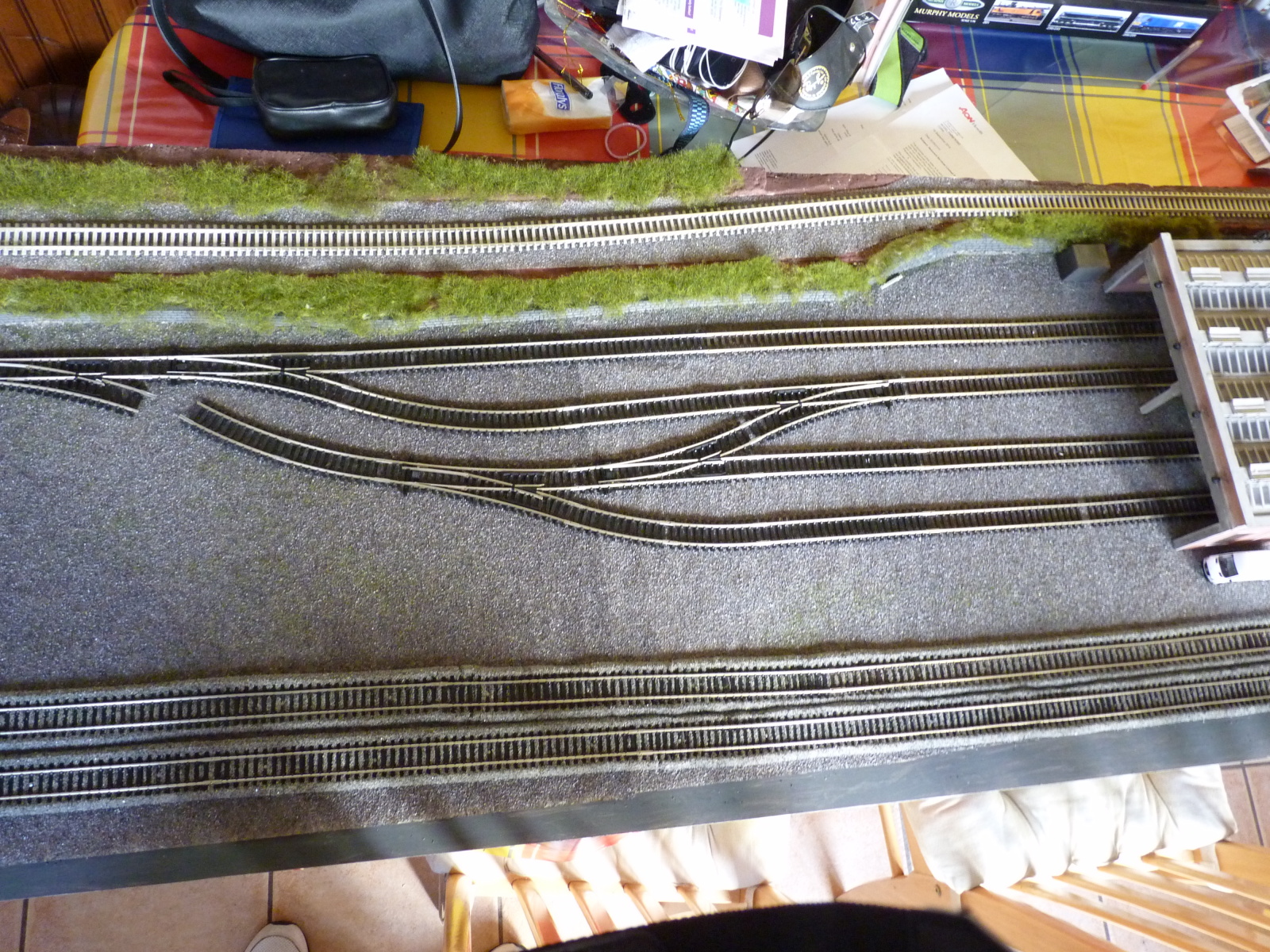

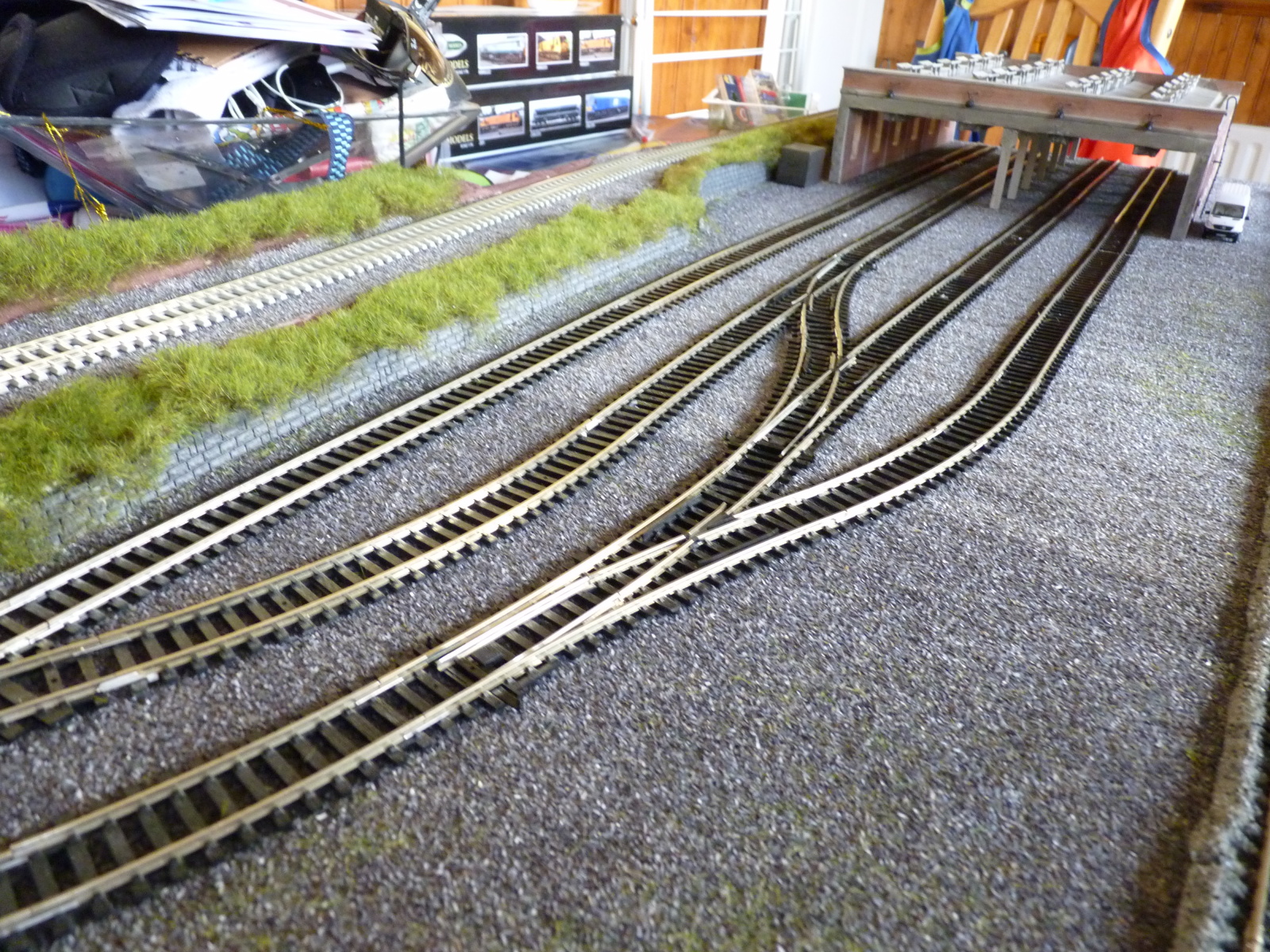

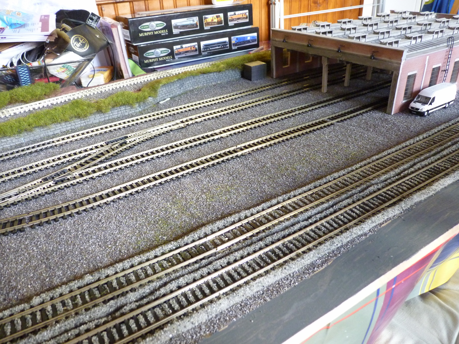

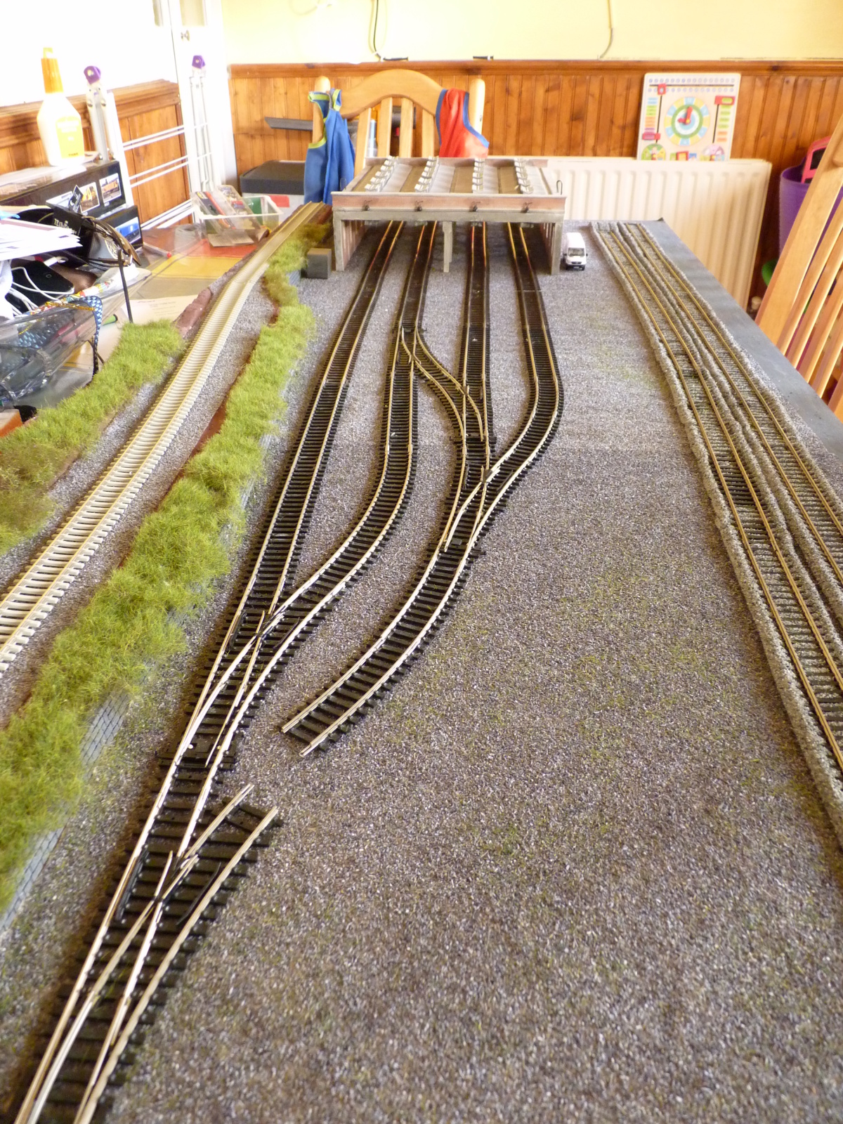

rebelred Posted November 14, 2014 Author Posted November 14, 2014 I managed to get more work done on my Loco shed, laying the track,ballast, as well as getting the ditches done, its far from finished as i have a lot of furniture & fictures to be got & put in to the layout, any ideas/ comments are welcome
burnthebox Posted November 14, 2014 Posted November 14, 2014 Rebelred, that sure is looking very smart, and comfortable too, well done, keep the pics coming,
BosKonay Posted November 14, 2014 Posted November 14, 2014 If using the ballasted foam, I'd highly recommend gluing the foam down rather than pinning the track, as the foam then looks squashed Otherwise looking excellent!
rebelred Posted November 14, 2014 Author Posted November 14, 2014 Thanks B.T.B & BosK for the tip , do you glue the track to the foam then or do you use pins?? By the way i bought the wrong size track for the missing piece of track hence the gap at the top!
BosKonay Posted November 14, 2014 Posted November 14, 2014 What I did when using it was slot the track into the foam then glue the foam to the baseboard. That lets the foam keep a nice profile and shoulder and excellent noise reduction as te track 'floats' on the foam.
rebelred Posted November 14, 2014 Author Posted November 14, 2014 I'll try that & see how it works out

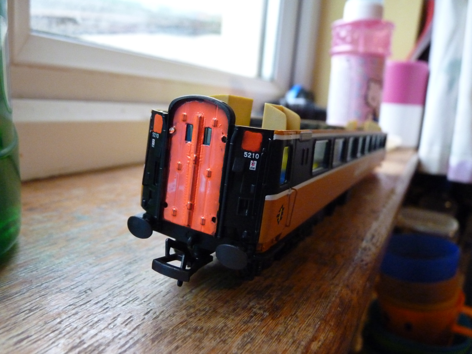

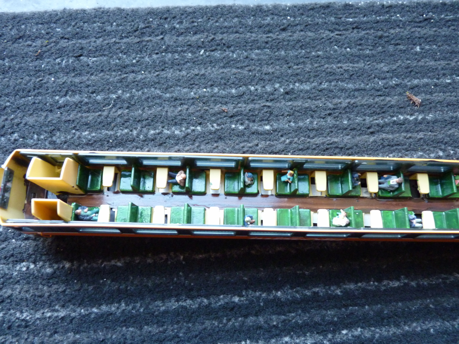

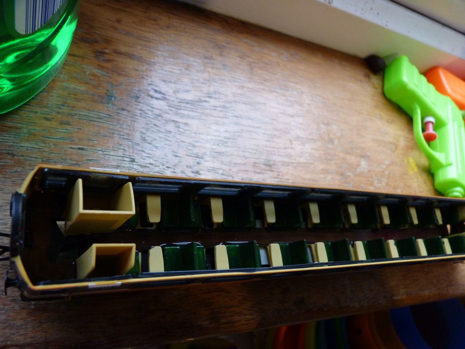

rebelred Posted December 12, 2014 Author Posted December 12, 2014 I modified the interior of one of my Mark 2 coaches, painted the seats,floors & added some passengers. I also painted the gangway doors & warning panels a Dayglow colour instead of the original red.
Noel Posted December 12, 2014 Posted December 12, 2014 Great idea. How easily does the roof come off MM Mk2 coaches? Somebody suggested to me that the most cost effective way of putting passengers in coaches was to buy assorted packs of folks standing, but cut off their legs and glue them onto coach seats as most seated figures might not fit under tables, or between tables and seating. This was aside from the cost savings compared to buying seated passengers. Has anybody tried this? I'm hoping to repaint the fluorescent blue seating in our cravens and place passengers in them over the Christmas holidays. I'd rather not reinvent wheels if possible.
rebelred Posted December 12, 2014 Author Posted December 12, 2014 Honestly Noel, this coach rolled off the table & the roof came off (only damaged a bogie) so i took advantage but there are clips running along the length of coach so if you squeeze the roof along the sides the roof should lift & you might need to lift the roof above the gangways using a flat tool - id take off the gangways at the end first- they just pop out. The cravens are different, i want to do the same with mine. My passengers are a mixture of Noch sitting people, half had no legs so they were easy to put in, the ones with the legs dont fit flush so put glue on their arses & top of their backs & that held them in place!

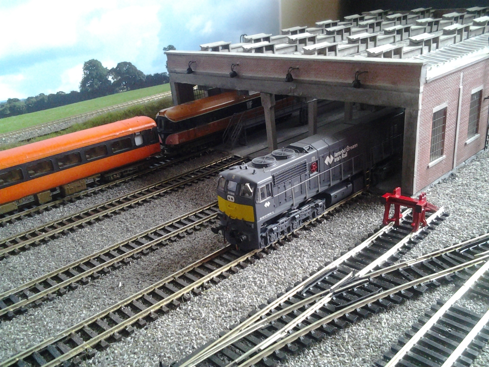

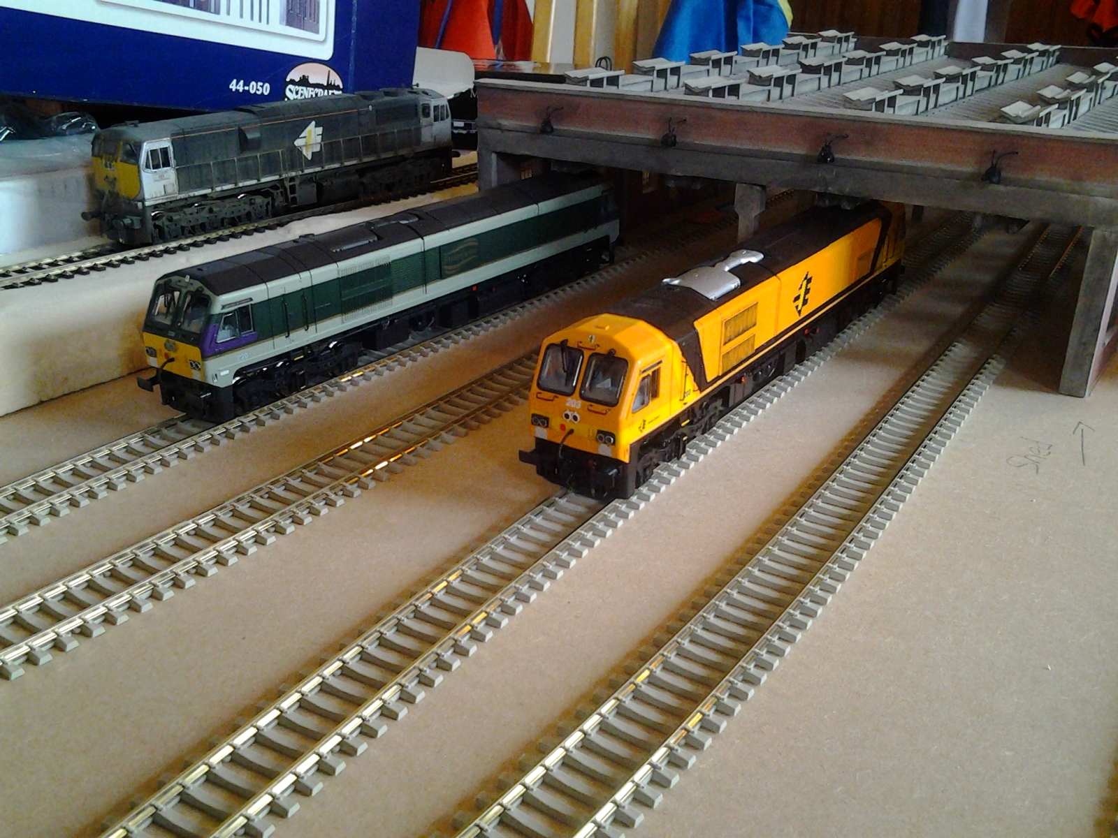

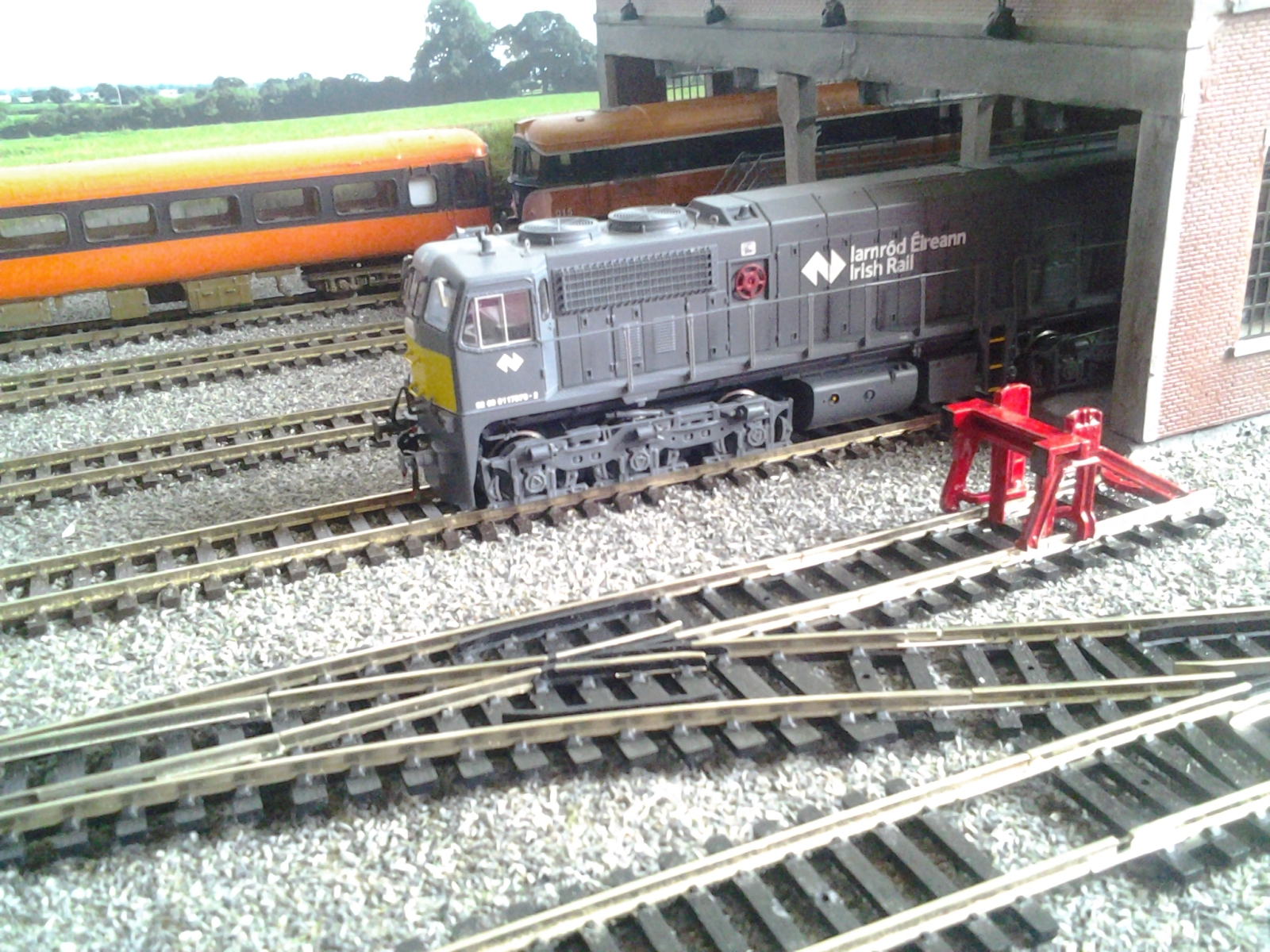

rebelred Posted December 19, 2014 Author Posted December 19, 2014 My Homework this week as well as putting in a concrete floor in the shed.Not finished painting these yet & i keep changing the track layout as im not happy with it. Ive a new found respect for lads here with multiple roads,branches & points!!!!
rebelred Posted December 19, 2014 Author Posted December 19, 2014 (edited) [attach=config]16446 i've no idea why the photos are coming out upside down, ive rotated them & they're still the wrong way up, it's a lot easier loading photos on a laptop rather than a tablet Edited December 19, 2014 by rebelred photo error
heirflick Posted December 19, 2014 Posted December 19, 2014 [ATTACH=CONFIG]16444[/ATTACH] My Homework this week as well as putting in a concrete floor in the shed.Not finished painting these yet & i keep changing the track layout as im not happy with it. Ive a new found respect for lads here with multiple roads,branches & points!!!!
driver301 Posted December 19, 2014 Posted December 19, 2014 It is taking shape Rebelred. Keep up the good work & updates.
rebelred Posted December 26, 2014 Author Posted December 26, 2014 've finally won the missus round with this modelling lark (despite taking over her kitchen table for a few days using it as a workbench!!) & she bought me 078 in battleship grey for xmas- she's opened a Pandora's Box now, no going back!
DiveController Posted December 26, 2014 Posted December 26, 2014 You could make a foundation slab with the polyfilla large enough to be the floor and a peripheral foundation for the shed itself to raise it back to rail height. I suspect that this will provide enough clearance for the 201s. The slab foundation will look well with the face of the shed which appears to resemble concrete and the side which is brick could be painted as a plinth, disguised with brick plasticard, shielded with ballast along the side tapering from the shed to road 5, or weeds and 'scrubby plants'. Do the 201s fit? 7078 looks great!
Dave Posted December 26, 2014 Posted December 26, 2014 Looks great, really like that livery. Layout is taking shape nicely
rebelred Posted December 26, 2014 Author Posted December 26, 2014 Very nice! Has she a sister? 3 of them but i got the best one! Thanks lads, yeah DiveC, the 201's fit perfectly underneath now, i put filler down as a concrete floor which gave me an extra few mm's as you suggested so sorted that problem.Thanks for that again!
