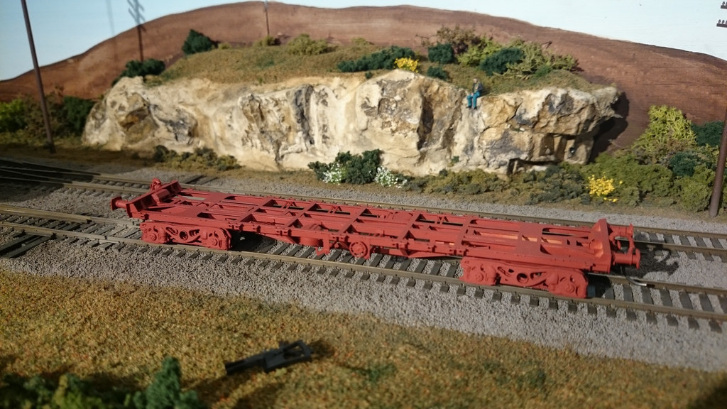

NIRCLASS80 Posted December 23, 2014 Posted December 23, 2014 Thanks to everyone for this guide and help, much appreciated. Here is my attempt on flickr.
enniscorthyman Posted December 23, 2014 Posted December 23, 2014 Thanks to everyone for this guide and help, much appreciated. Here is my attempt on flickr. Lovly job there, NIR Class 80. 1
Dave Posted December 23, 2014 Posted December 23, 2014 Very nice work, I have to get a few of them. Did you glue them together or solder?
