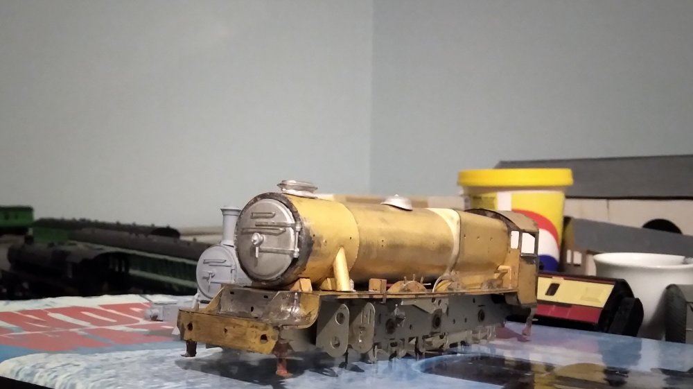

GSR 800 Posted March 17, 2016 Author Posted March 17, 2016 Tea consumption has gone up, by 43.2 percent... Modified smokebox door.. Goodnight all

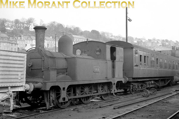

GSR 800 Posted November 3, 2016 Author Posted November 3, 2016 I had quite a bit of difficulty, when squinting at photos of J26s late in their service lives, trying to make out the smokebox rivet patterns as the photographic qualities weren't the best. Eventually, a photo of 560 on the little turntable at Waterford suggested that not only were there a lot of rivets, but that the ones on the smokebox front did not line up horizontally with the ones on the smokebox wrapper, giving a sort of staggered effect. Not sure how my rivet press is going to cope with this! You sure mate? Look pretty even to me...
Garfield Posted November 3, 2016 Posted November 3, 2016 You sure mate? Look pretty even to me... They're not even in that pic, they're staggered...
GSR 800 Posted November 3, 2016 Author Posted November 3, 2016 They're not even in that pic, they're staggered... Only one way to settle this..
RedRich Posted November 3, 2016 Posted November 3, 2016 I'm with Pat and Ivan on this, they are staggered in that pic. Rich,
Horsetan Posted November 3, 2016 Posted November 3, 2016 (edited) Only one way to settle this.. If you look at the rivets on the smokebox front of 560, and then try to line them up with the adjacent rivets on the smokebox wrapper (a bit like "joining the dots"), what you get is a zig-zag pattern, hence staggered. Most people won't be too fussed about this, and that's fine, but it is something I noticed and since I have a rivet press I might as well give it some proper work to do! GSR/CIE really were great believers in rivets - smokeboxes were absolutely covered in them, and it can be a total pain in the **** when you're trying to get it right. The other thing I have to try to do is calculate how many rivets there are around the smokebox front of 560. Edited November 3, 2016 by Horsetan More rivets!
GSR 800 Posted November 3, 2016 Author Posted November 3, 2016 If you look at the rivets on the smokebox front of 560, and then try to line them up with the adjacent rivets on the smokebox wrapper (a bit like "joining the dots"), what you get is a zig-zag pattern, hence staggered. Ah! I see what you mean now! My mistake...
Glenderg Posted November 4, 2016 Posted November 4, 2016 Agreed, with Red, the reason they're staggered is so that the ends of the rivets don't bump into each other as they are fixed, creating a stronger joint. If all the rivets were on the same plane, you'd have a Michael Bay situation, and nobody wants that
Horsetan Posted November 4, 2016 Posted November 4, 2016 I make it 33 visible rivets on 560's smokebox front.....so far.
GSR 800 Posted November 4, 2016 Author Posted November 4, 2016 GSR/CIE really were great believers in rivets - smokeboxes were absolutely covered in them, and it can be a total pain in the **** when you're trying to get it right. The other thing I have to try to do is calculate how many rivets there are around the smokebox front of 560. CIE, certainly, but the GSR maybe not as much. However, it was the GNR that started the pop head rivets on their locos, for the sole reason the were a hell of a lot simpler to take out than the countersunk rivets. Even the 800s originally had countersunk rivets. In my opinion, despite being a pain in the a^$<'*#$ to model, The (three thousand:p) rivets are a major charictestic feature of Irish locos in the CIE period

Horsetan Posted November 4, 2016 Posted November 4, 2016 Actual rivet-counting, actually going on as we watch, you don't normally actually see it happening in front of your actual eyes. It might actually be 35 rivets because there are a couple that seem to be hidden by the smokebox door hinges. I've taken a close-up photo of the original photo, and will see if I can blow it up even more to verify the count.
GSR 800 Posted November 4, 2016 Author Posted November 4, 2016 It might actually be 35 rivets because there are a couple that seem to be hidden by the smokebox door hinges. I've taken a close-up photo of the original photo, and will see if I can blow it up even more to verify the count. Give us a look, you might need a break from all the rivet counting....you start hallucinating after a while....
