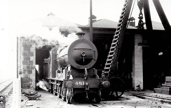

The depot hoist is more suited to a large loco depot than a railway goods yard. Waterford had a hand operated gantry outside the shed, Grand Canal Sheet had a sheerlegs Class K 2 - 461 - 2-6-0, built 1922 by Beyer Peacock as Dublin & South Eastern Railway No.15 - 1925 to GSR as No.461, 1945 to CIE - withdrawn 1961 - seen here at Dublin Grand Canal Street in 1938.
