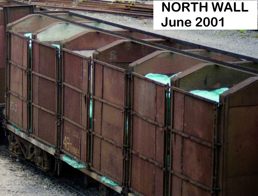

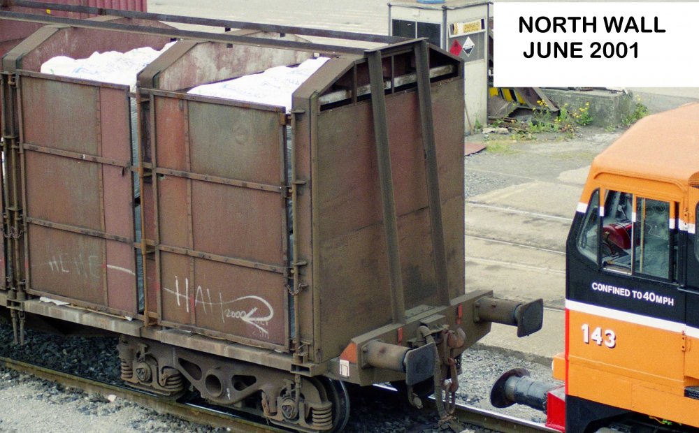

White or green , the green may possibl;y have been loose covers over the white for added weather protection
judging by the green bits hanging out of the bottom of the doors.
Ernie

You're absolutely right, Ernie, I had forgotten about that.
They'd load a pallet full of fert bags, and sometimes this entire pallet was coat with some sort of strong cellophane-type cover. That's the stuff you see.
The weathering details in your pic will be very useful to those who model these wagons.
Incidentally, that "48 TONNES" on the side of them was a late addition. It was not in them when new, or for a long time afterwards.
And NO CIE roundel on the side - normal for IE (later) days, though you'd still see a few CIE logos to the end. None ever carried IE logos.
If we wanted to be REALLY pedantic, and rivet-counting, it might be observed that the "48 TONNES" bit I see best matched with no logo. If you have that wording, and a logo, the latter is going to be old and workstained.
When new, all markings were, as on ALL brown CIE wagons, white. But they didn't stay that way, any more than white markings did on grey wagons!

Having lots of experience of the fertilizer traffic on this side of the Irish Sea, the polythene cover would be shrink wrapping which was applied to (A) keep the bags clean, also weather proof for outside storage and (B) hold the bags in stacks on the pallets. Because when the bags were being moved on  belts, rollers and  auto palletizers in the factories they got sprayed with a silicon lubricant. This meant that when the pallets of bags were moved any distance they promptly fell off the pallets. dont ask how I know but I have hauled 1000's of tons of fertilizer. In later years the bags were also glued together but thats another story!  I cannot remember the bulk bags having any kind of shrink wrapping, the product was contained by an inner liner that the outer, think big builders bag, contained which took all the lifting strains. Here endeth!!!!!!!!!!
