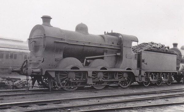

Class J 5 - 634 - M&GWR Class F 0-6-0, built 1921 by Broadstone Works as M&GWR No.40 - 1925 to GSR as No.634, 1945 to CIE - withdrawn 1959.
MGWR Cattle Engine F Class GSR J5

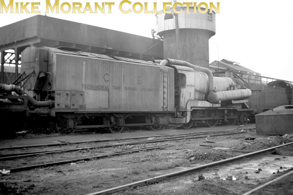

If it's strange looking steamers you're after, don't forget the modified GS&WR prelude to the CC1
Vintage Irish Republic Railways - Steam in Eire - 1954Inchicore works on 24/4/54 with Bulleid's turf burning locomotive taking centre stage. This rebuilt loco had been cobbled together in 1952 using ex-GS&WR K3 2-6-0 as the base and never again saw main line service as it was simply a static test bed. Withdrawal and scrapping finally put her out of her misery in 1957.
A weirdly beautiful machine..she is among my list of " should have been preserved "
