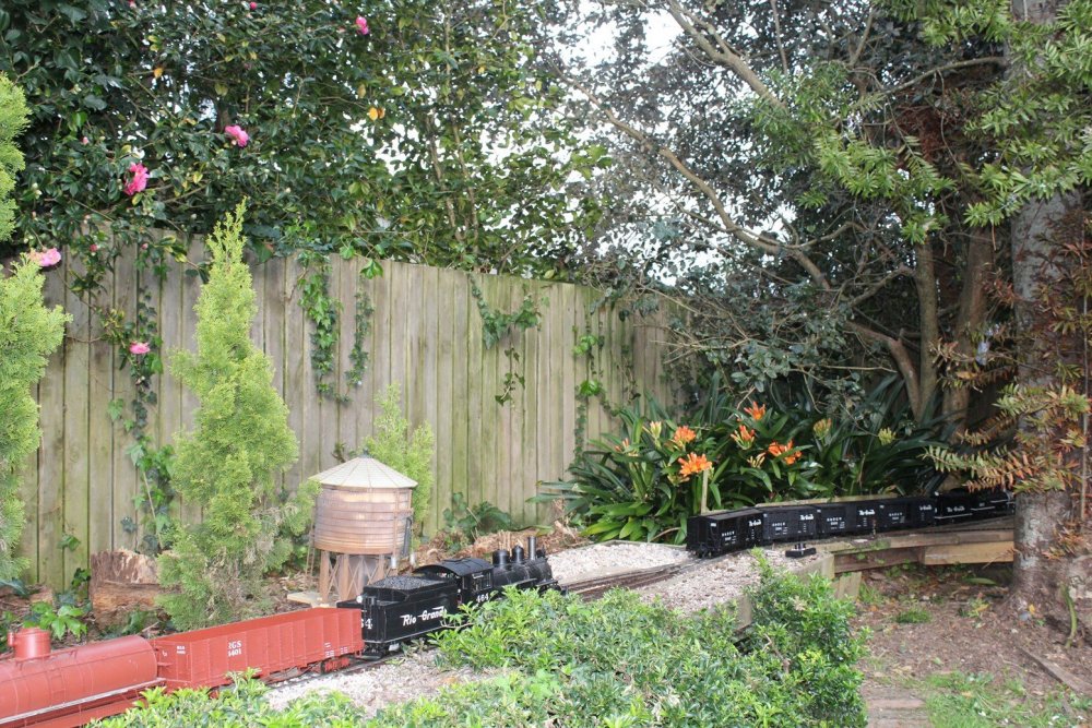

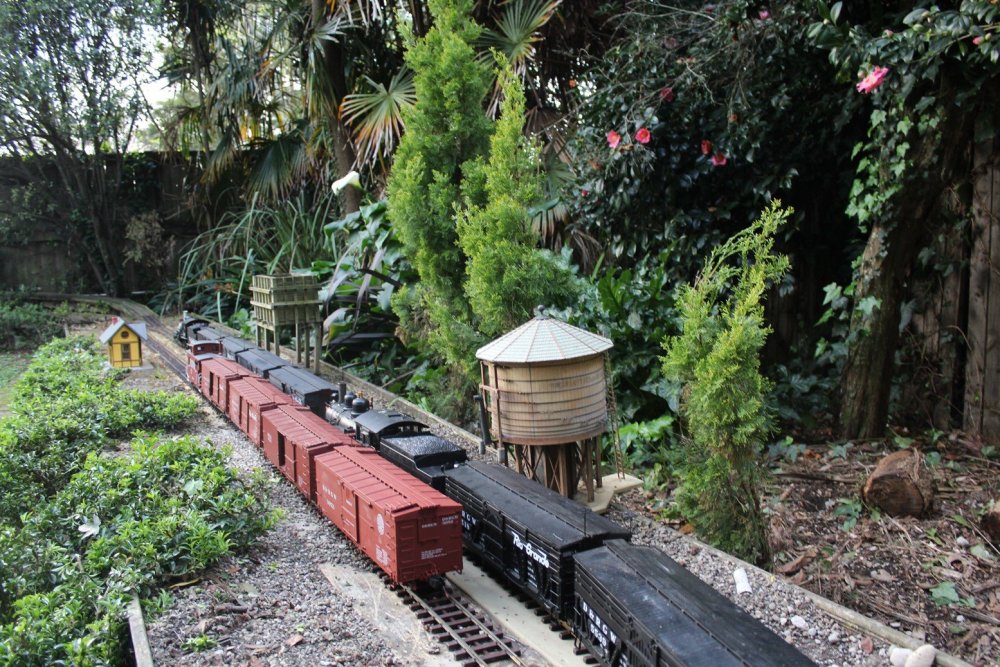

Finally added a water tower to the main station after 8 years! Picked up a Piko water tower on e-bay nicely weathered.

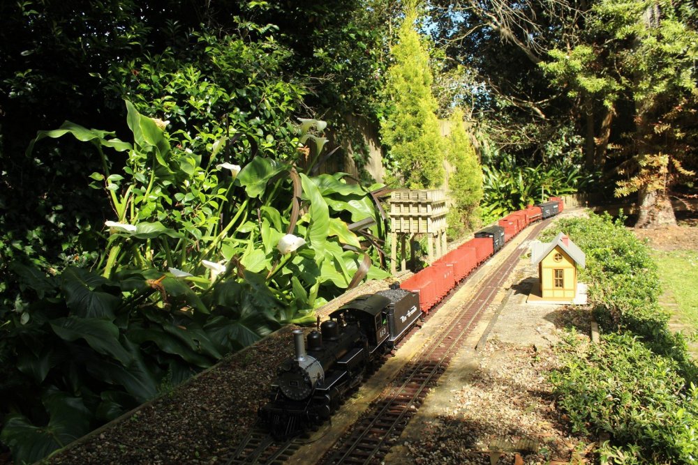

RGS Motor #4 on the passenger/mail run. This is a brass model produced by Accucraft about 8 years ago converted to on board battery 24GH RC control.

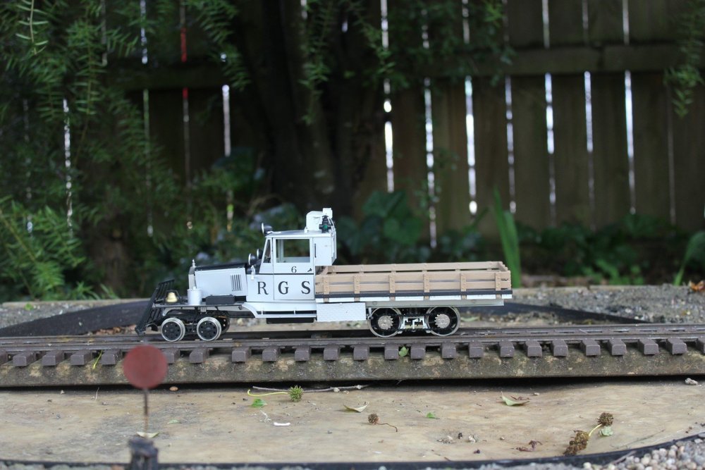

RGS Works Motor #6
This is a Berlyn Locomotive Works brass model dating from 1999 currently track power I am planning to fit this with a stay alive DCC chip.

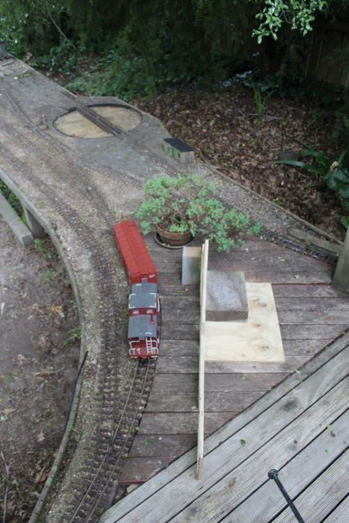

The turntable works nicely but is a tight fit for 464. Basically a length of decking pached on washers pivoting on a coach screw

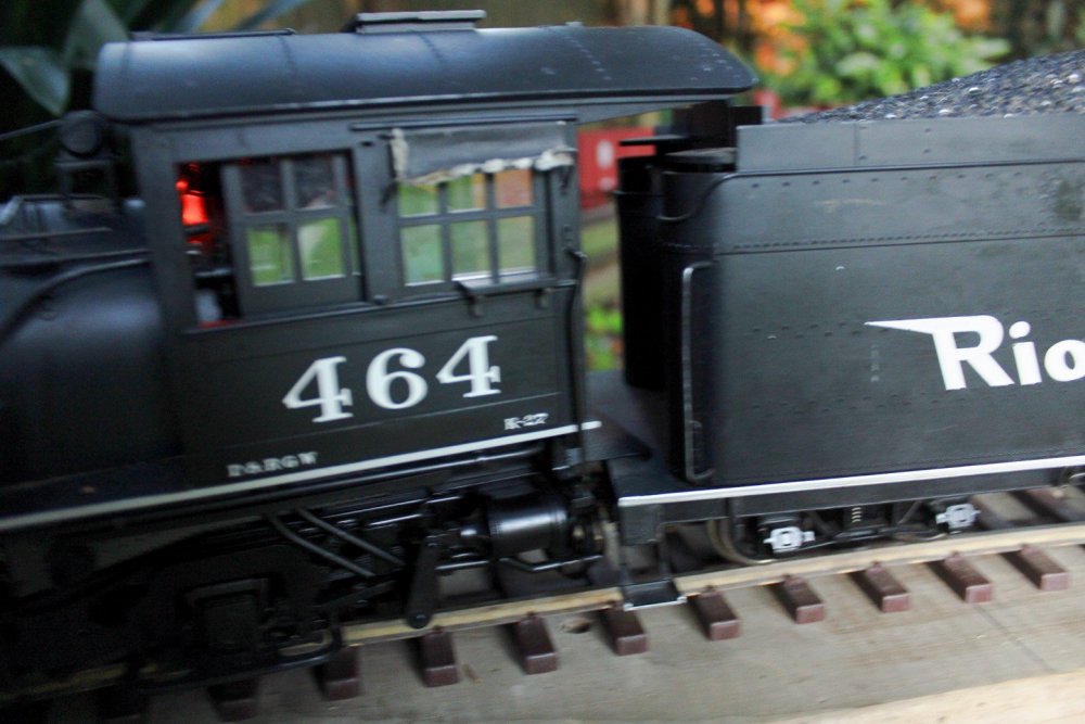

One of the jobs was to convert my old Bachmann 4-6-0 to on board battery control and a repaint in satin black as my stash of Floquil Dirty Black with its nice bulish tinge had finally run out. The loco derailed while on test rolled over and I ended up having to re-build the cab. I am planning to decal and varnish the loco before weathering

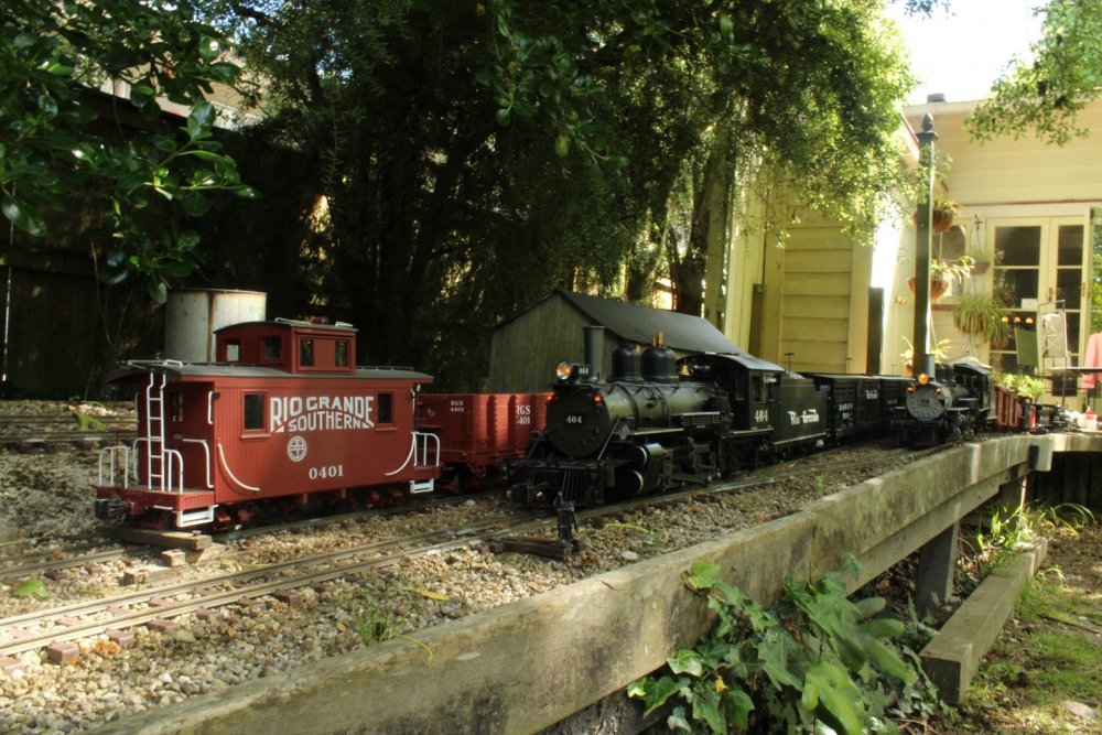

The Jackson County like the Rio Grande Southern seems to hire locos and freight cars from the DRGW to move heavy seasonal freight traffic.
This was our 1st weekend of winter, and we ran our 1st freight train in about a month after a lot of leaf sweeping/blowing/shredding and a new radio transmitter from RCS in Australia.

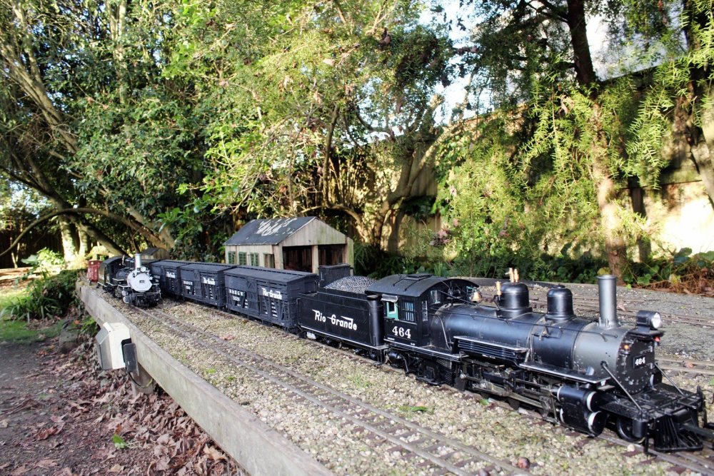

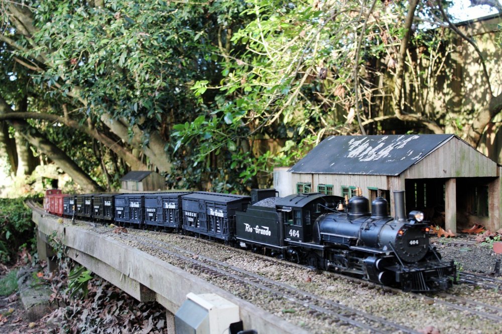

Jackson City DRGW K27 #464 arrives with stock cars and box cars from Placerville
#464 was regularly hired to the RGS during the late 1940s early 50s traffic ore in boxcars from local mines and sheep during the fall stock rush. Sometimes up to 3 locos were needed to move heavy stock or ore trains.

Having converted the Bachmann Big Haulier to on board battery control it was difficult to resist running a double headed freight with the modified Bachmann Connie 2-8-0. The 4-6-0 is just about capable of pulling 5 cars and caboose without slipping the 2-8-0 can manage 8 the 2-8-2 12 over my hilly line.
Locos on shed waiting departure this is the 1st time I had two battery powered locos on shed.

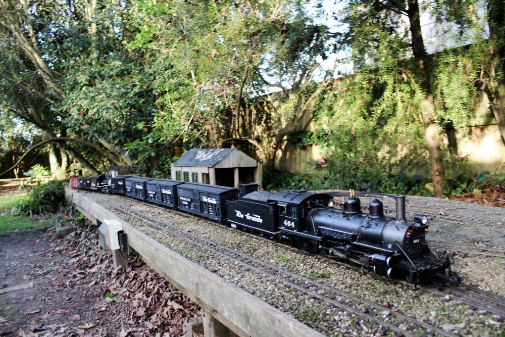

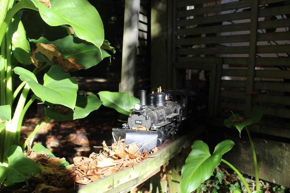

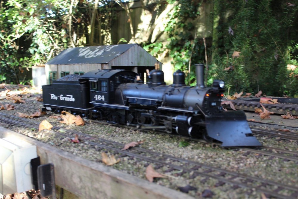

That time of year again! I decided to retrofit 464 with her snowplow and see how she would do with a recent leaf fall.  On sunny days our sweet gum and oak trees provide nice shelter from the sun, the down side is 6-8 weeks leaf clearing in Autumn
A couple of weeks earlier 464 arrives with a train of stock & boxcars this is a near repeat of a photo taken 12 months earlier only changes are the caboose and the loco shed getting into an even worse condition.
Bachmann originally produced this loco with a snow plough pilot, though I was able to source a road pilot with a standard cow catcher as a spare part from Train World, the front platform is a weak point on these locos, the stays back to the smokebox serve a real purpose as a section of the diecast loco chassis had broken off just forward of the cylinders.
464 arrives on leaf clearing duties the snowplough is temporarily secured in place on the pilot with short pieces of brass rod.
Temporary set up clearing the high line. At this stage the snowplough was held in place by a pair of rubber bands.
Over the High Line and across the Warren Truss bridge. I am planning to re-build the "High Line" as a long wooden trestle similar to one of the Ophir trestles http://www.rhyman.org/articles/trestles-rgs-styleat some stage during the next two years.  The main draw back is that in terms of climate the Waikato has more in common with the Pacific North West than Colorado

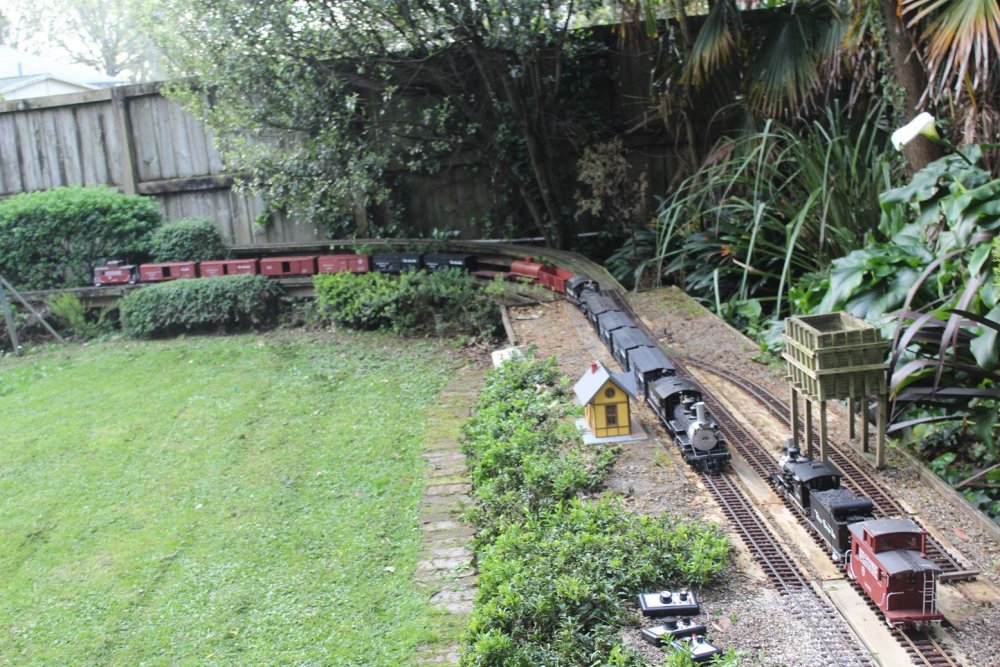

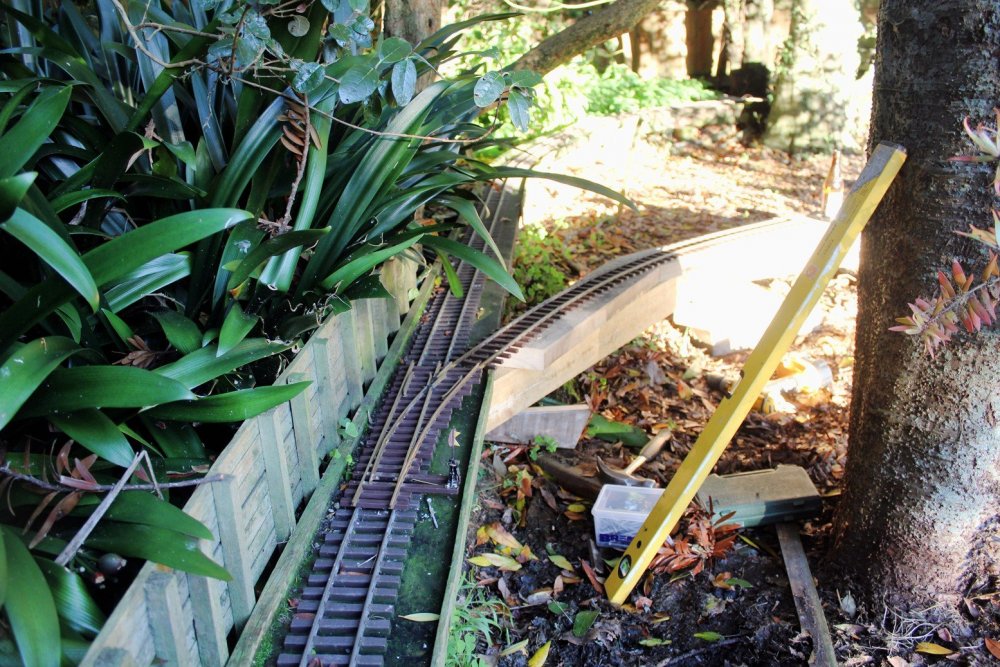

The Pacific Extension!
Many railroads in the west called themselves the Somewhere,Somewhere & Pacific but got nowhere near the Ocean or across the nearest State Line so it was only appropriate the Jackson County would make a start on a Pacific Extension.

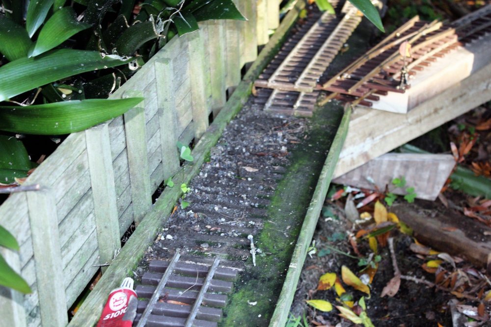

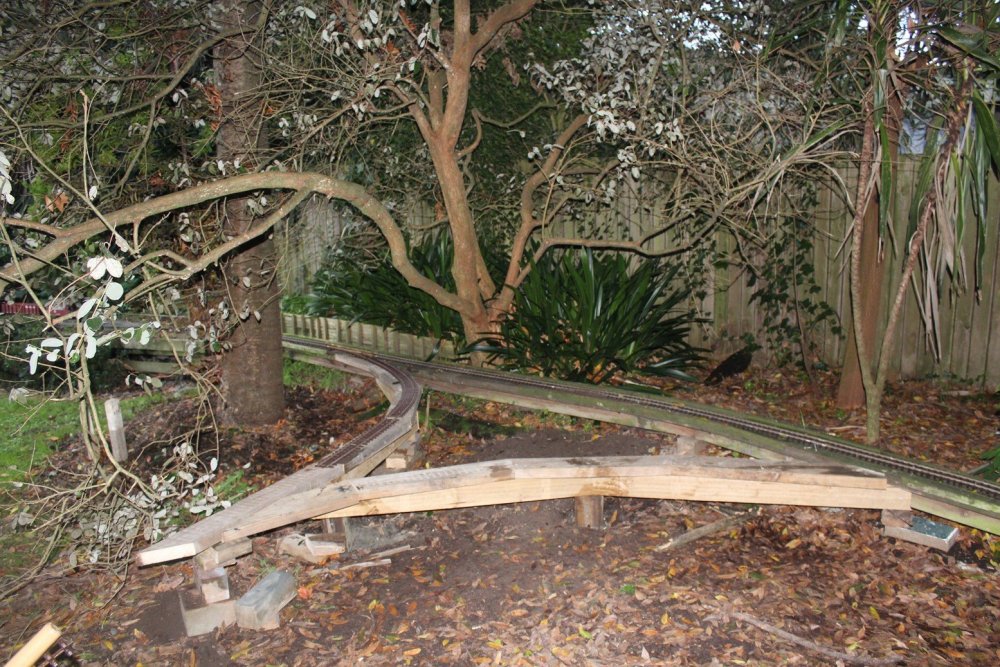

The starting point for the extension or at least a Wye for turning locos is on the inside of a gradual curve on the 2% grade from the junction from the lowest point on the railroad and Jackson City. The branch leaves the main line on a 5'6" radius curve the minimum for the Bachmann K27 2-8-2 loco the largest on the line.
Cut the rails with a junior hacksaw and tidied up the ends with a needle file, I grease the railjoiners with graphite which is both good for electrical continuity and allows the rails to expand and contract preventing the joiner siezing to the rail.
Switch installed and west leg of wye connected.
K27 loco drag beam and tender almost touching on inside of curve.
Roadbed 6X2 on 4X2 treated pine all connections with galvanised screws.

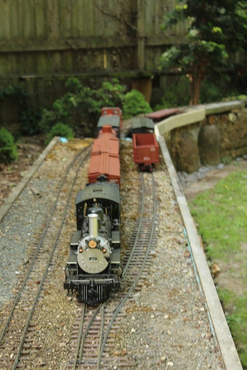

I first checked that the K27 would go round a 5'6" curve by temporarily laying the track on the deck.
The East leg of the wye will re-join the main line between  the gondola and tank. The train is made up to 12 cars with the K27 cut in between the stock cars and general freight. The real RGS often cut in the helper mid train on trains of this length or longer.  The extension is currently supported on temporary blocking, in this area I used short timber piles on paving slabs or shallow concrete pads on account of shallow tree roots. The tree to the right of the junction is juvenile kauri  a shallow rooted conifer which can potentially grow to 70m in height and live 600 years
The wye will mainly be used for turning locos working the 4% grade between this point on the railroad and the storage sidings in the garden shed.
I may gradually extend the Pacific Extension as a logging or mine branch like the majority of branches on the RGS & DRGW narrow gauge lines

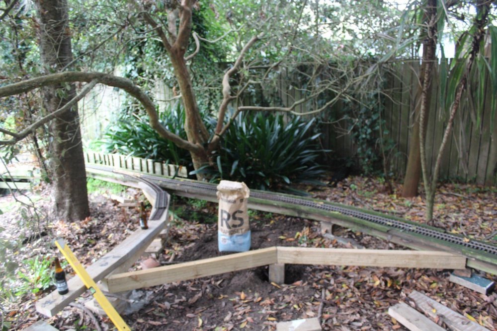

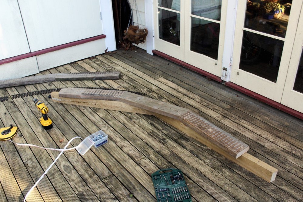

This was the 1st reasonably dry weekend we had in several weeks, so I started work on the benchwork roadbed for the east leg of the wye.
I decided to construct this section in situ and install the piles rather than pre-fab the roadbed on the deck, there was also the little matter of marrying in with the existing roadbed at either end!
Stringers are 4x2 fencing rail I had over from a job, piles are offcuts of fenceposts, Rapidset also surplus from a job so in a way the Pacic Extension is being built from revenue like the Ballina Branch of the Great Northern and Western in the 1860s. This form of construction with heavier section timber was basically the standard for house construction in New Zealand from Colonial days until relevatively recent times, quite a shock for someone with a construction background from Ireland

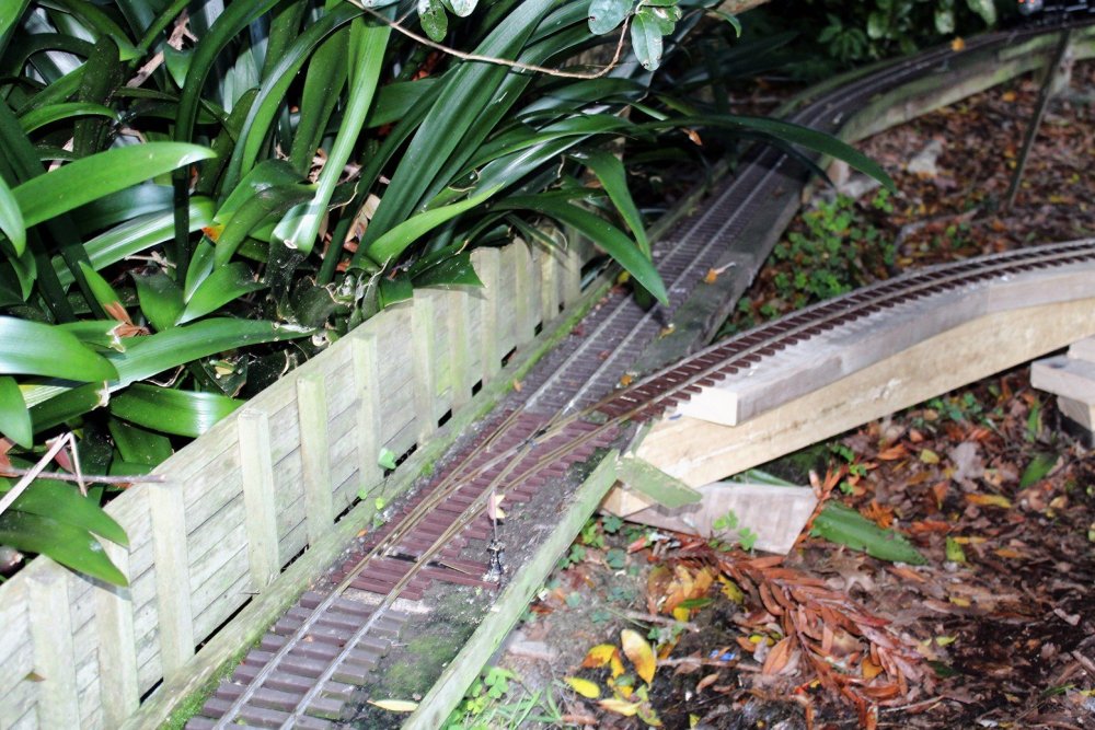

It has been difficult fitting the eastern leg of the wye into the space available, ending up with a 5' minimum radius curve rather than the preferred 6' minimum, I temporarily pinned down a section of track at 5' radius to check if there were any problems. The crew of 464 agreed to run over the temporary tracks while on their way to pick up some empty cars further up the line. I once heard a Canadian Pacific track gang asking the crew of a short line freight in Minnesota if the had time to spare to divert their train to run over a newly re-laid diamond a couple of times to check that everything was ok. It was getting late in the evening and the next CP train was not scheduled for several hours and the track gang wanted to go home after a long day!
The test was a success so installed the road bed for the eastern leg of the wye. The wye is under the drip line of a number of large trees and is a popular place for visitors to congregate on hot days, which could make the wye a very popular place indeed.
Th end of the wye is supported temporarily on blocks, for the present I will extend the tail of the wye about 6' long enough for a couple of locos to clear the switch. Rail for the wye will come from a re-lay job on the main line, where I am planning to swap out about 20' of AMS track with bleached out ties (sleepers) laid in 2007 with new material during August-September. The wye will be laid with the old rail AMS on new Sunset Valley ties which should be good for another 10-20 years.

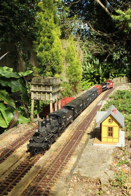

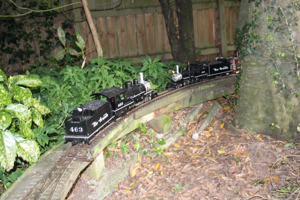

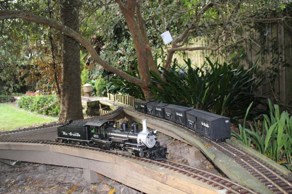

Went a little off the rail recently adding more locos and stock. The excuse was that another Mudhen was needed to handle the traffic and as insurance against the day 464 breaks her frames or the motion falls apart with metal fatigue, more freight cars were needed to cope with the stock rush and mine traffic just like the old RGS.
463 an early Accucraft model brass construction with stainless steel motion and tyres, should outlast 464 though motor may need replacement at some stage. Loco is currently track power will convert to on board battery r.c., loco is fitted with a Phoenix sound system similar to 464.
464 brings in her train,  the "new" stock cars and box cars appear to have been sprayed with Testors Dull Cote or some form of flat finish to tone down the factory satin finish.
463 waits on the siding to be cut into the train as helper as 464 runs past on the main with a cut of stock cars.
463 now cut into the train as mid-train helper. The RGS depended on hired DRGW Mudhens to move its heaviest trains from the late 1930s onwards, even in its final season of operation mid train helpers were needed to handle the Autumn stock rush and final ore trains. The loco shed is due to be replaced with a  brick roundhouse more typical of the area and a timber coaling tower, some day I might even get round to building a depot

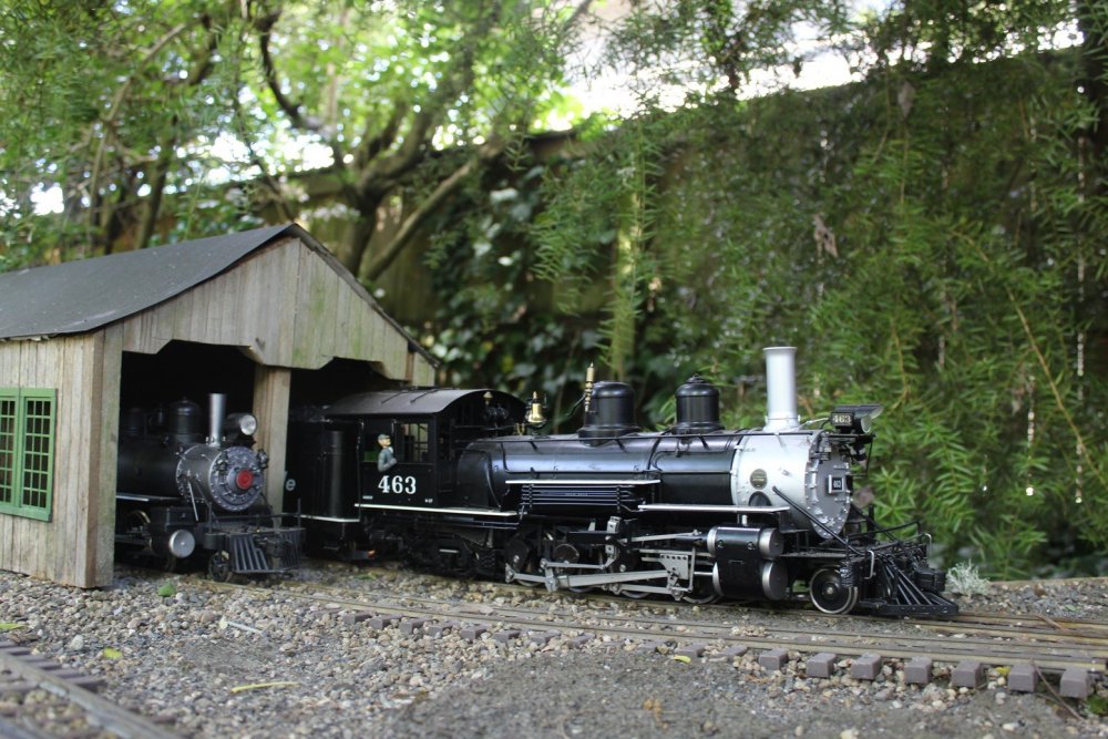

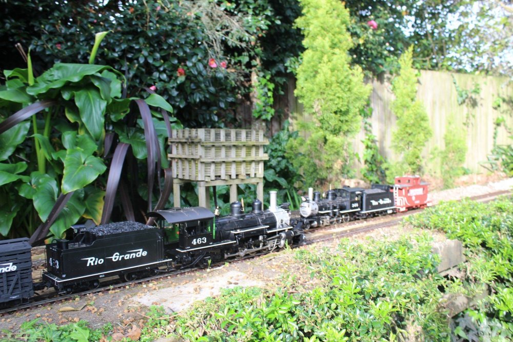

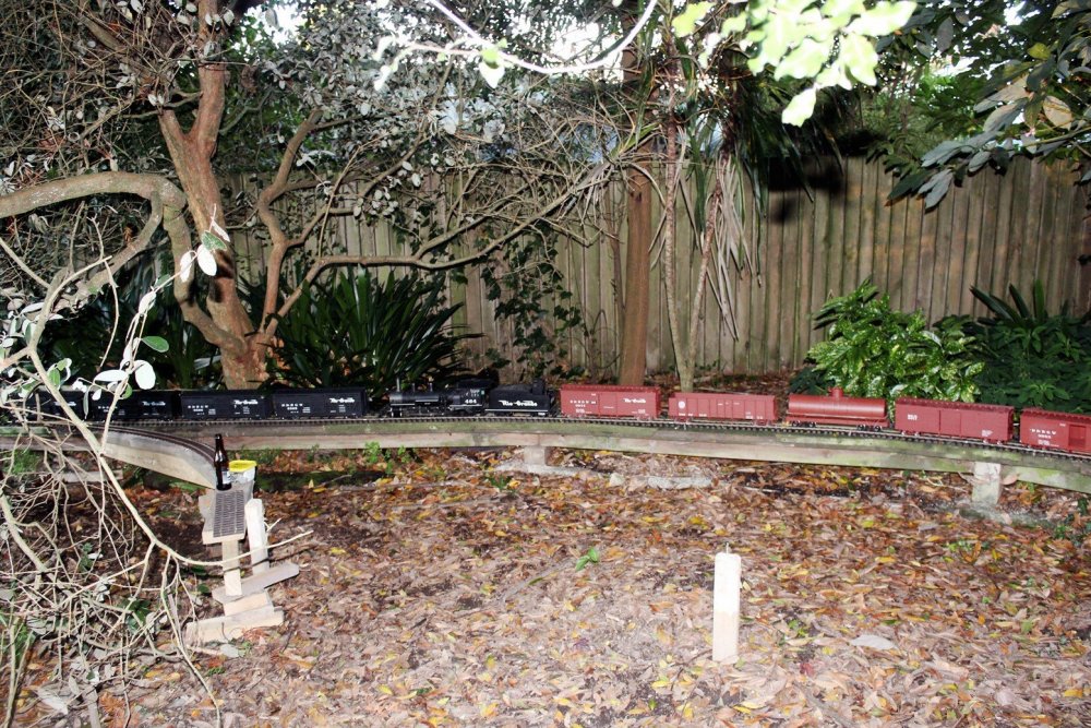

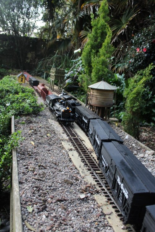

Spring has finally arrived. Newly acquired K27 463 had her damaged pilot repaired and has been fitted up for battery remote control with a Deltang receiver/electronic power controller and sound system re-wired with the chuff timer set up on a driving rather than a tender axle as on my other locos. Although the loco was in very good condition, her pilot was damaged and may had a nose dive at some stage similar to my C19 #348
The idea was to capture the sound of the driving wheels slipping, though in practice 463 stalls when overloaded rather than kicking up a racket slipping.
Today I managed an operating session of sorts while catching up on the gardening. In spring the old RGS used to run stock specials to return sheep to high pasture for summer grazing K27s 463 & 464 teamed up to work the empties back to the DRGW interchange along with some general freight.
463 is fitted with a Phoenix sound system similar to 464 but is a noiser and has an interesting echo whistle, the matt black/grey stock cars are part of a recent purchase, I am planning to tone down my existing stock cars with a flat finish to achieve a similar effect. The train has crested a grade and is starting to pick up speed on a long down grade.
463 has just arrived at Utah Junction, helper engine C19 348 & caboose have just turned on the wye and is waiting in the clear.
The train will reverse its direction here before climbing the High Line to the DRGW interchange
463 and the rest of her train the High Line branches off behind the train in the distance and climbs on a 4% grade to the staging yard in the garden shed. The timber track base has started to dry out following the long wet winter, interestingly the timber is in good condition with little weathering after over 10 years use possibly because it was covered by a layer of ballast.
#348 & her caboose have set back along the main line past the wye allowing #463 to draw forward. #464 waits at the clearance point while 463 & the front portion of her train draw forward past the West Switch of the wye.
#463 has cut off her portion of the train and draws forward past the east switch of the wye.
#463 turns on the wye before picking up her cars and drawing forward onto the High Line. Currently the tail track of the wye is only long enough for a loco and one car, once its extended it will be possible the turn a complete train without the need to divide and re-marshall.
#463 has picked up her cars and has drawn forward on to the siding to take water. Once she's clear #464 will draw forward and repeat the exercise with her portion of the train.
#464 and the 1st portion of her cars couple on. Once #463 & #464 and their cars have drawn clear #348 will grab the box cars then hook on to the rear of the train.
The whole ensemble complete with helper locomotive and caboose will draw forward along the main line, before setting back to pick up the caboose, the whole train will then set back eastwards along the main in order to get a good run at the high line.

November operating session IMG_3461.thumb.JPG.85955025b1c8b9879c382d8445374304.JPG
Tidied up the loco shed after 5-6 years exposed to the Waikato weather. Repaired/replaced window surrounds that had fallen off, re-painted cut checks in door heads so larger locos can fit inside!
RGS Motor 6 sits on the turntable. The RGS converted old cars into railcars and an open rail truck in the 1930s, interestingly most if not all of these vehicles survive in working order in the States. The turntable works and is basically a piece of decking board that pivots around a coach screw on some plate washers and has given very little trouble in 8-10 years service.
Busy west end of the yard 464 on the main line with a westbound stock special, 463 waits to follow with a way freight while caboose 401 on the end of an eastbound freight waits for her loco to back on once the stock special has departed.IMG_3482.thumb.JPG.14a22dc517003b7f273ff724b696693f.JPG
Stock special [asses gondolas under the hopper at Utah Junction.

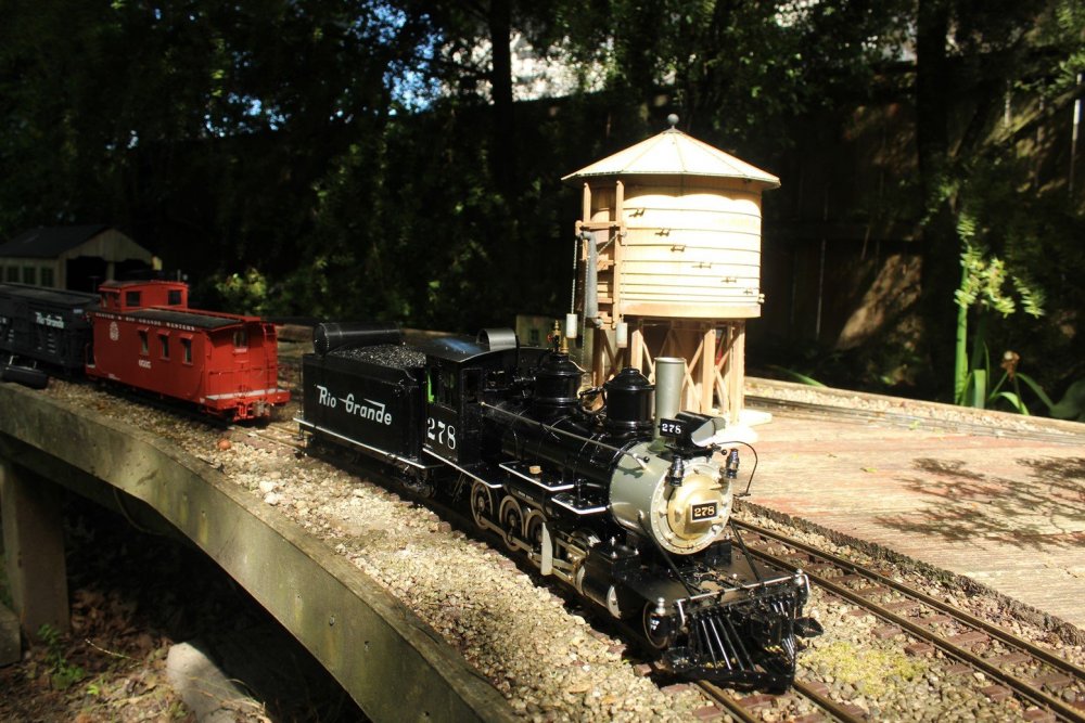

Live steam 278 waits to back on to her train once the stock special has departed and the main line clear for running. Slightly scorched smokebox door, these engines were the Rio Grande equivalent in size and power to the J15, the larger 2-8-2s were introduced from the early 1900s onwards to reduce freight train running costs and probably helped keep the remaining narrow gauge lines open into the 1960s.
The nearest to conventional baseboard construction, this section of track is supported on 3/4 construction ply on 4X2 treated timber framing and slopes in one direction to help drainage and avoid puddling. Pond lining is glued to the ply with contact adhesive in a similar manner to membrane roofing ballast and ground cover (8mm to dust screenings) is glued to the membrane with a PVA concrete bonding agent, moss is starting to die off with warmer drier spring weather. I am extending the siding on the right out over a dwarf wall which include what look something like coke ovens.
This area is normally shaded with sun only in late afternoon during spring,summer, autumn months. 463 has added tonnage to her train since her last stop and has just picked up two gondolas from the hopper and is probably 2-3 carsover her weight limit for the 3-4% gradient to the covered storage tracks in the shed.
After a brief spurt of activity preparing for a garden railway convention in 2011 the Jackson County has been pretty neglectful about providing covered accommodation at Jackson City for its staff and the very odd passenger that might want to ride the line.

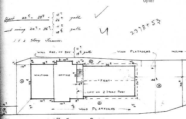

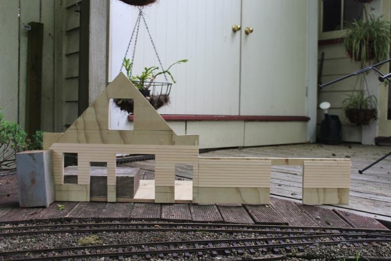

After toying with the idea of a NZR style building, I settled on Ophir Depot on the RGS as a potential depot/company head office.

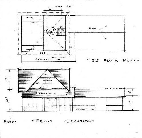

A rating valuation elevation and floor plan are available on line, a reasonable start for designing a mock-up to see if it would fit/not over dominate the scene.
The real Ophir Depot was on the inside of an almost 180° curve, Jackson City Depot will be on the outside of a 90° curve.

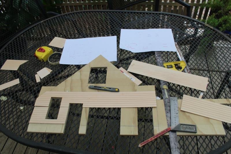

I planned the mock-up/shell of the building in 12mm treated ply, buying 2 1200X600 panels from a local DIY warehouse, funnily enough 2X600X1200 panels were $6 cheaper than a single 1200X1200 panel, be interesting to see how a full 1200X2400 sheet works out. Plywood is manufactured from locally grown Radiata Pine which is fast growing and tends to twist all over the place, even when bonded into a sheet of ply.
I cut out the basic outline of the platform elevation with a battery powered skilsaw and cut out the window opes with a drill and a jigsaw.

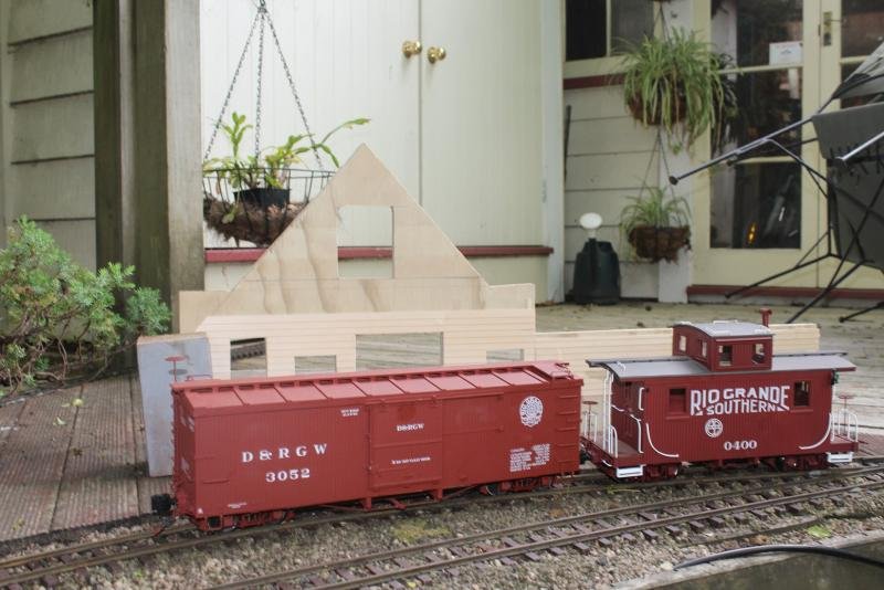

I was a bit worried that a 1:20.3 scale building might over-dominate the scene, so did a mock up with the basic elevation and depot floor, before cutting out the door and window openings.
The ground floor of the building was clad with a combination of horizontal and vertical weatherboard, the roof and upper storey in shingles. The weatherboard is a Midwest Scale basswood product, the lower panel edge is rebated to disguise horizontal joints the top strip overwidth to compensate.
I cut out the window and door openings using a sharp craft knife, openings will be trimmed with L shaped strip to form the timber flashings used round doors and windows with this form of construction. The weatherboard is temporarily fixed in place with double sided tape.
The section below window level was clad in vertical weather board with a dado rail between the two cladding systems, the large opening between the doorways is for a bay window which incorporated the telegraph operators office.
I am looking at the option of laser cutting for forming doors and windows, fixing individual shingles to the roof and upper story would be time consuming but could be very therapeutic depending on your outlook
Ophir Depot like most on the RGS was a combined depot and freight house for LCL traffic and seems to be reasonably in proportion for the site without reducing to 1:22.5 or 1:24 Scale
