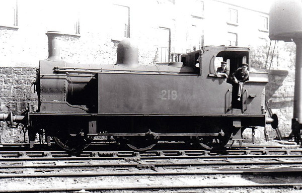

murrayec Posted May 1, 2017 Share Posted May 1, 2017 (edited) Hi With the need for a small steam loco to run on Closetmodeller's Greystones Layout to pull a RPSI or IRRS type excursion train, we looked for an easy and inexpensive conversion. I had previously earmarked the Jinty 0-6-0 as a relative easy conversion to an Irish type tank loco- the Inchicore Class J10 or a J11. At the Wexford Show a Mainline Jinty was offered for €10.00, so CM splashed out and our 0-6-0 Tank Loco was secured and travelled off to the workshops. This will be its story..... The J10 is easier to do as its cab needs very little work, the main work is in-around the front splashers and snadboxes, most of the other bits are pretty close. So with that and some other minor fettling- handrails, coal bunker, valance & front steps, valves, and roof top whistles, its going to be a J10 The tanks are little a bit short, but not sure yet if I'll go at that! The plan is worked out, this I did by scanning the loco side and setting up a drawing to have a pattern to work to for sizing the bits and working out what gets in the way! According to Mr Clements 5 of these were built for shunting around North Wall Goods Yard, a photo exists of 617 (Pioneer) taken in 1938 at Broadstone, so 617 it will be...... Eoin Edited May 1, 2017 by murrayec 2 Quote Link to comment Share on other sites More sharing options...

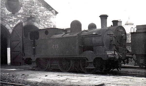

Mayner Posted May 2, 2017 Share Posted May 2, 2017 (edited) The Mainline J72 was the nearest thing to an "Official" RTR conversion for the small Midland E Class 0-6-0 tanks or CIE J26 Class. The late Alec Phillips a very talented modeller pioneered the conversion of the J72 into an E Class after struggling to get the early TMD E Class to run. Alec built excellent scratch built models of a DART & a cement bubble in OO & B121 & B141 Class in O Gauge. The J10s or MGWR P Class were built for heavy shunting at the North Wall & banking trains to Liffey Junction , basically a tank version of the Midland Standard Goods. The J11 was a GSWR design and tank engine version of the J15 or 101 Class did similar work on the GSWR system and around Cork. The J11s had slightly rounded edges to the tank tops and an archaic looking cab roof seemingly folded from one piece of iron, nice modelling challenge. Edited May 2, 2017 by Mayner Quote Link to comment Share on other sites More sharing options...
jhb171achill Posted May 2, 2017 Share Posted May 2, 2017 The late Alec Phillips a very talented modeller.........built excellent scratch built models of a...........B121 & B141 Class in O Gauge] Now THAT would be a sight to behold! Quote Link to comment Share on other sites More sharing options...
Kirley Posted May 3, 2017 Share Posted May 3, 2017 Eoin, are you aware, New Irish Lines gave away, with their magazine, drawings from the GSR Register. Both J10, J11 and J26 (mentioned by John)are included? The wheel base on a J10 is shown as 14' 11" and I think the Jinty's wheel base is 16' so close enough. 1 Quote Link to comment Share on other sites More sharing options...
Dhu Varren Posted May 3, 2017 Share Posted May 3, 2017 It depends on what you class as a Jinty. The name Jinty normally refers to the LMS Fowler 3F, which has a wheelbase of 16ft 6ins. The loco in this post, referred to as a Jinty, is in fact an LNER J72, which has a wheelbase of 13ft 8in. The Bachmann 3F Jinty wheelbase is 66mm, which is an exact scale 16ft 6ins. I have no idea whether the Mainline J72 wheelbase is correct to scale or not, as I do not have one to measure. Quote Link to comment Share on other sites More sharing options...
jhb171achill Posted May 3, 2017 Share Posted May 3, 2017 Eoin, yes, normally a light yellow creamy colour but according to jhb171achill Senior, who spent many Saturdays bumbling about Inchicore in the 1930s, the odd one did have polished numerals and rims, like 186 currently. Quote Link to comment Share on other sites More sharing options...
Kirley Posted May 3, 2017 Share Posted May 3, 2017 It depends on what you class as a Jinty. The name Jinty normally refers to the LMS Fowler 3F, which has a wheelbase of 16ft 6ins. The loco in this post, referred to as a Jinty, is in fact an LNER J72, which has a wheelbase of 13ft 8in. The Bachmann 3F Jinty wheelbase is 66mm, which is an exact scale 16ft 6ins. I have no idea whether the Mainline J72 wheelbase is correct to scale or not, as I do not have one to measure. I think John was referring to another Class of locomotive not the J10 or J11, "The Mainline J72 was the nearest thing to an "Official" RTR conversion for the small Midland E Class 0-6-0 tanks or CIE J26 Class." I have two Hornby 3F's a new and an old model, both have a 16' wheelbase unless I'm not measuring it correctly, is it from wheel centre to wheel centre? Sorry Eoin for going off your subject. Quote Link to comment Share on other sites More sharing options...
Warbonnet Posted May 3, 2017 Share Posted May 3, 2017 I think John was referring to another Class of locomotive not the J10 or J11, "The Mainline J72 was the nearest thing to an "Official" RTR conversion for the small Midland E Class 0-6-0 tanks or CIE J26 Class." I have two Hornby 3F's a new and an old model, both have a 16' wheelbase unless I'm not measuring it correctly, is it from wheel centre to wheel centre? Sorry Eoin for going off your subject. I'm pretty sure the Hornby jinty features a generic 0-6-0 chassis which also went under their old 08 and pannier tank. The Bachmann model of the jinty would have a more accurate wheelbase. Quote Link to comment Share on other sites More sharing options...
murrayec Posted May 3, 2017 Author Share Posted May 3, 2017 (edited) Hi Guys I was a bit confused by John's post, but now it's all straightened out- The Mainline model above was offered to CM as a 'Jinty' when I was asked about making it Irish, a Jinty being a model I looked at before for converting, so I said yes go for it. When scanning it I did think it looked a bit odd but not being up on British stuff I just ploughed ahead and looked more at what its going to be. That said, it will cease to be a 'Jinty' or a 'J72' it's going to be our version of a J10 Yes Kirley I have that drawing, interesting to see the front sandboxes are not on the drawing, the 3Fs & 4Fs I do know a bit about, my favourite British locos, I bought plans for a 3.5inch 4F live steam model which is on the list to do before I die.... actually that will be after all the other stuff I'm doing! I collected about 6 Bachmann Jintys and 3 4F to do Irish things with but could not bring myself to the point of chopping them up... Now I'm wandering off... jhb- good to know Senior saw polished plates as I do like a bit of 'Brass' on a loco- 617 will have brass numerals n rim Eoin Edited May 3, 2017 by murrayec Quote Link to comment Share on other sites More sharing options...
