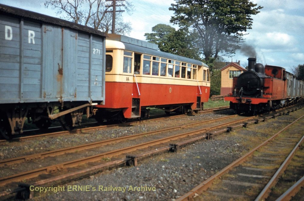

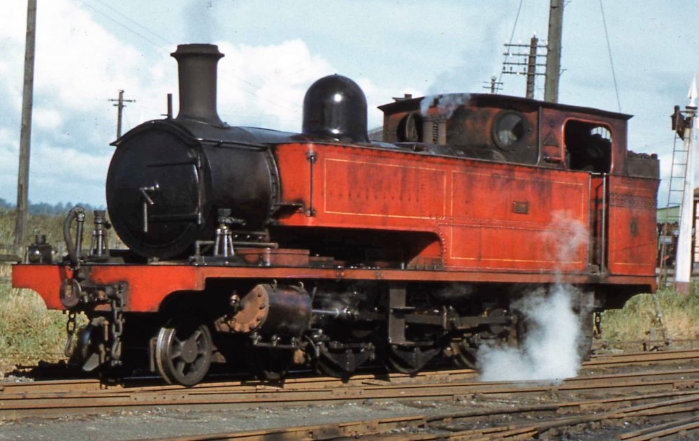

Irishswissernie Posted May 28, 2021 Posted May 28, 2021 Checking through my photos I have a feeling that some locos did end up with rather black looking domes. Check out Erne and Blanche below, both domes look polished rather than dirty but there is a hint of red on Erne's dome. Possibly wiped down with old oily rags but on Erne they didn't bother trying to clean the cab front 2
jhb171achill Posted May 28, 2021 Posted May 28, 2021 Yes, and the cab front and back, and tank ends and tops could also look solid black! In the early days of the RPSI, despite being only a few years since blue engines were all over the place (ex-GNR area), there was even a debate over what parts of the frame were, or were not black. Today, people forget how dirty an environment railways were in steam days. I can even remember layers of dirt on all surfaces in UTA stations in the sixties. Sheer dirt is another reason why many thought that all CIE engines were black. And it’s not just the grey locos - I’ve seen pics of green ones which, if you didn’t KNOW were green, you’d swear were black all over. Look at pics of CIE steam engines in their last years. See any red buffer beams? Very often, absolutely not a trace of red - but they were red! So, steam-era people - get absolutely STUCK into those weathering powders! 1
Mayner Posted May 28, 2021 Posted May 28, 2021 (edited) With its focus on railcar operation the Donegal was down to a few steam crews in its final years presumably with maintenance staff focusing on essential maintenance and little time for cleaning steam locos. Interesting the shiny dome and the fallout from smoke and ash on the cab & sidetanks. There was an interesting weathering pattern on the coalfired black Cumbres and Toltec steam locos (still 3' gauge) The upper part of the locos were weathered grey with ash with only the vertical surfaces black and a hint of a sheen on the sand and steam domes, on American locos the smokebox and chimney is usually painted with a heat resistant graphite paint. Interestingly the weathering appears much more subdued and less noticeable in photos than when I saw the locos in operation. The neighbouring Durango and Silverton locos appeared to be cleaner possibly different coal source or a greater focus on cleaning and presentation. While the C&TS appeared at least to me to be the more "authentic" of the two railroads, the boxcar (generator car) was a nice tribute to the days of the weekly "Silverton Mixed" which operated in the 1950s Edited May 28, 2021 by Mayner 1
