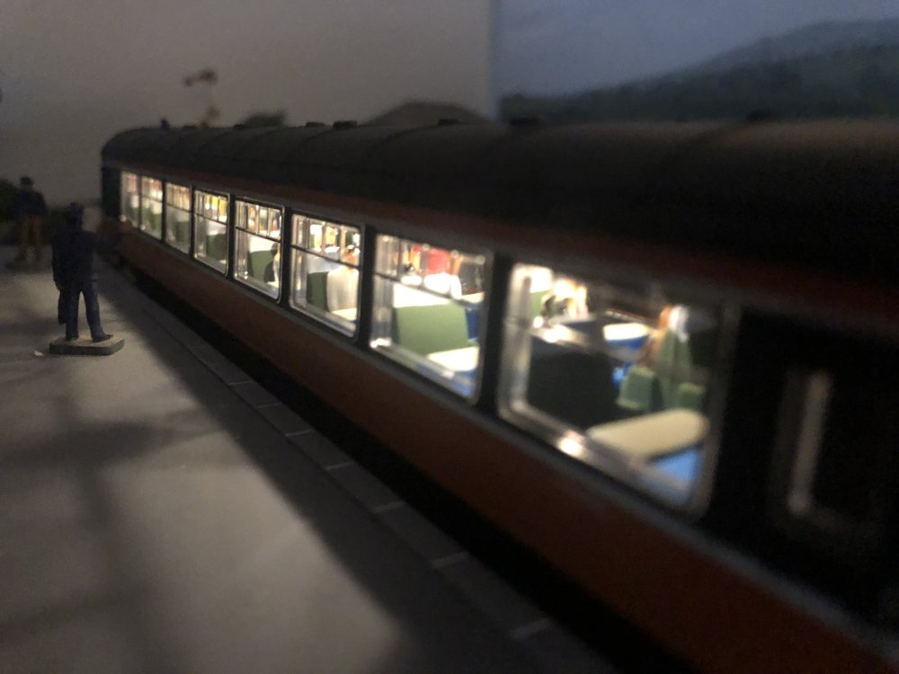

Noel Posted March 14, 2023 Author Posted March 14, 2023 Model Craven standing at Gort Platform 2 after passengers added to reupholstered coach with lighting added. Later that evening Lady in Red seems in a hurry to find the right seat 9 1
Noel Posted March 15, 2023 Author Posted March 15, 2023 Inexpensive passengers in packs of 100 from china cost about €4. Snip the legs off with a wire cutters and glue to the seats. Led coach Lights are triggered by motion and stay on for 5mins after no motion. 6
