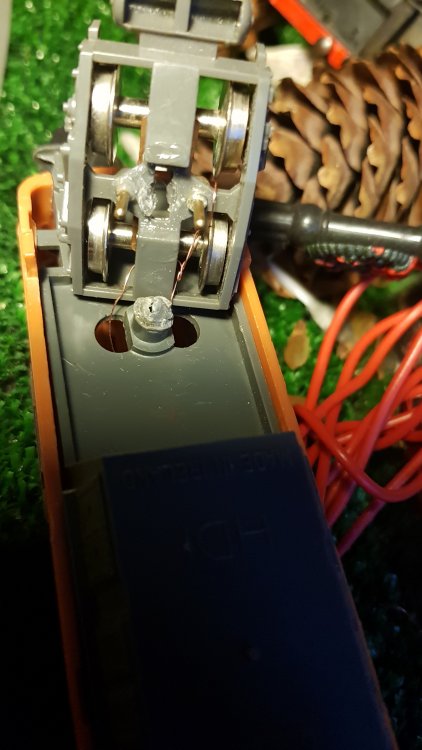

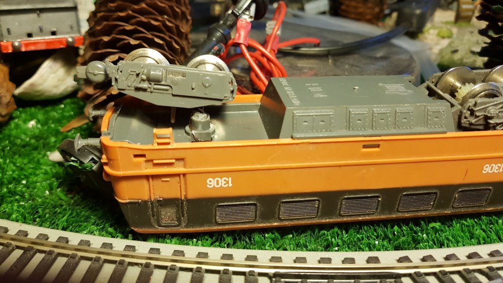

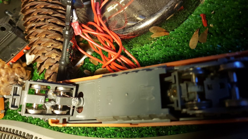

Hi folks anybody. Out there that can help me find this chassis I'm stumped it's hdi try to repair but sadly I made it worse broken hearted any advice i would appreciate it thanks anthony

Hi Anthony
Here is one way of fixing it- remove the broken pivot from the chassis, insert a brass or plastic bolt through the hole and epoxy it in, epoxy a washer or two in the centre of the bogie to get the height right and to allow the bolt go through the washers, when set- slide the bogie onto the screw with a washer put on a loose nut so the bogie can wobble n rotate, loctite the nut when your happy with the fit;-
Eoin

A quick question eoin. Would gorilla epoxy work I should I use epoxy putty thanks anthony

Sorry Eion would I use grorlla epoxy glue or epoxy putty thanks anthony
Hi Anthony
I use EVO-STIK or Araldite, but I suppose any epoxy glue would be fine. If buying EVO-STIK or Araldite I go for the screw on cap tubes- the double syringe option has many problems, it's fine when new but as it gets older the quantities come out unbalanced!
Eoin

Hi Eoin just been  nuisance here.see pictures would a little bolt have any effect on the two brass terminals on the bogie wheels I don't want to make a mess .just trying to be careful don't won't to burn out the bogie or would it be ok.thanks Anthony

Hi Anthony
Yes your correct, you don't want to electrical short those, use a bolt and washers suitable that fit between and does not touch them- or using a plastic bolt is even better.....
Eoin

Thanks Eion it's looking like plastic bolt as there's not enough space between the terminal I'm glad I checked with you thanks a million Anthony

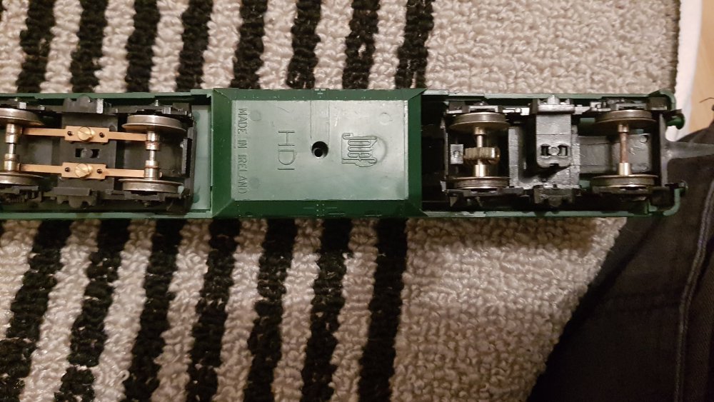

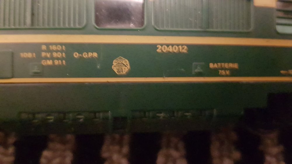

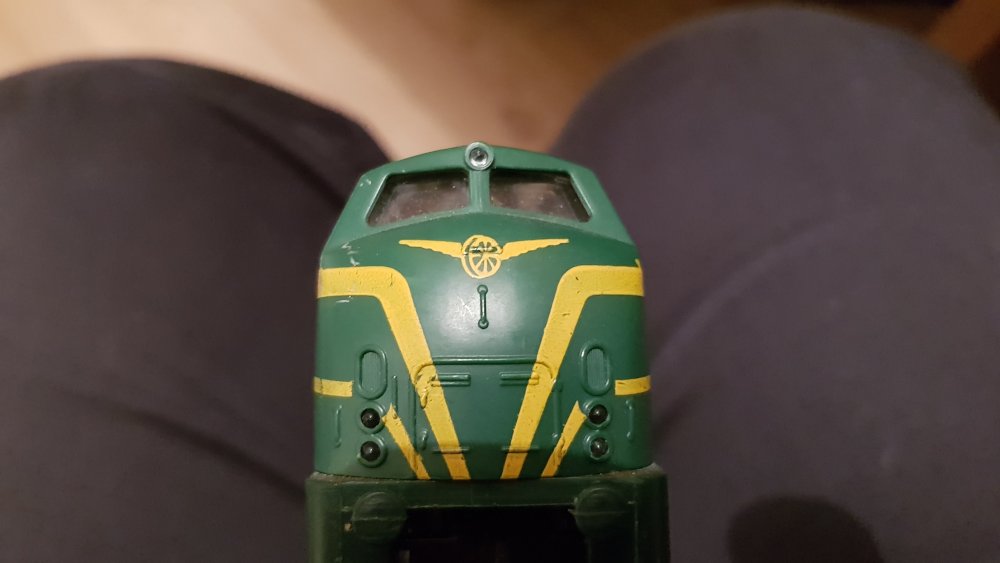

Hi folks trying to find out any information about this train set HDI anyone got a name for it I have taken these pictures don't understand the crest thanks anthony
The logo on the front is vaguely reminiscent of one used by PJKA, the Indonesian railway authority, in the 1960-80s period. But neither the loco, the livery, or the markings are any more Indonesian than they are Cavan & Leitrim.
I would guess it’s a “makey-uppy” thing, like some of those early “CIE” models of crude British outline locos and coaches in even cruder “Irish” livery.
I'm greatful for your knowledge guys I'm just puzzled it runs pretty well has 3 coaches bearing the same logos .green body and sliver roof on the coaches would I leave it alone or try painting the set in CIE colours??

Came across this elbem folks extremely close to the one on my loco ...??? Soviet railway badge wings and wheel .
A very common logo in the car & motorcycle world
https://www.google.com/search?q=wings+wheel+logo&client=firefox-b&tbm=isch&tbo=u&source=univ&sa=X&ved=2ahUKEwicrN_9s7reAhUB_KQKHVGcBw0QsAR6BAgGEAE&biw=1280&bih=891
There is a thread on here discussing the origins of the flying snail logo, where we came to the conclusion that the Persians came up with the winged logo for their God- Aru Mazda (could have spelt that wrong) and since then all have adopted it in some fashion....

I found this elbem ALSO wheel and wings on a train .sorry German locomotive CREST but more details seemingly its a badge received after 40years service on the train????
Just realised that the wheel is a loco wheel between the wings on close inspection
If German, the Crown would mean it's one of the old pre Deutsche Reichsbahn companies. Could be Royal Bavarian State Railway or something.
Don't think it's 40 years service, 40 may be just the staff id number.

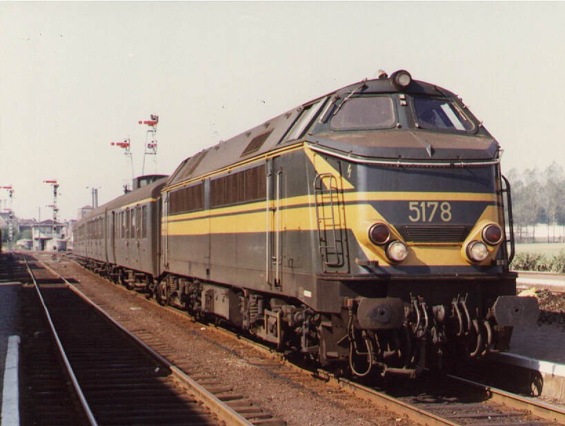

The model loco appears to be carrying the old SNCB livery and logo.

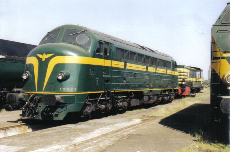

It looks like the loco is in an approximation of  SNCB/NMBS (Belgian Railways) livery. The model appears to be based on the German V200 diesel locomotives, there were broadly similar locos in use throughout Europe the Irish assembled V200 seems to have been available in British Rail, Belgian, Danish, German, Norwegian, and Spanish railway liveries.
9 hours ago, Garfield said:
Probably intended to be a representation of the SNCB class 51s (or one of the visually similar classes 55, 60, 62, 64 or 65)...
Thanks folks just trying to identify the locomotives I'm not much use at it to be honest Anthony
