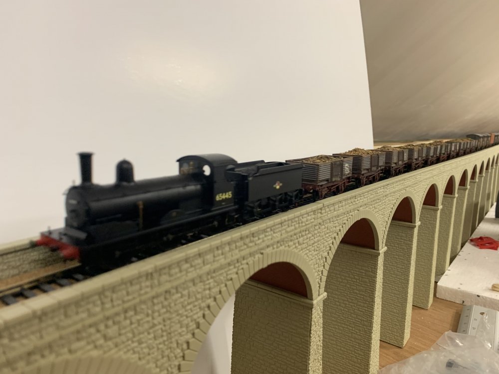

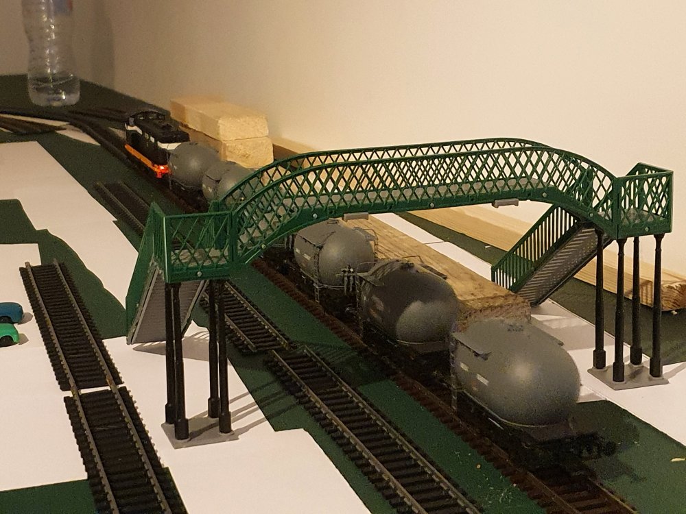

fergalm1 Posted October 5, 2020 Posted October 5, 2020 Here's a teaser Ed. Beet and Cattle Special coming under Haggerty's Bridge. Bit more work done on the foliage and Mountain River IMG_0234_HEVC.mp4 9 3 Quote

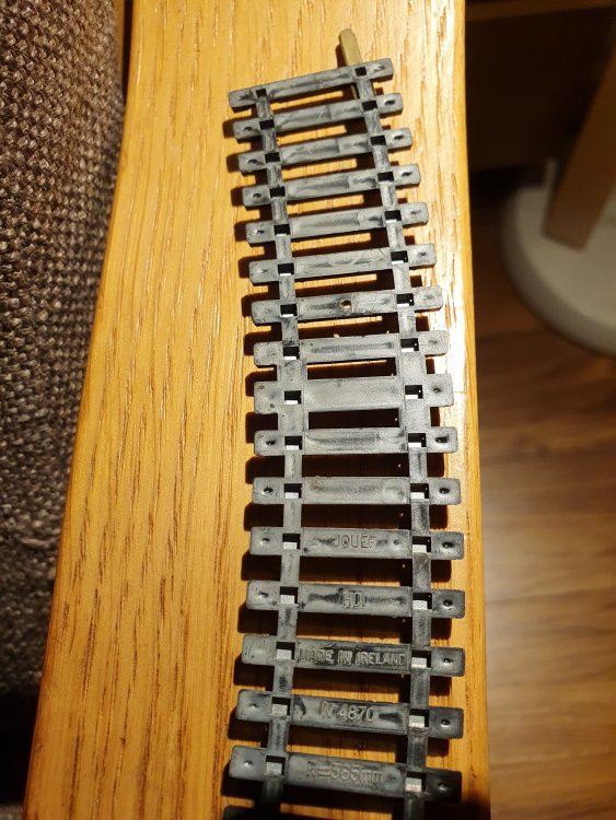

Edo Posted October 10, 2020 Author Posted October 10, 2020 Did a final running session with those great 121s running on over 90% irish made track (Jouef made in Shannon over 30 years ago) - borrowed off my father in law while I wait for my Peco order to arrive. Well the baseboard configuration is pretty much complete - now i will take it all apart to sand, varnish and paint the modules , reinforce the shelves and get it all secured back into place again......I'll post again when all that is done and there is real progress on the layout. 20201010_204948.mp4 7 Quote

Edo Posted October 10, 2020 Author Posted October 10, 2020 Thanks GM ....the track is Jouef H0 interspersed with hornby code 100 - its the very slight difference in height that gives the very satisfying /very irish pre mid 90's clikiddy clack......totally unintentional - but does raise an interesting dilemma ... 2 Quote

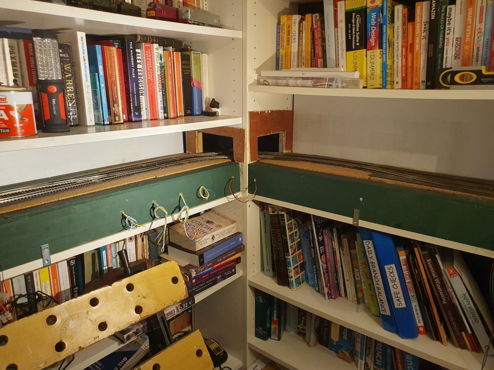

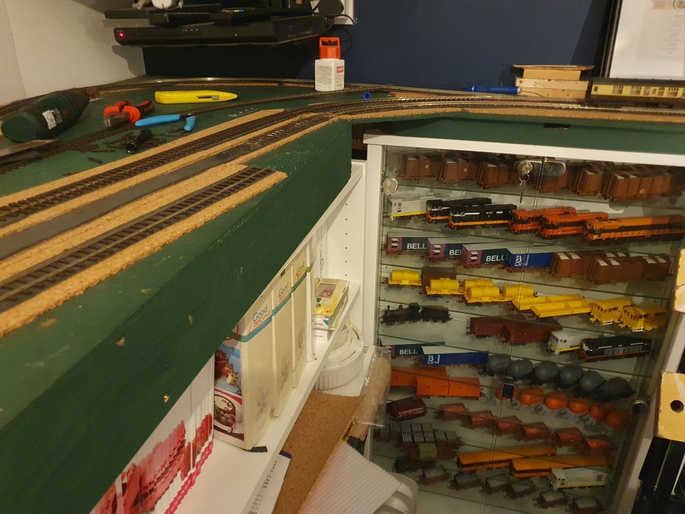

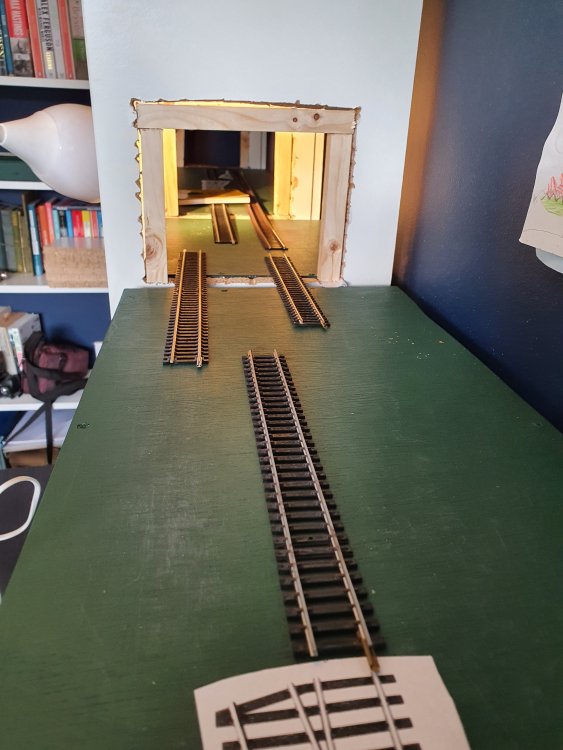

Edo Posted October 31, 2020 Author Posted October 31, 2020 The latest I've sealed and painted all the baseboards ( grey primer and green over that...why green?...it was sitting in a can in the shed...free!)...and they are now secured - but easily taken down to be worked on The book shelves area is the same - tho I've started the process of reinforcing the cut out areas - will be doing more aswell as disguising the entrances - when all the structural work is done, Im thinking of making different bridge facades for each one..just a though for the moment.. Other than that Im just waiting for Peco to restock their customers - who knew code 75 track was more in demand than the latest playstation 6 Quote

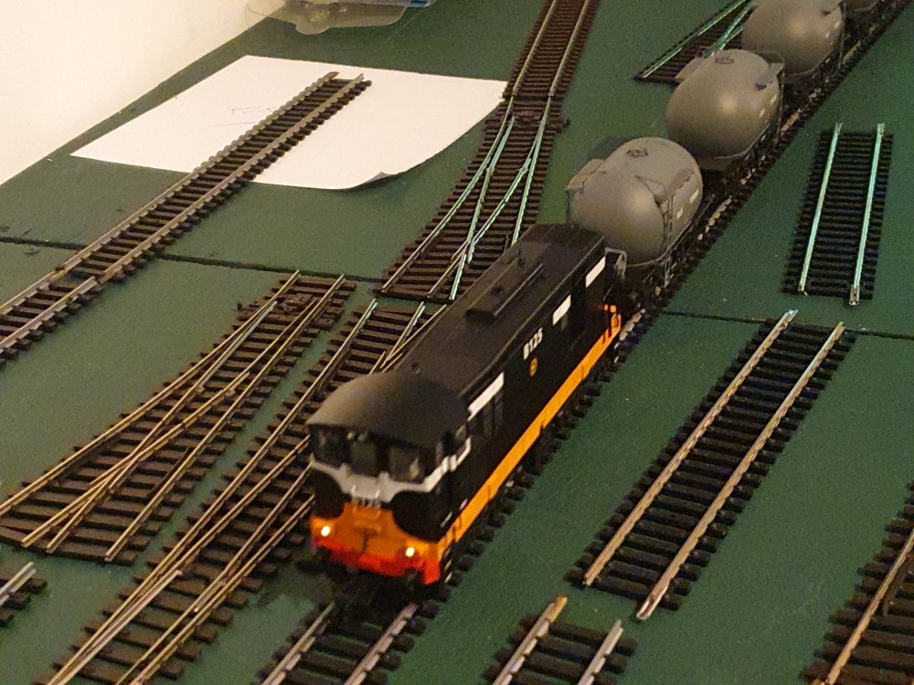

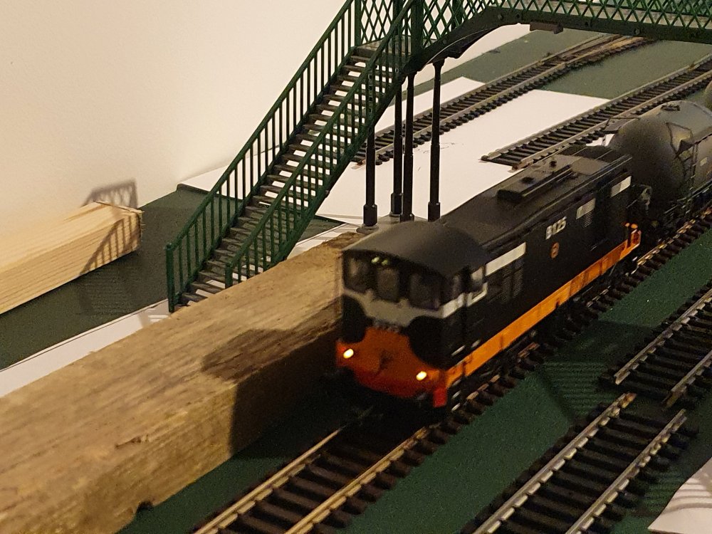

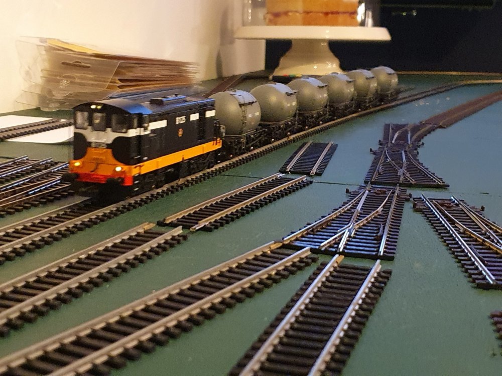

Edo Posted November 25, 2020 Author Posted November 25, 2020 B125 with a cement load making its way gingerly thru the Bagnalstown Yard ahead of major construction works - the 121 is such a smooth runner... 7 Quote

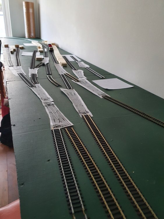

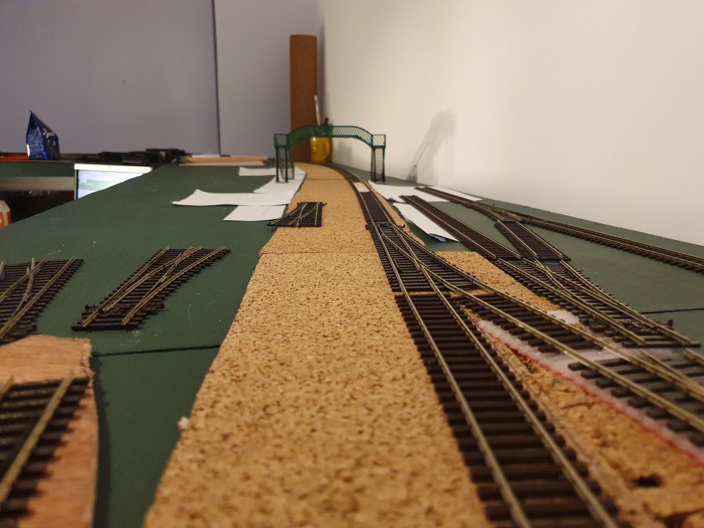

Edo Posted December 31, 2020 Author Posted December 31, 2020 My final Post of 2020 - what a year - and a happy new year to all. This year was the year i finally got the finger out on the layout. Progress so far has resembled the year - stop start - waiting for stuff - juggling the finances etc etc .....however im happy enough with things - all things considered. Im still awaiting a last delivery of track from Marks when the Peco delivery finally lands to finish off the track network - the layout is now really in 3 zones - 1) the permanent layout through the bookcase area 2) the display area of 3 removable 4 x 2 ft modules which is the station, and 3) the fiddle yard and lift out door crossing area. Zone 1 has had the most work - with the cork underlay and 1 of the 2 sheets of floor underlay im trying as a noise dampener down. The track plan is complete, cut and ready to be glued down permanently. The Shelve uprights have been reinforced and cleaned up. Next step will be to wire the section up for running and get the point motors in place...i also have LED lighting for the lighting of the Shelf sections ready to be installed....all in all lots more structural work before an ounce of scatter or paint goes anywhere near the area. 2) the display area - which will be Bagnalstown Station and yard circa 1960 - is coming along slowly - i've got the main line (dublin - kilkenny) in place along with the Palace east branch - i have the points in place for the passing loop and engine shed....and the points for the goods yard...all to be finalised and connected up when final track order comes in. The display area is all code 75 - the transition pieces to code 100 on the rest of the layout seem to work really well....again lots of structural work and wiring to be done here before anything else. 3) the fiddle yard area and lift out door area are still not really finalised yet - i still havent decided on a firm course of action as im not happy with the structure of the lift out piece and landing area ....to be revisited again and again id say! So lots more work this year - but at least it is up and running - hopefully i can get to some of Leslie's kits too to get some rolling stock for my J15s and Grey 121s Here's some video and pics of the current state of affairs - happy new year everybody and stay safe and please God i might get to meet some of you in the coming year at an IRRS meeting or a show as soon as its safe. Ed 20201231_205312.mp4 20201231_210348.mp4 9 Quote

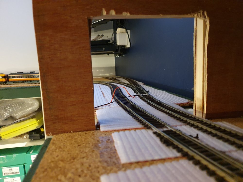

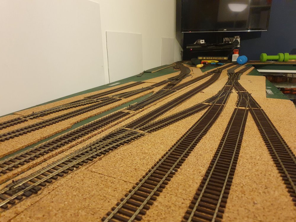

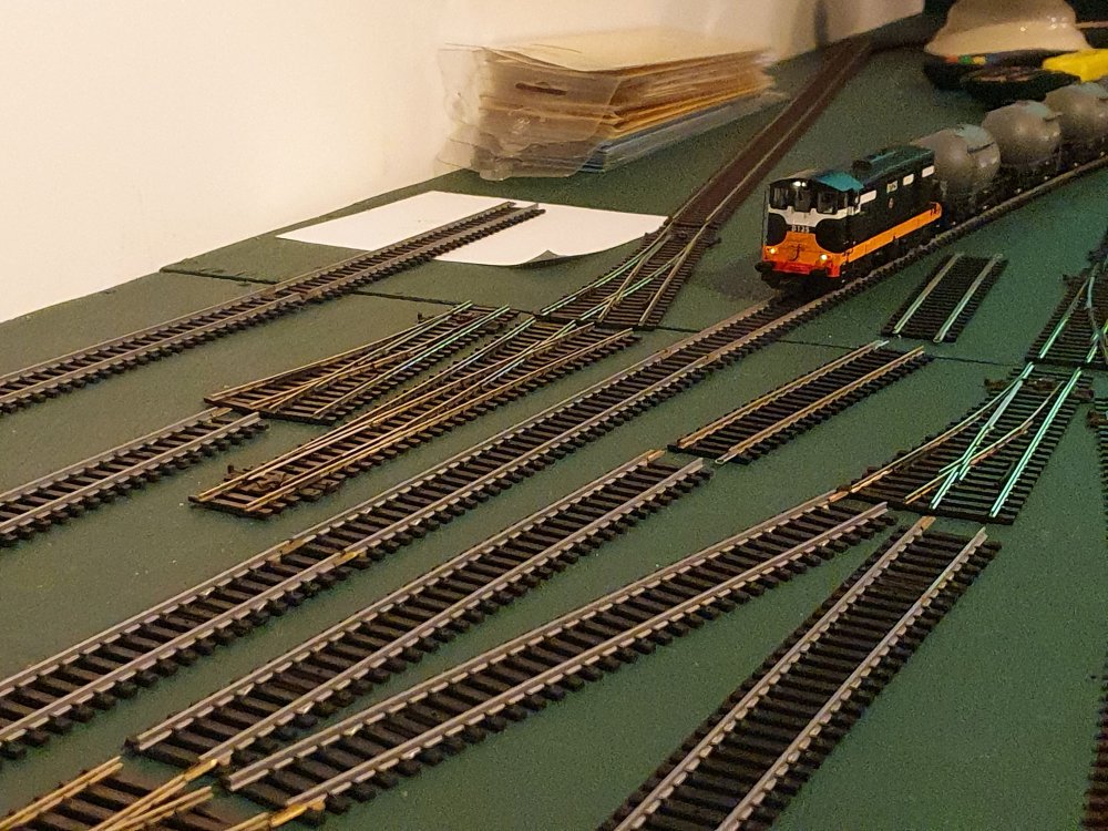

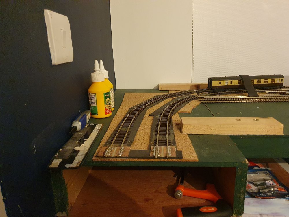

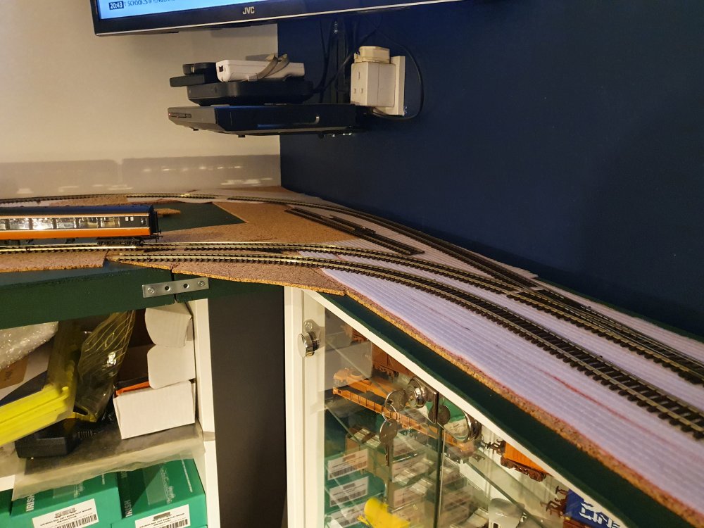

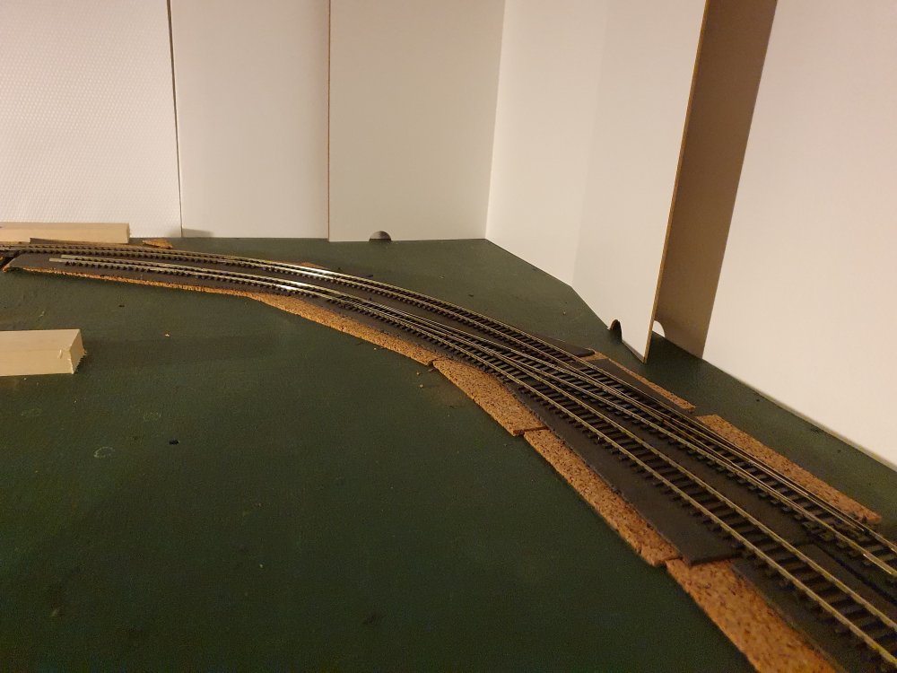

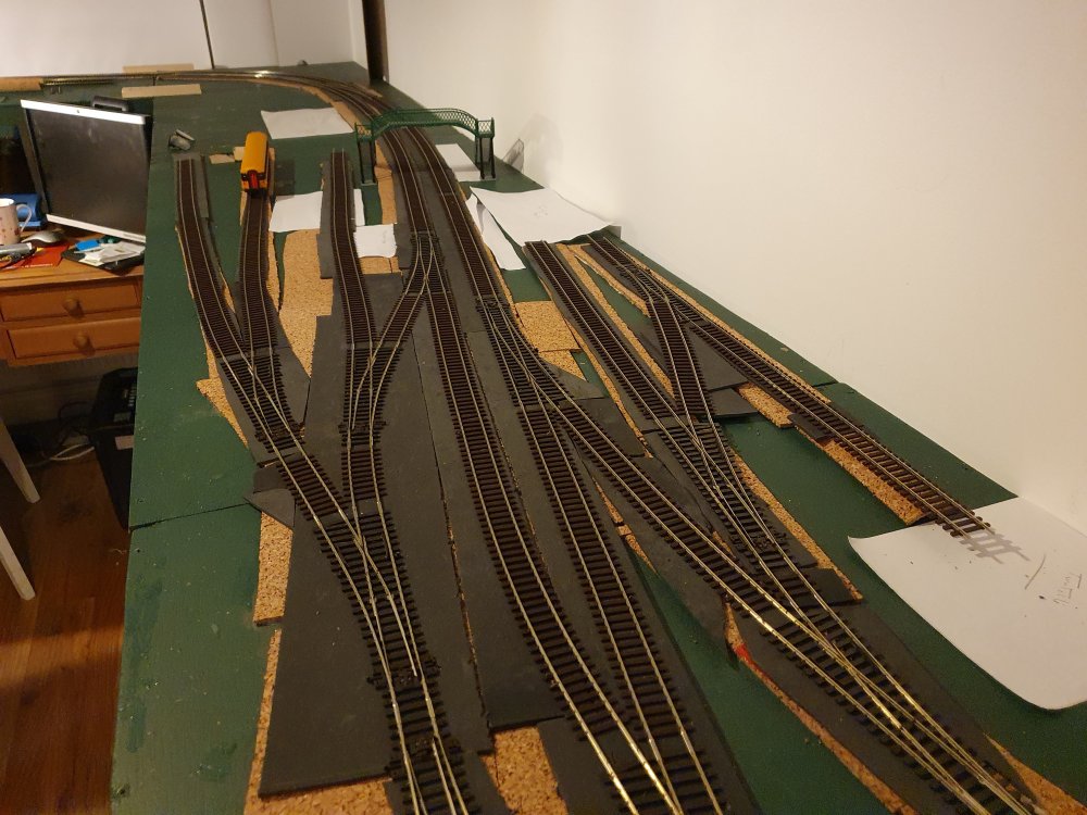

Edo Posted February 14, 2021 Author Posted February 14, 2021 (edited) Feb update On the face of it - not a vast amount done since Christmas. I had a bit of a rethink on the underlay - for the better I think. Also changed the lift out section in front of door into a hinged bridge section - its functional - i can see it being refined as time goes on. The Bagnalstown yard track is pretty much cut and fitted - just the engine shed and yard to be completed. The Palace East branch is in place as are the goods shed and sidings....im going to take advantage of the fact that Bagnalstown had 2 rather long sidings/headshunts on either side of the passing loop (osi maps)to give myself options for double line running..... Thats going to be it for a while - work and the garden are going to take over until the autumn now - but i have a functional railway to run my As when they arrive in a few months time. For the first layout i've attempted since i was in short trousers (40+ years) and without an engineering bone in my body - its going ok and very educational.....next up is wiring which i will attempt ....hopefully without shorting out the entire Shannon region! Edited February 14, 2021 by Edo 9 Quote

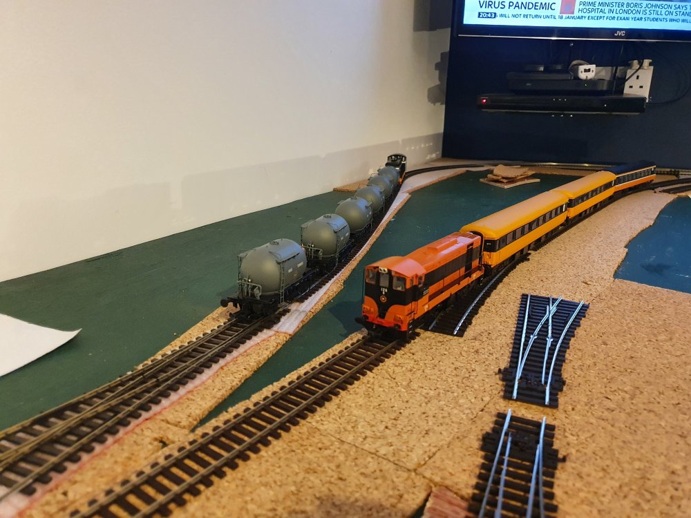

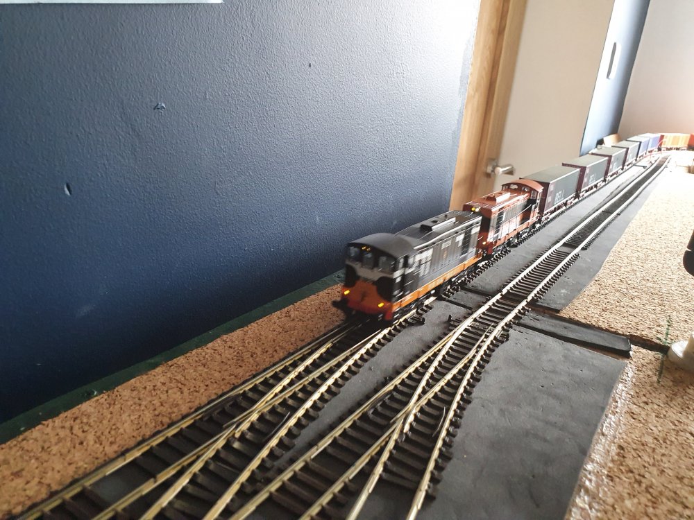

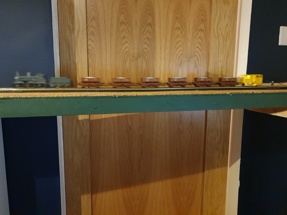

Edo Posted March 14, 2021 Author Posted March 14, 2021 No progress to report - just took the 42ft fleet out for a spin today - in between cooking the dinner! - 20210314_132914.mp4 delighted that the compact non prototypical passing loop still is able to hold up to 9 containers or ferts comfortably..... 20210314_132650.mp4 9 Quote

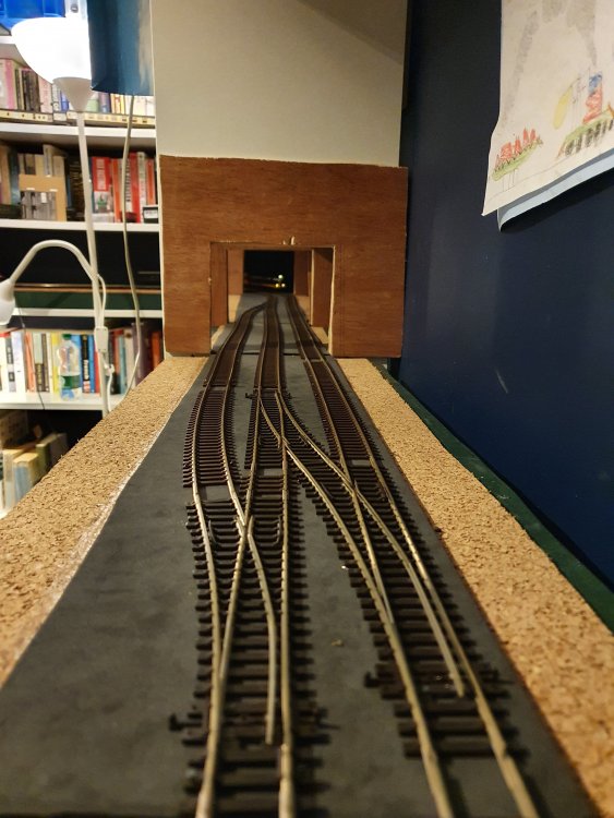

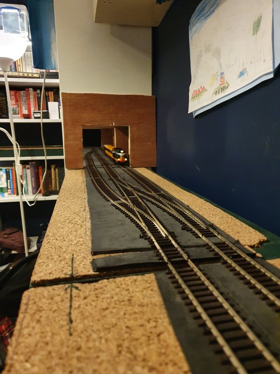

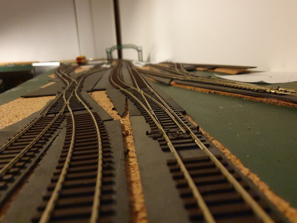

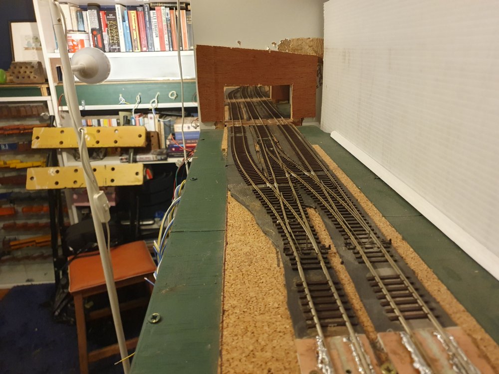

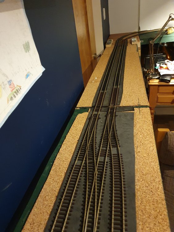

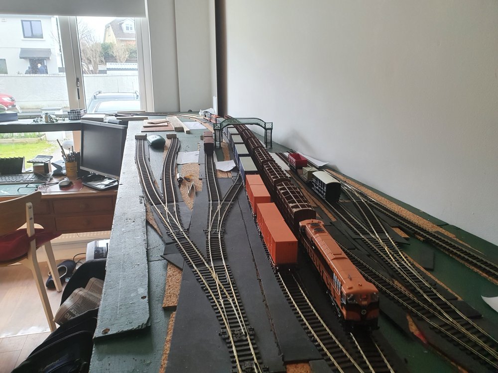

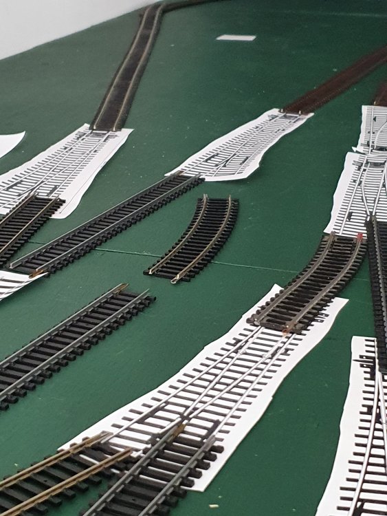

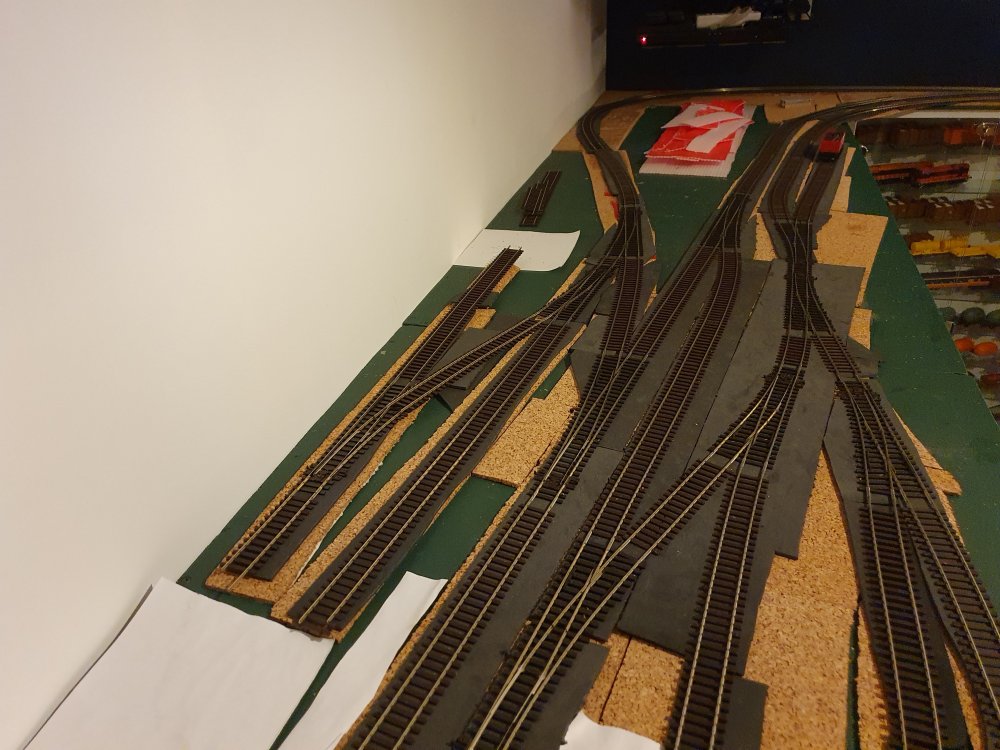

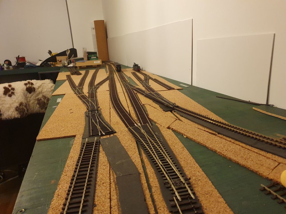

Edo Posted July 7, 2024 Author Posted July 7, 2024 Well here we are 95% of the track laid and wired up - just the sidings to be done. Cobalt points set up and wired in, solenoid points wired in - all on Dcc currently - track is Dc - but dcc ready - will switch over as i get locos chipped. Can finally start to thnk about scenics 6 Quote
DJ Dangerous Posted July 7, 2024 Posted July 7, 2024 11 minutes ago, Rob said: Well done- now the fun part can start!!! Sticking no-smoking signs onto stuff! 1 Quote

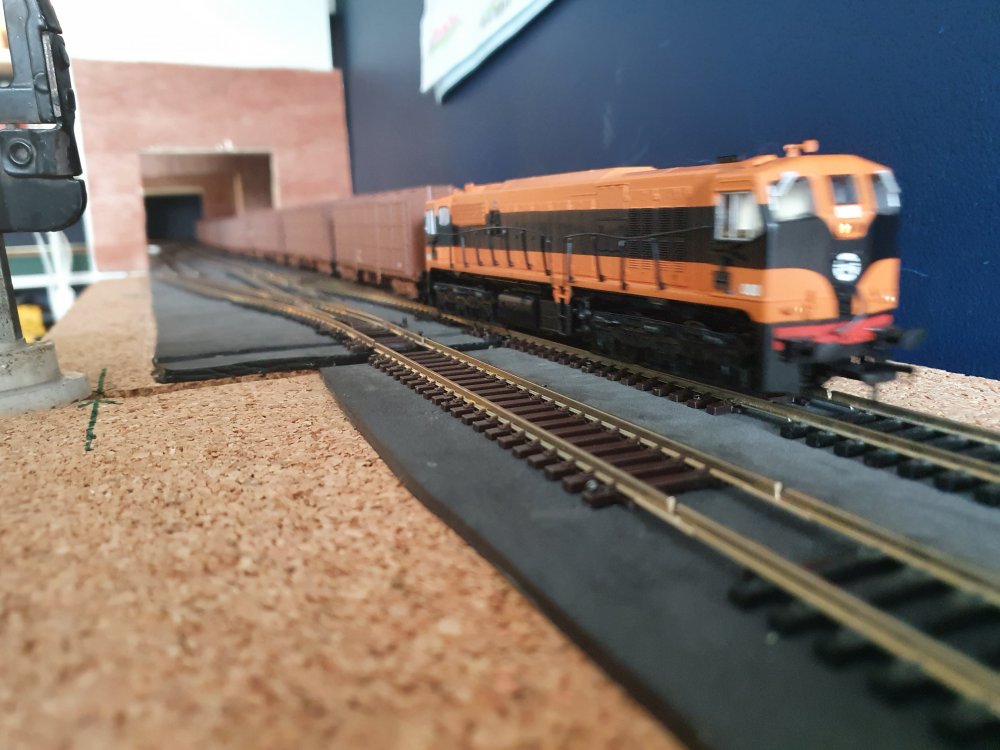

Georgeconna Posted July 7, 2024 Posted July 7, 2024 2 hours ago, Edo said: Well here we are 95% of the track laid and wired up - just the sidings to be done. Cobalt points set up and wired in, solenoid points wired in - all on Dcc currently - track is Dc - but dcc ready - will switch over as i get locos chipped. Can finally start to thnk about scenics The A is derailed so you might want to look at the track there. Gives the points a right smack. Quote
Edo Posted July 8, 2024 Author Posted July 8, 2024 8 hours ago, Georgeconna said: The A is derailed so you might want to look at the track there. Gives the points a right smack. Indeed - it actually hopped off on a bit of bad soldering before the point - the A 's are quite unforgiving of any deviation of the trackwork...stuff the 121s, 141s and 071s just fly over.....only took the first of my As out of the box over the last couple of days and I've already fixed up a few spots.....all part of the fun! 1 1 Quote
