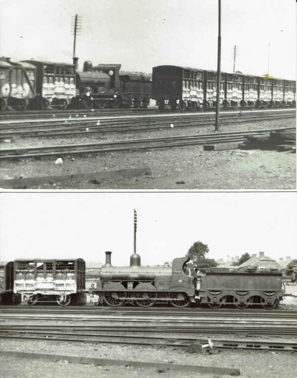

The MGWR covered cattle wagons were quite different in design to other companies cattle wagons and made up a relatively small proportion of the livestock carrying fleet with over 1613 Convertible & 450 Covered cattle wagons in service in 1924.
Some of the cattle wagons were vacuum piped and later fitted with vacuum brake gear which indicates that they are likely to have been used for urgent traffic running in passenger and mail trains.
The Midland tended to go through phases of rebuilding open cattle wagons as standard covered wagons, eliminating the type by 1885 then building small batches between 1885 & 1895.
Unfortunately I have been unable to find a good close up photos of the MGWR covered cattle wagons or find a drawing or photo of the open cattle wagons.
Upper photo un-credited, lower photo ©L&GRP 22486 Loco No133 "Titian" both photos appear to have been taken at the same location on the same day.
Jack Kennedy's photo of  129 "Celtic" one of the MGWRs largest and most prestigious main line passenger loco on a cattle train at Athenry illustrates the relative importance of cattle traffic on the Midland compared to other Irish railways, as Jack once commented the MGWR would not have been interested in "The High Speed Train" (IC125) unless it was capable of hauling a cattle train. The Midlands express passenger locos had relatively small 6'3" driving wheels compared to similar GSWR & GNR locos to improve their ability to haul mail and cattle trains, the D & K Class 2-4-0s & F Class 0-6-0s were true mixed traffic engines with 5'8" driving wheels similar in concept to the Scottish "Intermediate" 4-4-0s similar to the North British "Glen Class" & Highland "Loch" Class.

The overhead gantry above the sidings at Ballysadare opens up all sorts of interesting possibilities.
Ah, that.  I thought the comment referred to maybe hooks for holding the ropes of the tarpaulins.
I have no idea what the above castings were. As you say, probably too small for grain, and I think in any case it’s almost certain that bulk grain wasn’t carried in vehicles like these.....
5 hours ago, Mayner said:
I think Mike is referring to this one
The vents or whatever their purpose were a standard detail on MGWR Standard Covered Wagons and would have been very small for unloading grain.
Its just about possible bulk grain was carried in these wagons and discharged through the doors, just as boxcars were used in the States & Canada up to the widespread introduction of grain hoppers in the 1980s.
http://catalogue.nli.ie/Search/Results?lookfor=ballysadare+mill&type=AllFields&submit=FIND&filter[]=authorStr%3A"French%2C+Robert%2C+1841-1917+photographer"&filter[]=format%3A"Photo"&filter[]=digitised%3A"Digitised"
Hi John,
I'm afraid I've no idea what the castings are that @Mike 84C is referring to, although at first I wondered if they were label boxes for consignment labels, then looking at the shape of them again, I wondered if could they be drains for washing out after the vehicle has been used for livestock, but I suspect they're too far up the vehicle's sides.
Thanks for the link, those photos are full of atmosphere and great detail on the convertibles, including useful numbering!
With kind regards,
