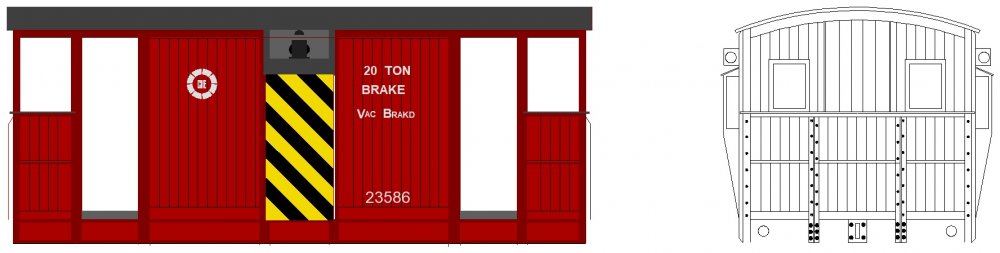

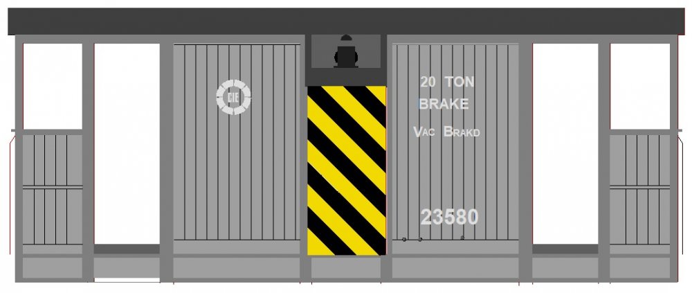

The brake van roofs are slightly lower than the H Vans a distinctive feature of the prototype.
The decorated sample was to test whether the printers could achieve the required standard before producing the more complex post 1963 scheme with CIE roundels and ducket wasp stripes.
56488457_CIE20TGoodsBrakeGreywithWheelLogo.thumb.jpg.f3b717379080c27aa4122d83a312516e.jpg
23580 Grey Post 1963
B23586 Red Oxide late 1960s
Unfortunately the project experienced a set back this week, our printer received notice to vacate their premises in February which is likely to have a knock on effect on production.
I hope to make an announcement once I have clarity on the printing situation.
