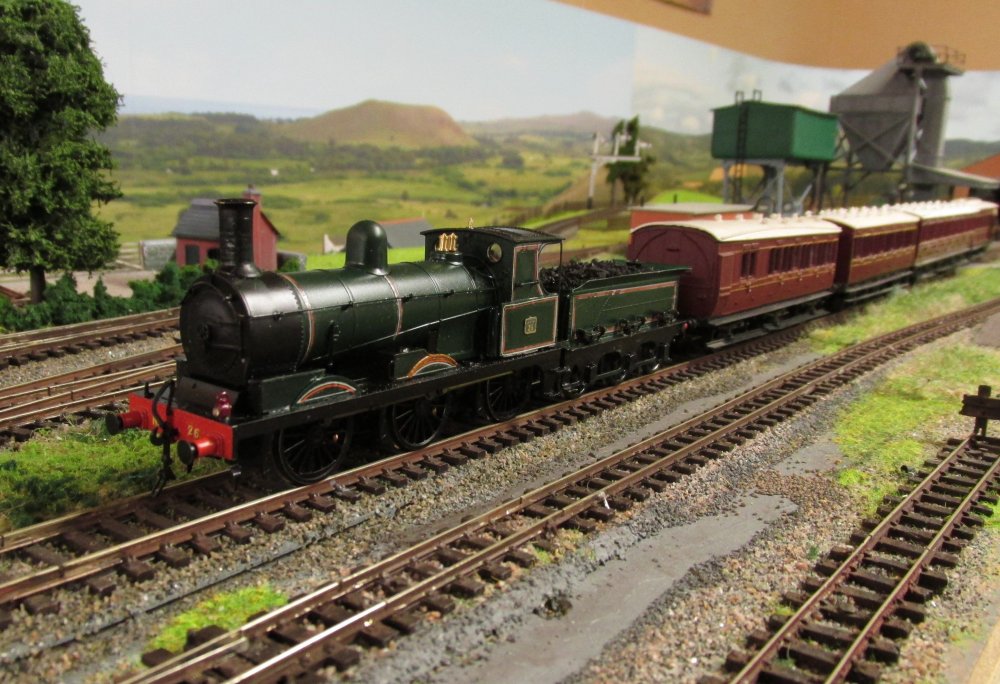

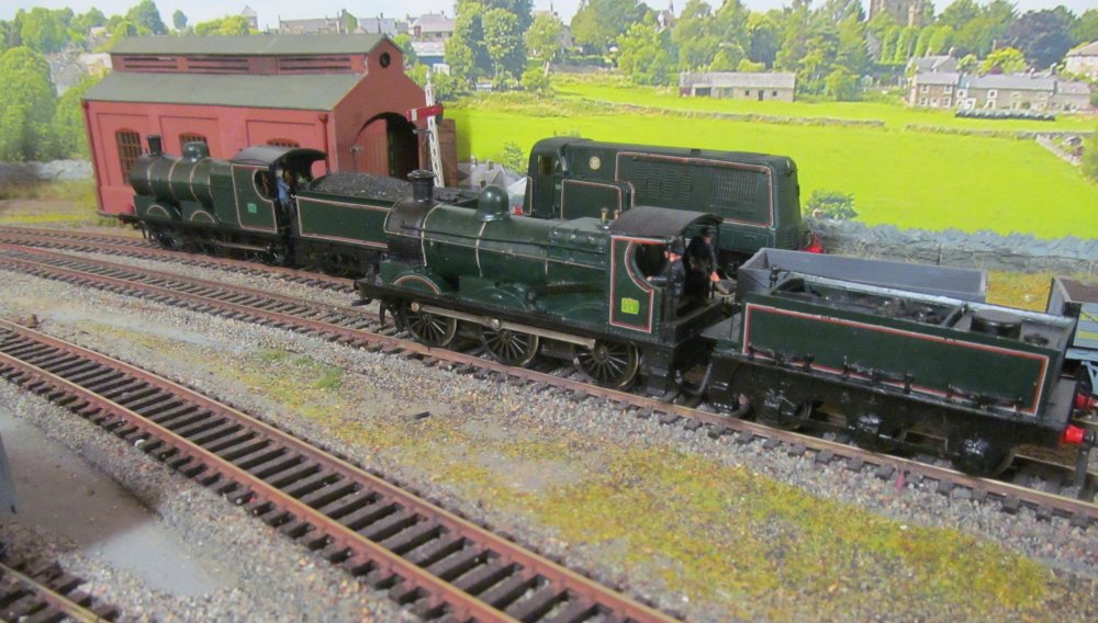

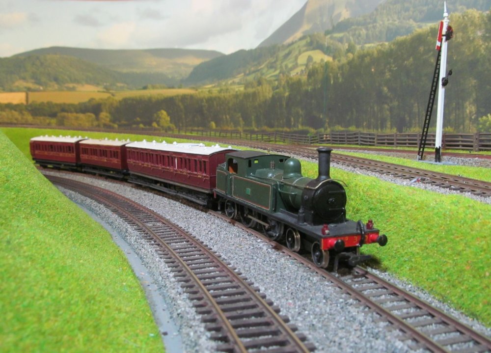

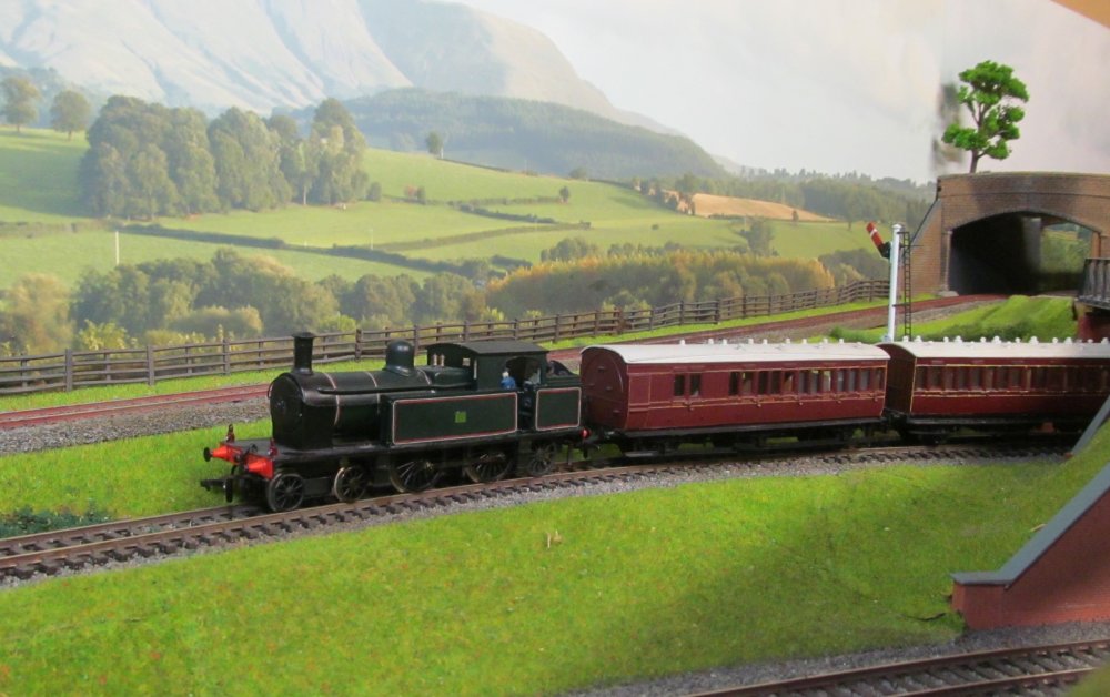

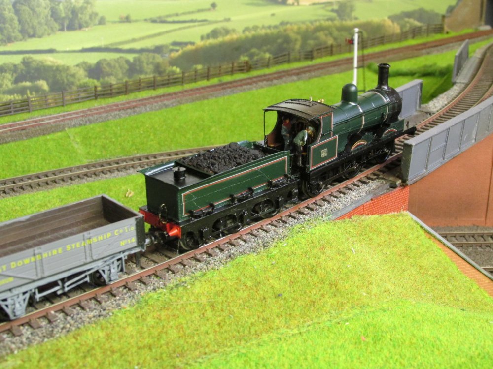

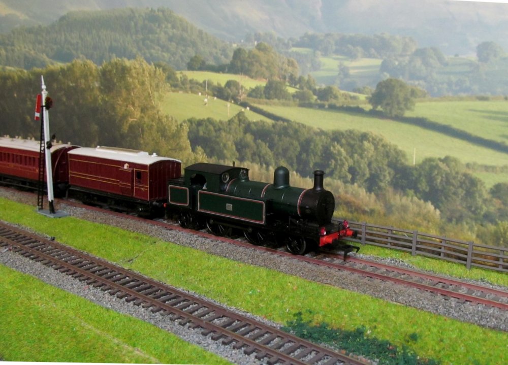

colmflanagan Posted February 27, 2021 Share Posted February 27, 2021 (edited) Greetings all, It's been a good long time since I posted anything on this forum, but time flies - my main vaguely Northern Irish based layout is "The Ballycrochan Line" it's on RMweb's Irish group., if any of you aren't aware of it, and fancy a look.. My first serious efforts into modelling Irish, was back into the early 1970s when I decided to try and build something from a Belfast &County Down railway ; the result was a modified Tri-ang LMS 3F 0-6-0 into a representation of No 4 on the BCDR. I didn't even line it as I hadn't the skill, or nerve, to "have a go". The photo below is taken on my layout of the day. The second picture was an effort to do No 171 "Slieve Gullion" from a Tri-ang Southern Railway L1 4-4-0, it and as for name plates or transfers, no-one as far as knew, made them in 1971. Believe it or not, I still have both of these though No 4 has become No 14, and 171 is now "Slieve Donard" - both lined with name/numberplates! Anyway, I thought some of you might be interested in a little BCDR get together I had recently on my layout; there are three "BCDR 4-4-2" tanks in the pictures. Spot the differences.. No 30 was built by me from a K's SR Adams radial tank with a largely new body shell. No 12 is essentially a Craftsman kit chassis built by David temple, who advertises in Railway Modeller; I grafted on a plasticard body.; No 27 is the newest, a project I recently built for a friend. It actually isn't a 4-4-2 at all. It's a Bachmann Lancashire & Yorkshire 2-4-2 tank, repainted with a few tweaks to look a it more "County Down". As such we gave it the number 27, which was in fact a BCDR 2-4-2T But the L&Y loco looks more like the 4-4-2Ts, I think. The three locomotives; it may be tricky reading the numberplates; 27 is at the back; No 12 on the right, and No 30 on the left. As No 12 is slightly overlapping No 27, you can't tell if it is a 2-4-2 or a 4-4-2! Anyway, which one is the nearest to the prototype? I leave you to decided for yourself. I have a vague idea of seriously attacking another Bachmann L&Y 2-4-2 loco and actually converting it to a 4-4-2. But thisI will require me to call in some engineering help, as fitting a bogie will be tricky, if the thing is ever to run properly. Colm Flanagan Edited February 27, 2021 by colmflanagan extra info 10 2 Quote Link to comment Share on other sites More sharing options...
jhb171achill Posted February 27, 2021 Share Posted February 27, 2021 I've seen that on RMweb, Colm, and it is absolutely amazing. It is also very timely here, as recent posts on this forum in the last week have enquired (on another modeller's behalf) about the correct BCDR green for locos - you have it - and the types of carriages which ran on the line. I have a few questions - in the second colour picture, that brake third - is that one of those Ratio long wheelbase 4-wheel GWR types on a (prototypical) 6-wheel chassis? The carriages you have are fascinating. Dare one ask that when you've time you might post some info on how they were made, adapted from what, or scratchbuilt? The carriages are absolutely superb. 2 Quote Link to comment Share on other sites More sharing options...
Galteemore Posted February 27, 2021 Share Posted February 27, 2021 Welcome back Colm. Hope you post more. BCDR tanks have been under discussion here of late so your fine work is making a timely appearance ! 1 Quote Link to comment Share on other sites More sharing options...
murphaph Posted February 27, 2021 Share Posted February 27, 2021 I love the backscenes. Really great depth. 1 Quote Link to comment Share on other sites More sharing options...

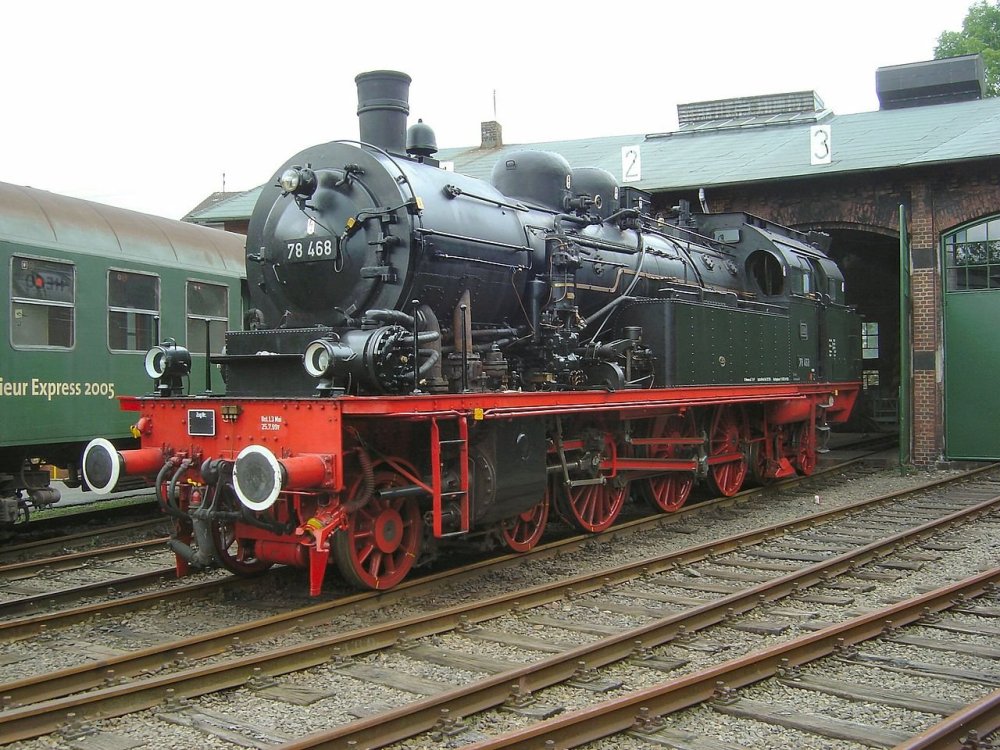

Mayner Posted November 3, 2021 Share Posted November 3, 2021 Its interesting how overseas railways turned out successful 4-6-4T locomotives while British companies struggled to produce a successful 4-6-4T tank with the notable exception of the Brighton Baltics. The main problems with the British locos appears to have been poor front end and ashpan design. On the 3'6" gauge NZR successfully used 4-6-4T for branch line, mixed traffic and suburban design. Interestingly the first NZR Baltics the WW Class of was a 1913 development of a 1904 2-6-4T design, the final NZR 4-6-4T design the Wab/Ws class was a 1919 development of a 4-6-2 Mixed Traffic design https://en.wikipedia.org/wiki/NZR_WAB_class All NZR 4-6-4T Classes were modern designs with long travel valves outside valvegear and free steaming boilers. 1 Quote Link to comment Share on other sites More sharing options...
Galteemore Posted November 3, 2021 Share Posted November 3, 2021 And as for the Prussian T18…. The BCDR did at least redeem themselves in the rebuilt 2-4-0, No 6….. 2 Quote Link to comment Share on other sites More sharing options...
