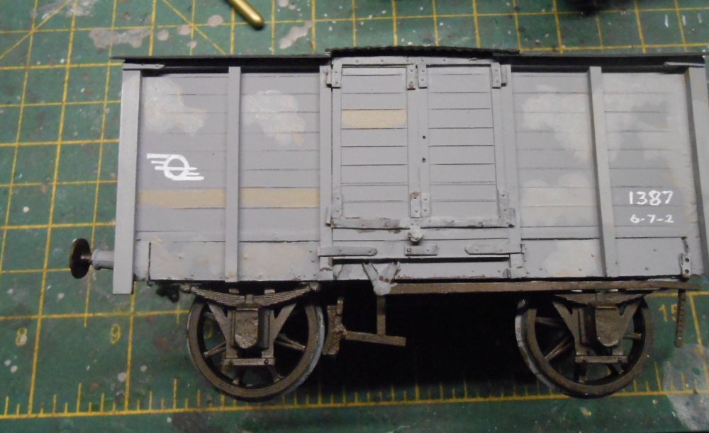

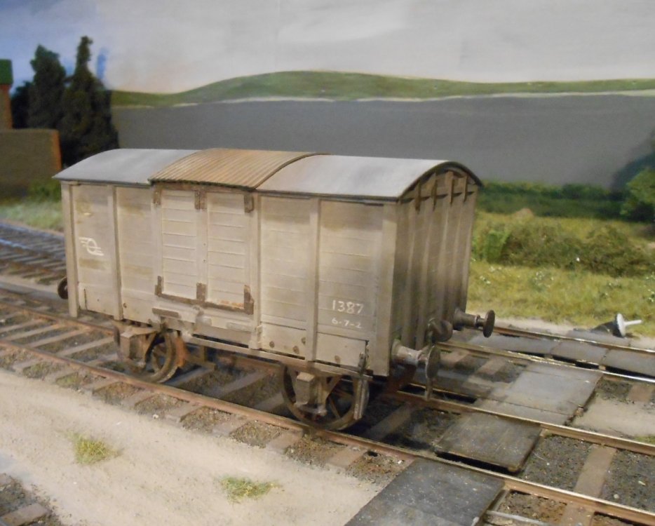

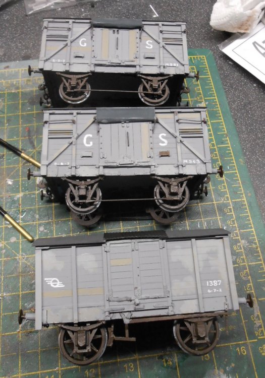

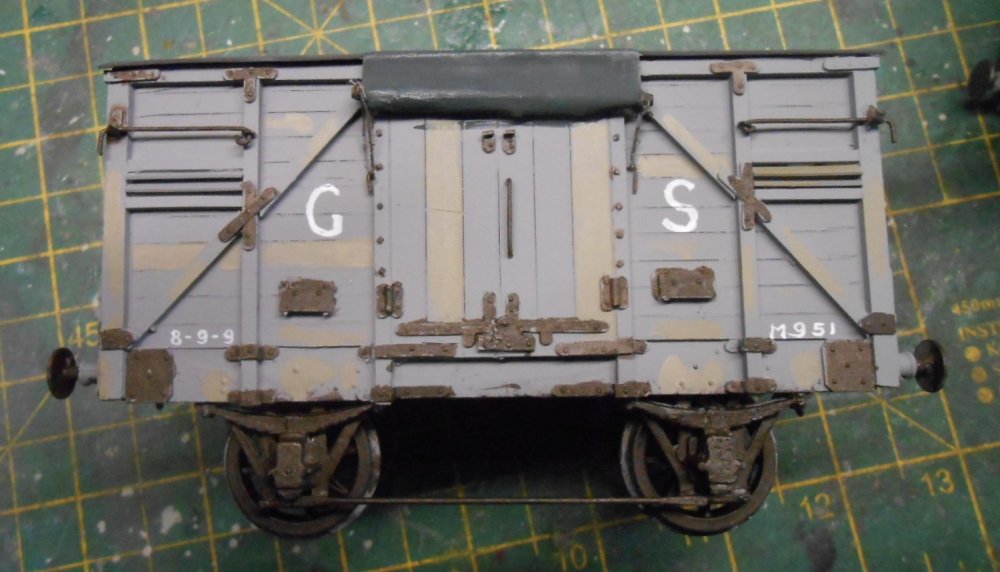

Should have known better Got a PM last week from our resident livery specialist. Not the first time either, but his advice is always very welcome, even [especially] when I get things wrong. To be honest, was rather expecting it, as the GSWR brake and van were not only too light a grey, but the former had its strapping highlighted in black. So, out with something darker, which also necessitated doing the lettering again. Shame in a way to over paint Richard's brake van, but even the maestro got it wrong occasionally. Anyway, many thanks JHB and hopefully this shade looks a bit better!

Trying to tie up some loose ends at the moment, one of which is my Castle Rackrent GSWR brake van. A bit tatty when I acquired it, there was a corner missing from the roof, while the steps on one side had broken off. It's interesting exploring someone else's work, especially a master modeller like Richard Chown. The brake van is mostly made of wood, with white metal W irons, but a plasticard roof. Repairing the broken corner was simple enough, with a small triangle of 20thou, supported by a small strip underneath. Replaced the steps with new ones, also made from 20 thou & then tidied up the paint work. Not sure Richard was terribly into weathering, though back in the day, a coat of 'dirty thinners' tended to suffice. On the GSWR brake, whatever shade this started as has faded to strange yellow green, so mostly painted that out & then did my usual thing with a light dusting of weathering powders. Richard used Alex Jackson couplings, but I am using a mixture of three links and Dinghams, so for now have added the former. Back in September, I built a pair of GSWR vans, but only one of which got painted. The other was intended for my 1900s period, so has been painted in their dark grey, with white lettering [dipping pen] & lightly weathered. The loco is my Timoleague and Courtmacsherry Tramway loco, St Mologa [patron saint of beekeepers], now masquerading as Belmullet's harbour branch shunter. Interestingly, in the latest GOGuild Gazette, someone has rebuilt one of these Alphagraphix kits into one of the Bideford, Westward Ho! and Appledore railway 2-4-2T tram engines.

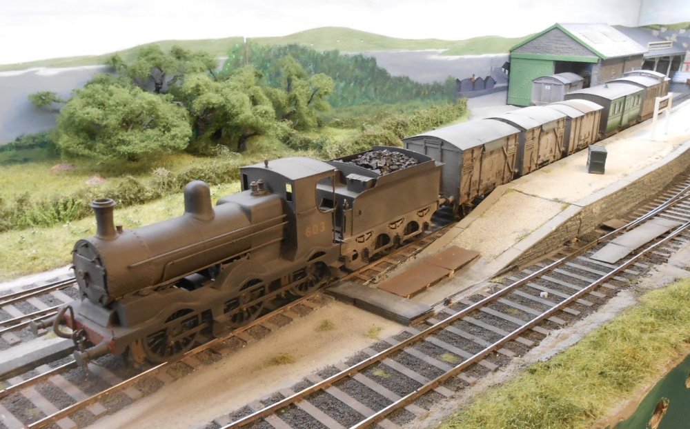

Back to the 1900s Recent work on the GSWR Brake 3rd, plus new wheels for WL&WR 0-6-0 Shannon have all been about moving Belmullet backwards about 50 years to the early 1900s. A few liberties are being taken, because my 101 0-6-0, being a later Coey engine, wasn't built until 1903, while the WL&WR had already been taken over/absorbed by the GSWR by then. However, it always took time for locos and stock to be repainted, so hopefully what I'm doing isn't too outrageous, although a railway to Belmullet never existed anyway of course. Anyway, Shannon now has its new wheels and the bodywork has been given a further bit of TLC, touching up paint chips here and there, plus a bit more work with T-cut to freshen up the rest. Still needs balance weights to be added to the wheels, while have just noticed one of the handrails need straightening - is any model ever really finished? However, was keen to pose and operate the two new trains to herald the move back in time. Shannon's train is very much a nod to creator Richard Chown, being what he called a 'Mail Goods'. This featured on his Castle Rackrent system and as well as Shannon, I also have his two Dublin and Meath brake vans. Quite why he built even one of these is anybody's guess, but he was often drawn to obscure prototypes and with their salmon pink ends, these vans are certainly that. The rest of the train comprises my own scratchbuilt models of a WL&WR full brake, plus a carriage truck from the same company. On Castle Rackrent, photos show a carriage truck on the Mail Goods, sporting what looks like a horse drawn pantechnicon - there's a word for you! These days we call it a removal van. My fiddle yard is 43 inches long, but Shannon's train is only 39 inches - hence not enough room for another wagon. The WL&WR did have a couple of six wheel carriage trucks, but at just over 9 inches long, there is not enough room for one of these. At the moment anyway! The 101's train has previously been described as a private excursion, though with a six wheel first, brake third and two horse boxes, probably works as an ordinary service train too. However, 101 0-6-0s rarely ventured this far north or west, so a 'special' probably makes more sense. The two trains are shown with Shannon waiting in the bay, ready to depart east, then south for Limerick with mail and parcels, while the 101 leaves first for [eventually] Dublin or Cork. Suspect the coaches will be added to another train somewhere further on.

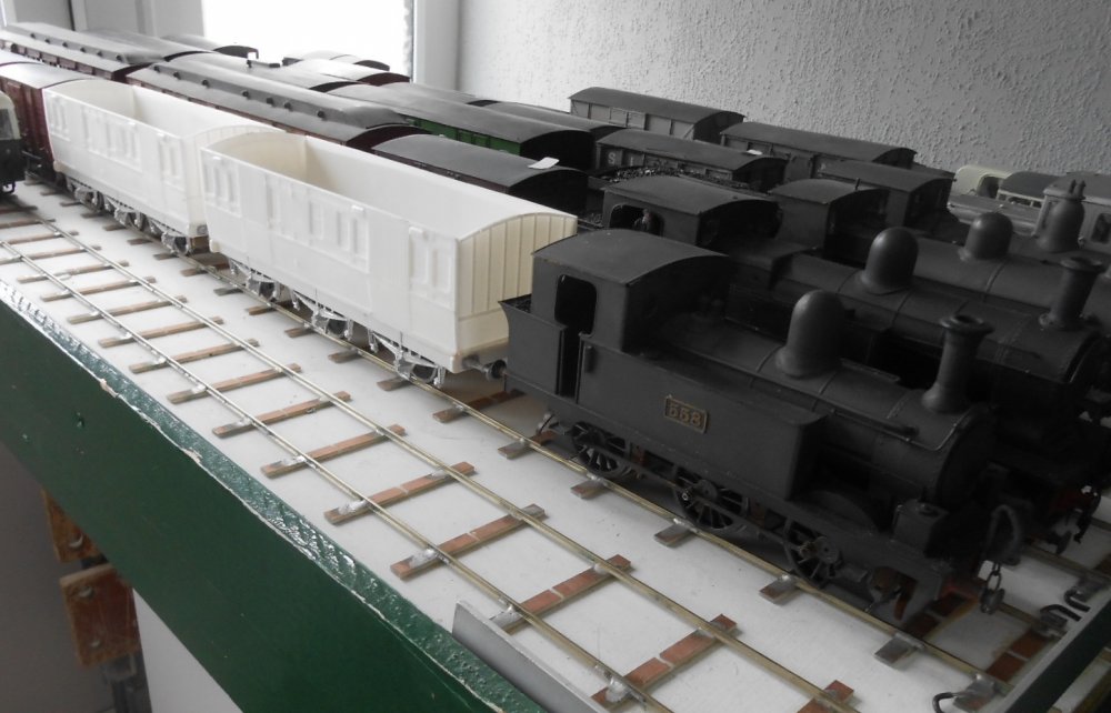

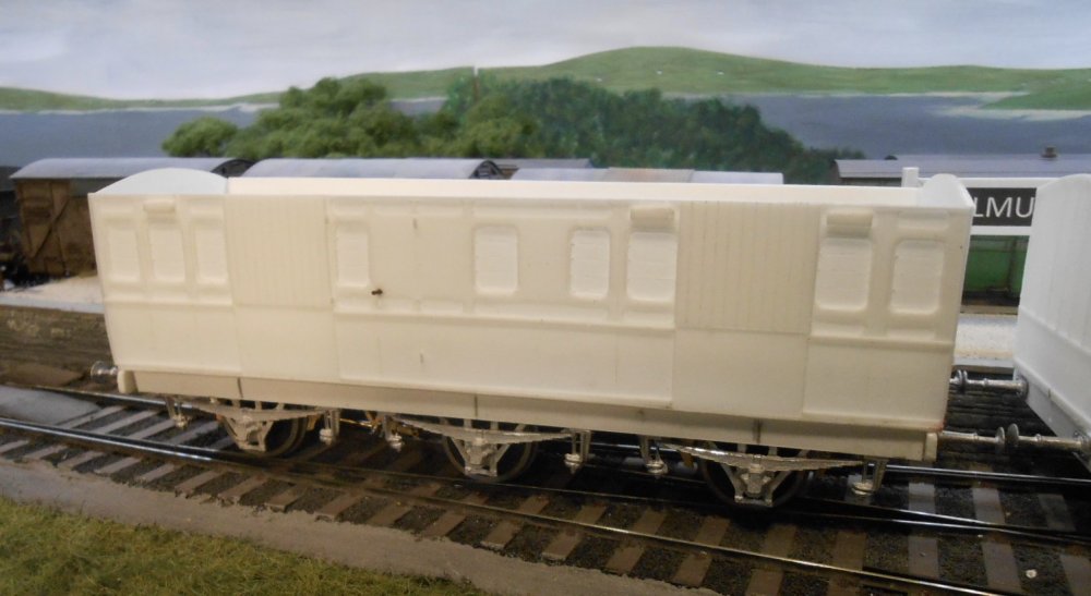

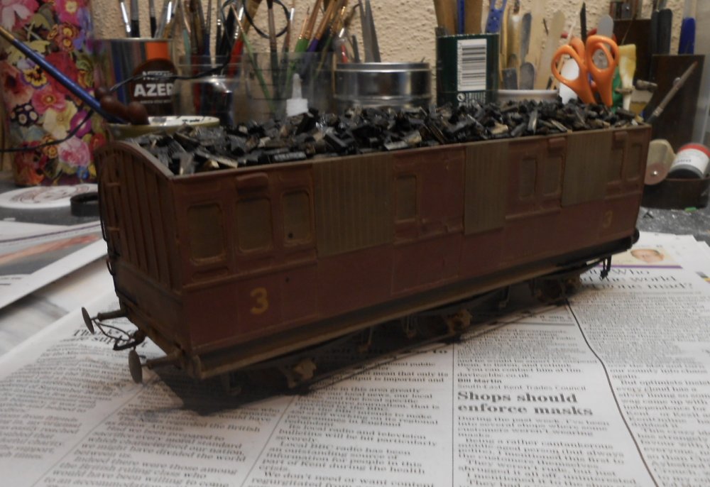

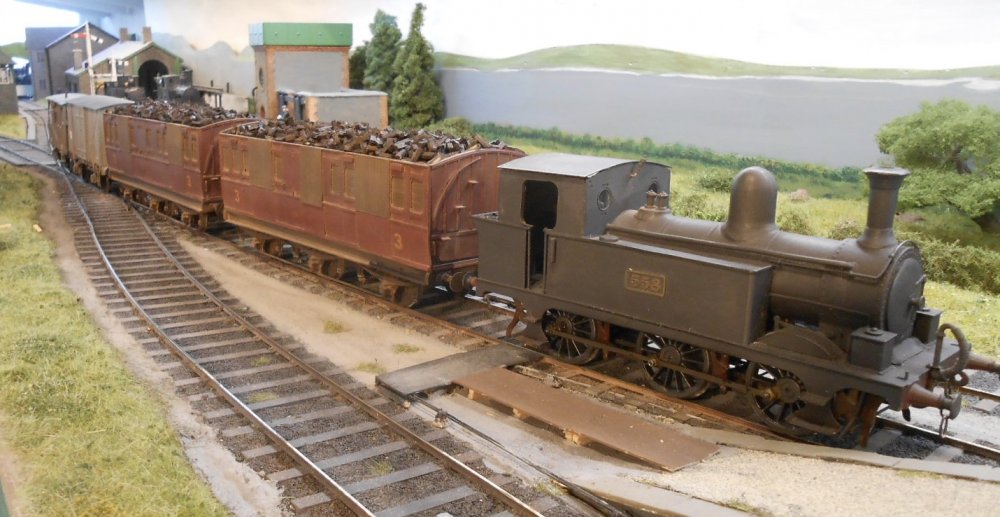

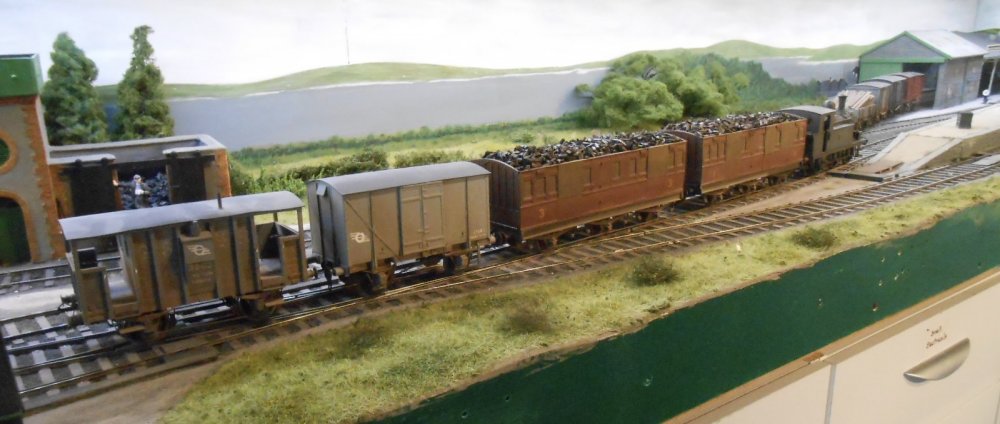

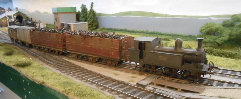

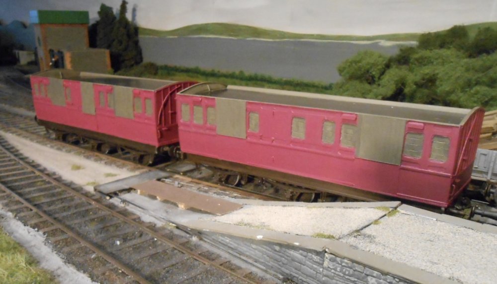

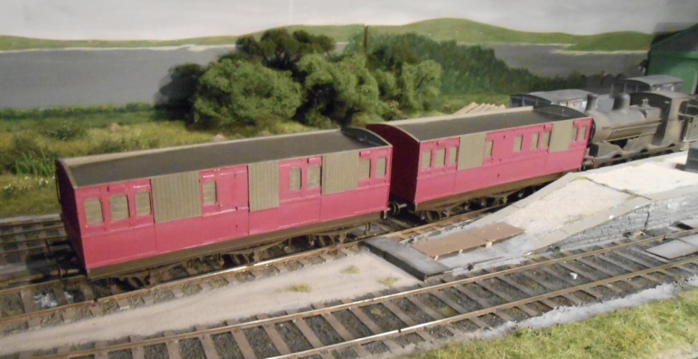

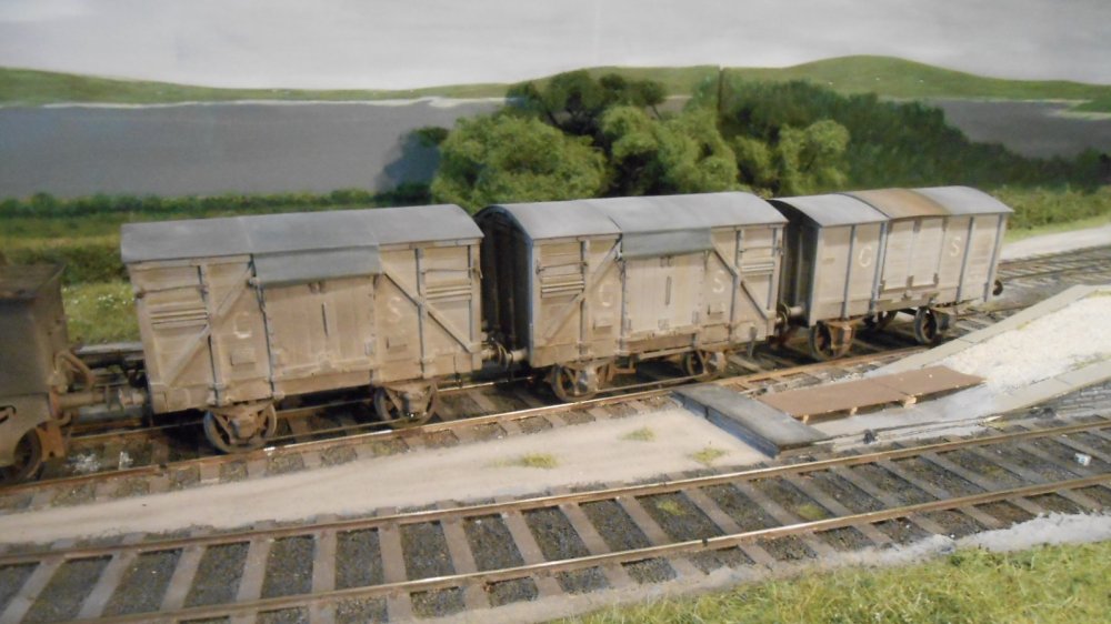

Nearly there with the brake third. Grab handles and hand rails [0.8mm brass wire] the main task, then it was a case of finishing off the roof. I raided my dwindling parts boxes for fittings, but Sod's Law has meant that I only have five torpedo vents, when I need six, and while I found three lamp tops, they were of two different styles. Got ahead of myself then and painted the roof, but forgot to add the rain strips. Needed a second coat though, so not far off now. The photos show the third with its intended train. This comprises an Alphagraphix/Tyrconnel 6w first [brass kit], along with a WL&W horse box and carriage truck - both scratchbuilt. The idea is that this is a private excursion carrying a well to do group [in the first], together with servants and luggage [in the brake third], plus horses and a [yet to be built] carriage. Both the latter can be shunted/unloaded in the cattle/unloading docks. Meanwhile, as before while waiting for paint/glue to dry, carried on playing around with rebuilding Shannon. The loco has had pick ups fitted and runs fairly well, though I think the coupling rods still need easing a little. The RG4 gearbox is proving a little noisy, so may yet replace it with a Mashima type unit from Precision - especially as RG4s do not like feedback control anyway. As for the tender, having stripped everything out last time, I decided to make a new set of inside frames from plastic sheet, rather than spend ages fretting sides and spacers from brass. Not as radical as you might think, as I've used brass bearings, but certainly a lot quicker. As you can see from the photos, the inside frames are pretty much hidden. It runs well enough, so fingers crossed!

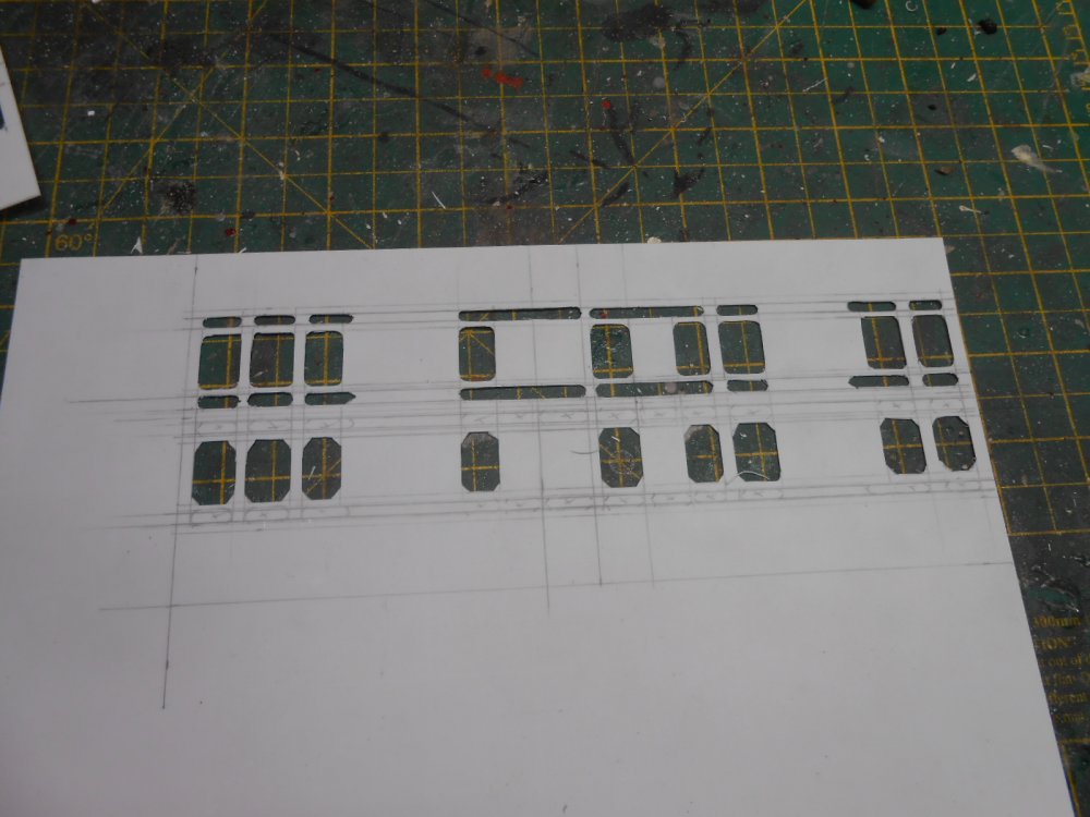

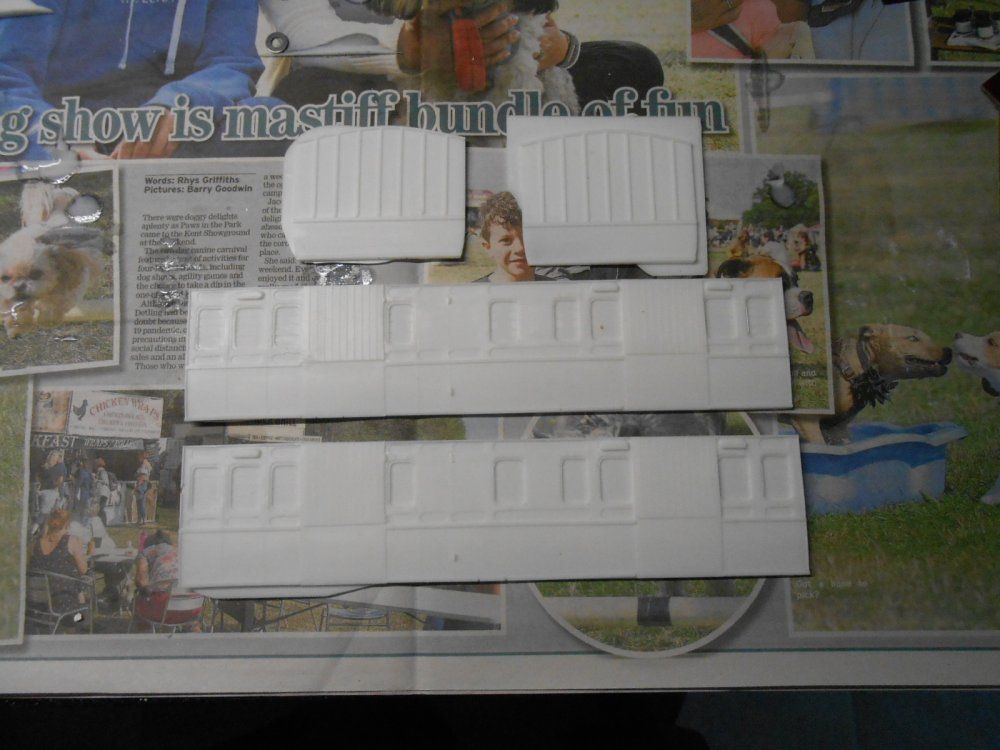

Things still going slowly with the Brake Third, but it has been given two coats of dark lake, with the door handles and glazing going in as well, along with the birdcage lookout and some passengers. Just occasionally, I remember to plan ahead, so the sides were built with spaces for 20thou perspex to be slid in. While waiting for the paint to dry, I busied myself with the 101 adding tender pickups and wiring these to the loco. Much to my surprise, the loco runs really well. However, another 0-6-0, Richard Chown's Shannon, has been having some attention. The model is approaching 50 years old and while the body work has stood the test of time, the same can't be said for the chassis. The driving wheels are so worn that there is a clear rut in the treads, while the centre drivers had a 2mm wobble. Shannon nevertheless still ran ok, probably helped by the fact the the centre wheels are flangeless. The tender wheels were similarly worn, this time the problems was more about the flanges, which had worn to a razor edge. The latter probably because the tender had considerable extra weight thanks to a speaker and electrics for an old Pacific Fast Mail sound system. The lead and middle drivers came off ok - am guessing they are Walsall wheels and have a Romford style centre nut which requires a screwdriver with a slot cut in the blade to undo it. The rear drivers were much more of a problem, being fixed with a slotted bolt/screw, which refused to budge, so I had to resort to brute force in the form of a slitting disc in the Dremel to cut the wheels off. The motor/gearbox is an adapted Portescap RG4 and despite running many actual miles, still seems ok. So an order was sent off to Slaters for new driving and tender wheels, along with six broad gauge axles. Cost me over £150, which is why buying an 0 gauge loco kit is only half what you eventually pay. The tender wheels had been fitted inside the body, so the only way to get them out was the Dremel again, cutting the axles in half. The plan is to build a new set of inside frames for the tender, though haven't yet decided how this will be fixed in place. Meanwhile, the loco wheels were reasonably simple to replace, the main work being adapting the coupling rods, which had to have their bosses drilled out to accept the Slater's crankpin bearings. Better that the holes needed enlarging than making bushes had they been already too big, methinks. Found that I needed to thin down the rod slightly, to take the nuts and washers which hold them in place. Assembling everything again then showed that the old wheels had thicker centres than the new ones, which meant the rods were fouling the brake gear. In the photos, you can see this in the shiny spots where I've had to file some areas down. Thus far, its been a really interesting exercise and [fingers crossed] Shannon still runs as well as her maker intended and should be good for a few more years now. Working on it has felt like a bit of archeology at times & it's certainly been a privilege to see how Richard approached building what is still a lovely model.
