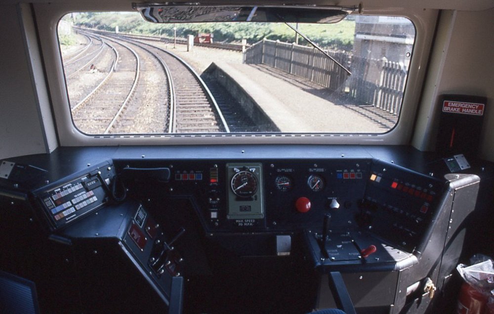

The Mark 3 Push/Pull driving cab interiors do look nice.
Regards Kian.
