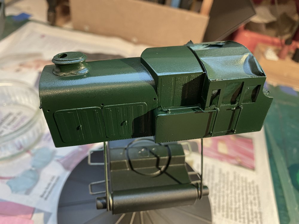

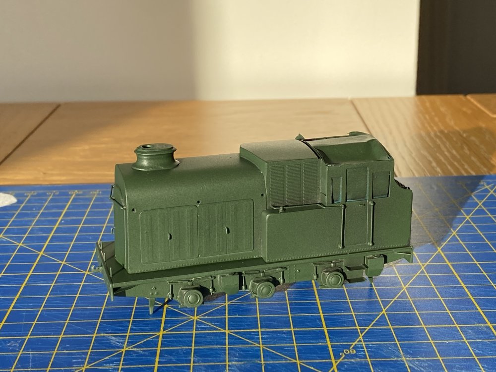

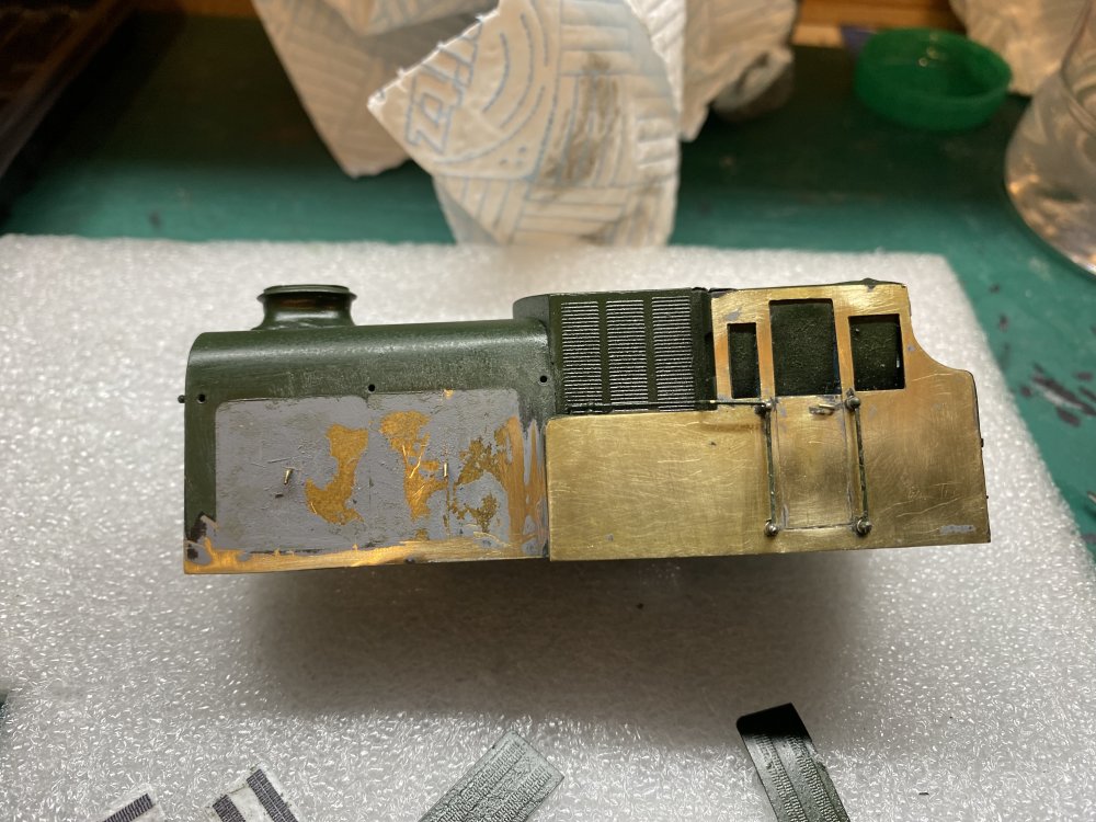

Tullygrainey Posted December 30, 2022 Author Posted December 30, 2022 I decided to take the easier route and stick with what I know, using transfers for the lining. I was making good progress with the paint - a nice even coat of GWR green overall, left to harden for 3 or more days. Then a dusting of (acrylic) gloss varnish to provide a good surface for the lining transfers. And that's when the disaster arrived. It crazed the paint - on one side only, strangely enough. Trying to sand it out proved futile and I've now taken it back to the metal in places. The engine casing doors, complete with louvres proved unsavable and will need to be remade. Also the rivet strip at the bottom. It's going to be a challenge to blend this back in. I've so far resisted the temptation to bin it but It's certainly taken the shine off my day. Backwards and downwards Alan 7 1 Quote

David Holman Posted December 31, 2022 Posted December 31, 2022 What paints and varnish brands did you use, Alan? Your misfortune could yet help others avoid such problems. However, seems to me you did the right thing in waiting three days for the paint to harden, so no idea why this should happen, though thinking about it there may be a 'rule' that says acrylic-enamel only works one way. Hopefully others will confirm and explain. Either way, much too good a model to discard, as that coat of green proves! Pause, deep breath and go again. Profanities and rude words optional, but certainly work for me. 2 2 1 Quote
Tullygrainey Posted December 31, 2022 Author Posted December 31, 2022 Thanks David. Yes, the loco may be green but the air was decidedly blue here yesterday! And yes, I think we're looking at an enamel/acrylic reaction here. Clearly 3 or 4 days drying time for the colour coat wasn't enough! The fact that only one side was affected is odd but I think the culprit was an over-liberal dose of varnish on the affected side. For the record: the green body colour was Railmatch enamel, (GWR loco green 1601) the varnish was Humbrol Acrylic Varnish (Gloss 35) both applied from aerosol cans. The unaffected side shows it can be done without mishap but it needs care and plenty of drying time. Patience, in fact. I must order some of that Alan 1 Quote
Galteemore Posted December 31, 2022 Posted December 31, 2022 I have had a few similar reactions - both chemical and verbal ! I understand that the solvents in enamel can take well over a week to clear. Enamel over acrylic is ok, but I know the reverse can be problematic. 1 1 1 Quote

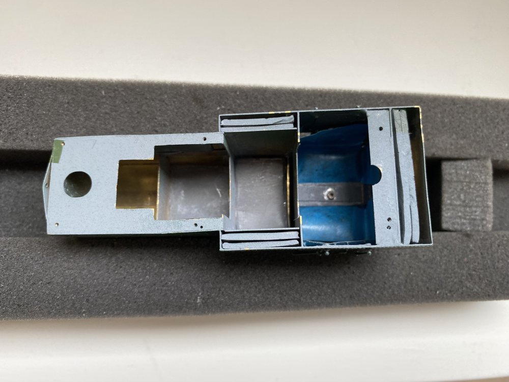

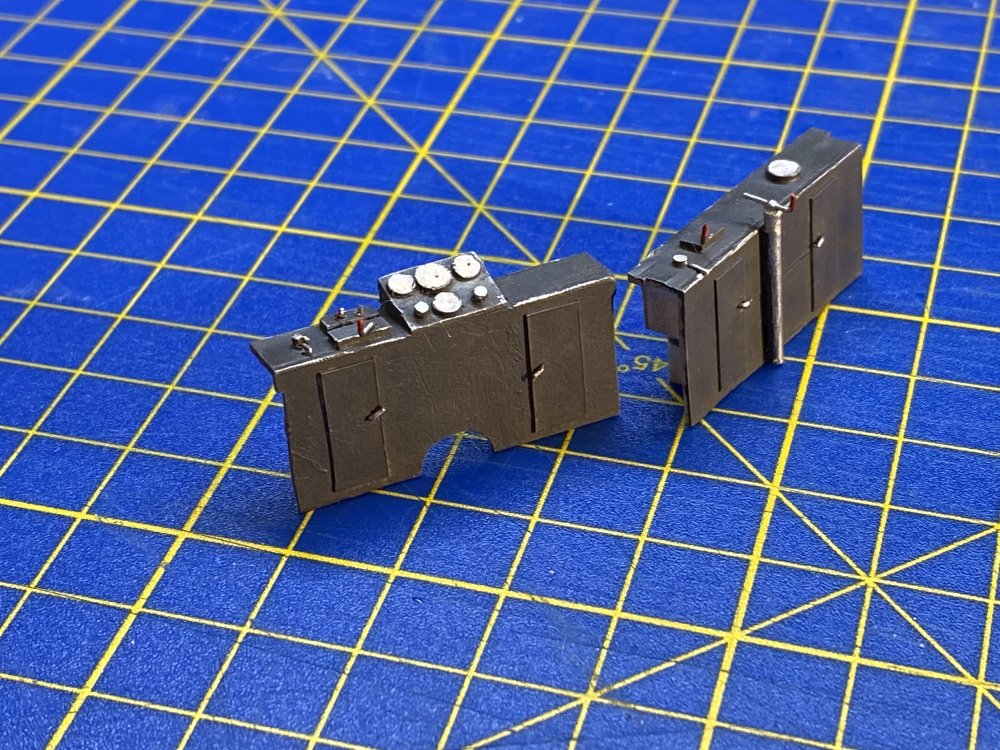

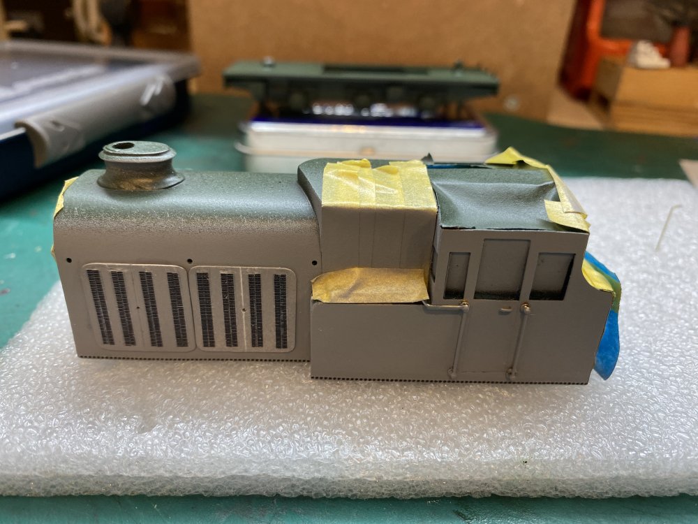

Tullygrainey Posted January 21, 2023 Author Posted January 21, 2023 So, the swearing eventually stopped, the tantrums subsided and when calm was restored, the recovery got underway. The engine casing doors were remade, the rivet strip reinstated and some Halford's grey primer was applied with care... ... and every cloud etc, so with encouragement and advice from jhb171achill (thank you again JB), we took the opportunity of the repaint to try and get a bit closer to BCDR green. That Great Western colour I used before was a bit too olive. This time Humbrol Brunswick green enamel was the starting point, darkened with a little black. There's loads of room inside this bruiser so the shell is now lead-lined... ... and here's an approximation of the control desks for inside the cab. They'll hardly be seen. Onward and upward again Alan 12 5 Quote
Galteemore Posted January 21, 2023 Posted January 21, 2023 Superb, Alan. Well done - if anything, looks even better now. 2 1 Quote
Patrick Davey Posted January 21, 2023 Posted January 21, 2023 Always like to see updates on this thread Alan and this is a cracker - the loco is looking great and with all that lead it'll probably be able to haul 10-coach Bangor specials as well as the 2-coach Ballynahinch branch set... Colour looks great, and the cab controls will make a big difference even if they can't be seen too clearly - we all know they'll be there!! Looking forward to more!! 2 1 Quote

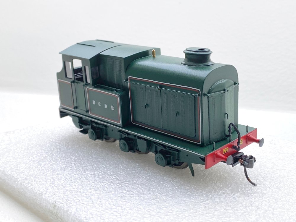

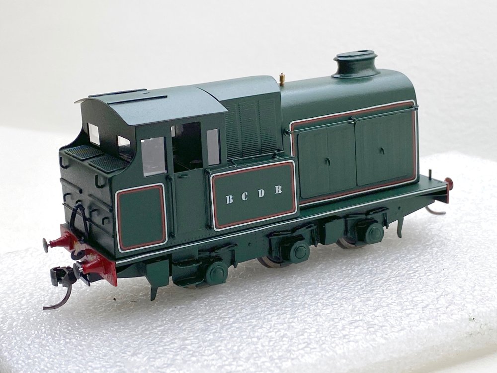

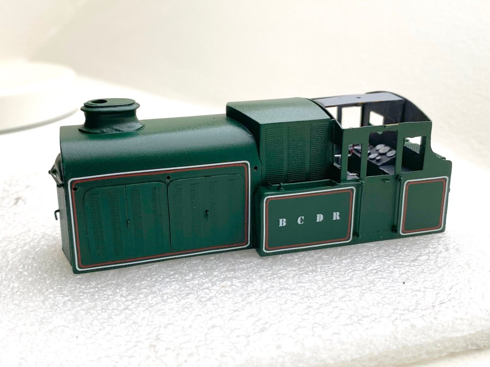

Tullygrainey Posted February 4, 2023 Author Posted February 4, 2023 A quick update. The last week or so has seen the delicate task of applying livery. This involved working without breathing. The air has been blue occasionally on this project. This time it was my face. The results aren't entirely prototypically accurate because (a) the lining is overscale, (b) there should be another white line inside the red one but adding this would unbalance it I think and (c) the lettering isn't the correct font but I hope that overall, it conveys a general impression of the thing. Lining transfers are from Fox and the lettering is from the Railtec BCDR wagon sheet. The transfers have been sealed with satin varnish - I used enamel this time! Once bitten... Onwards towards more fiddly bits Alan 9 7 1 Quote

jhb171achill Posted February 4, 2023 Posted February 4, 2023 27 minutes ago, Tullygrainey said: A quick update. The last week or so has seen the delicate task of applying livery. This involved working without breathing. The air has been blue occasionally on this project. This time it was my face. The results aren't entirely prototypically accurate because (a) the lining is overscale, (b) there should be another white line inside the red one but adding this would unbalance it I think and (c) the lettering isn't the correct font but I hope that overall, it conveys a general impression of the thing. Lining transfers are from Fox and the lettering is from the Railtec BCDR wagon sheet. The transfers have been sealed with satin varnish - I used enamel this time! Once bitten... Onwards towards more fiddly bits Alan I think the lining looks extremely neat at that scale, and the lettering looks the part. The only alternative would have been to get specially made lettering with the right shading, but at 00 scale who'd notice! Probably more important for a gauge 0 model. Overall, that loco is absolutely superb. Looking forward to seeing it operating! 1 Quote
Galteemore Posted February 4, 2023 Posted February 4, 2023 (edited) Alan - that’s simply spectacular. Anyone would think that’s a well-made etched kit. The crispness of the work shows a very high level of scratch building skill. Whatever livery inaccuracies you think are there are not at all obvious - it really looks like the prototype to me. Edited February 4, 2023 by Galteemore 3 3 1 Quote
jhb171achill Posted February 4, 2023 Posted February 4, 2023 14 minutes ago, Galteemore said: Alan - that’s simply spectacular. Anyone would think that’s a well-made etched kit. The crispness of the work shows a very high level of scratch building skill. Whatever livery inaccuracies you think are there are not at all obvious - it really looks like the prototype to me. Couldn't agree more. Superb work. 1 1 Quote
Popular Post Tullygrainey Posted February 13, 2023 Author Popular Post Posted February 13, 2023 Getting there, slowly but slowly. Buffers from Alan Gibson (4908 Early GWR Dean), Kadee couplers, Whistle from Smokey Joe, vacuum hoses from the bits box. There's a driver in there too, from Dart Castings, trying to understand the improvised controls. Some detail painting still to do. A bit of light weathering wouldn't go amiss either. Watch me wreck it Alan 14 8 Quote
