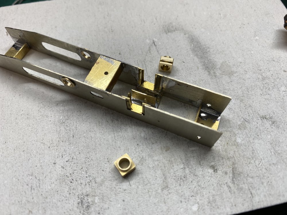

Jigs and rolling bars. There’s an answer to everything ! In all seriousness it’s nowhere near as hard as people think. You can probably get rods from a 4mm supplier. Use them to mark out the axle holes and drill. Poppy’s Wood Tech do a 4mm jig which will hold it all together while you solder it. It’s possible to get a running chassis without any fettling that way. As for boiler, brass or plastic tube if you don’t fancy rolling one.

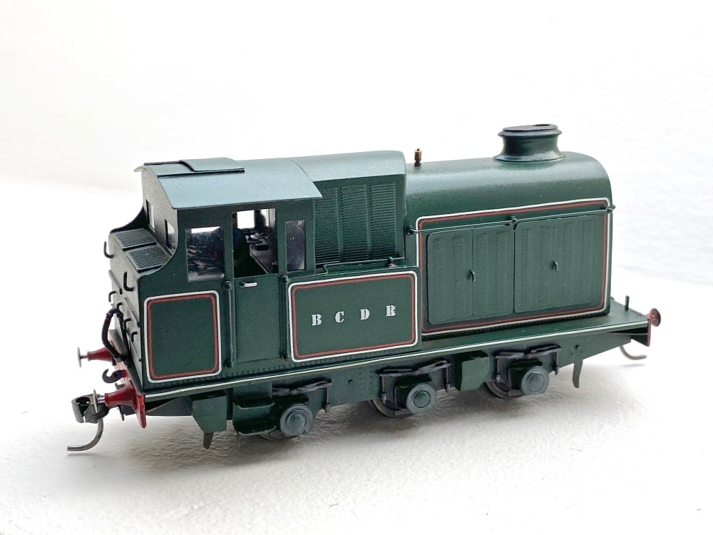

A few more pics of No 2, now weathered, and some video of the inaugural run.
It still needs a few tweaks to get it running reliably but the fitters are lying down in a darkened room at the moment. It also sounds like a bag of nails on the video - not so bad in reality 😄
The observant will notice it hasn't got any brakes. I always find those a real pain to fit. I have some tender brake shoes from Gibsons which should do the job and being plastic, they won't cause any electrical shorts, which is always a problem.
No appropriate passenger stock available for it to haul yet. Goods wagons will have to suffice for now.

You want to be well pleased with that. Beautifully finished off. It looks like a kit that you have had professionally built - inside and out.
That opening scene could almost be Donaghadee harbour siding. The noise thing seems to be a feature of the recording process - mine always sound worse too!

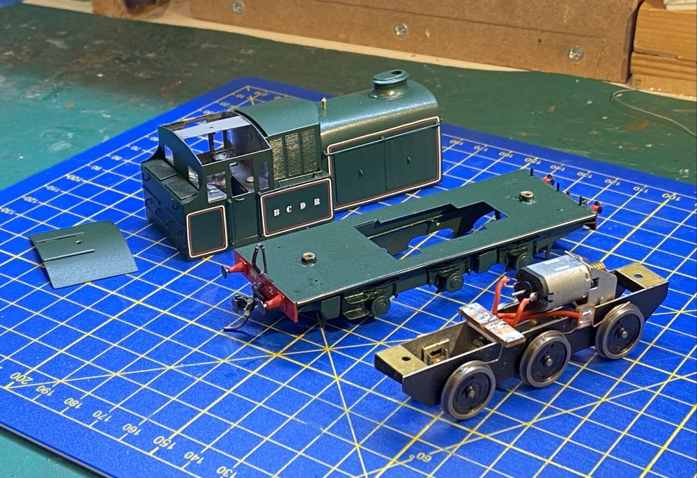

As the object of a scratch build, No 2 was probably a good choice. Chassis jigs and quartering tools notwithstanding, the lack of crankpins and rods probably made life a bit easier and the body shell has lots of flat panels, straight edges and no compound curves to speak of.
There are still a few details to add and I might consider DCCing it after it's been run in a bit though I always find adding chips a bit of an ordeal - what ran smoothly on DC suddenly starts stuttering and stalling on DCC. In truth, there's probably enough room for a sound chip and a speaker but I probably won't go there. Also, not sure what sound files you might use.

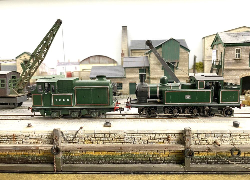

BCDR diesel electric No.2 is now DCC chipped and making friends with its new stablemate at Loughan Quay
- DCC Concepts DCD-ZN8H.2 decoder
- DCC Concepts DCD-SA3-SM-1 control board and 3 wire stay-alive
The job was not without incident. The decoder needs to be hard-wired and I only used 4 of the wires - red & black to the pickups, grey and orange to the motor. I usually trim back the unused wires for tidiness' sake. Pity I can't tell the difference between grey and white isn't it. Cut the wrong one didn't I. Bit of splicing required to get it sorted. All ok now. Until the next episode of brain fade.
Wire cutters locked away for now

Lovely picture and interesting to see how chunky the diesel is alongside 29.
're dcc, I hope things have changed since my own experiences of flirting with the Dark Side. More than a little care was needed 10 years ago, when fitting chips inside metal bodied locos. Indeed, with the Chatham Club's 0 gauge oval now running again, post Covid, found that the chips on several of my locos were kaput.
 Now converted back to DC and probably just as well I only used basic, one amp chips (Mashima motors only draw 0.25-0.5 amps), or it would have been multiple hundreds of squids down the pan...

Thank you very much J-Mo. I have to say I'm very pleased with how No.29 turned out. There were a few moments when it felt like a failed project but I'm glad we got there in the end. Both locos have the same DCC gubbins but of the two, No. 2 seems to run better - smoother start and stop mainly. A bit of tweaking needed maybe.

No.2 IS a chunky beast isn't it. All the way through the build I couldn't shake the notion that I was building it over-scale but I used the published wheelbase as my benchmark and scaled the drawing accordingly. It may have ended up a bit larger that it ought to be but not by much. Mind you all the photos of the original show a tall solid looking engine.
The DCC chips I use are shrink-wrapped in plastic (fairly common practice I think) to reduce the risk of components shorting inside the bodywork. There's still a risk from the ends of cut wires but a dab of nail varnish sorts that. I find the main challenge is finding places to stuff the chips, stay-alives and wires and then re-assembling the loco without trapping wires or dislodging carefully soldered connections. These two weren't too bad - everything went inside the boiler on No.29 and the diesel would have room for a sound chip and speaker, and probably a packed lunch for the driver.
Loughan Quay was conceived as a DCC layout hence the desire to chip the BCDR locos. However, I still have a number of kit-built shunters which would be challenging to chip, given their size. At present they chunter back and forward happily on a little auto-shuttle layout on a shelf above LQ.
