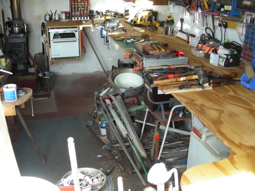

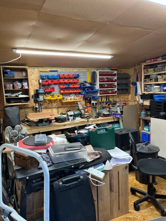

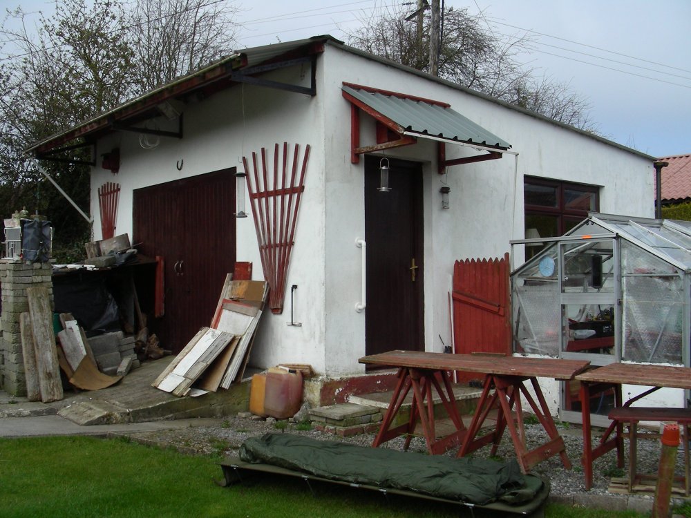

I'm (slowly) reorganising this one.
Cavity blocks and a steel roof, but I did put in an insulated plasterboard ceiling, just before the Plague hit.
Edited by Broithe
  • Like 7
A fine structure indeed. It actually looks like you'd be able to add external wall insulation relatively cheaply and easily yourself, unless it's built right up to the boundary and the neighbour would object to the overhang?
That might happen one day, but it hasn't really been an issue - the fire helps and only burns €1 to €1:50 of wood a day.
I did use it to 'isolate' for a couple of fortnights during the Plague, to avoid potentially contaminating the house - hence the camp bed and sleeping bag.
Another possibility is to 'glaze in' the space between the greenhouse and the window, there's a lot of free heat to be had there.
Baking the wood in the greenhouses definitely had a hugely beneficial effect on the efficiency.

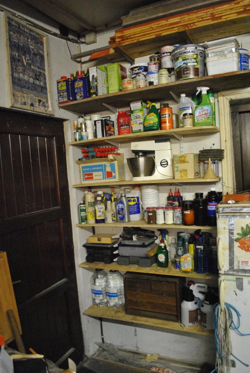

shelving storage
On the basis that there's no point having it if you can't find it, shelving has been a large part of the recent renovations.
Any area of 'dead volume', behind the door, along the eaves, etc, has been filled with shelving, so that stuff can be stored in a visible manner.
This is an ongoing project, with the intention, so far unachieved, of keeping the benches clear of tools and materials that aren't actually in use.

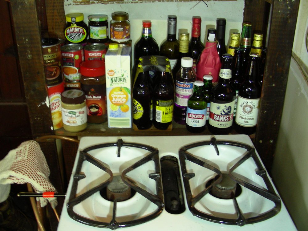

8 minutes ago, Galteemore said:
Looks good. Although if that’s an ingredients shelf above the food mixer I’d be reluctant to partake in any cake or buns at your house….
Oh, Come on, David, the mixer is for grinding up surface scatter, as recommended in all the Good Books.
There must be suitable Biblical quote, but I can't think of one offhand. (Parable of sewer, perhaps .....).
(Filling in the car parking form for Warley has addled my brain)
  • Funny 1
The mixer is mostly for the birds.
They do like to supervise the process.

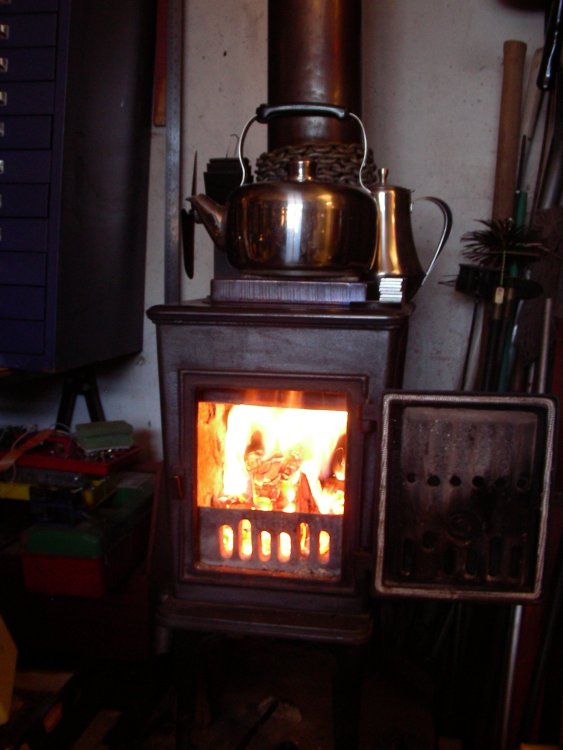

When I was living in the Shed, people sometimes commented on the amount of alcohol in the larder, but nobody ever noticed the bottle of meths in the middle.
I did build the cooker in, when the benches were rearranged, to avoid going back up to the house unnecessarily.

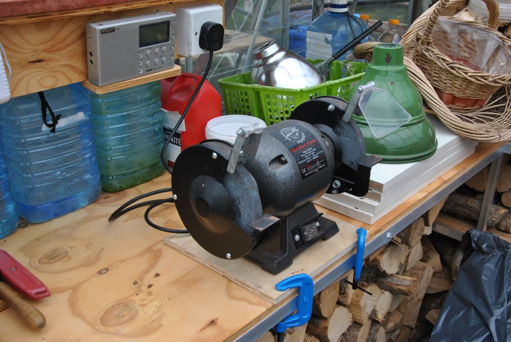

One thing I have been doing is mounting 'occasional' machinery on plywood plates, so they can be clamped (almost) anywhere when needed and stored away when the empty bench-space is more useful.
They can then be used around the main shed or in the greenhouses.
The plates have an M6 T-nut sunk flush into the bottom of the plate and threaded rod to pull the machine down firmly.

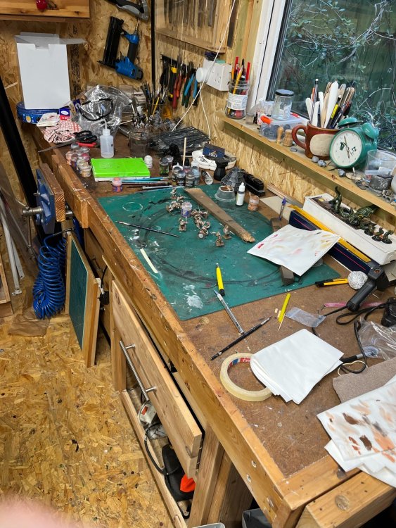

Yes I do the same, a lot of my tools are mounted on an MDF board which are clamped down like your photo above.
I use ujktechnology.co.uk T slots and clamping system on the low workbench which takes most of these mounted tools.

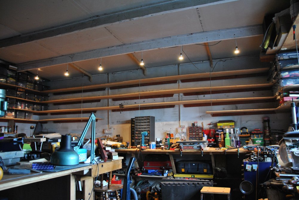

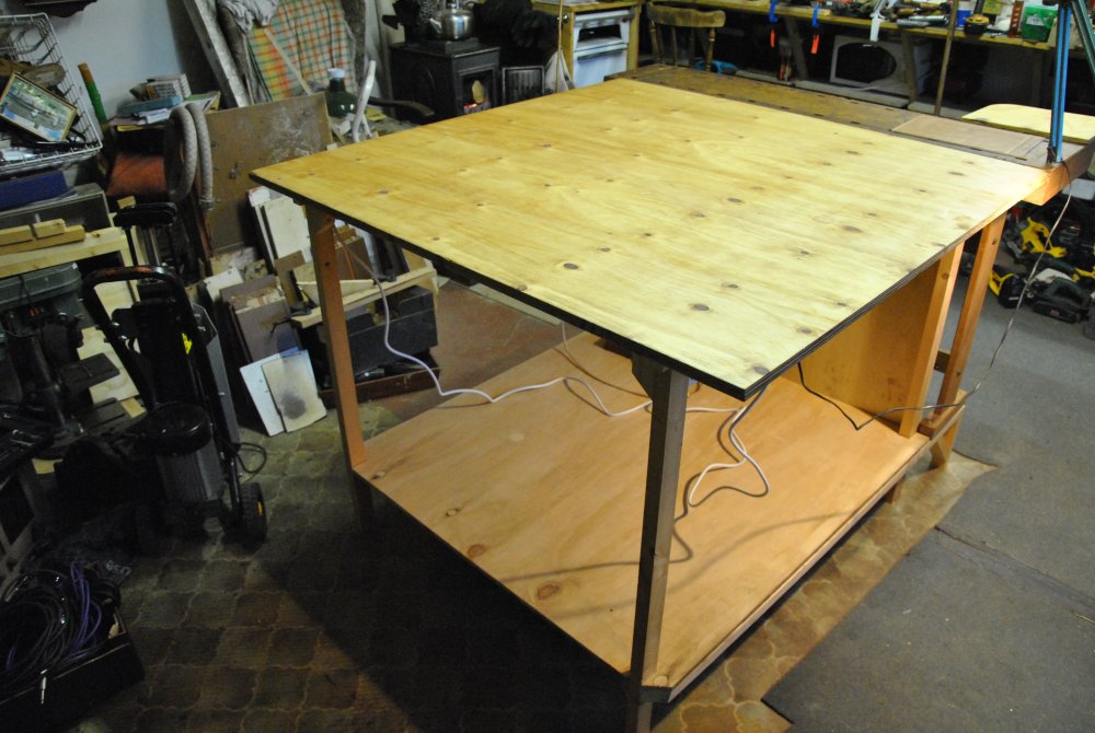

There is an island bench in the middle of the shed which is just a 'pile of stuff' at the moment. Eventually, it will have this ex-school workbench with a plywood extension behind it.
It'll be raised to the same height as the main bench along the back wall and provide a decent open workspace.

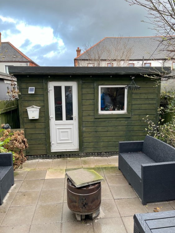

Photos of the 'Shelving Shed'
It's your common 2.4x1.2m timber garden shed with tar sheet roof, tight headroom and a 'Duck' door head.
All the timber was liberally oiled with Creocoat and then a few mods were made.
The floor was insulated with aeroboard and silver stuff- the floor is upside down in the photos.
The ground was prepared by removing the sod, levelling with gravel, installing level bricks with a bit of dpc stuck on top.
Floor down sitting on the dpc/bricks.
The walls up, their sitting on a dpc dressed down over the floor and will be carried up the inside of the walls. the walls were screw fixed with galvanised steel L brackets- so easy to dismantle if needs.  I added a few roof frames to give extra support to the roof- these type of shed roofs always droop in the middle!
Aeroboard being installed in the walls. Not much room here, I want an air gap behind the wall sheeting so I installed 12x12mm strips adjacent the studs and then fitted 18mm boards on top of the strips- flush with the inner face of the studs.
Silver stuff was then installed on the walls, the ceiling will be later as I am insulating the roof on the outside and finishing with corrugated iron sheeting, so holding off silvering.
Shelving going in,
Yet to do the electrics and the roof......
Eoin.
Edited by murrayec
  • Like 7

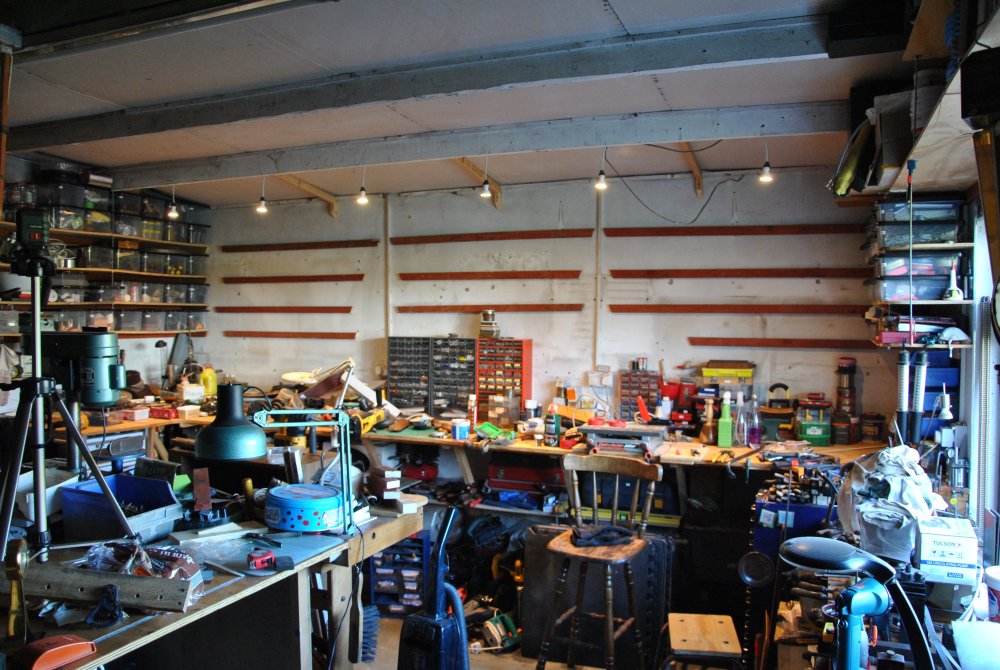

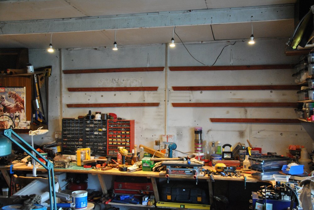

The rebuild of the centre bench is (mostly) done. There will be some additions to the storage zone beneath the top at some point.
It's at the same height as the bench along the rear wall, which has proven itself to be 'right for me' and it means that big stuff can be laid across the gap between the two, if necessary.

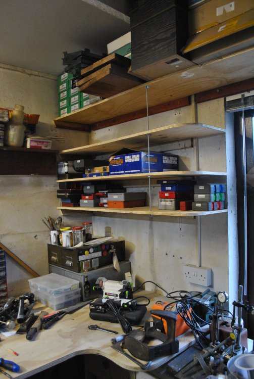

I've moved onto the run of shelving along the back wall. This is not straightforward, for various reasons, but it is progressing in stages. The battens are up for the right-hand half. I need to produce beams for the hangers and relocate some of the electrics now.
I replaced the fluorescent tube with six 5W GU10 LEDs. A better spread of light, a nicer colour and a 'floppy hang', if they do ever get hit by anything.

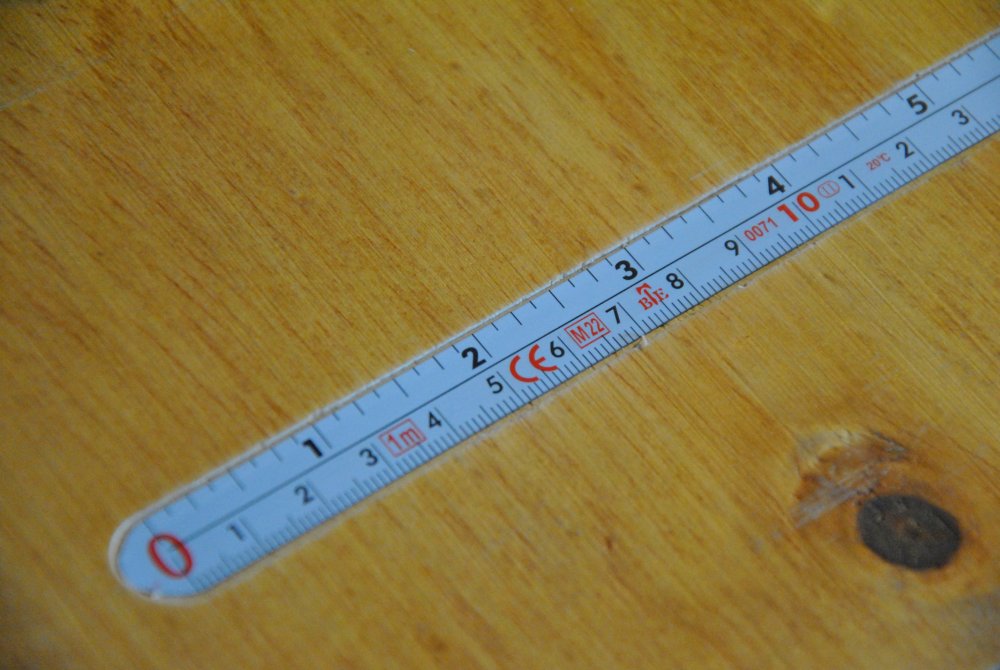

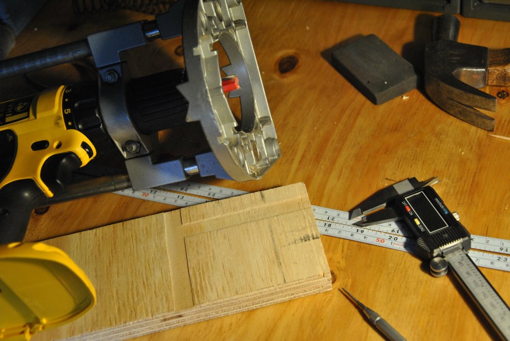

I did get a laser cross-beam projector level from Lidl and it has proven to be a God-send in all this work. Well worth €30 in time saved and cock-ups averted.
Lidl also had some self-adhesive steel metre tapes. Having one mounted on the bench seemed a potentially good idea, but I felt that it needed to be 'inlaid', rather than just stuck on the surface. I have some router bits here, but the router itself is 200 miles away. However, I managed to codge up a device to do the fairly lightweight job - from a cordless drill and a Wolfcraft drilling jig. Used with care, it did a better job than I expected.
I only needed a half-inch wide groove by about half a millimetre deep. This was done with a 12mm cutter, so it needed a slight nudge sideways for a second pass for the required width.
It all worked well and the tape is installed now.

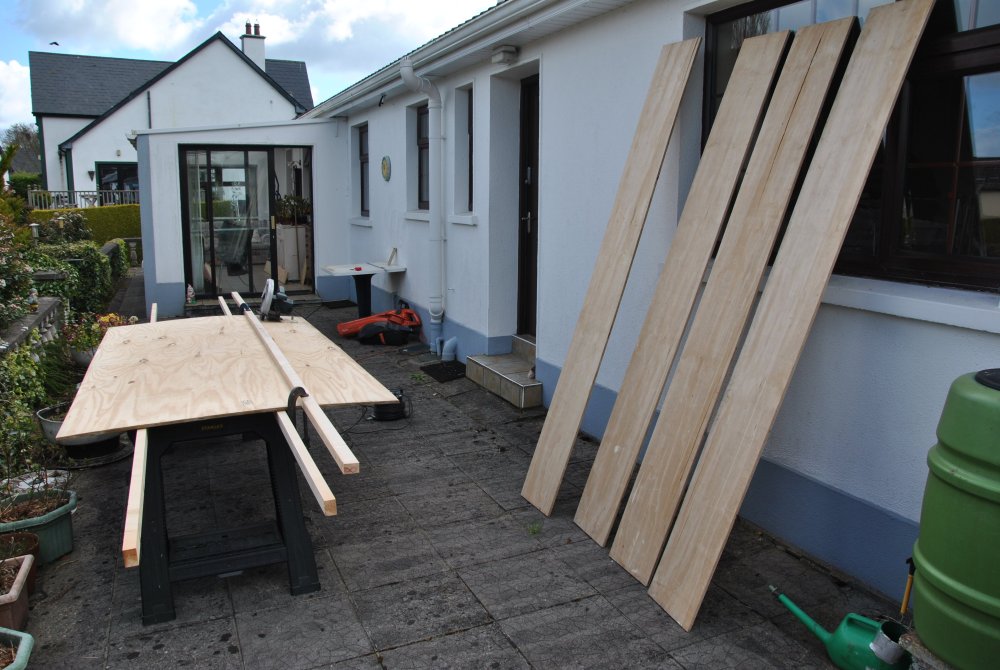

After the apocalyptic weather yesterday, today was nice enough to slice up the sheets for the shelves - outdoors, a much less messy location - just blow the sawdust away.
I removed the chipboard cupboard that has been there for 25 years and attached more battens, plus the hanging rods to support the front edges of the shelves.
A little trimming, a few suspension holes and cable notches, then the shelves could go up - an intricate sequential operation, but it was achieved with no great mishap.
There's still a bit to do - plates to stiffen up the joints between each panel, trimming the suspension hangers and moving the sockets, so the drawer cabinets can fit the space better, etc.
But, I now have another fifty feet of shelving, that should do for now.

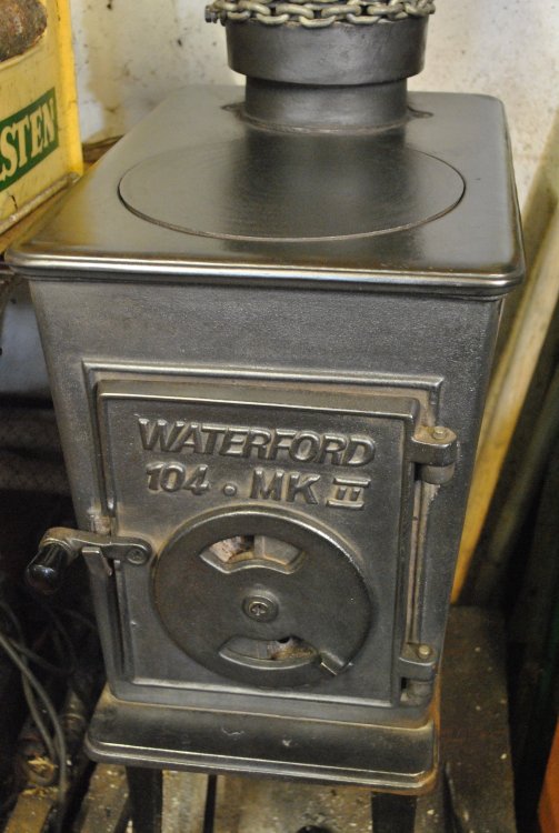

19 minutes ago, WRENNEIRE said:
You haven't lived unless you had one of these
Made the best toast ever, just plank the slice on the top mmmm.......
Could do with a lick of Blacklead.
Jaysus Dave that pipe looks a bit askew 🤭
  • Funny 2
Toast done with a toasting fork + butter and local honey.
This is from the time of using the shed to isolate during the early days of the Great Plague.
I also did cheese on toast, but the cheese bit was done under the grill on the gas cooker.

I eventually got the insulation and corrugated sheeting on the roof of the 'Shelving Shed';-
The roof was extended out to give a bit of porch cover to the door for those rainy days. The locking and hinge system was also upgraded for better security.
The timber purlins were fixed down on top of the existing tar roof finish, 80mm thick styrene insulation was installed again on top of the tar sheeting, then the corrugated sheets. Timber barges and eaves are next, there will also be metal barge pressings when the timbers are done.
