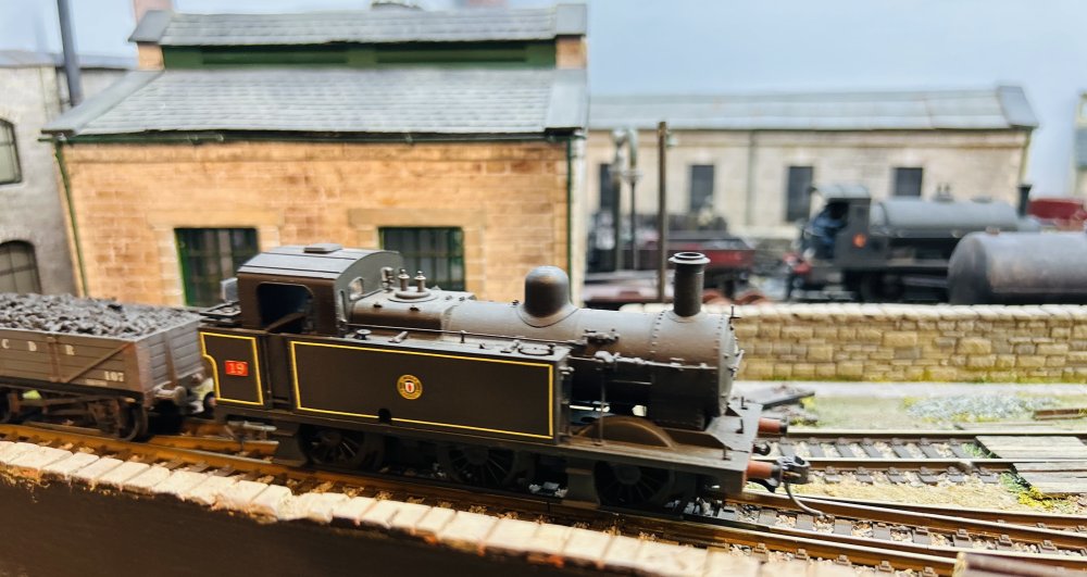

Now NCC No 16...
More plastic card and brass wire. Even more butchery...
The starting point, an unsuspecting Hornby 0-4-0 Pug...
I used 10 thou plastic card to wrap and extend the tank  - easy to bend and glue down.
L&Y Pug chimney (LYR0001) from Wizard Models. Dome carved from dowel. Archer rivets. Can't remember where the buffers came from.
Now the chassis. Plastic cylinders cut off. Connecting rods trimmed and drilled for 12BA bolts. New conrods and slide bars are Hornby spares (Ref: X8834W)from Peter's Spares.
New cylinders cut from the plastic barrel of a disposable propelling pencil.
And some weathering to finish. A scratch build might have been easier! Certainly more accurate. Next time 😄
A Branchlines replacement chassis would be a good long-term upgrade for No16.

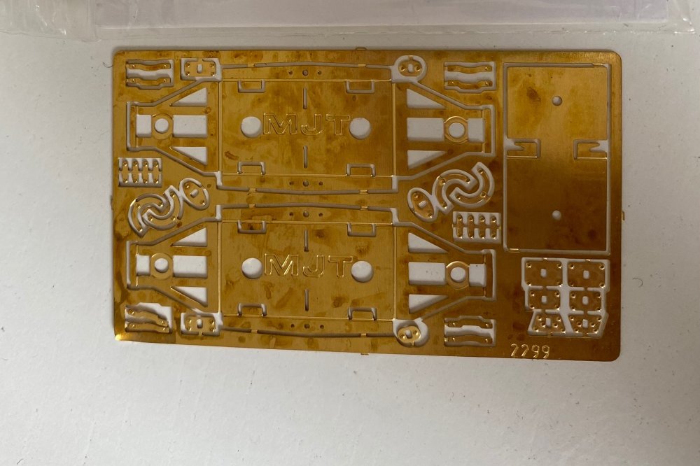

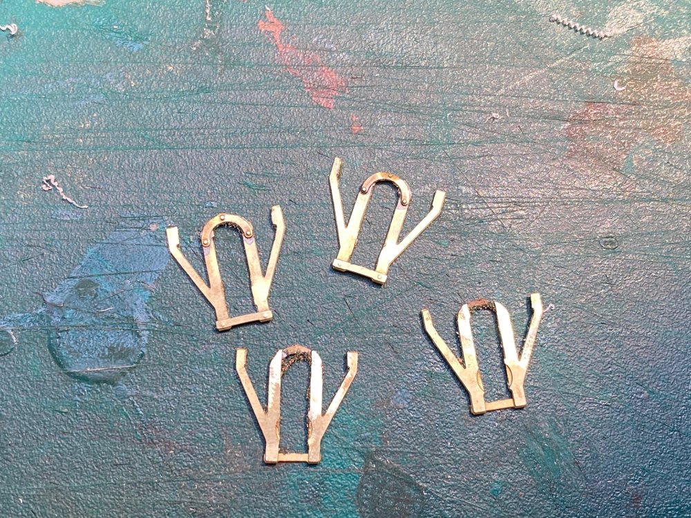

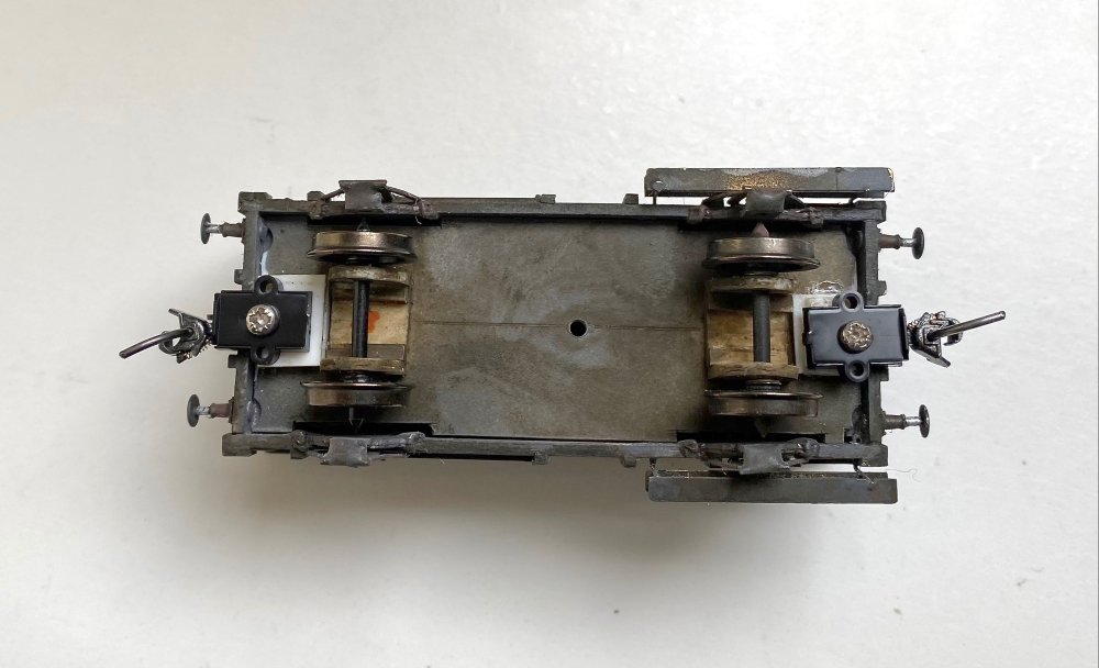

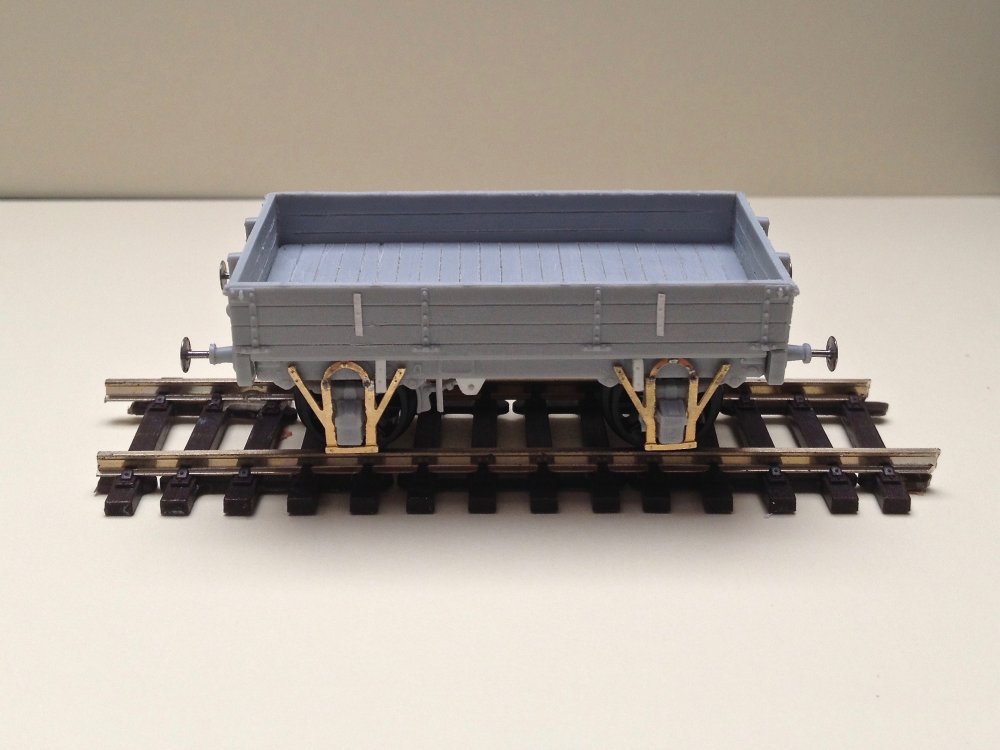

Some more info Patrick. Starting with the outside W Irons.
I used MJT etches from Dart castings to make these. The one to choose is 2299 Compensating Wagon W Irons (RCH/GWR type) which has the horseshoe shaped bits needed. The pack comes with 4 of these etches if memory serves. Only some of the parts are used.
Some delicate 'editing' of the required bits and a touch with a soldering iron gives you this...

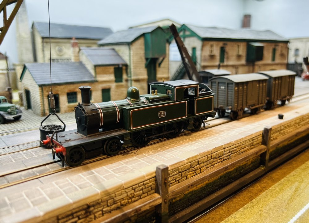

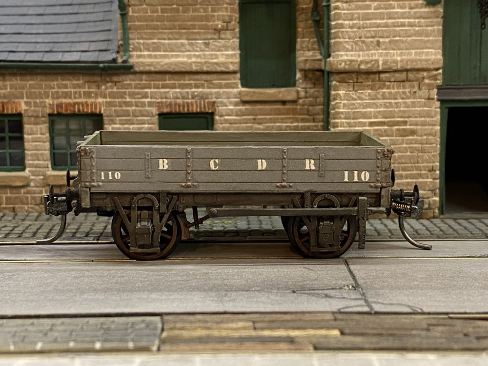

The open wagons were the easiest to do -  a kitbash of the Slaters 4mm Midland Railways 3 plank dropside (Part no: 4029). Just glue the new bits on...

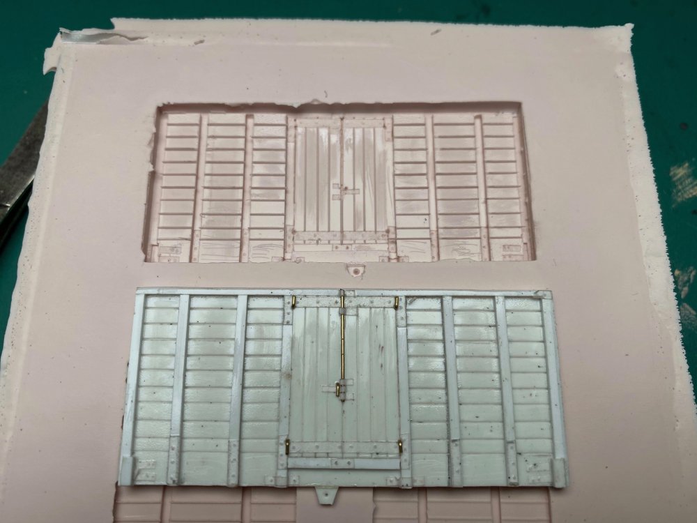

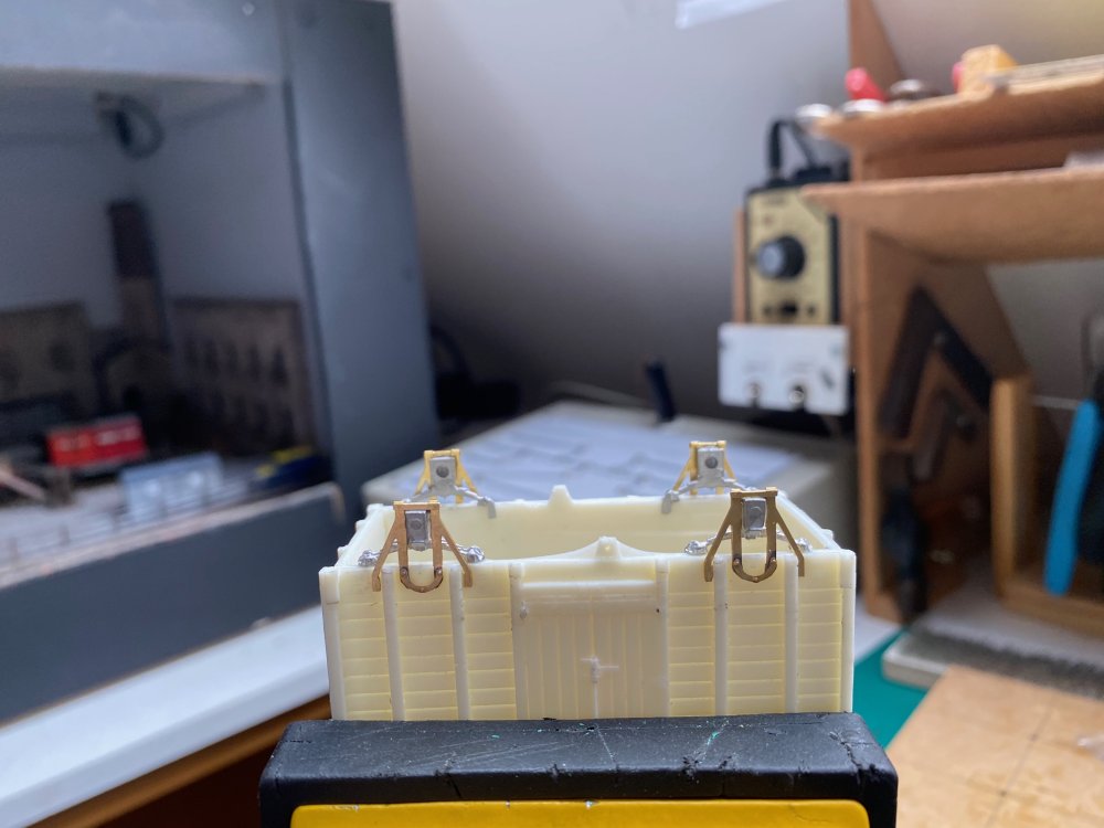

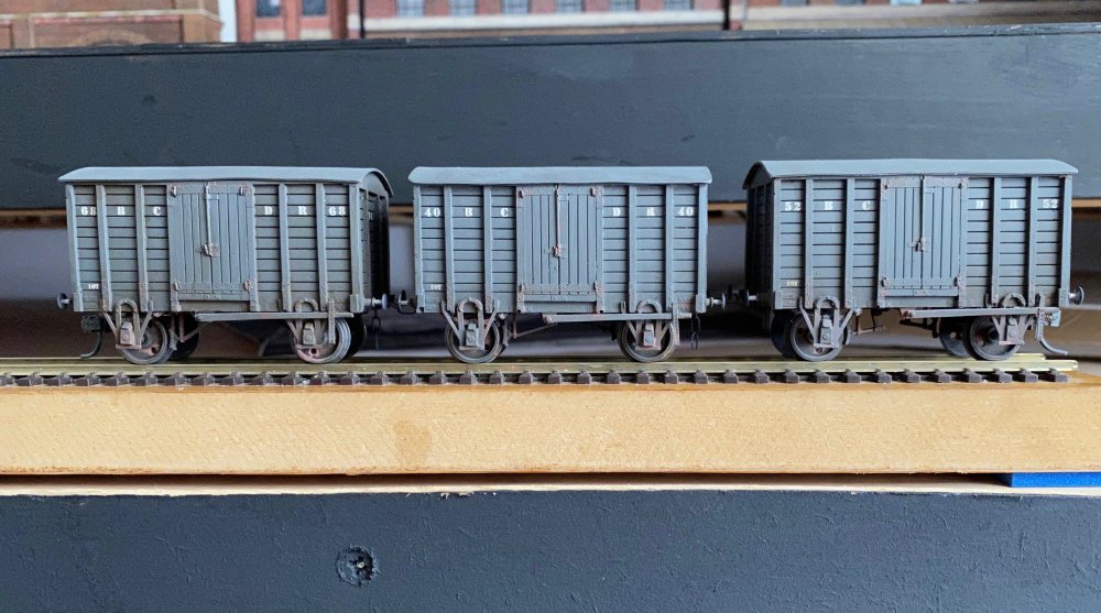

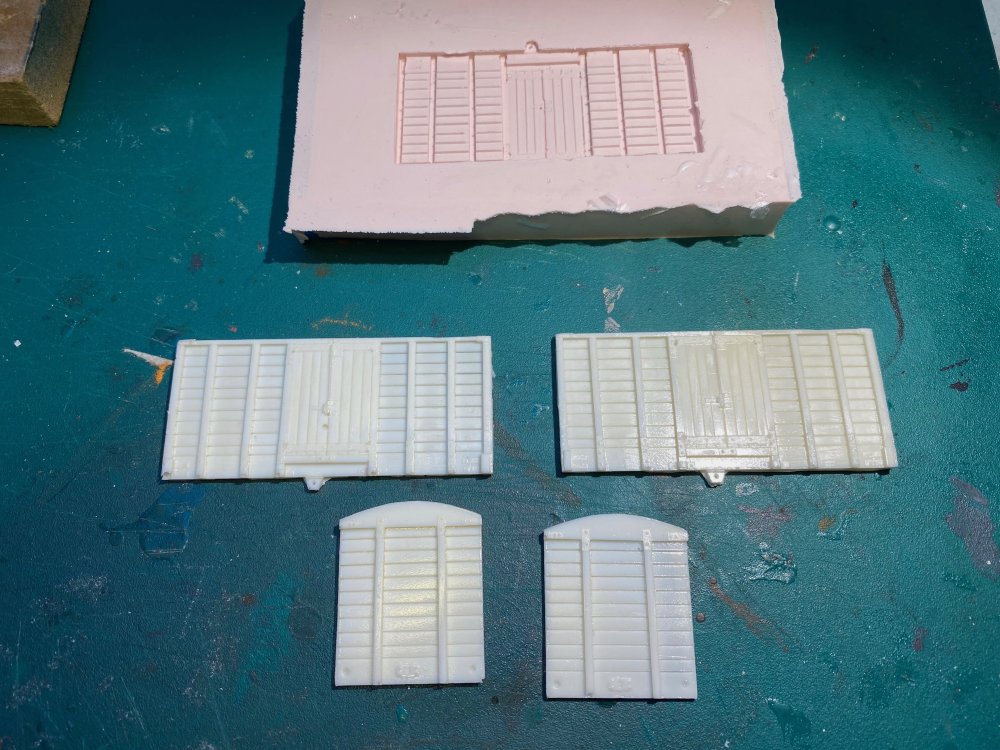

The covered vans are based around resin casts from a master made with scribed plastic card, 1.0 x 1.5mm plastic strip (I used Evergreen 143) and 0.45 brass rod. The various brackets and strips are made from bits of sticky address label with rivets embossed.
Here's the master for a side and the silicone mould made from it...
And here are the resin casts for one wagon...
For springs on these, some MJT white metal castings (MJT 2249: Midland Axlebox with spring); Everything attached with epoxy.
The underpinnings are a bit primitive. Because of the dimensions I used for the ends, the standard 26mm pinpoint axle isn't long enough to reach the axleboxes.
This is the brake van. No brakes yet, bit of an oversight in a brake van 😆
On reflection, it might be better to make up longer axles from 2mm rod and grind pinpoints onto the ends. If I'm honest these guys look better than they run.

Haven't done any resin casting for a while, but as Alan clearly shows, putting a bit of effort into making just one side and one end soon reaps rewards. Last time I looked (admittedly pre Covid), a kit cost about 30 or 40 quid. This includes the two part resin, plus the silicon goo to make the moulds. Probably enough for 20-50 wagons depending on scale, so ultimately good value and potentially a fair bit faster than 3D printing - ideal for a Luddite like me!

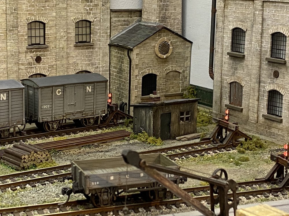

Unbelievable work here Alan. The level of detail is mindblowing. Just wondering where you get your figures, particularly the three lads beside the C N wagon. (One with a mug of tea in his hand). Also , your company signage. Are the signs handmade or made to order, as you mention that they are named for your four great Grandfathers.? If handmade, fancy sharing techniques?. Thanks and well done again
Link to comment
Thank you Derek. Most of the figures on the layout are from the Monty's Models range sold by Dart Castings. The bloke leaning on the doorframe with the tea mug is MSV27: Worker (maybe he does work, sometimes. I've never seen it😄), the fellow with his hands in his pocket is MSV10: Porter (another busy individual) and the lad in the uniform is from one of those 'station staff' packs from Bachmann (I think)
The signage was all done on the computer using a word processor, in my case 'Pages' on an Apple iMac.

Really amazing stuff Alan!! Do you mind if I ask what (brand? I guess) you used for the mold and resin casting? I’ve been thinking of doing something similar but I’ve tried resin casting before (with non-train models), with mixed results.
Many thanks JBG. I used stuff from the Polycraft range which I bought on-line from MBFibreglass (www.mbfg.co.uk). They sell starter kits in various sizes with everything you need. I've no connection with the firm except as a satisfied customer. I found it fairly straightforward to use and it did what I needed it to. The components are mixed by weight which is easier that working with volumes. I used a small set of digital kitchen scales which were perfectly adequate for the job. Good luck if you have another go.

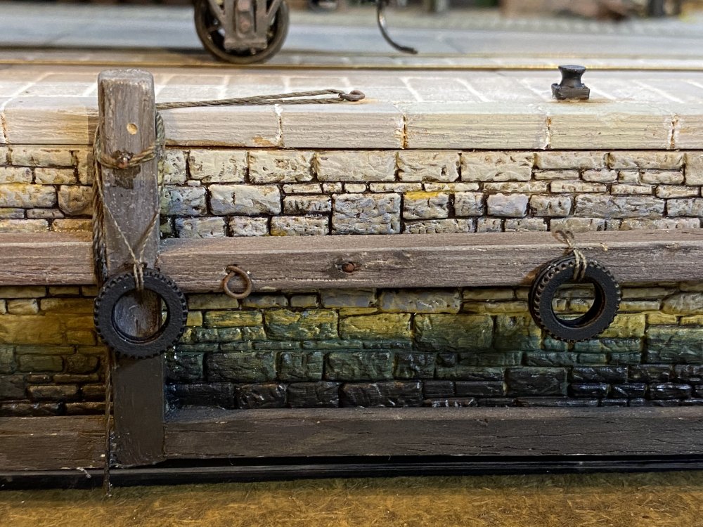

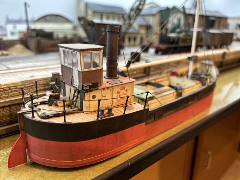

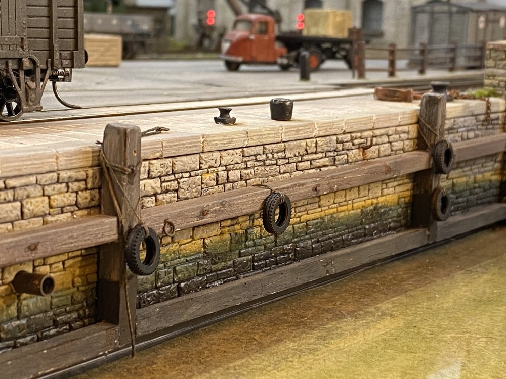

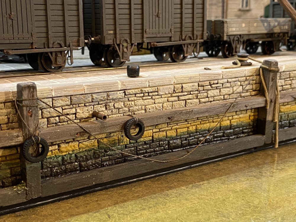

 I always felt the quayside at Loughan was a bit too pristine for a working harbour so it's been cluttered up a bit...
The good ship Wild Rose seems to have drifted off. That'll teach them not to tie her up properly.
A few more hidden corners round the back. Nobody about. Must be lunchtime.

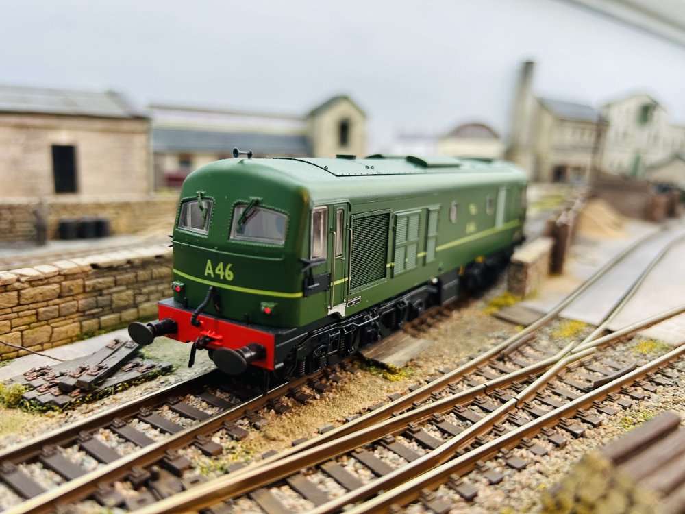

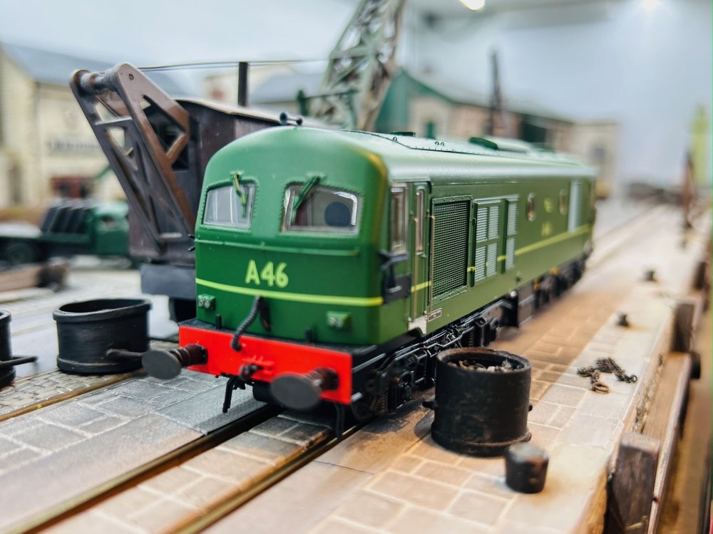

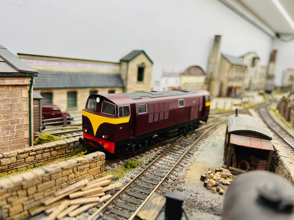

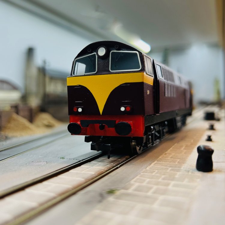

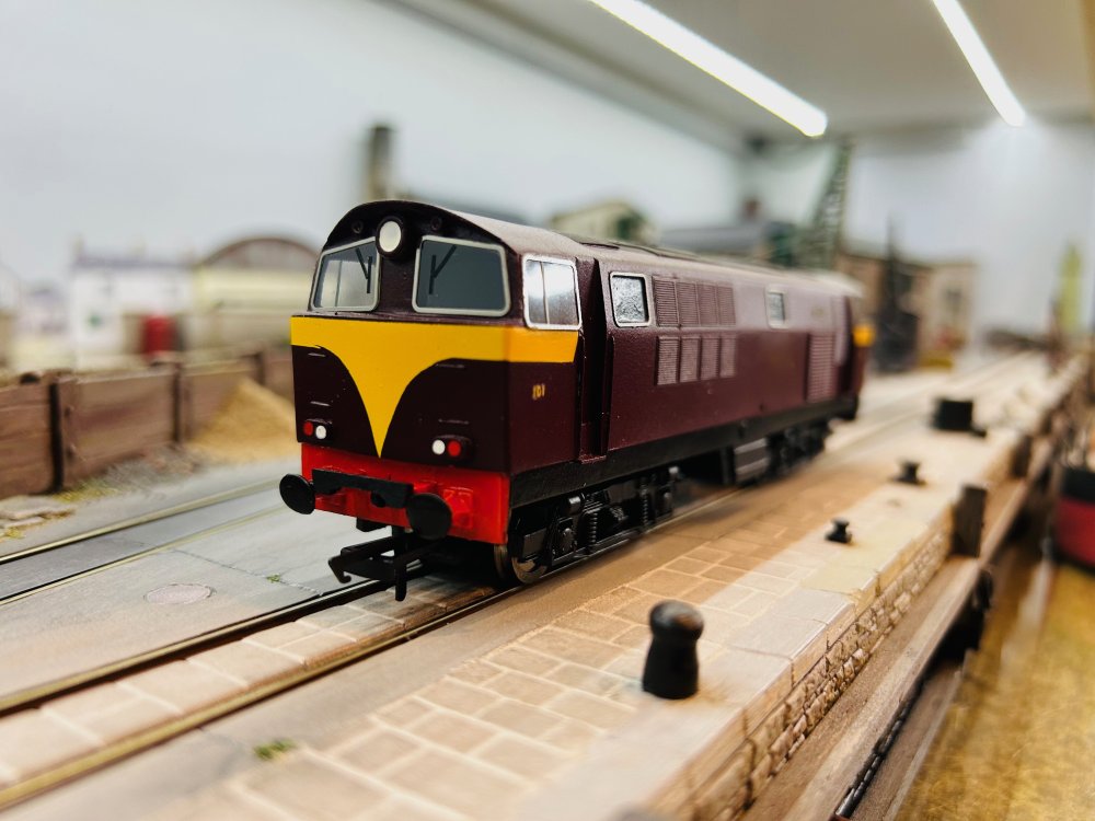

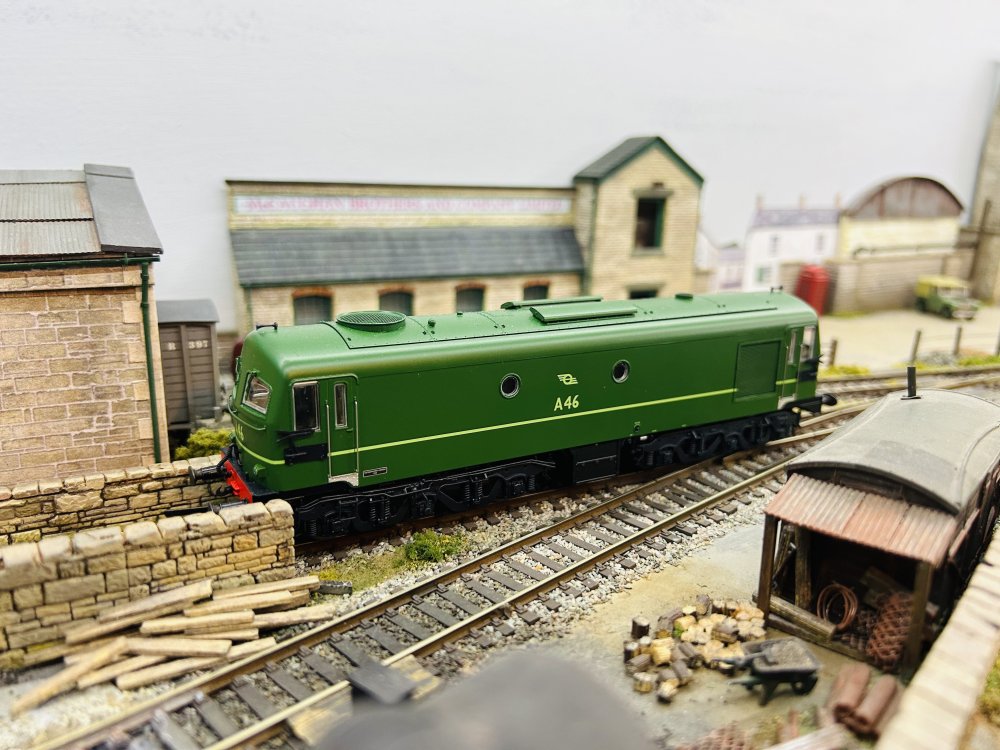

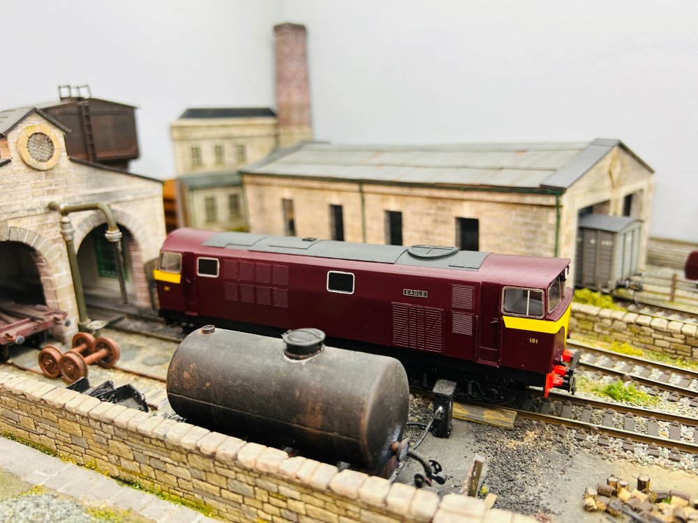

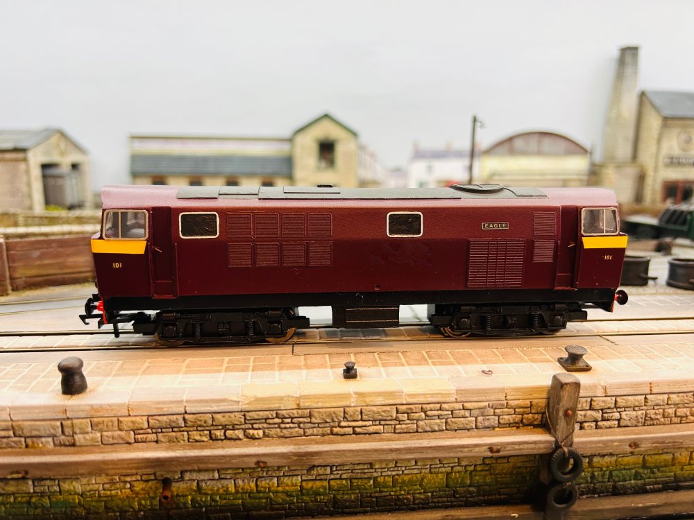

If the BCDR main line had survived into the 1960s, then the new CIÉ diesel locomotives may well have appeared at Loughan Quay:
(It might have been possible for a new A class loco to have reached Newcastle (Co. Down) - the locos started arriving in Ireland a few months after the GNR closed the line to Newcastle in May 1955 but presumably the track was still intact during the rest of 1955 at least, so it might have been physically possible......?)
And with even more of a stretch of the imagination, had the line survived into the 1970s then NIR's Hunslet locomotives may even have reached Loughan Quay as well:
With thanks to Alan for welcoming these unsual visitors to his absolutely stunning layout!

I have used resin from Alex Tiranti , bought as a kit and found both resin and rubber had/have a very long shelf life.  I also found you have to be prepared to throw away unsatisfactory castings or repurpose them as grounded bodies. I also found a mix of thin superglue and talcome powder is good for fixing small holes etc;
