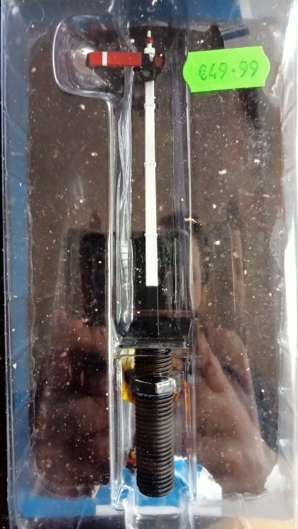

Would anyone know if the motorised signal I got from dapol would work with a z21 signal decoder. I'm trying find out if it has momentary switching in the z 21 signal decoder so works with the dapol motorised signal.
I haven't bought the decoder yet.
Don't know about that decoder. The problem with the Dapol semaphores is the momentary switching as you mention. There are some fixes for this.
MERG has a replacement PCB that changes the operation so you can use a toggle switch. You need to be a MERG member for this and capable of soldering SMD components. I have converted two of these signals so I can testify that it is not too hard to build.
I have seen a kit that uses a toggle switch as input and does the momentary connection for the signal when the switch changes. I think this was from Heathcode, but I am not sure. Problem here is that the unit can get out of sync with the switch.
Dave Fenton of Megapoints produced a Youtube video where he replaced the motor part of the semaphore with a servo. Then he could control the semaphore from his servo controlers and get a nice bounce effect.
